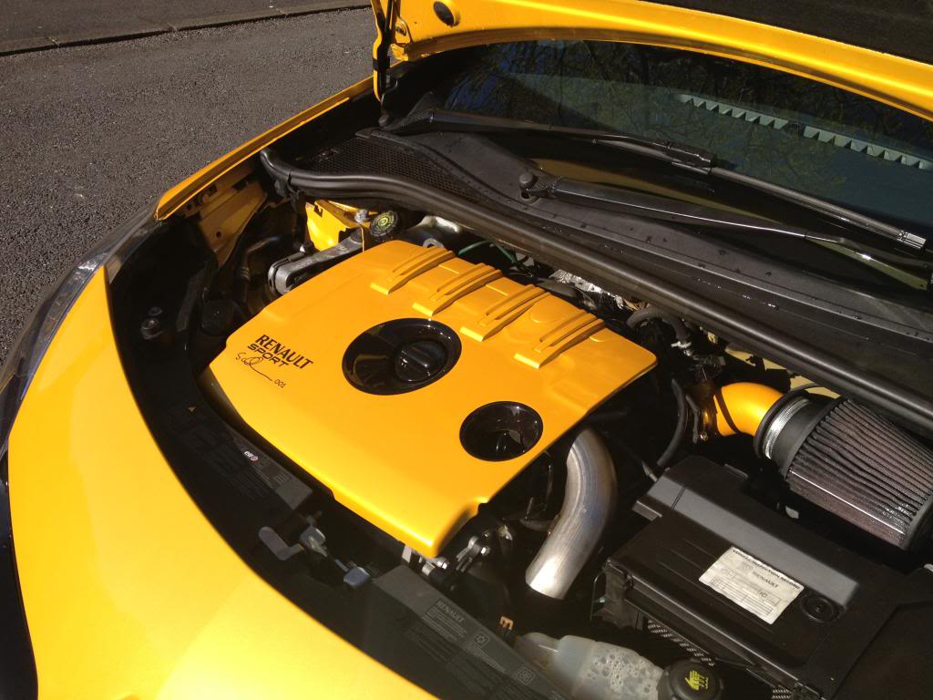

Any pics of the small rad and where it is installed?
Not fitted it yet...

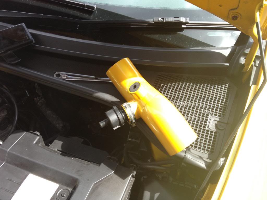

Heres another pic....
