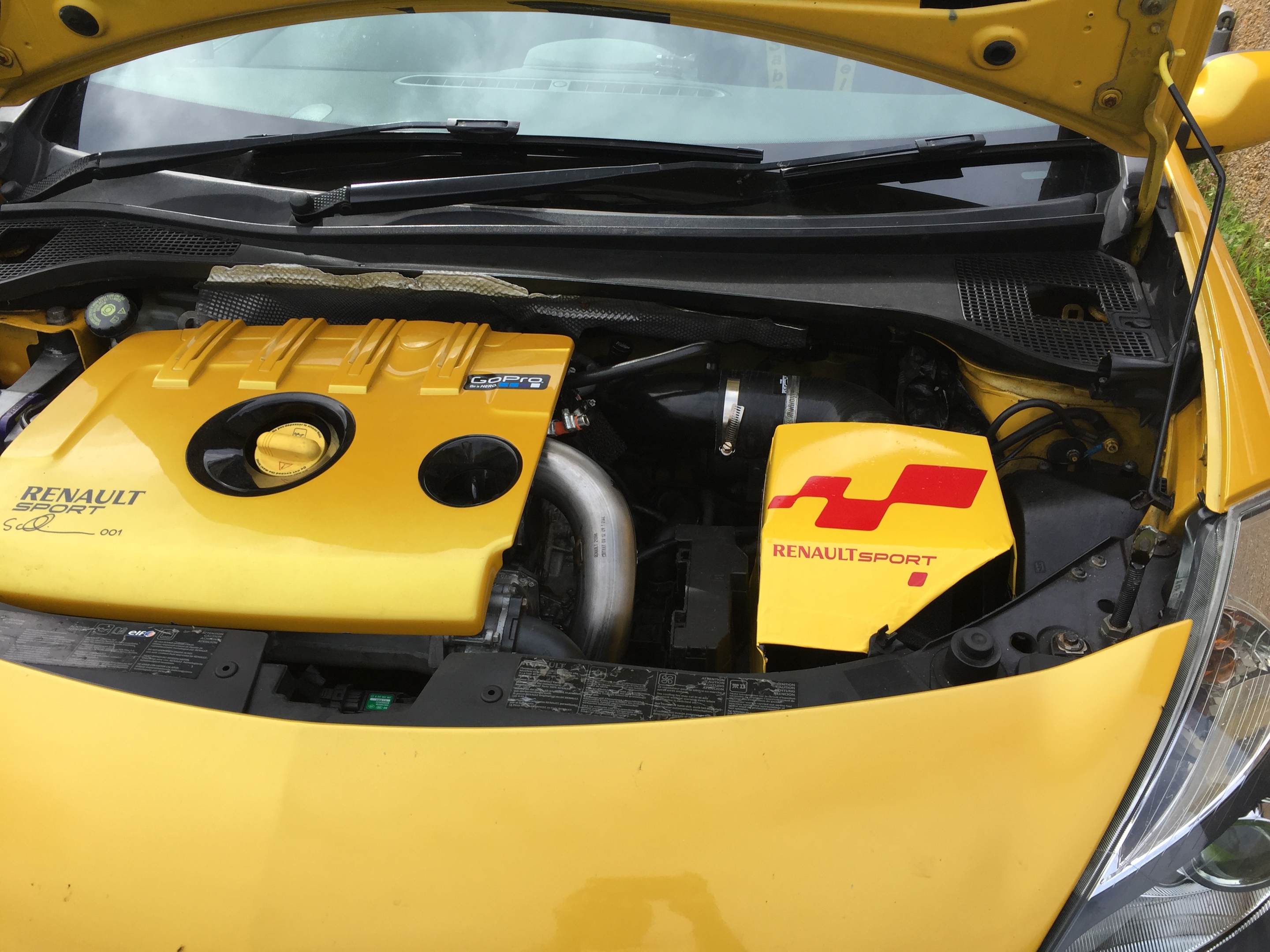

Wilson sold it to Glen, who sold it to me. When I purchased it, it was in a very sorry state, torn recaro,bald tyres, cracked, and very badly repaired alloy wheels, leaky rad,going into limp mode, and a standard 250 map on it, to try and cure limp mode.(It Didn't !.)and far too many things to list. Now,after many months, and about 60 odd jobs,doing everything that needed doing, including RST putting the map back on, the car is where it deserves to be. This car is a keeper, and an absolute pleasure to drive. First test,Cadwell, 1st September.

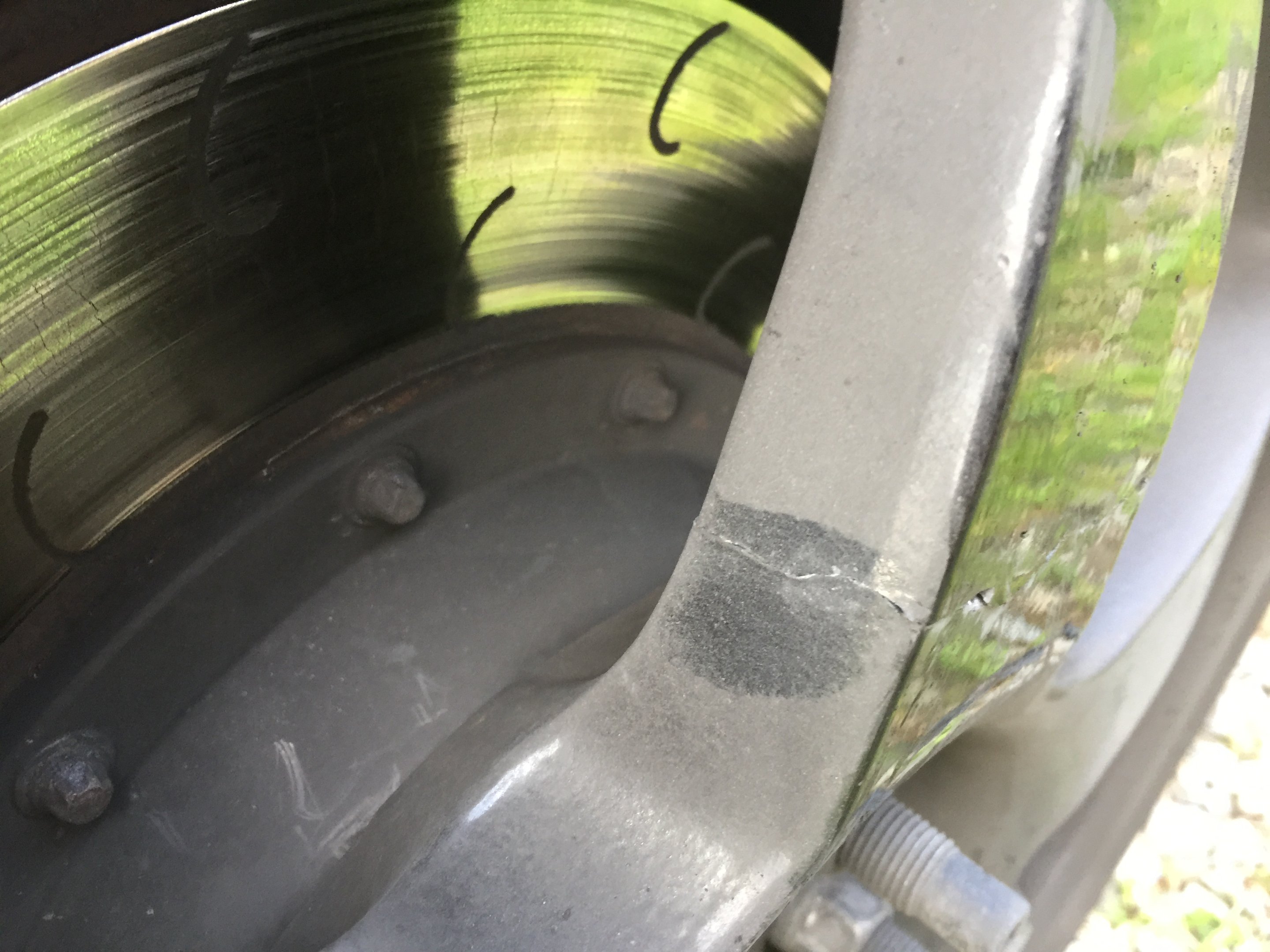

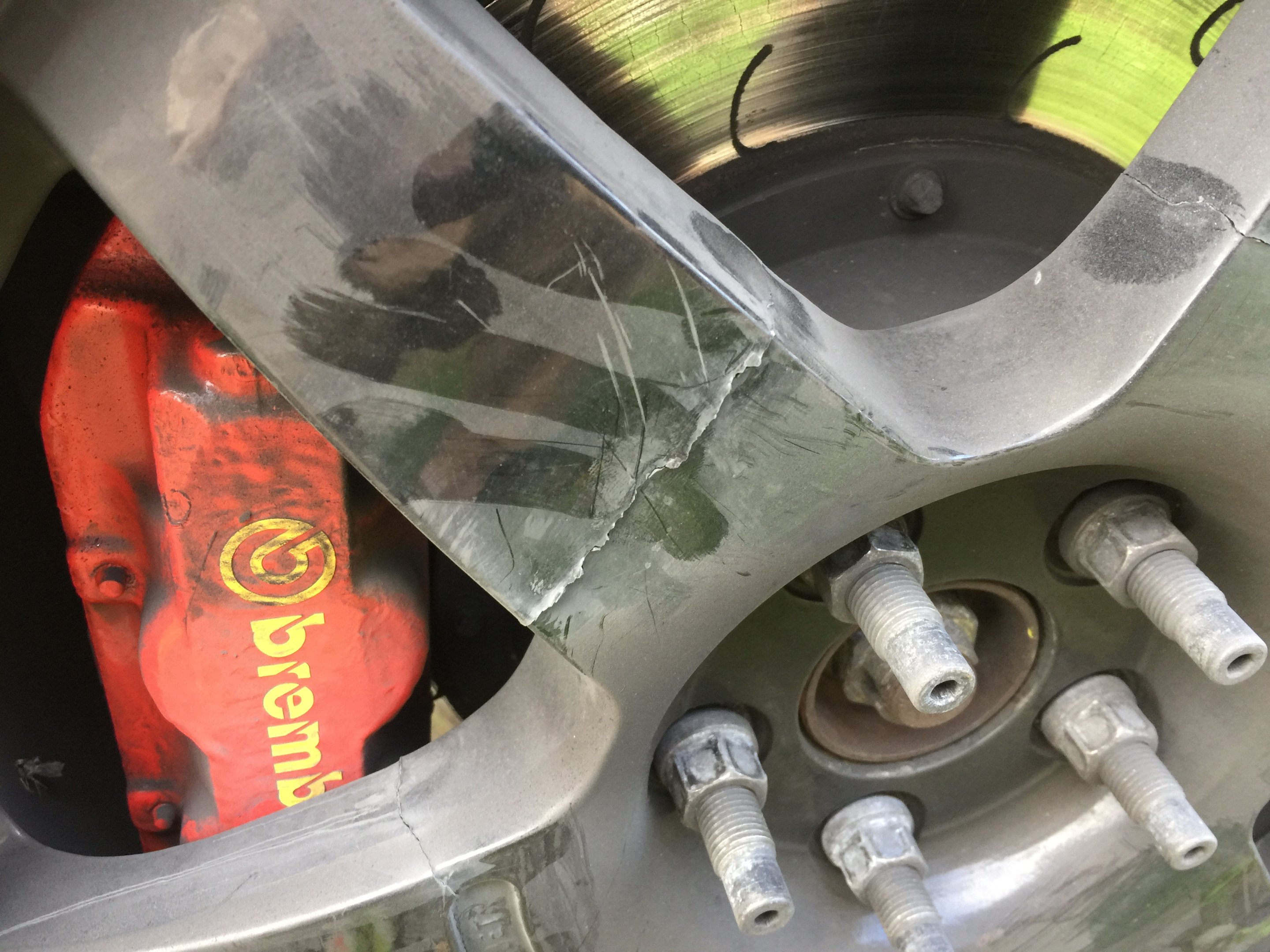

Anglesea July, this broke. Water pipe from Turbo, was joined in 3 places, instead of one pipe.This part snapped, being a plastic insert, inside a plastic insert, thus strictly reducing water flow!!. Problem was fixed at track, thanks to a few strangers who popped in and ended up with dirty hands!. Battery now in boot, two solenoids replaced, new Map sensor. Rear inner strut brace removed. It was held in by a top bolt on the drivers side, no bottom bolt, due to one already broken off in the hole, a bolt, but no thread, on the top passenger side, and no bottom bolt. This is typical of the build quality that was done. I could write a book, on all the faults. We will ignore the cracked, badly repaired alloys that finally failed at
IMG_2115.JPGIMG_2117.JPGIMG_2137.JPGSpa, BUT car is now as good as it can be, and for me, well worth it.
