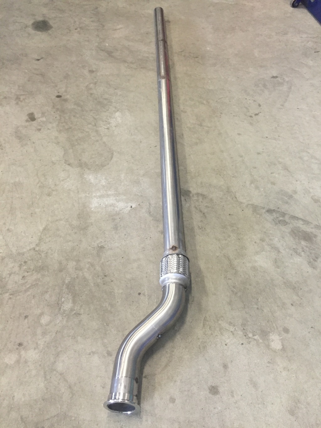

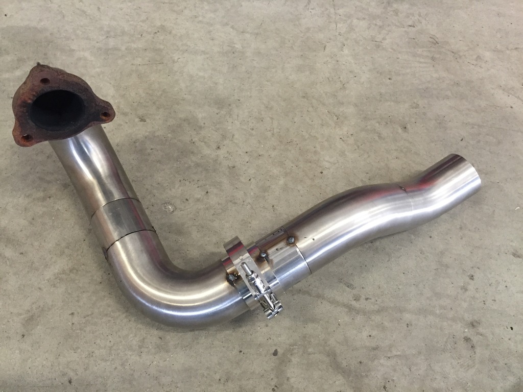

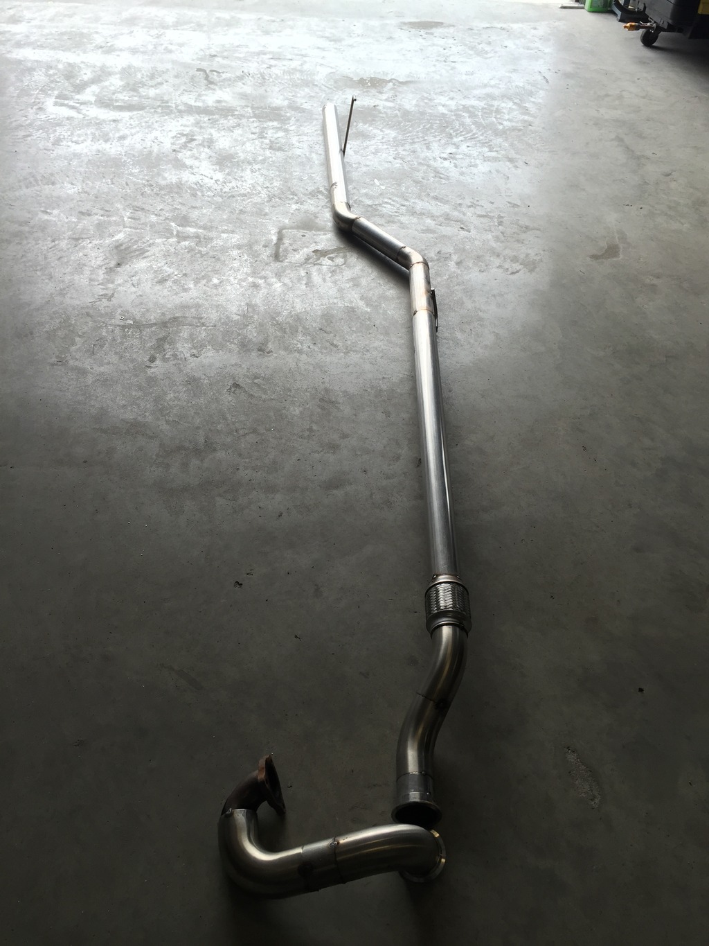

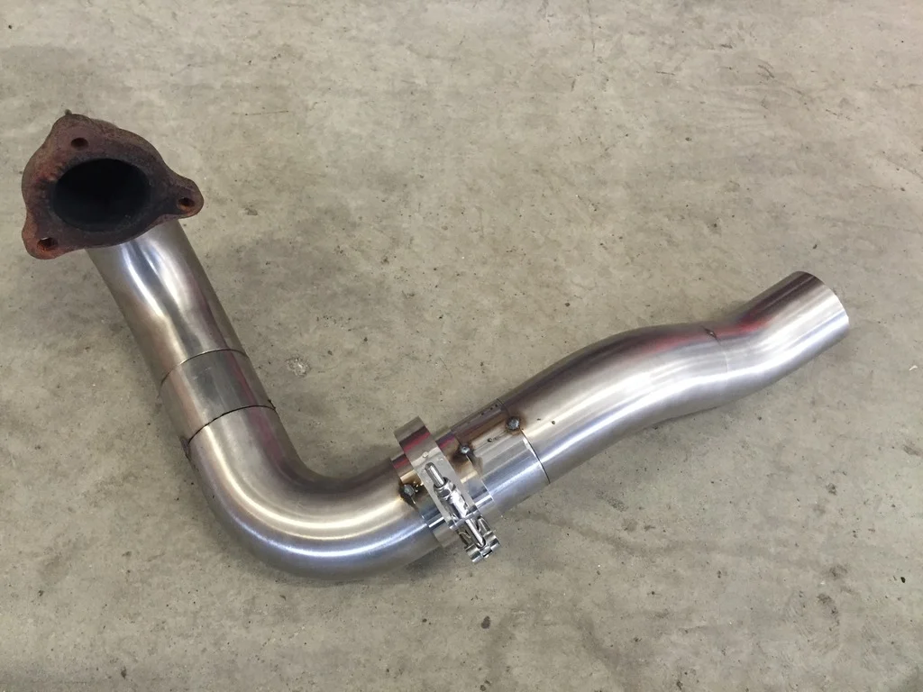

Couple of pics from when I was building the exhaust...
I didnt get any pics with it welded, but its been on for a while now and its perfect. I could do with sorting a tip out, but I'll leave that for now as it'll act like a megaphone, on a already 95/97db exhaust lol.

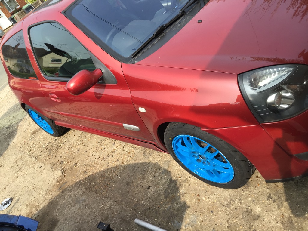

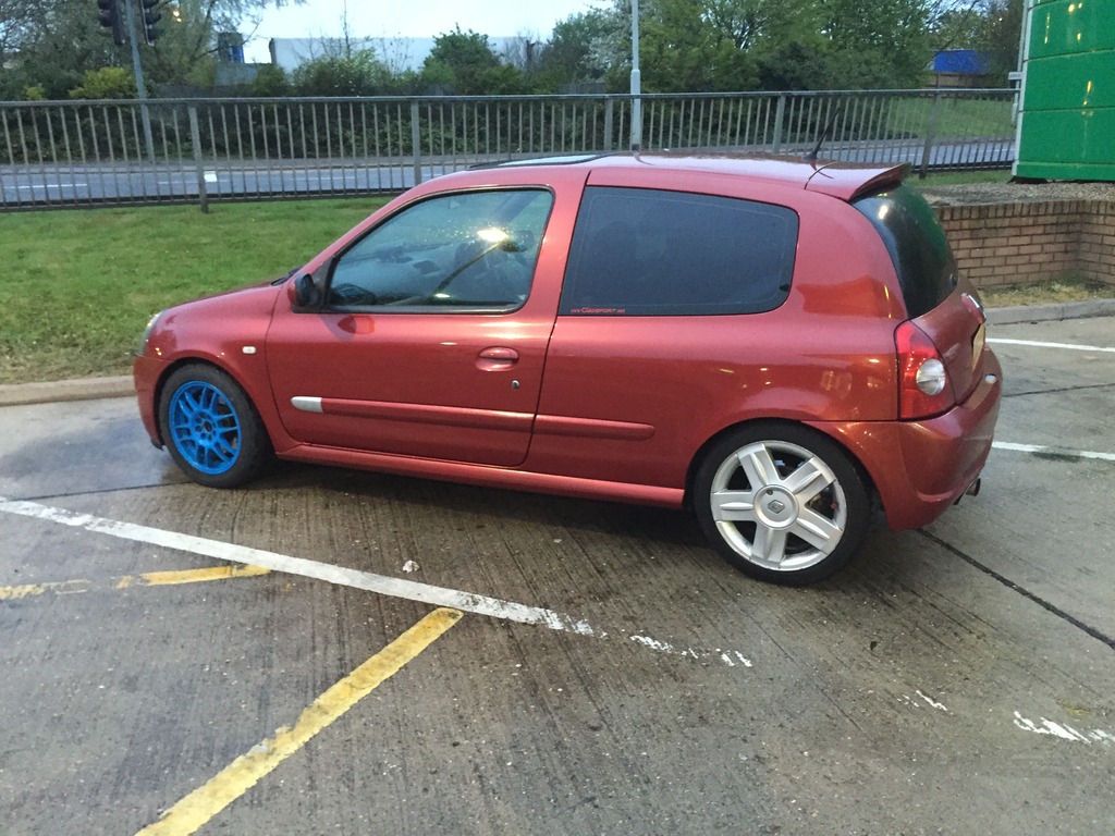

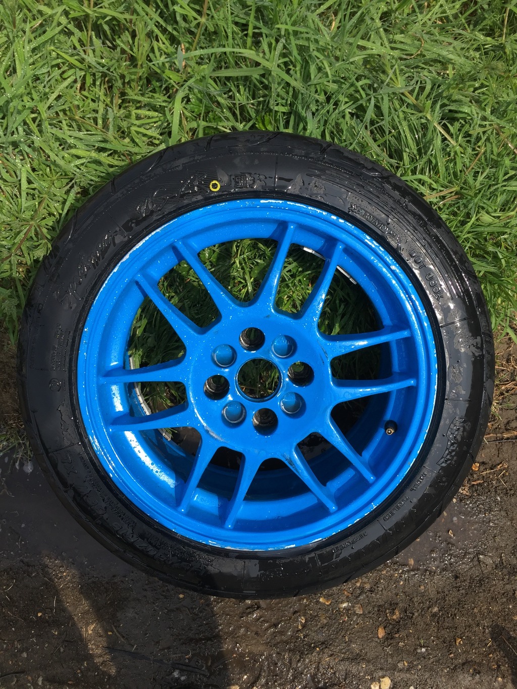

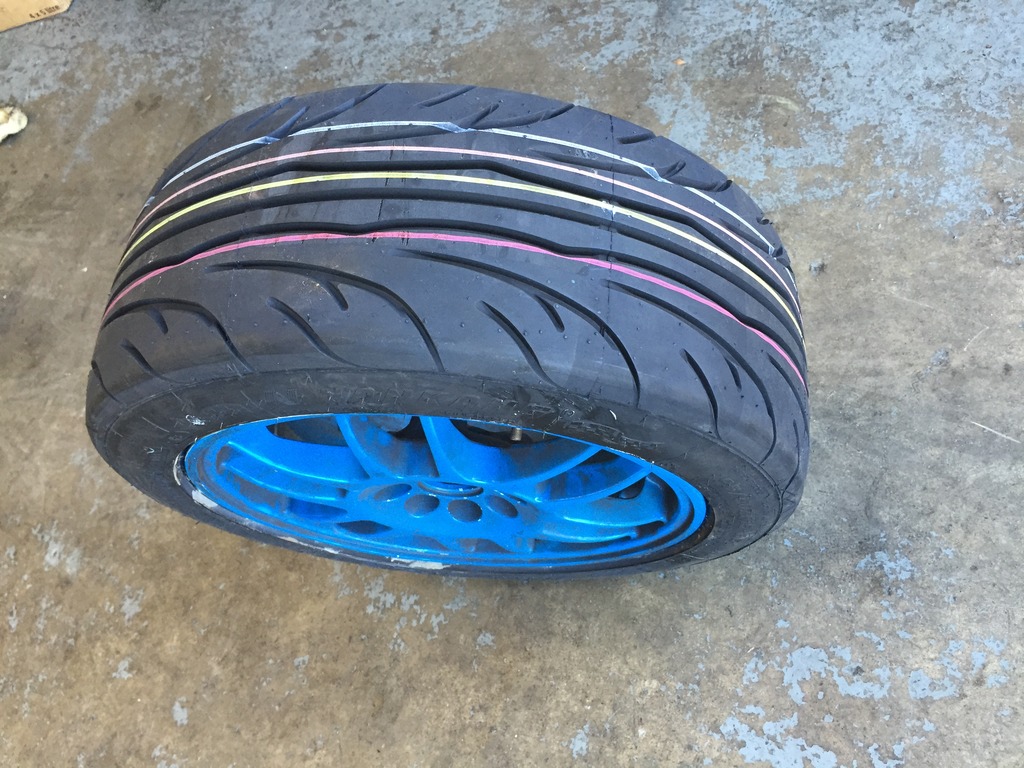

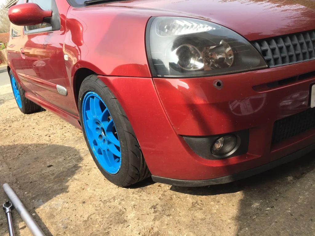

Found myself some OZ F1s and stuffed some NS2Rs on.
Cleaned them, (Yeah, I know its the wrong order lol)
and stuck two on.
I then moved them to just on the front.

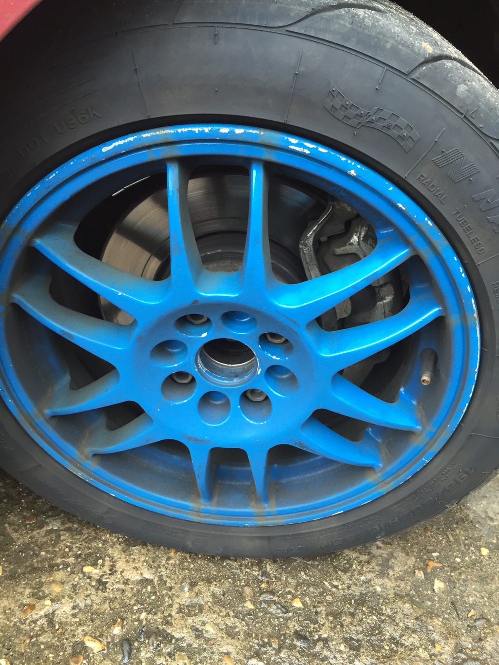

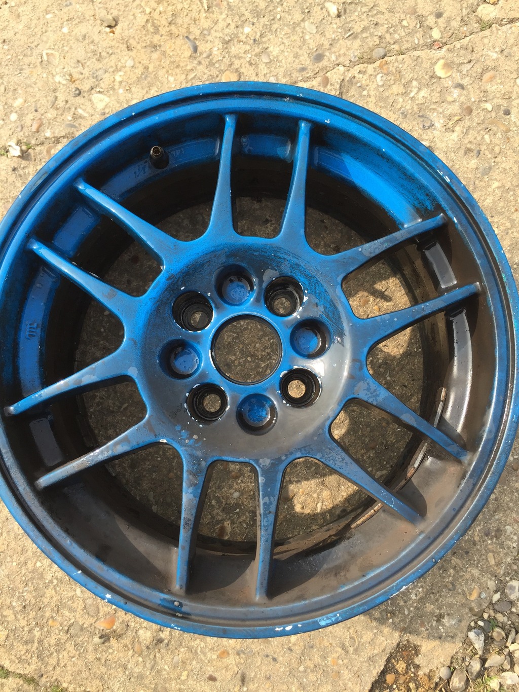

Didn't get four tyres in time, which sucks, but gives me time to clean the other two, which are very very dirty... Heres after doing half of it with wonder wheel for 20mins lol.

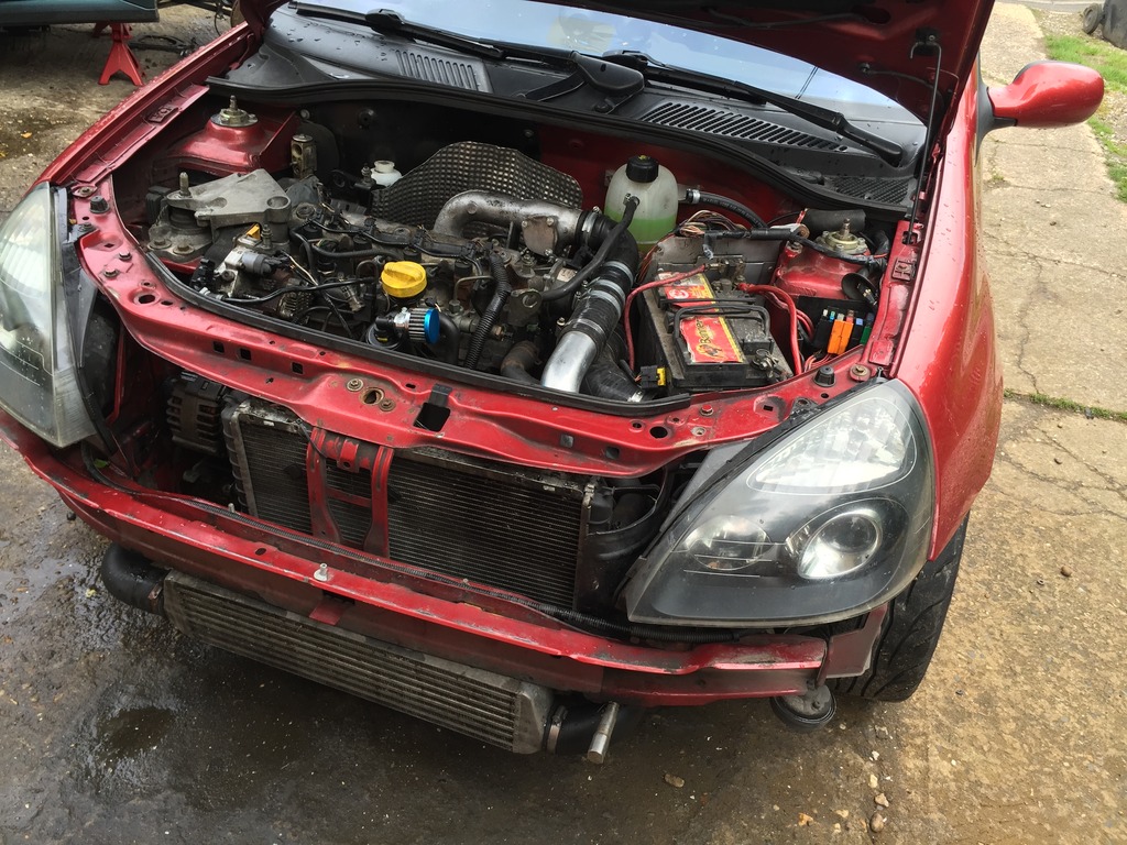

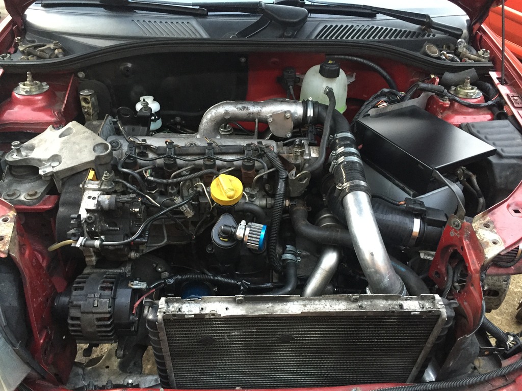

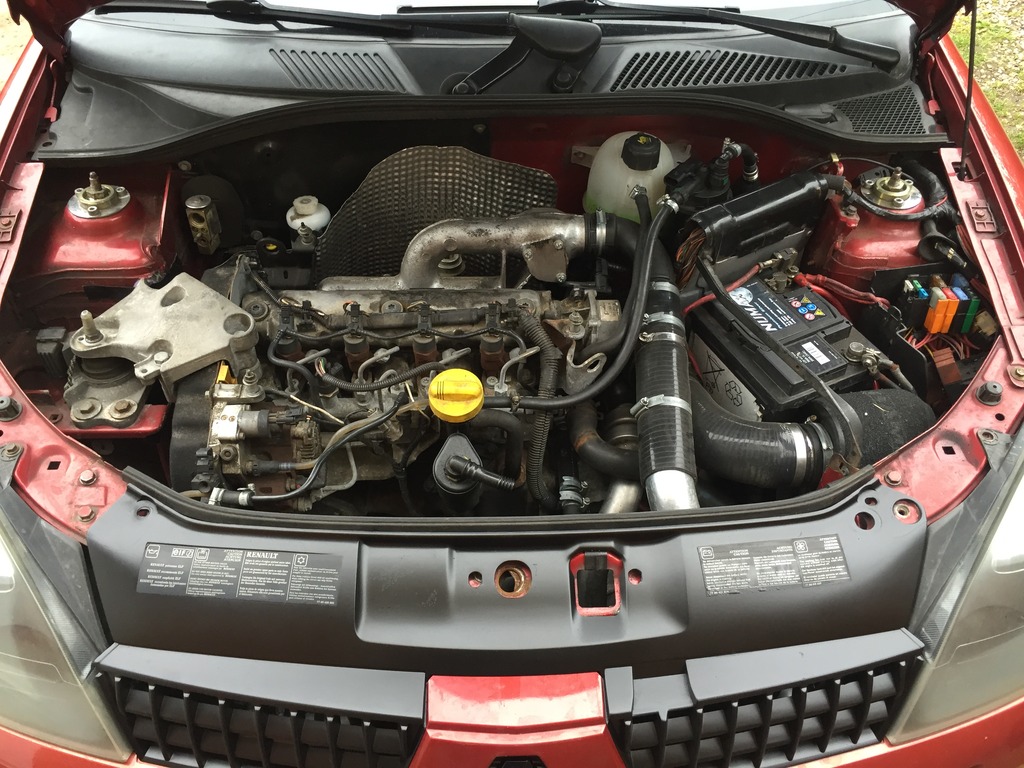

Tided up the engine bay a bit, next up is sorting the breather properly, this wasn't high up my priority as the standard setup has a in-built catch tank that works very well, and then a K&N air filter which should be on its way to me, to replace the aweful foam.

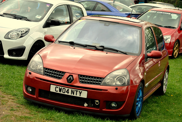

Yesterday was my annual trip to Castle Combes Spring Action day...Car looked silly
This is the best pic I've seen so far...

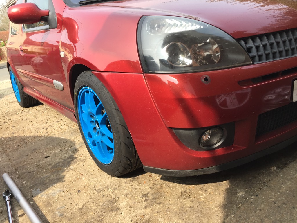

Wheels are dirty again :(

Looks so s**t on them wheels.
Wiring looks better in the bay, wish you would trim that hose back though.
Looks kinda clean in the photos.
I like
As I said, I love it on these wheels, looks so stupid.
Yeah I do need to trim that boost pipe, however I'm going to move the AFM once my K&N turns up, so going to do it then, in case I need to move that boost pipe at all. I did clean it Friday night!

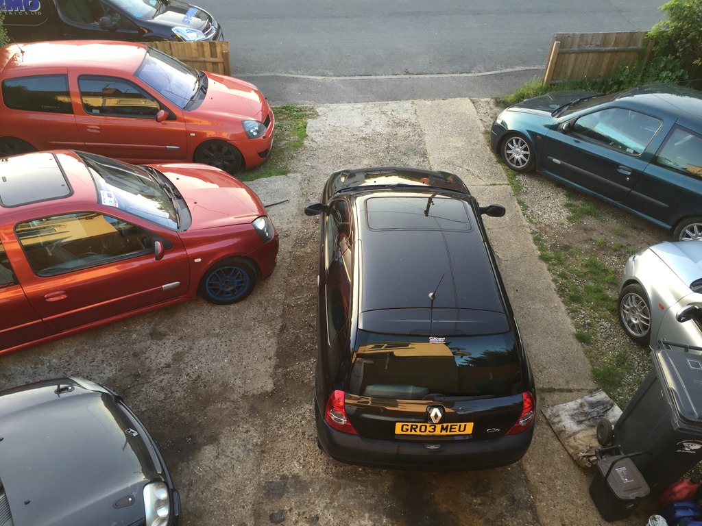

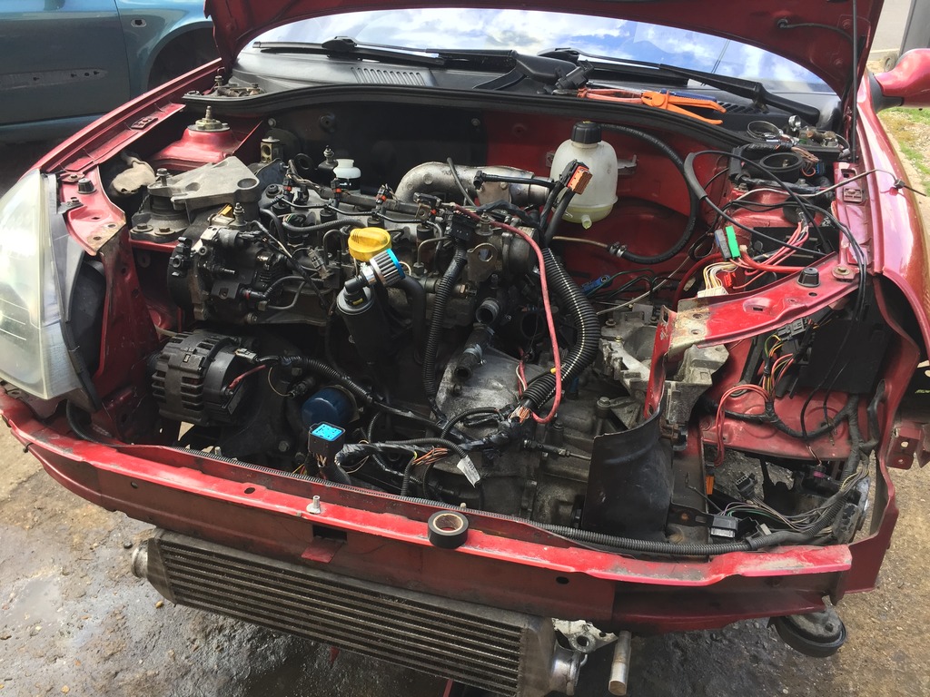

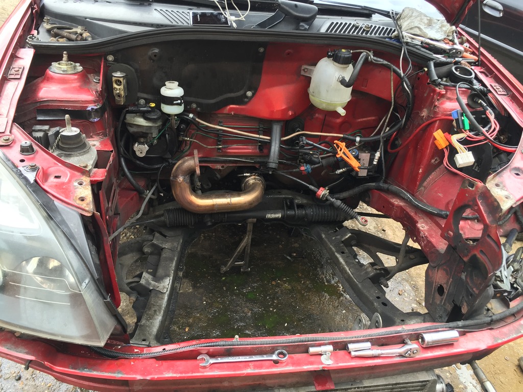

I've been slacking on my car because I've had a driveway full..

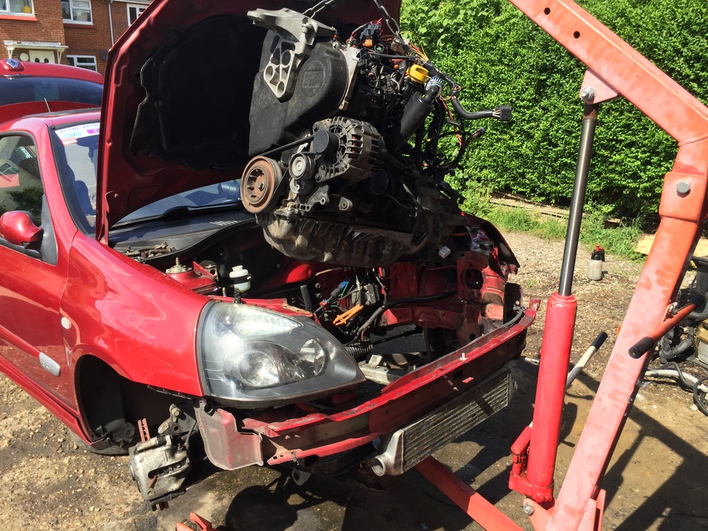

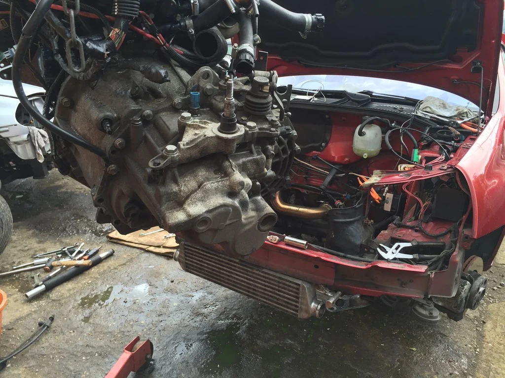

So the clutch Slave packed up, and the fuel pump, so best thing, pull the engine out!
A wet, but together Flamerr
pics stopped, but usual, engine out on crane..
First time I've had engine out since doing exhaust, love it. Also a good chance to check for other issues, noticed Ive experienced a bit of side to side engine movement on track, signs on chassis legs, engines tight!

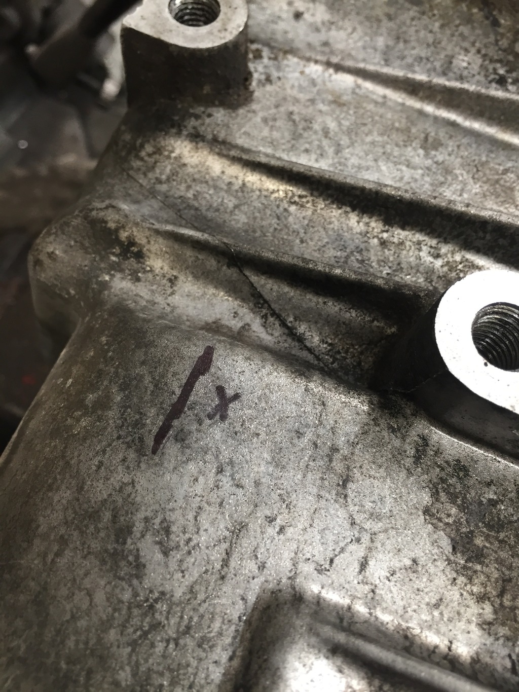

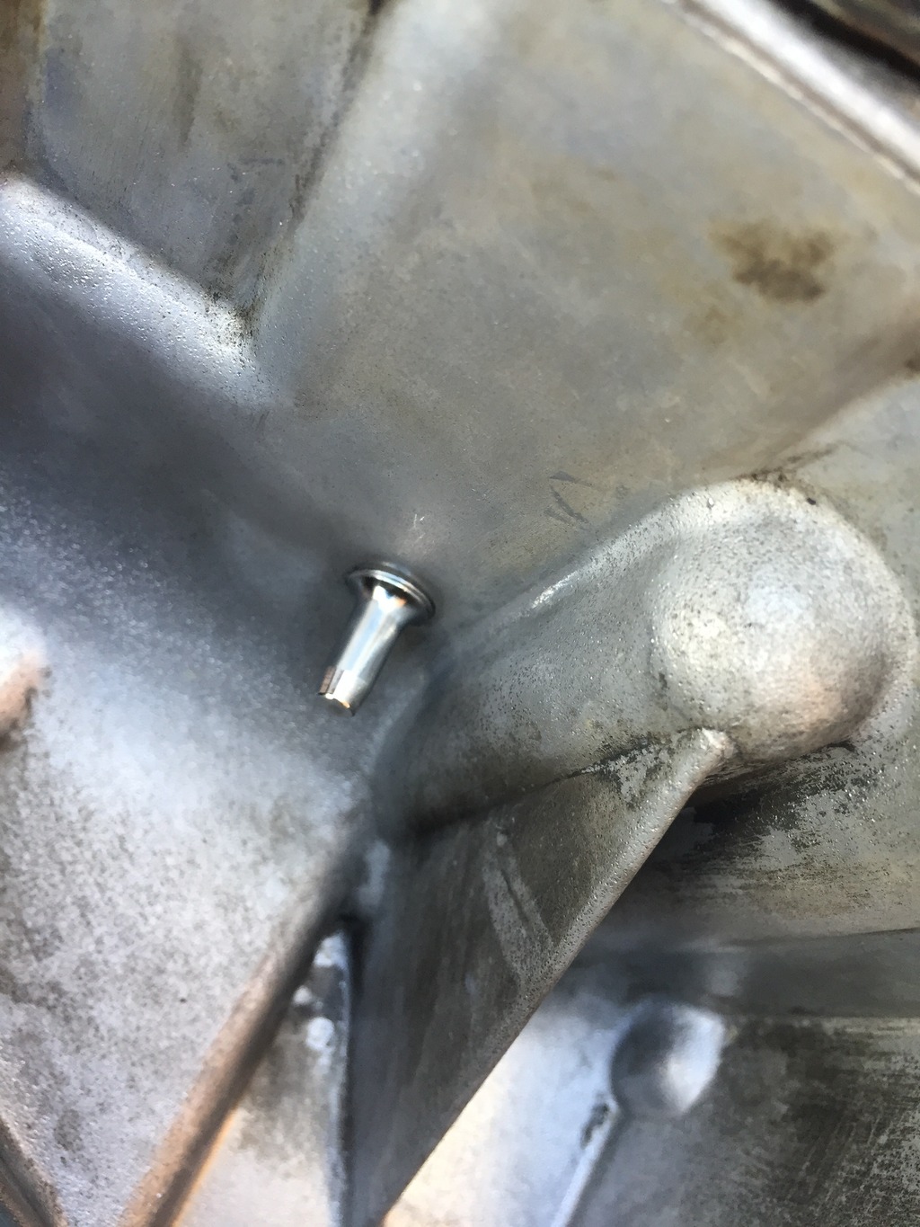

Then, X marks the spot...
For oil temp sensor...
Back in..
Put most bits together, tried battery cover on, looks well out of place, still bits to do in this pic.
In the end, while it was out I did....
Cambelt kit (Genuine)
Water pump
High pressure fuel pump
Clutch Slave cylinder
Oil temp sensor in Sump
Fitted short shifter, after a bit of modifying
all fluids changed... I have forgotten what else.
Gotta fit a in-tank fuel pump now too, then its done, in time for FCS!
