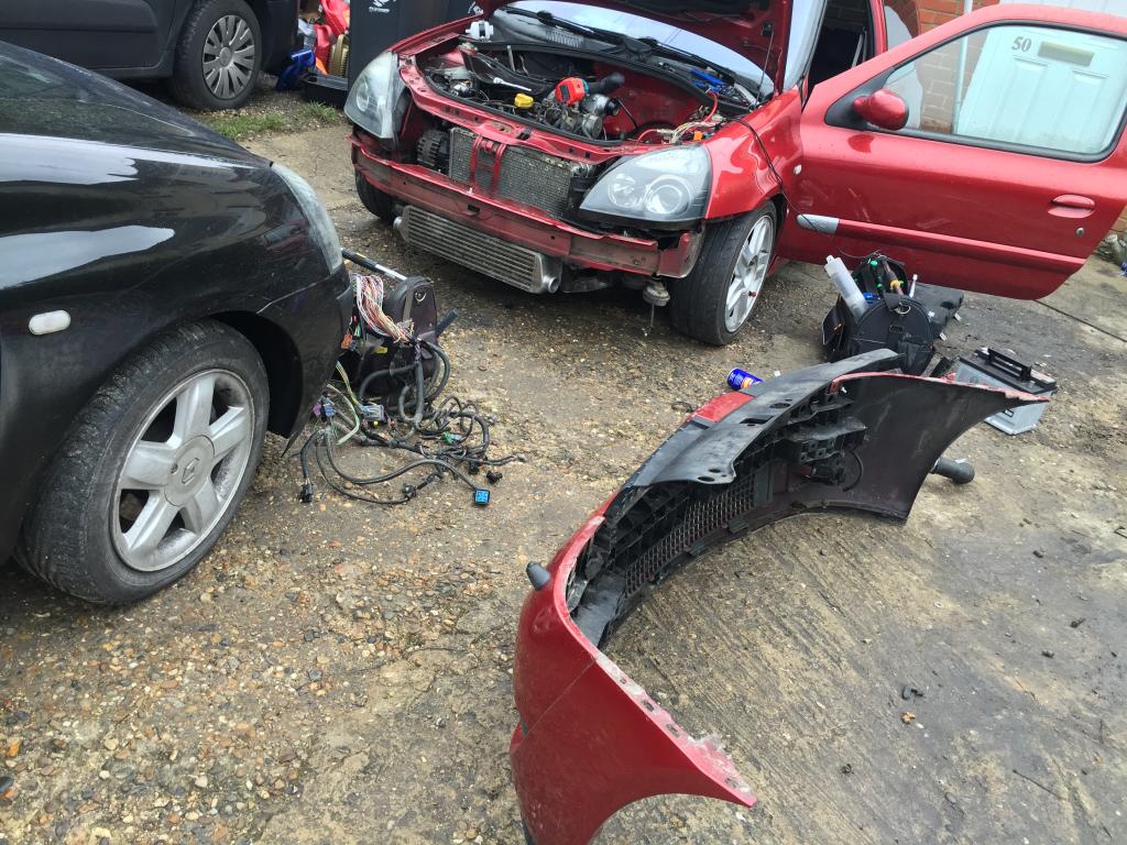

So as the eagle eyed of you will have noticed, I got the Flamer home last week, due to starting my new job.
I finally found time to do some work on it this morning....

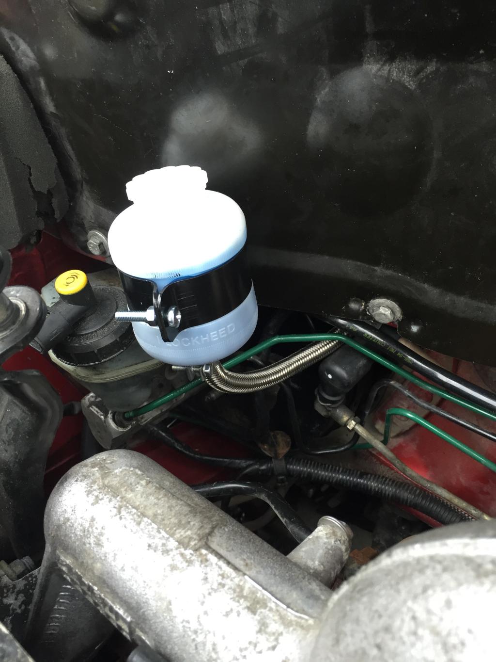

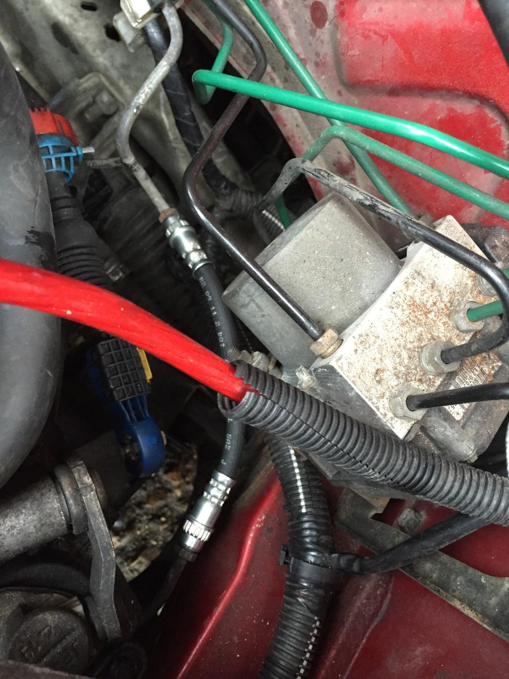

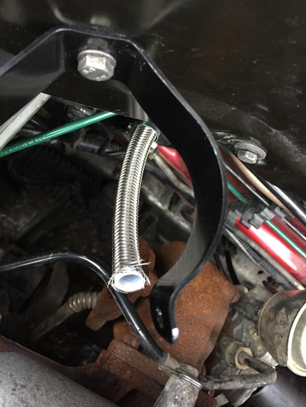

One of those jobs was the Hydraulic Clutch setup... I bloody hate this braided hose..
But, got the reservoir mounted up and filled, Pretty happy.
Ended up using a Clio rear brake pipe for the flexi, I did want a braided pipe but couldn't find a single one off the shelf easy enough. I like the idea of this being replaceable easily whereever I am.

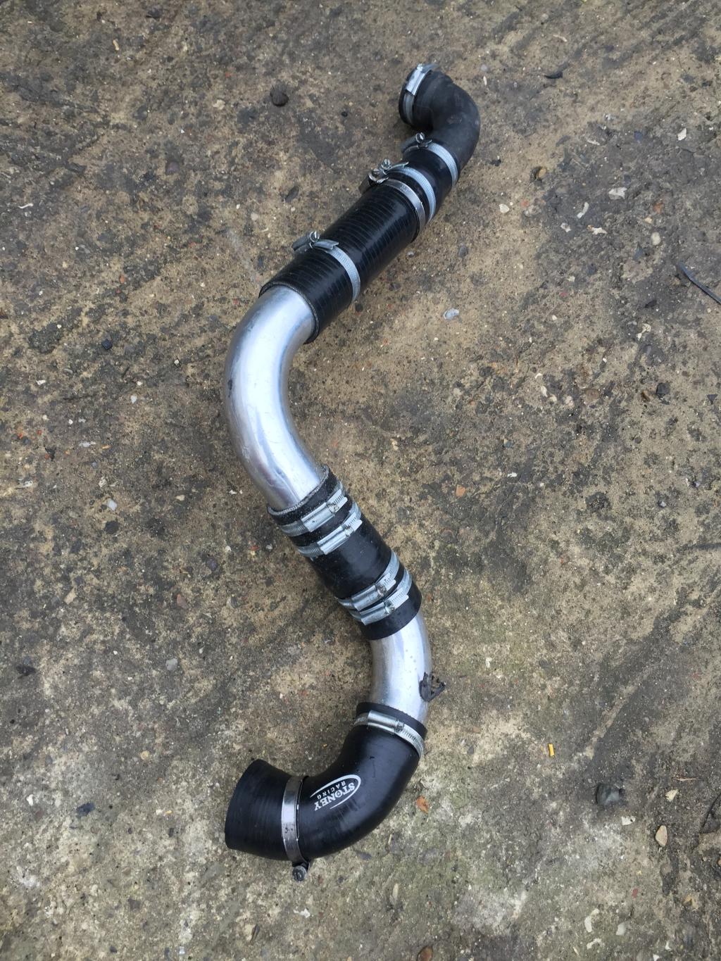

Removed one of the boost pipes, its so luls how long and big it is.

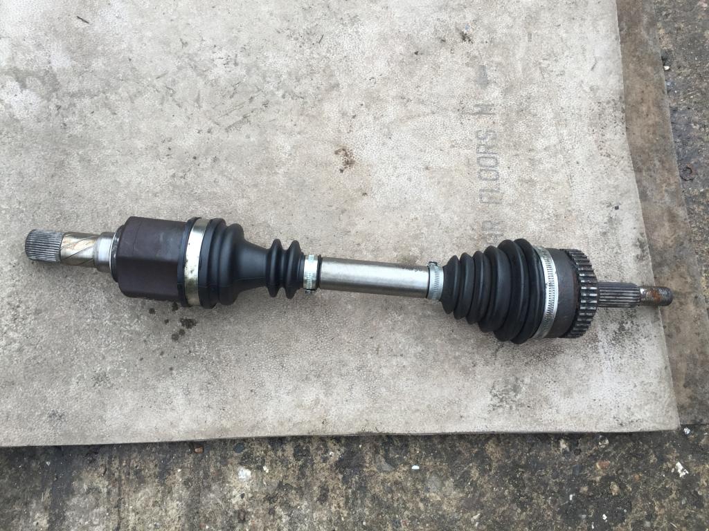

Fit CV boots onto O/S shaft and fit shaft.

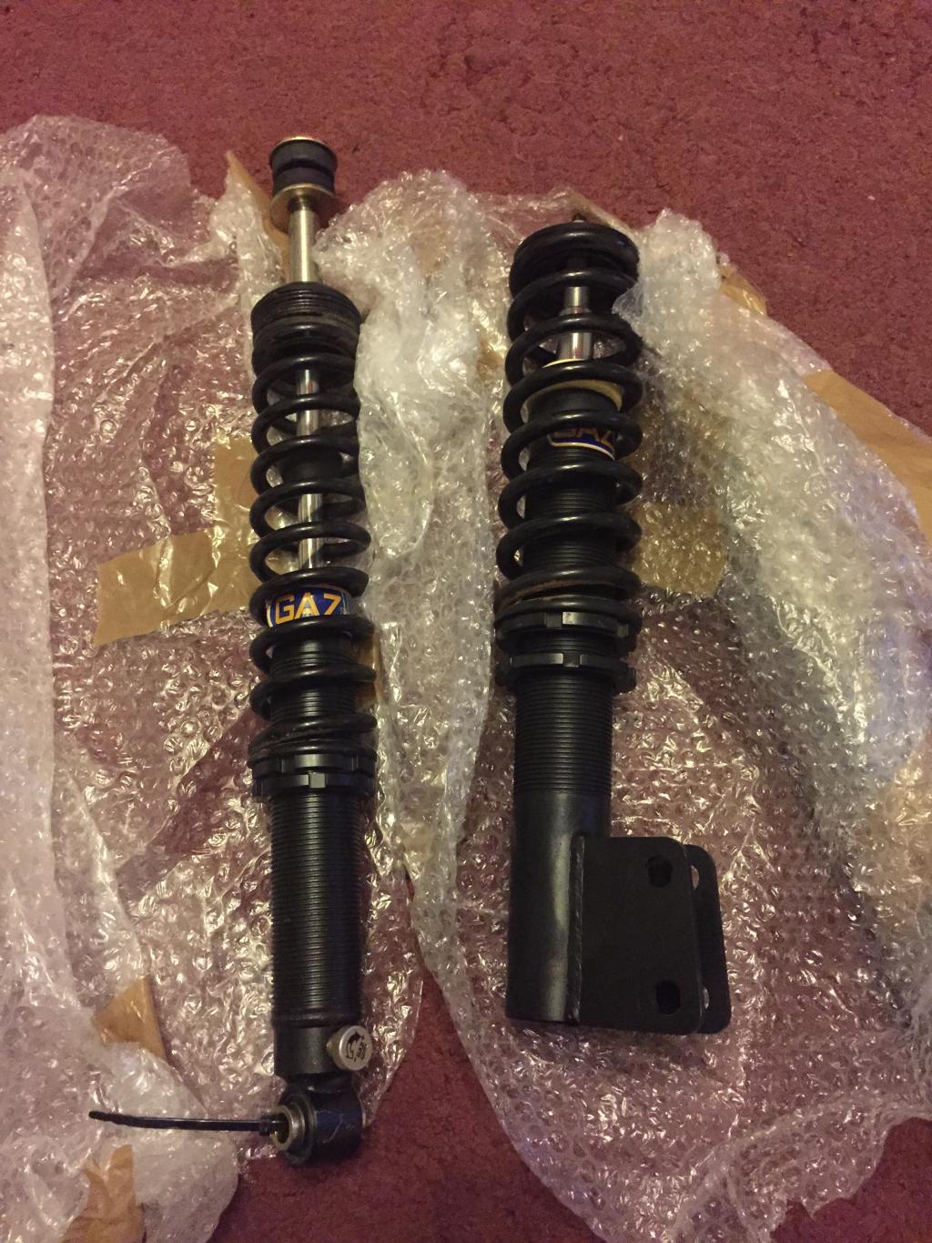

First up, got my GAZ Coilovers..

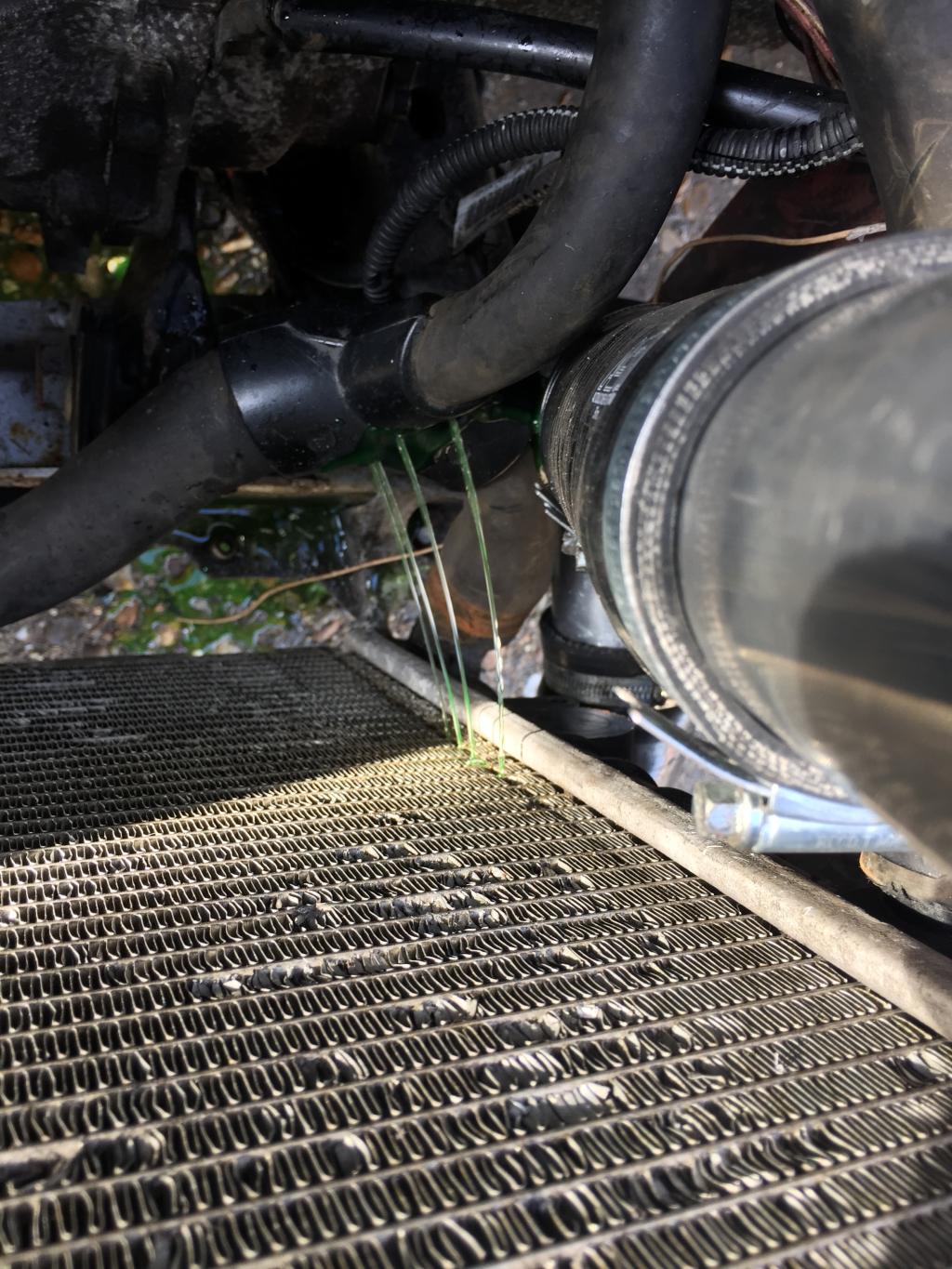

Sorted out a few coolant pipes etc this morning, found I have a leak, luckily I have another rad as I thought this one was a bit s**t anyway.

My rad sprung a leak from there, the fan housing was rubbing the rad, I had to space it away to stop it from doing to the new rad.
Luckily I'm fitting a slimline fan to this (all I have space for!)

I did make a little more progress tonight, have another coolant leak from down the back somewhere, probably one of the heater pipes.

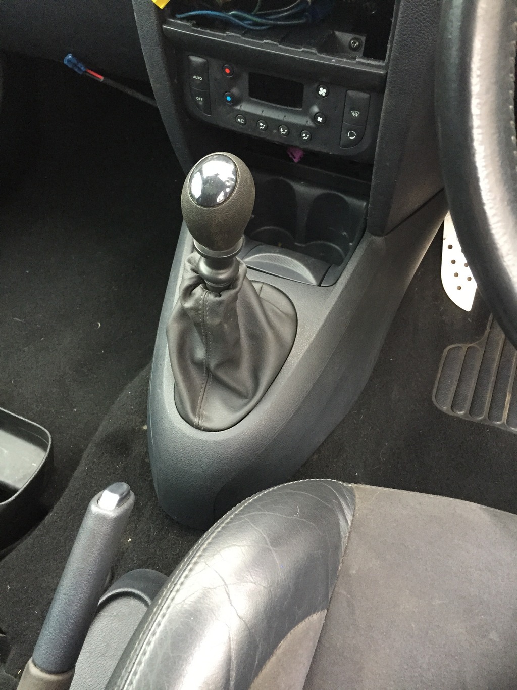

Today I cleared out the interior, vacuumed it all and refitted all the interior at long last, sorted out all the centre console etc, and fitted the gear gator, I love how OEM it looks! I just need to get a Megane insert now.

lovely knob
Please please please change your carpet for the one from your 182

lovely knob
I love a good knob.
Meh, I'm so used to this one, and I had one to fit but was too dirty, if the carpet from the 182 doesn't sell, I shall keep it for this.

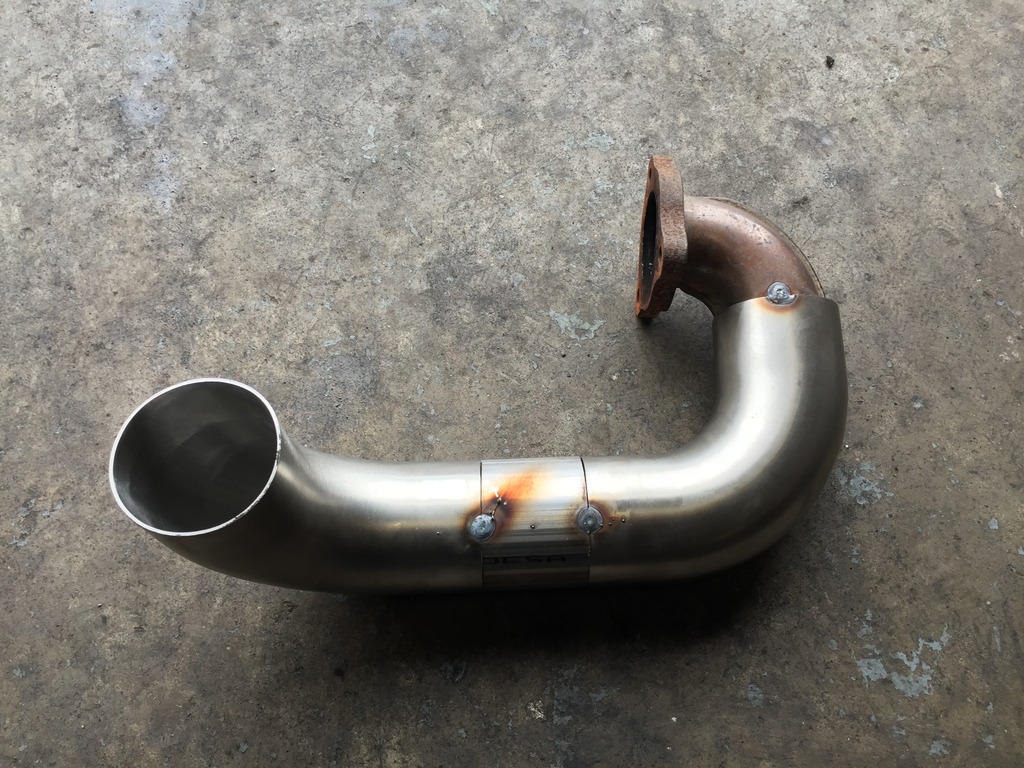

But the major progress, I made part of the exhaust downpipe. Couple of things to note here, I kept the standard turbo flange and the 90 off of that, due to planning to change the turbo, and I didn't fancy doing things twice, It'll do for now! Secondly, Its going to be V-band clamped where the mid part is, but it didn't turn up in time.
But I'm happy with it so far, got to order up a few more parts, and contiune to tack it up, before it gets tig welded. Its being entirely straight through, no boxes or anything :smiley:
