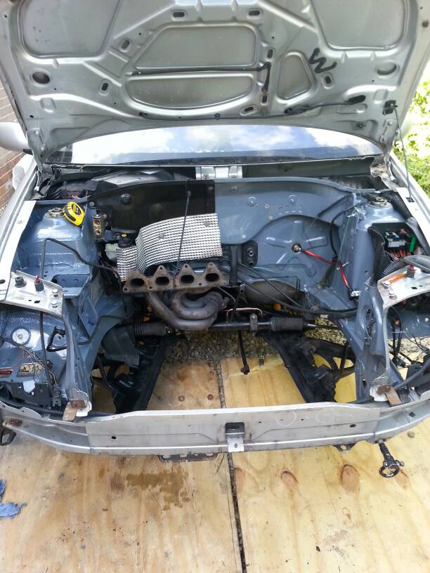

The first thing I did was removed a few brackets in the rear that had been left behind from interior etc - I bought a new angle grinder from screwfix for a bargain of £25 and it's very good quality which I was surprised about.

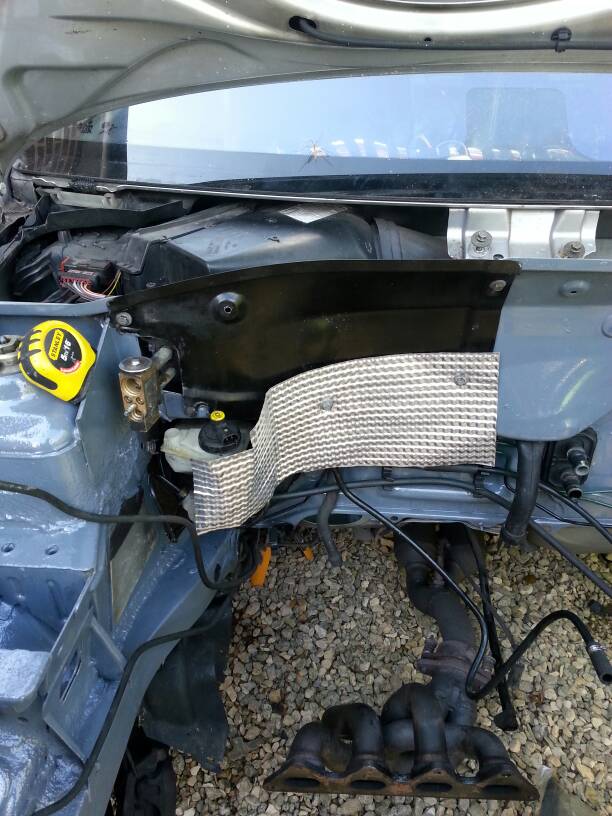

also had some spare heatshielding in the garage so used that to cover brake lines and MC, which works quite well for a 2 minute job.
In addition the subframe is back in, in the first couple of posts I removed the captive bit of the front subframe bolts and now makes it so much easier to remove - swan neck spanner on top and impact gun for the bottom - easy
Painted the cam cover again, not the best job but it'll do (which pretty much sums up this car haha)

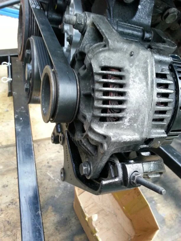

fitted the cup alternator set up but removed it in anticipation for painting the block... which I'm really putting off haha

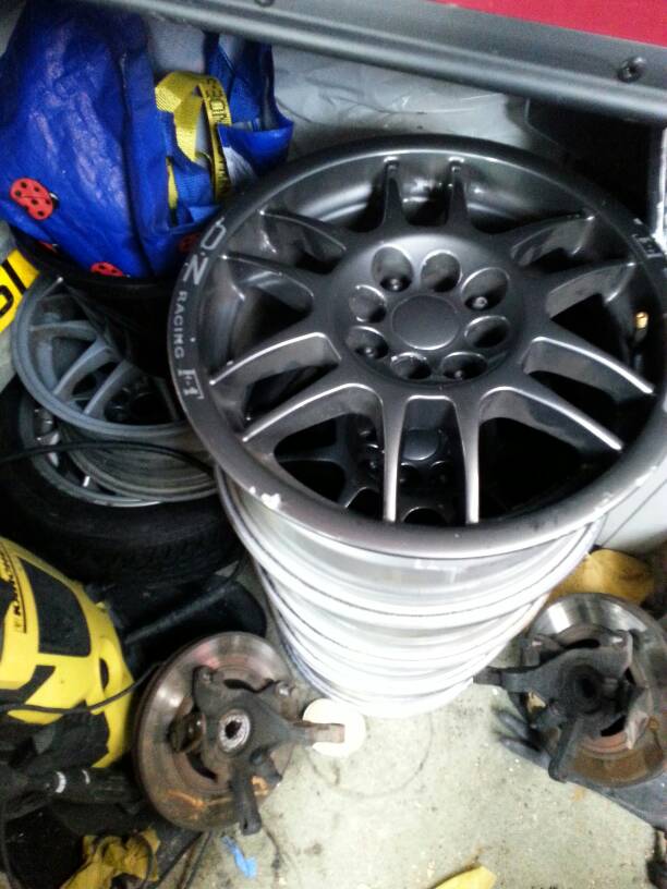

Also picked up a bargain of non geniune 15" oz f1s - these are in quite good condition so going as a road set wrapped in rainsport tyres I reckon... (road and wet track days)?

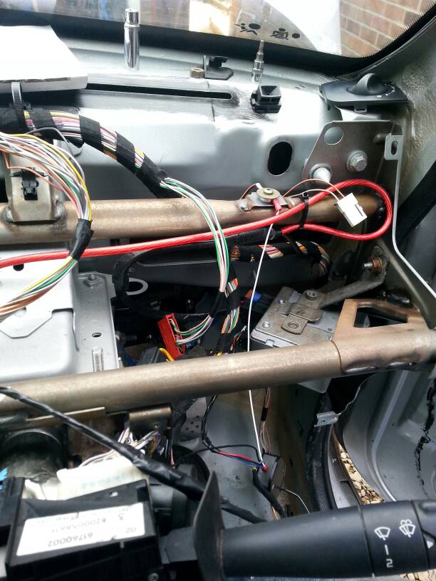

Biggest update so far is that the EPAS is all wired in and column fitted with ph2 squib
(can anyone confirm that the variable resistance for the epas will not work with the wheels off the ground? due to the motor needed some resistance in the first place)
or am I chatting s**t and I've broken something...

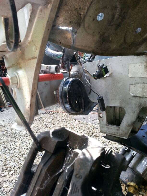

couldn't find anywhere to mount the ecu, so removed the 2nd horn earlier on in the day and thought the bracket would be perfect to mount it... and so it was.
Screwed straight into the chassis

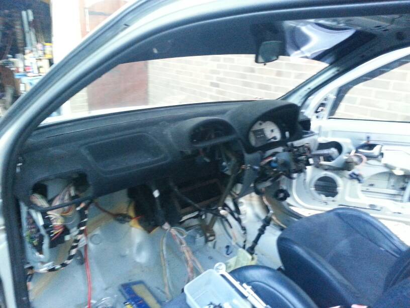

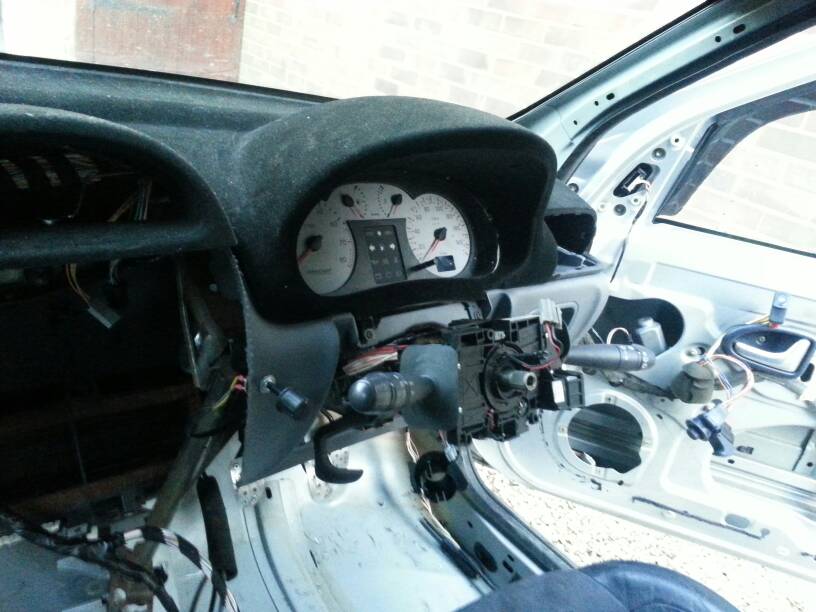

So butchered so lower dash so I could keep a place to securely mount the dash
atm it looks pretty untidy, but I will be ordering a sheet of 1.5mm alloy to use as the centre console bit from underneath the clock pod straight down to the floor to mount everything.
Currently I am using the pull cables to adjust the heater vents, although it will be fixed on windscreen only but the temp is variable and will remain variable by cable pull - until I get a lightweight heater.
I gutted the switch panel and remove the knob and electrics that control the power if the air and that will be mounted on the centre console.

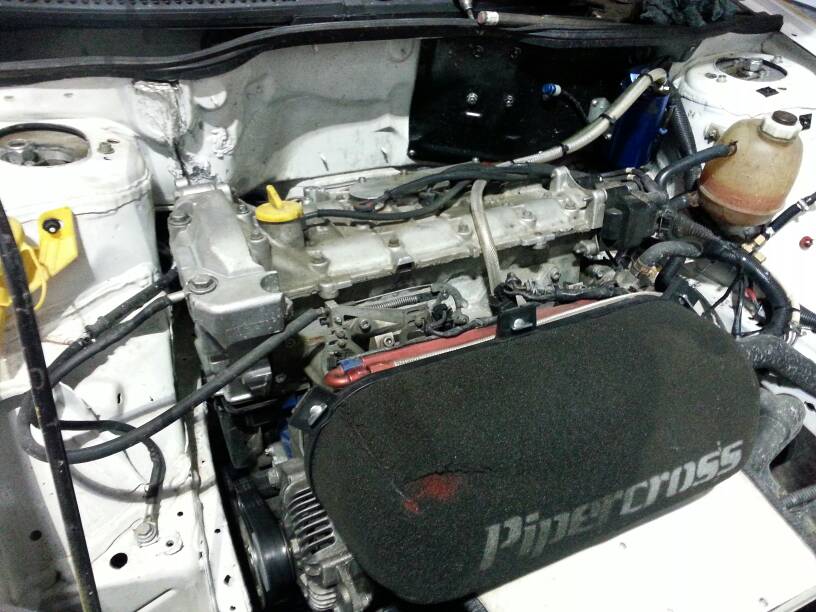

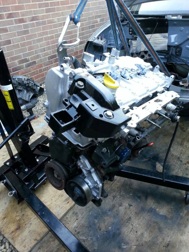

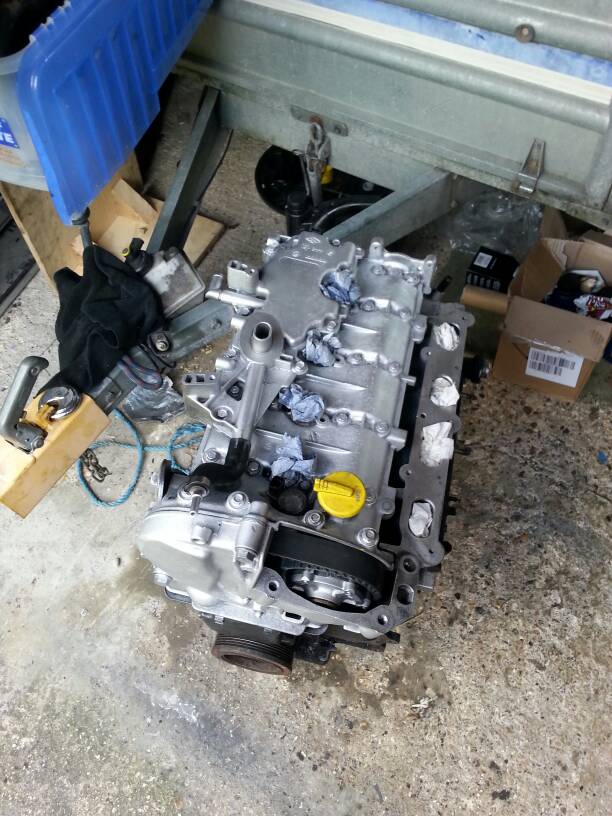

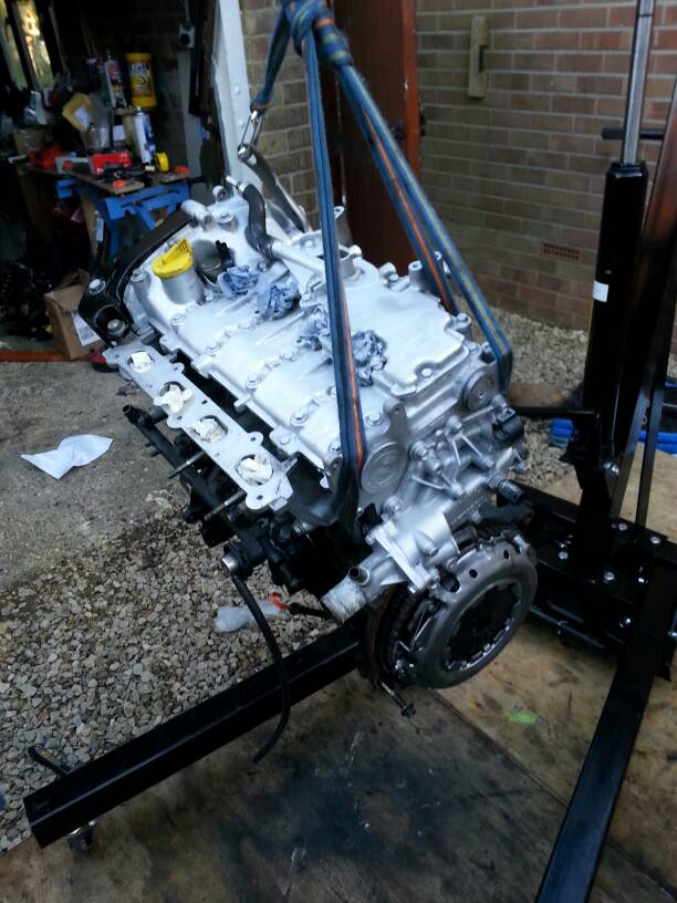

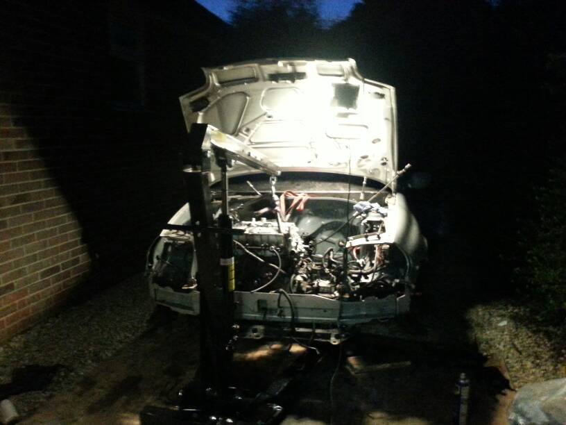

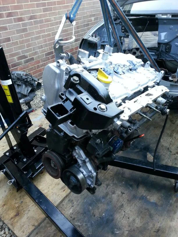

So a little update from the other day - Engine is in, was waiting on a water pump to arrive from another seller, but I can get geniune same day so ordered another one so I could get cracking.
water pump on, clutch on
Engine is in with a few things plugged in, but still got suspension to put in yet!

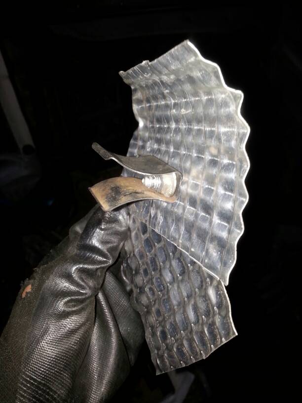

Totally forgot I snapped my starter heatshield when I removed the engine, so I used the old clamp thing and some spare nimbus heatshielding to make another one, dremeled the nut so it is now captive and it fits like a glove - happy days

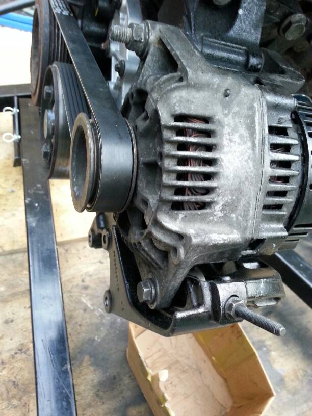

One thing in question is I really don't know how tight I should make the 10mm nut to put tension on the belt...
it's near the top of the travel but really not sure if that's to tight or not...

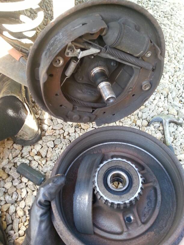

Had a bit of a bad scooring noise when I braked on my dci... looks good to me
  172 Ph1
That is quite common on Renaults lol
Be sure to not forget the little bevelled washer that slips over the dowel for the swinging adjuster arm when fitting the new shoes.
Haven't replaced anything yet, kinda just left it with no friction on the brake shoe at the moment... Whoopsie

Ah yeah! memory like a goldfish. good job they were put to good use then?! :) gone full on with the dash removal but it should look good once completed - I like the flock, I have mine being done this week.
Yes bud was the last piece of the puzzle on the 182 before I sold it - yeahh definitely, if it looks s**t I will get a Ph2 top dash and cmc switch pod! ahhh saweet! love a bit of flocking!

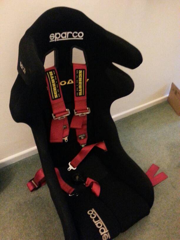

So recent purchases - many many bargains wooo
New drivers seat, need to source side mounts and one subframe .
Really really comfortable and cooooool

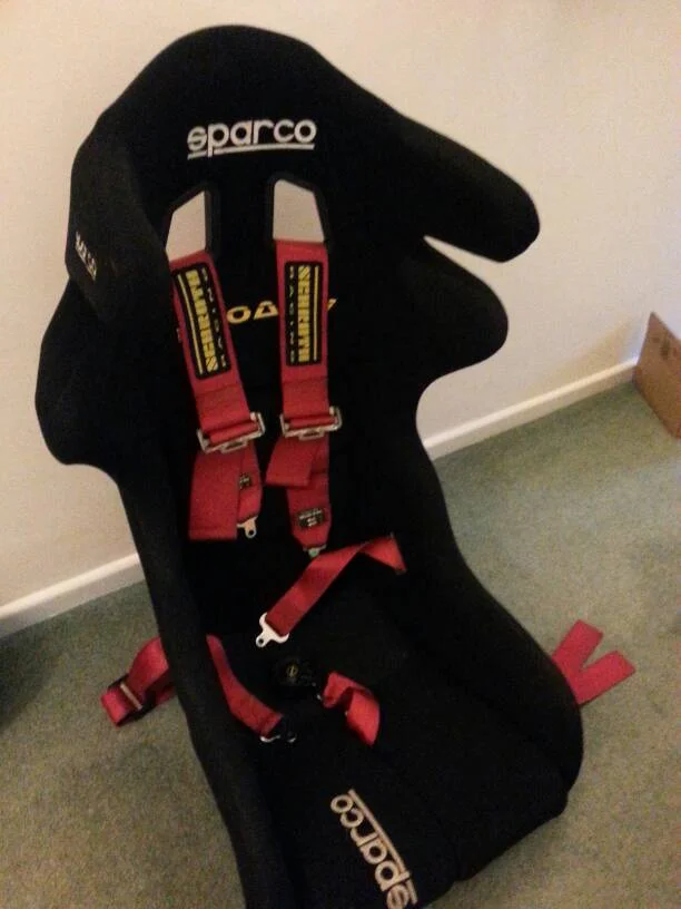

Drivers side 6 point Scroth harness, gonna just go 4 point for passenger side.
Anyone recommend me some spreader plates and eyelets, guessing I can just put eyelets straight into the outer holes for the standard seatbelt mounting points then put spreader plates on the exhaust tunnel for the inner eyelets?

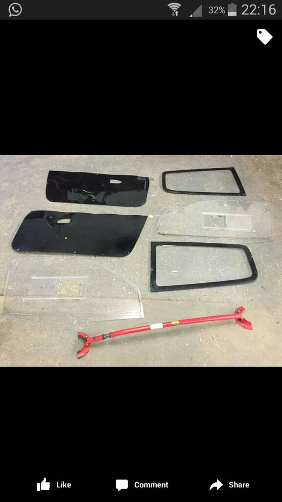

Also front and rear polycarb windows Inc door cards!
Really happy with the recent purchases, in addition to ask for advice again, what's best silicone glue to use for the windows and how best to prep it?!

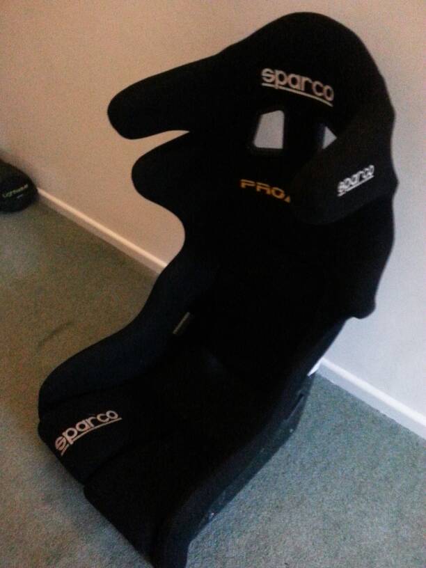

Look here for how to mount your harnesses: http://www.cliosport.net/threads/mounting-harnesses-correctly.768754/
