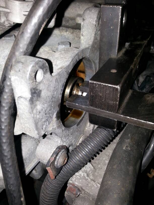

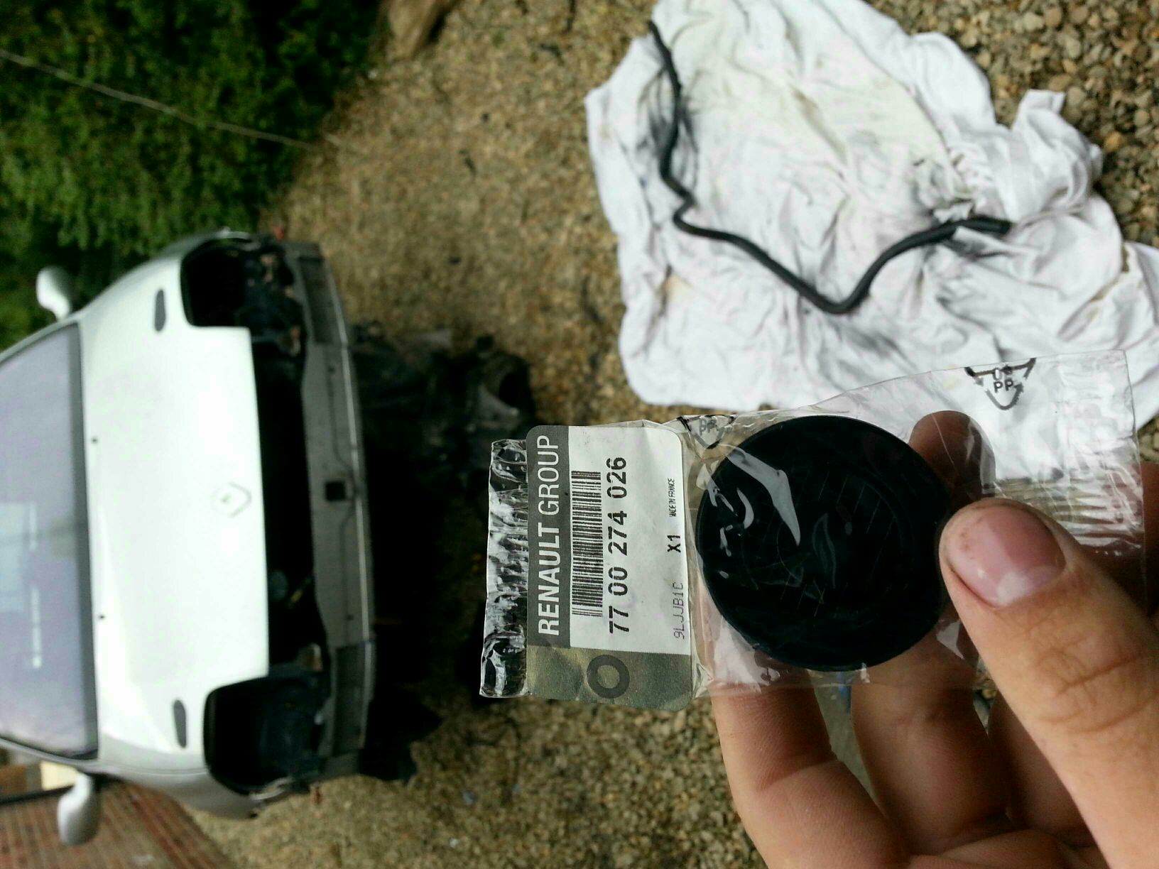

Ive got a 182 turbo that's suffered a large engine oil leak and when ive looked theres a lot of oil around that circular hole in the side of the engine thats near the throttle body and thermostat etc, and oil spray all over everything as well as the underside of the bonnet, can this leak? If so what's the cause?
What's this part of the engine mate?
Ive got a 182 turbo that's suffered a large engine oil leak and when ive looked theres a lot of oil around that circular hole in the rocker cover thats near the throttle body, and oil spray all over everything as well as the underside of the bonnet, can this leak? If so what's the cause?
You'll be looking for cam seals, if it's leaking from that area.

this is the smaller one, but haven't got the bigger one delivered yet - coming with my waster pump (big order, few things in stock and few out, hence the spread out delivery)
  RB Clio 182
Yes, does yours not? they are a little bit awkward to put on straight :)
No mines just open like in you pic, I thought I hadn't noticed it like that before, if that cover has popped off would it leak out all oil? Or would there have to be a bigger problem?
Theres oil everywhere.
Yeah there would be oil everywhere, the cams would have just fanned it around and out that hole, I couldn't say if there isn't a bigger problem, apart from if your oil levels have got very low!

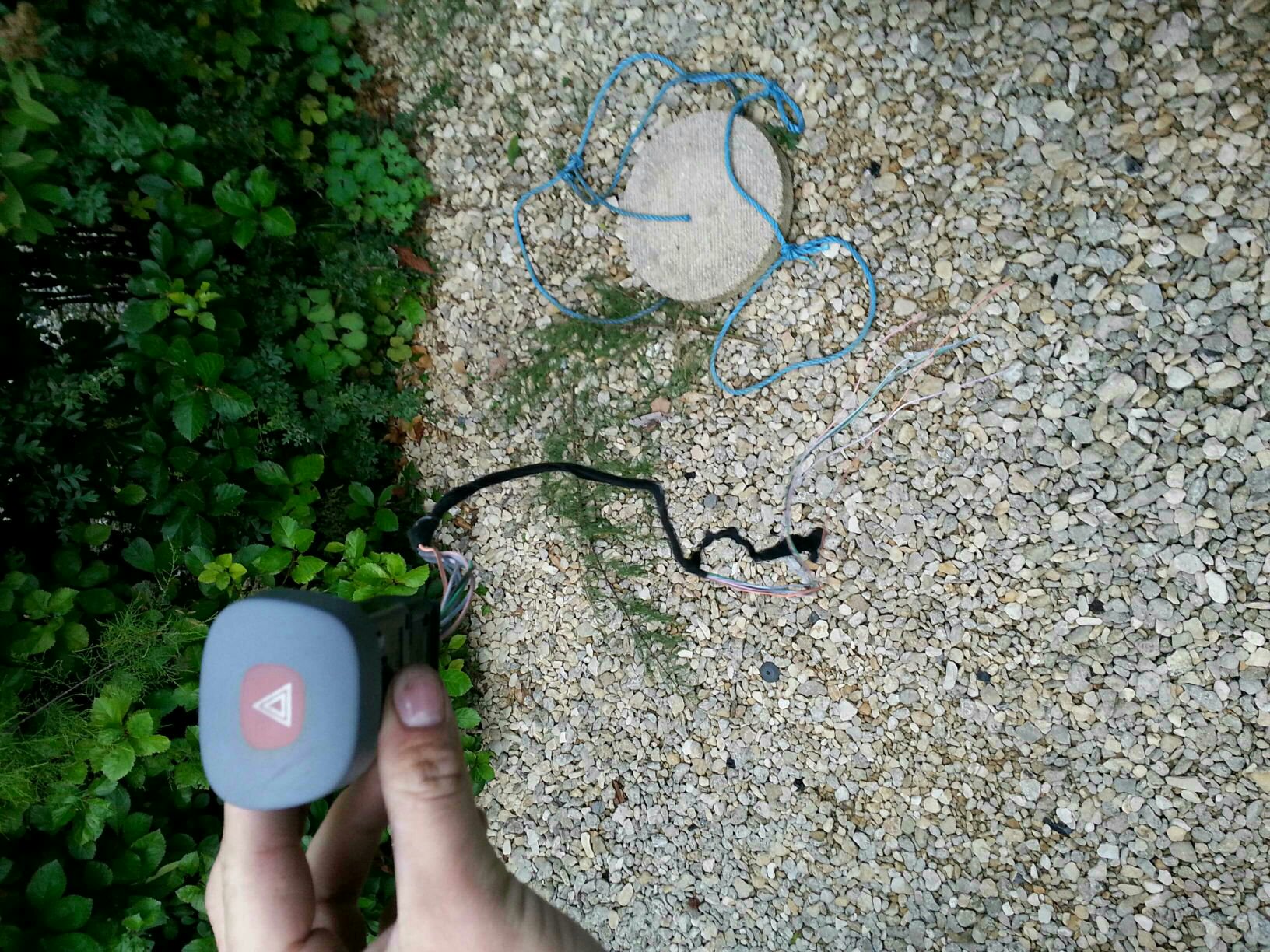

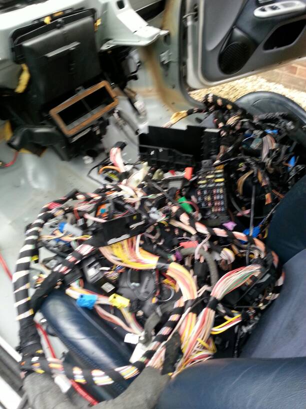

Well I've been an all mighty wanker haven't I - remember I asked what plug that was up there - well I've found out :(
why does everyone get it wrong the first time...
I even took my time, and made sure I didn't f**k up... haha [emoji36]
What's the solution now guys I'm guessing it's new loom?
Oh s**t - you haven't have you ?
Cut it out I mean ?

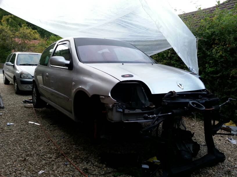

Quite a lot of little jobs have been done recently:

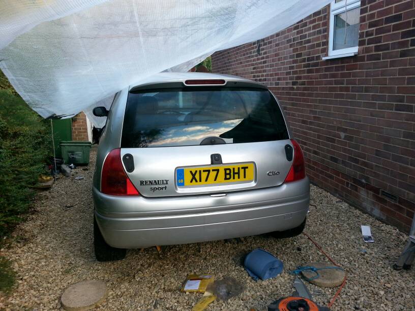

One job was fitting the rear aerocatches, christ what a job that was, lot of cutting and panel beating, but they're done and it's not to messy

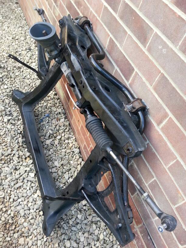

The next job was to install the Powerflex black arb and steering rack bushes on the subframe, took a bit of time trying to get the catches over the bush and arb but they went on with a large pair of molegrips

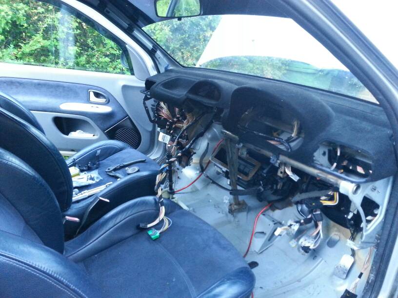

So as you guys know I accidently cut the hazard switch off, I mean I know people f**k up with the loom, but mine was bad haha hey ho, picking up a new loom tomorrow.
So yeah I'm gonna take my time on this one a bit more... anyone got any wiring diagrams for the ph1, I believe I cut the right wires in regards to the airbags, as when I plugged the dash back in no airbag warning light came on although the immobiliser light was just flashing quickly...

Those Roll Bar Bushes are a right Royal pain in the backside to fit , good job you have everything on the floor.

Nice work on the rear catches -a thing I need to sort when I get my CMComposites rear screen.

yep can't Imagine doing that on my back haha!

Cheers bud, I definitely should of gone horizontal - I though this way would save a bit more waterproofing, in the end i cut exactly how I would if it was horizontal annnd I had to do alot more work trying to make the panel flat which didn't work to well haha - hey ho FG tailgate and screen soon also!

So a little bit has been done recently... getting back into working life is hard when all I've been doing recently is working on my ph1 haha

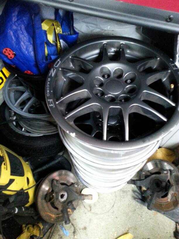

Got a another set of wheels for road and wet trackdays, gonna put a set of rainsports on them I think -unless anyone recommends better.. very good condition for the price I paid, not genuine but who cares ey

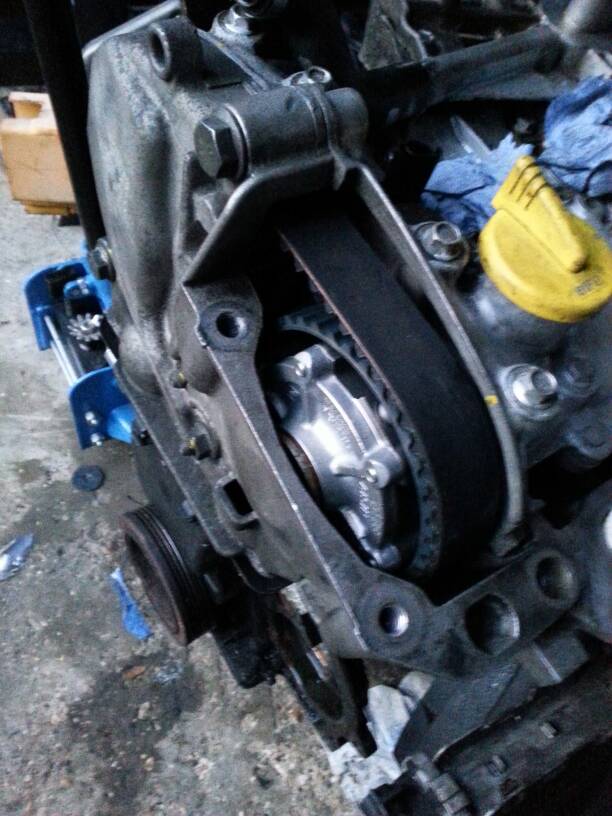

Got the cambelt kit and new dephaser on, just waiting for the water pump to arrive and put the sumo gasket on then the engine will be ready to be put back in
I can't remember if I posted it up there, but the looms are now swapped over, and hopefully have a working loom in there including hazard switch ha ha (although I have chopped out the alarm wiring, airbag ecu and loom, seats, interior light, aerial and loom, speaker and radio loom and a few other bits and bobs)
Also put the top half of the dash in, there's still a lot of tidying to do with the loom to keep it out the way etc but it looks good, when payday comes i'll have a look at some material that goes from the top dash down the centre to the floor for switched and cut offs

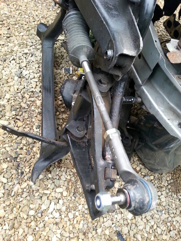

Forgot to mention new track rods and tie rods have been put on!
Thanks for reading, hopefully it should be back on the road by Sunday:

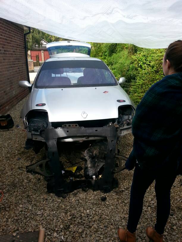

blah blah blah engine in
Gonna lift chassis up and drop it over the engine as that saves the hassle of dropping the gearbox end and slotting the engine into the bay - although I need to align the column to the steering rack, so it might be easier to put subframe up first align and fix column to rack then drop engine in...
