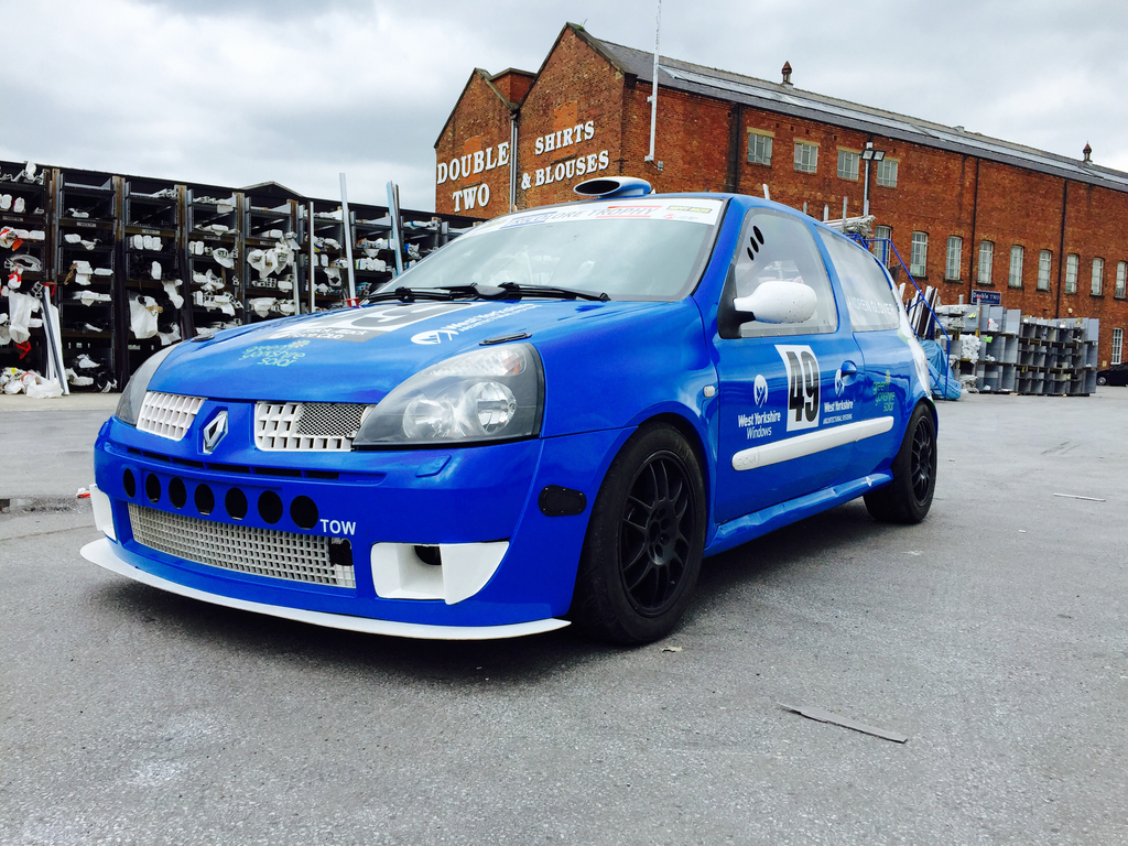

Car looked mega at Rockingham from the pics mate!.. Love the wrap you have on it and the livery!
Thinking I need a racy livery on mine!

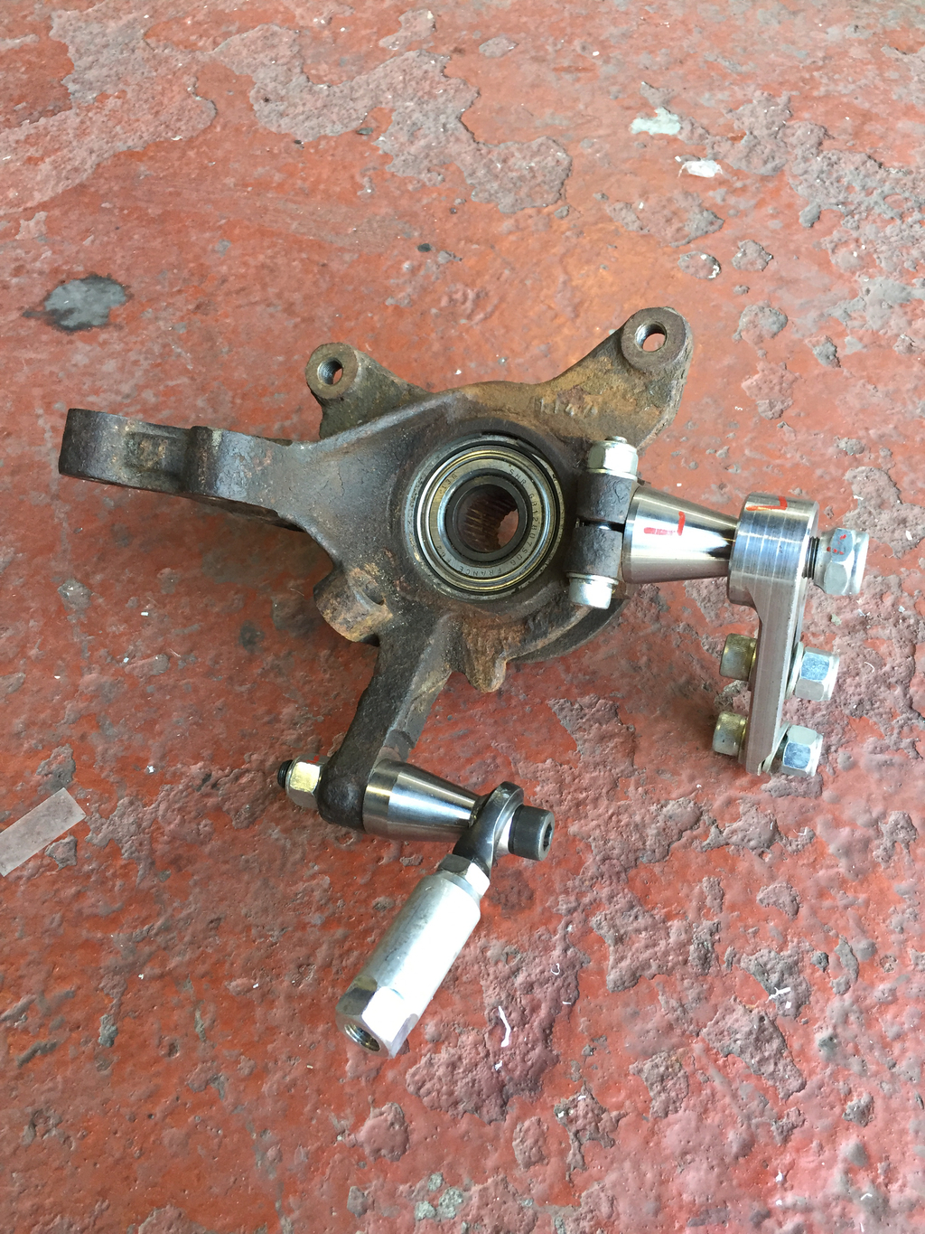

Yeah sorry I did get your email buddy been so busy didn't have chance to reply! Lindop finished my wishbones and my oh my am I glad i had him do them!! Superb job the guy is my hero!!! Did a little wee when I picked them up!!

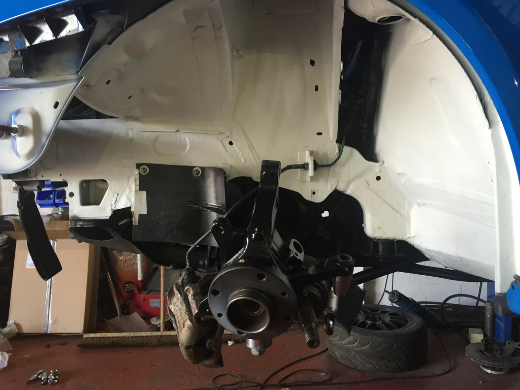

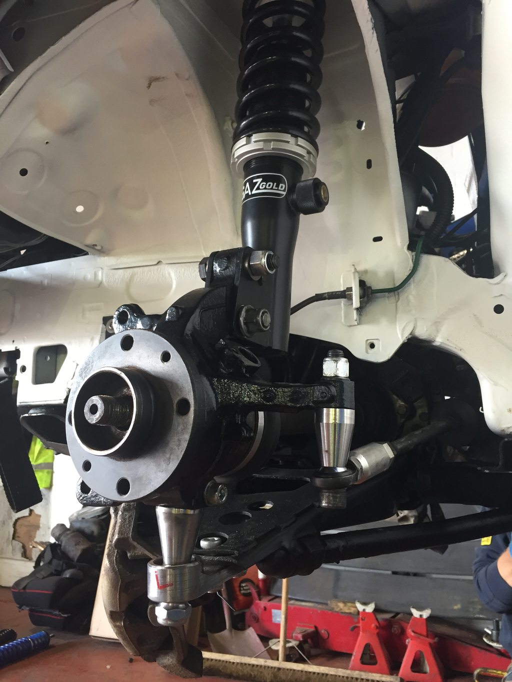

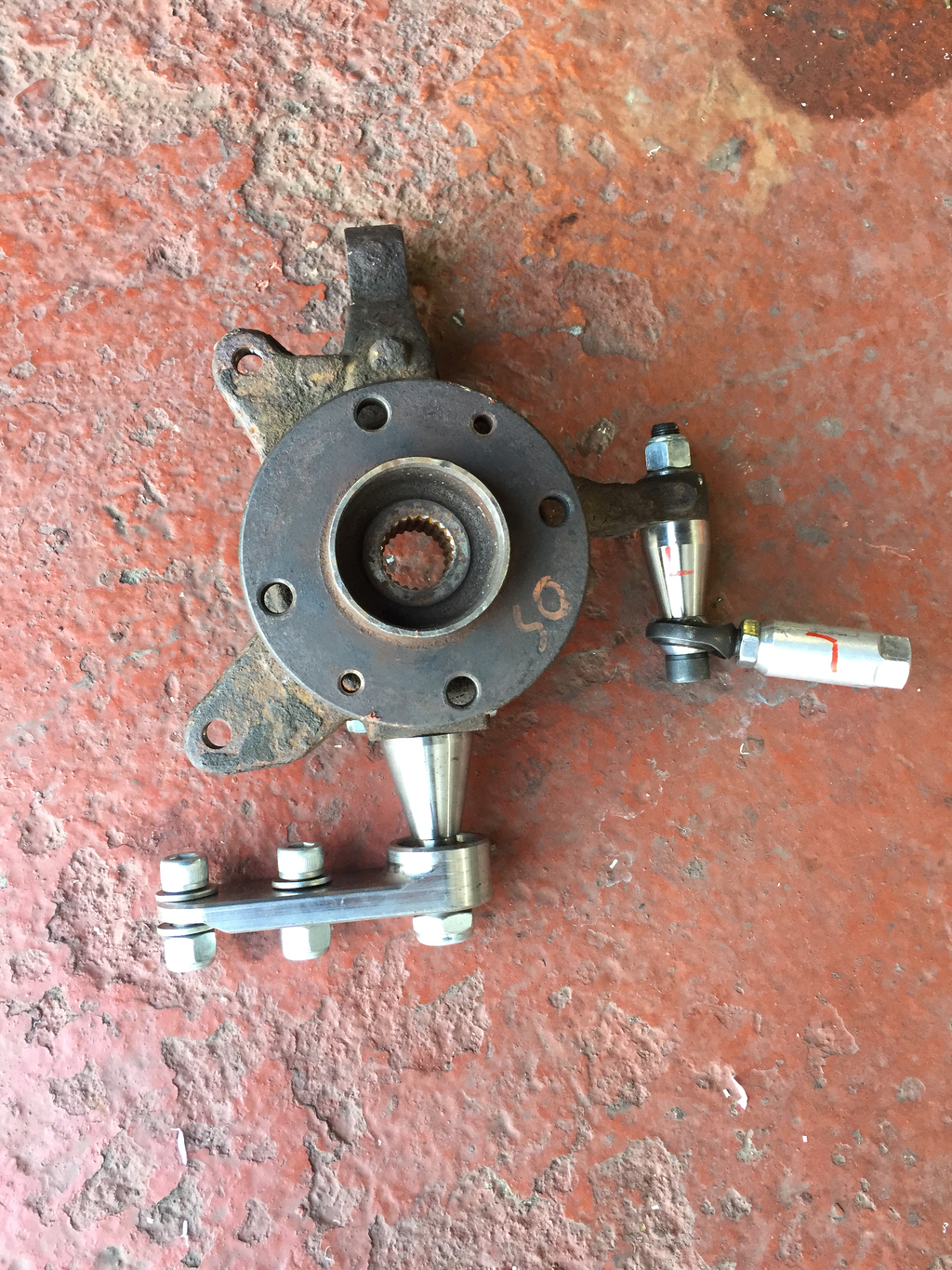

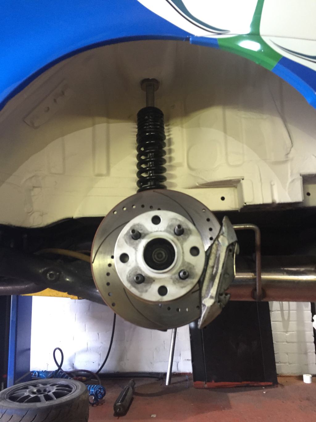

Bit of work taken place on the Clio today. Full new suspension!
Actually a very easy job, even for me, who doesn't know what he's doing! We got a set of the Role Centre Kit's from James Ashton (thanks pal).
The hubs needed a clean up and paint, but other than that, spot on!

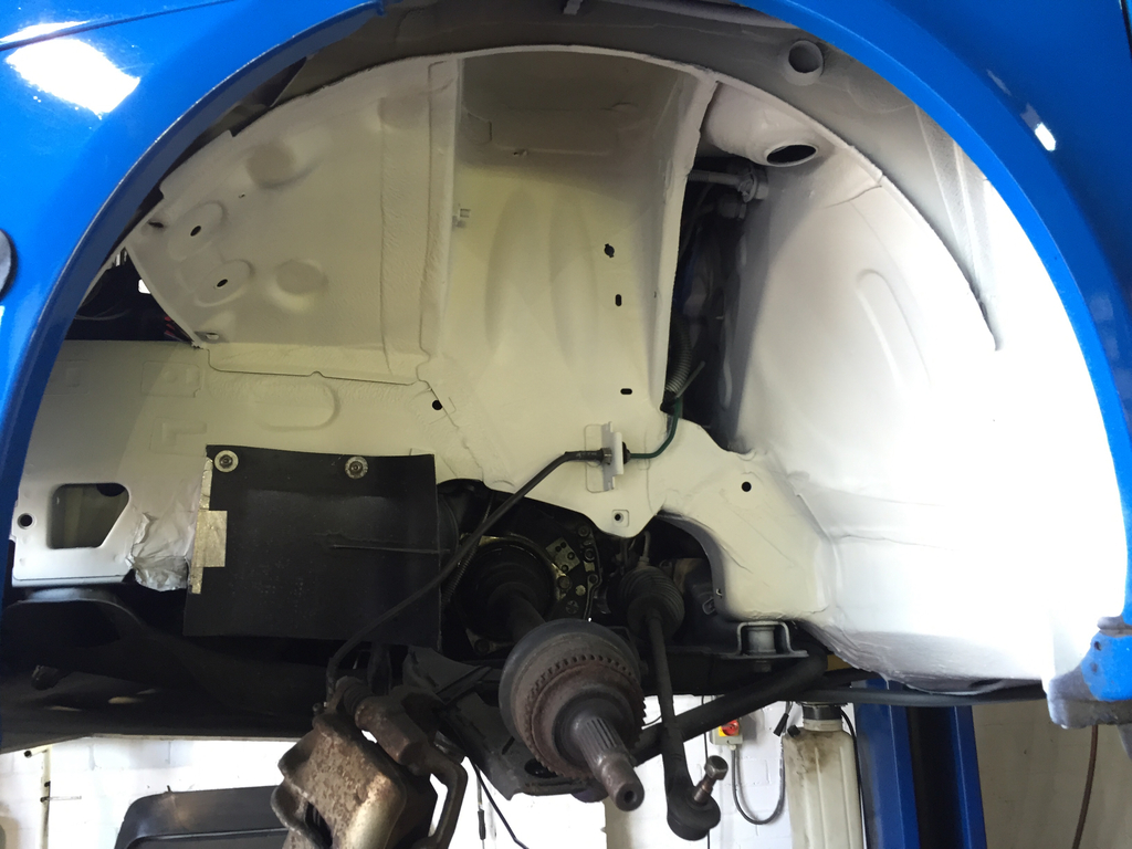

We started by stripping the old stuff off, cleaning the inner arches of all the crap they had picked up on the track, and gave them a lick of stone chip paint. Think it looks pretty good!
Then, started building it back up. Back first, as it was the easiest
Then on to the front.
It took about 2 hours to fit all the new kit. Helps obviously having a ramp to work off, rather than just the floor!

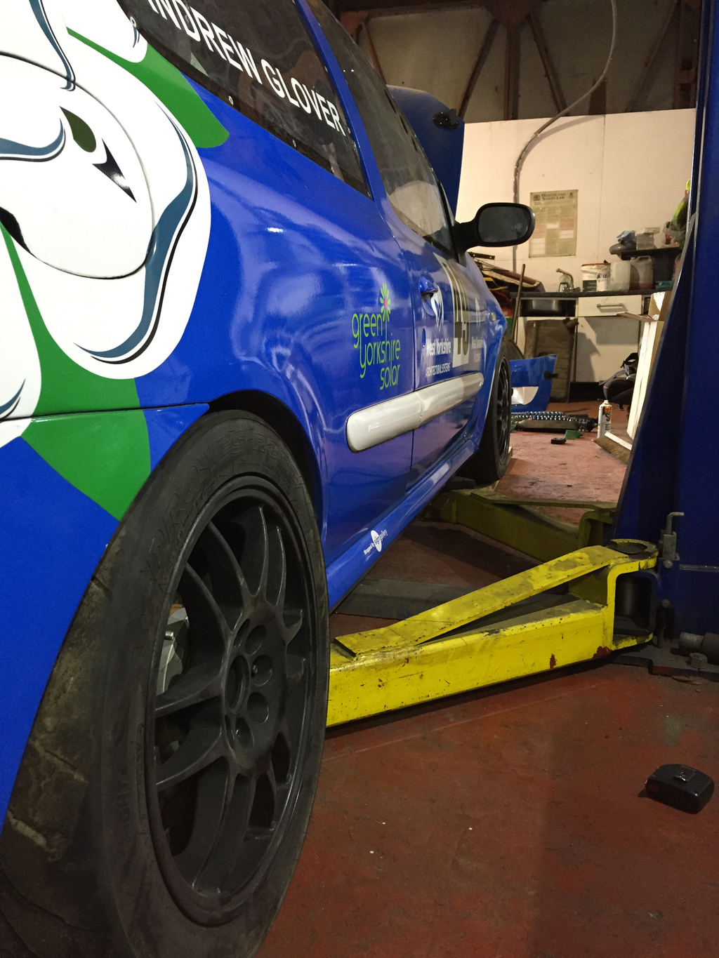

We then set too, to get it lower. Took advice over the ride height, and set it up. About 45mm lower then the last time I raced!
Took out for a spin around the car park, to get it all settled in.

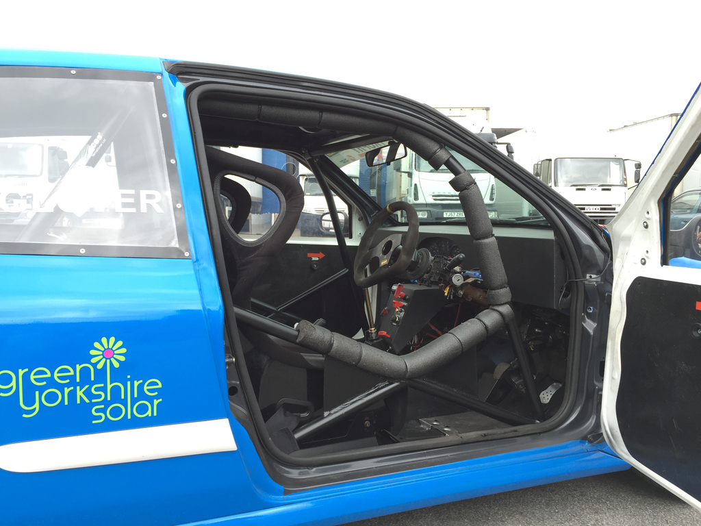

Also, after the spin at Rockingham, I felt vulnerable at the side, so decided to add some more strength. It may be more weight, but I don't particularly fancy being hurt in a crash, so worth the sacrifice!

Really might have to think about getting me a set of these now they can be made in smaller batches, I've heard nothing but good things after fitting them. Will be interesting to see how you get on with them.
I don't think there has been a smaller batch made, I think this was the last set he had.
Looking good Andrew, I do see Dave's point about learning the car first but also see Anthony's point about learning in a car thats set up correctly will be more beneficial (again learning from experience). It doesn't help when the Clios are all different specs so hard to judge driver improvemnts, apart from improved lap times. Again hard to tell if its driver or modification related thats taken the seconds off, I suspect both make a combined effort.
Good thing that the hubs are being made but sad now as my hubs are longer "Limited Edition" :( lol

Nice one mate.. Good to see the door crosses in!.. Interested to see how much it weighs, have you had it weighed before?
Yes, after the first batch of work I had done, it weighed in at 891KG, without me in it. I haven't made any significant changes since then (other than the engine rebuild, which i dont think would have changed the weight). We did weigh them before we fit them, and I am expecting to see an increase of 16kg.

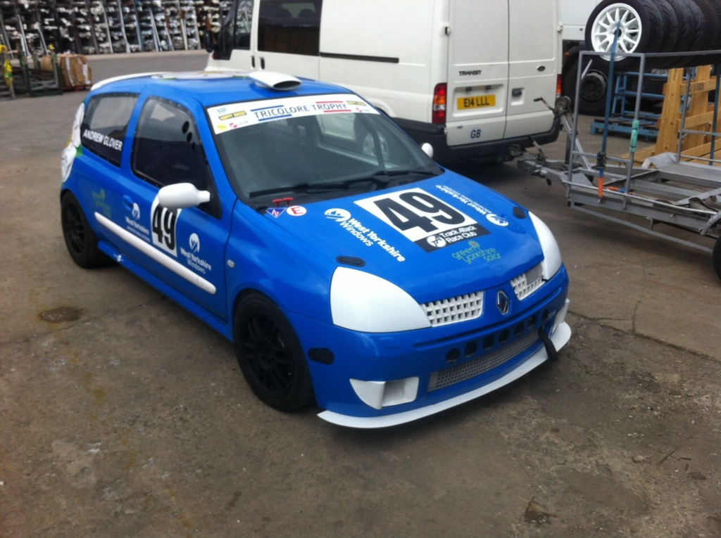

A couple of cosmetic changes. Put some white front light blanks in, and fitted the white wheels. Think it looks pretty good now:)
Other than that, the car is good to go. Not sure what the grid will end up like for Cadwell, but hope it's a good one, and I'll try to remember to record the races!

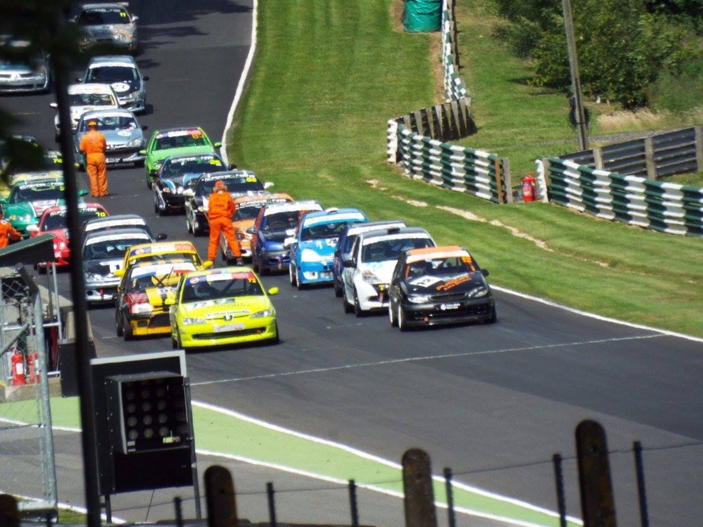

Okay, not really changed much on the car, just been getting used to it. Didn't do too good at Cadwell last time out though, as had real trouble with fuelling. Qualified in 7th, but could have been quicker. I was struggling with the car loosing power in 4th, couldn't even get enough speed to find 5th gear!
Back in the pits, we thought it was the fuel pump. Luckily, Dave Bell had a spare, so we stopped it over.
Started the first race well, kept my spot from the start and took a place on the second corner. Then, the problem started getting worst. Started loosing power in all gears. It mainly seemed to happen around corners, so we presumed it was fuel starvation! Finished first race in 13th!
So we brimmed the tank, to test/try out if it was fuel starvation. 51litres worth of extra weight! Anyway, it wasn't that, and I didn't finish the first lap. Ended up limping back to the pits and loaded up for a irritated trip home!
If you listen, you can hear it missing on the video, and see the difference as I got paced!

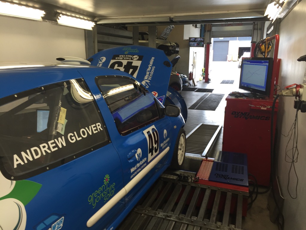

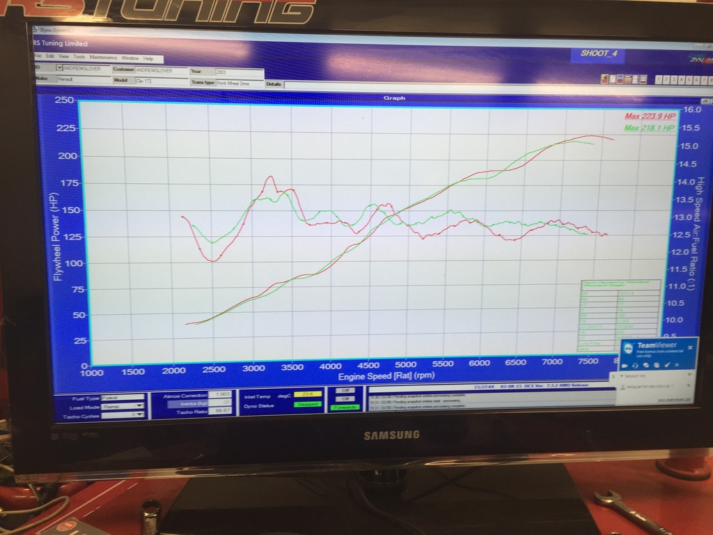

Long story short, we went back to basics at RS Tuning, and looked at the things we had done. We had changed the starter motor and alternator, mainly as a precaution as I'd been struggling to start. We checked all the wiring, and one of the wires was touching the manifold, and had burned through! Problem solved!
So, the good news, while we RS, we got the car back on the dyno, and got some more power out of it
We also had it running for over an hour, without a single misfire, so hopefully it's mended.

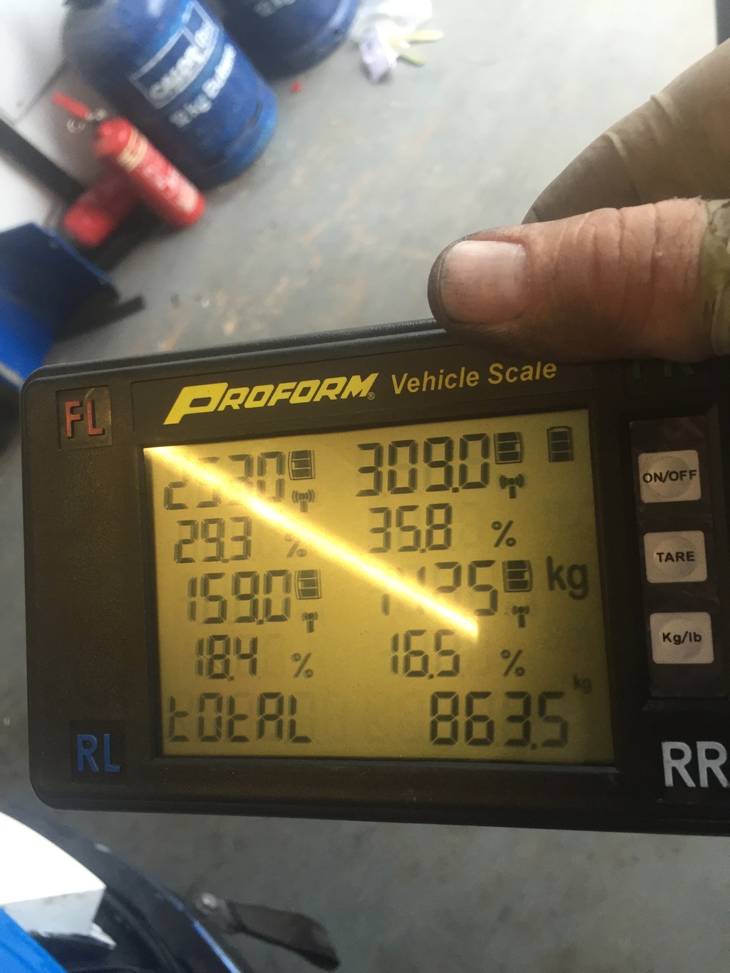

Also, forgot to mention that I've had it on the scales.
Not bad, I don't think :) this was with 20 litres of fuel! We did get the corners within 3kg at the front, but couldn't get any closer than 13kg at the rear.

Hopefully the rear end changes, and moving the fuel tank will help balance the weight a bit better, and probably reduce the overall weight. I'd imagine the steering convention will reduce it a bit as well, so could end up with an even lighter car:)

Great update thats some serious weight reduction there, cant see how you managed to get down in to the 60s, are you running perspex windcreen?
  Renault Clio 172
I binned my 4pots and went back to standard, just make sure their well maintained.
Ha, no mate. If it makes you feel any batter, I also have no idea how I got down to that weight! I actually got one of the corner scales and weighed myself, and it courted I'm a fat bugger, so it must be right :)
