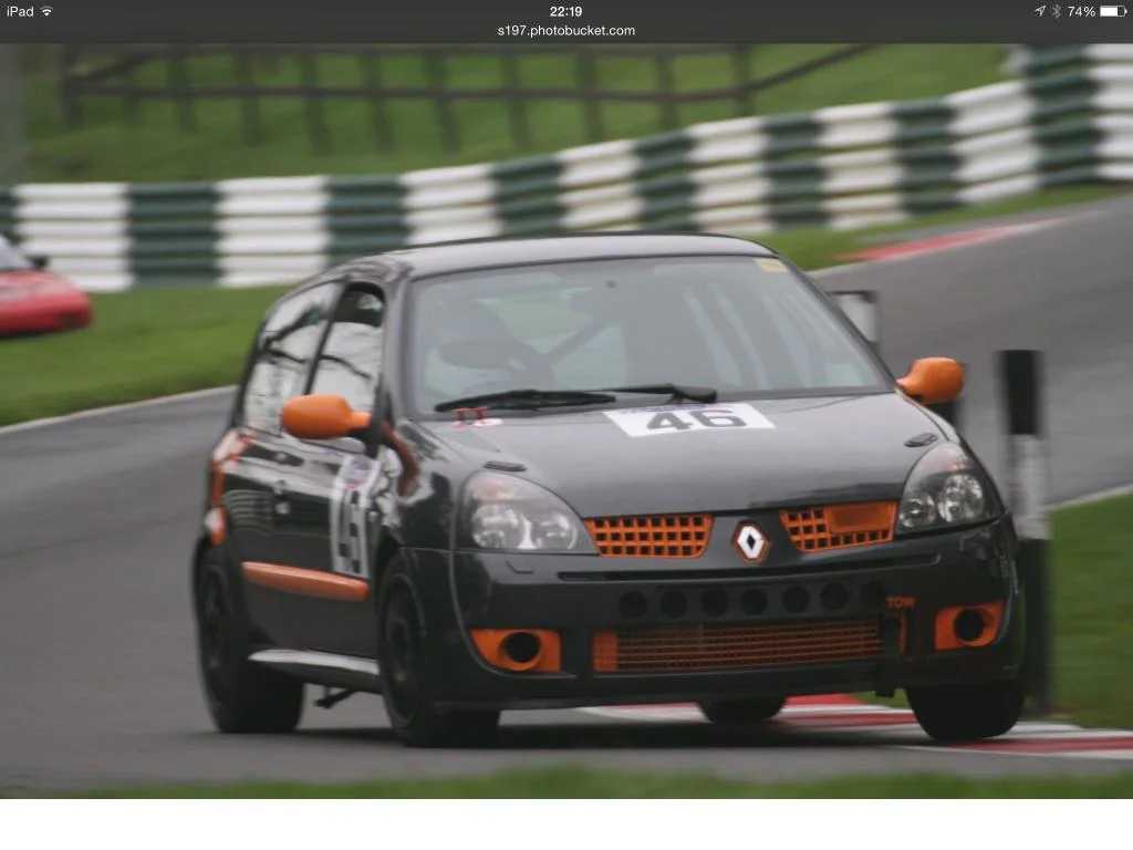

Thought I'd share a bit about my car and clio experience so far...
I bought an ebay clio at the beginning of the year, to scratch a racing itch I've had for years, racing. No idea what I was looking for, or what I'd bought!
Ended up with my 2003 172 clio. Absolutely love it!!
I tracked it a few times and couldn't believe that a risky ebay purchase didn't turn out to be a turd. The car really did feel like a good one.
I took it to a chap in Wakefield that builds cars, to have a look at it and let me know what I'd bought. The car is pretty stripped, has a role cage, racing seats, etc, and ready to race. Adjustable suspention, stuff like that.

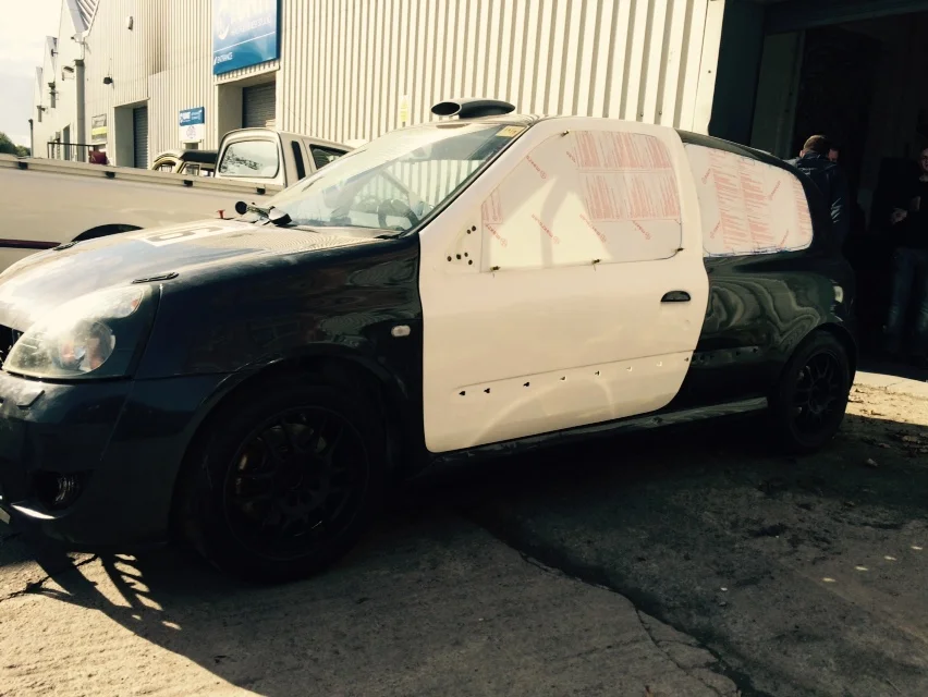

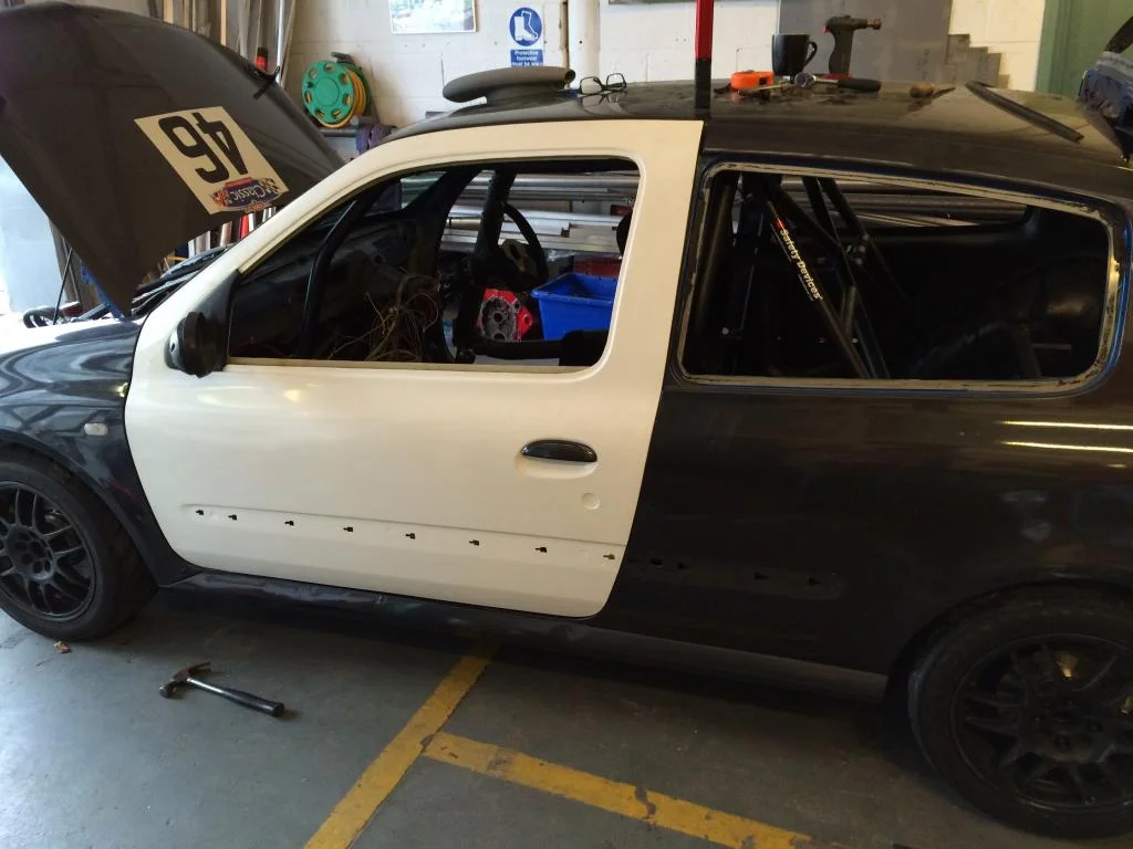

Today, fitted new GRP doors, from CM Composites, removed the glass, in prep for Perspex, and tidied up a bit of the wiring, after removing the dash. Also fitted a bar on the back suspention that stiffens stuff up, from Whitline. Electrician also added a push button start, cow there cool!

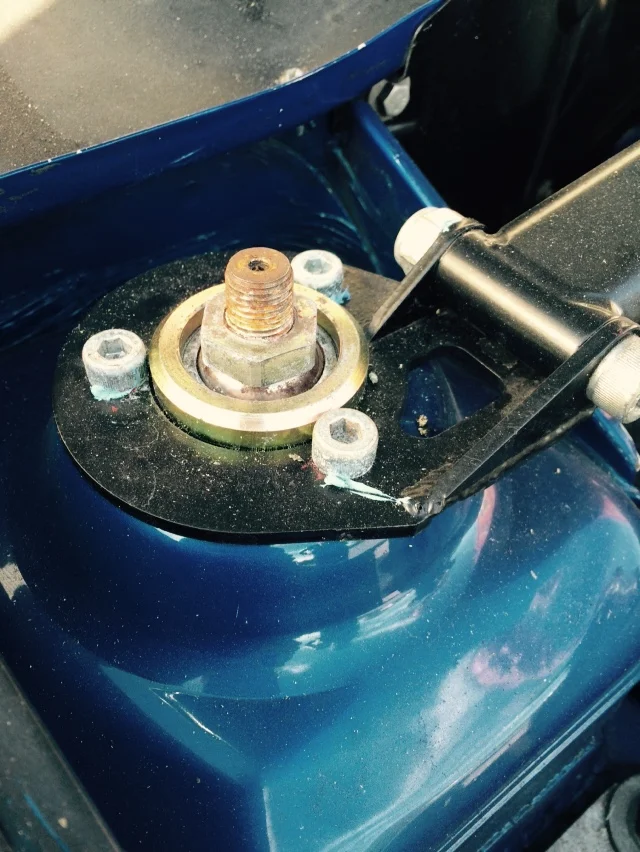

Just ordered some rear camber shims, a rear axle bearing conversion kit and a gear linkage kit. Not sure if I'll have time to fit them before Snetterton though. Probably just be part of the winter build stuff.

Can I ask how you secured your windows in? Screwed fronts bonded rears?
I'm fitting mine this week :) also how did you get the rears out lol don't wanna break em lol
  Renault Clio 172
Cracking work so far :smile:
I'm fitting mine this week :smile: also how did you get the rears out lol don't wanna break em lol
Screwed all in. Against some other opinions, I like the look when they are screwed in, it shows that they are changed!
Started cutting the back windows out, with a wire and blade, then ran out steam, so popped them with a hammer! Much quicker:).

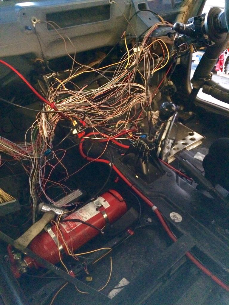

Time for a couple of updates. Done a load of stuff, so will separate them all. Turns out, the car is so much better than I thought! I knew when driving, it was good, but on closer inspection, there is more to the car than first seen.
Anyway, electric starter fitter, wires all tidied up and ready for the new Ali dash (still to make).
From this....
To this....
Also stripped a load of un needed wires out.

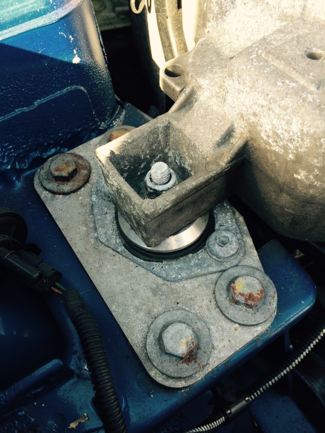

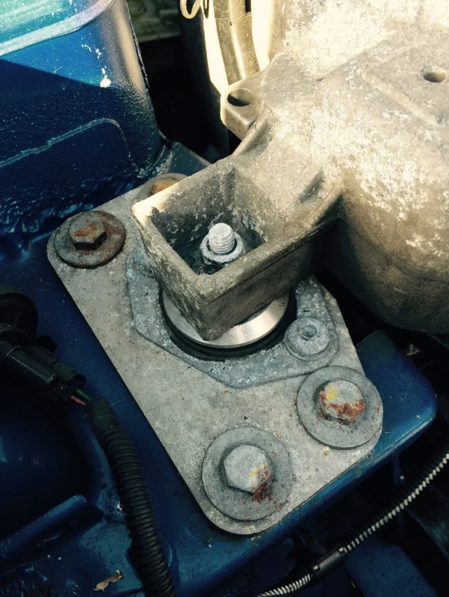

Next, was fitting the new matched and ported inlet manifold. Found once I'd taken the old one off, that it looks like the cylinder head has had some work done to it! That will save me a few quid!
Bit of work done here. Picture doesn't show it too much.
Fitted new gaskets, silicone sealed to ensure no leaks!
All done and started first time!
Changed the plugs and leads while at it. Sounds really sharp now.

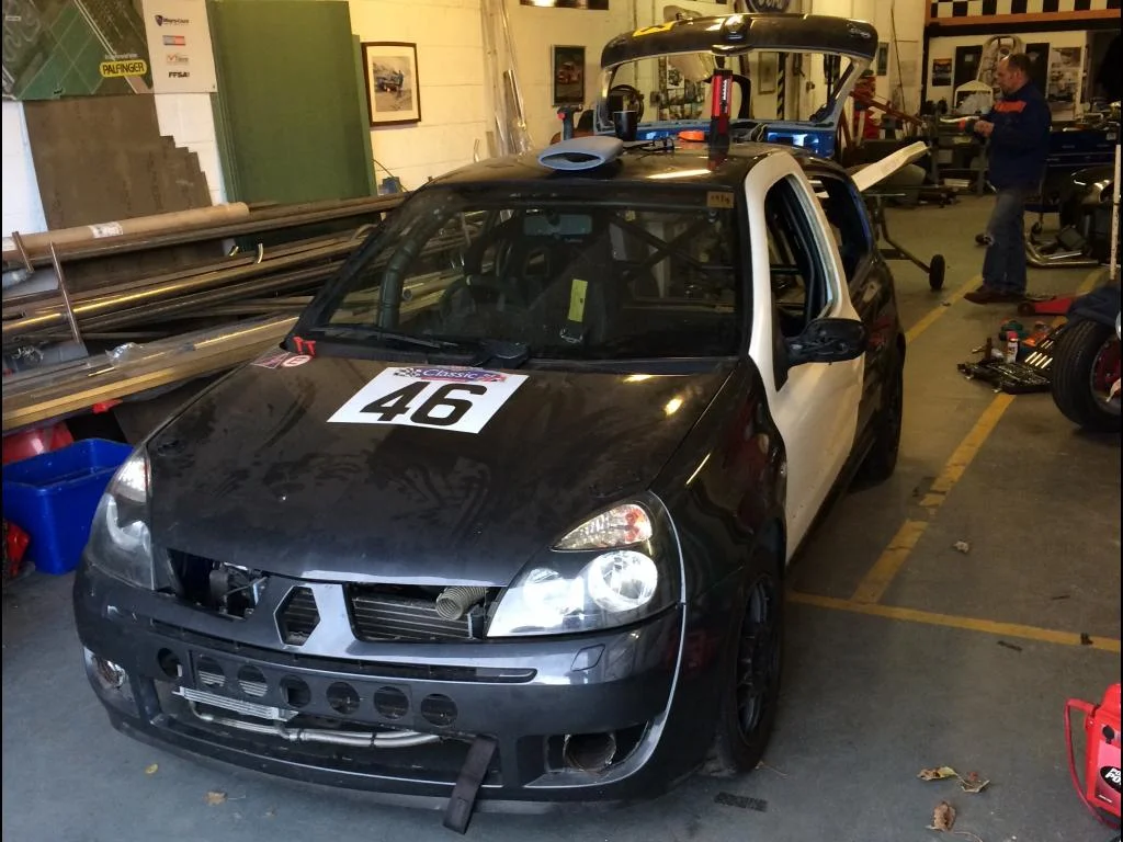

Re aligned the air intake, so it has a straight path from the front grill, rather than filling the battery hole, that it used to.
  Renault Clio 172
I always struggle to get the car on the trailer, as its a bit low at the front, so fitted some of these catches to make it easier to get on and off.
It'll also make it a bit safer when racing.

Painted all the trims today, to change from Orange to white.
Realist I took all the pictures with a filter on, so these are actually white, not cream!
  Renault Clio 172

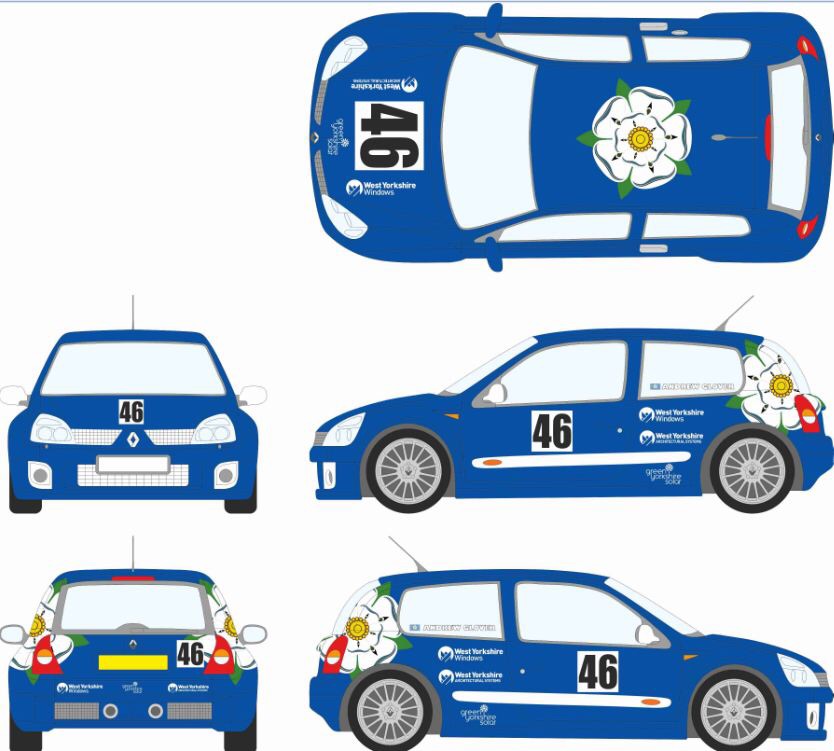

Cars now ready to go to the wrapping shop. This time next week, it'll be a true Yorkshire Racing Car!!
All the windows are cut and fitted, but we removed them ready for tomorrow.
