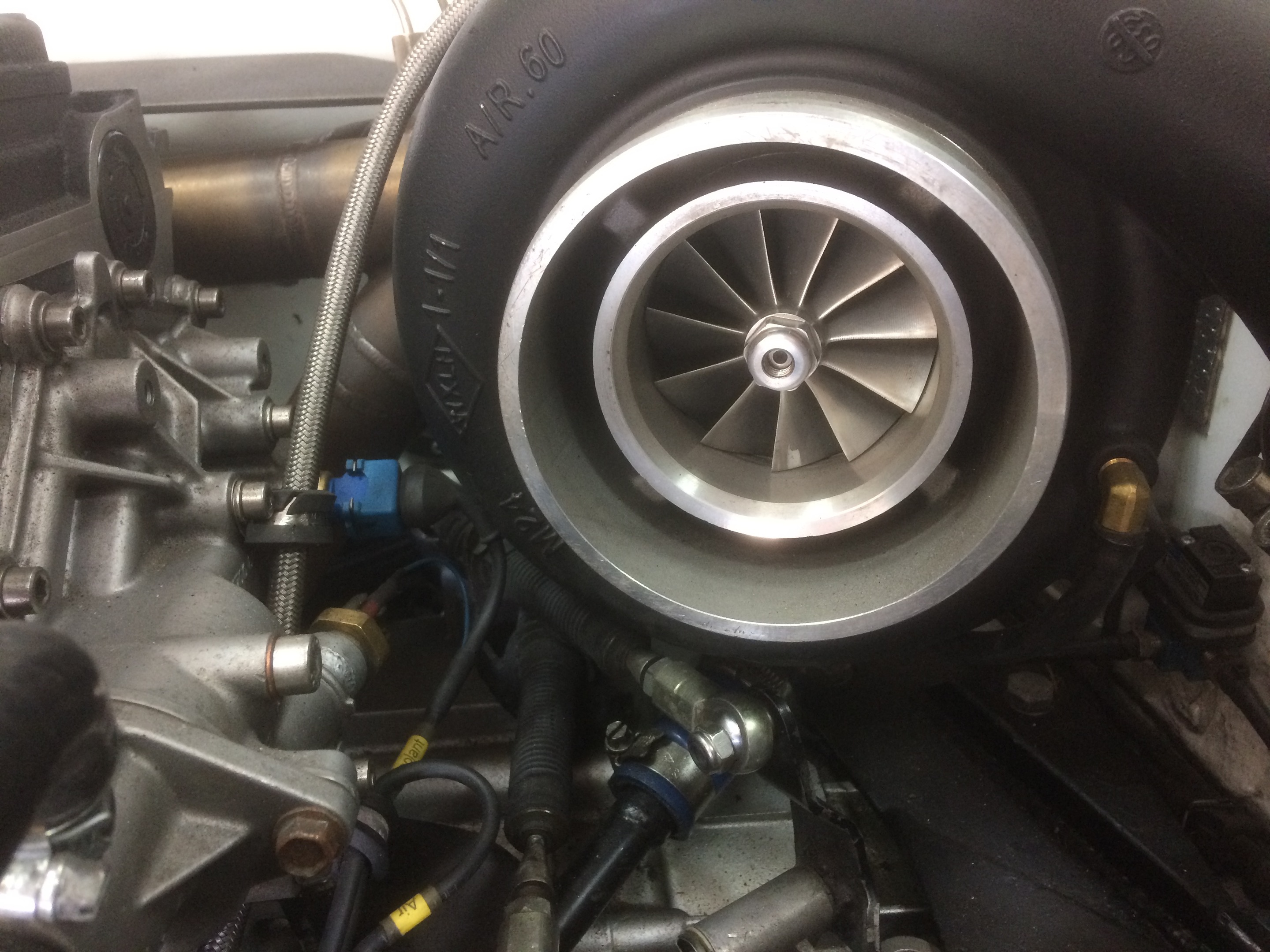

I should be arriving at efi parts in 12 hours, im a little worried because Andy who fitted my box noticed that the actuator rod was rubbing, so he heated it up and adjusted it over to give clearance, but he said it could have damaged the actuator and the car felt slightly down on boost to him compared to last time he had the car.
This could also be because of the new walbro thats been fitted because scoff said he thought my old pump was on its way out the last time my car was mapped.
We shall see tomorrow, lets hope its all hunky dory.

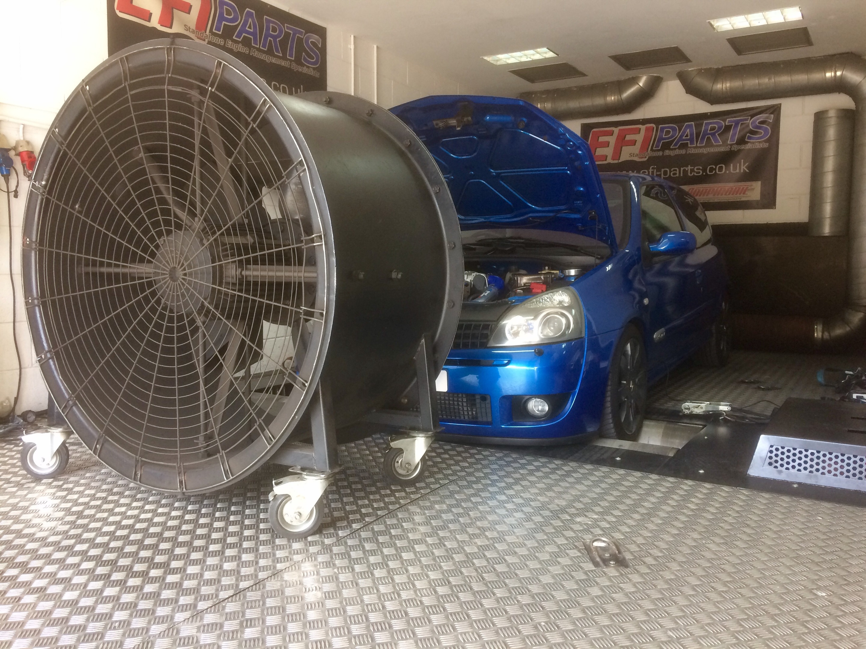

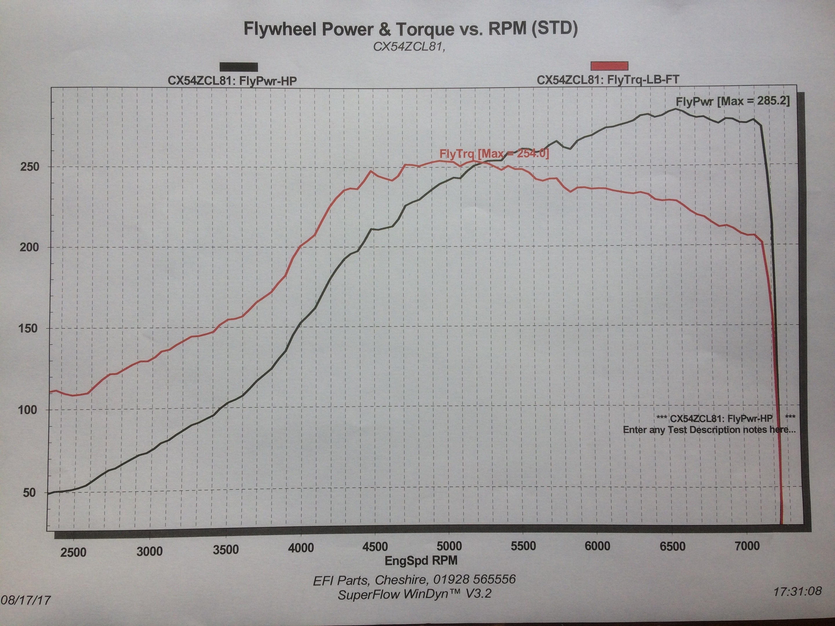

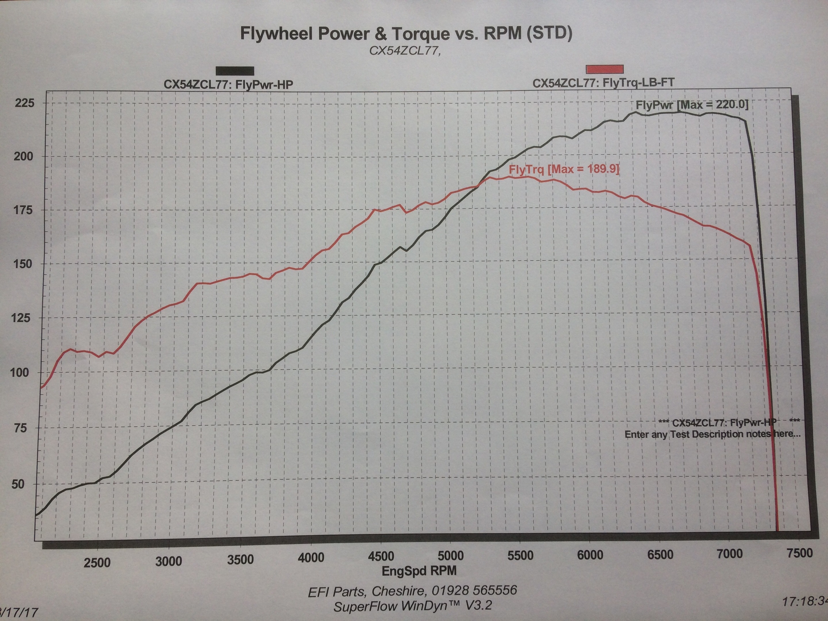

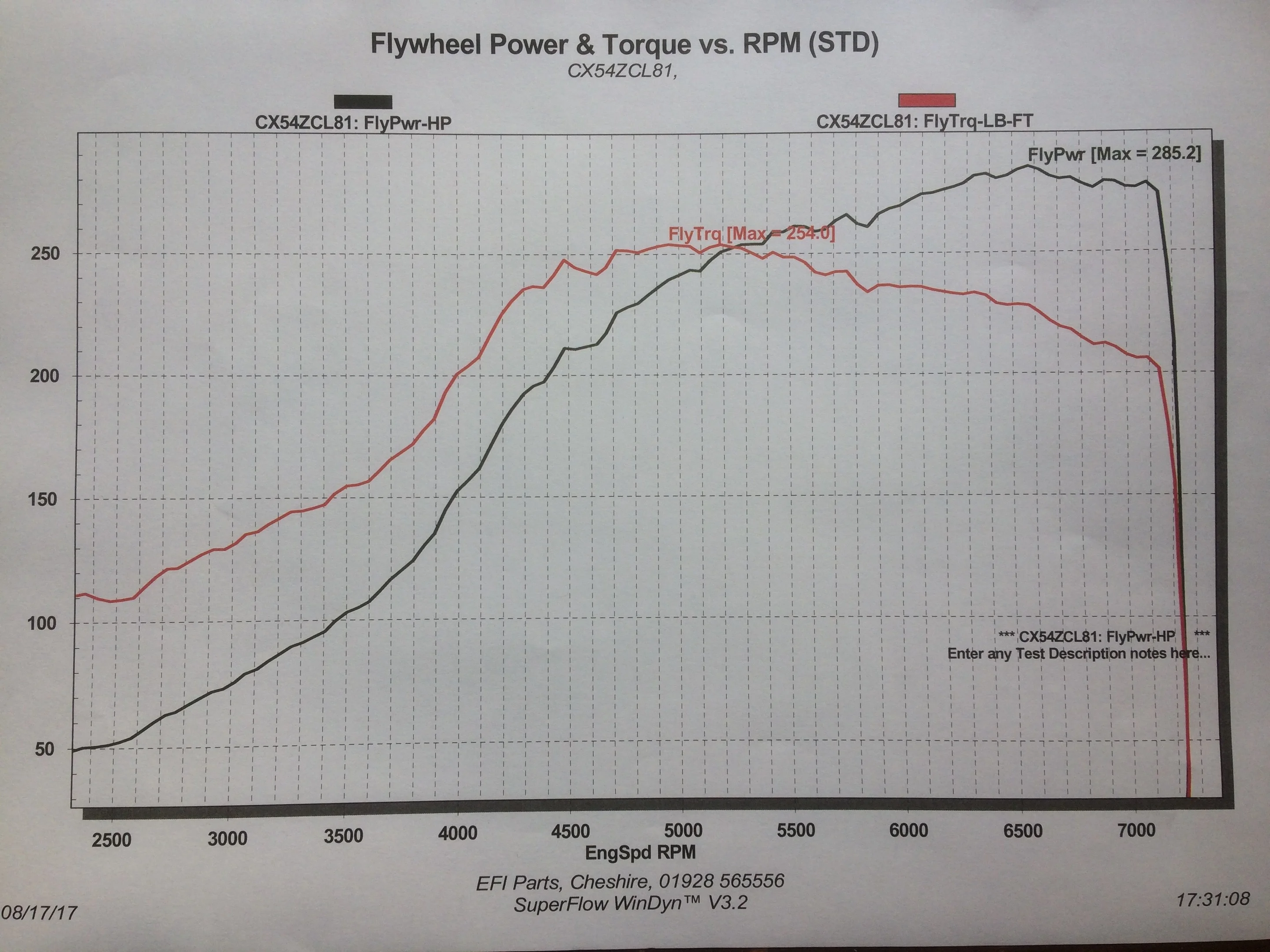

Yesterday i made the trip to efi, the car was previously mapped to 275hp, scoff had to lower the boost at high rpm the previous time as it was leaning out, so he advised me to get an uprated fuel pump, which i did.
So today it made 285.2 bhp and 220 bhp on low boost, it feels f**king rapid, the midrange torque feels awesome, he told me he left a big dollop midrange, which you can really feel.
I was nearly late for work on the way home tho as the traffic around Runcorn was ridiculous with the M6 been shut!
So as scoff predicted, after fitting the walbro it was massively over fuelling, so he was right, the oem pump was fucked!
He was also really happy with how the car behaved, it took a bit of adjusting but it ran faultlessly with some healthy figures, he was happy, so i was happy :smile:

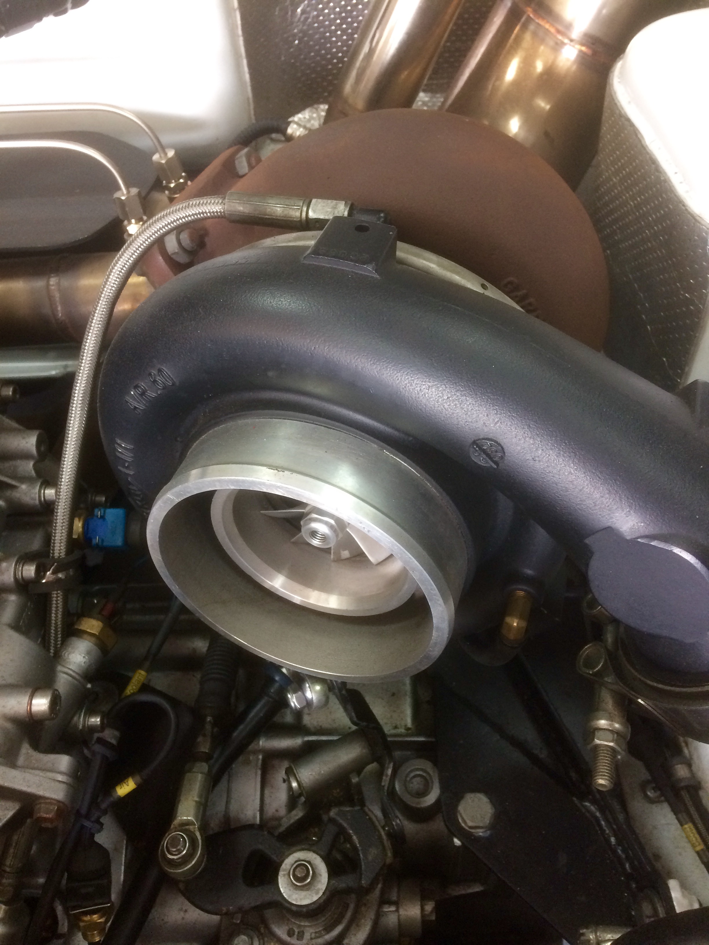

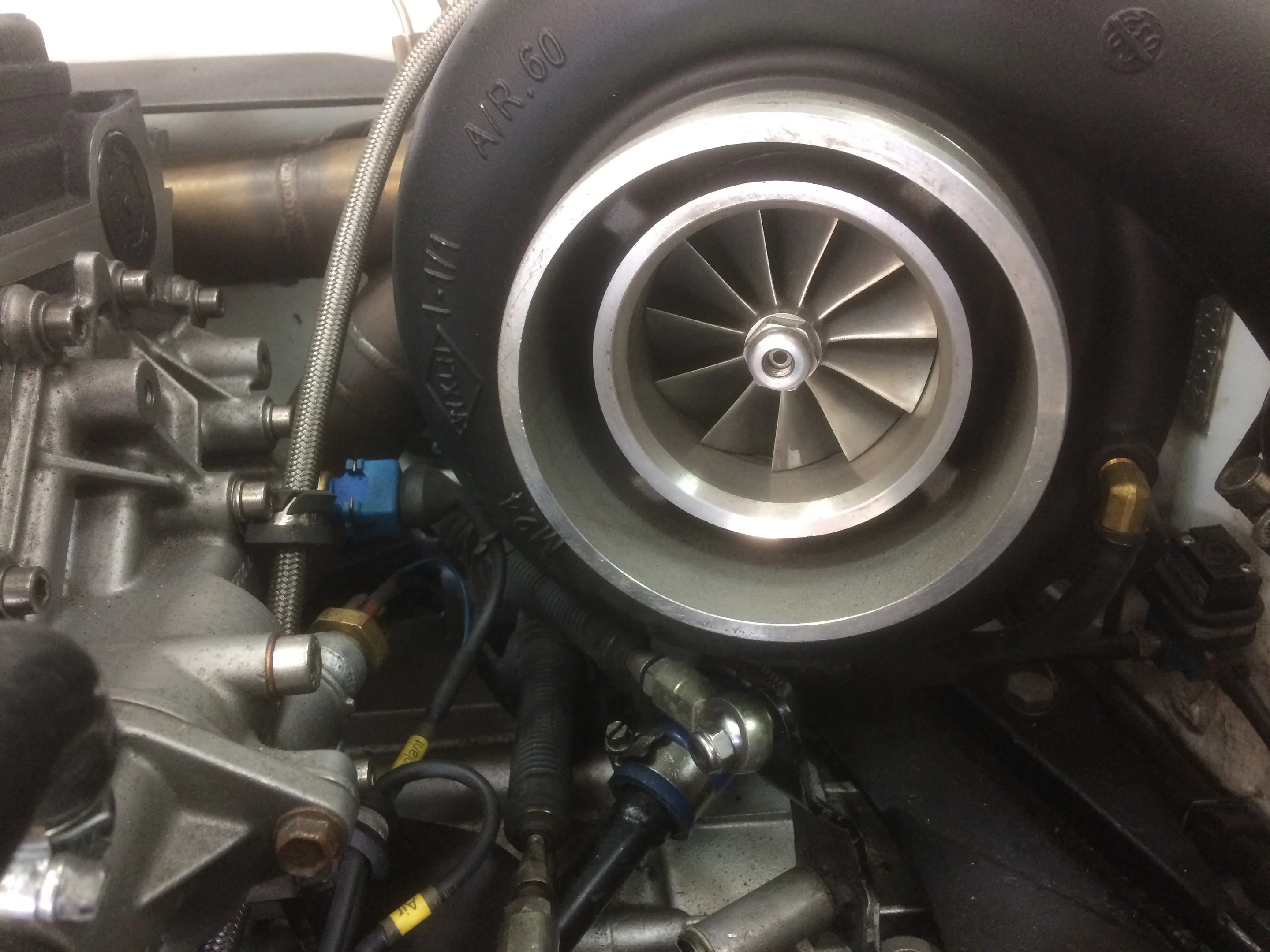

Scoffs little turbo..

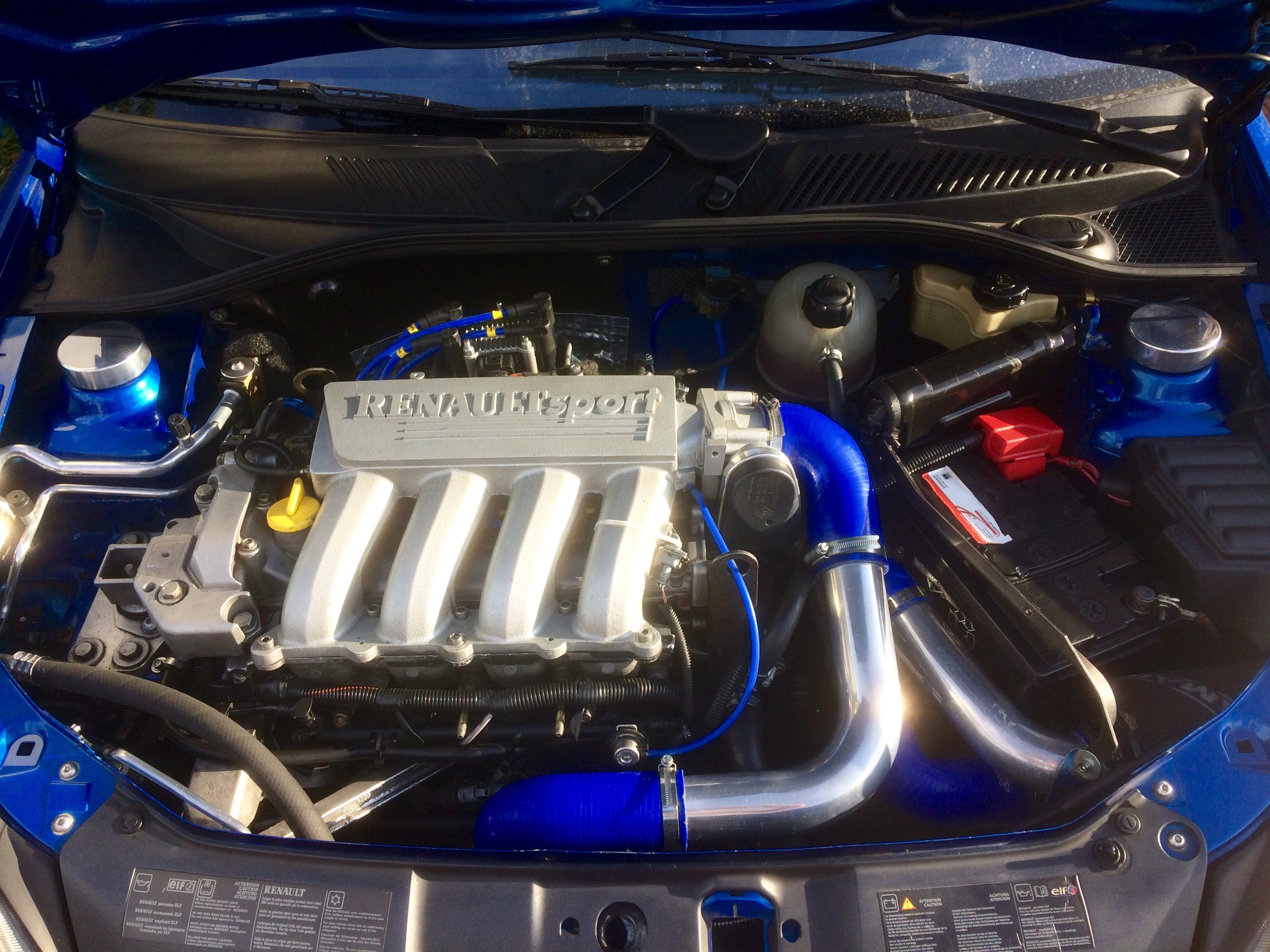

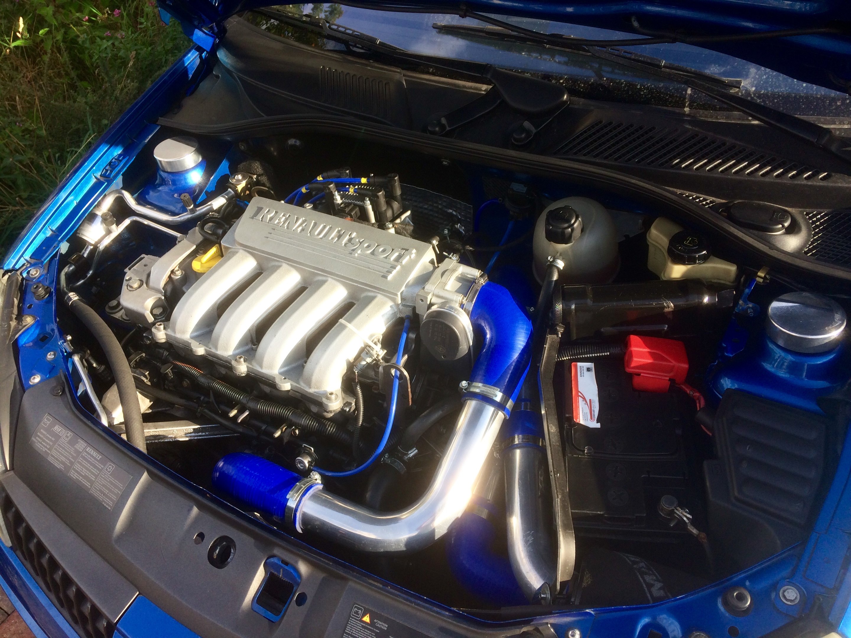

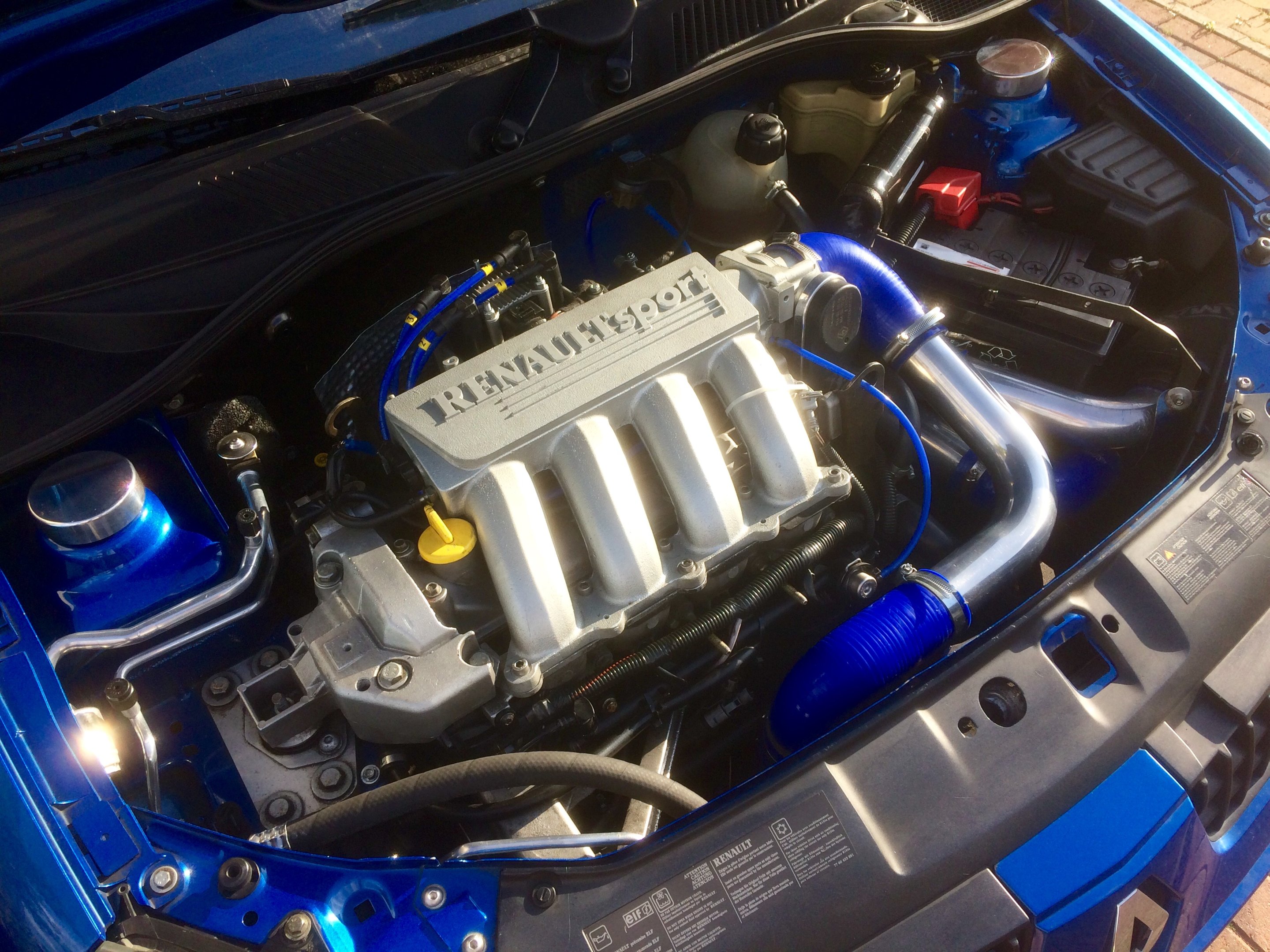

So today with the sun out i decided to give the bay a clean, its not perfect but its pretty good, i need to respray the inlet and get some autosol as ive run out so i had to polish the metal with maguiars compound, but its brought it up better than it was as everything was looking dull, i have also removed the clioturbo sticker off the boost pipe haha!
That engine bay looks great!! The autosol is really good though isn't it, was amazed how well it brought up my air-con pipes and also how much crap came off them, loads of black on the cloth!! lol
leedsboy
  Bean 182 + E70 X5
Bang a new coolant bottle on with some fresh coolant in and that'll look spot on.
One thing I've noticed is you're not running a fuel guard cover. Is it not possible with the boost pipes?
  RB Clio 182
So all good now?
Yes mate all good :smile:
Finally lol
That coolant bottle was brand new the other year but its gone shitty again, ill probs do the coolant and tank again for the sake of about 20 nicker.

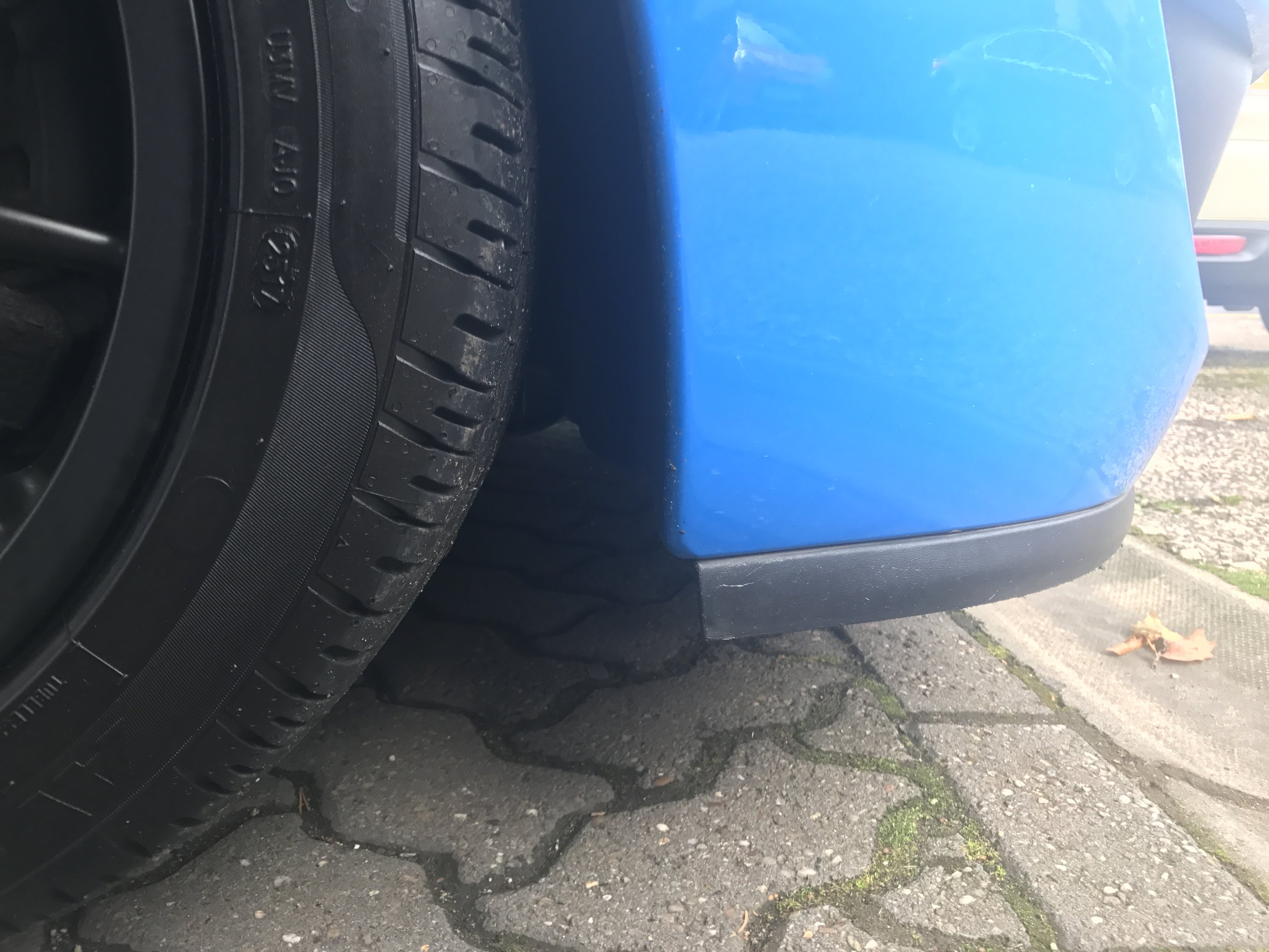

I really want another oem front splitter, i bought one a few years a go for £125iirc, but when my car came out of the garage it didnt have one on, and the garage denied it. They are £200+ now tho :(
