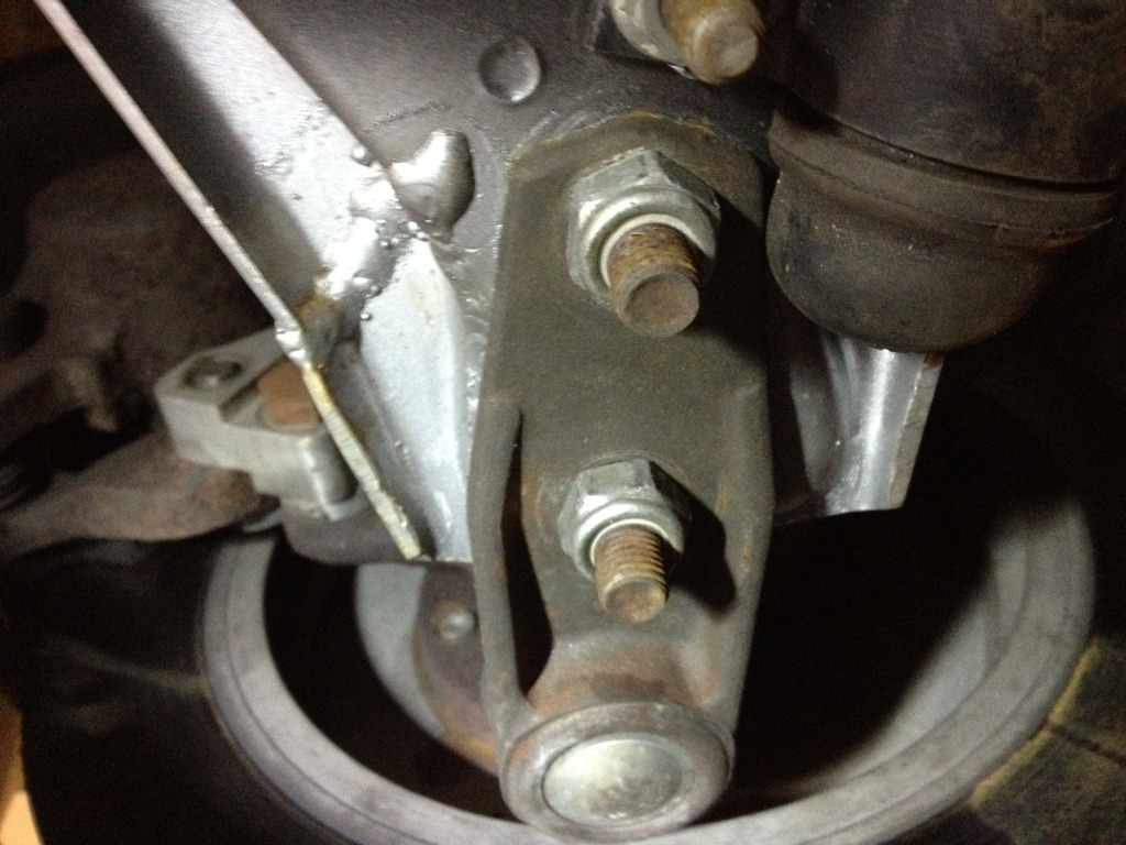

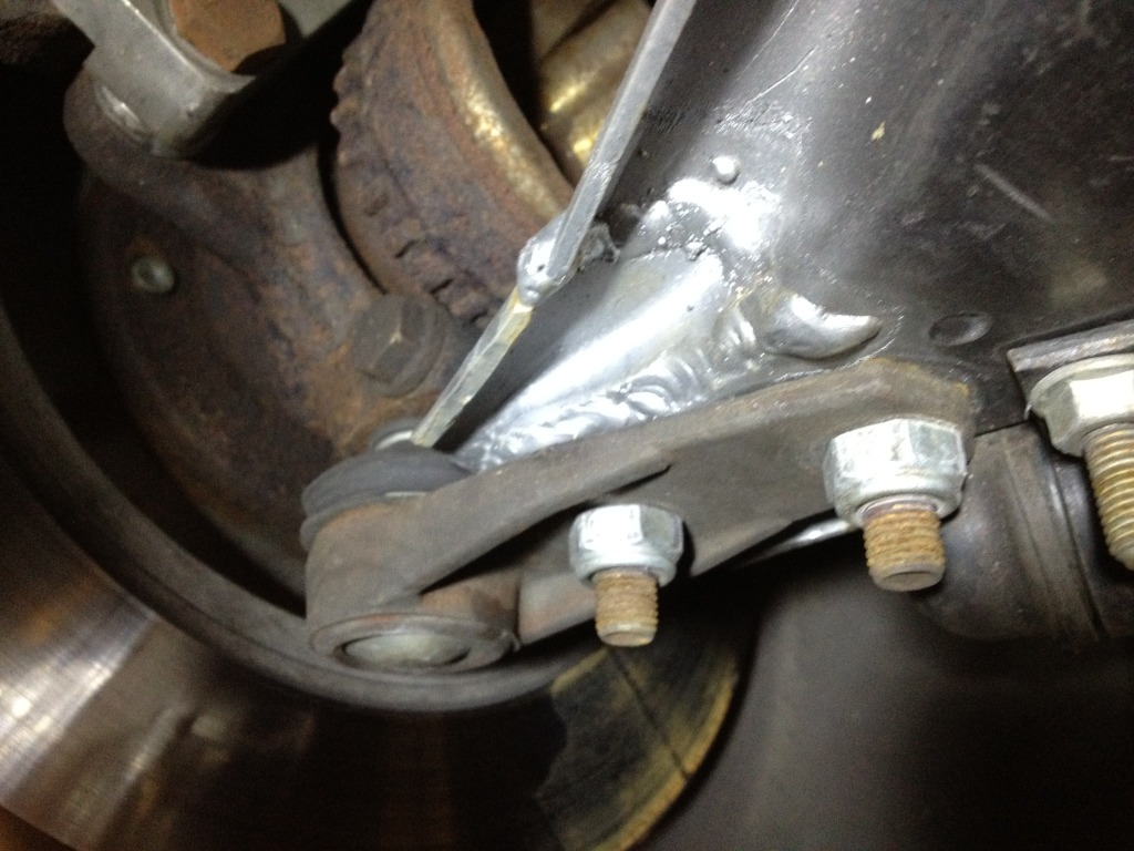

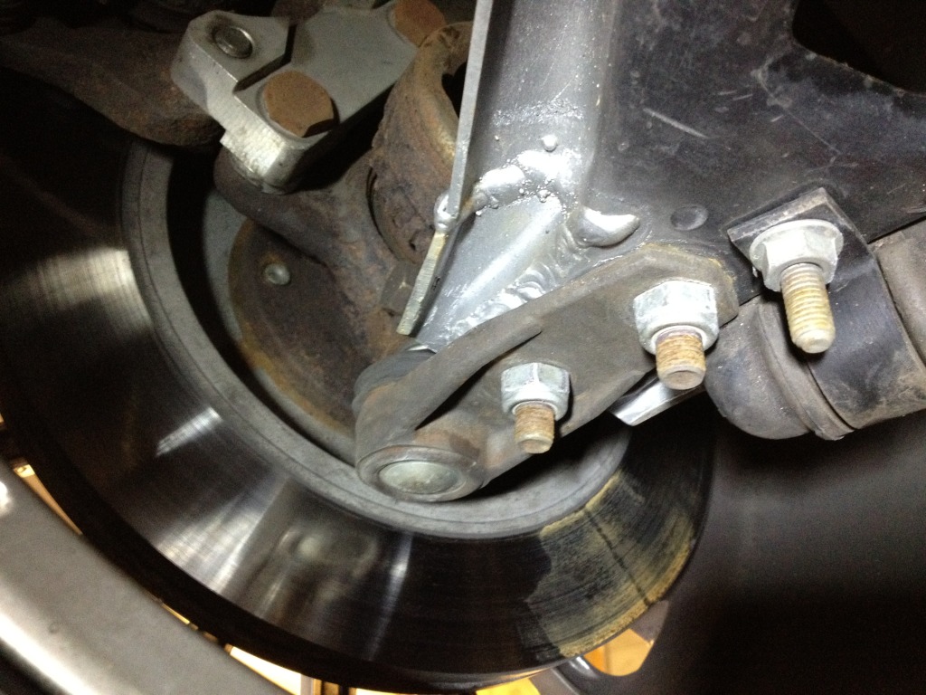

A fair bit of work has been done to improve the clio's handiling characteristics recently. When she first hit the road, the handling was interesting to say the least ! Over 50-60 mph and the car felt scarily twitchy. The trip to french car show was a long one ! it felt as if the front was too light and also that there could be some movement at the rear. I tried various camber and toe settings with not much joy, so set about altering the front caster angle.
I redrilled the front wishbones and then repositioned the lower balljoints further forward, crudely but effectively increasing the caster angle to around 5 degrees. The difference was amazing, all of sudden i had a useable car and it feels much better up to and over 100. I still think it would benefit from even more caster, but for that i'll either need to hack the turrets up, or fit some adjustable top mounts......
I'll add pics of the modification later on

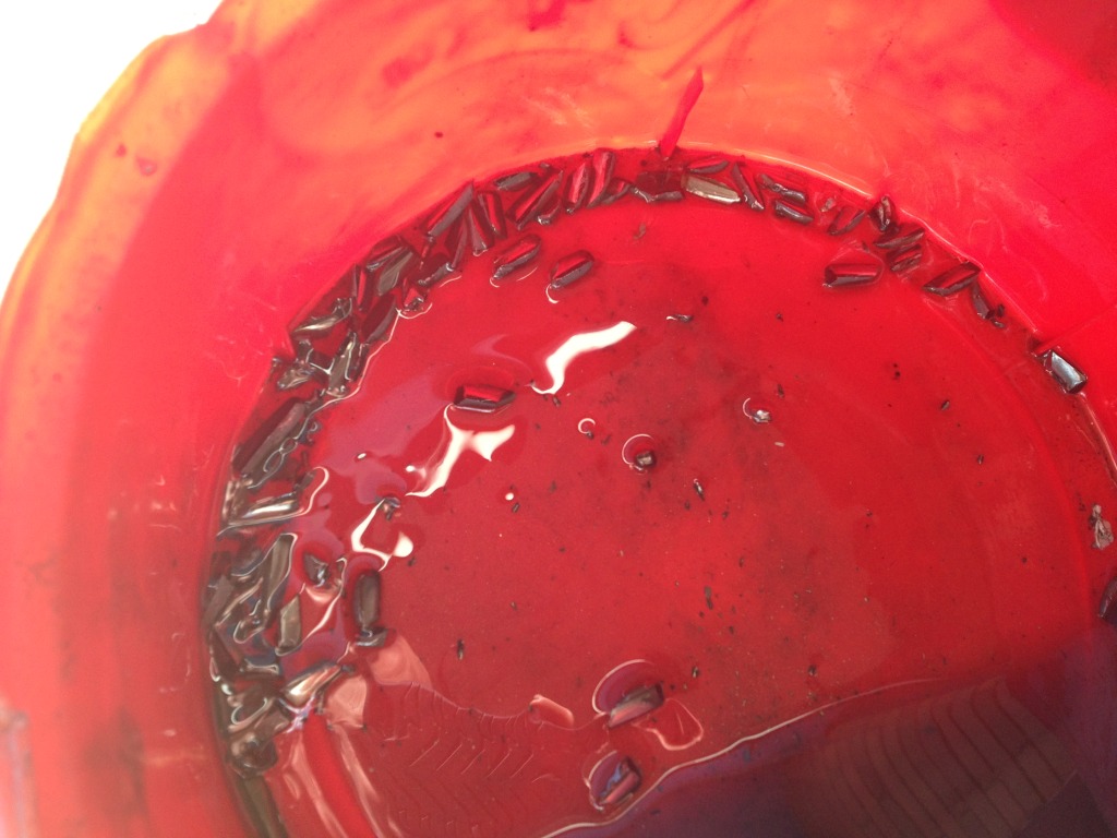

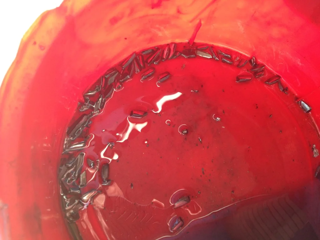

Well, as many of you already know, i managed to strip all the teeth from 5th gear on Sunday...... It was a day that was destined to fail from the off...... while driving over to Efi-Parts the car developed a misfire and i felt it was caused by some recently changed spark plugs, so once i arrived at scoff's for around 9:30 we made a few phone calls, and managed to source some replacement NGK's. A trip down Runcorn and i swapped them over. Quick road test, and the problem seems cured....... so i heads back to give a white knuckle ride to one of the lads and lo and behold, 120mph, 5th gear, s**t loads of torque and a nasty road undulation i didn't know about equals a wrecked gearbox. oops :-(
Still not giving up, i jacked up the car, unbolted the gearbox end cover and tried to clean out the swarf and bits of teeth. after bolting it back on and testing it up on the industrial estate, the broken teeth were still clattering around inside so decided it wasn't worth the risk of running her on the rollers or attempting the drive home either. Luckily i have AA cover, so the patrol came out and dragged us back to Yorkshire.

Couple of pics
Some of the recovered teeth lol

I know theres more traction etc i'm just a tad surprised is all, it wasn't an off the line job so its simple torque application that's done it, already rolling in gear, thought it'd take way more than that
the reason i'm interested is obviously a common thing now is to fit the VAG box to the F7/F4 series when turbo'd and I had this image of complete indestructability essentially of the VAG boxes. having seen scoffs s**t out 700bhp+ and the box take it on drag slicks at pod I figured they must be hardy. but seeing a relatively low power and new build dropping a box so soon is making me shift my expectations of the VAG boxes and perhaps it isn't as bullet proof an option as I thought!

A boosted vr6 motor puts out way more torque than a boosted f4r or f7r. Mine was 430lbs/ft at 18psi. Also i'm running an standard fit VR6 O2A gearbox, just with a quaife fitted. The O2M is a much stronger gearbox. I'm looking at converting to an O2M now, so we'll see......

You're not reading it right mate, he has the older 02a. It's the 5-speed gearbox which is original on the vr6.
they are known to break above 350hp so actually it isn't bad with his rwd conversion.
  R5GTT, 2L turbo
The 02A / 02Js arn't quite as bullet proof as the later 6 speed things. I broke 3x 3rd gears in an 02J, never seen 5th breaking so it was unexpected but andy will be fine on an 02M if he can shoe horn it in there.
Only recently Jordie with his 9sec 4x4 800hp scirocco started to break 4th gear on the track in his 02M. He's just swapped up to SQS gears and touch wood they're holding up.
