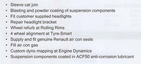

So, I provided Alex with a summary of the work that I was after being done and we agreed on a loose ‘starting’ price. By this stage it was late February 2020 and the gearbox on the Clio sounded like it was crying in pain. My wife flatly refused to drive it in such a state and we were down to using her car mainly for the commuting trips, both to and from work.

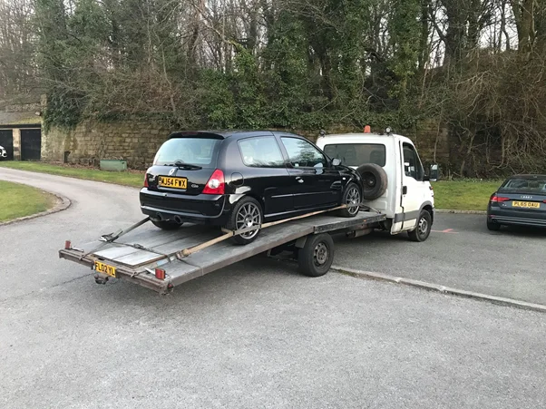

Another niggle that cropped up – Alex was 215 miles away from me. Do I risk driving the car on what would be mainly motorway driving down there? Or do I play it safe and get it transported?
25th March arrived and I got it loaded onto some Eastern European knackered flatbed. The driver could speak 3.2 words of English and seemed to be smiling far too often. Would it get there? Was he having a laugh? Should I have just risked driving it in the first place? I genuinely hadn’t been as concerned about the Clio in all the years I’d had it.
The following day, Alex messages to tell me that Clio arrived intact – relief! Not only that, but this was the time where COVID restrictions came on in force. I was set to work from home, so I didn’t really need the car anyway. But I had no idea if this would affect Alex and his work practices and whether or not some parts would even get delivered?

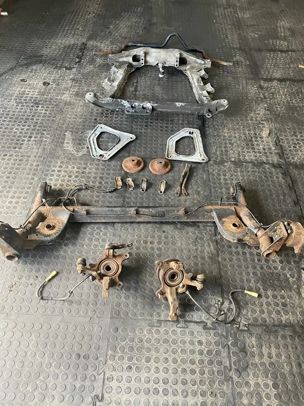

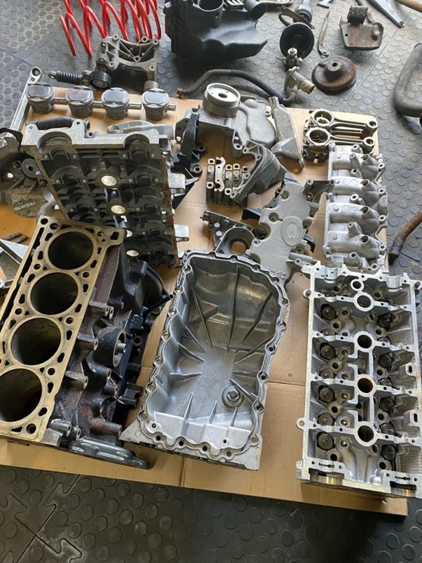

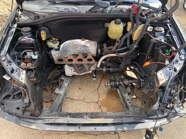

The strip down started in earnest and alarmingly quickly. Even though you know what’s going to go on, it’s still a bit of a shock to see your own car in so many parts!
The strip down and cleaning revealed that I had very slight scoring on one cylinder lining – which matched the same cylinder that had had a failed injector on. Aside from that, Alex said that the engine was in good condition given the age and the mileage, being a good platform to do a refurb/enhanced build on.

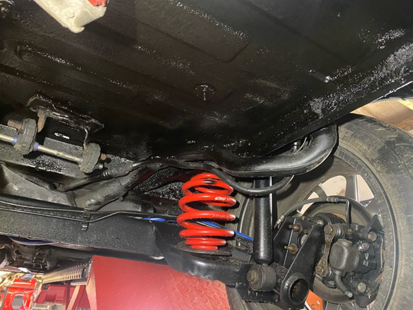

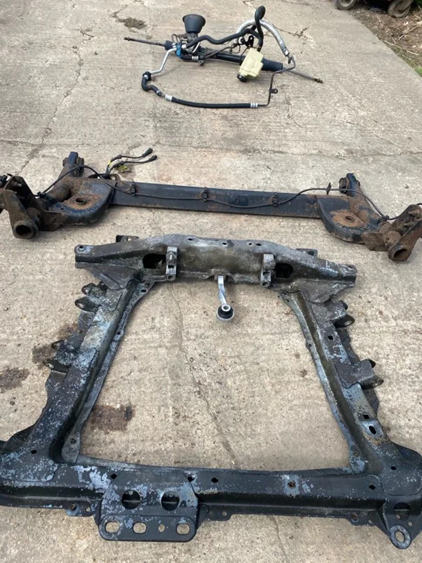

Aesthetically, as can be seen, several bits were very tired – over 15 years of being exposed to the elements and crap thrown up by the road had taken their toll. I wasn’t initially that concerned with the tarting up of such parts – but having seen their condition, I couldn’t just leave them in that state. This was going to get more expensive…. :LOL:

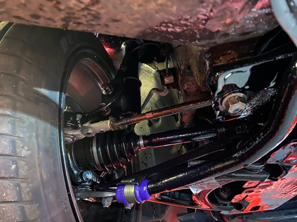

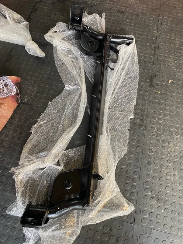

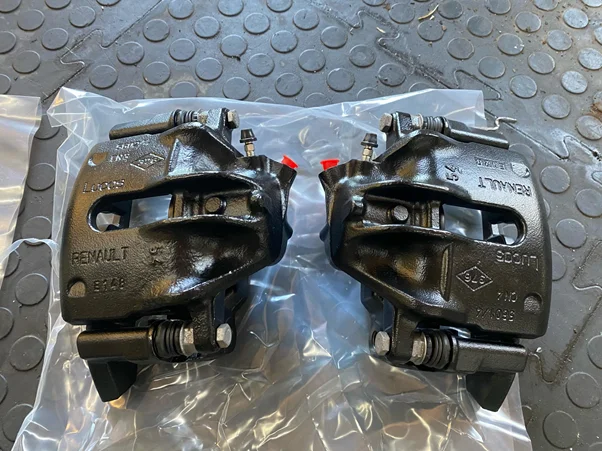

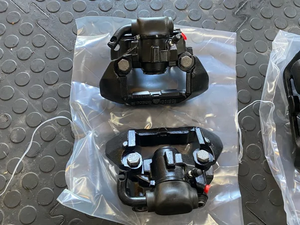

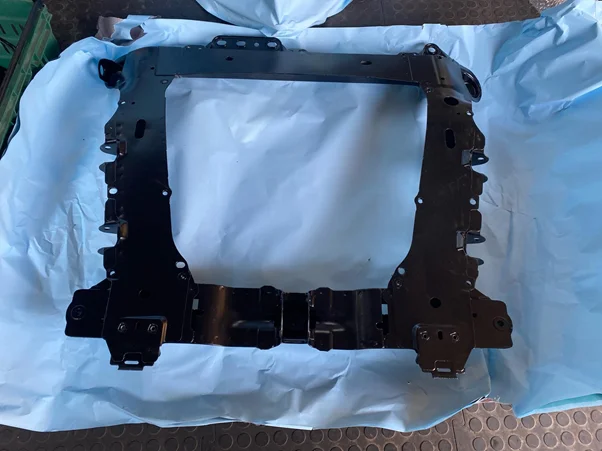

So away various bits went to get refurbed and retreated, subframe, rear beam, brake callipers, etc..

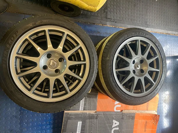

The wheels got a fresh refurb at the same time – a combination of bubbling paint in a few areas along with an ill-fitting tyre seating, meant that pressure was being lost gradually at least on one wheel.

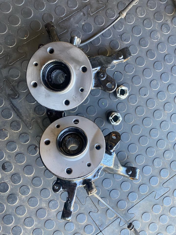

New bearings in the hubs – I honestly can’t recall if I’d ever had the originals replaced?

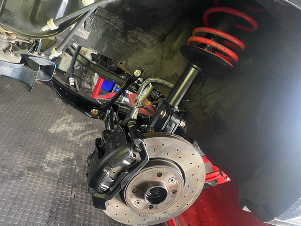

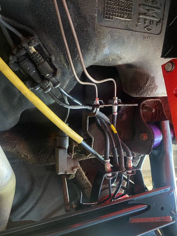

Alex agreed that the brakes were shocking. Not the pads and discs themselves – but the lack of any direct force applied to them. Quite frankly, it was dangerous – the handbrake creaked and groaned when applied and I believe it was only properly engaging on one side. Plus, my brake lines resembled withered spaghetti. They were on the original list to get looked at as well, but to see them in the condition that they were in, revealed just how bad they had got.

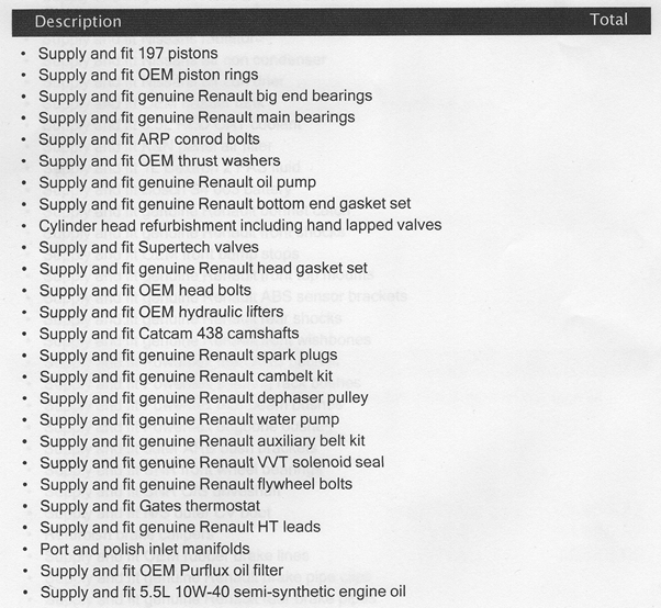

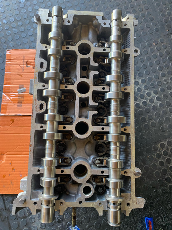

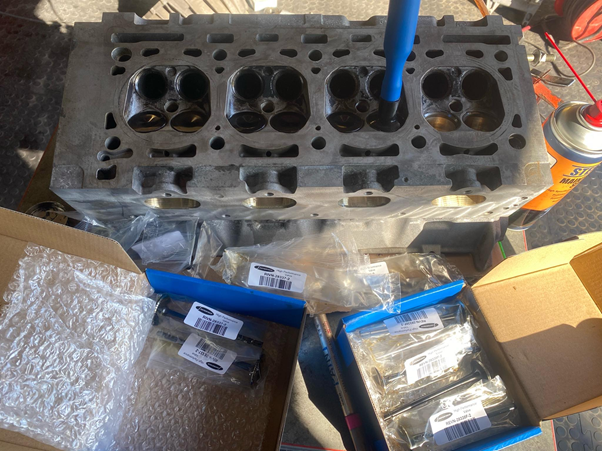

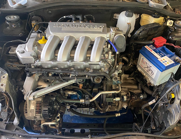

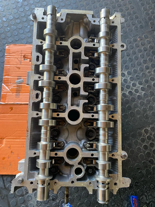

Bits started arriving and Alex was on with the engine rebuild itself. New cams went in…
Lapping of the new valves…

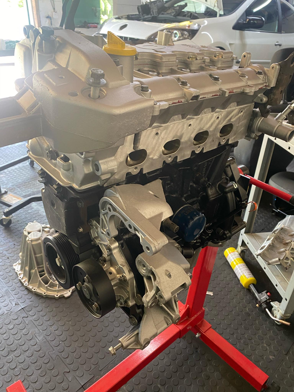

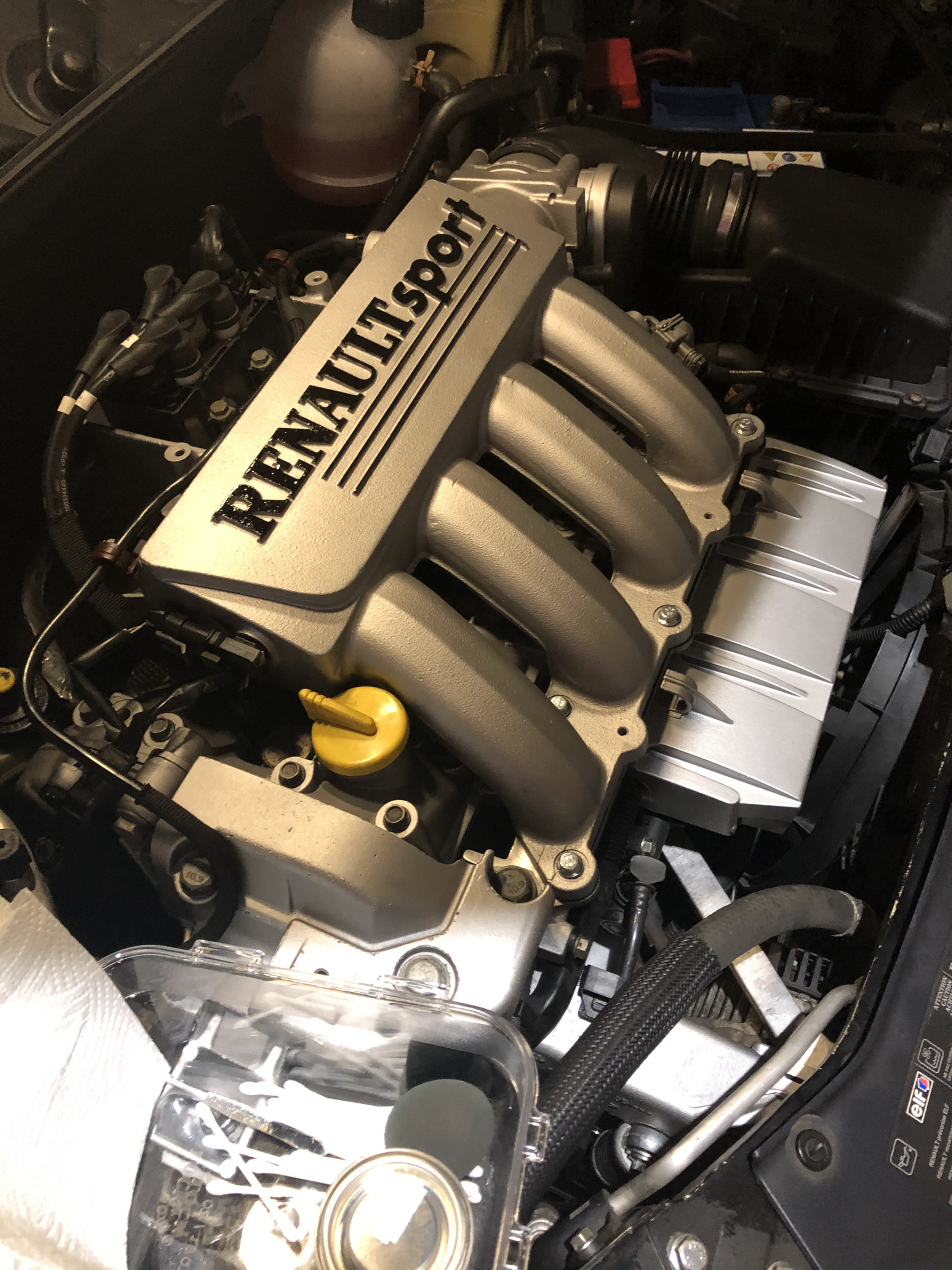

And it wasn’t long (or it didn’t seem like it!) before all the parts started to look like an actual engine again…

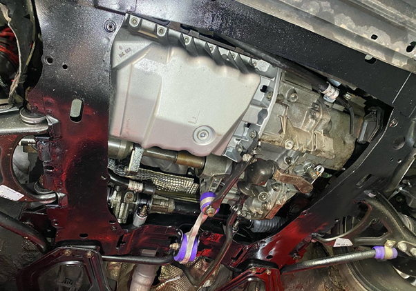

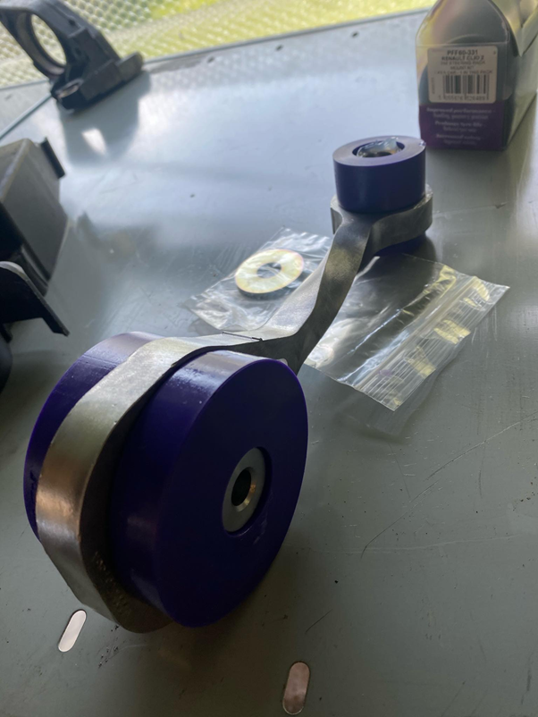

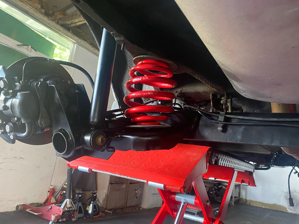

Bushes and fittings aplenty got swapped out as it made a lot of sense to do so at this stage.
The Eibachs went back on. Strictly speaking I should have perhaps replaced these as well – more so with the dampers all round being renewed. But they looked OK, with very little corrosion or tip sections snapped off.

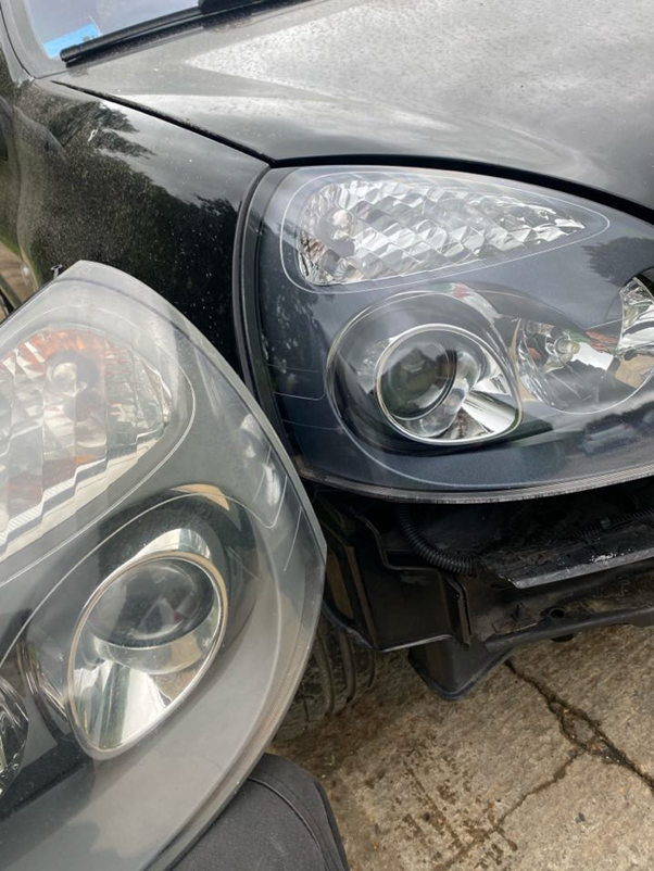

One thing I was eagerly after changing were the shitty, crappy, awful light-silver headlights that 182s came with as standard. These were a pet-peeve of mine and I wanted the darker grey/black ones of the 172s. It took me a while to find a set (and I still have a slight issue with the passenger side one, to be honest) – but the colour difference is very clear.

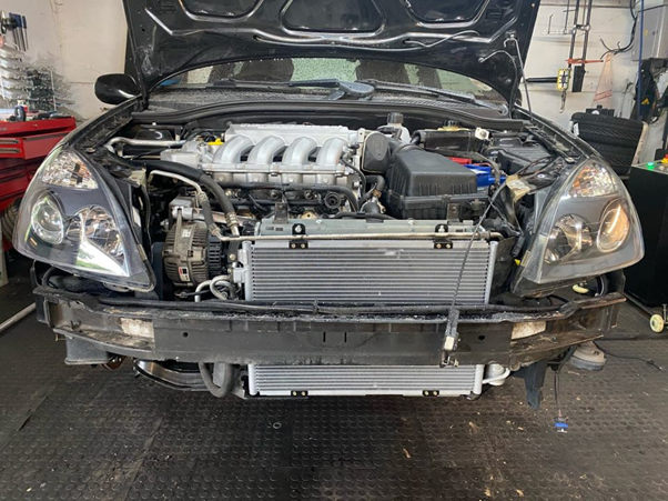

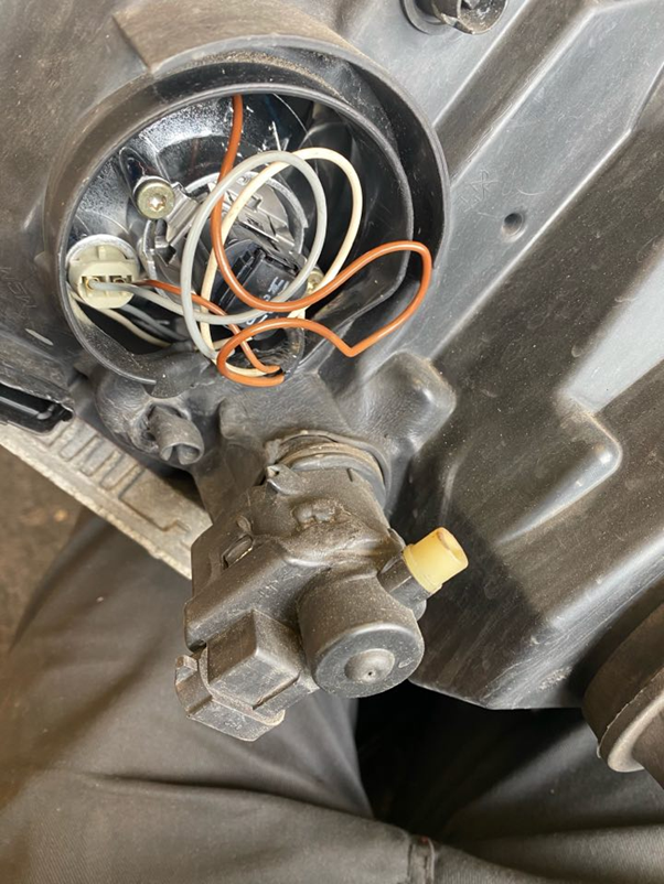

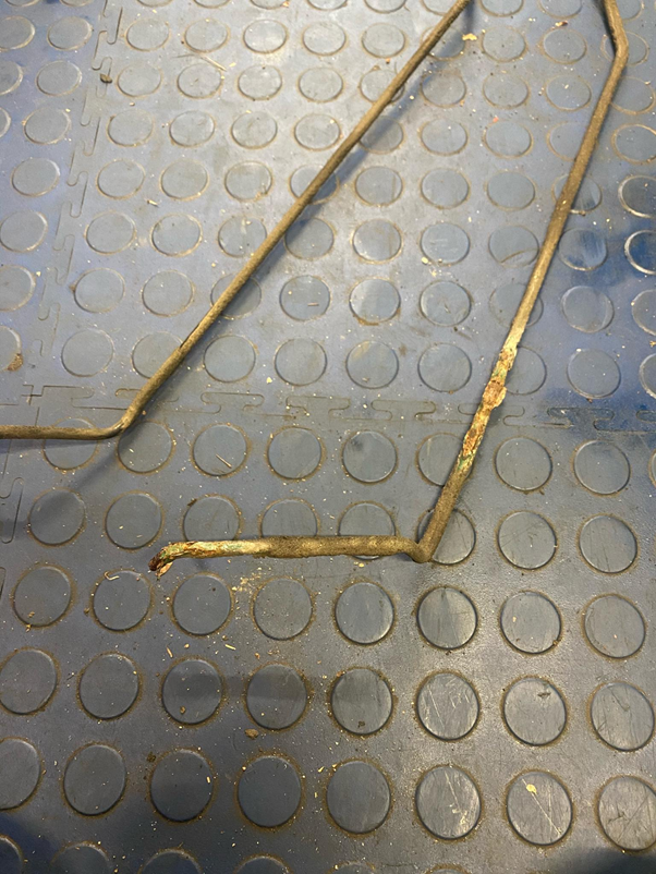

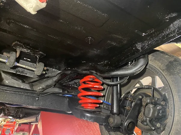

Whilst removing my headlights and swapping parts over, Alex had noticed that part of my driver’s side unit had appeared to have melted at some point in the past. It still worked, but that’s never a good sign!
My air-con rad was shot, along with a fair bit of the accompanying pipework. Those were being replaced, as was the main radiator behind it.

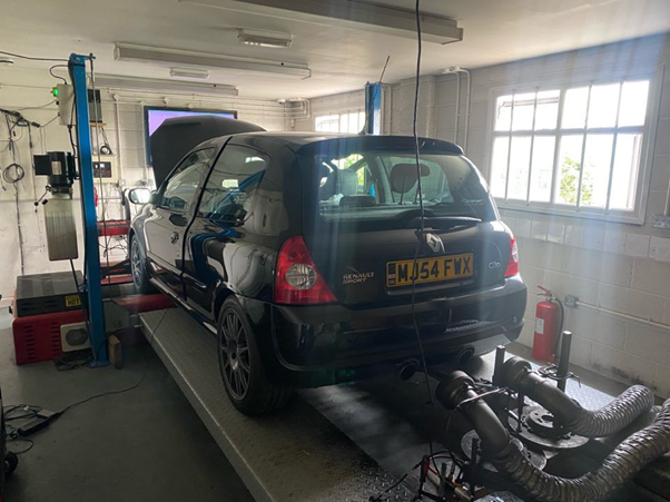

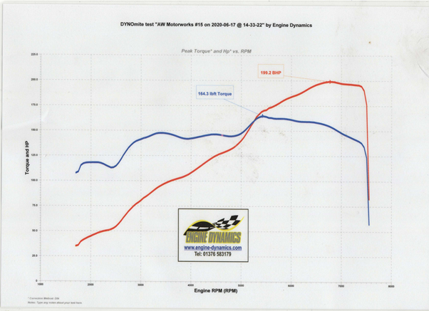

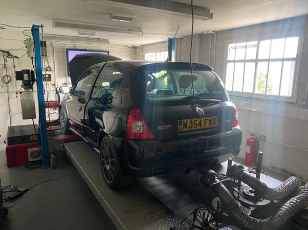

One of the last parts to be done was the remap. For this it was off to Andy at Engine Dynamics and on the rollers to get fettled.
The results I was more than happy with. Hopefully once the mileage cracks a thousand or so and all the parts of the rebuild loosen up, it will nudge into the 200bhp bracket, but from the offset, it was tantalisingly close!

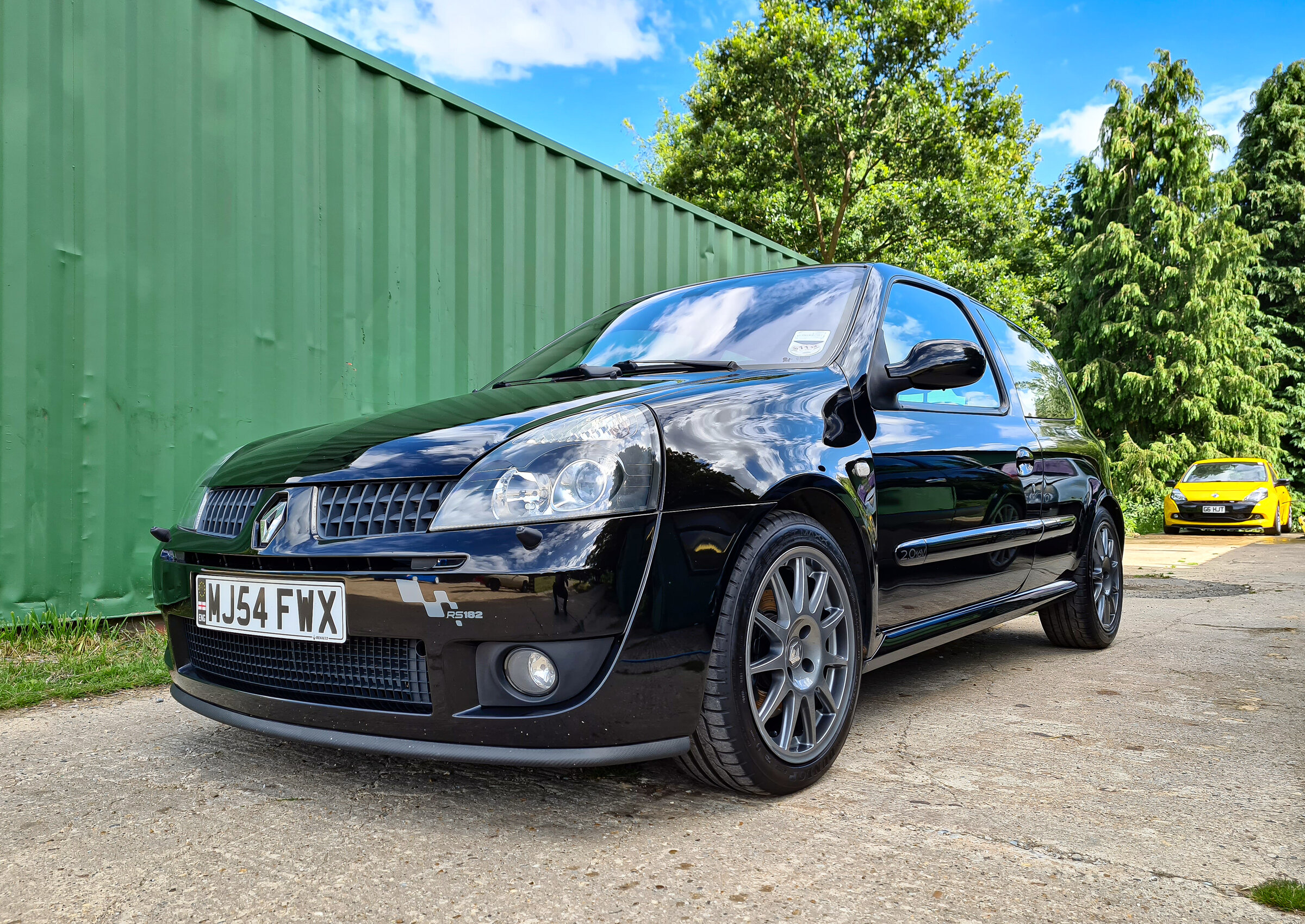

Finally, ‘Collection Day’ arrived – just one day short of the car having been away for three months. I caught the train down to Stansted Airport and arranged with Alex to bob over and meet me in my own car. I heard it before I saw it – walking over from the meet & greet at the airport, recognising that unmistakable 2.0litre and KTR exhaust sound combination. In my mind it sounded different – but similar for the most part. Would I actually notice the difference?
So Alex and I chat on the way back over to his unit about the Clio and the work having been carried out – all the while, this completely familiar car to me feels decidedly different. The air-con is blasting in my face – something that I’ve not had working for years. The clattering of loose parts that came from the OSF wheel area doesn’t exist. The whine from the gearbox has gone. The gearbox itself is firm and super-decisive in selecting gears. The handbrake had required a proper motion to disengage and along those lines, the brakes were a joy to use again

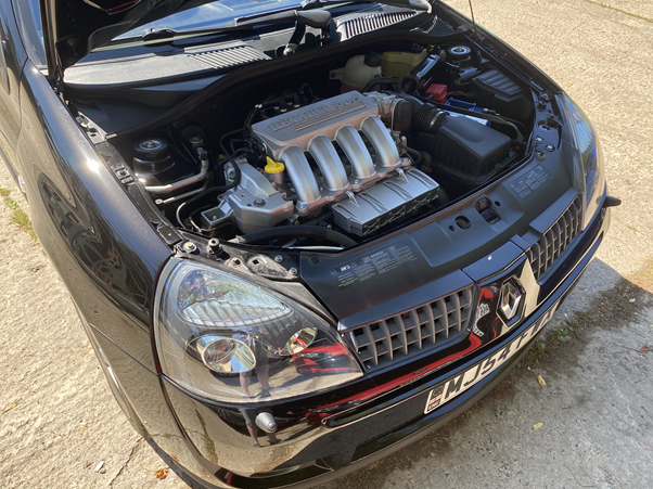

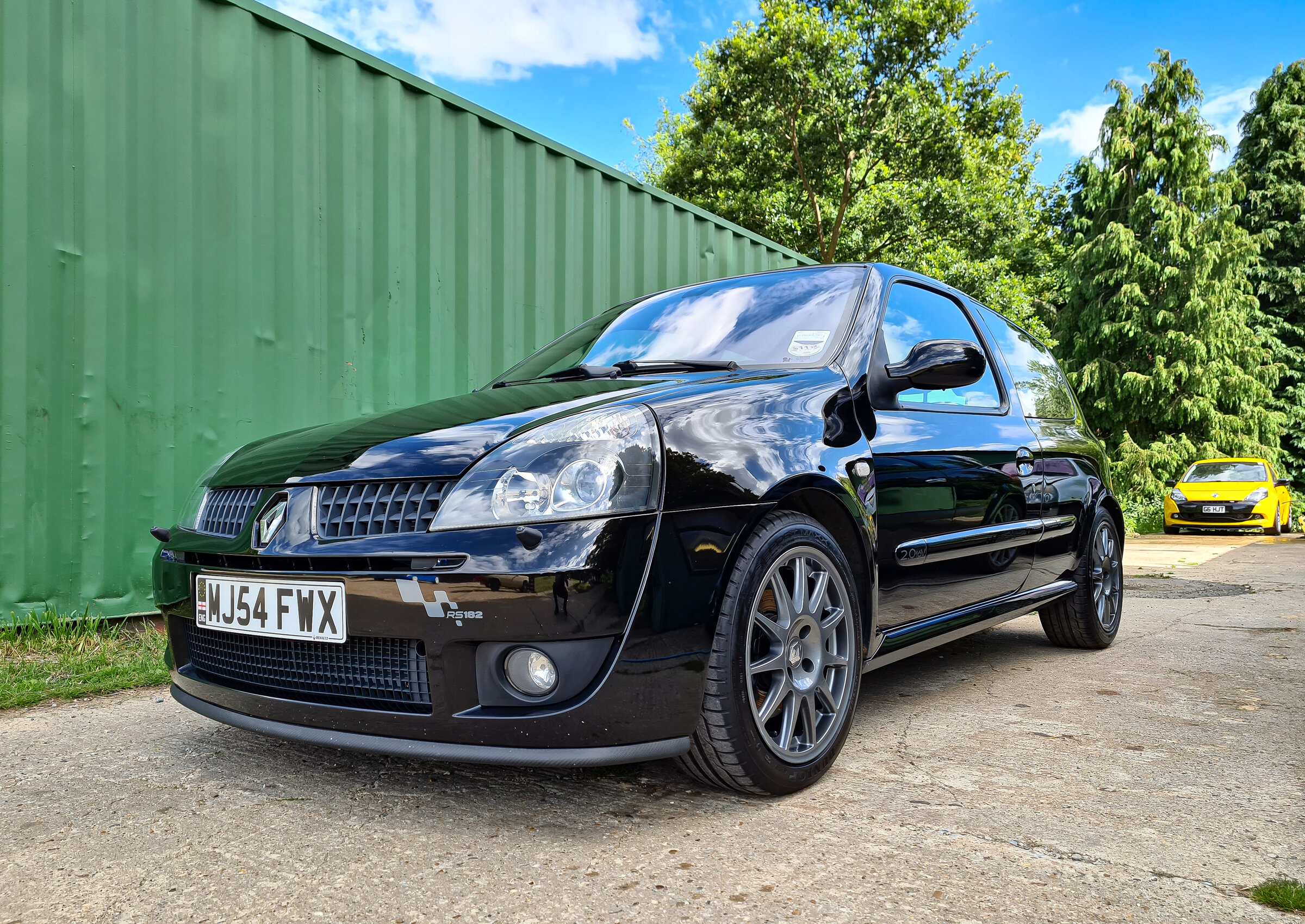

This was clearly an end result of many hours worth of work. My car had been de-aged by at least a decade, feeling taught, rigid and really quite poised. It was tired previously and needed TLC – ironically the gearbox issue and weak compression of one cylinder tipped my mind into actually getting the work done.
Back at Alex’s unit, I get to walk around the car properly and discuss what’s been done. Alex was clearly busy, but rather than just hand the paperwork over and say ‘bye’ I think it’s a testament to him in understanding that level of attachment that some owners have with their cars.
And to put into context the amount of parts that have gone into it. Alex himself said that there’s a few sundries that have been missed off – they just got ‘done’ alone the way. 😊
Once I left Alex’s, it was time for the 200+ mile drive home. It was mid-afternoon by then and really quite warm. Thankfully, with the working air-con, it was a much more comfortable place to be sat. I’d asked about the initial maintenance during that immediate period of post-build. At my request, Alex had been putting miles on to it since the rebuild, including two trips to Engine Dynamics – more of a final confirmation that everything was fine than anything. He’d managed to clock around 200 miles himself and with my trip back home on top – I’m about halfway before requiring a precautionary oil drain and change.
But did it really feel any different? Pootling about and lazily progressing through traffic – it was just a normal 182. It felt a little more eager and certainly engaging with the cog changes. So far so good. Then came the slip-road for the motorway – nothing ahead, clear view of any traffic and I left it in third gear. Acceleration, then more….. then oh, hang on, that’s a bit different, then shitting hell! I glance at the rev counter and its well beyond 6k but is pulling and pulling. I quickly loop up into 5th having already joined the motorway at wrist-slapping speeds. Erm…. Wow.
