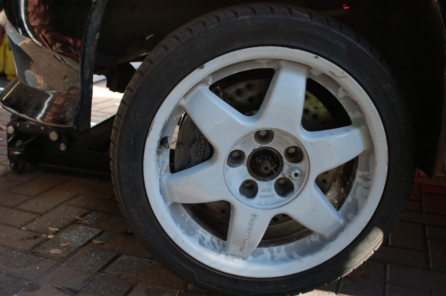

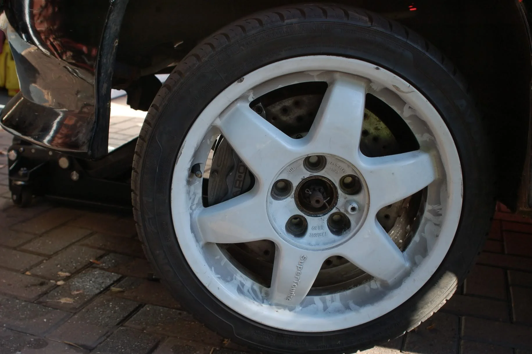

Love the turbines m8, but i'm gonna convert it to 5 stud, with VW hubs up front, so that pretty much f***s that idea over ! That way i can use bigger CV joints, And bolt bigger brakes on up front easier ;-)
The difference in grip off the line when you move the engine to the other end is certainly very significant.
Absolutely unbelievable grip tbh m8. Mine only runs 195 section tyres and it puts the lot down in first and second ! I did expect to have to widen the arches, but so far so good .....

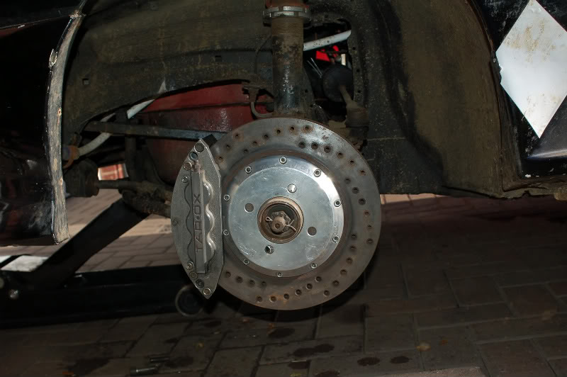

Love the turbines m8, but i'm gonna convert it to 5 stud, with VW hubs up front, so that pretty much f**ks that idea over ! That way i can use bigger CV joints, And bolt bigger brakes on up front easier ;-)
get a set of grand scenic 300mm disks and Peugeot 4-pots. pretty cheap and simple...
  182/RS2/ Turbo/Mk1
With 500bhp, I dont think 15 inch wheels and cheap brakes are a great idea TBH.
Ive stuck with 16s on mine, seems a good compromise between not being too big for handling and not being too small for brakes.
  R5 gtt, R27 F1 team
Cheap doesn't have to equal bad :)
Those brembo's are designed to stop a 1450kg car so would be significant enough imo
  182/RS2/ Turbo/Mk1
Agreed they are good calipers, Ive used them on other things, but the 300mm disks are a compromise especially if it is a solid steel one not an ally bell IMHO
