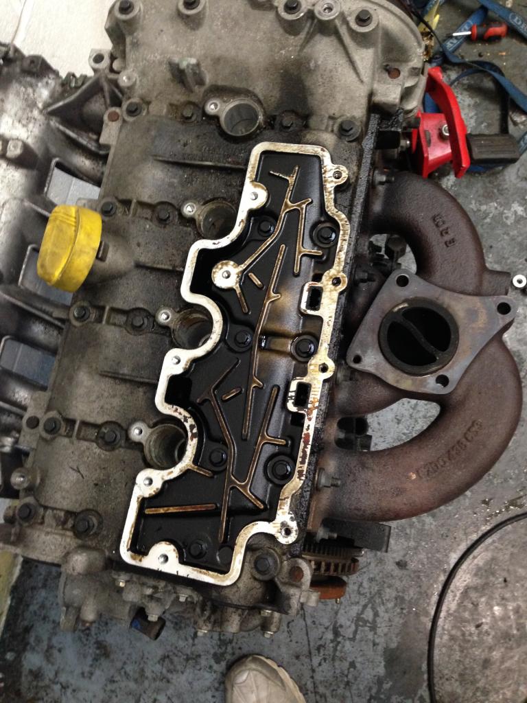

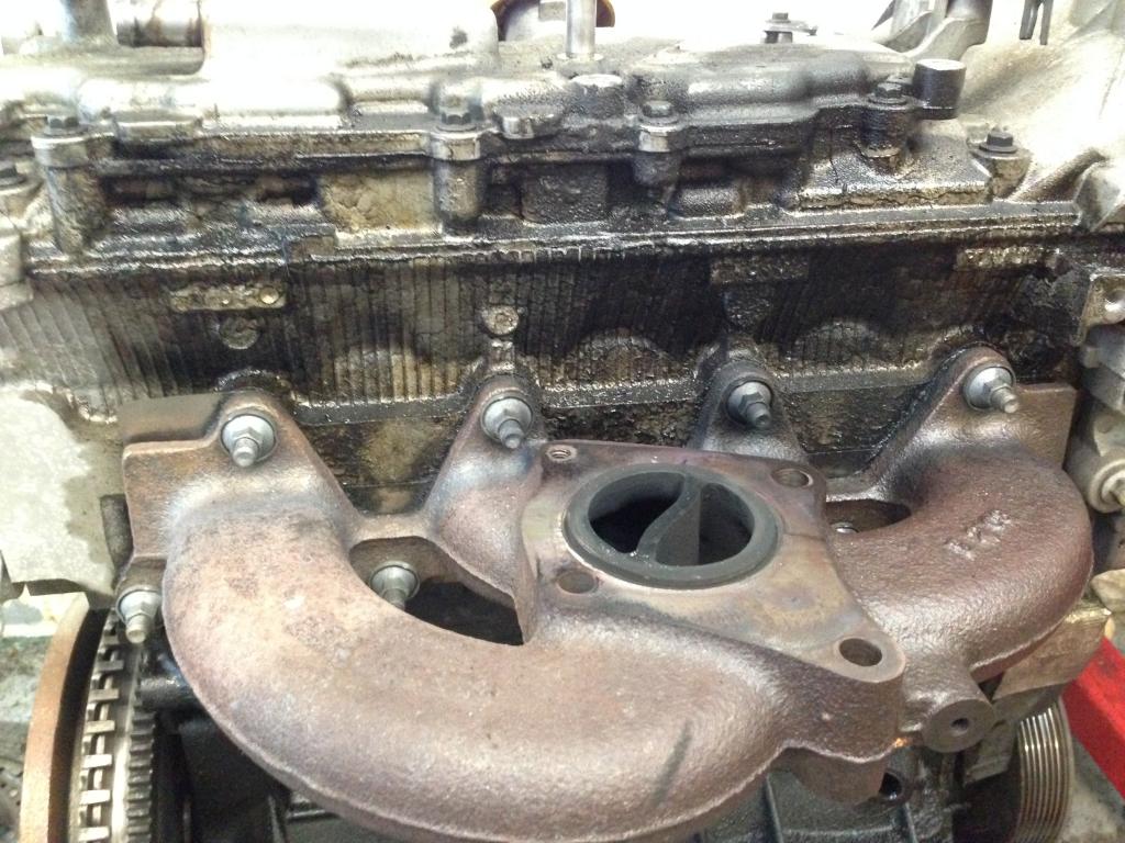

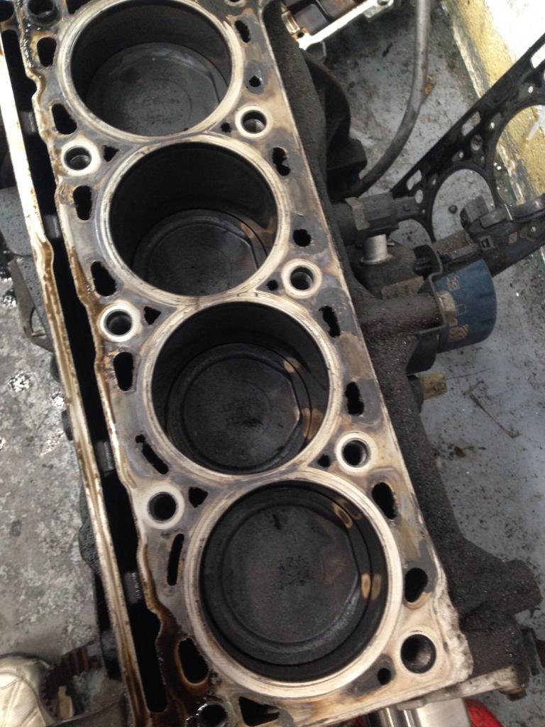

I stripped down the old engine this morning.
Oil has been leaking from the oil breather and rocker cover.

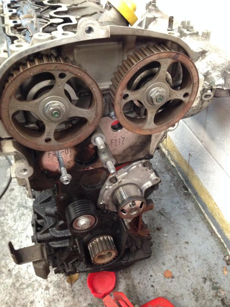

Started by removing the cam belt, you can there was oil on the tensioner and cam belt cover.

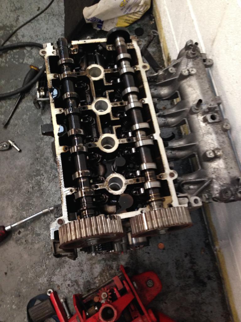

Removed the oil breather and rocker cover
Cylinder head removed

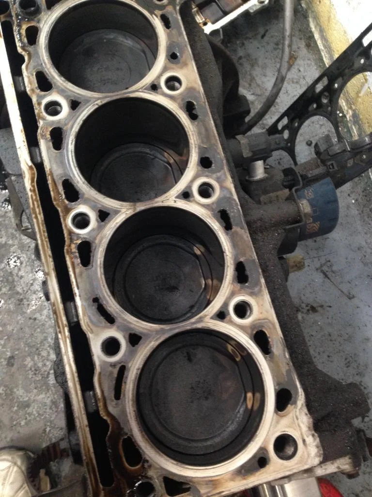

Bores look ok and you can still see honing marks.

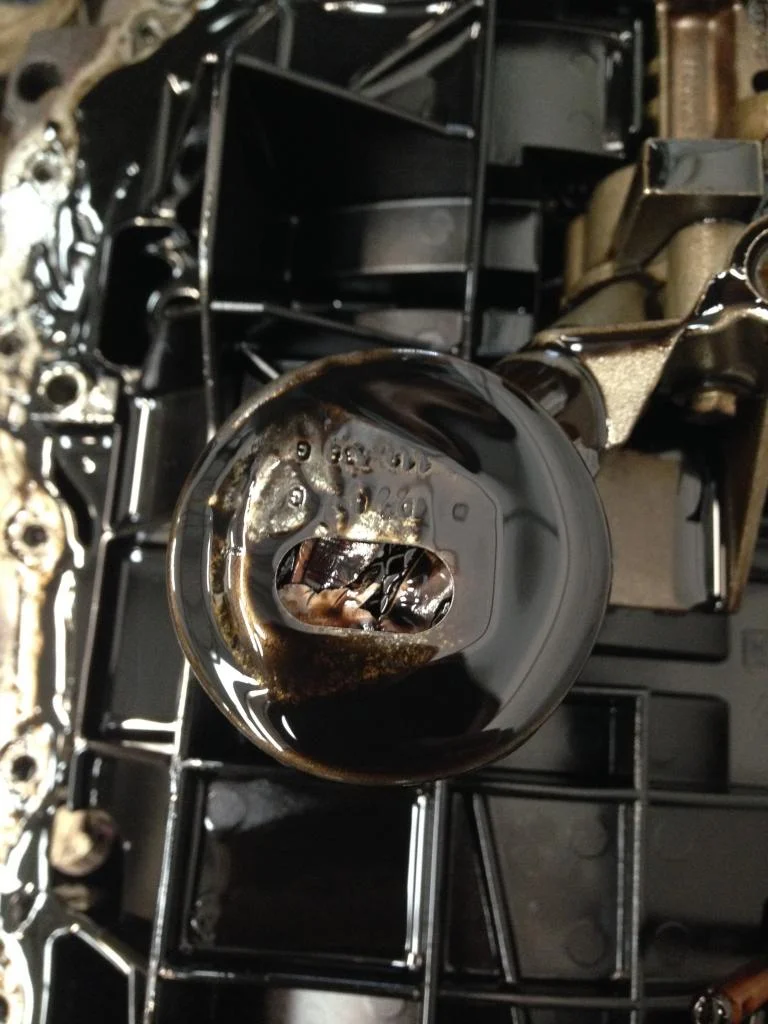

Then flipped the engine over to remove the sump and discovered this. Oil pickup was blocked with what appeared to be gasket sealant.

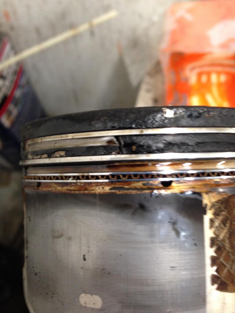

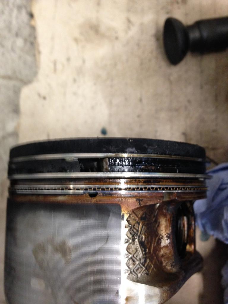

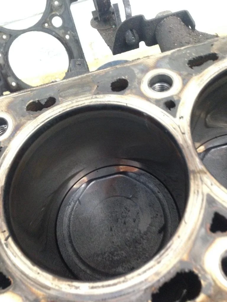

Cleaned the pistons and upon inspection two were cracked. One with a large piece missing, not sure were that went or which cylinder as there is no obvious damage to the bore!
The other two pistons were in good condition and all the rods were all straight (surprisingly).
I guess the oil pickup blockage has been starving the engine of oil causing the piston damage and the excessive oil consumption.
I'm definitely glad I've got the new engine now as it looks like I was lucky the engine didn't blow up!

I seen a few engines with this gasket sealant stuck in the pick up, seems to be quite a common problem.
It looked like it had disintegrated so I'd advise anyone removing the sump not to reseal it with sealant!
Glad we've only used a sump gasket on my new engine.
JP83
South Central-Oxfordshire
Seen it on plenty of bike engines. Too much of it and when the sumps bolted back on it squeezes it inside the sump and then it gets sucked into the oil pickup. BOOM!

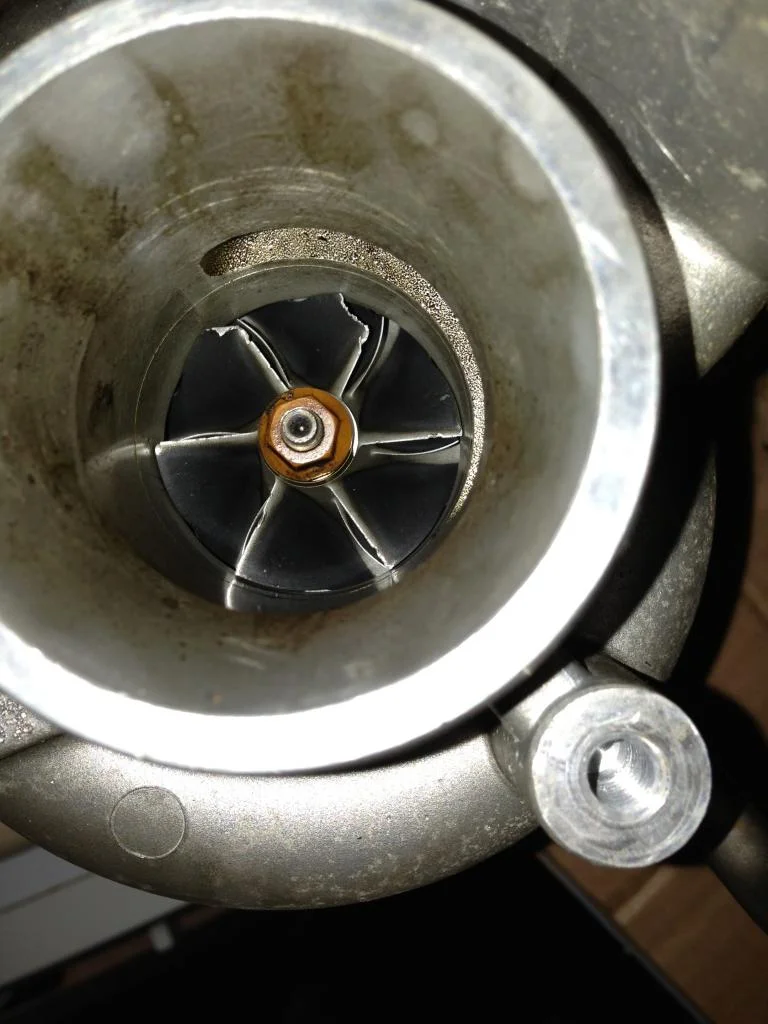

Dropped the gearbox off at garage yesterday afternoon only to find out I've been sent a turbo with an incorrect oil feed thread!
They've apologised and arranged to collect the turbo and return it by 10am Thursday.

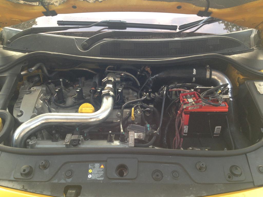

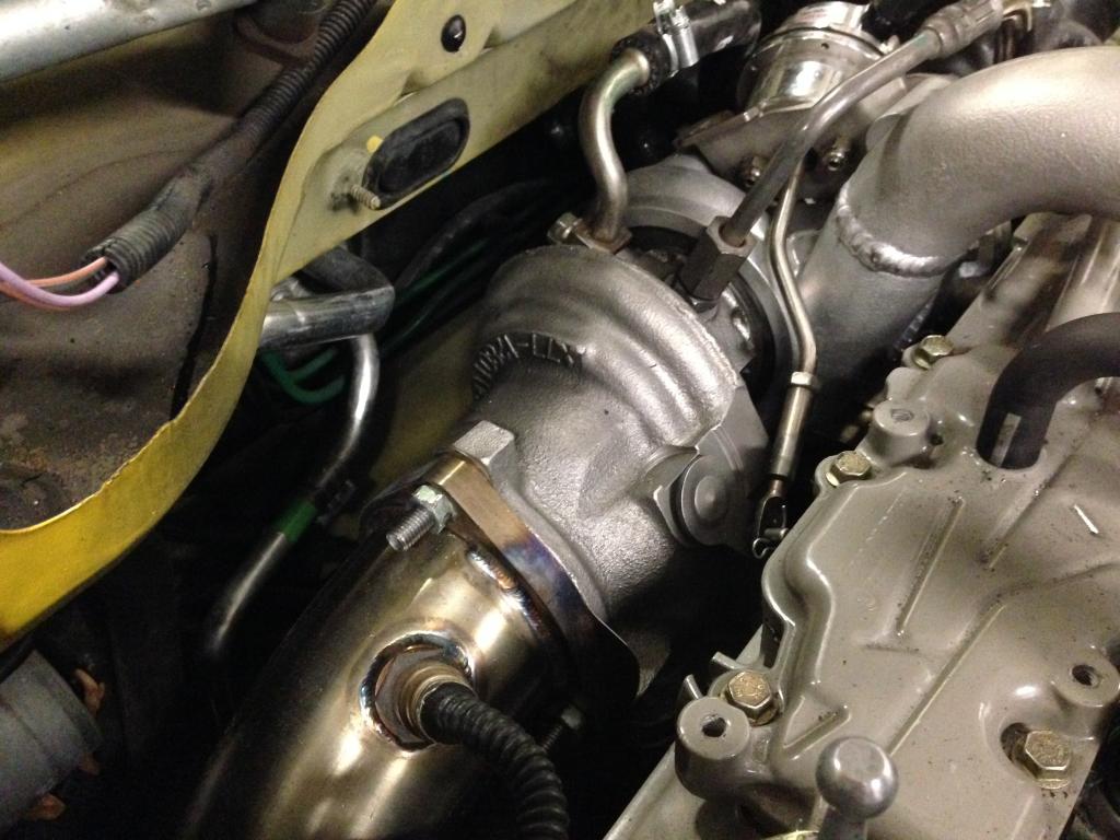

This is how the engine bay looks at the moment and a pic of the hybrid turbo.

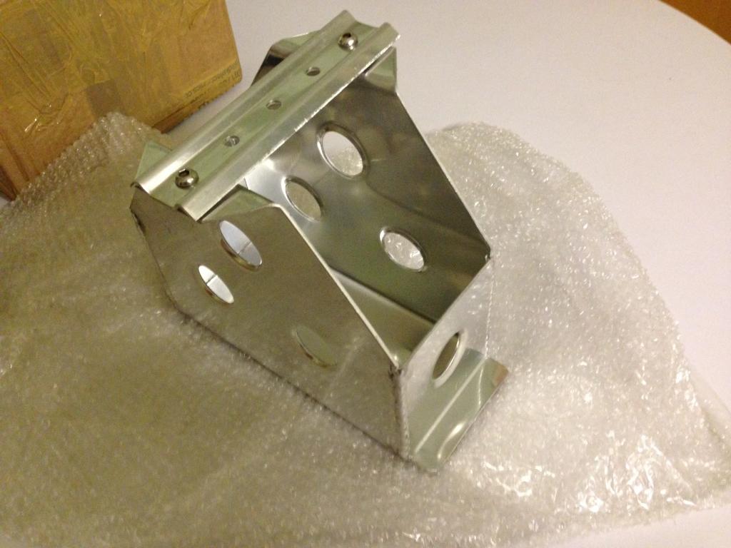

Odyssey battery is cable tied in at moment but I've bought this holder for it. Going to mount the Mocal catch tank on it, weld it to the battery tray and get it powdercoated black. I'm also going to get all the black plastics carbon dipped as it looks great on @Pete. 's Type R.

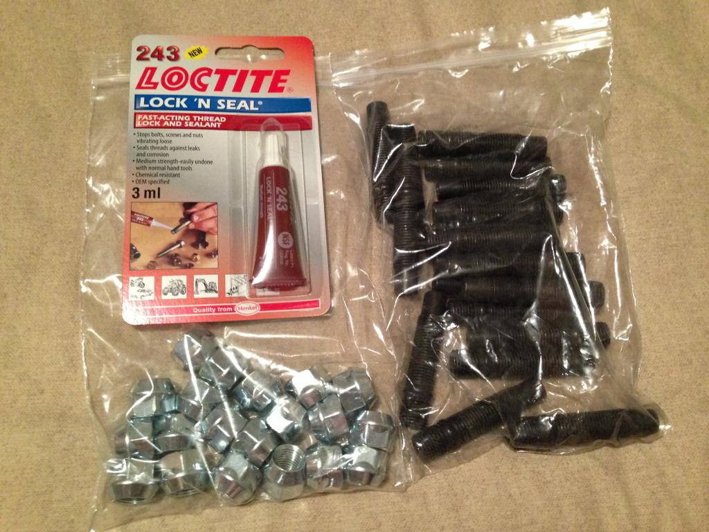

Also purchased a stud conversion kit from Ktec which I'll fit next weekend.
