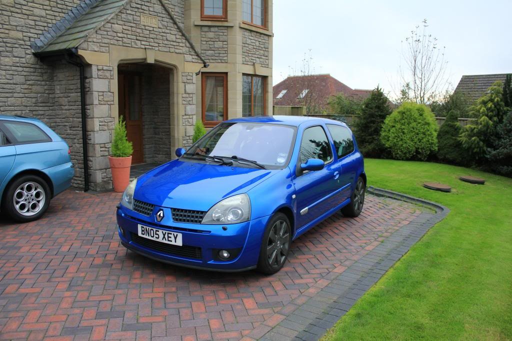

I put down a deposit almost immediately, and made the 8 hour round trip to Wales to pick it up! Pics taken from advert - hope @DanGill doesn't mind!

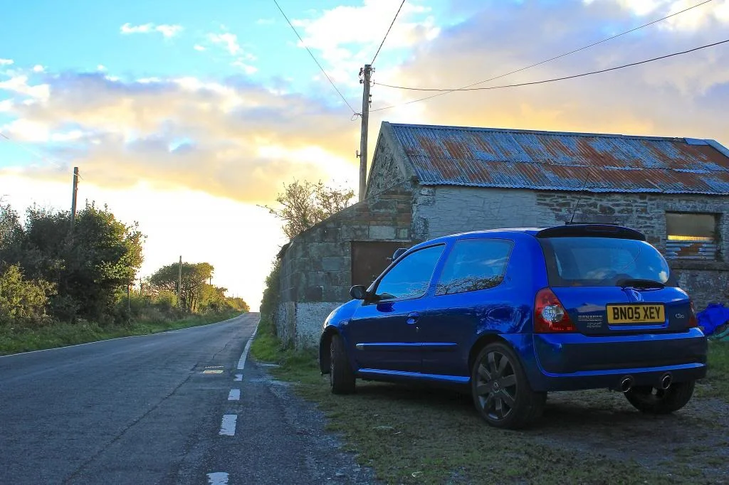

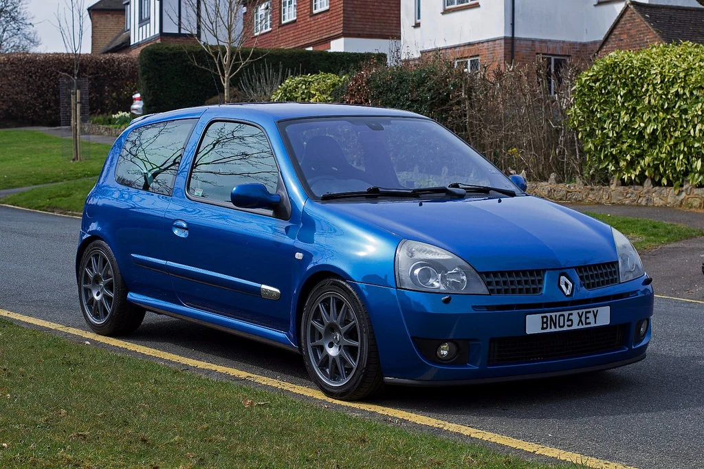

Quick picture on drive after a clean:
Love driving it, such a difference to the 1.2, puts a smile on my face every time. As for the future, I don't want to change too much apart from maybe Turinis, but other then that servicing it regularly and keeping it clean!

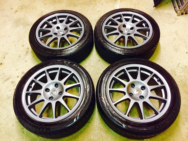

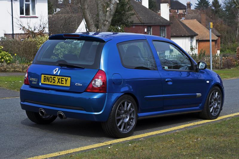

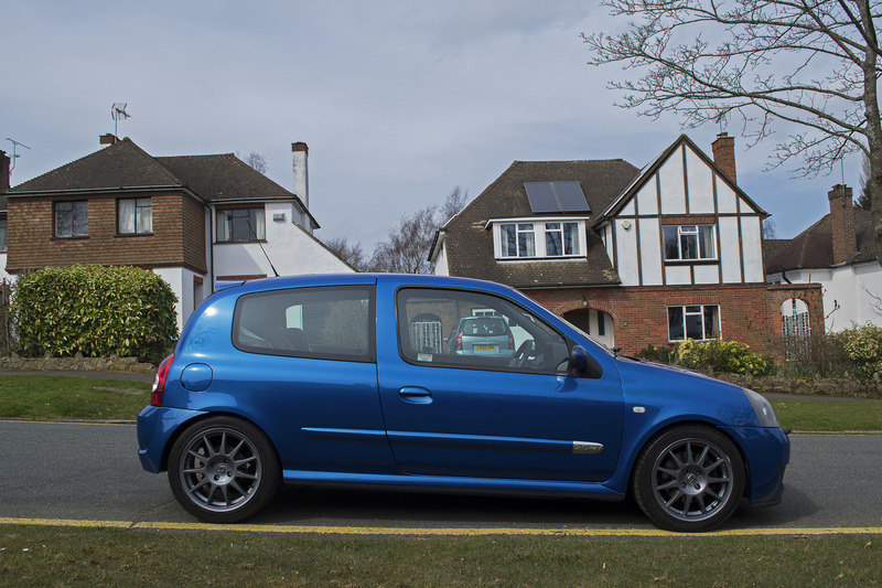

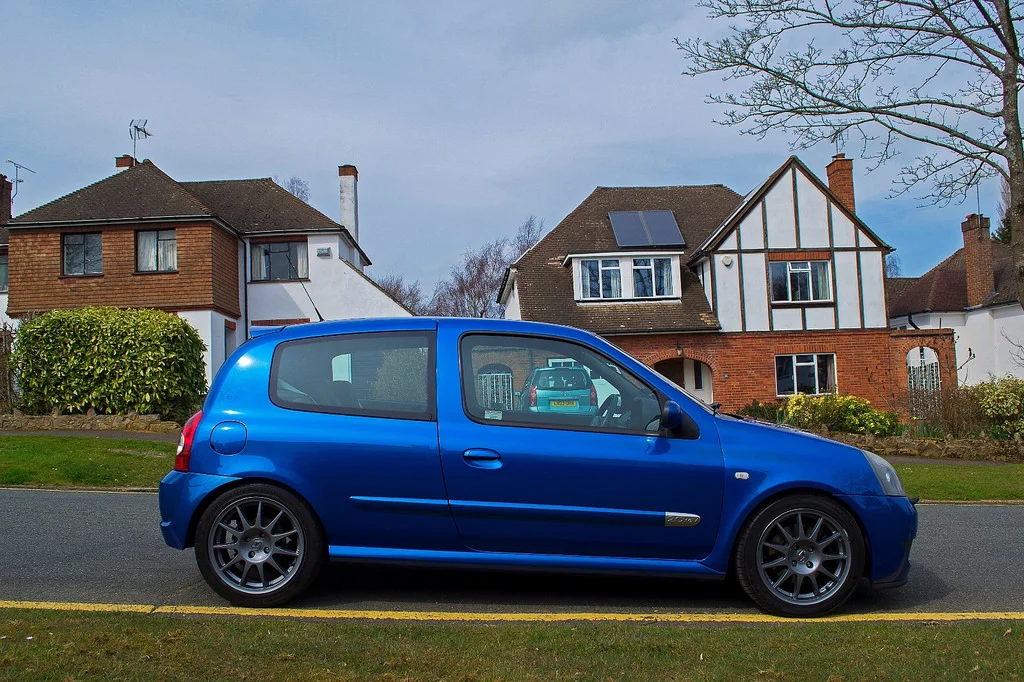

And quite a major one at that! I purchased these off Steve at @R-Sport Cars LTD back in January, but wanted to wait till the worst of the weather was out of the way before fitting them.
And 3 months later and following a thorough clean, I finally got round to fitting them yesterday - and it was worth the wait:
Really happy with how it looks now, can't think of any other modifications I want to make.

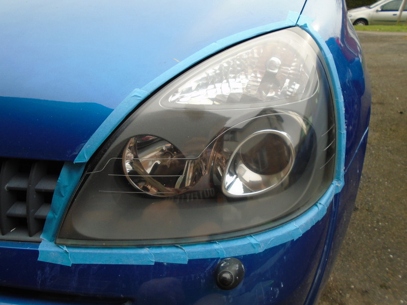

Following on from my previous post, I decided to do a couple of jobs this weekend which I'd been meaning to do for a while, but just hadn't got round to.
It only had one advisory at the most recent service, and that was that the upper brake light wasn't working. So, I removed it to check the connectors were working fine, which they were, so I've ordered a replacement which I'll put in when it arrives later this week.

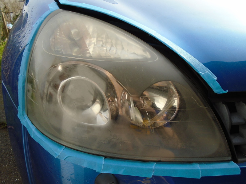

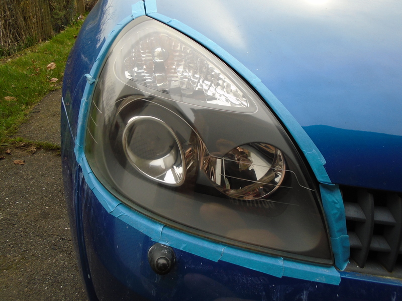

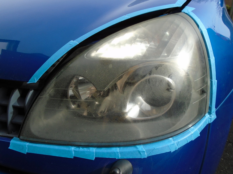

Secondly, the headlights were badly in need of a restoration - see pictures below:
So, I spent a couple of hours doing that - pretty happy with the results:

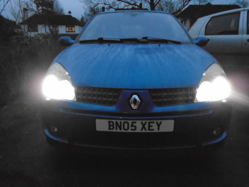

I'd also been meaning to switch the side lights for some LED ones to match the xenons, and I'd seen a couple of people had recommended these - http://cgi.ebay.co.uk/ws/eBayISAPI.dll?ViewItem&item=251442847277 - although they have gone up in price since I bought them. They are a pretty good match, see below (apologies for the terrible picture!):

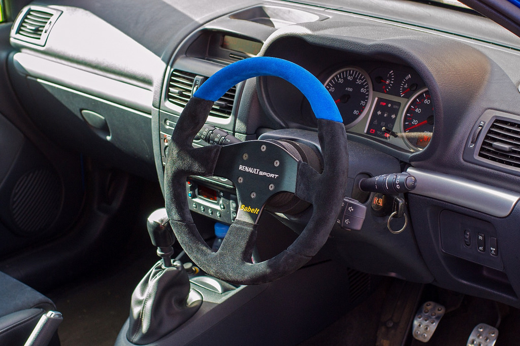

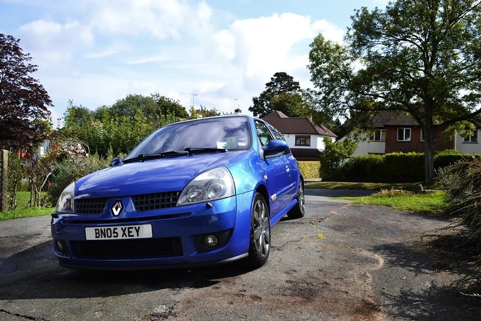

Thought I'd post some up to date photos of my Arctic Blue 182 as it stands. I recently bought a Sabelt off @R-Sport. , which I'm really happy with. With the sticker he supplied, it's pretty much identical to the original.
Sabelt by Peter Rawlins, on Flickr
And here are some of the car from earlier this summer:
Front by Peter Rawlins, on Flickr
Rear by Peter Rawlins, on Flickr

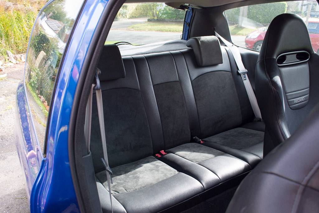

Re-trimmed rear seats to match the Recaros:
Back by Peter Rawlins, on Flickr
