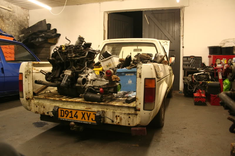

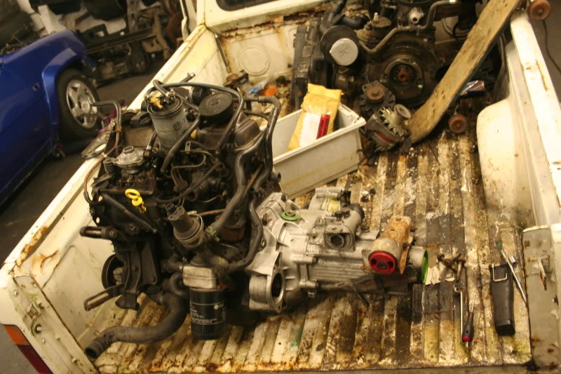

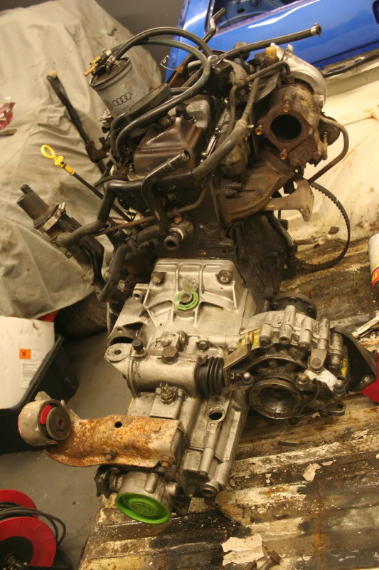

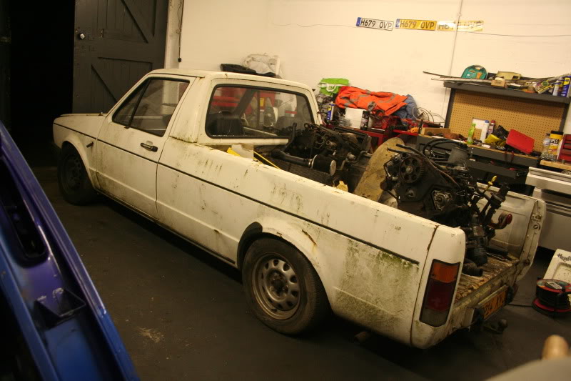

Well it failed to get to Edition38 lol.. I was just to busy to get it done in time and i'd pretty much lost heart till now
Its still not finished but its getting there.. downpipe and pump timing then its all go

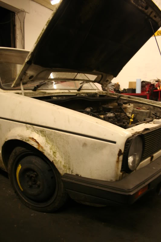

I will let the pictures do the talking....

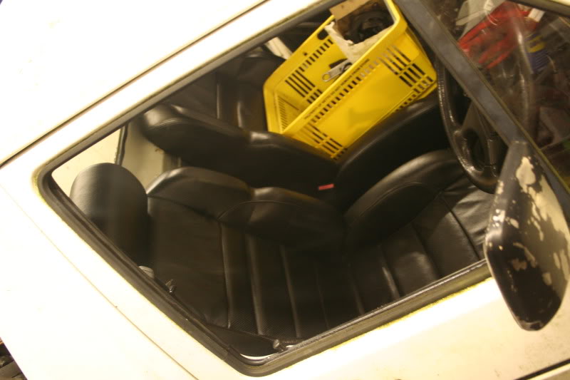

Volkswagen seats are like sitting on a wooden chair Daz.... French cars are sofas on wheels... Ph2 Valver leathers.. best seats ever?

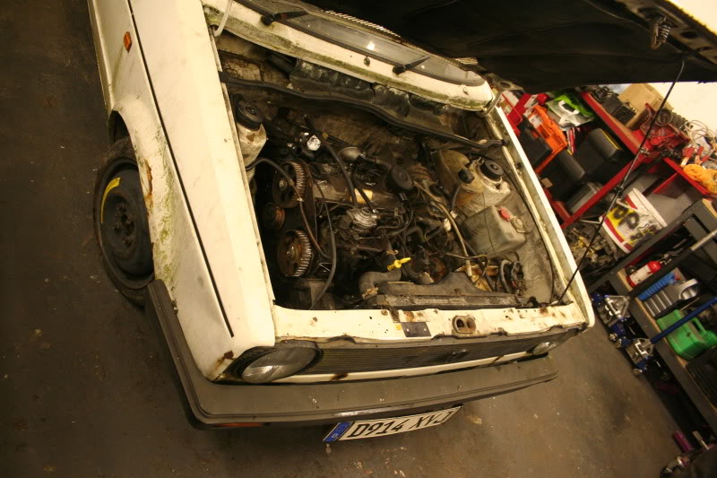

Cheers Muggles... Me and my mates have not long had this work shop... roll on winter ;)
Right!!! lets get back on track..... it has been awhile:eek:

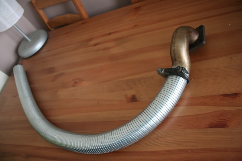

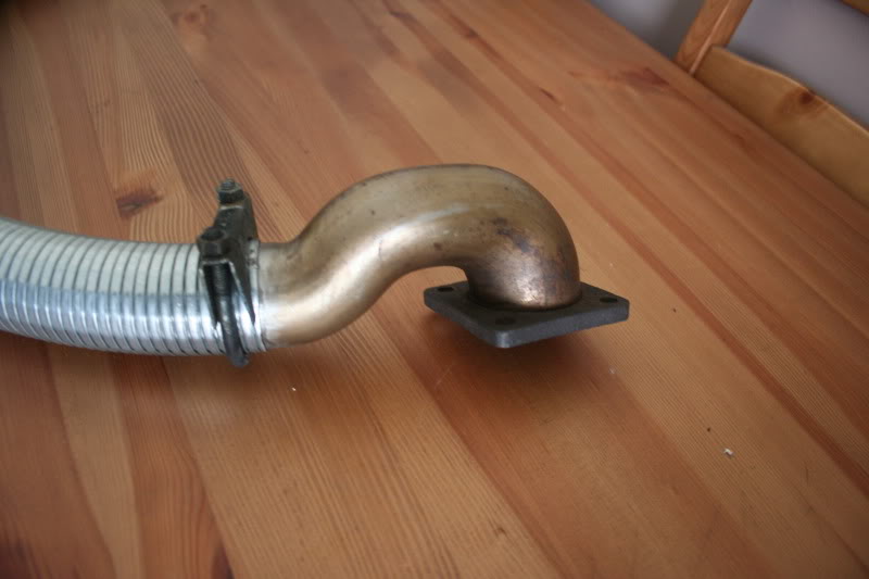

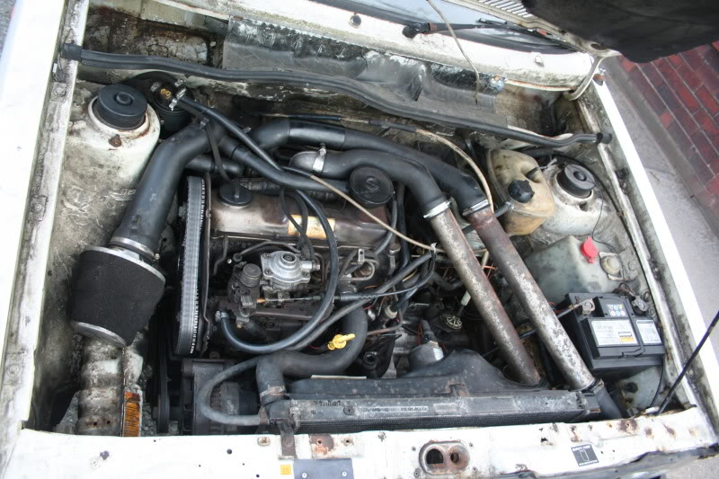

The main thing holding up my caddy was the downpipe. I planned to get a S/S 2.5" one made but I was never flush enough to afford one.. so it sat looking like this for a few months
So when cash is low and you have no car on the road there is only one thing to do... Rig something up lol.. Mk3 TD downpipe cut in half and a long arse 50mm exhaust flexi to the standard caddy exhaust

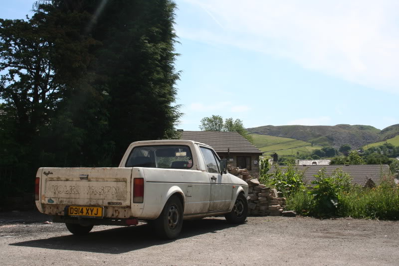

With the downpipe now sorted it was time for the dreaded MOT... It failed, not on to much tho.. abit more welding, number plates, wipers and brake lines... I got the work done and it passed its retest yay.. Its been on the road for just over a week and im loving it :cool:
Plans now... Chassis notched, 3inch blocks and axel height adjusters... low for shows and like it is now daily

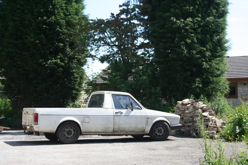

This is the first week in 3 years it has been on the road as my daily.. Still loving it, cheers folks :D
