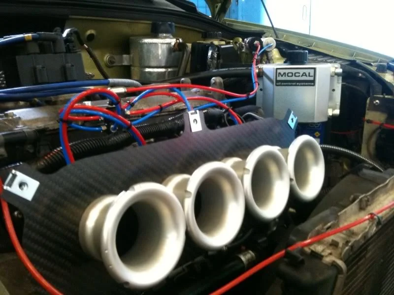

You're lucky that hundred shot of NOS didn't blow the welds on the intake!

I however still have the 50 shot and so far haven't had any issues. I'm yet to try pressing the big red button on this setup though...
