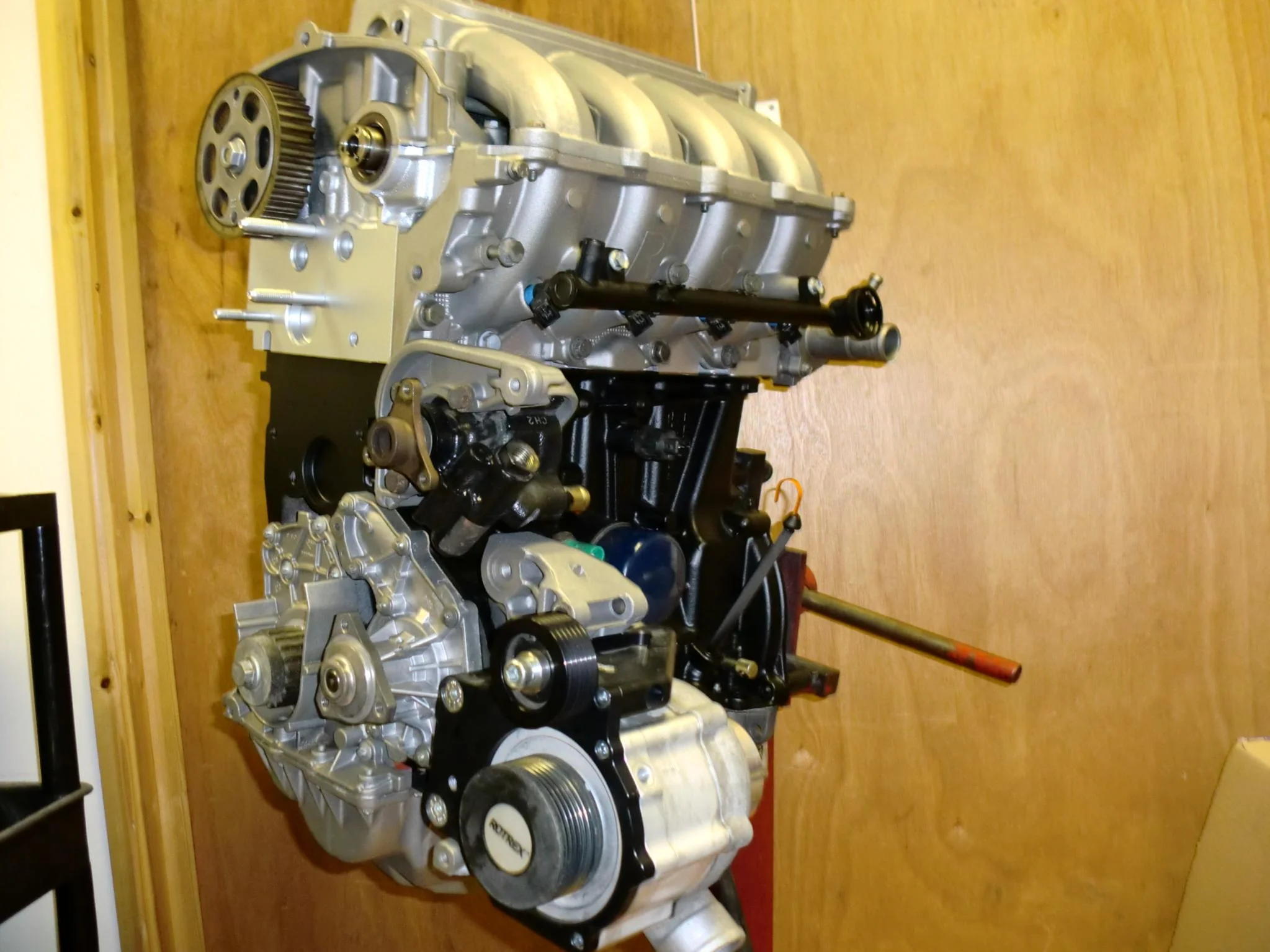

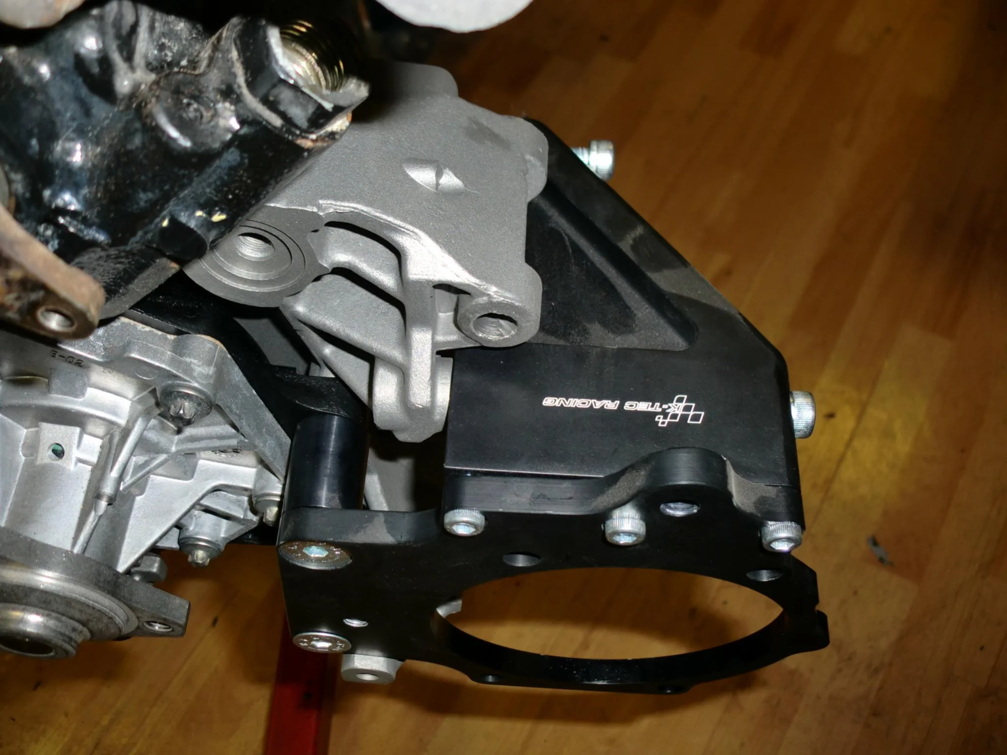

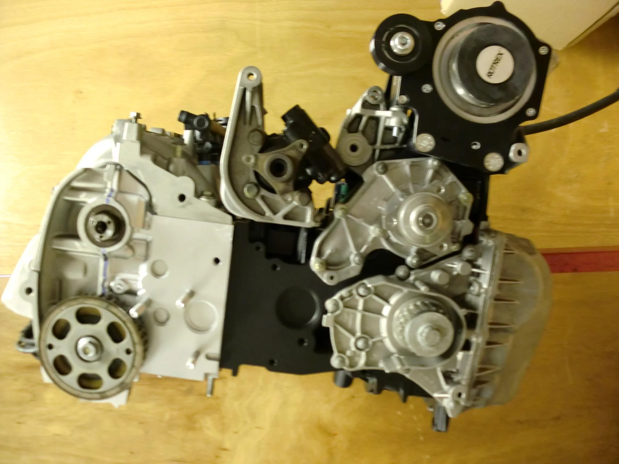

Looking good from the little pics (cant open them because of cr*p internet)
I look forward to seeing some videos and more pictures :)
