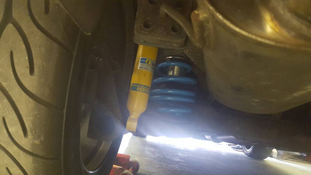

How do you manage to bolt from above?! Is that not fairly hard?
Pigtail springs can go either way up so it doesn't really matter.
Mr R.
  A special one.
You don't mate.
The spring will only sit one way in the adjuster.
  SQ5
How does the adjuster fit on top if you don't bolt it on then?
Obviously the spring only fits one way in the adjuster as it has a flat edge for that side.
I'm just intrigued as to how the adjuster cuts at the top as in the number of times I've fitted Coilovers it's always gone on the bottom.

The adjuster is held in by the spring bud.
There is also a lump at the top on the body of the car.
  SQ5
All adjusters I've had are bolted in.
The top of the car has the exact same lump as the rear beam on the bottom, the adjuster then fits over the lump and bolted from below.
Being held in only by a spring doesn't sound safe considering lowering springs can fall out of these quite easily!
  Ph2 172
That must be specific to the Billy's then?
As far as I know. They were the first set I've ever seen on a clio that sit like that. My spax and vmaxx both bolted through the beam as normal so I was confused when I first went to fit the billies.
  172 Cup & Mini C 1.6
Your telling me when i took the v-maxx platforms off and put the bilstein ones on i was thinking WTF. I just couldn't get my head around it. But it kinda makes sense now as the writing on the springs are currently upside down. Bit of an unusual way i must say

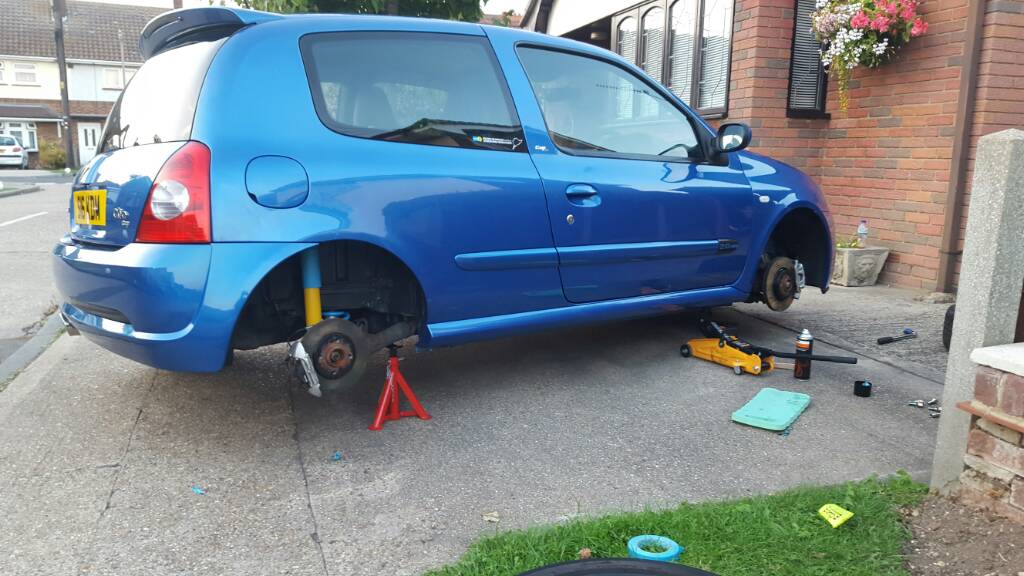

Got the adjusters up the rightway @Phase1sr it only took 5 minutes to sort it out in the end :)
Jekyll
Stands under each rear Jack point, 18mm shock bolt undone, shocks and springs drop, remove adjuster and refit it correctly, reverse process.

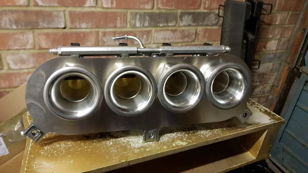

Anyway onto the project pictures. Excuse the mess in the garage it's a shite box atm I know. Pictures are not great either but you kinda get the idea

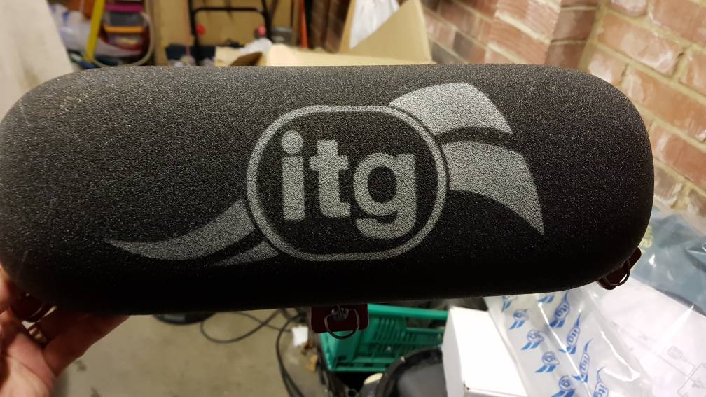

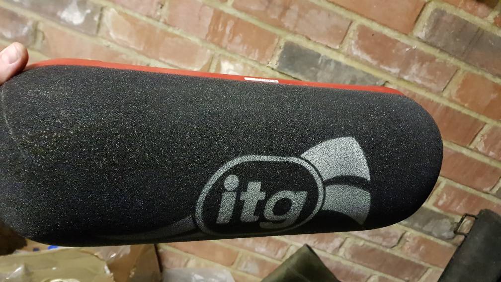

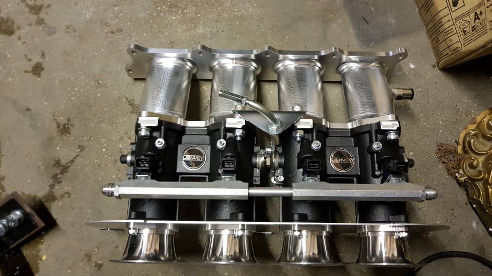

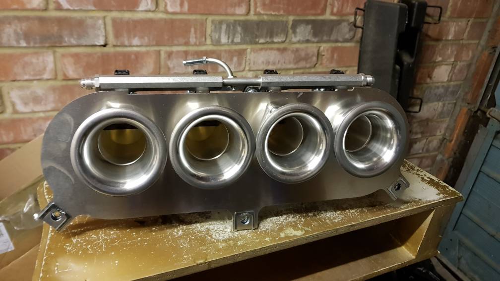

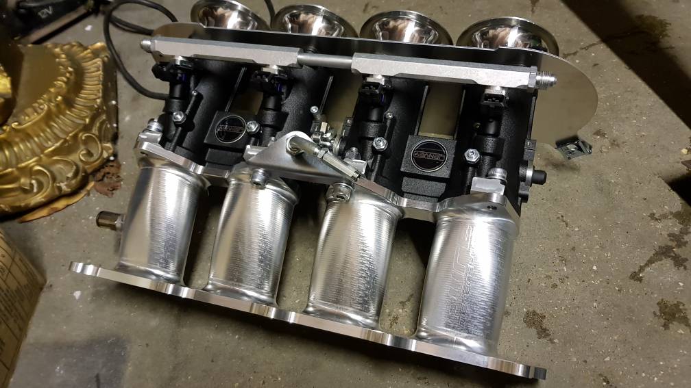

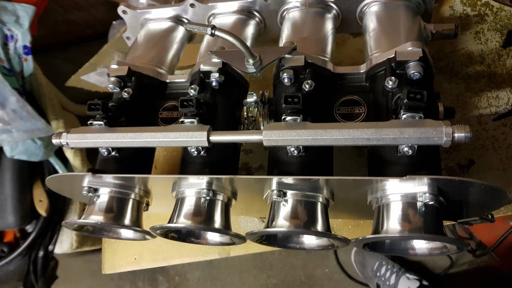

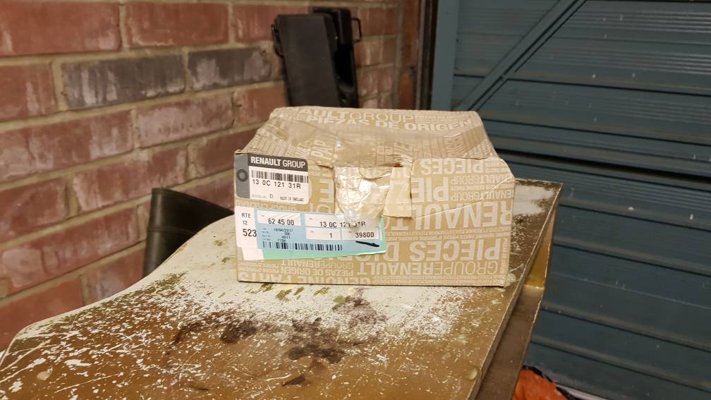

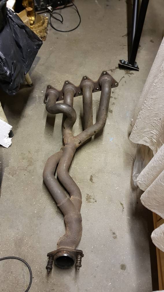

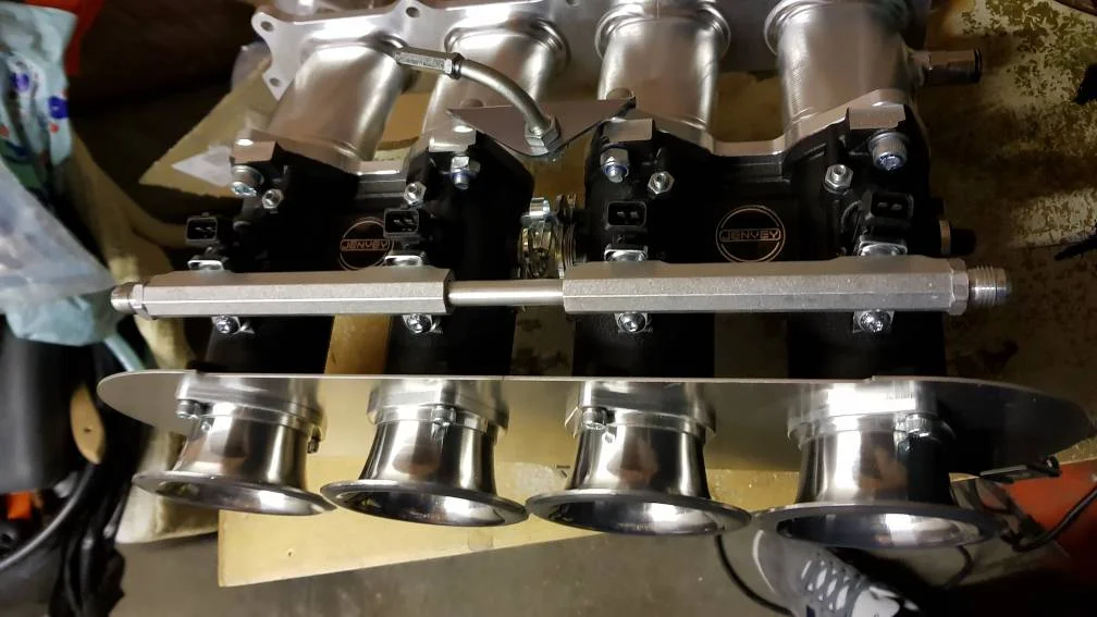

1st few pictures are off the ITB kit which is the PMS 48mm kit complete. I will be running a Me221 ECU. Im also going to be running a Spartan2 wideband controller. Both are currently with Mike @MWM who will be doing the build. Also full headwork will be done plus a few things like a cam tweak on the 438s

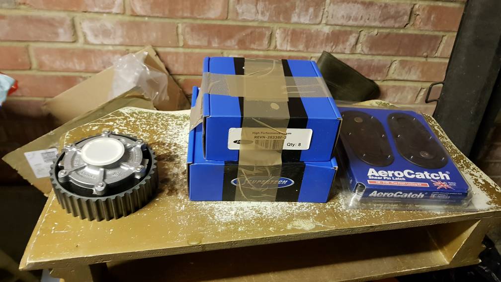

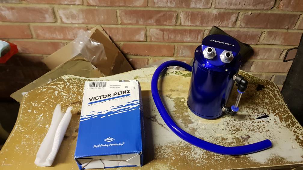

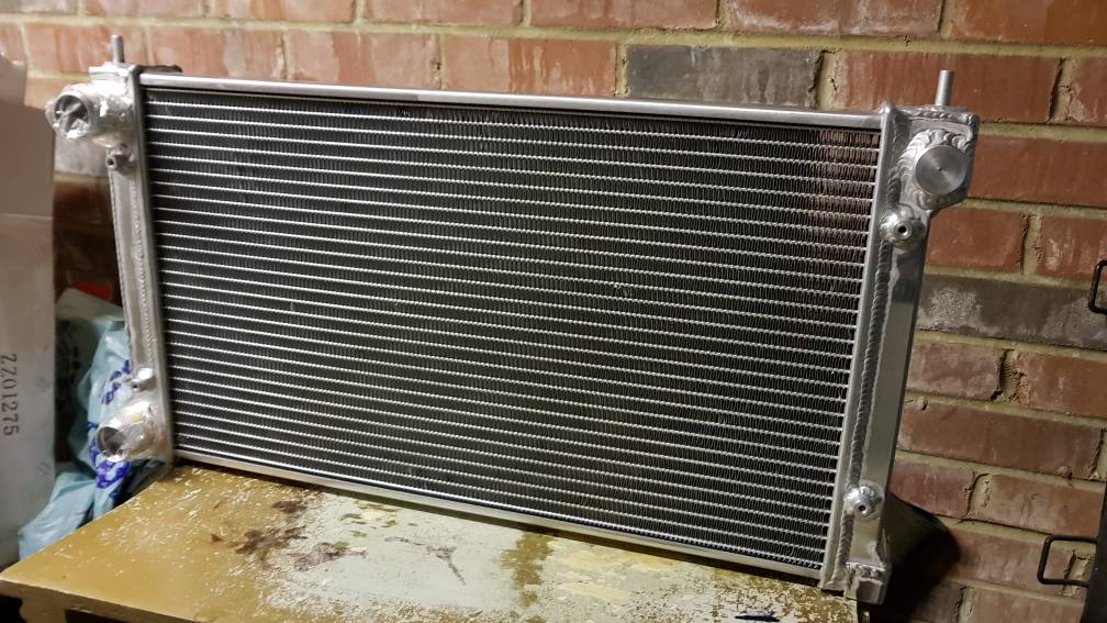

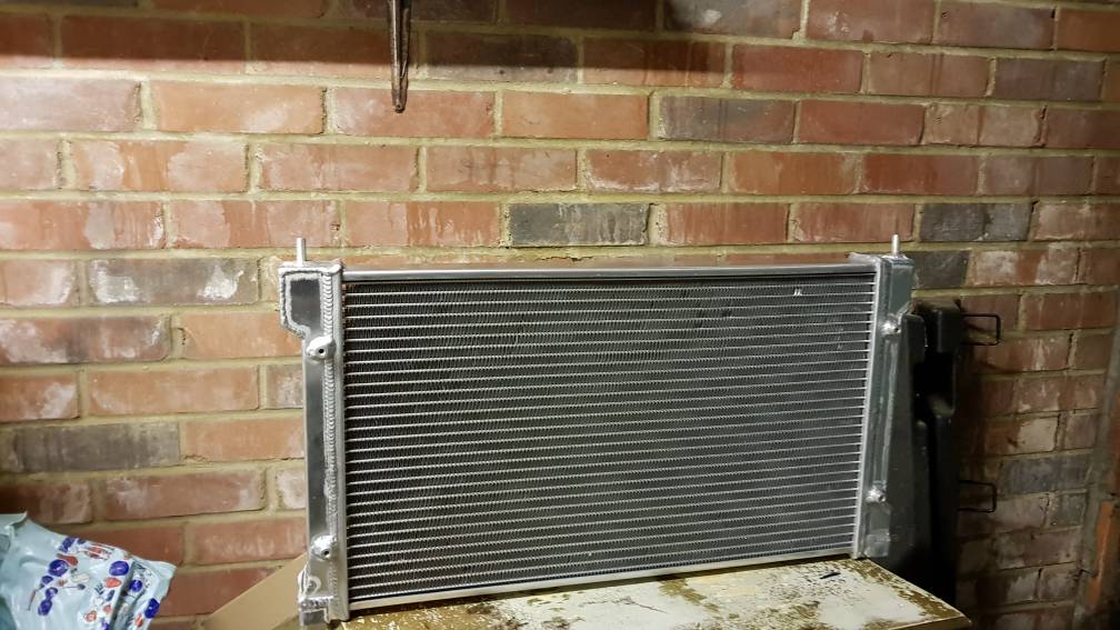

As I want to get as much power as possible without going down the forged route I thought it would be a wise idea to purchase things like Supertech valves and new cylinder head bolts and ARP Bolts which I have the pictures off here. Also I've got a new Cambelt kit and new dephaser pulley. Also got a nice alloy radiator which is a Direnza mk2 golf I believe. Smaller fan aswell which is for a Vw Polo. Direnza alloy catch tank for a bit of looks under the bay

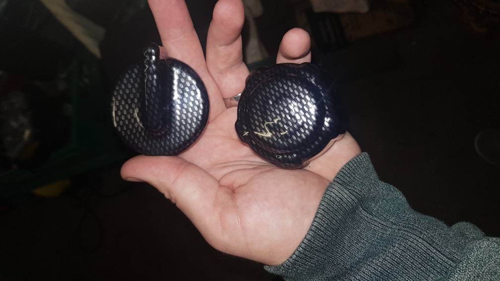

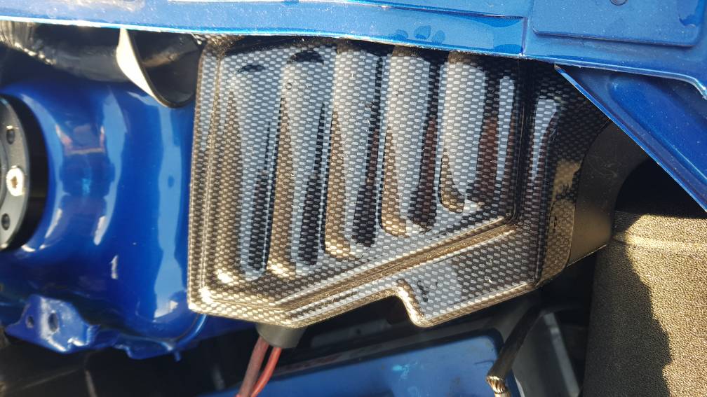

A couple of carbon bits. Coolant bottle cap and engine oil cap.. Added a fuse box cover also

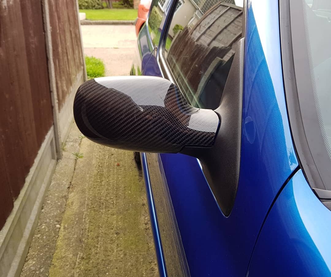

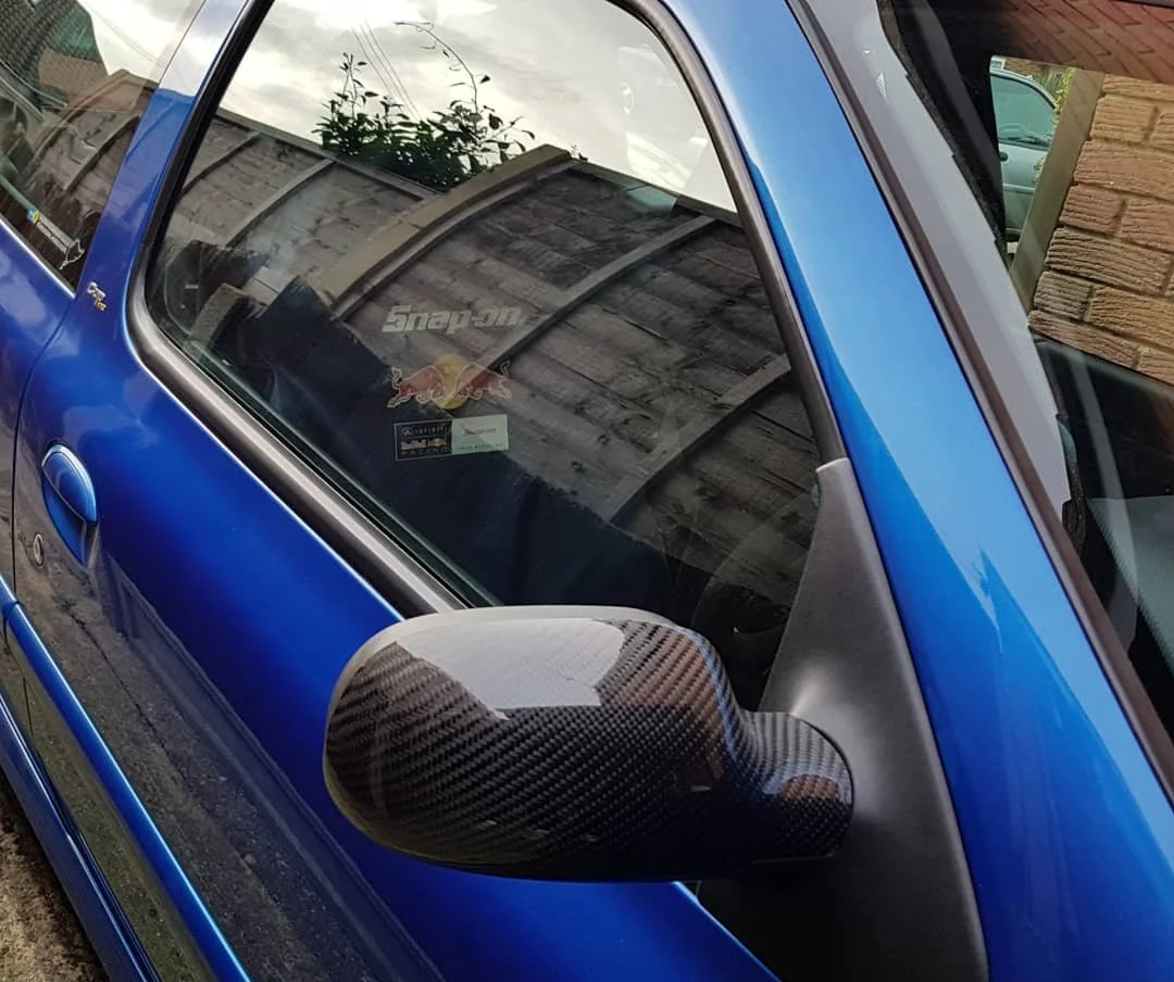

Carbon wing mirror caps also

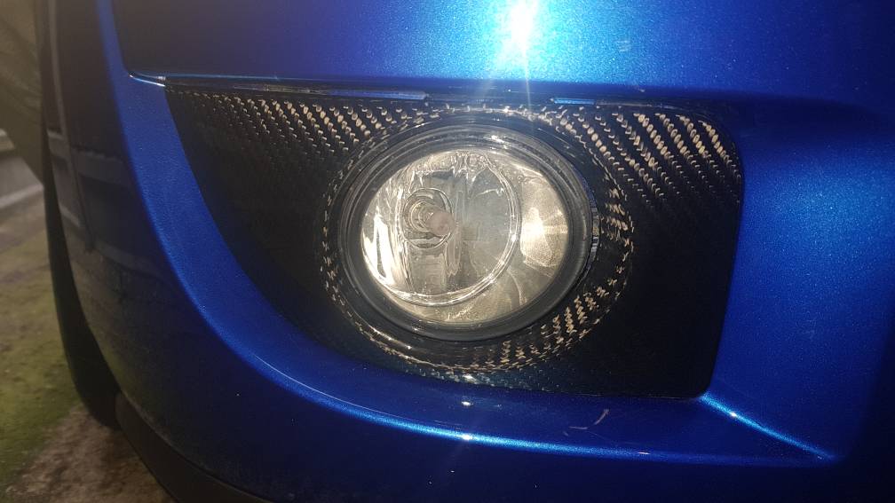

Carbon splitter is on the way I'm just waiting on it from K-tec. It's already been a month gone by since I've ordered it. Done carbon fog surrounds aswell which I done ages ago.I got these from streamlinecarbon.com

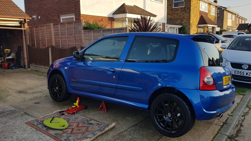

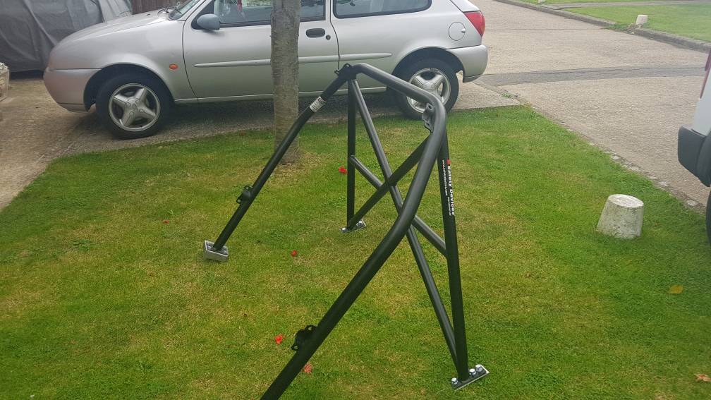

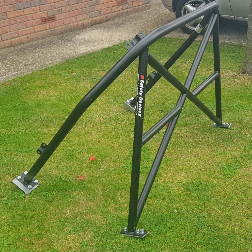

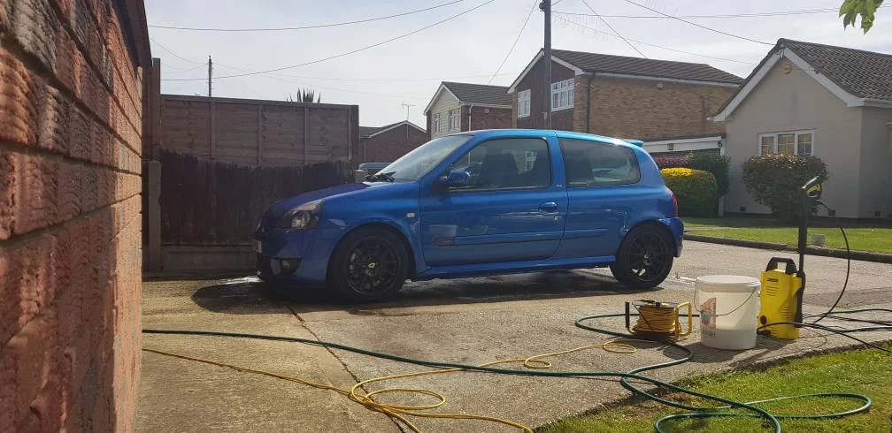

Couple of recent photos of her. Tried taking the seats out of her to place the cage in but like a complete cabbage I rounded one off the bolts off so I'm awaiting a turbo socket so I can get the bloody thing off
[emoji85][emoji23][emoji23] I'm possibly going to be returning the Turini's back to silver aswell but this won't be done until the build is complete.
All in All I'm proper happy with the way it's looking and coming along she is a real minter and looks so much better in the flesh. The pictures really do not do it justice at all

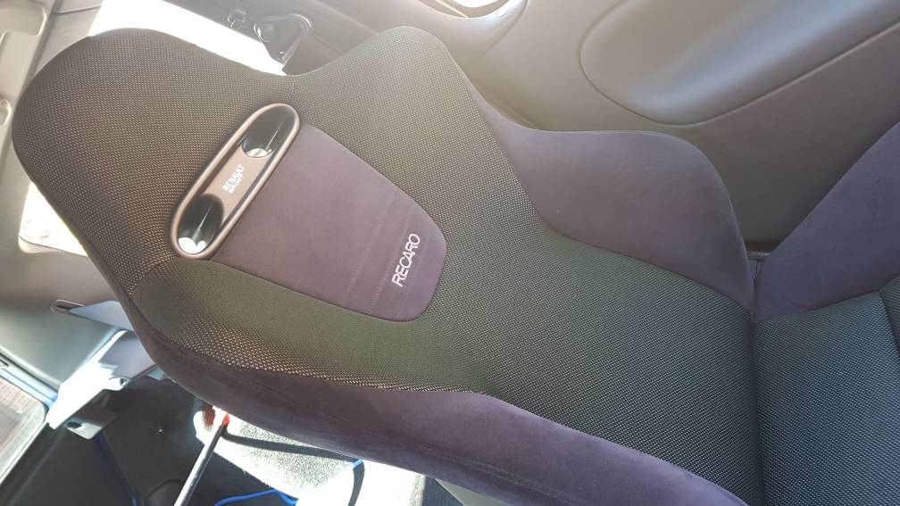

Also the only other plan I do have is I'm also going to purchase some meggy 225 f1 recaros and replace the current Honda accord Type R ones
