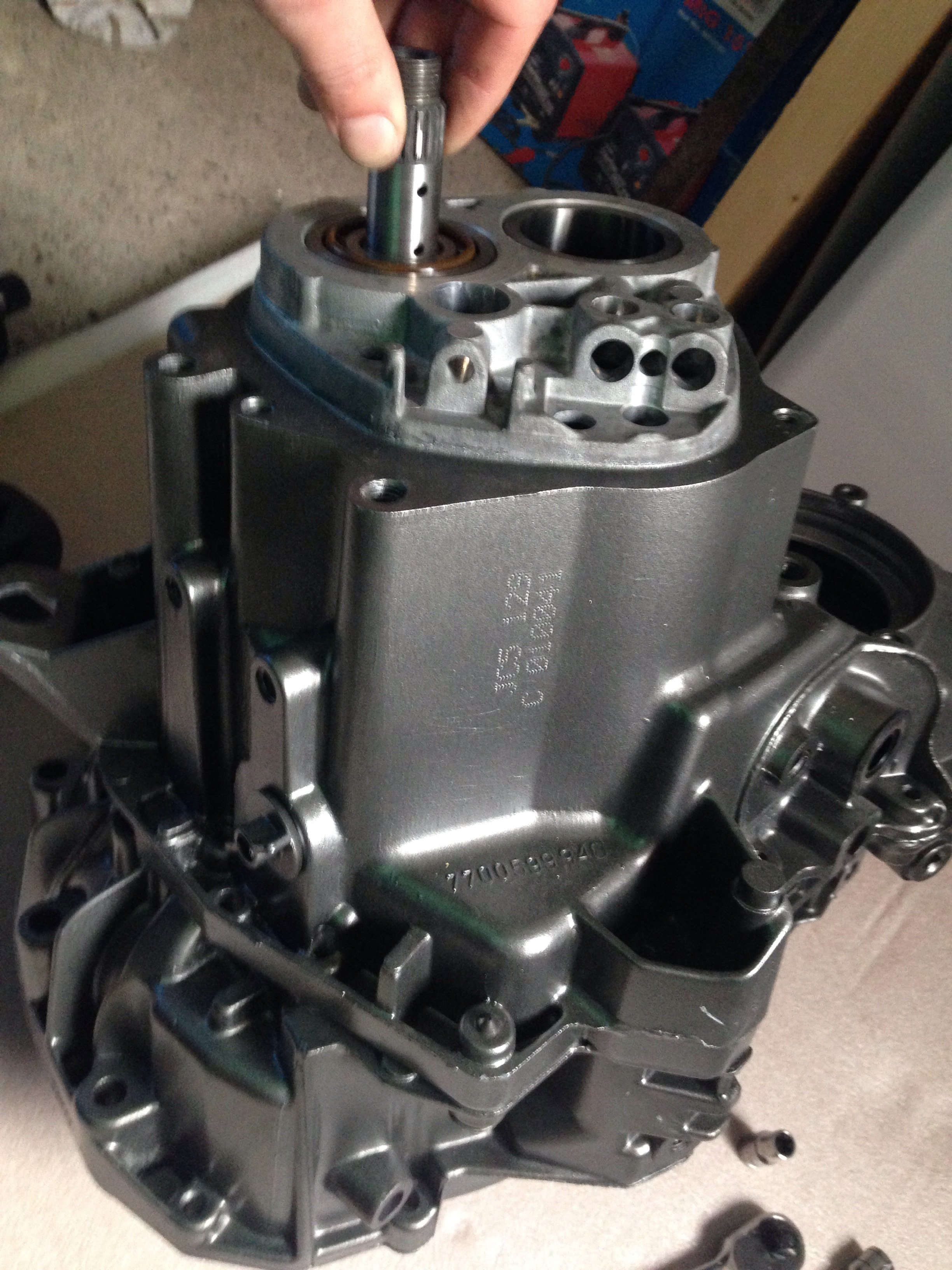

I started off by checking the preload on the input shaft using one of the old shims as a guide. This is very much a job done by feel. The Renault way is to use a dti gauge to measure the lift without a shim fitted, then calculate the correct shim to add the required amount of preload. Or in another description, a load of b****cks. I build up gearboxes in trucks as part of my day job, so I think I'll stick with how I do them! Lol! 15k truck box and a 100% success rate vs a 20p jc5.......hmmm, yes I'll stick to my way thanks.

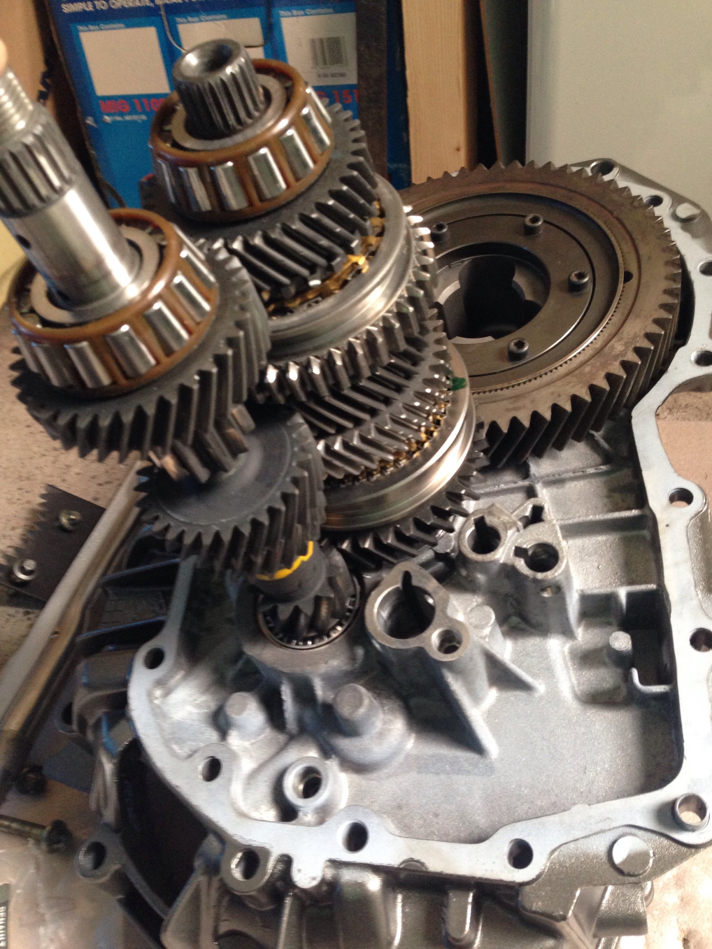

Input shaft:
Giving it a bit of a 'feel' with the casing on.
In this case it needed a bit of adjustment, so this was carried out until I was satisfied.

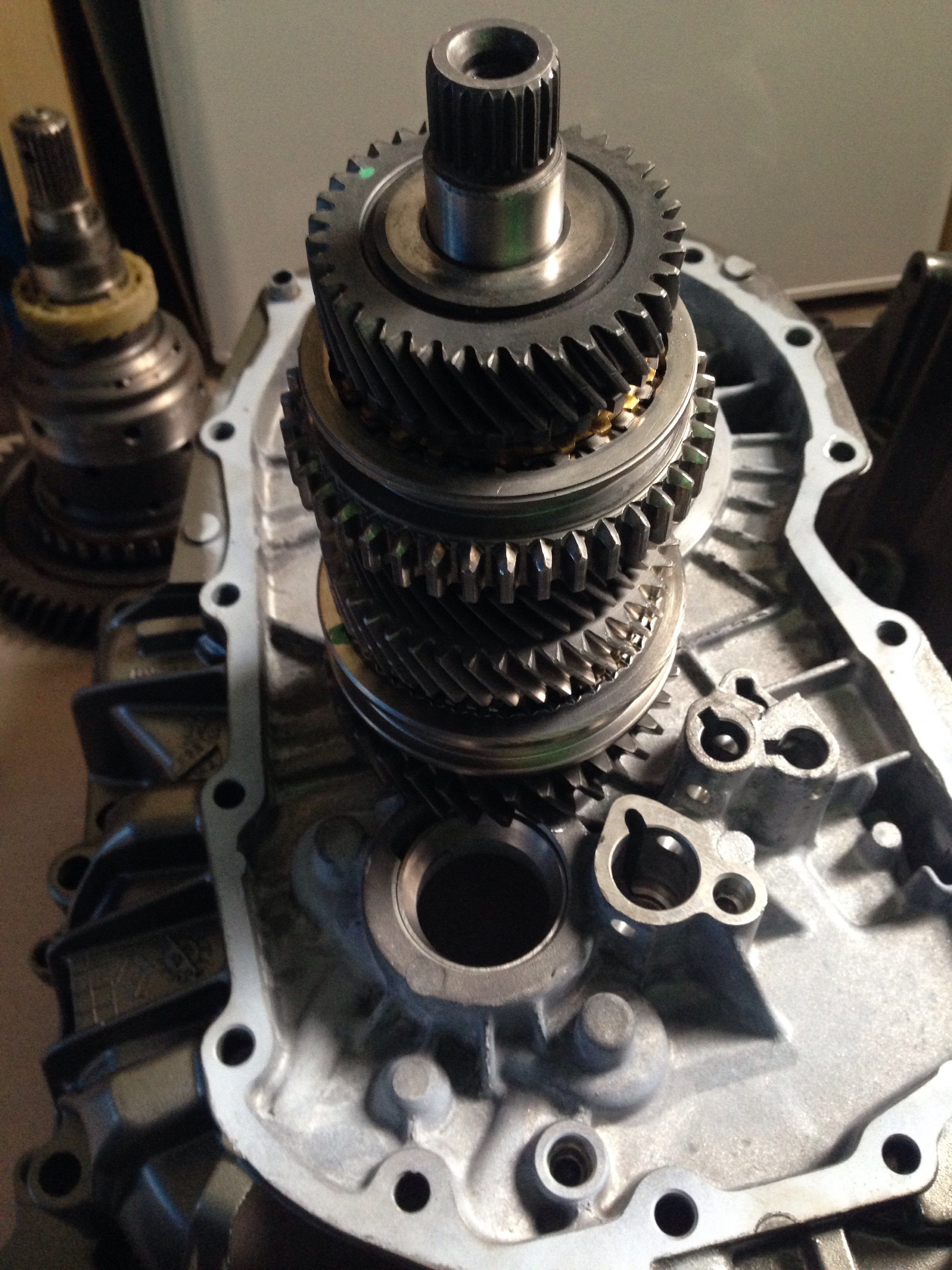

Moving on to the mainshaft. Did the same thing and tried it using the original shim. It needed adjustment also, but it's been fully stripped to a bare shaft and had new bearings fitted so this doesn't really come as much surprise.

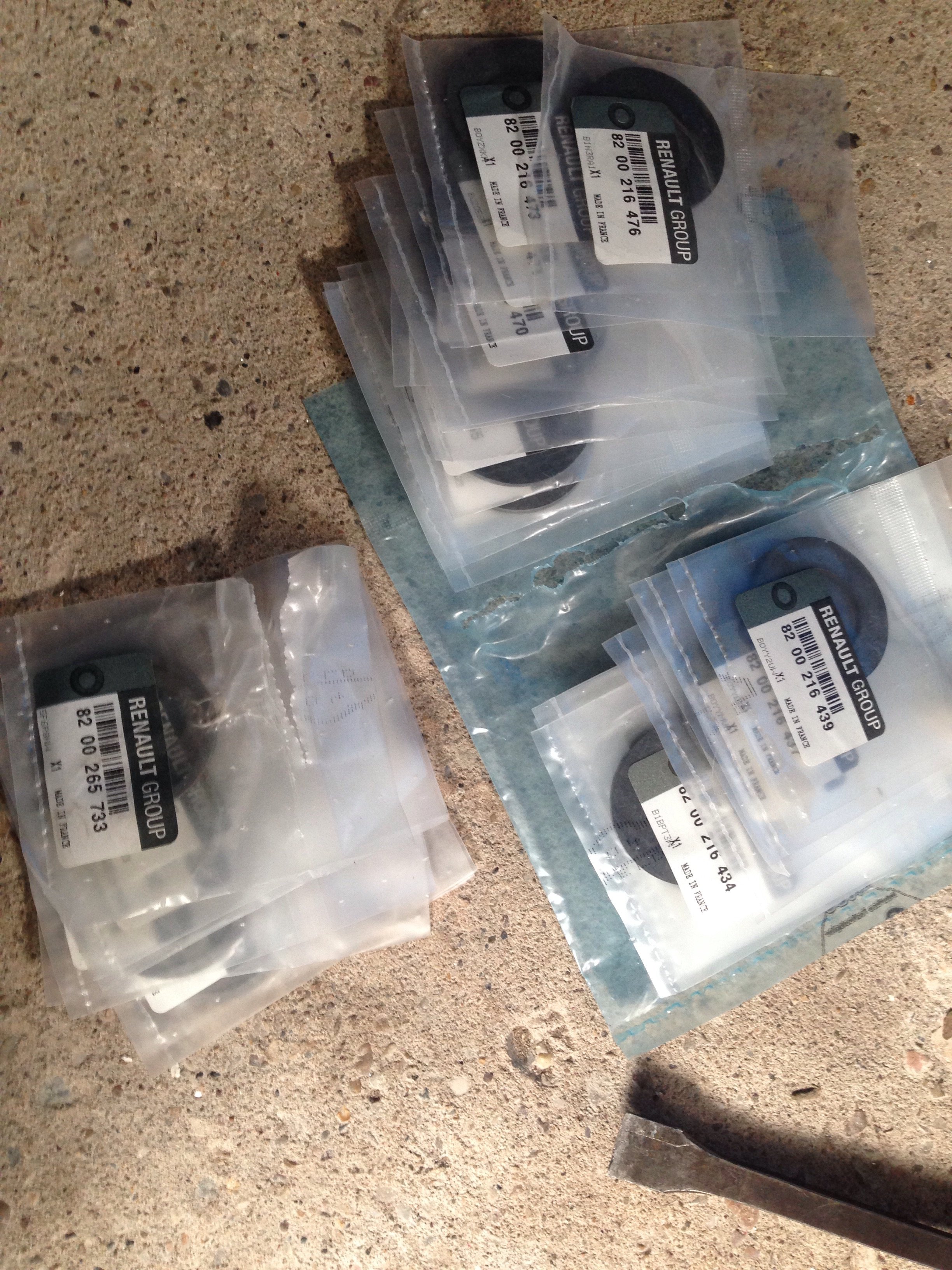

Here are the shims in question. As you can see, I've got plenty in stock!

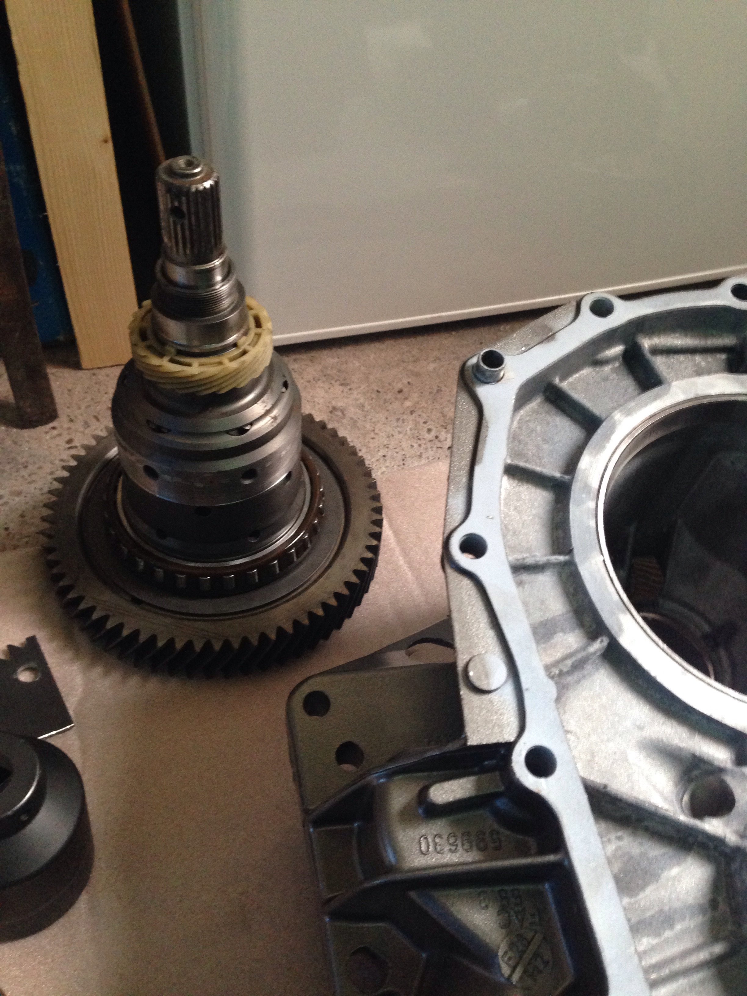

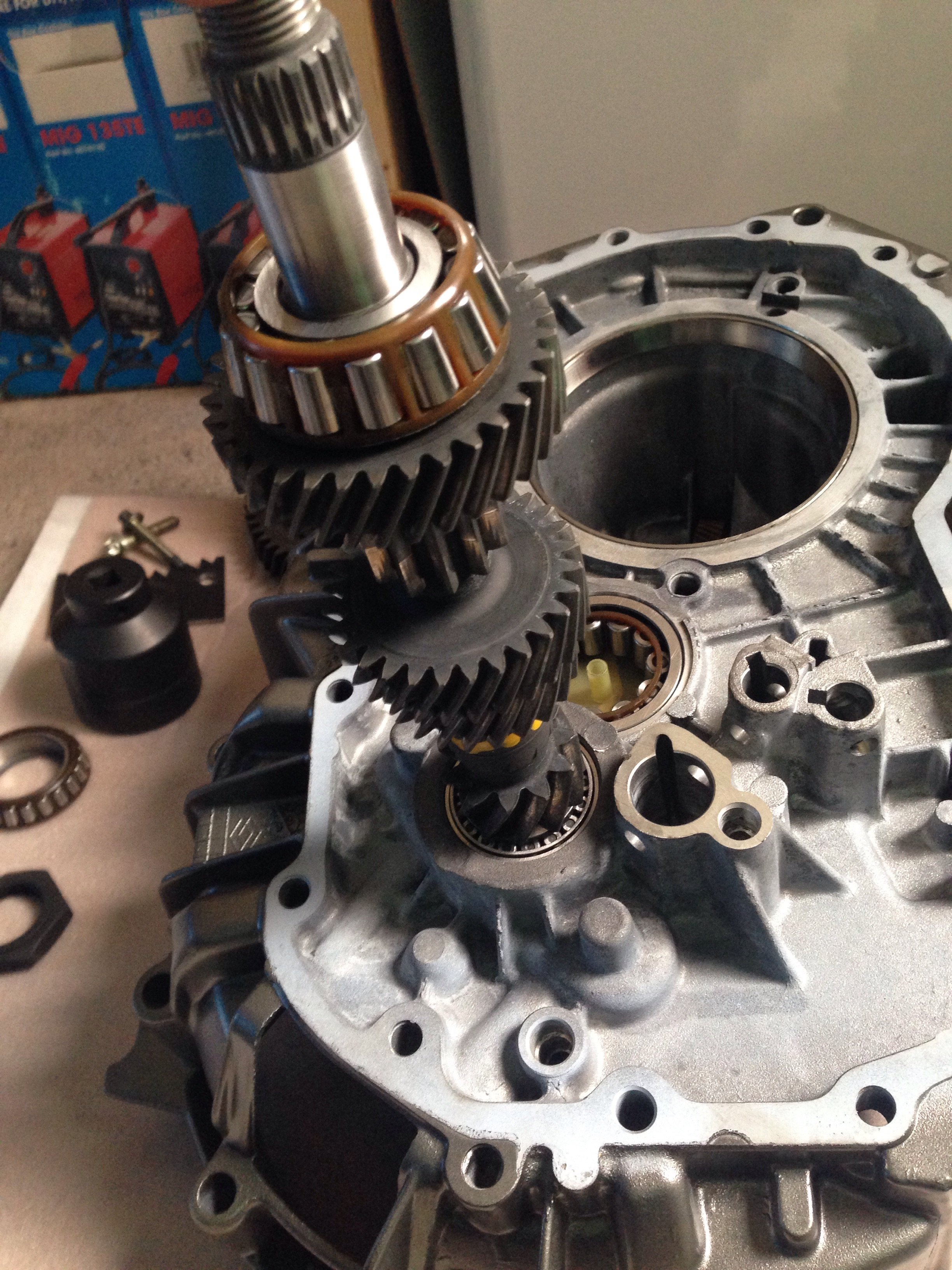

After the 2 shafts are done it's time to move on to the diff. Same method - old shim, try it, adjust as necessary.
There's a lot of faffing around with these gearboxes! You spend a lot of time building it up, checking, building up, checking etc etc to get the desired preload.

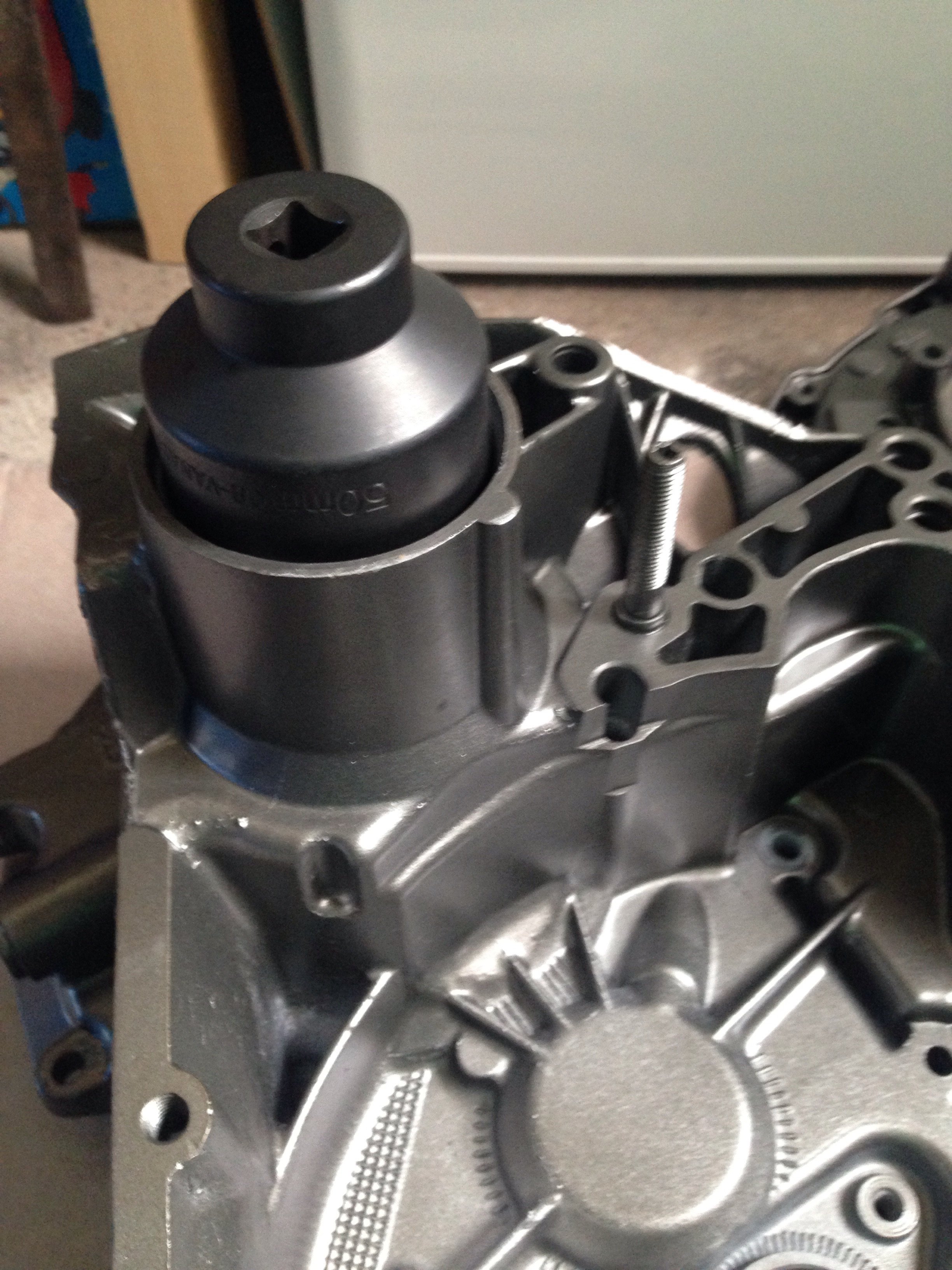

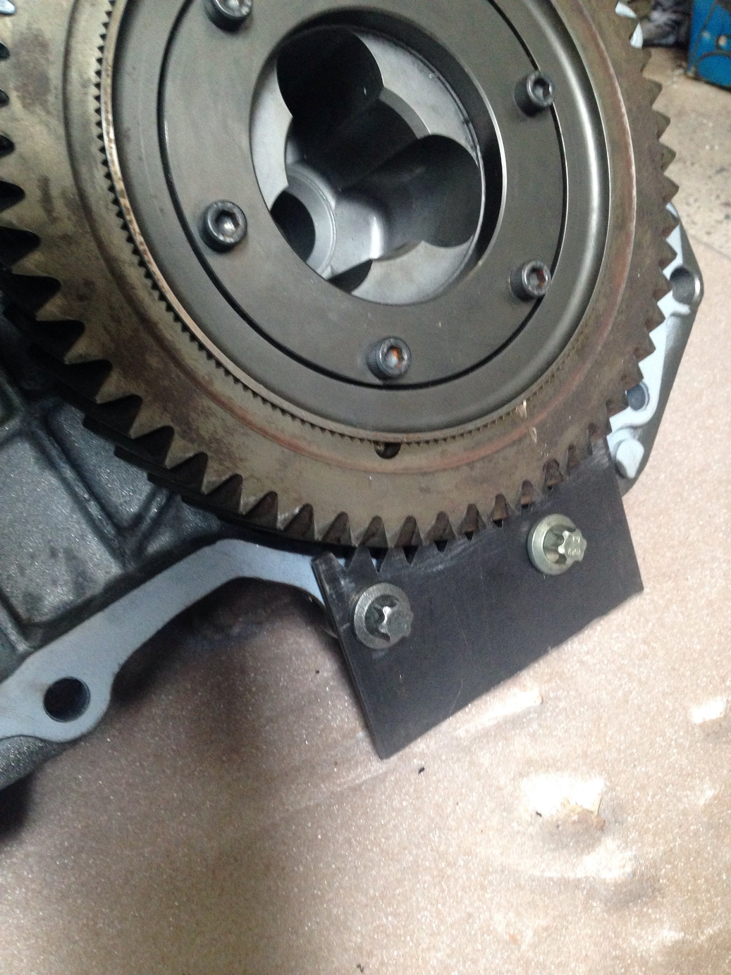

Fitted and carrying out tightening:
The diff nut has to be torqued up to 130Nm so this ^^^ little bad boy comes into its own.
Once I was happy I fired all the shafts in and gave the box a spin over to settle everything back in together. It's a bit stiff as the mainshaft is bone dry so the synchros are dragging. Bit of jollop and they're like brand new. Lol!

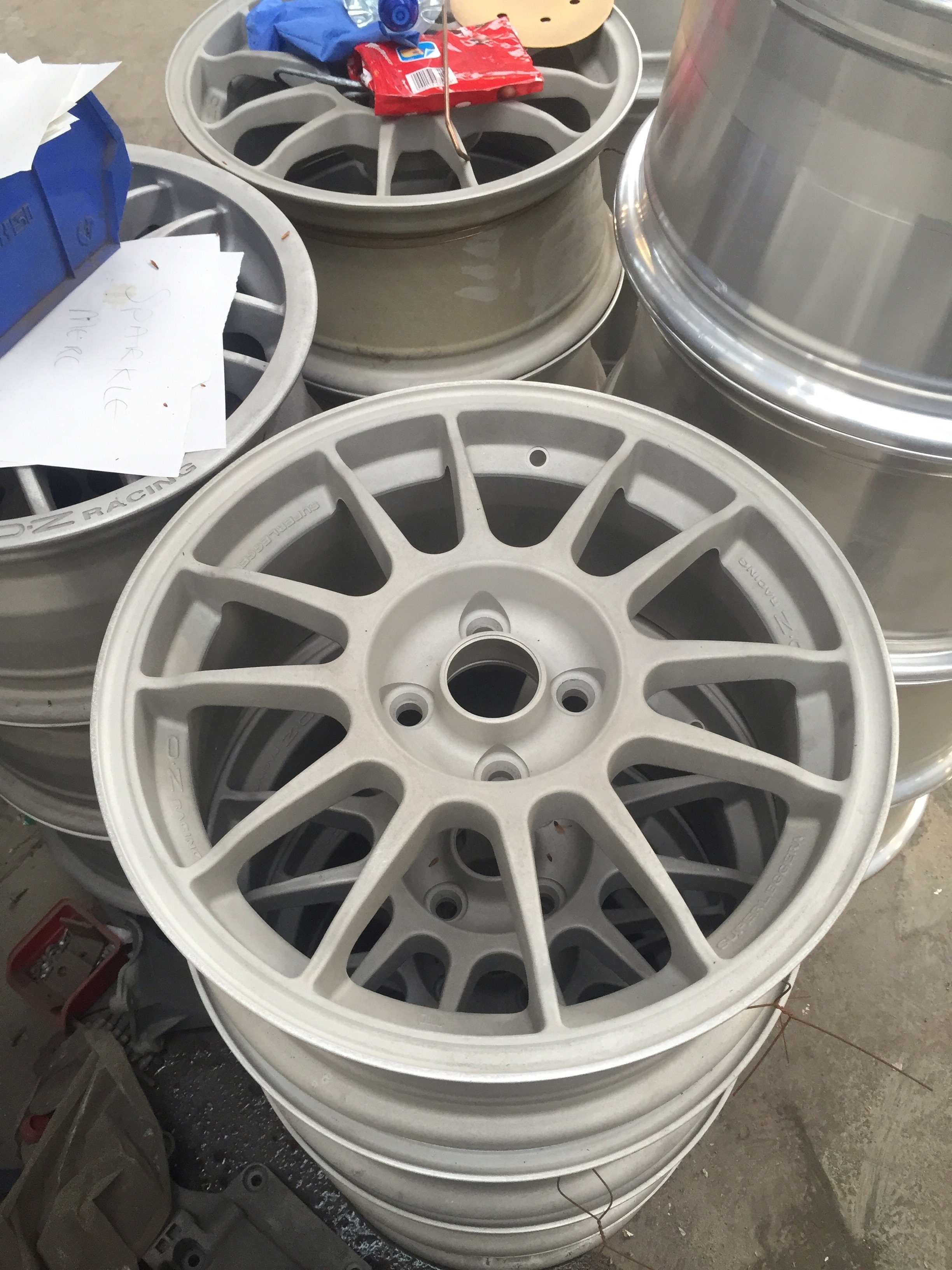

My track wheels are 15" turinis and tbh I think the car looks better on 16's. I know it's not about looks, but as with the engine, I like to go against to general consensus!!
I've bought a set of 16" superleggeras that will be painted in the green that adorns the inlet manifold and other items on the car. The wheels will be wrapped in a tasty set of 205/45 kuhmo V70a's in medium compound.

p@blo
  Clio/A3
Nice change Mark. You not tempted with some kermit 2118s? :)
They already primed, hard to tell on my phone? Will you bake them once you've painted or just let them air dry before refitting the tyres?
NorthloopCup
Nice change Mark. You not tempted with some kermit 2118s? :smile:
No definitely not tempted by 2118's mate! Never been a fan tbh.
They've been acid dipped mate so bare aluminium atm. They'll be done in whatever process my mate does them! Lol! He does them that cheap it's pointless me even wasting my time.
