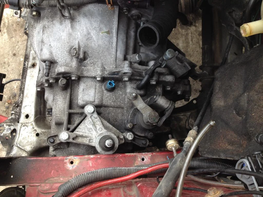

So, I would have liked to have got more done this weekend, but not been in the right mindset for it yet, plus I'd like to do things in the order I have them in my head.

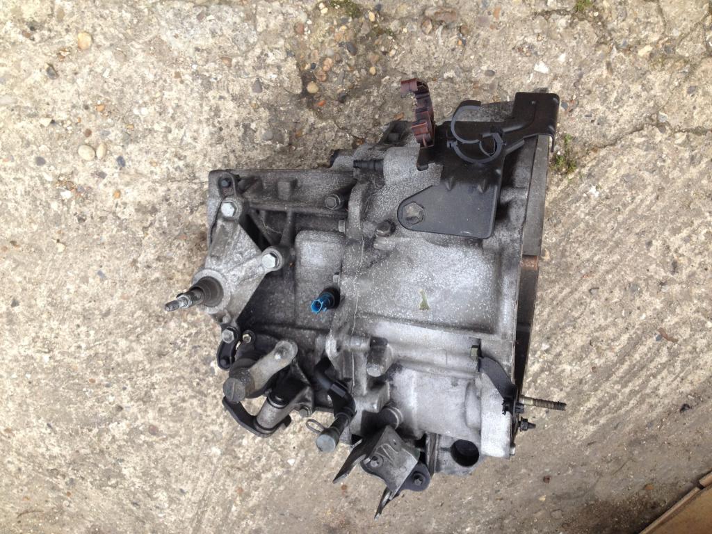

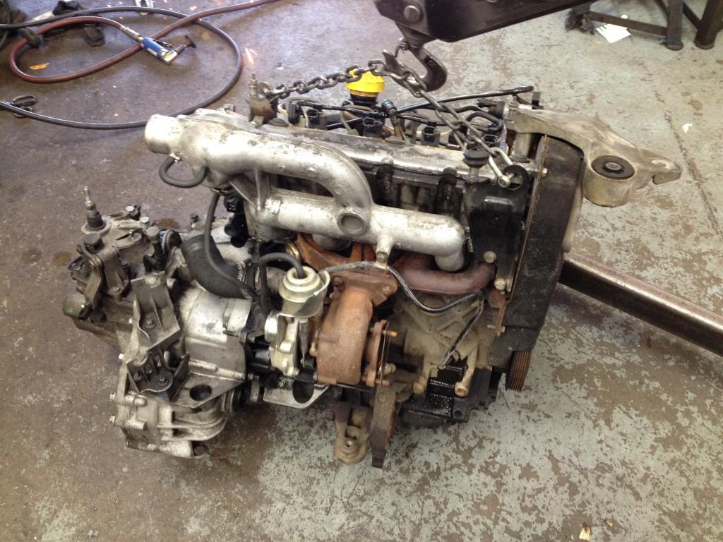

I discovered the other day a Megane 1.9 DCi 6speed box would be a better fit, NDO01 box vs the Laguna/Trafic/Clio V6 huge PK6 box.
So bought one, and a megane shifter, as the NDO box has a different cable layout.
Ripped the enigne out, swapped box and got it back in... Much better fitting
Even the Clio mount lines up lovely
Ideal!
Next on the list now is to cut some of the chassis leg out, to get the gearbox higher (its currently sat on the subframe), and back ever so slightly.
I had a look at the Megane shifter, once I knock the studs out of the Clio tunnel it will bolt up perfectly.

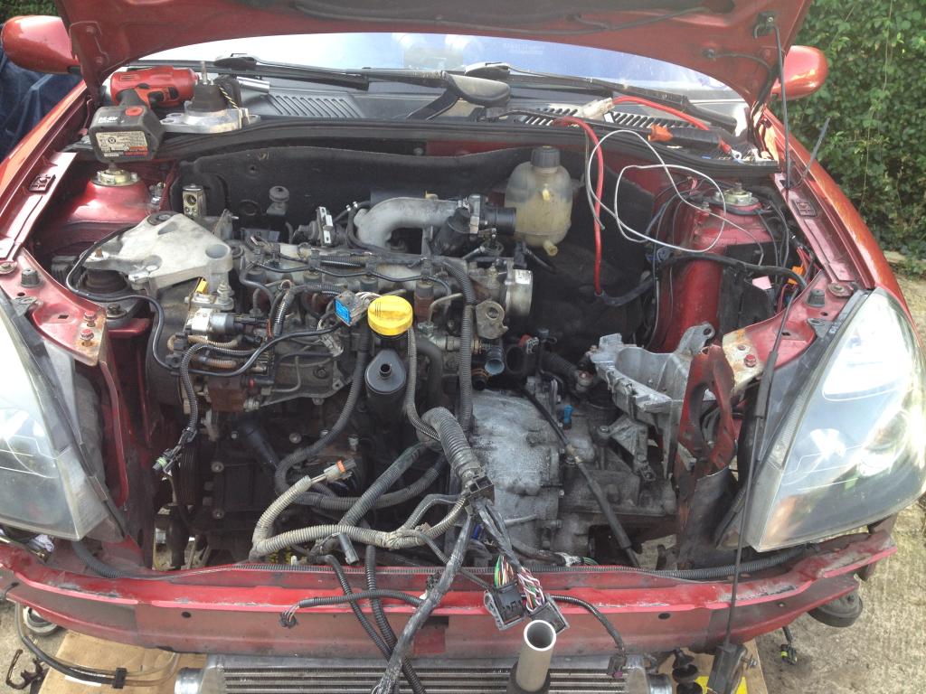

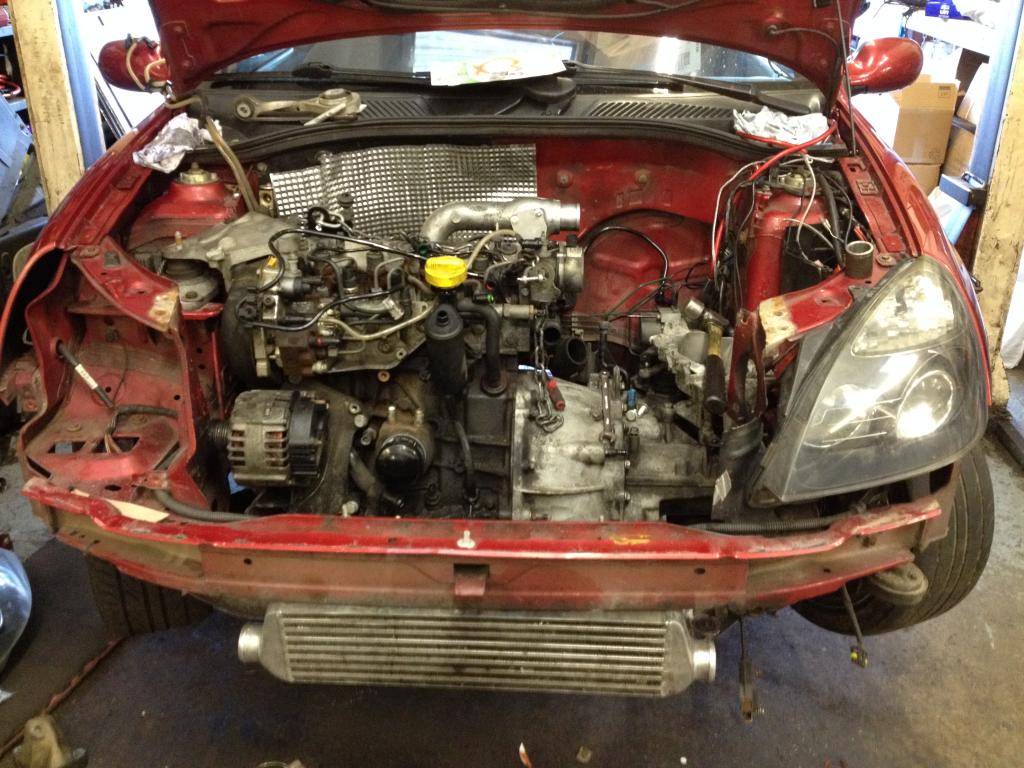

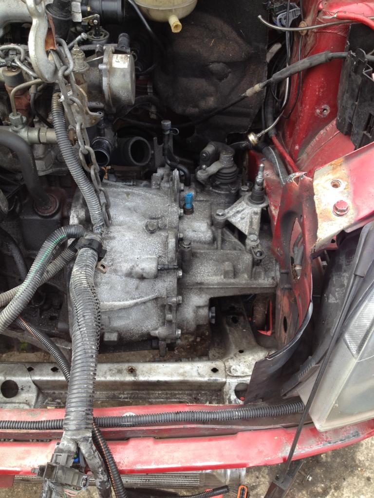

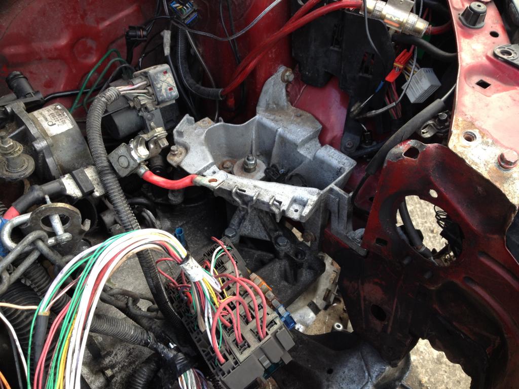

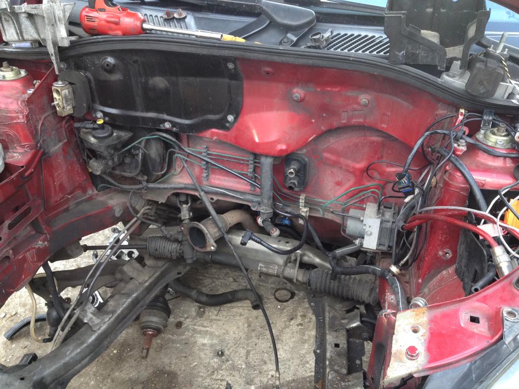

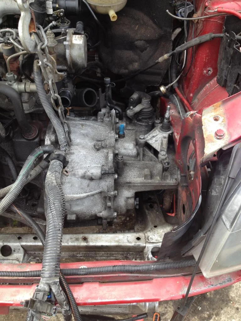

Pulled the engine out again today... Getting pretty damn good at it now.
Removed the bulkhead sound deadening, as I ordered some Nimbus to replace it. Also removed the clutch cable after this photo.

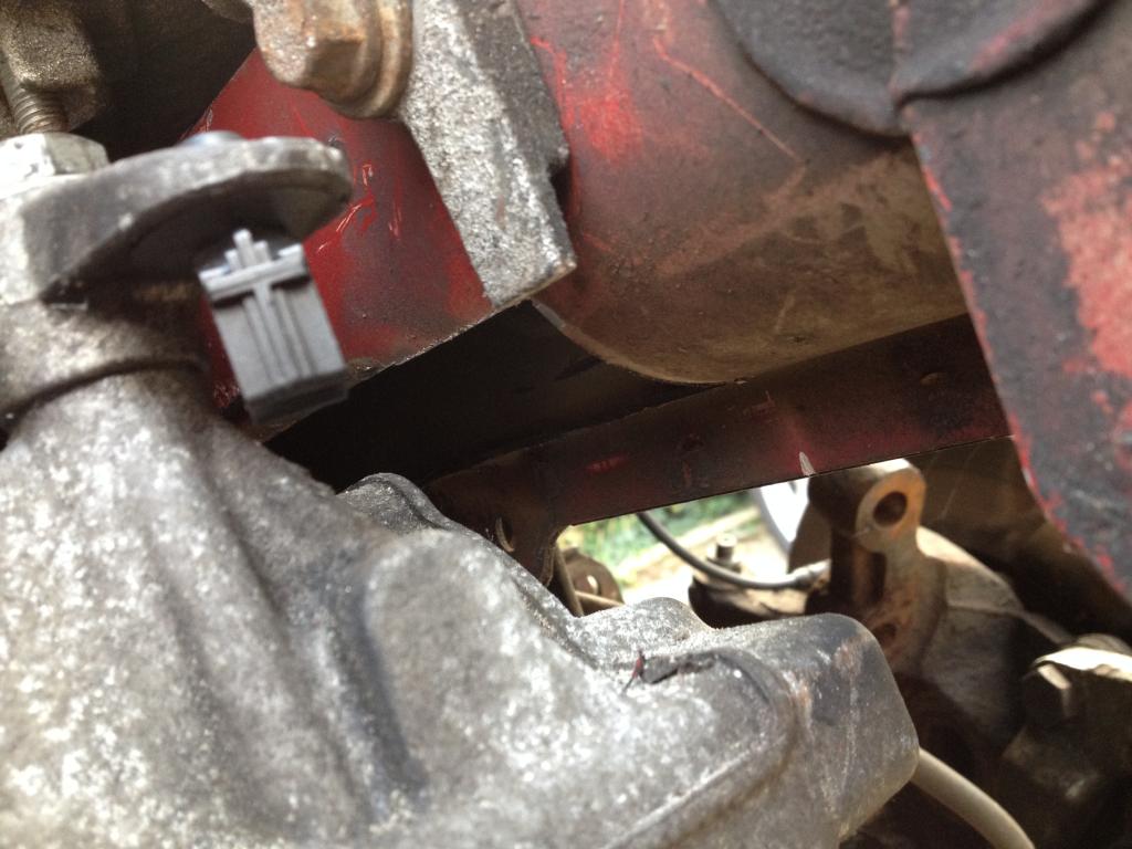

Then cut like 1/3 of the chassis leg out... Meaning I could get the engine back in, and mounted properly.
Plenty of room... Cut is much bigger than it needed to be, but I'll box it back up again, so I don't care really.
To get the engine and box level, I plan to trim the alloy part of the mount (Actually need another one of these, as this one is broken, no time to collect one though!)
Its certainly pretty close to level
Look at the clearance on the rack! Thats with it right in too, so close as it will ever be. Ideal!

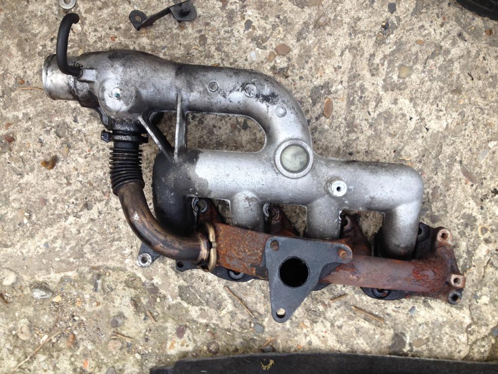

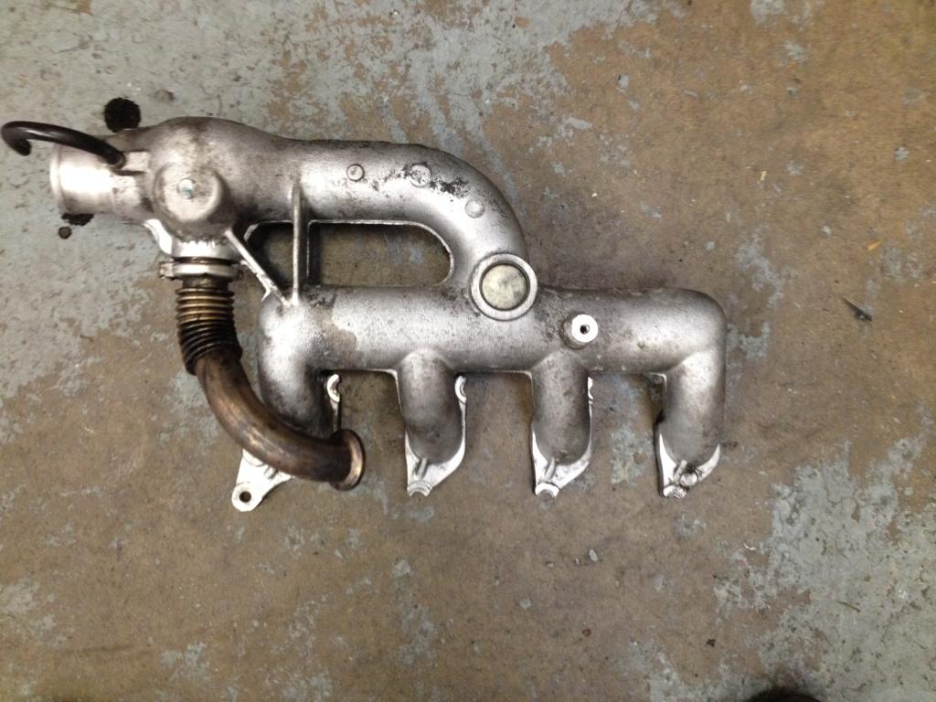

Also bought a new inlet manifold from a Trafic 1.9, Came with the exhaust Mani, not that I need it.
Cleaned it up a bit and split it from exhaust mani. Reason for this inlet is due to the lack of intake flap valve thing, plus makes it easier to sort EGR blanking/EGT sensor.

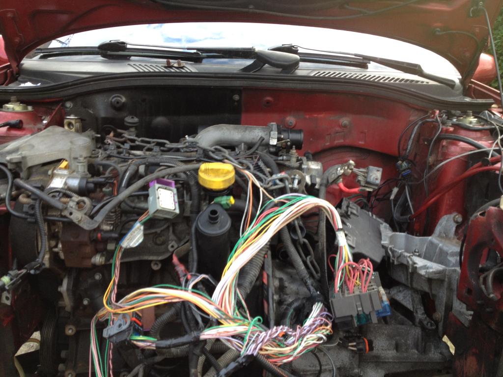

Lol at the wiring , mine looks like I'm half way stripping it down with no wiring loom needed.
Box is is mighty close to that boot, get a smaller boot ? Just incase it catches. You don't want s**t getting in there and having a nightmare changing the rack after it's all fitted ;)

Yeah was doing some investigating on the wiring last week or whenever it was. Will hopefully make a start on that properly soon.
Its actually going to be miles away from the boot, with the engine in the correct location (tilted a bit) its even further away. Ive decided its going to be pretty solidly mounted (while still being rubber/poly) so won't move. If I have to change it I'll rip the engine out again lol.

lol, go source a wiring loom and ecu from a traffic first ;)
Im hoping I can just use the Laguna loom. Need to check wiring diagrams/strip looms, or just do as you said... I also need to decide what to do on the ECU front.

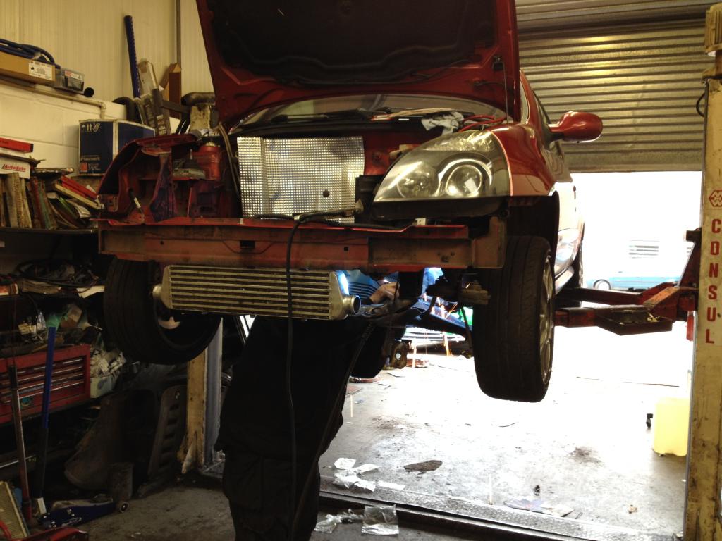

I did mock up my 300mm calipers... I didn't think I'd have any clearance issues, and I was damn right, loads of space!

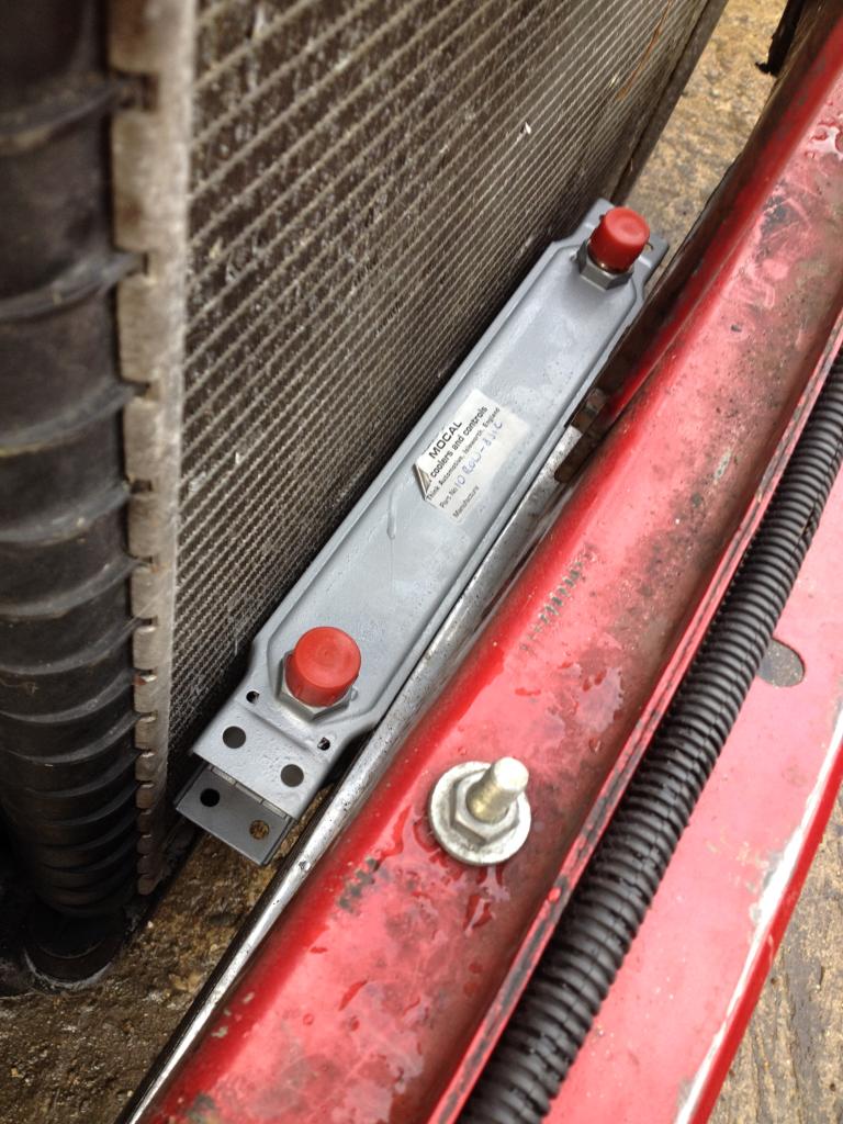

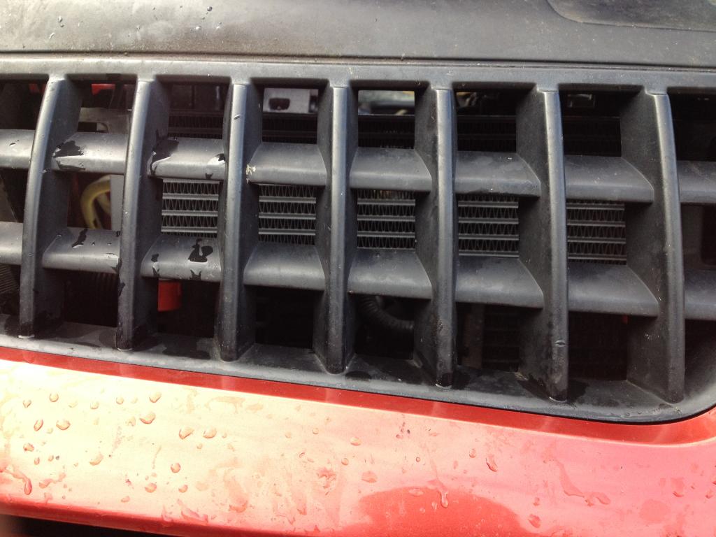

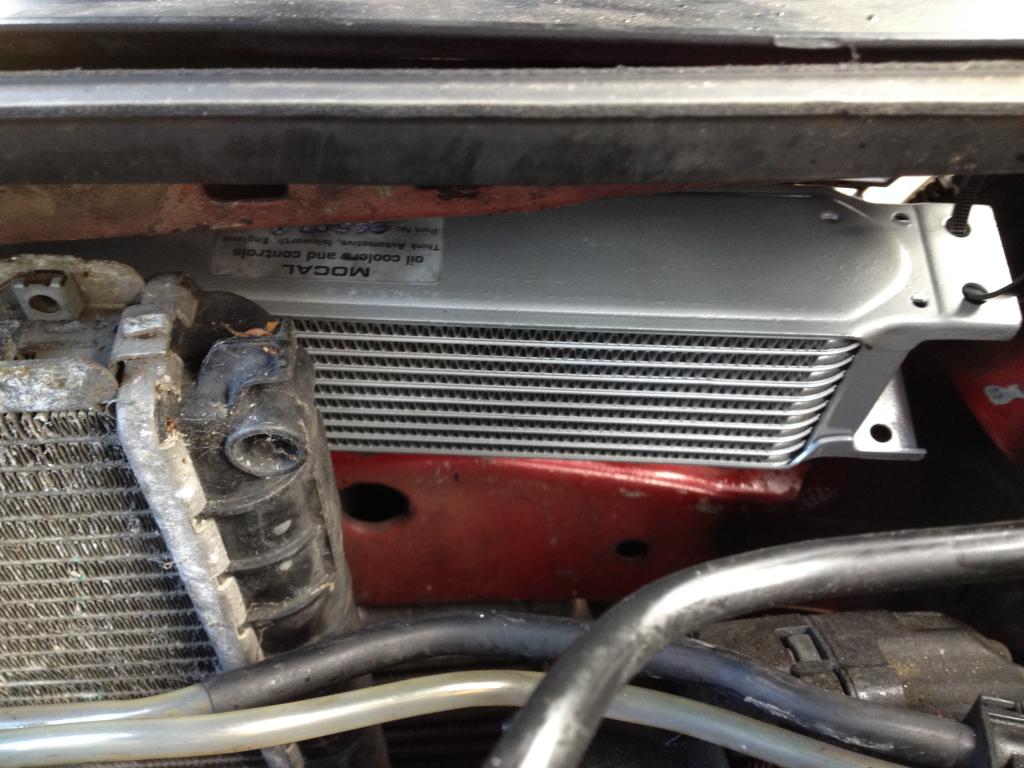

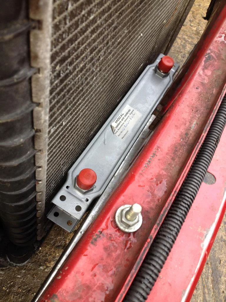

Also mocked up/worked out where to fit my oil cooler. Its a 10row Mocal. This is due to me binning the oil to water cooler, for two reasons, firstly it makes coolant pipes much easier, and secondly, it'd be needed in the future, so may as well just do it now. I'll use a thermostatic plate.
I thought about here, between the intercooler and coolant rad, this would require moving one of the former, plus its not ideal for cooling purposes, although would still be quite efficent due to no air gap between everything.
But I actually decided here, its a bit tight, but I can make it work, will sort out brackets next week probably.

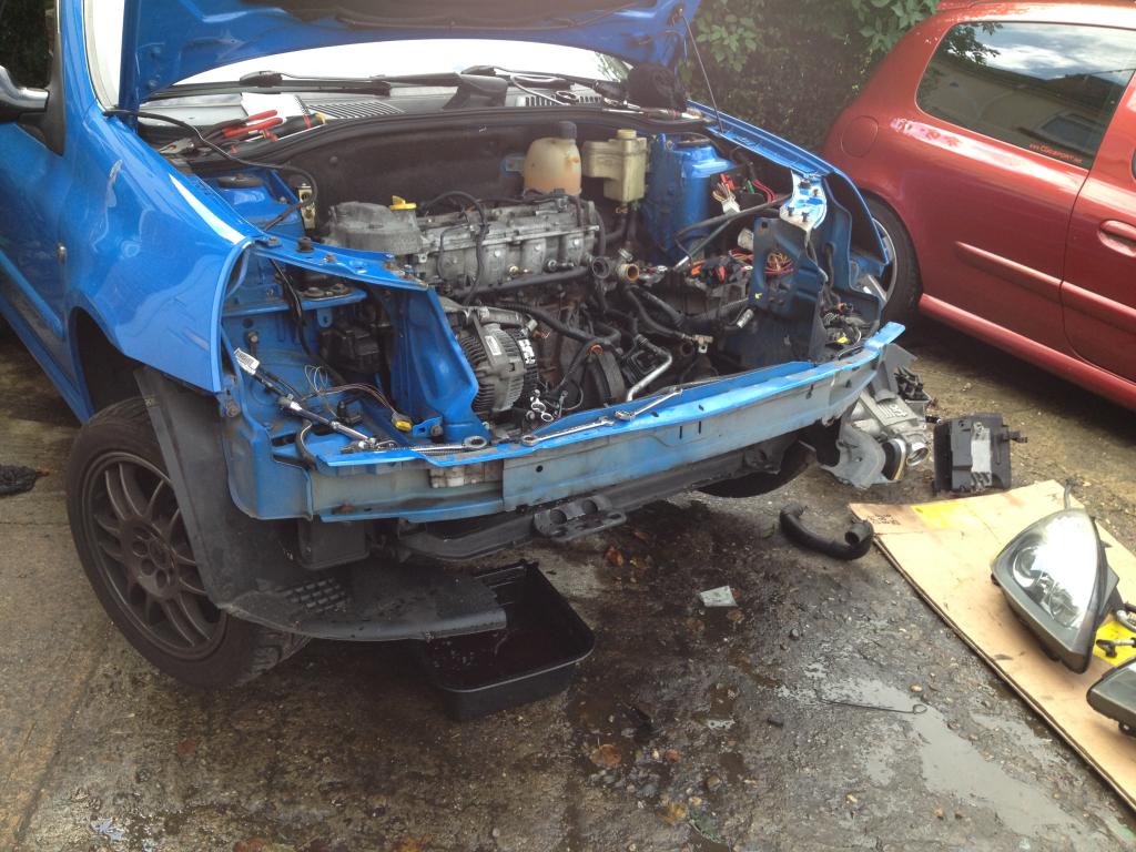

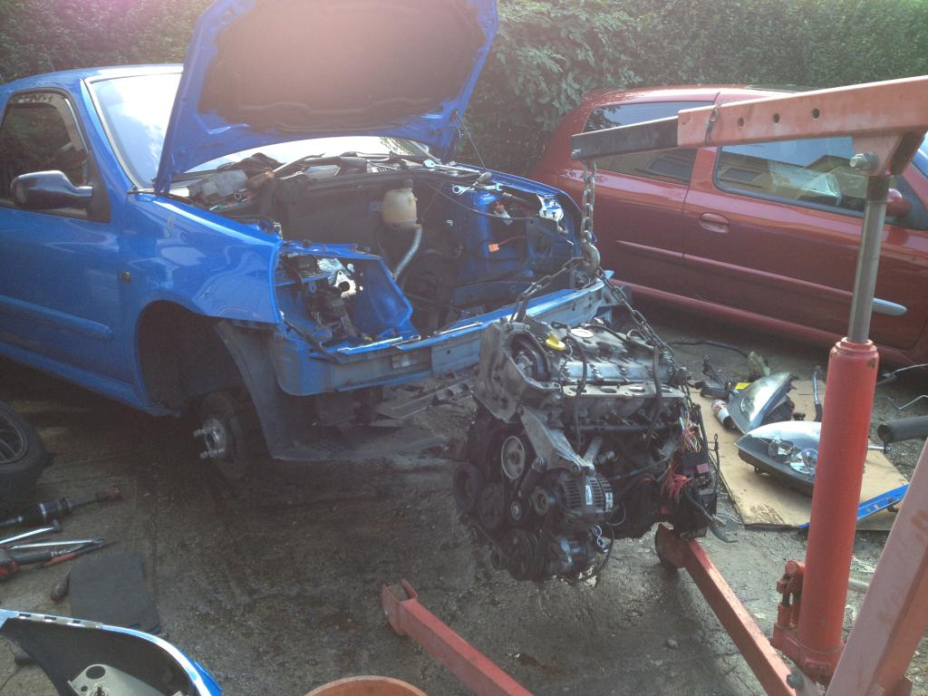

Then made a start on @trails Clio.

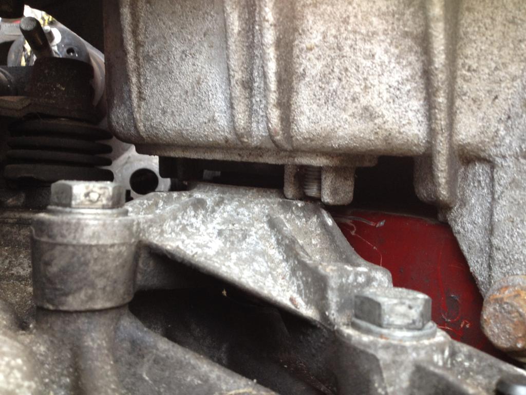

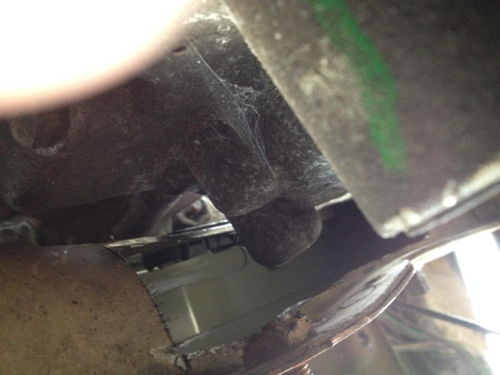

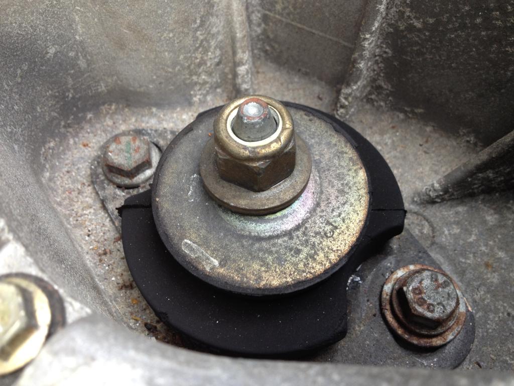

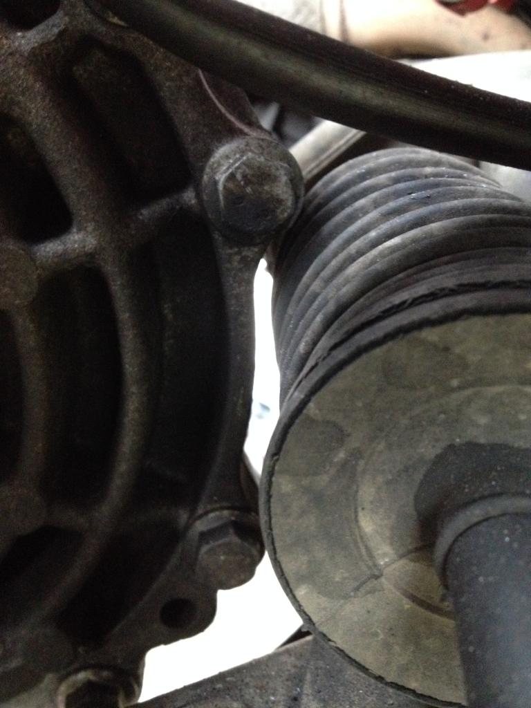

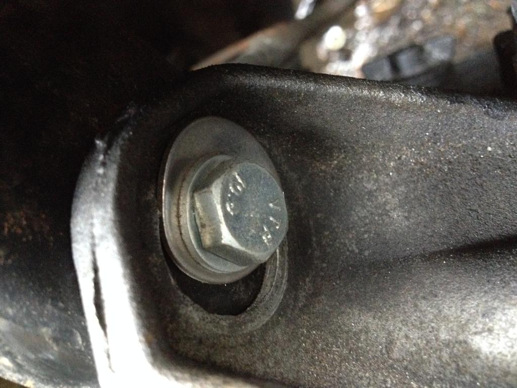

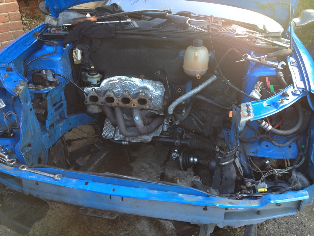

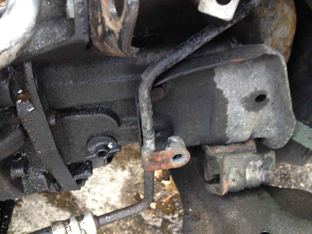

Found a few issues... Loose gearbox mount nut (like, not done up at all), plus broken gearbox mount, and various other bits, couple below.
Nice attachment of the clutch cable support
Missing pas pipe bolt
But, I got it stripped,
And engine out
Box is off to Agency and I'll be doing the Cambelt and dephaser while its away. It'll also get new clutch and few other bits. Plus lots of broken and missing bits fixed. One issue that has always bugged me on this car is the wiring isn't secured for the most part, and run completely wrong, so will spend a bit of time fixing that too.

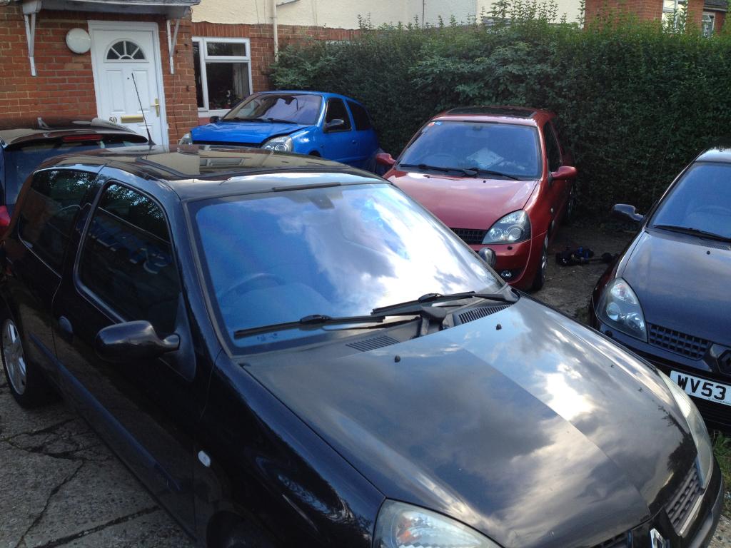

With the purchase of another 172, I've run out of space
Plus I have another Clio waiting in the wings!
Keeping busy as always!

Thanks Alex
Not noticed it because its probably been like that since I bought it...along with the broken engine mount and a plethora of other bits of cowboy maintenance. Broken engine mount did make it challenging going round right hand corners quickly though... @welshname
  Many.
That gearbox mount is ridiculous. I've no idea how someone wouldn't notice how bad that was?!?!?!
Also you need a unit.
Yeah, as below, its obviously been like it the whole time, and although I've driven this car, I guess I didnt look for it.

LOL 5 Clios on the drive, good effort!
:D Keeps be busy and sort of off the street lol

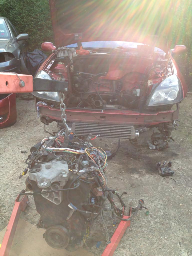

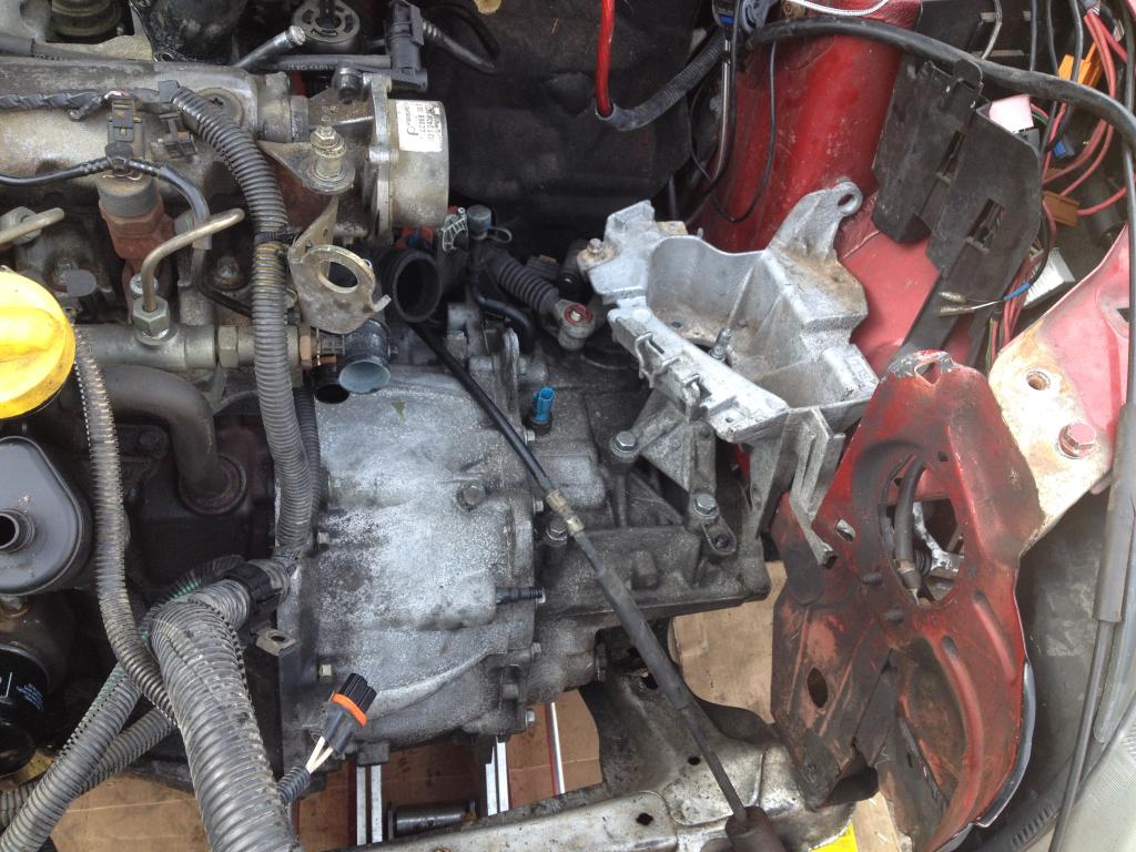

Towed it down my mates workshop, and got to work.

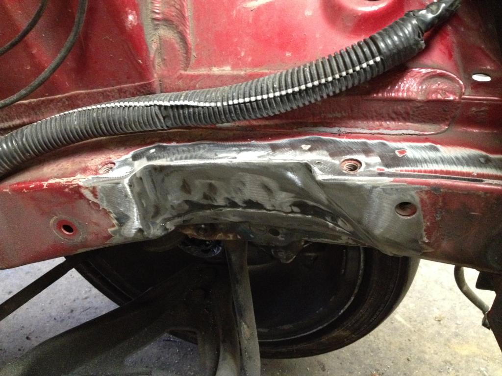

Pulled engine out, changed inlet and exhaust manifolds, re-assembled everything, but I'll be changing the turbo yet.

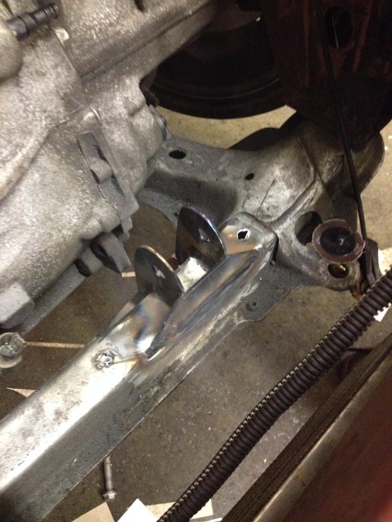

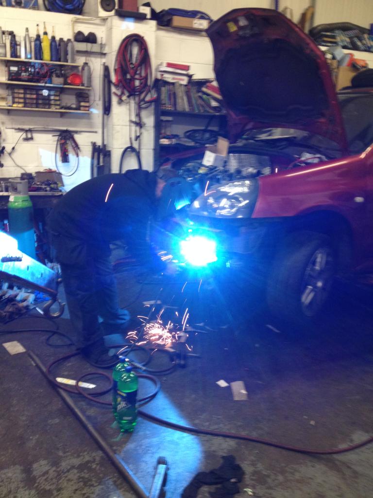

Mate welding up the chassis leg, note badly fitted Nimbus, will sort that out later
To produce...
Chucked the engine and box back in

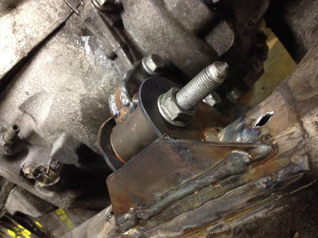

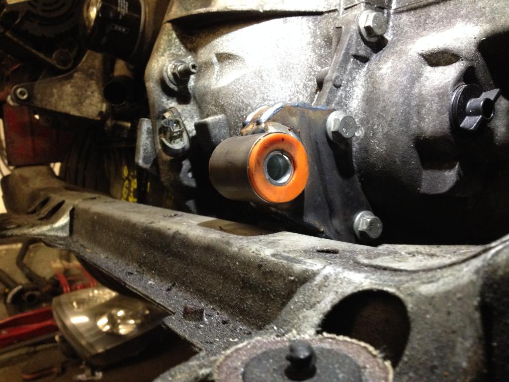

Then started on the front gearbox mount..
Some more welding...
To produce
Ta-dah

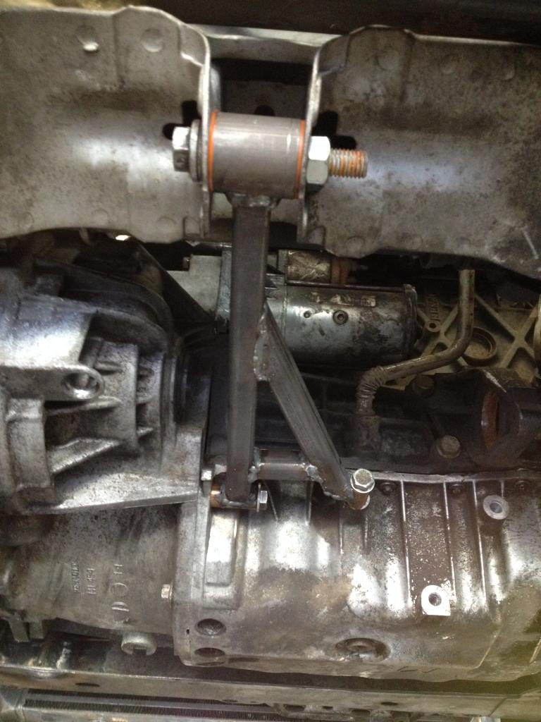

Thats all for today. Tomorrow is dogbone making, and a few other little bits.

Ahh it's the front mount! Is that still my 182 subframe? If it is my friend will be happy his much loved car has the parts put to good use.
That engine isn't going to rock!
  Many.
Yeah sorry I didn't reply to your text, will do so now. Is indeed your old subframe, hope I dont f**k it up.
It is pretty solid actually, concerned about vibration now.

And thats the rear mount done, pretty solid.
