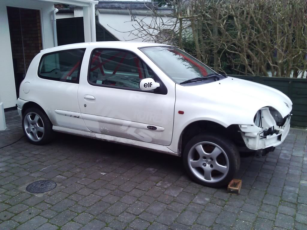

Ok so i've had this phase 1 white Clio 172 shell for 3 weeks now so i thought i'd put a few pics on here to show what's been going on. I'll obviously update this thread as and when more work is done to the Clio.
The plan is to use my Odyssey blue Clio 172 as a donor using the brakes, suspension, seats, engine, gearbox, all ancillaries and any other part to complete the project. Along the way parts will be bought new that need changing or decide to uprate.

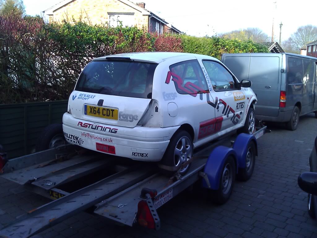

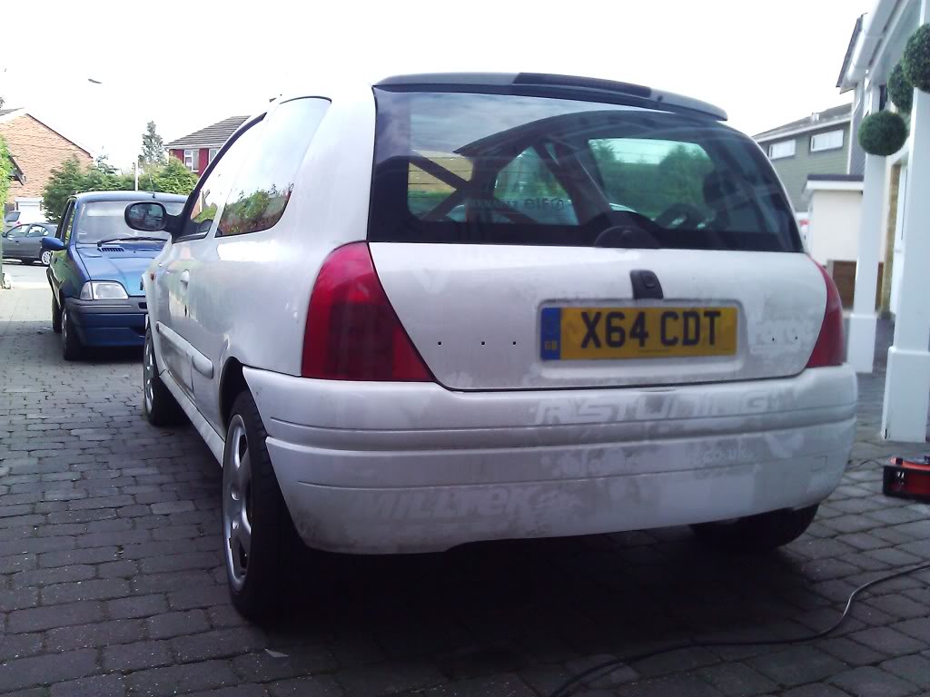

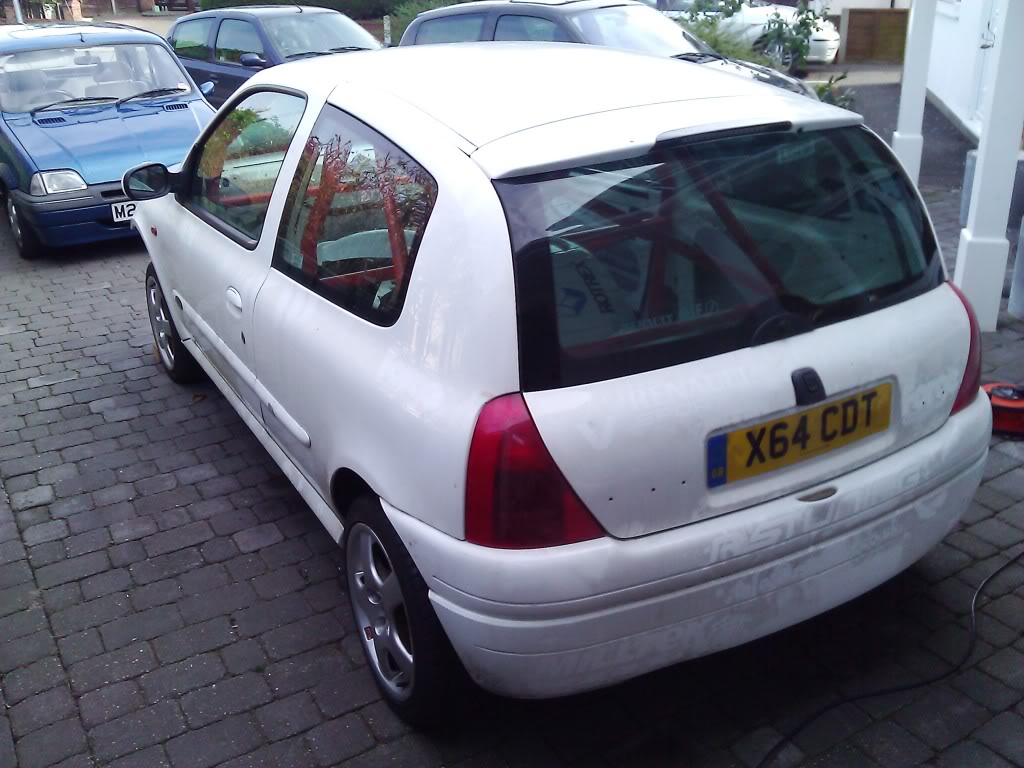

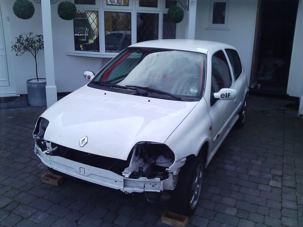

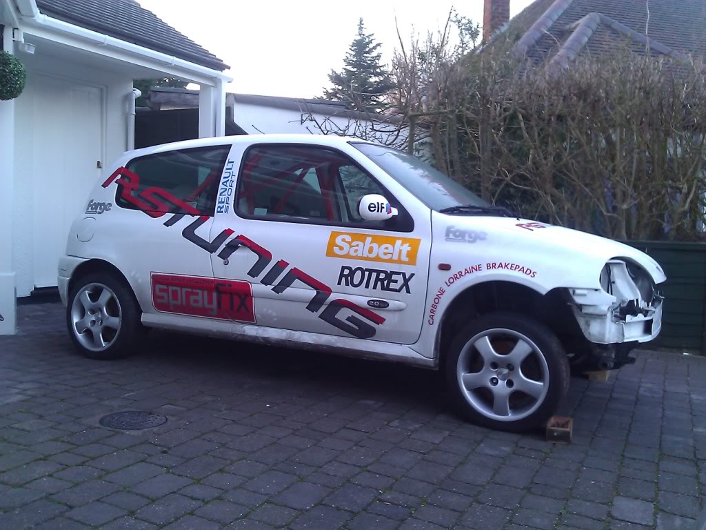

White shell back from after picking up from DannyR in Suffolk

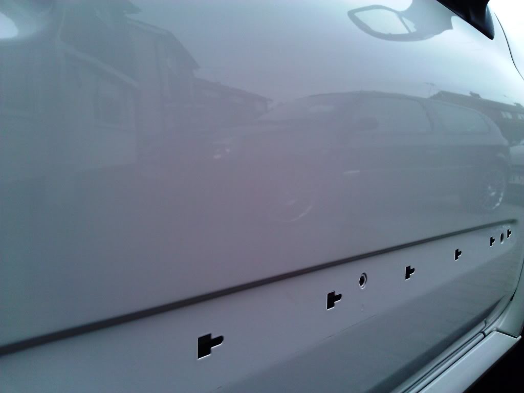

First job is to remove all the stickers!

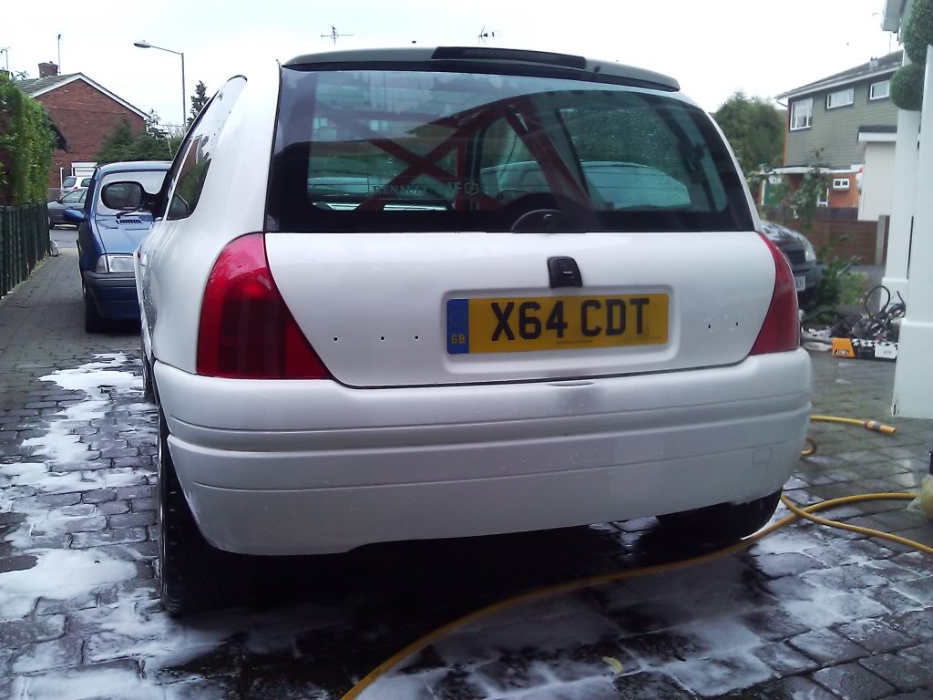

Back end
Passenger side

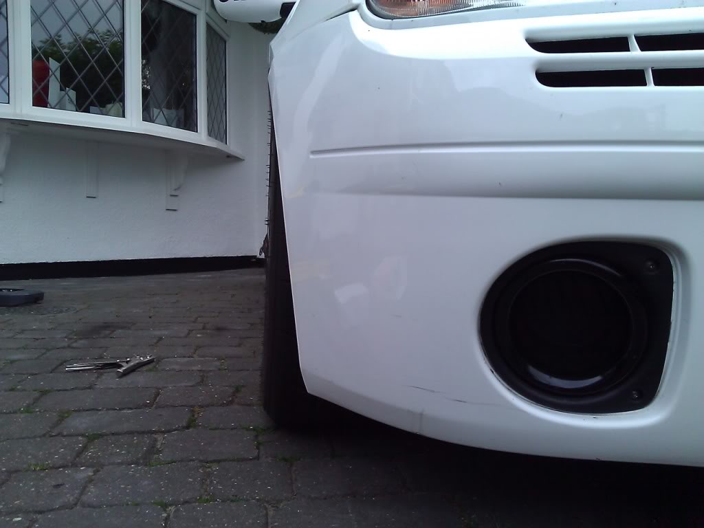

Front
Drivers side

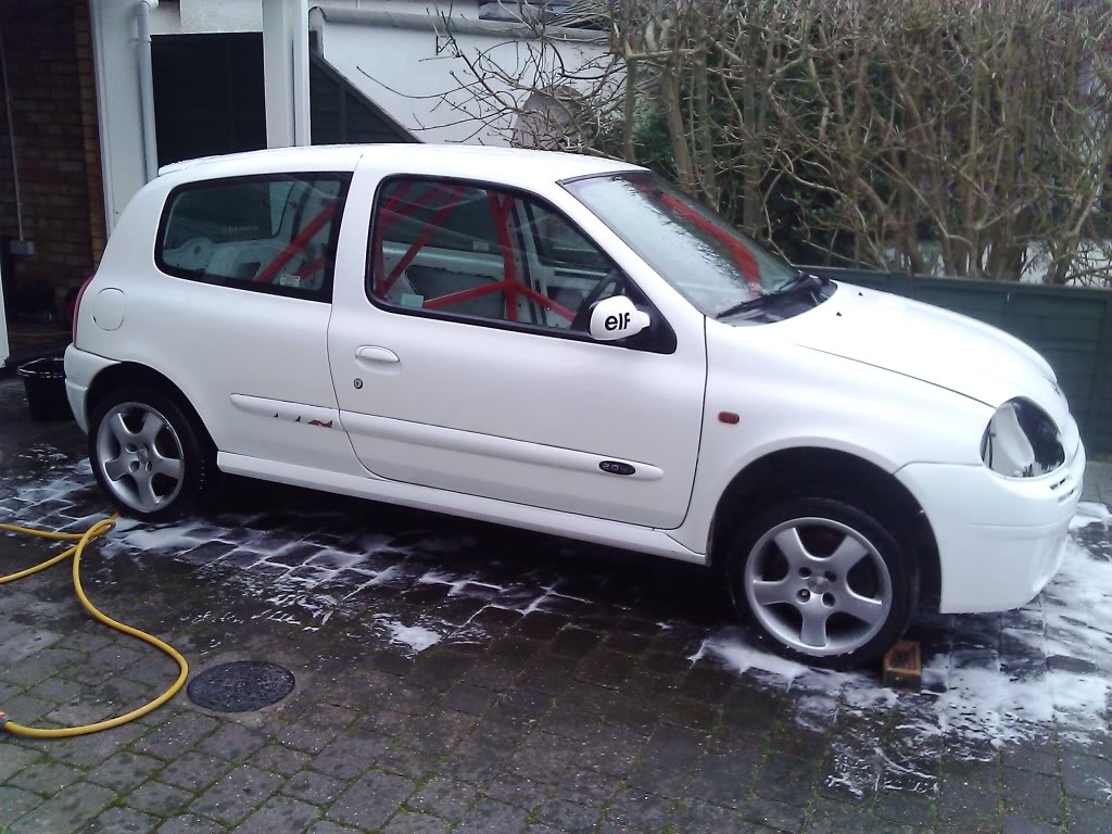

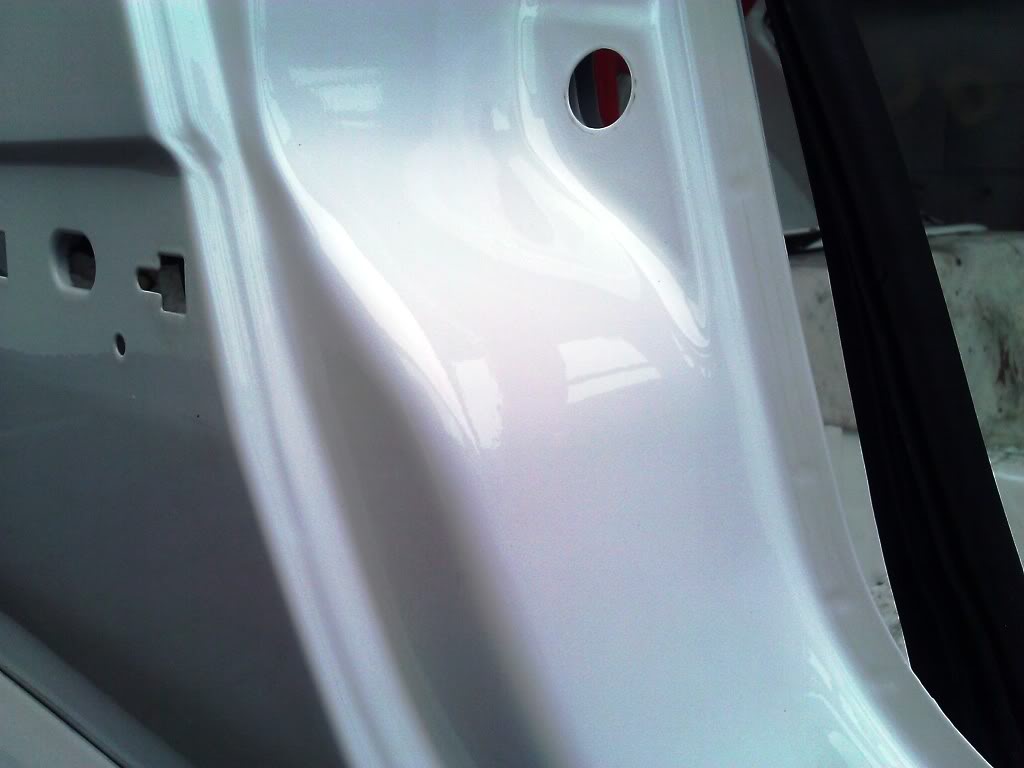

First wash after months

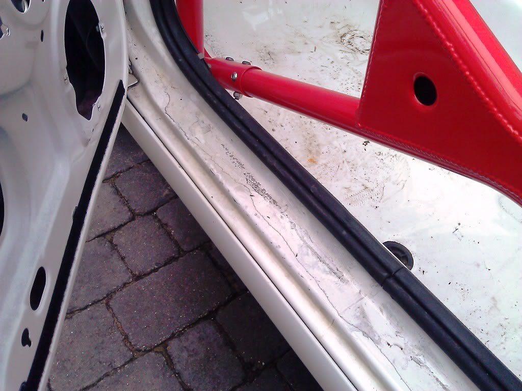

AutoGlym tar and bug remover to clean glue residue, then Super Resin polish

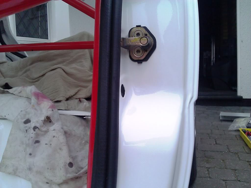

Wash and polish door shuts, rubbers removed

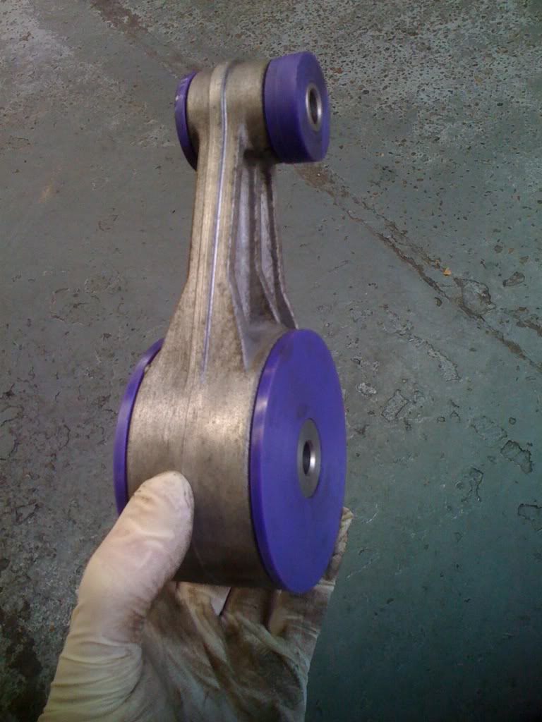

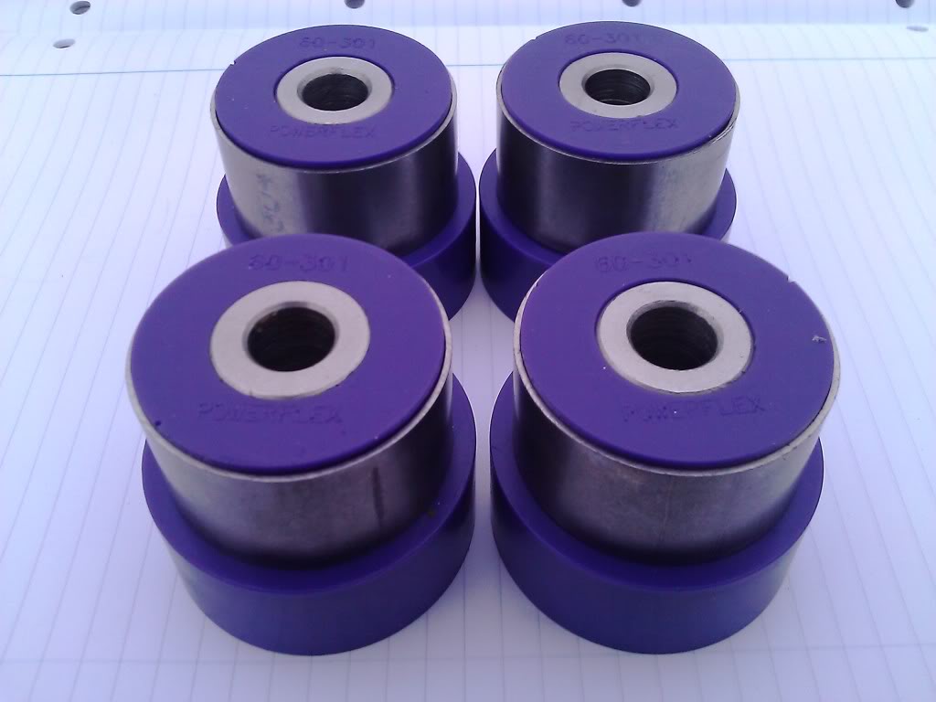

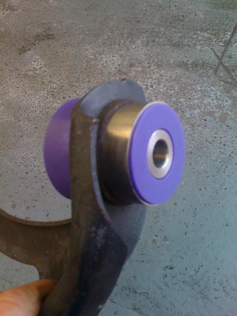

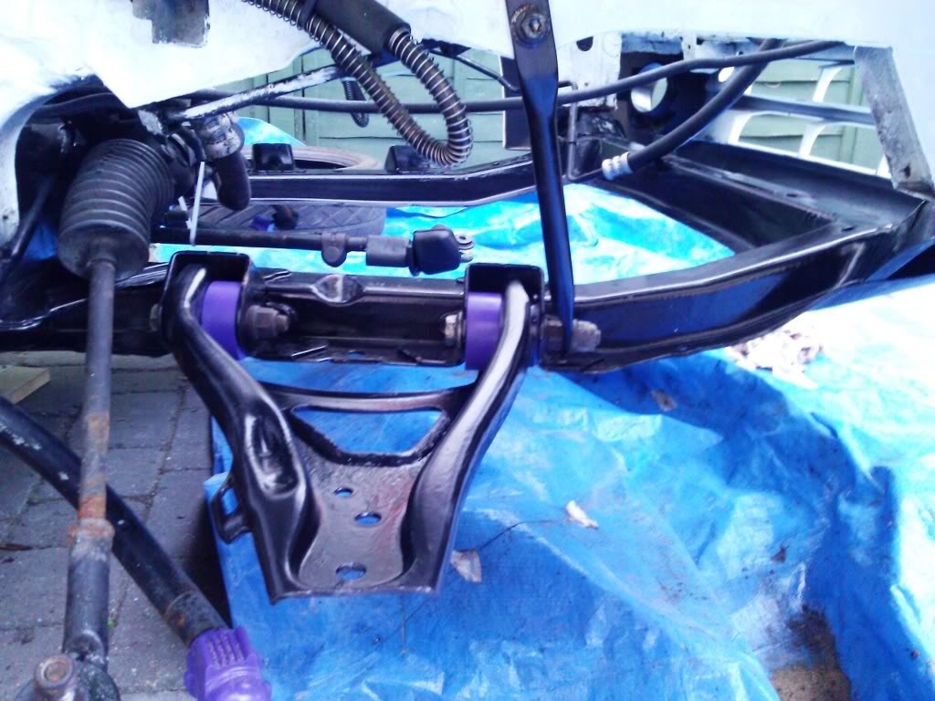

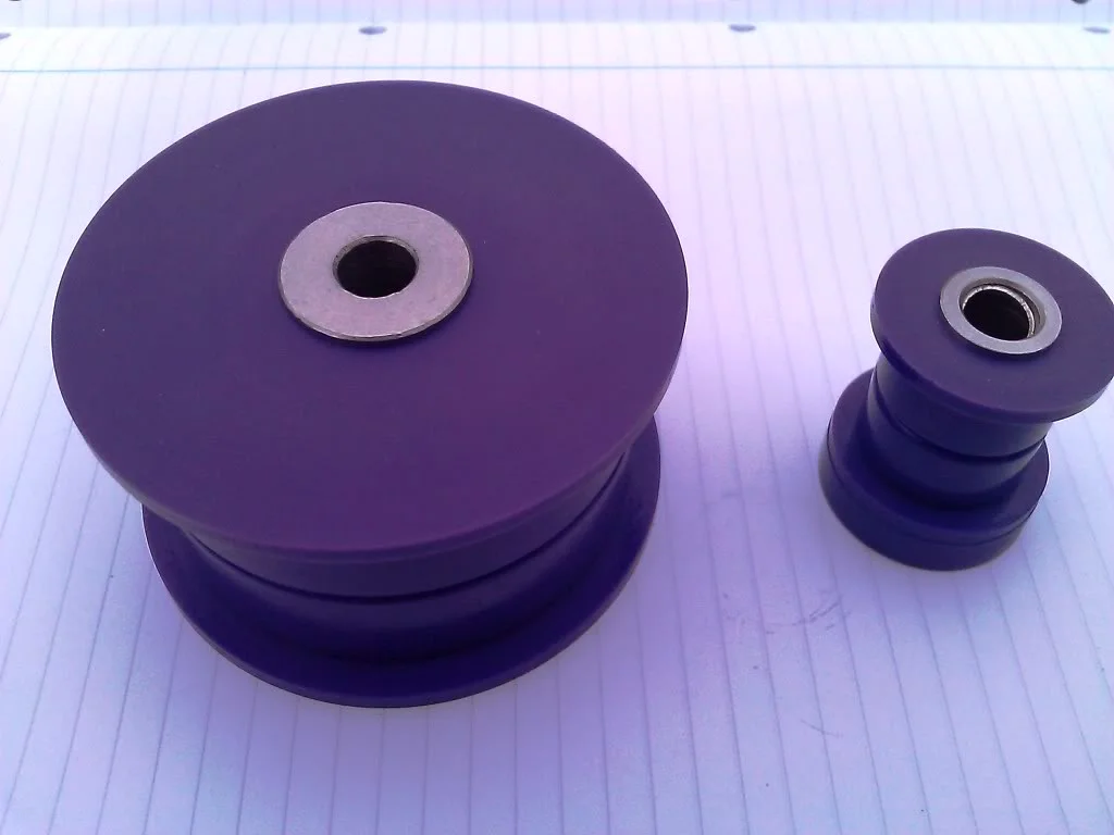

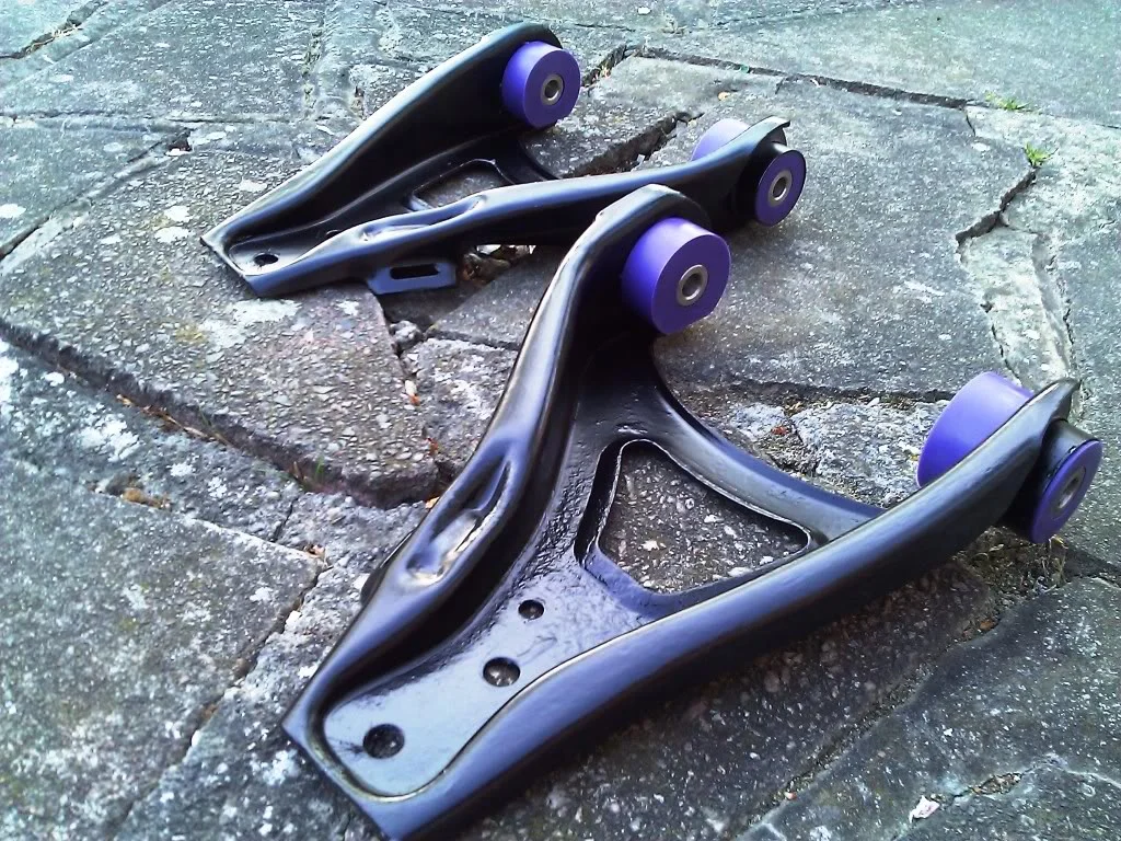

New Polyflex wishbone bushes
New Polyflex Dogbone bushes

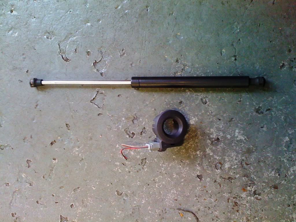

Decoder ring and tailgate strut

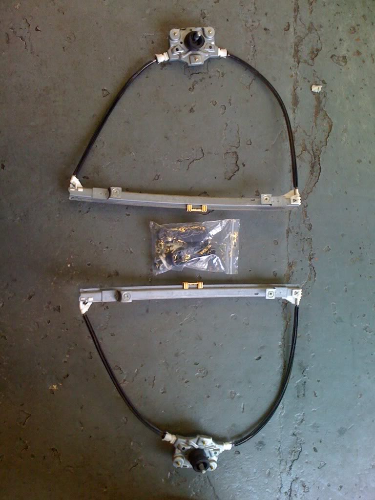

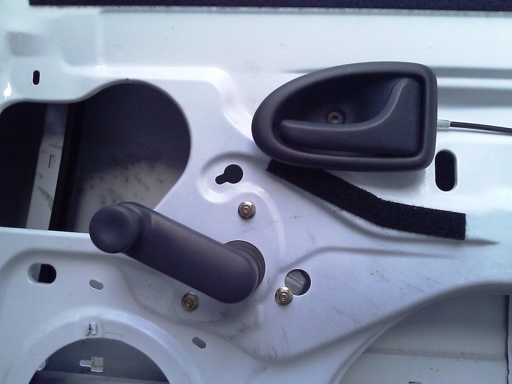

Manual winder mechanisms and handles

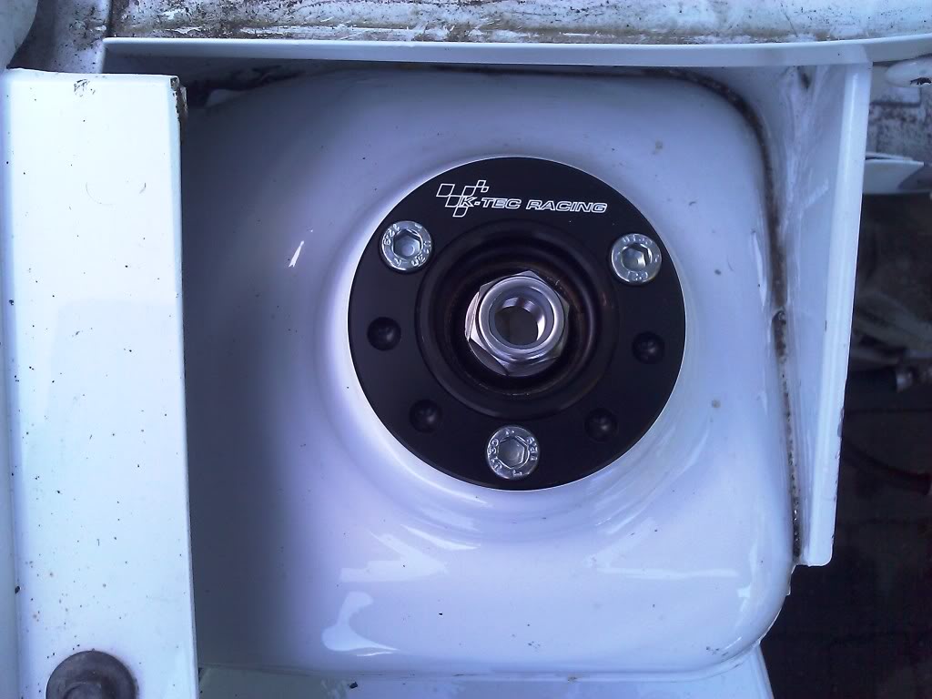

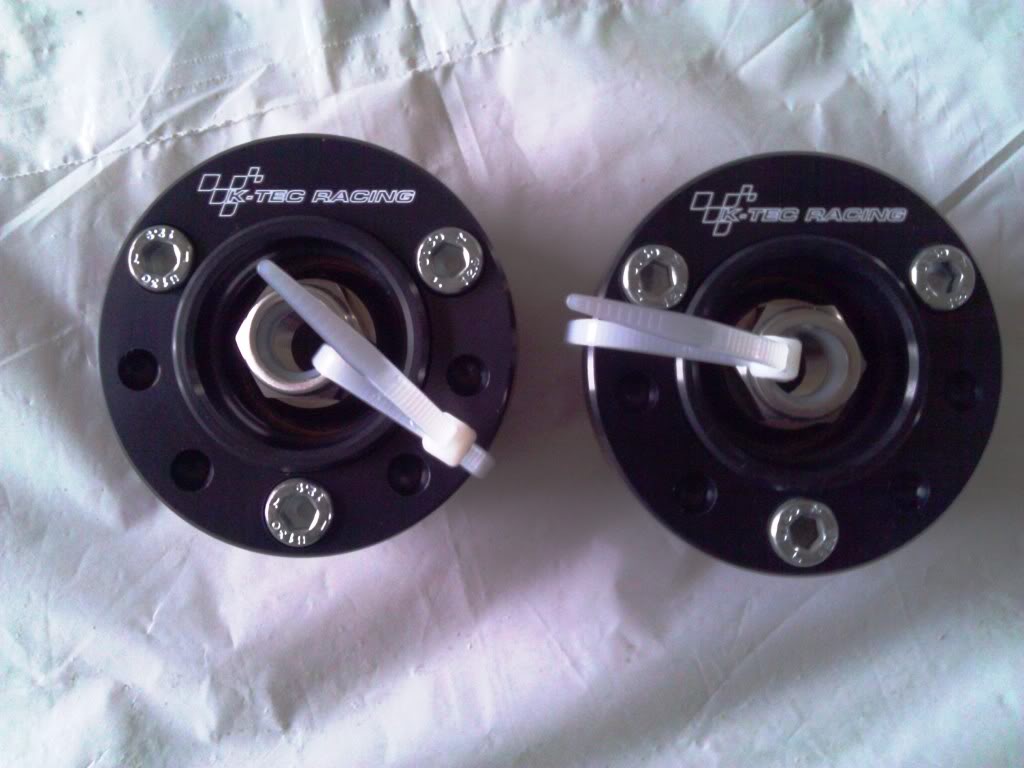

New solid top mounts

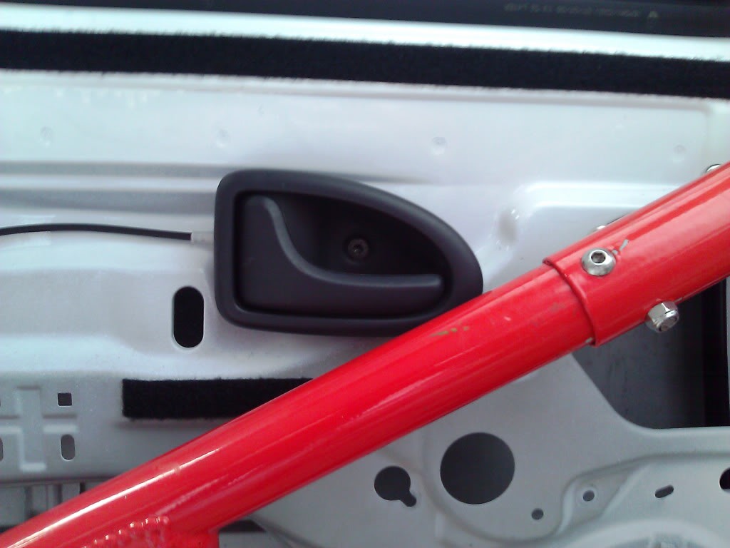

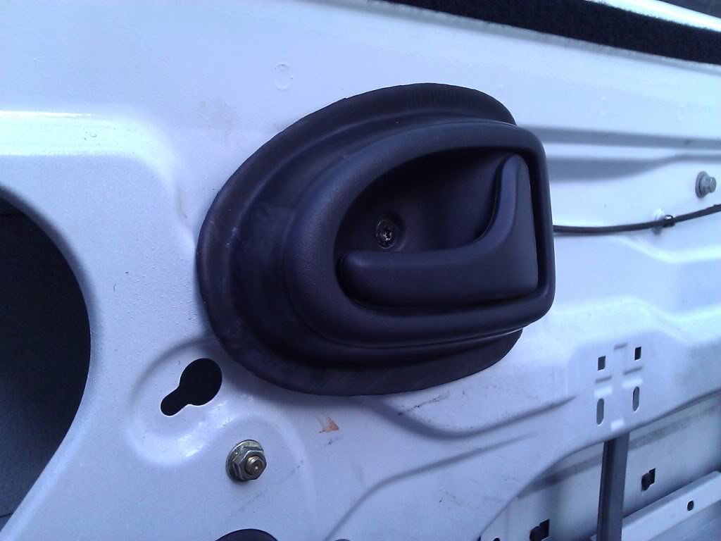

Interior door handles fitted, waiting for cup spacers

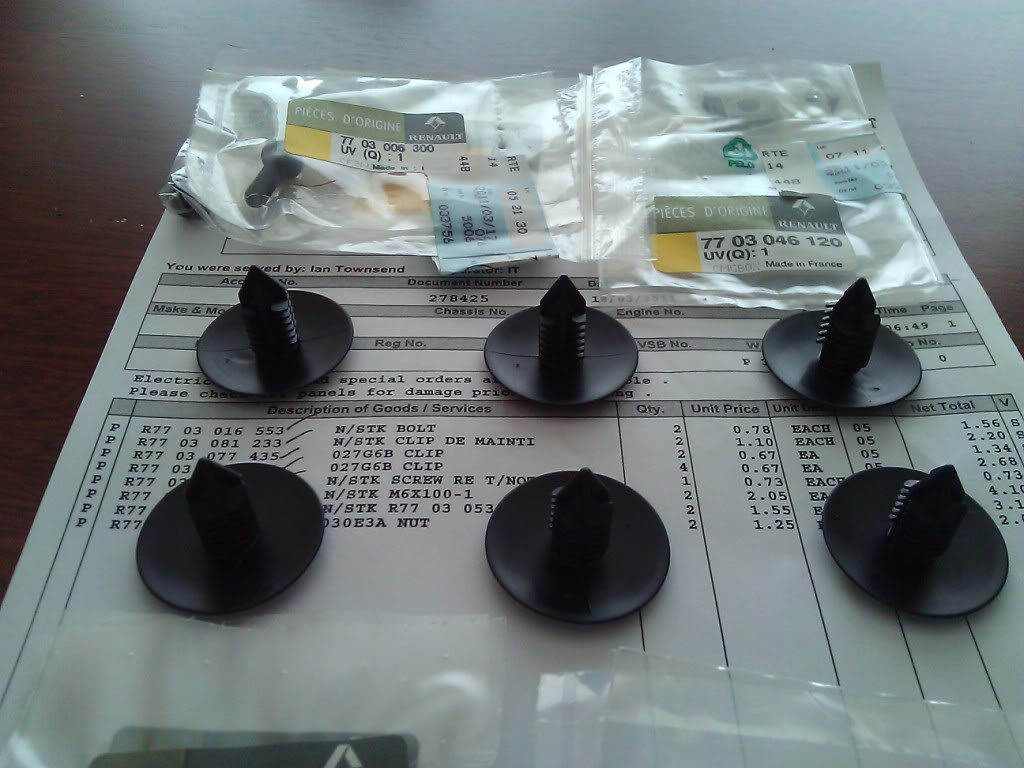

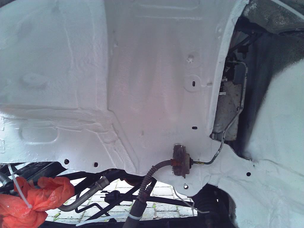

New front grill, bumper, inner arch fixings

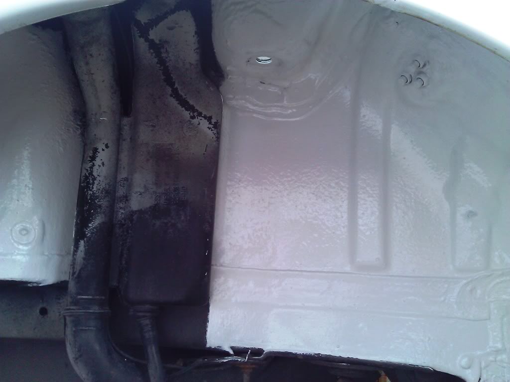

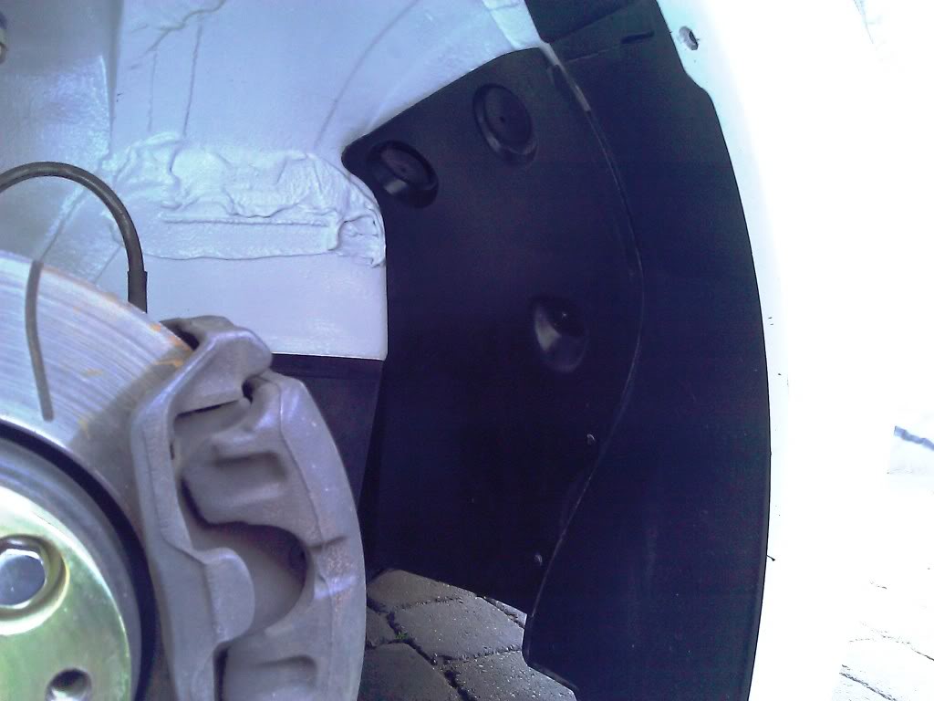

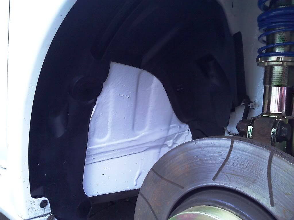

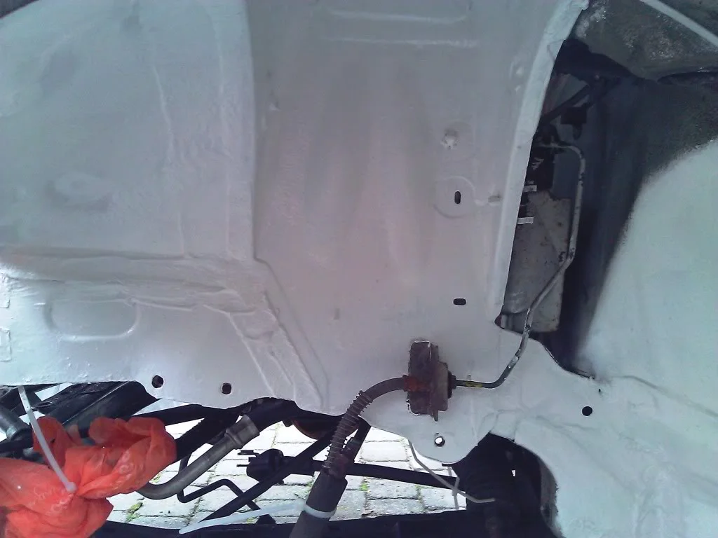

Smooth Hammerite inner arches

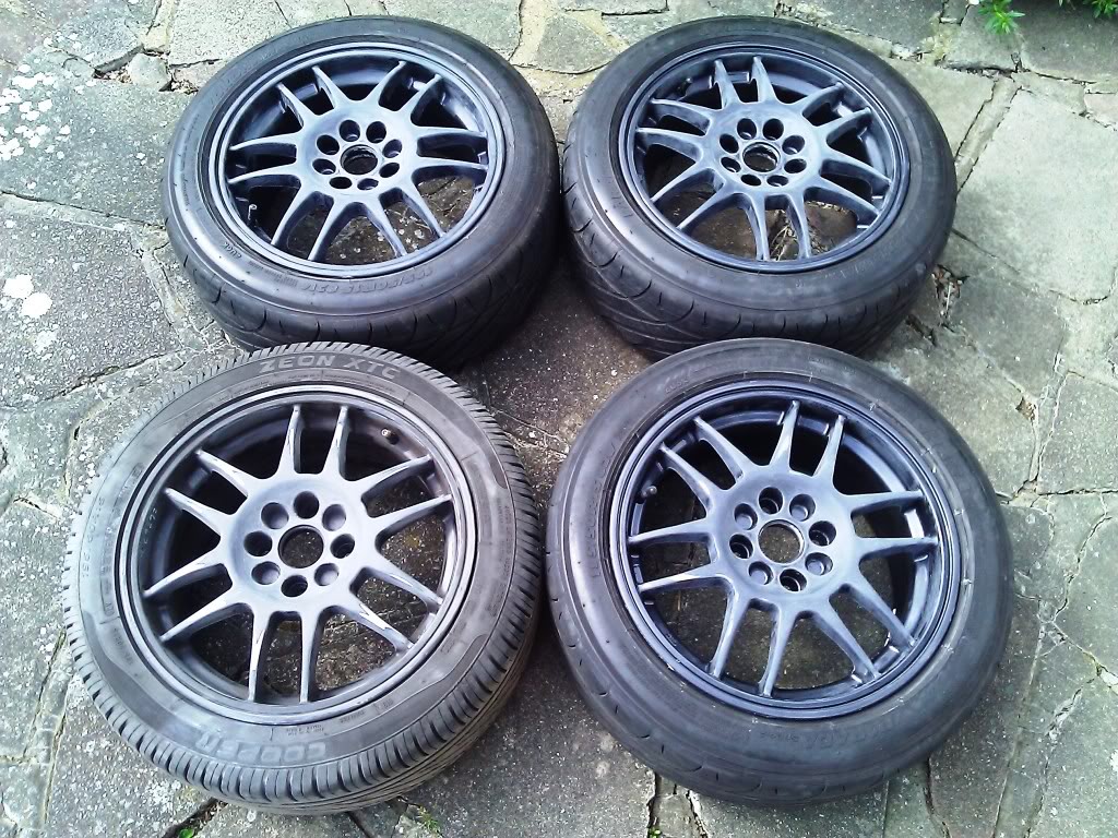

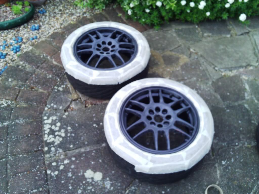

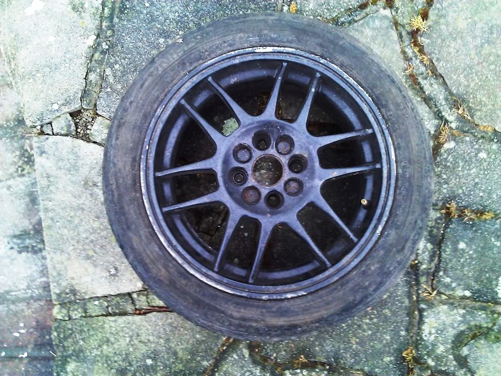

Mock up painted OZ F1 wheel on the Clio

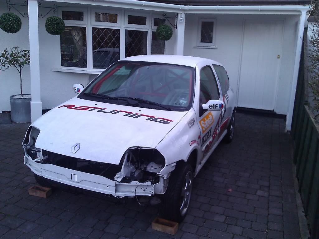

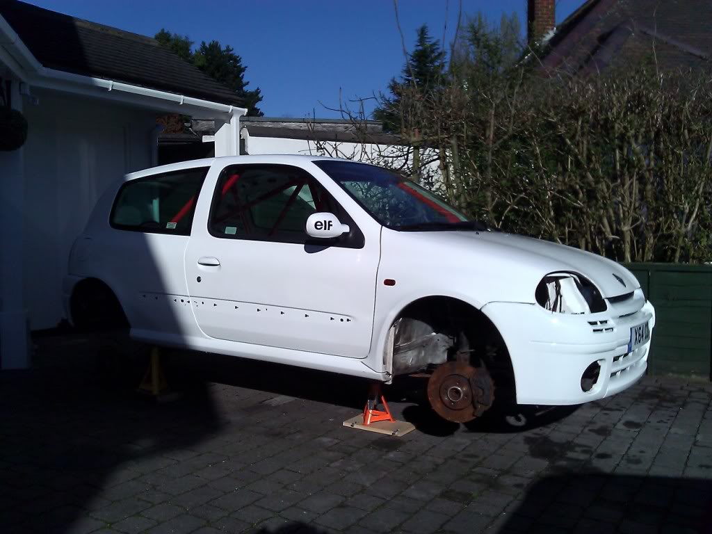

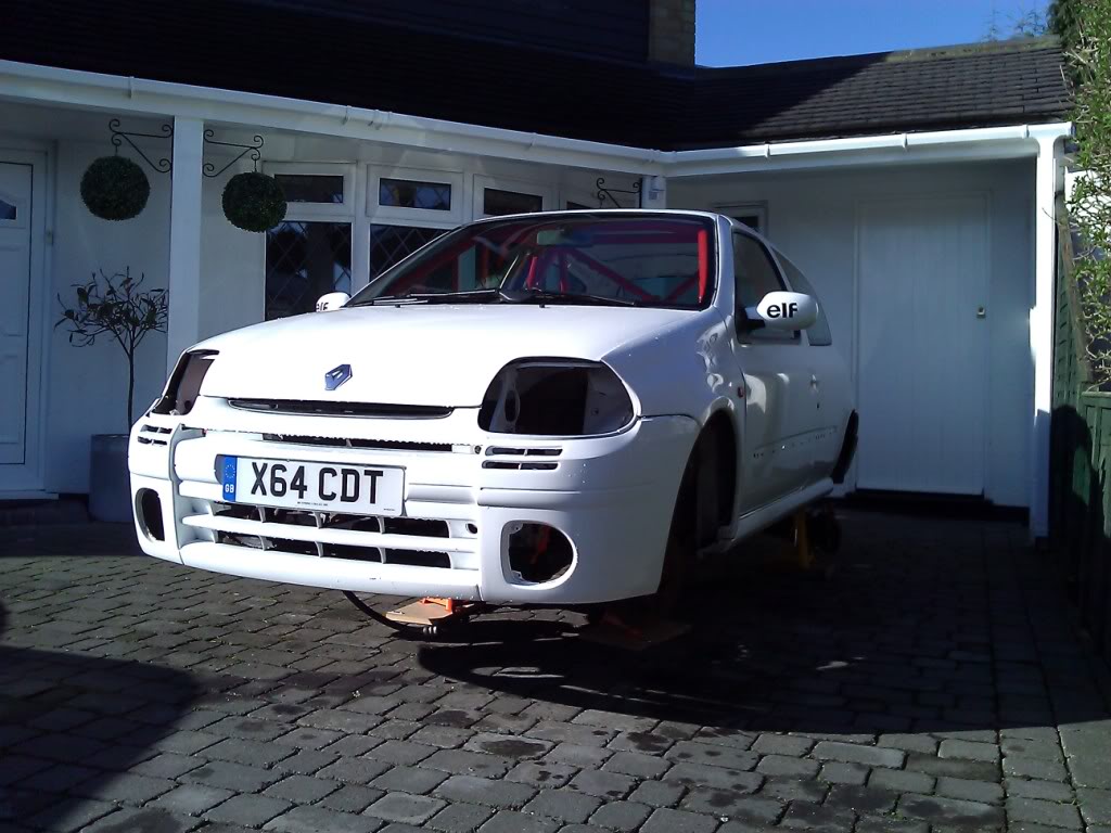

As it sits from last weekend
I'll be working on it tomorrow all day with a friend, the plan is to trim the interior loom right back to only what we'll need. Basically i'm getting the shell completely ready for when i fit the parts from the blue Clio

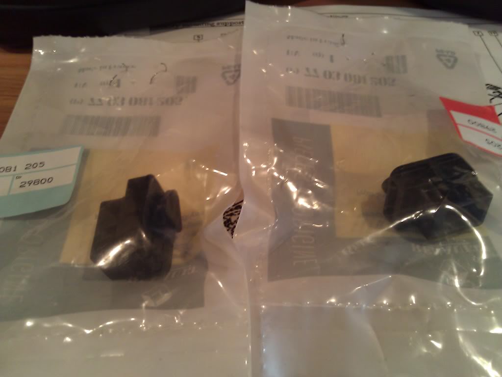

How much did the grill, bumper and inner arch fixings cost from renault?
Probably the cheapest thing you have bought but i need a few!

looks awesome, another good project thread...
you order the cup door handle spacers from r-sport?
i was told they were totally out of stock and not making anymore....
Thanks, been reading your project thread with great interest.
Regards door handle spacers i put my name down in the group buy on here. I believe he has a set and it making copies of them, it's the little parts that make the difference IMO :)
It all came to about £23 inc VAT, i still need more plastic round inner arch grommets but i'll take them off the blue Clio. I was going to order the lastic inner arches but nearly fainted! So back to the scrapyard

Had to buy another OZ alloy as i found out 1 of the painted alloys was badly buckled. I bough this from Cliospares in Doncaster

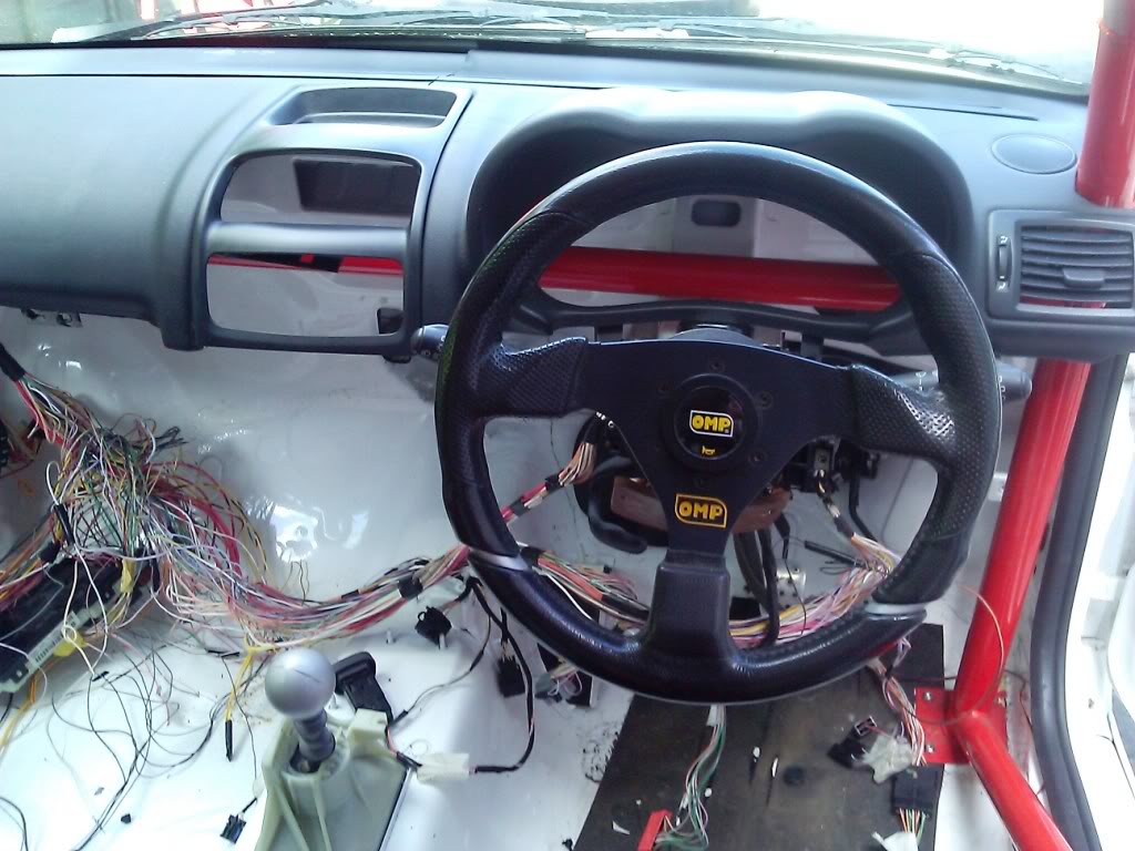

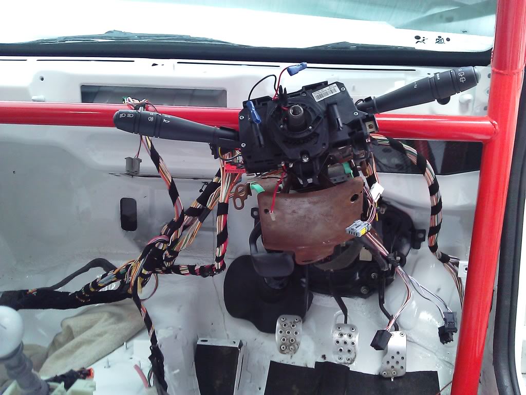

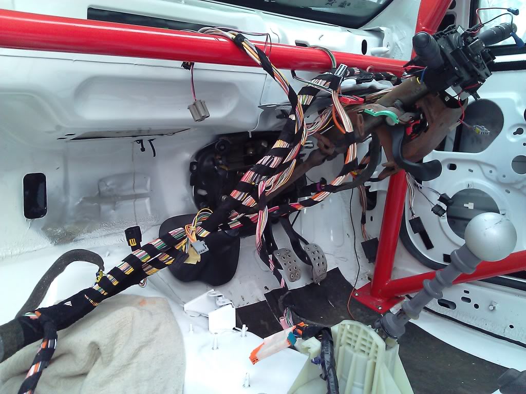

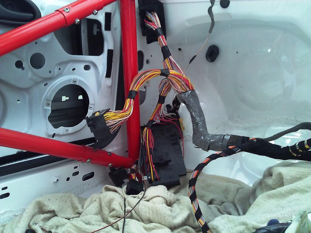

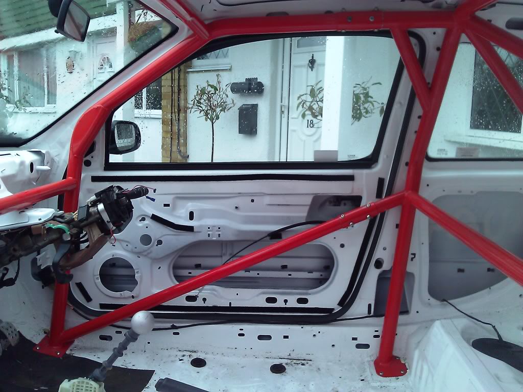

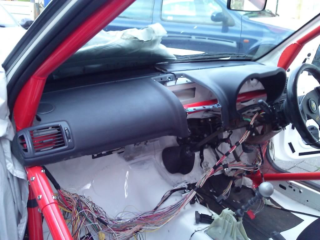

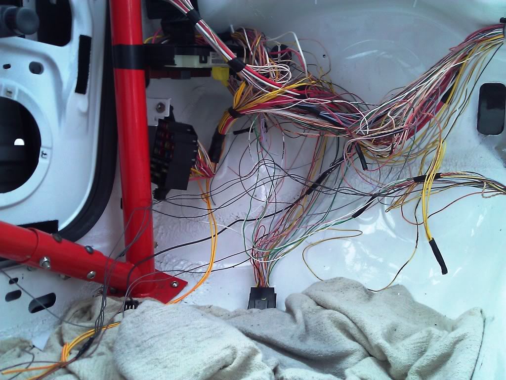

Trimmed the interior loom right back, airbag, stereo and speakers, central locking, electric windows, heater-AC, rear wiper and demister wires all gone. 12V supply, hazard swith and OBD port stays. Now thinking of putting a dash top in to hide most of the loom
Manual winder mechanisms fitted, ignition decoder and tailgate strut fitted too. 1 strut support isnt enough to take the weight so i'll buy another from the breakers

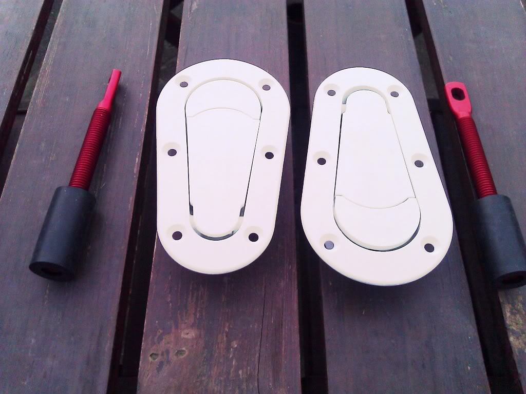

Aerocatch bonnet release in white

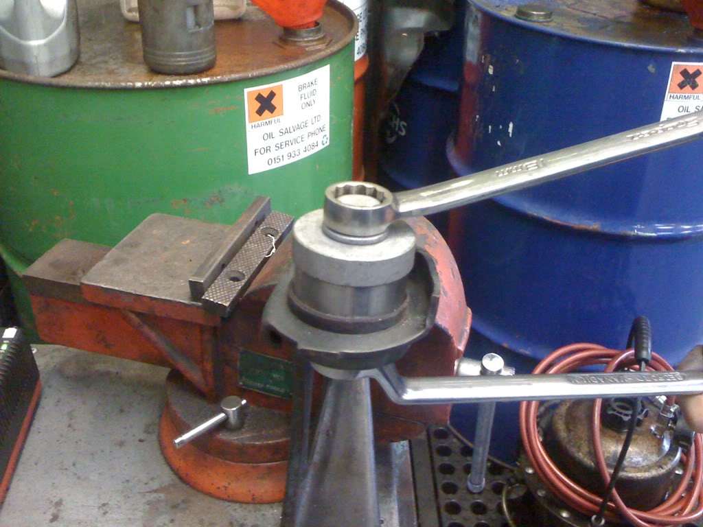

A friend of mine is fitting the polybushes to the wishbones and dogbone mount at work

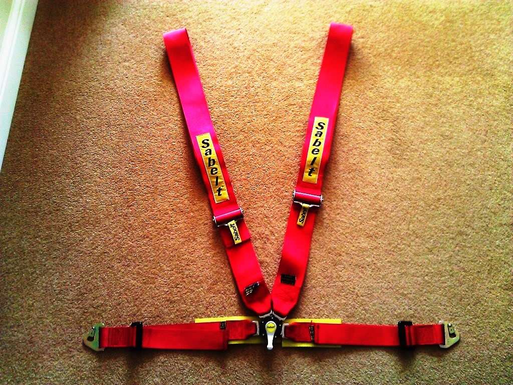

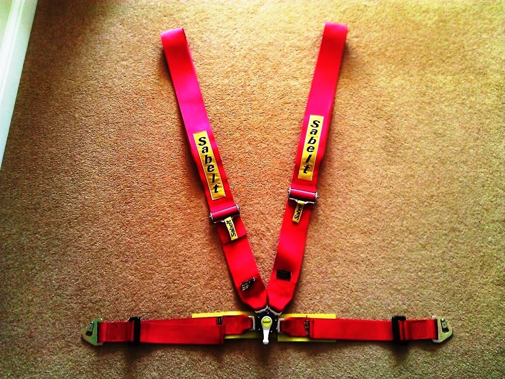

Sabelt 4 point harnesses

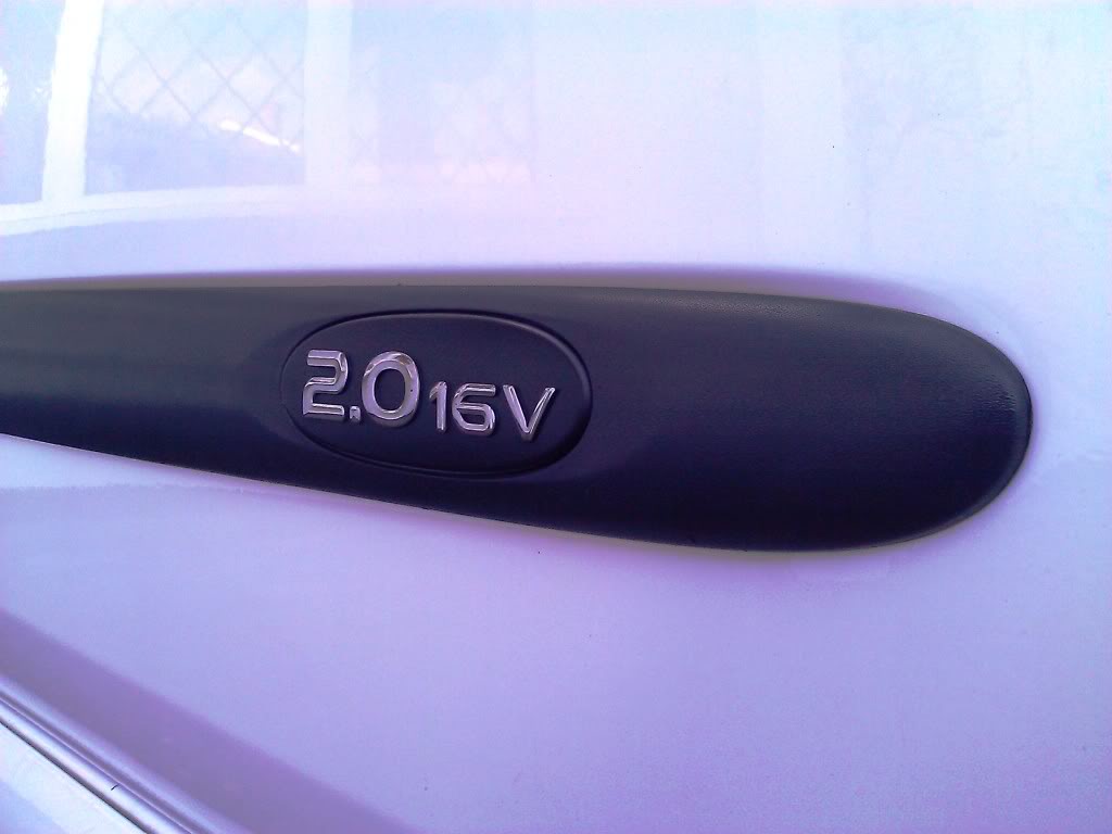

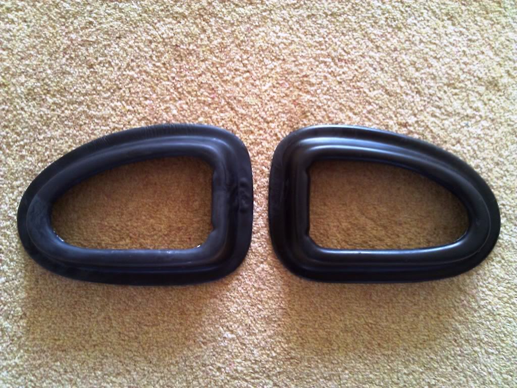

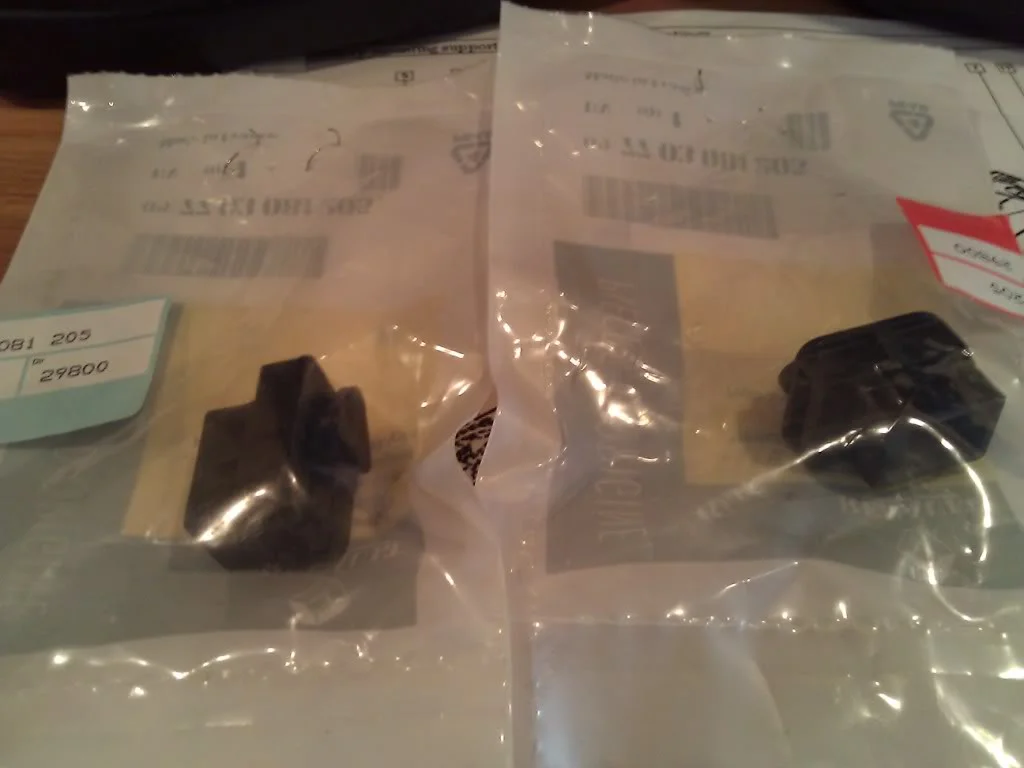

Clio door handle spacers

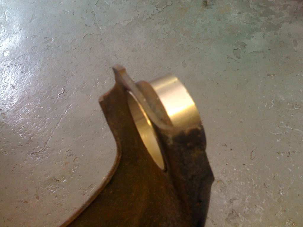

Nice track car, only just seen this thread, do you know you have to tack the metal wishbone sleves to the wishbones or they will cut the subframe!

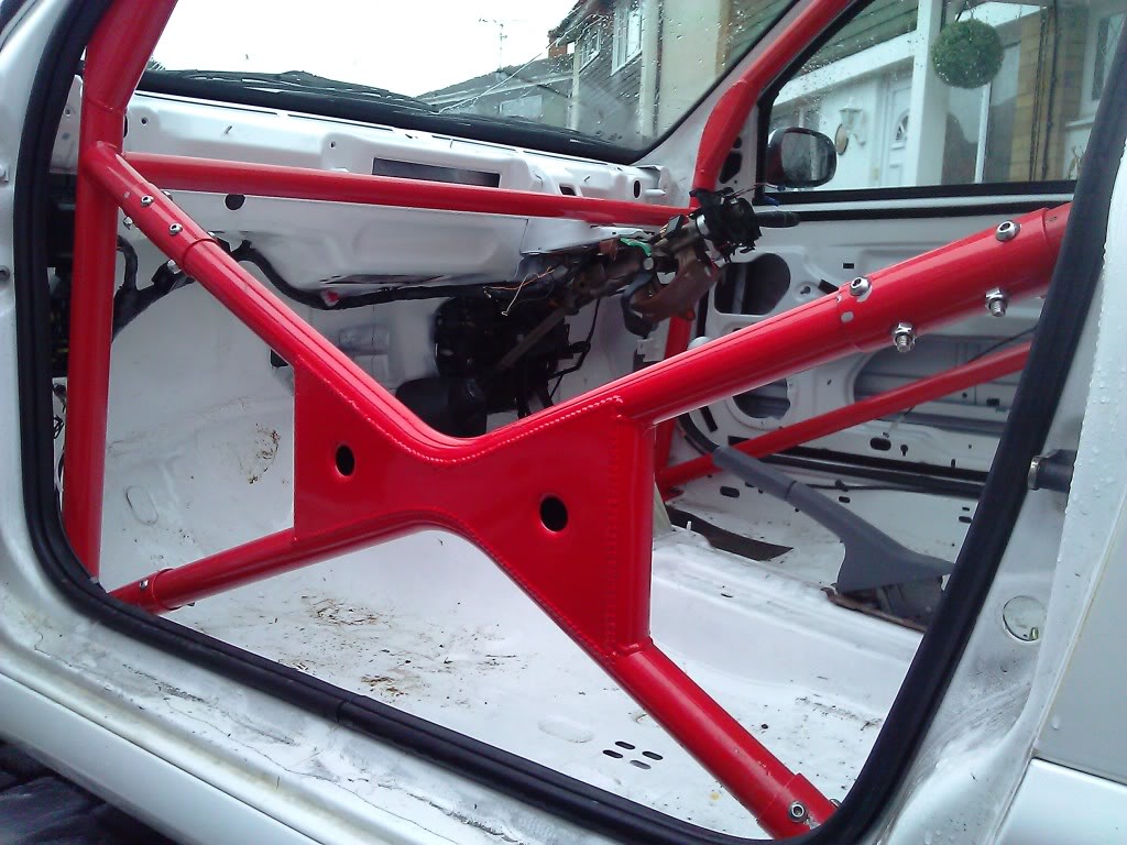

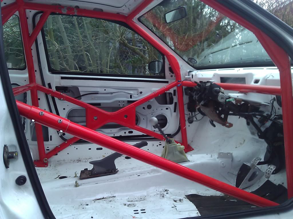

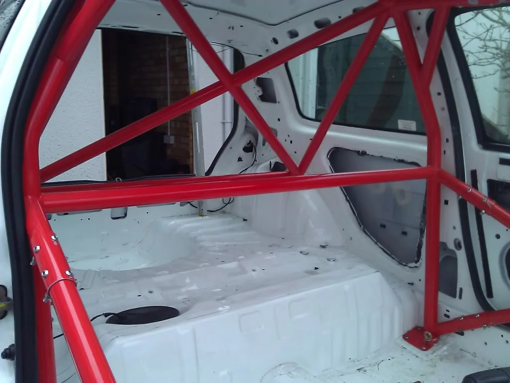

Now that is one sexy looking cage lol
Whole car looks great so far mate keep up the good work will keep my eye on your progress :approve:

Sleeves were tacked in after that pic

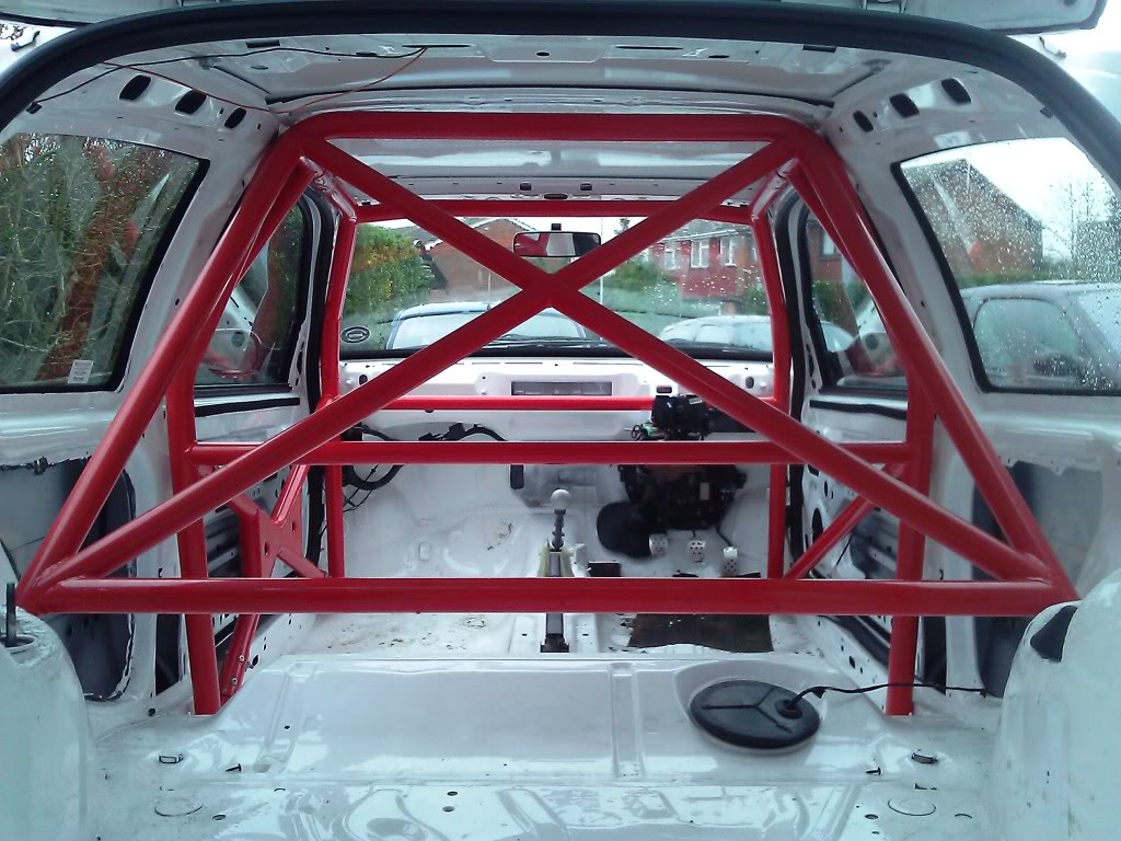

A few bits been done since the last update so here we are with pics
Shell is cleaned, the blue Clio is off the road, SORN so time to take exterior parts of the blue and ontohe white

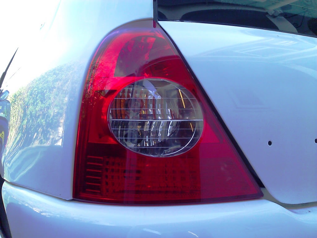

Phase 2 rear lights

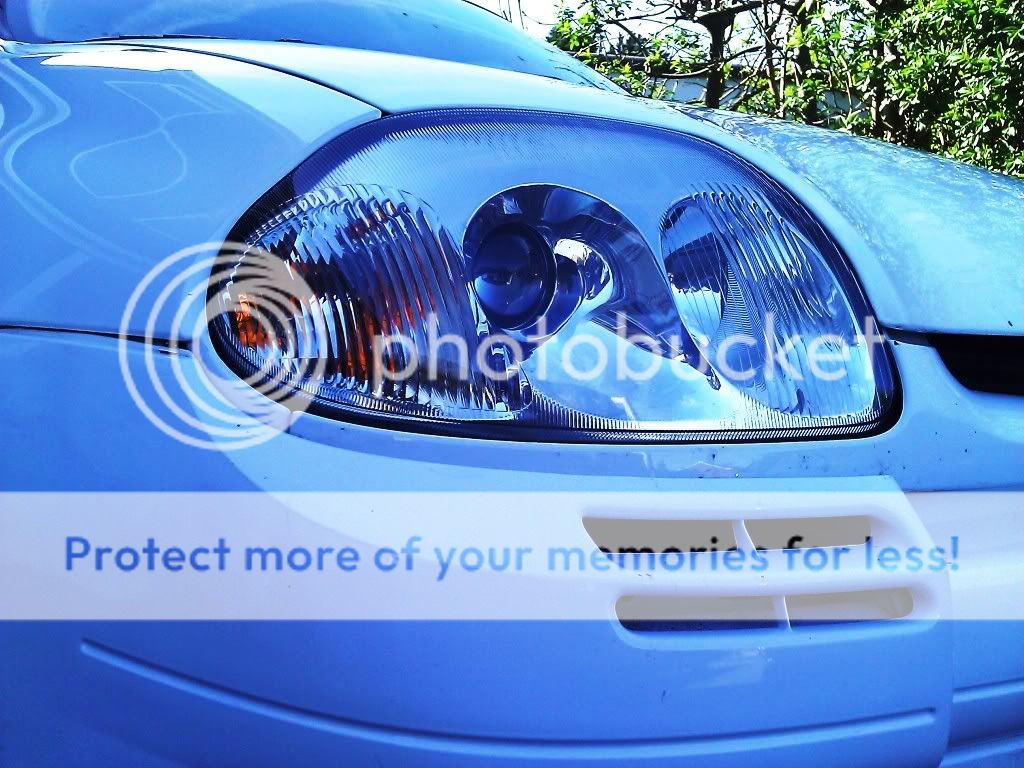

Headlight
Cup racer replica door handle spacers

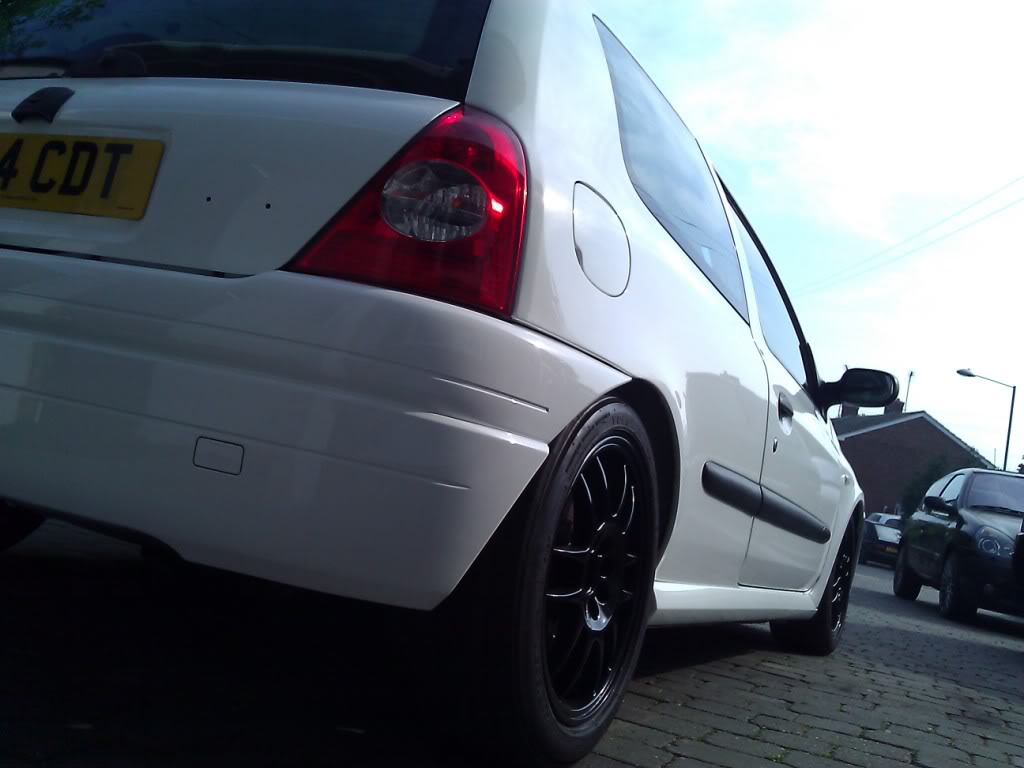

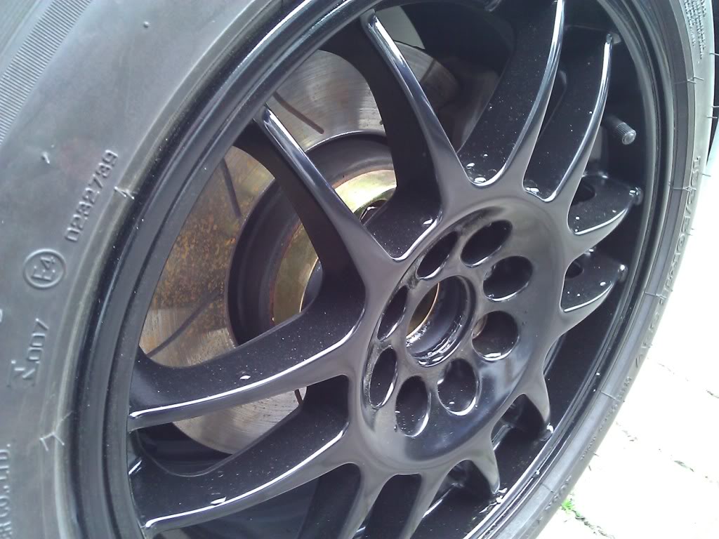

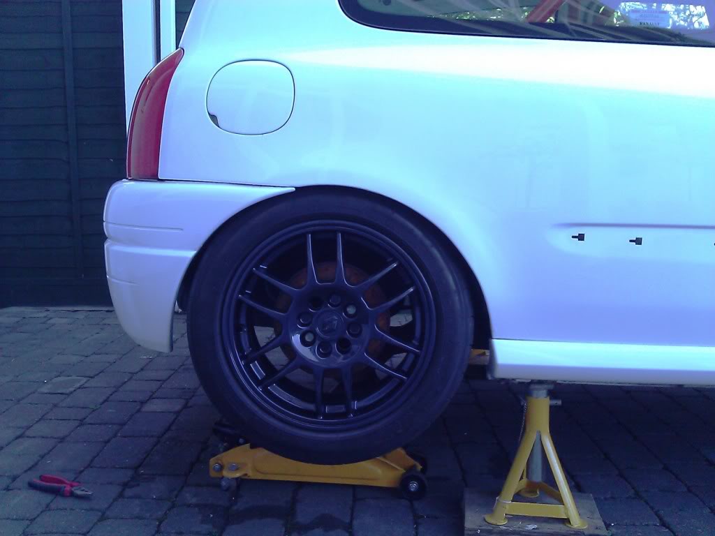

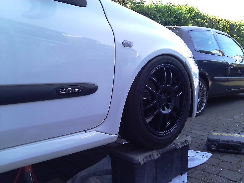

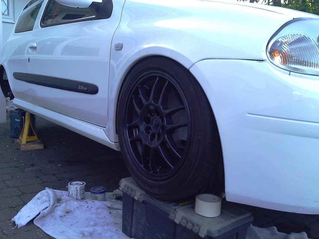

Front wheel mock up to see how the painted wheel looks
K Tec solid top mounts fitted to the turrets

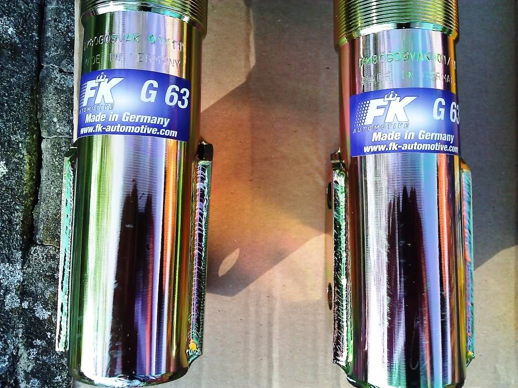

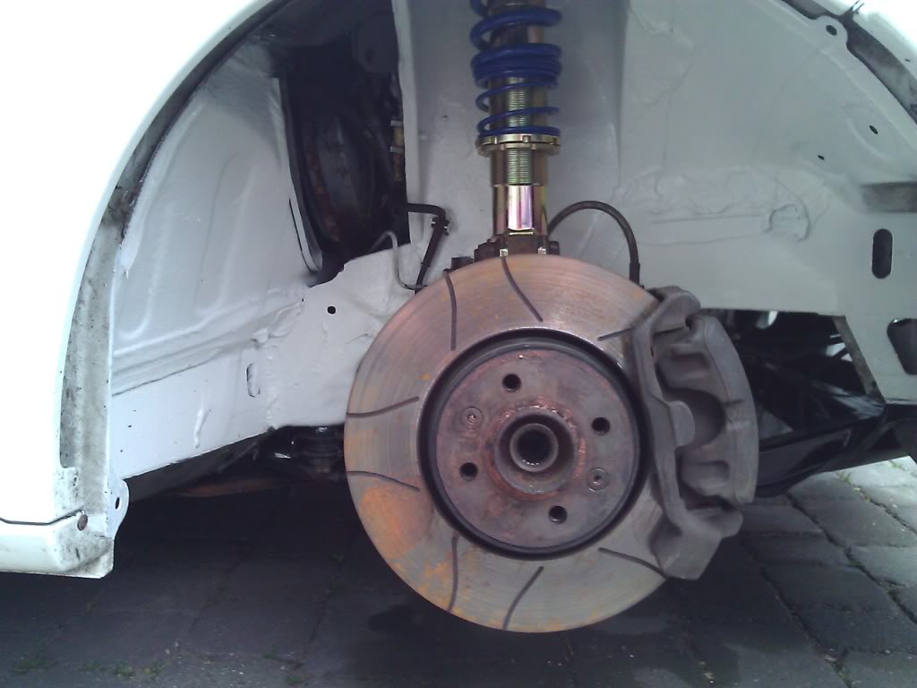

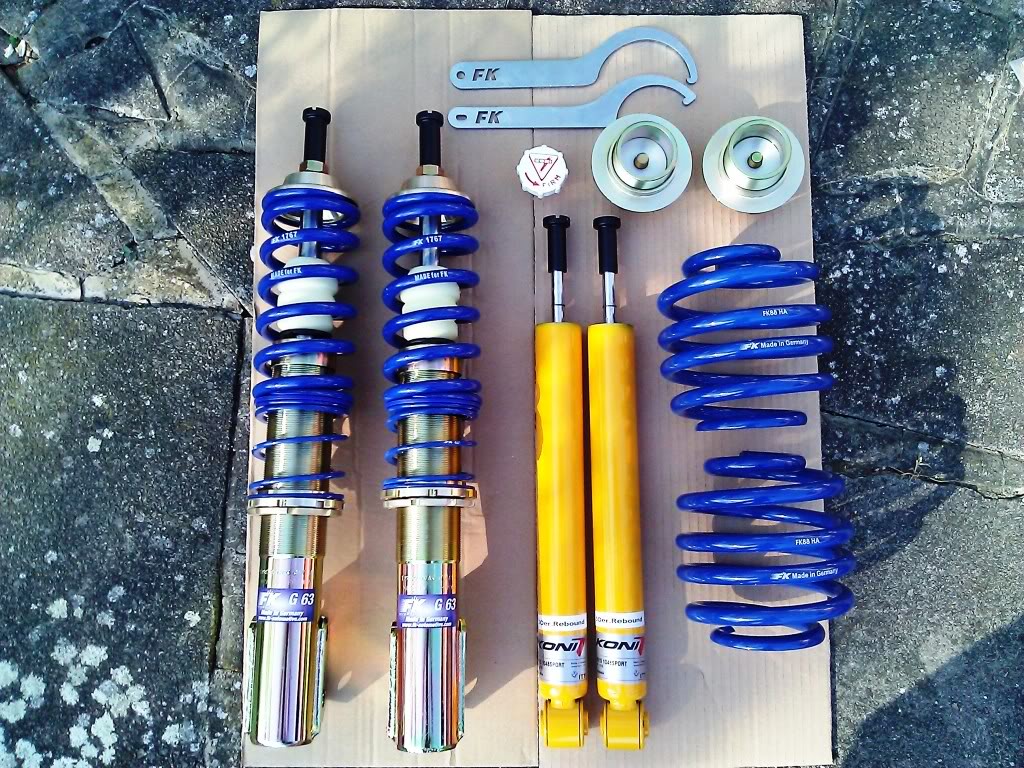

K Tec coilover kit and white Speedline 2118 wheels sold to purchase the FK Konigsport coilover kit

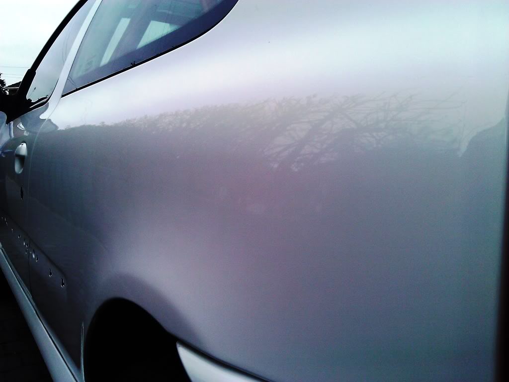

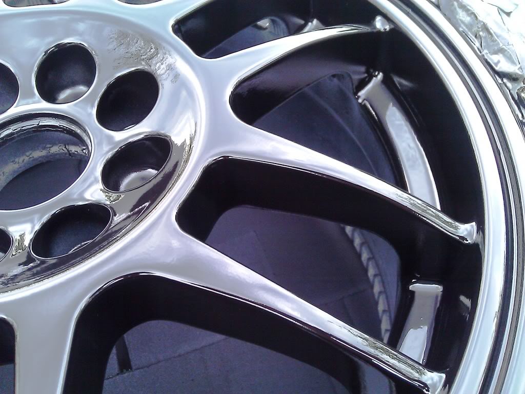

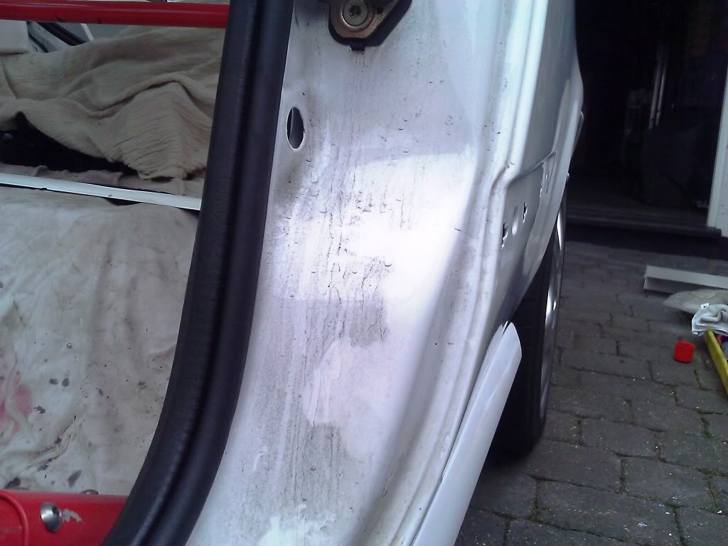

Wasn't happy with the finish on the mettalic grey so i decide to sand back down and paint again.... In a different colour, gloss black

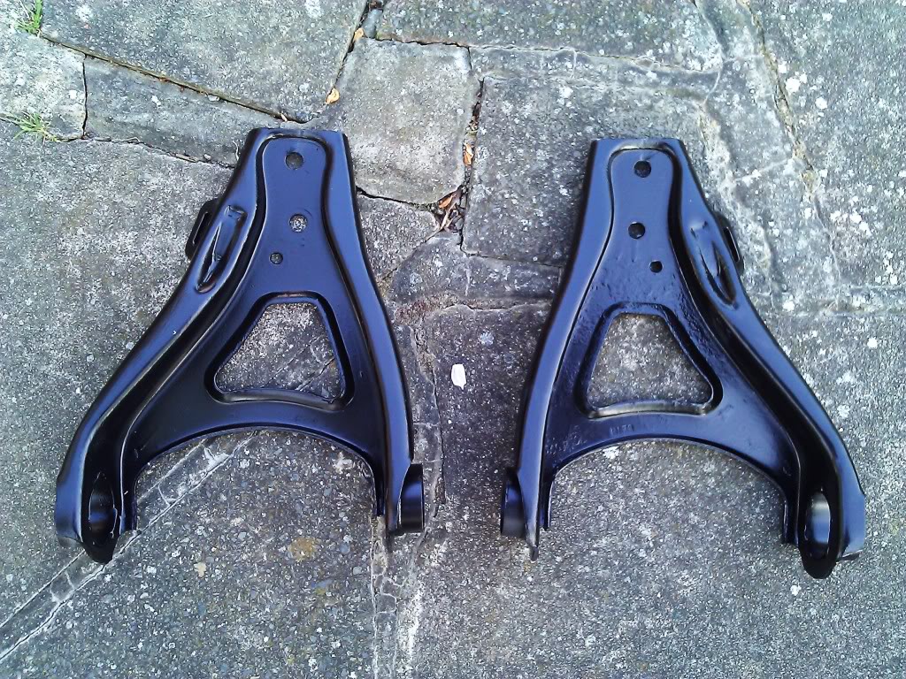

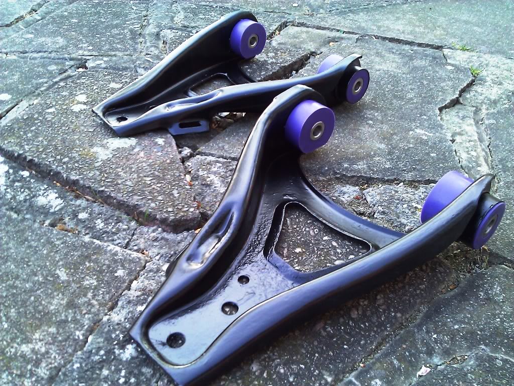

Wishbones are sprayed in Hamerite satin black

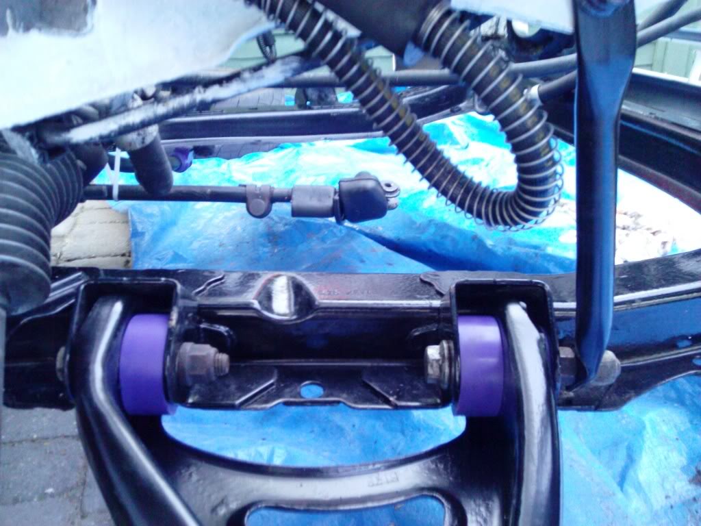

Polybushes pressed back in
Wishbones fitted back onto degreased and cleaned subframe

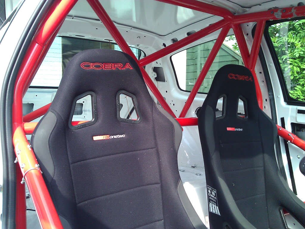

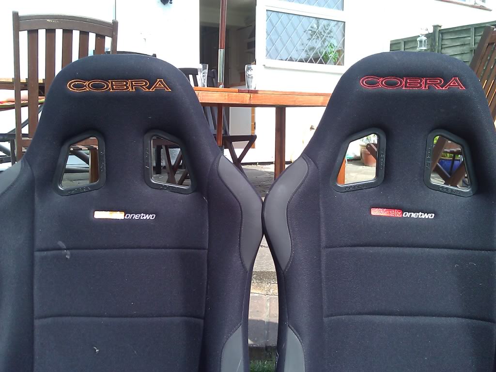

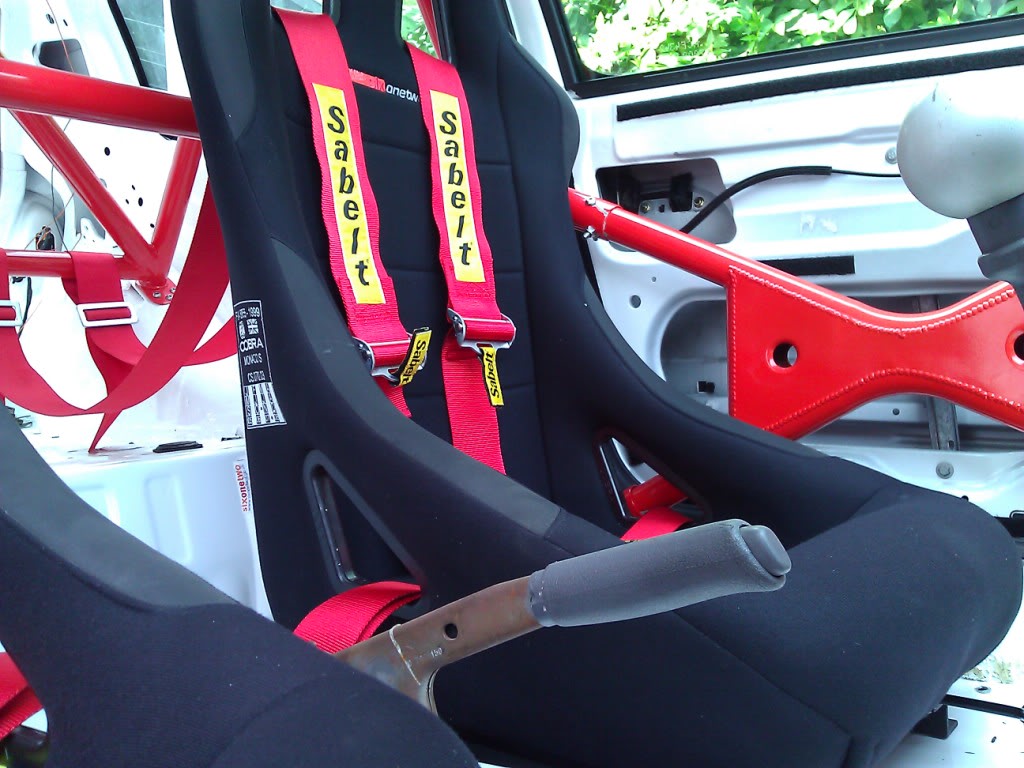

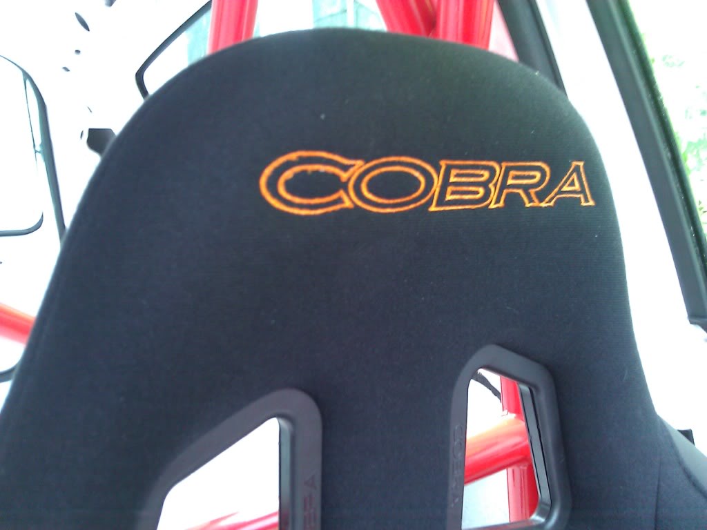

I have Cobra Monaco S seats and although the stiching colour went ok in the blue Clio it woldnt look right in the white and red of the cage.
10 mins later and the missus has changed the stiching colour

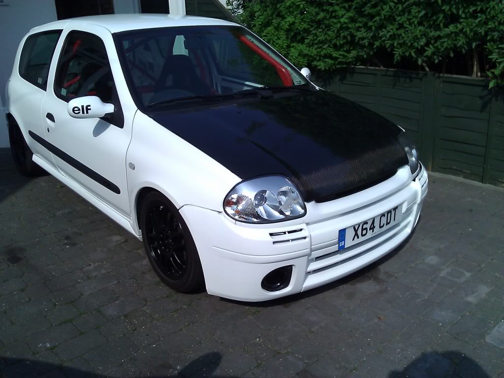

The carbon bonnet is fitted
How it sits, wihout the engine in yet

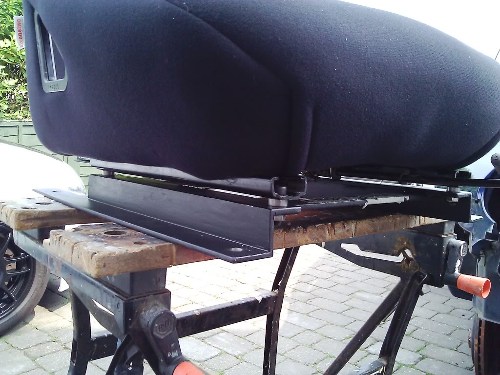

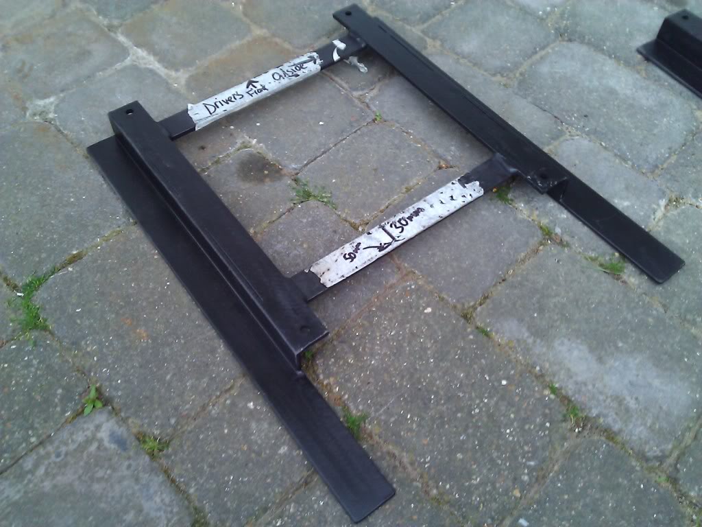

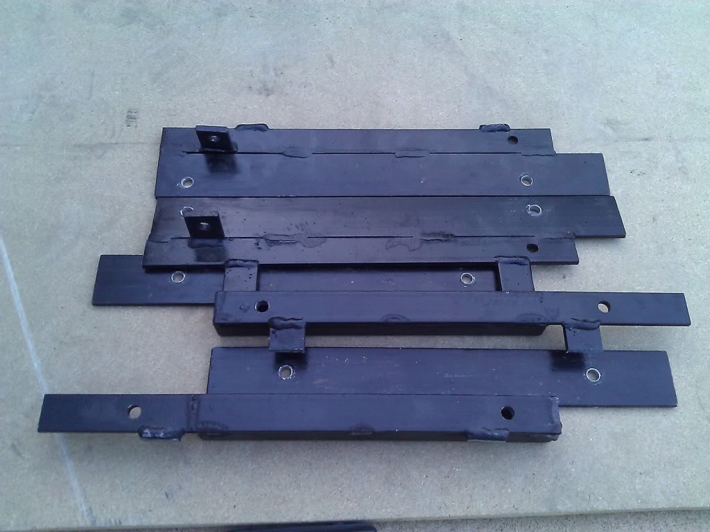

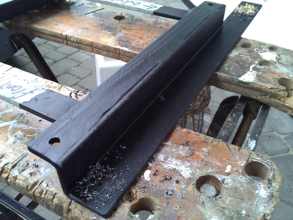

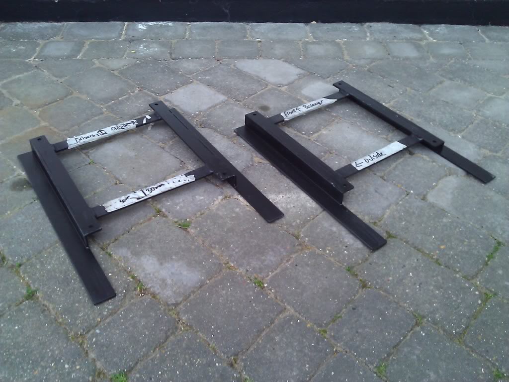

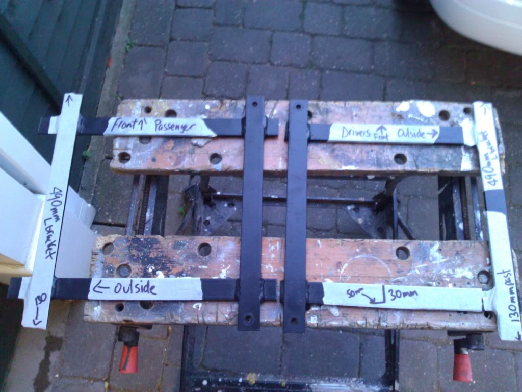

I had to modify the seat subframes to utilise the oe mounting points in the blue Clio as the subfames were for a Fiat Bravo. What i realised in the white shell is the floorpan is different to acommodate bucket seat sidemounts. So the seat subframs i modified now have to be changed again.
7.8kgs of excess metal cut off the seat subframes
Subframes measured and marked up ready to be fabricated
Subframes back from fab work
Holes drilled ready for bolts

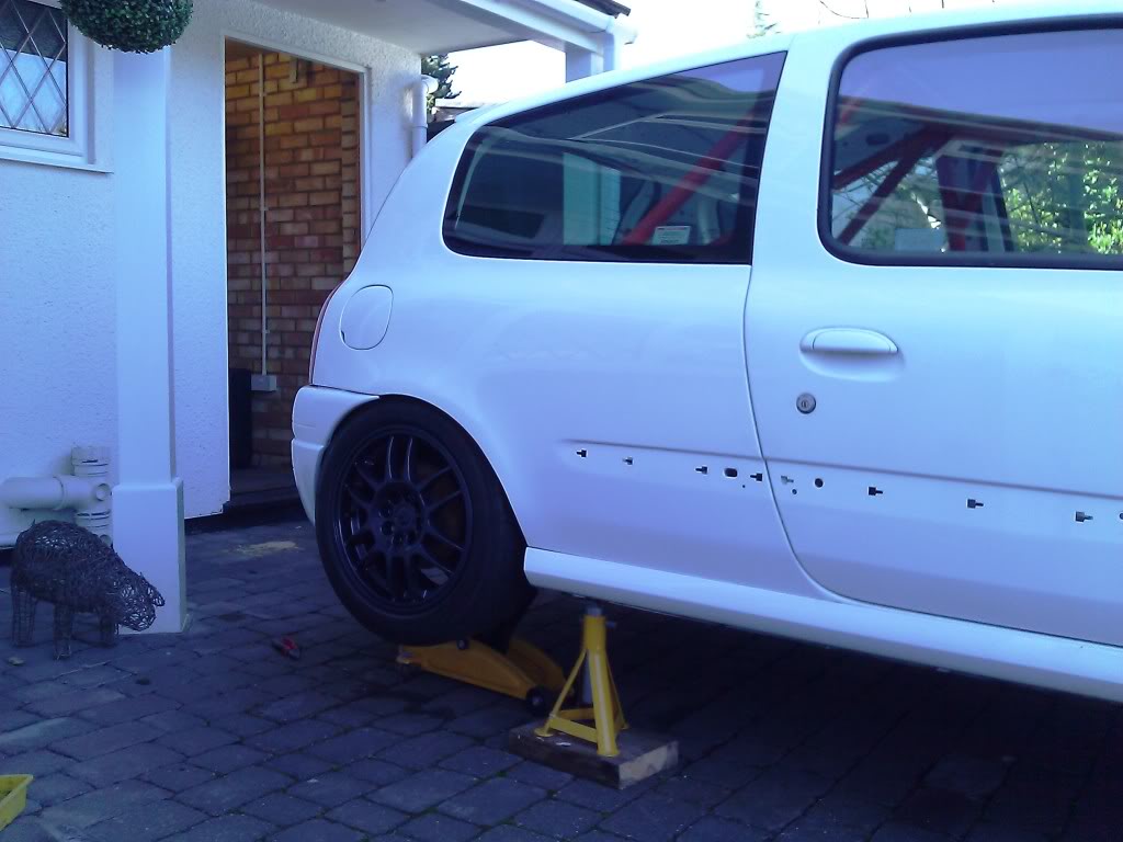

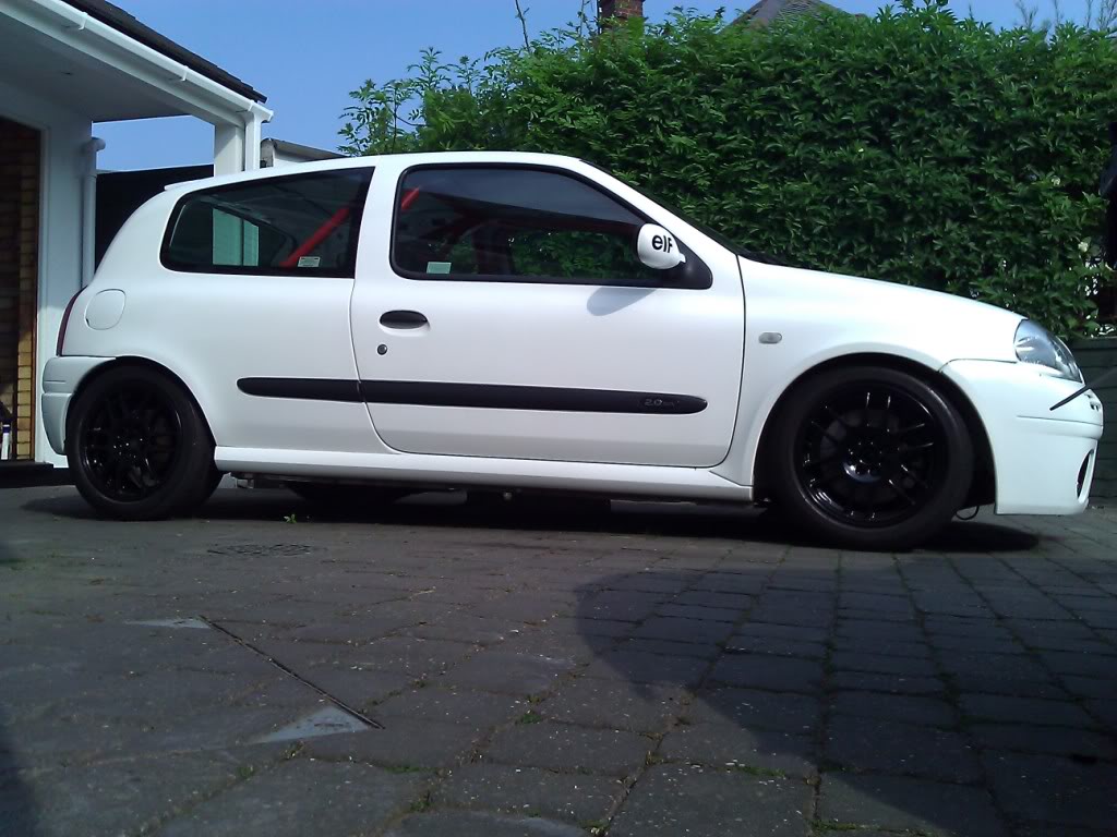

FK coilovers, wheel back off to fit the 25mm spacers
25mm spacers fitted, also showing the negative camber potential

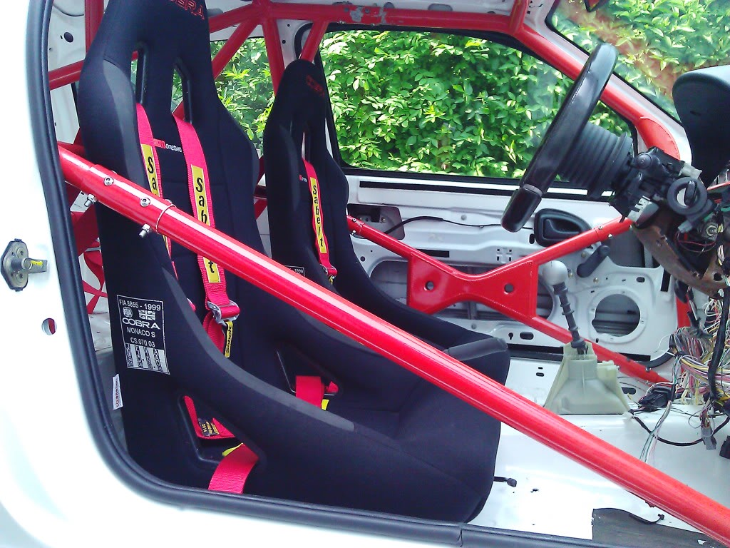

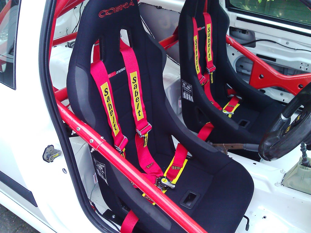

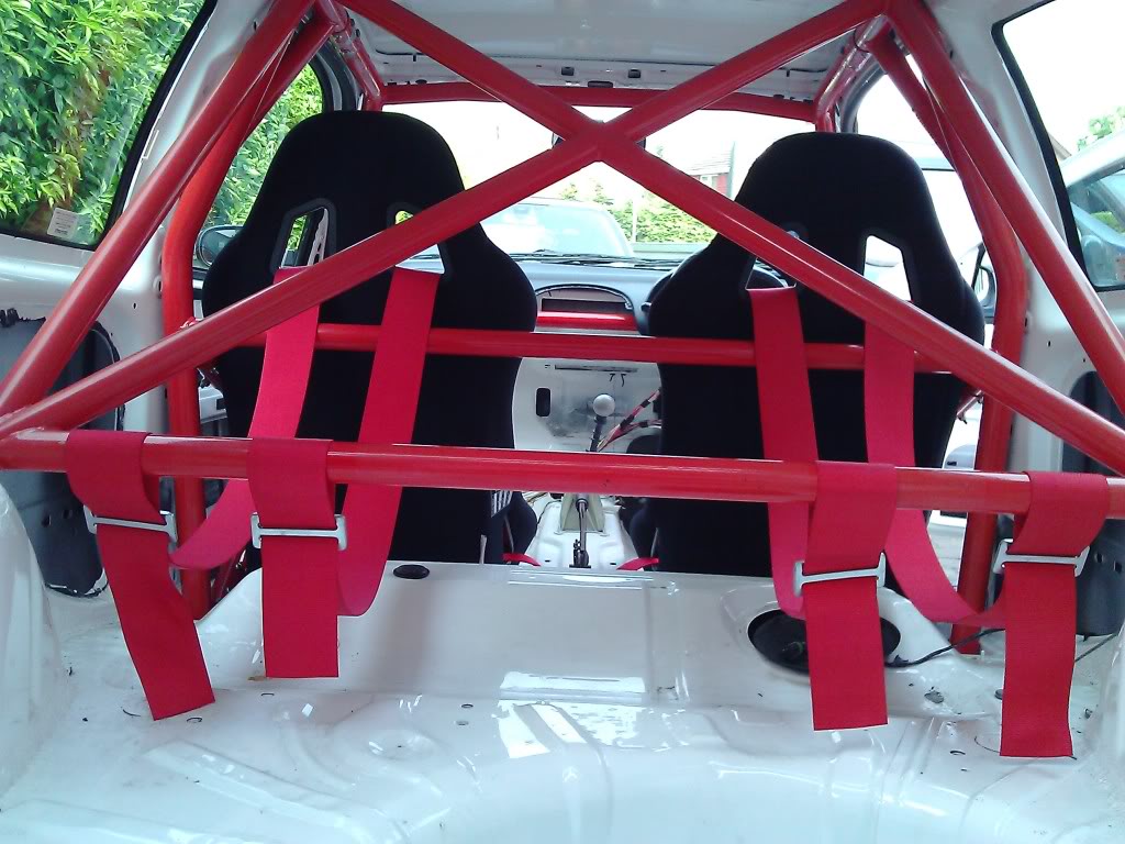

So, with Wills and Kate tying the knot this gives me the day off to put a bit more in. Time to get those seats in.
Subframes bolted to the seats

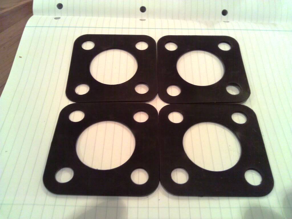

25mm spacers
Seats now in, Sabelt harnesses in place, also fitted the OMP steering wheel too

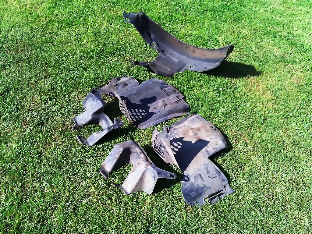

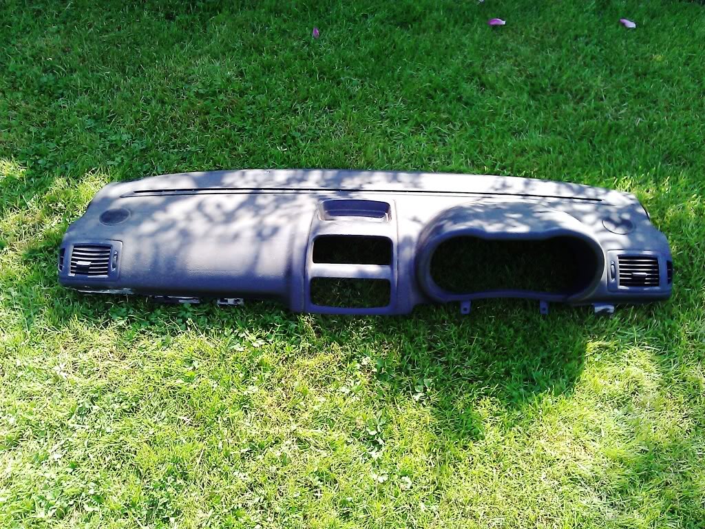

Popped down to our local scrapyard Saturday for a few bits and pieces, on the lookout for a cigarette lighter 12V feed and a dashtop from a later Mk2 Clio (02-05). While i was there i spotted a silver 172 so i took some plastic parts from the inner arches.
Mk2 dashtop
Plastic arch liners, also note plastic parts that go over the driveshafts
Gave all the plastics and dashtop a good scrub then used Auto Glym bumper care to revitalise them back to a nice black

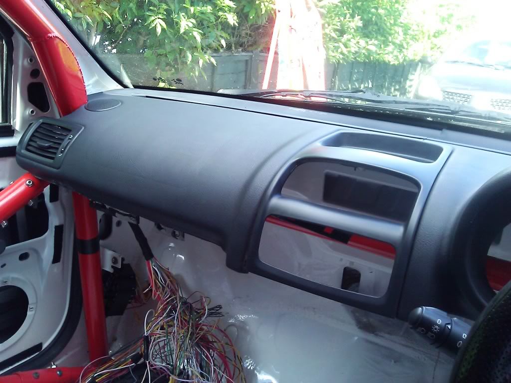

Started on the dashtop last night, i had a phs 1 dashtop in place but 1: I didn't like the blue 2: Cut it badly each end just to get it in to see what it looks like 3: Prefer the Mk2 as the centre part is in place and will be used to house the 12V feed, hazard switch.
The phs 1 dash in the centre was missing and just looked wrong, i prefer the look of the later dash. The plan this time was to cut the dash in half strategically where the plastic inner vents are joined, so the cut line is in line with the vents. It's the only way i can get the dash in to scribe each end around the rollcage. Luckily with the later dash the plastic centre bit takes up most of the centre part of the dash so there's not much of the cut line showing.

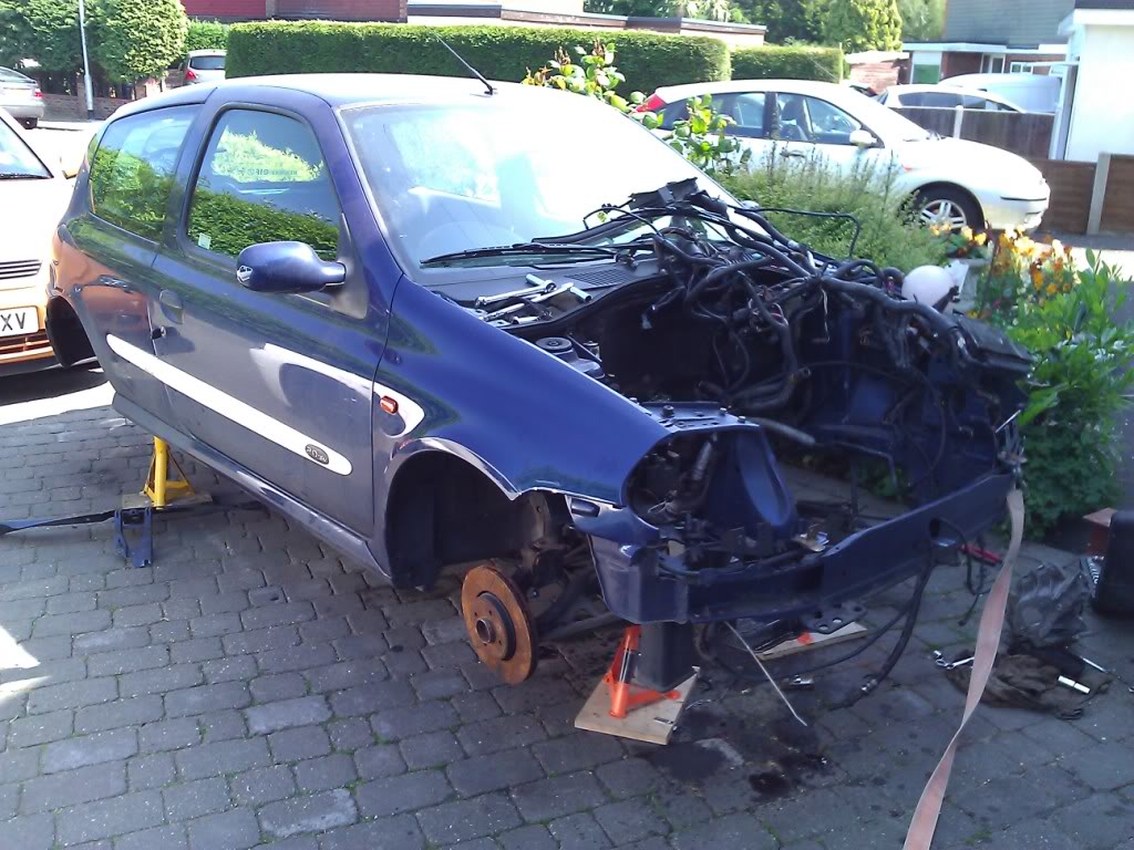

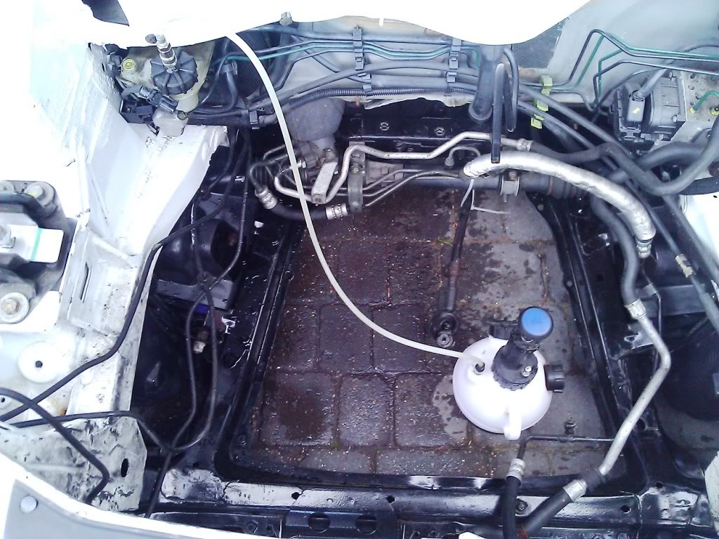

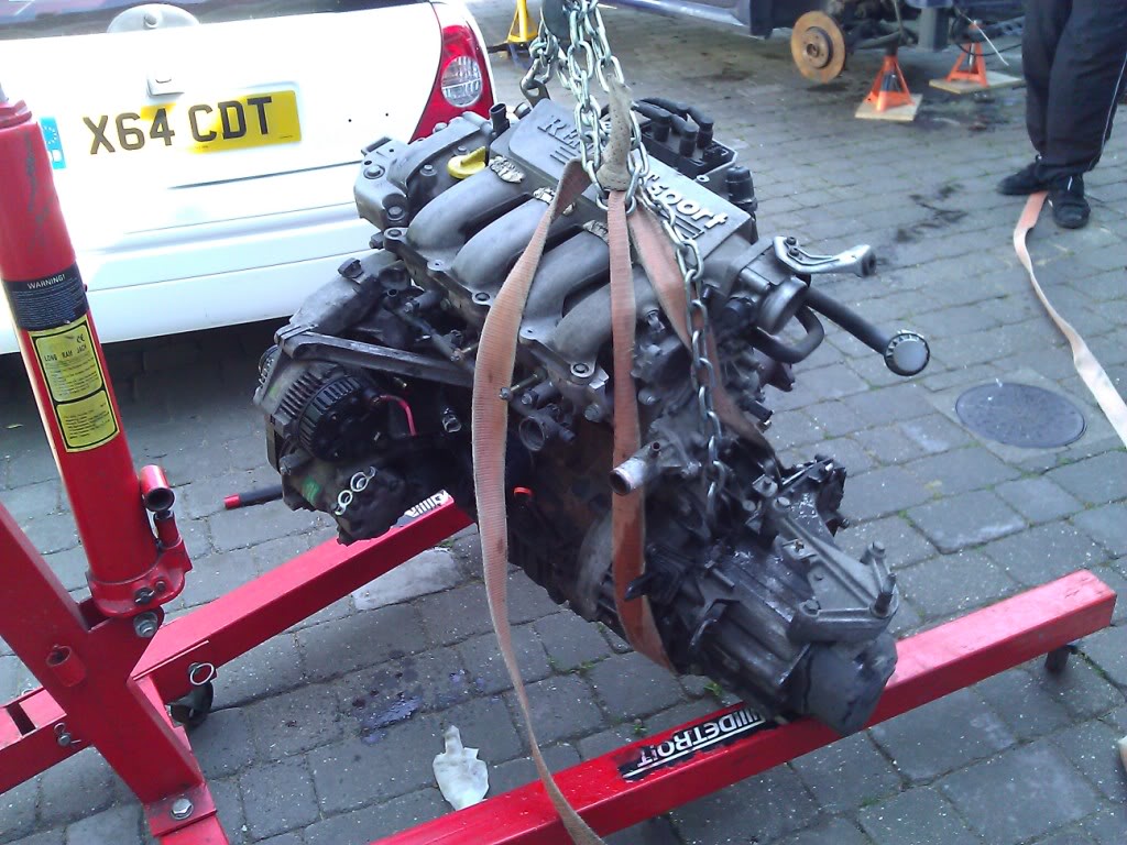

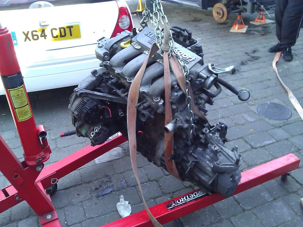

A big thanks today to my mate Rich and my brother for popping round to help lift the 172 lump out of the blue Clio. Now it's out it gives me the chance to swap the inlets over, give it a clean and degrease, and to also have the cambelt and other belt changed
This week i'll put bits back on the blue Clio to get it to a rolling shell then it can go, i'll work on the dash centre to blank off the openings to house the hazard switch and 12V feed. I'm looking into using a digital dash so the OE part of the clocks will be blanked off.

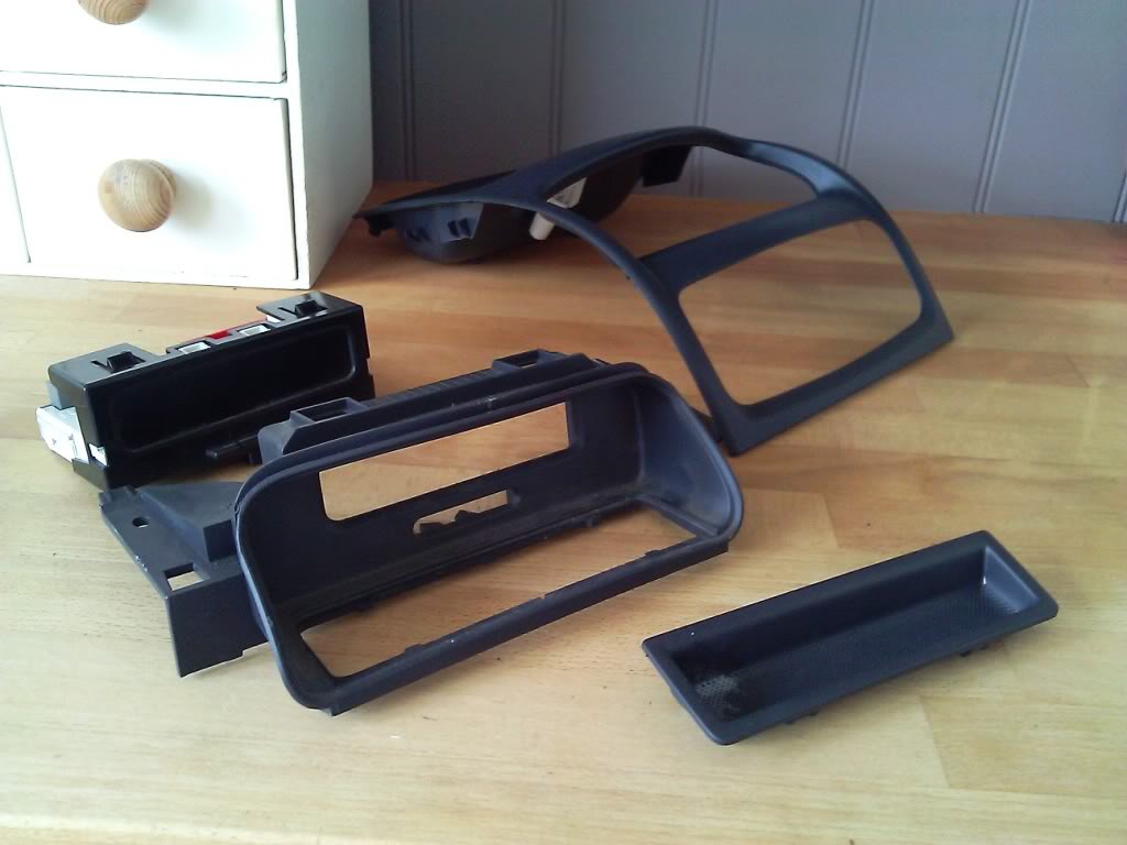

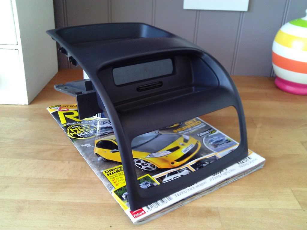

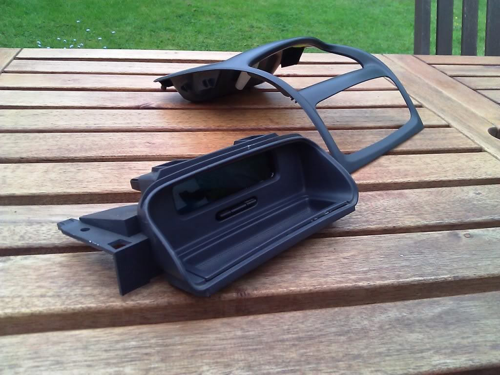

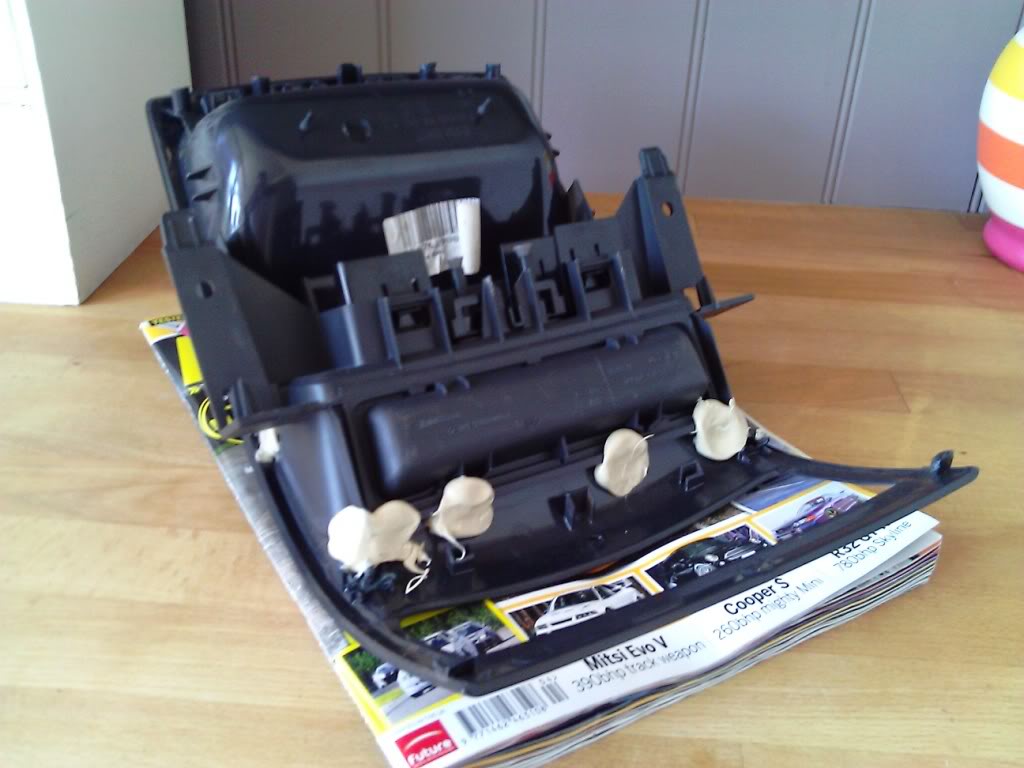

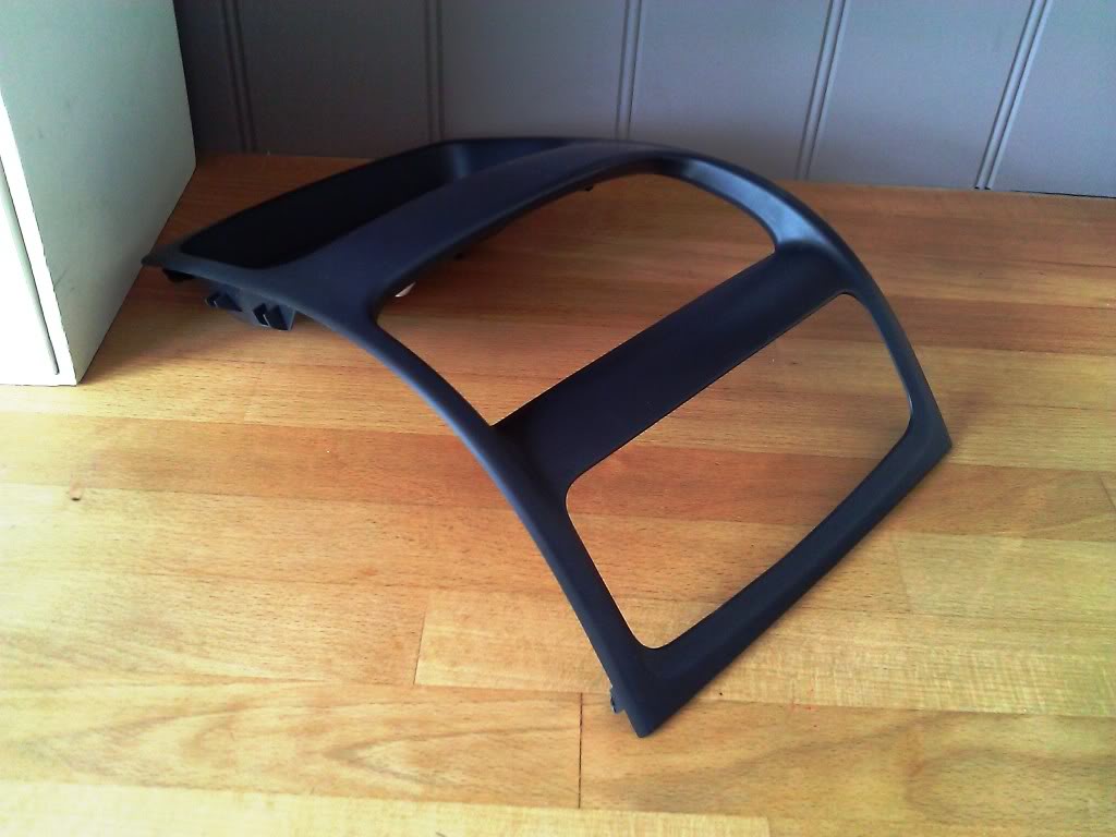

So, the weekend just gone. Nothing big but to me i wanted to do this. The centre section of the dash houses the digital display, as its missing and i hate having the void there i decided to head to the scrappers to buy 1 just to fill it. As the lower dash and everything is missing i had to superglue and gripfill the parts to the centre plastic section.
Centre section
Digital display in parts
Display ready to be glued into place
Gripfill in places
Finished item
The void below the digital display which usually houses the centre vents will be blanked off with carbon fibre, this will house the 12V supply and the hazard switch.

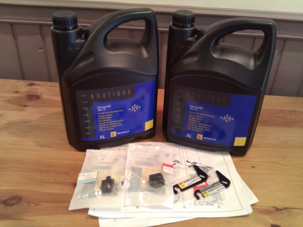

Parts from Renault, 10 litres of Type D coolant

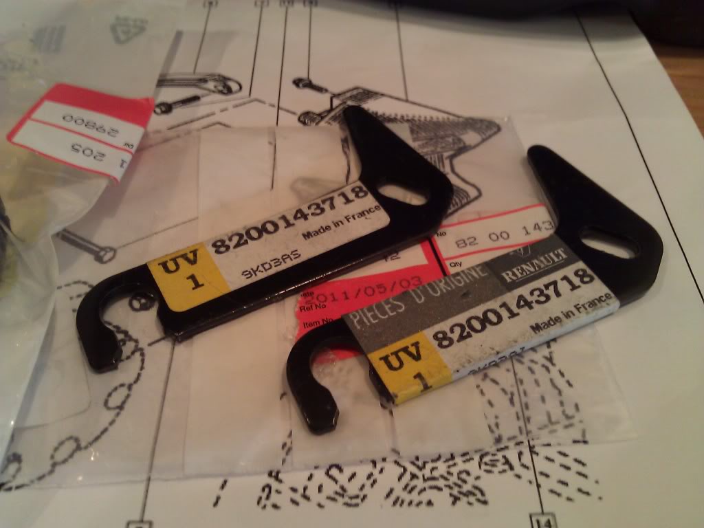

ABS sensor cable brackets

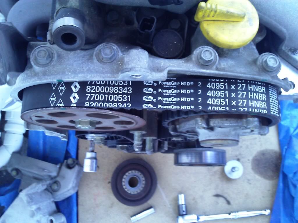

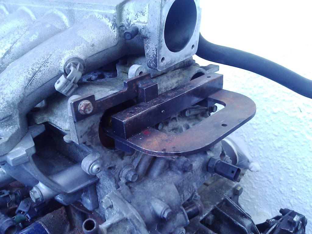

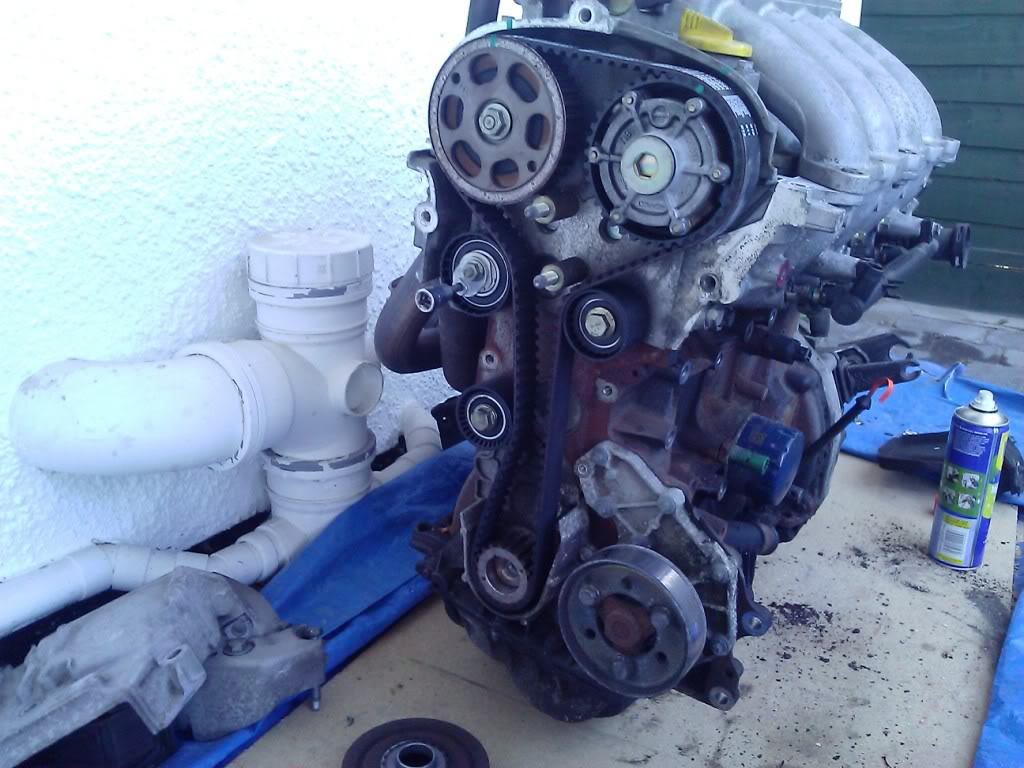

Sunday was cambelt day, along with bleeding the brakes and fitting the remainder of the ABS lines front to back
Locking tool
New belt
Genuine item of course

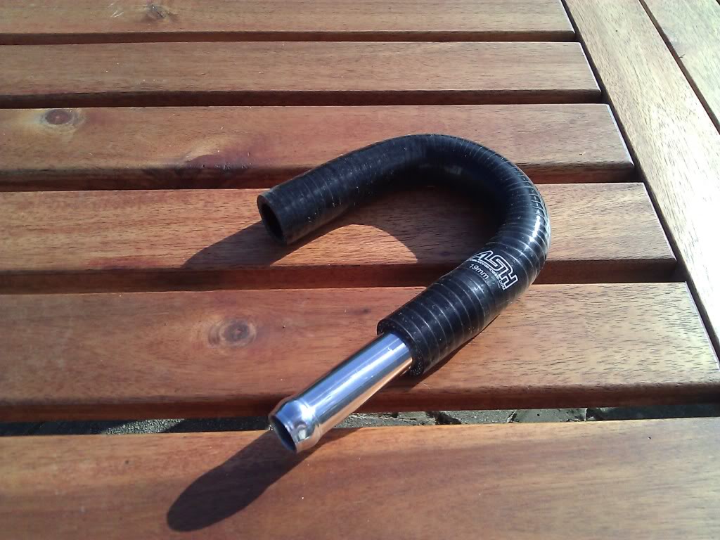

As i'm not running the heater matrix i've purchased the 180 degree pipe which will join the old matrix pipes together and the joiner.
