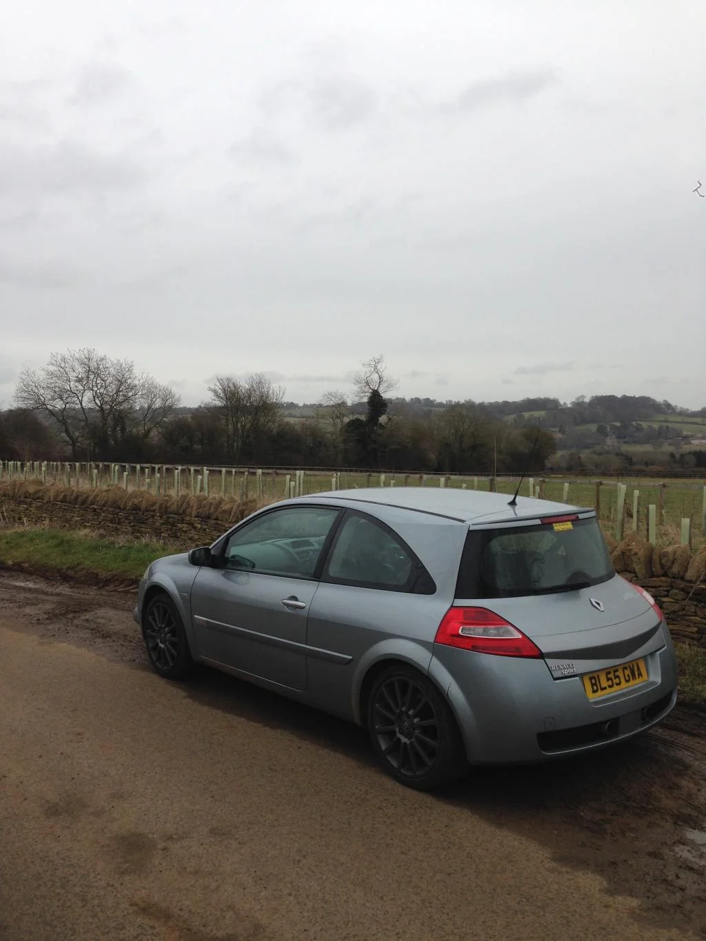

The weekend after getting it I headed his way (ish) again for a weekend away in the Cotswolds, where I started getting used to the car more and how it drove. In short it’s a great car to drive, comfy and quiet when on long motorway slogs then fun and well damped when enjoying the lovely country roads.

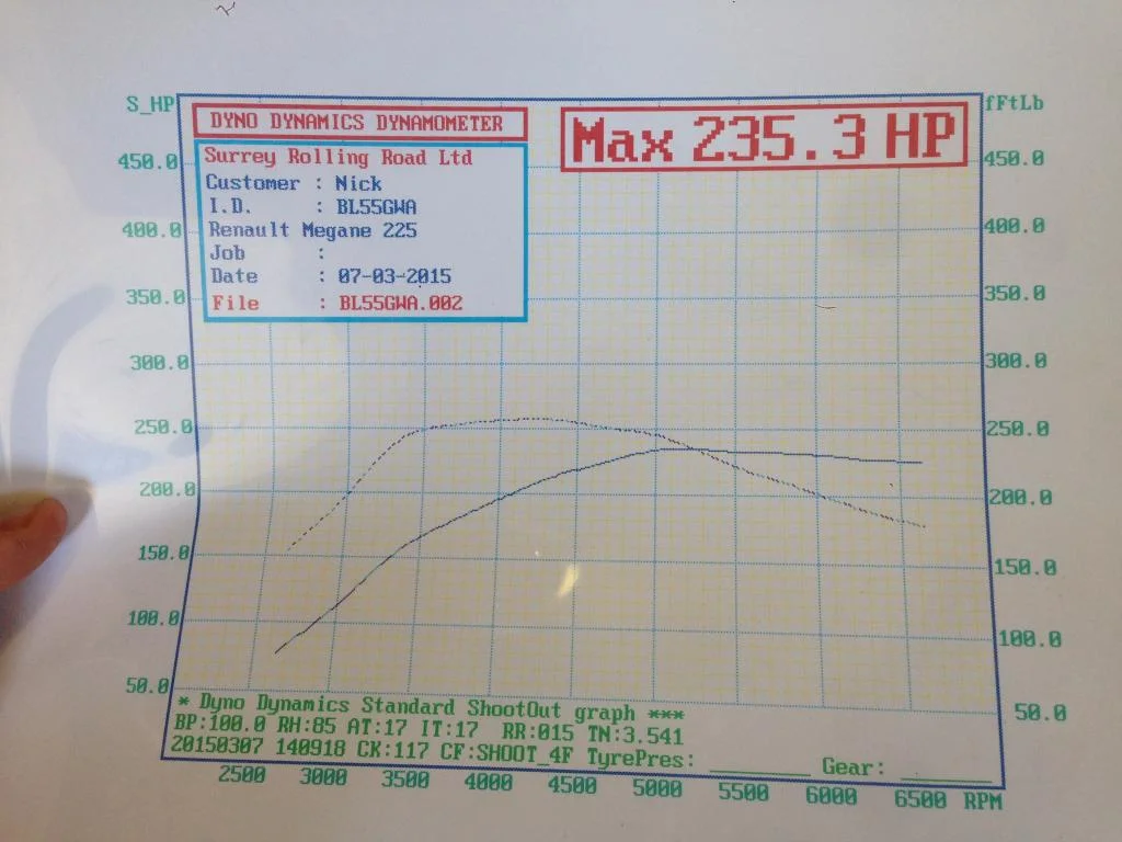

This weekend I attended the annual Surrey Rolling Road day organised to Cliosport to see what sort of figures it made, Dan had said previously that it made roughly 260bhp so I was intrigued to see the outcome on an honest set of rollers like SRR.
Unfortunately it didn’t make the claimed figures but it wasn’t all doom and gloom, Charlie at SRR did say though that the car was running healthy and that it’s probably just the re-circ valve that’s weak so it’s leaking boost. So I’ll be getting a forge one ordered up in the week to see if that makes things better.

Looks very nice mate, shame about the power run but I guess if it is the recirc valve then you could be gaining another 30bhp for little money!
