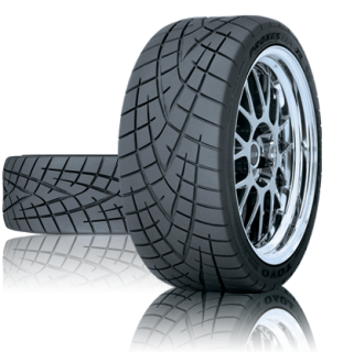

Tire_Reflections_PXR1R.png Used them at Llandow in the pissy wet day we had there, couldn't believe how much grip they had.
As soon as it dry's though, you will chew them to bits, but you are asking for a wet tyre. Tbh a good set of 888's are fairly good in the wet, surprisingly so, but these take it to another level.

What are they mate?
For pissing down rain and for wet?
Yep, totally agree with Tony. Threw it down at Mallory a couple of months back and I was the only one on track. You can to a certain extent use them in the dry but they get hot very quickly. I use them as my road/wet tyre. They're rumoured to be the same compound as 888s but I think they're a lot softer TBH. I'm sure the tread blocks come into it obviously but I think it's just that they're both Toyo, that that rumour started.

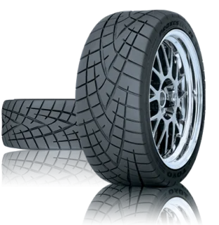

View attachment 104199 Used them at Llandow in the pissy wet day we had there, couldn't believe how much grip they had.
When you say dry, do you mean when it stops raining or actually dry?
I wouldn't use them in the damp or dry because obviously have 888s for that.
So as you say using these in the pissing rain they're awesome but what about when it stops raining and the track is still wet and slippery? Or is that what you mean when you say you'd kill them?
Looks like this could be the one to try out then maybe. Still need to consider top spec Michelin road tyres too though.

As long as there is water on the circuit, they are fine.
I took them out at Rockingham testing when it was a little greasy, but not wet, 5 laps and they were starting to melt.
Nature of the beast really, good tread blocks for moving water, in the dry tread blocks move about and over heat. You choose.
And they are cheap.

Well I read what you said and thought ..... if its good enough for mr tony hunter.im sure they will be more than capable for me ... I think I got them for 70 a tyre I shall look at invoice
  182cup & 172 racecar
Better, we used to run Pe2's for a wet tyre, but these are much better, as a wet tyre. Compound is much softer.
Awesome thanks Tony.
Set of 888s for the dry and damp then a set of these for the wet and rain should do me then.
Apart fromwhen the 888s start to get towards the end of their cycle. But that's life.

+1 for toyo R1R as a wet tyre. Fine in the dry as well as long as your sessions arnt stupidly long. Did a day at Donington National with them and they didnt cook up.
