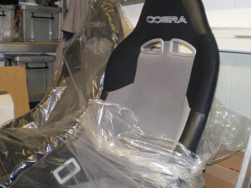

The engine is from a 182 and has done 11k and the seats are cobra clubmans which are cheap but should be more than adequate.

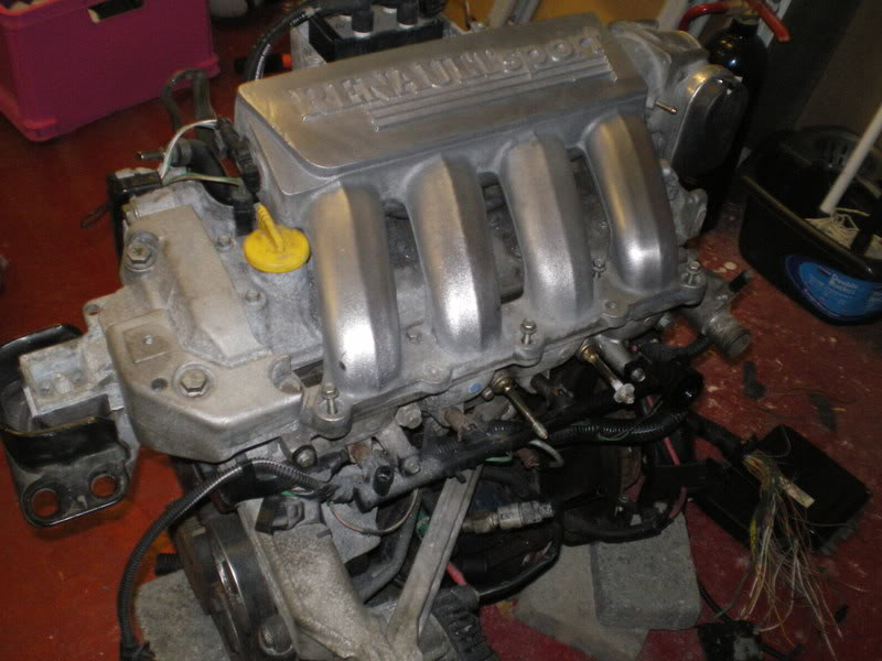

Heres some pics

how come its got a 172 manifold on it?

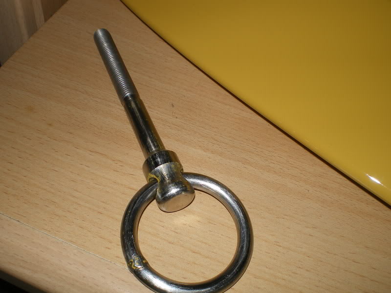

where did they get the tow hook from?

^ I'm guessing its a 172 engine and they don't know it yet. Still for what difference it makes.
What are you planning doing for management? Or have you got the ecu/uch/decoder ring/key from the donor car? Loom looks to be in a bit of a state?

the tow ring is a OMP one,

Guess its a 172 engine then does look v dirty tbh.yeh the loom is fooked we knew this before we bought it but shouldnt be too hard to do
