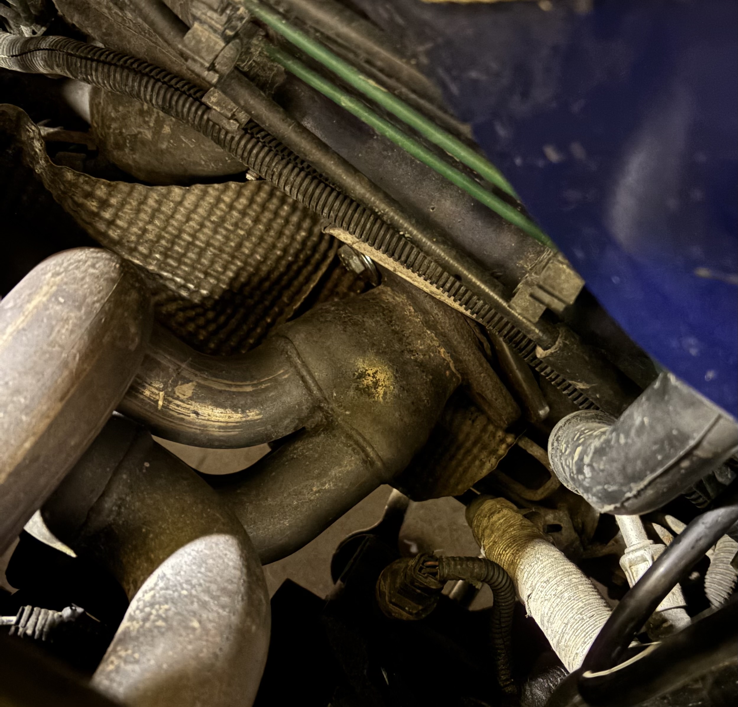

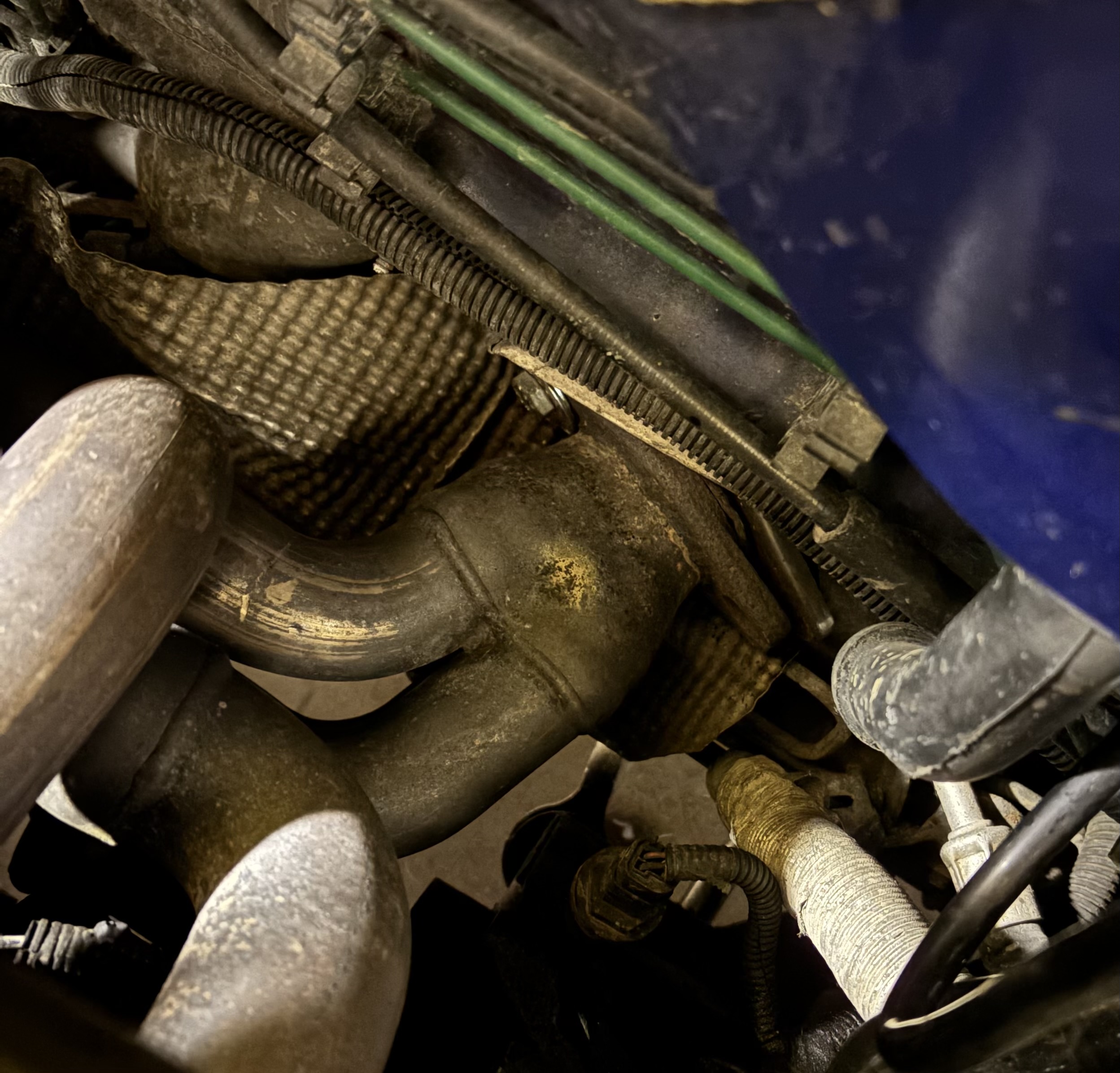

I have lost a bolt on the manilfold where it meets the cat - could it be this?

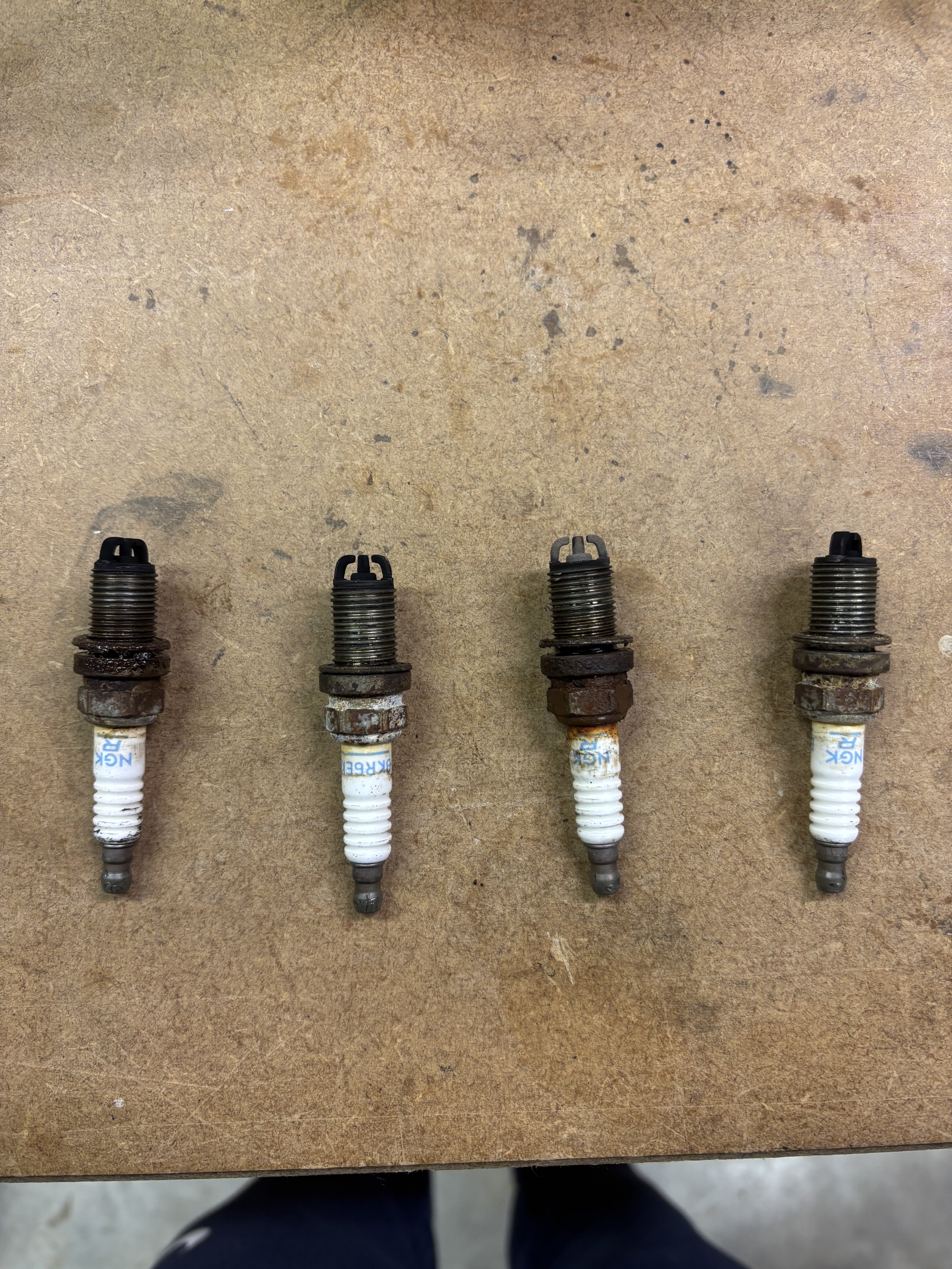

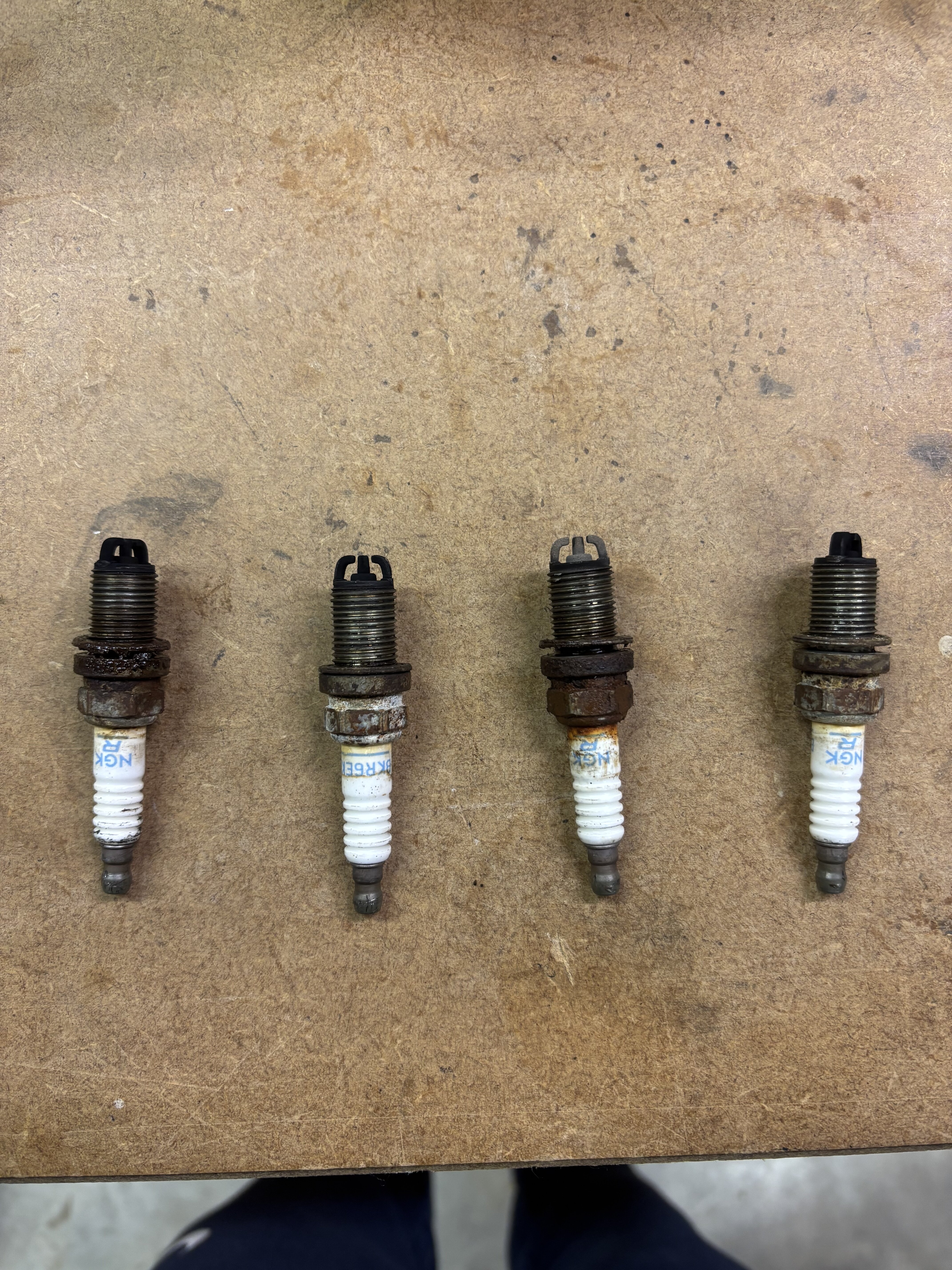

4 out of 3 spark plugs look terrible….

Did you replace those spark plugs? Are all HT leads actually OK?
No I was thinking compression test first before I start spending cash on it - maybe it’s now time for new coil pack, leads, plugs and injectors 🤔

Id definitely start with new plugs at the very least. Check your injectors resistance with a multimeter and note back what they are. Make sure theyre all cold though

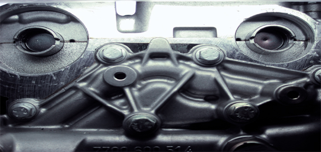

Since you haven't mentioned it yet. Check the timing.
If you don't have a crank locking pin. Remove cyl 1 (gearbox end) sparkplug and rest a screwdriver on the pistons crown. Manually wrench the crank until it's at TDC. Then remove the rubber cam caps. Inspect the cams. You should see both cam timing tool slots inline with each other. Smaller crescent towards the bottom.
If this what you see. The timing is not your concern.

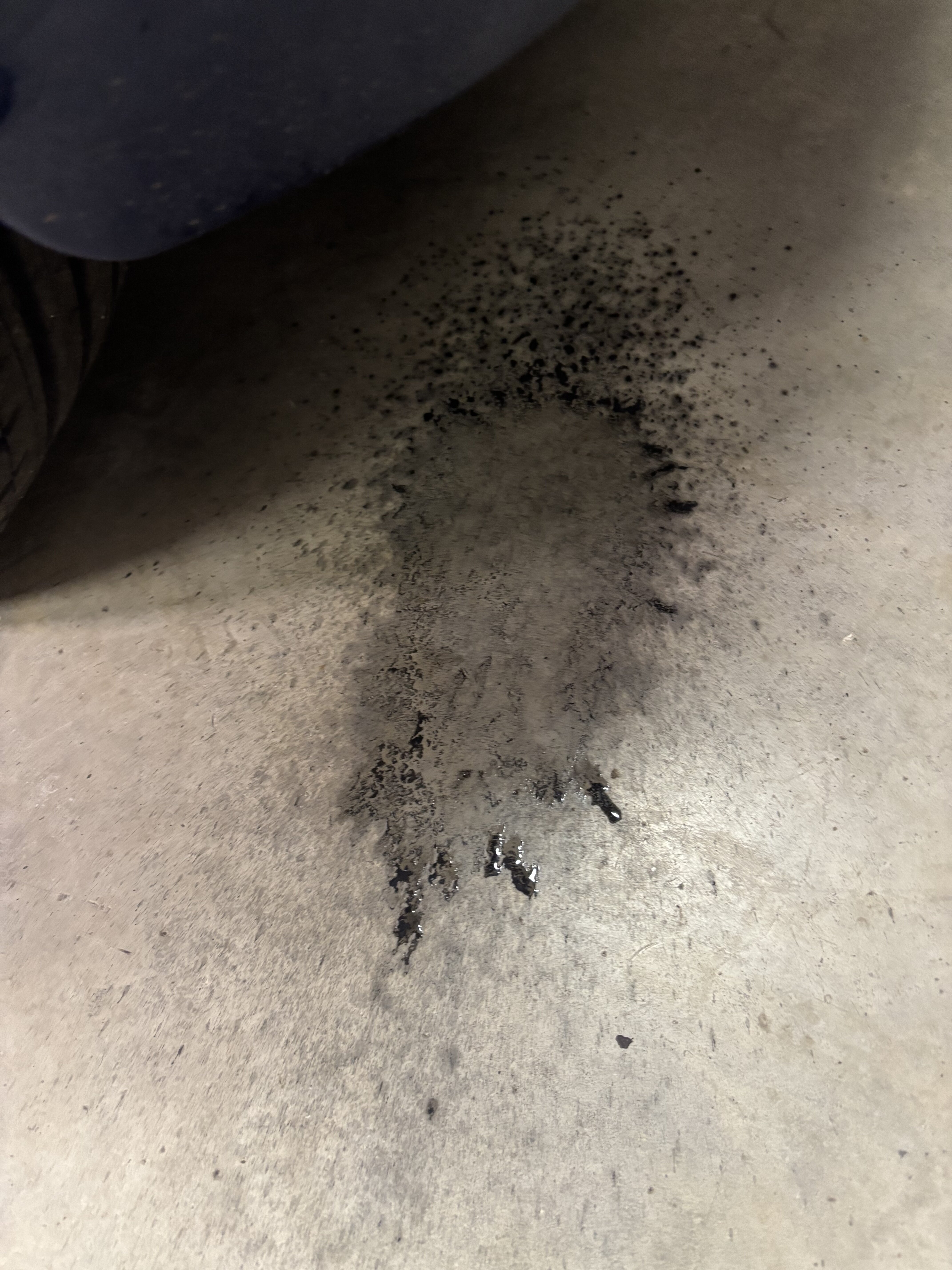

Also as a side point - there’s this black sh*t on the floor of the garage from the exhaust which isn’t looking great….

Touring_Rob
If your compression tester is accurate 100psi is low as f**k.
If you have changed the ecu, the fuel pump, the injectors, the plugs and the coil pack then you are down to either an engine issue, wiring loom issue or sensor issue. They have a MAP sensor which could very well be the cause, but also temperature sensors which could fail resulting in an overly rich fuel demand.
You mention that codes were read.... what are they?
One clean plug next to 3 dirty plugs is a bad omen.
