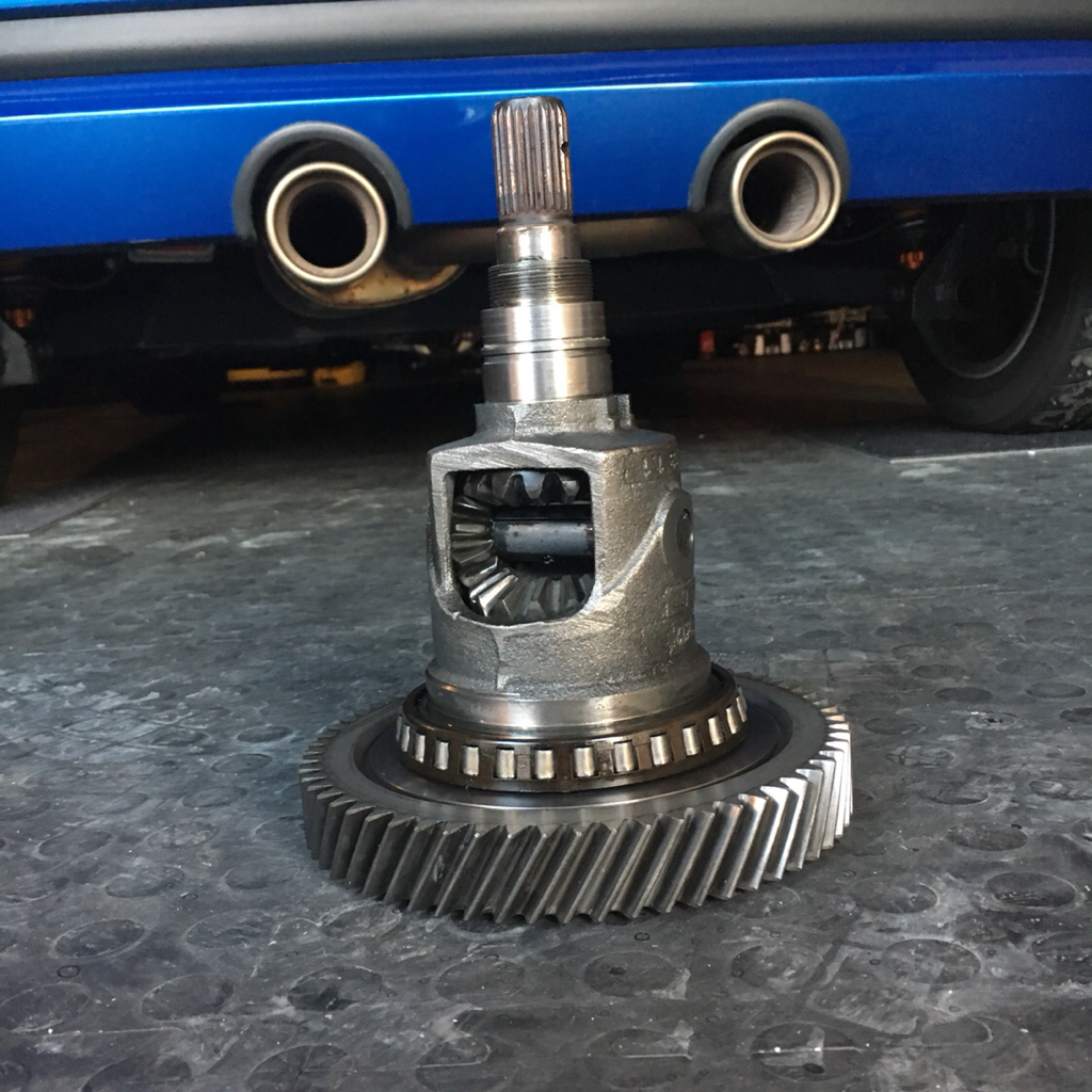

We’re looking at fitting a quaife LSD, custom roll centre correction kit, potentially softer front springs.. get it weighed properly, and dyno’d to see what class we will be running in next year etc

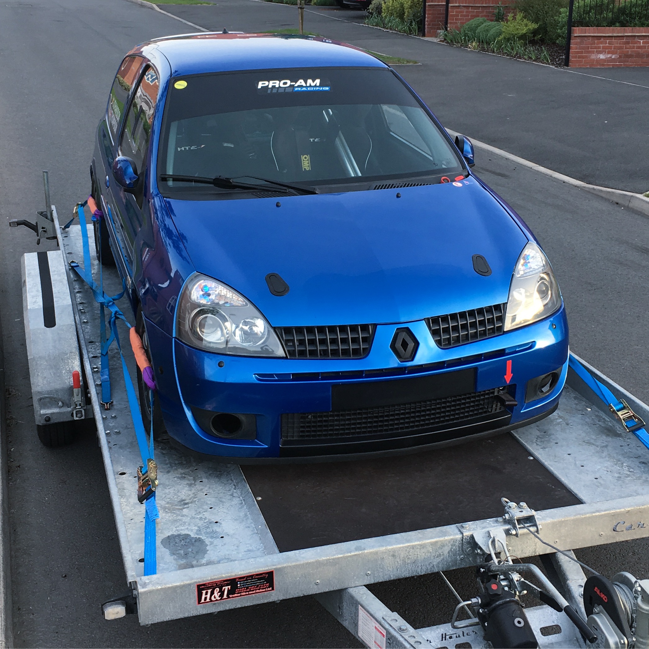

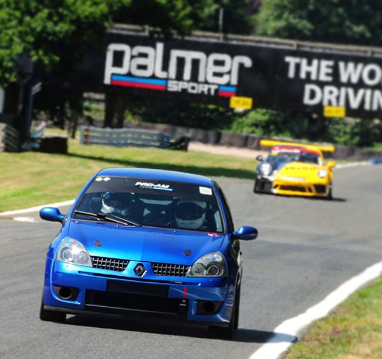

Donington Park complete!.. Both @Jenbo and I had a great day last Friday getting to grips with the circuit and making some setup changes throughout the day.. The car felt mega! (little bit of understeer to dial out).. We both built up our confidences on the brakes too.
Donington is such a ballsy circuit, needing a lot of commitment and confidence in the car.
Few pics and vids of the day.
Got the new PRO-AM Racing logos on the car and hitched up ready to go.
Trying to keep up with Epps in his cup car!.
Then a quick break for lunch, review some onboards and talk setup
A quick lap of the circuit with me driving.
Coming in hot from another successful test complete!
Next stop Oulton Park in 3 weeks.

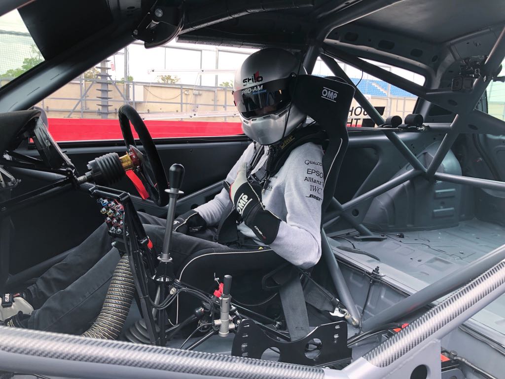

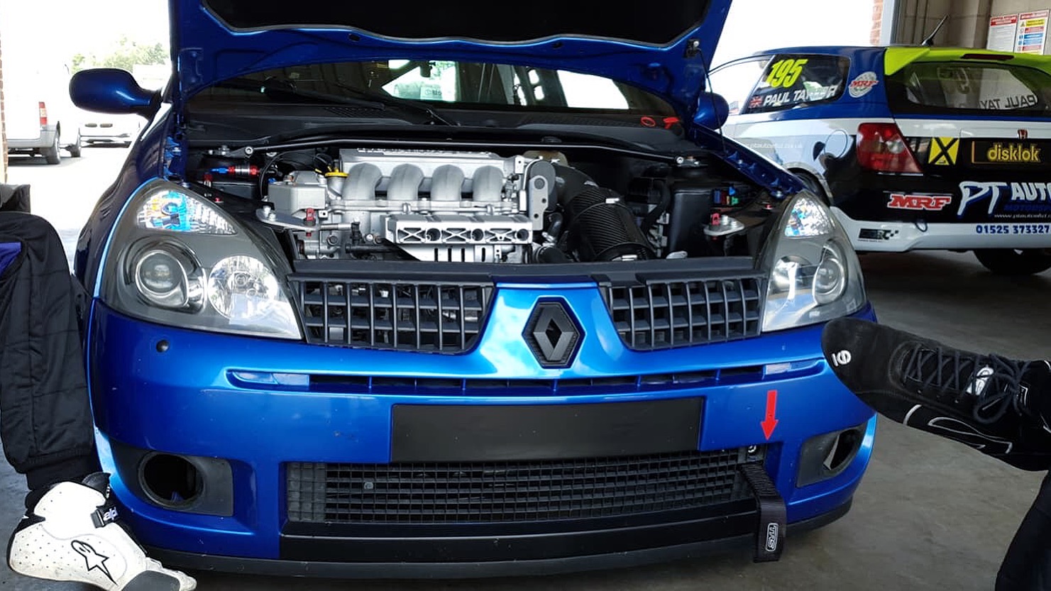

What's that little box above your rear view mirror ? Also, your speedo doesn't work, did you not keep the ABS module and sensors for the speedo ?

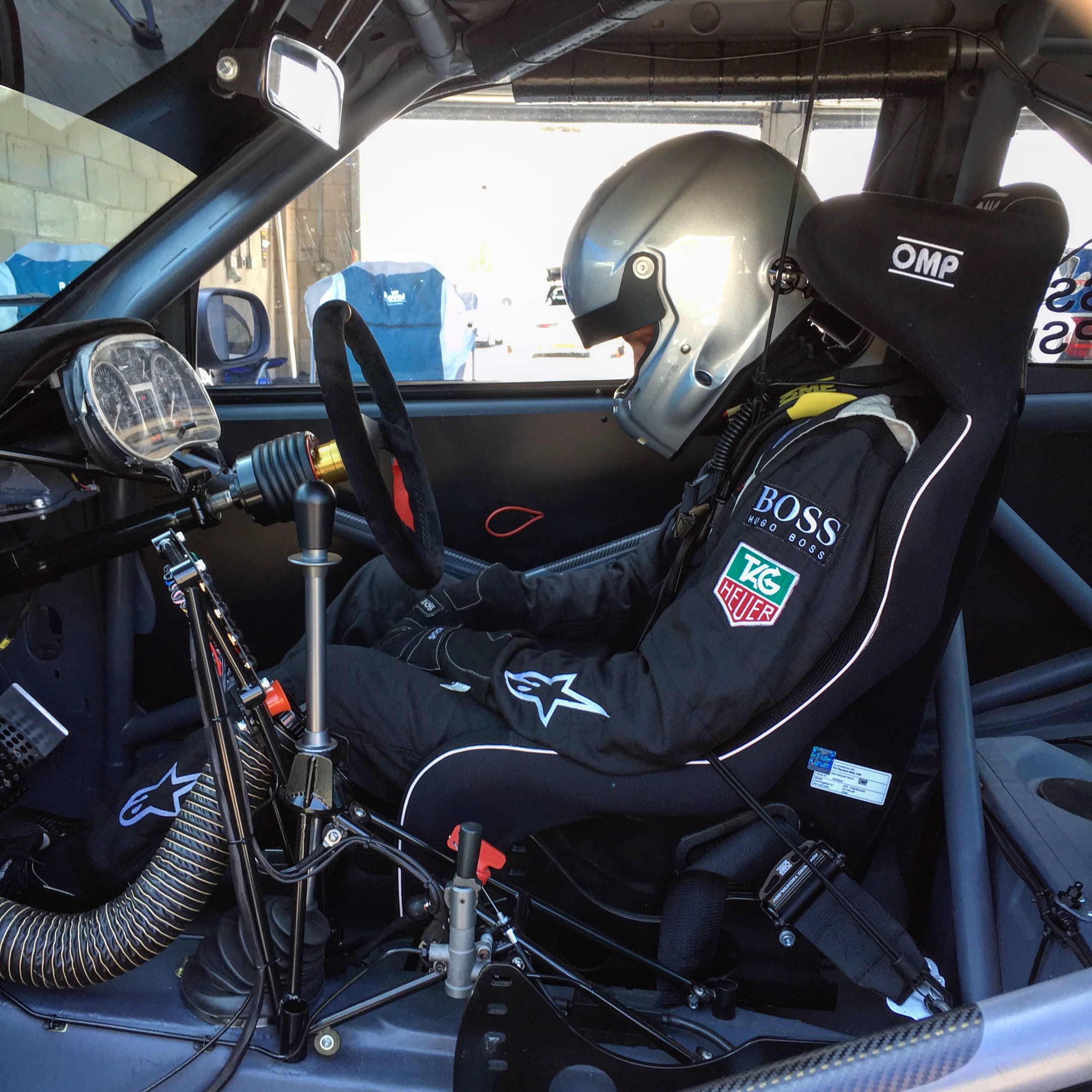

I bet it feels like a right little racer with the seating position/gear lever etc
Yeah I love it!. seating position is what makes the car I think, doesn't feel like a clio when your sat inside. Everything is where I need it, lets me just concentrate on the driving.

We've got an OMP i Race intercom fitted, allows for pit to car radio and when we have passengers we can talk easily.. and yes we have removed everything to do with ABS, so no speedo.

Base unit cost, cheaper to run, minimal servicing, not running silly power so don’t need any aggressive locking, smoother operation, great customer service
Great build!
How do you find the Quaife; how much difference does it make on lap times and tyres?

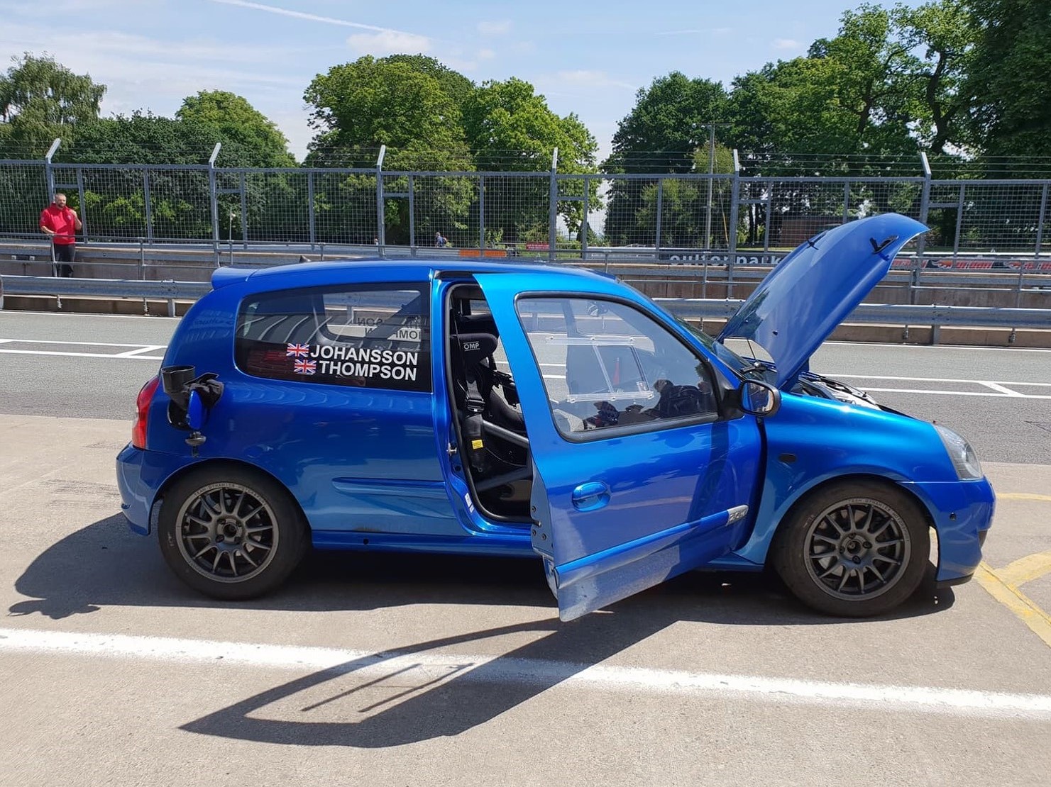

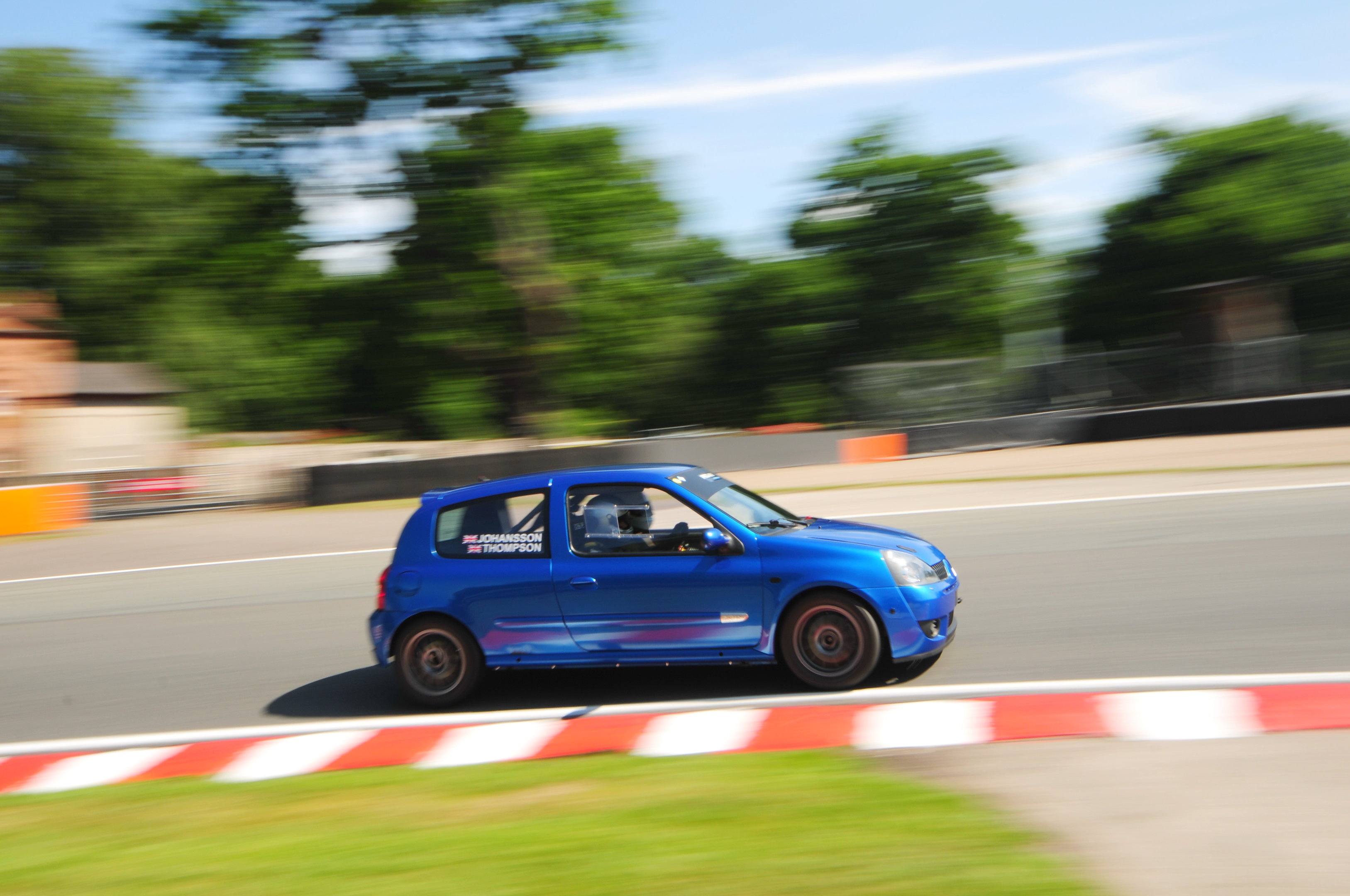

Its been a few weeks since we took the Clio up to Oulton!.. and wow what a circuit.. Completely different to Donington. A lot more technical, bumpy and narrow, but just as enjoyable!. We could really start to see the strengths and weaknesses of the car too, which was very useful and what our season of testing was all about!
The day again ran very smoothly, racking up over 70 laps ~190miles
We had @chrispy.clio in the car too for a drive, giving us valuable feedback from all his experience in Clios.
Here are a few pictures of the day!

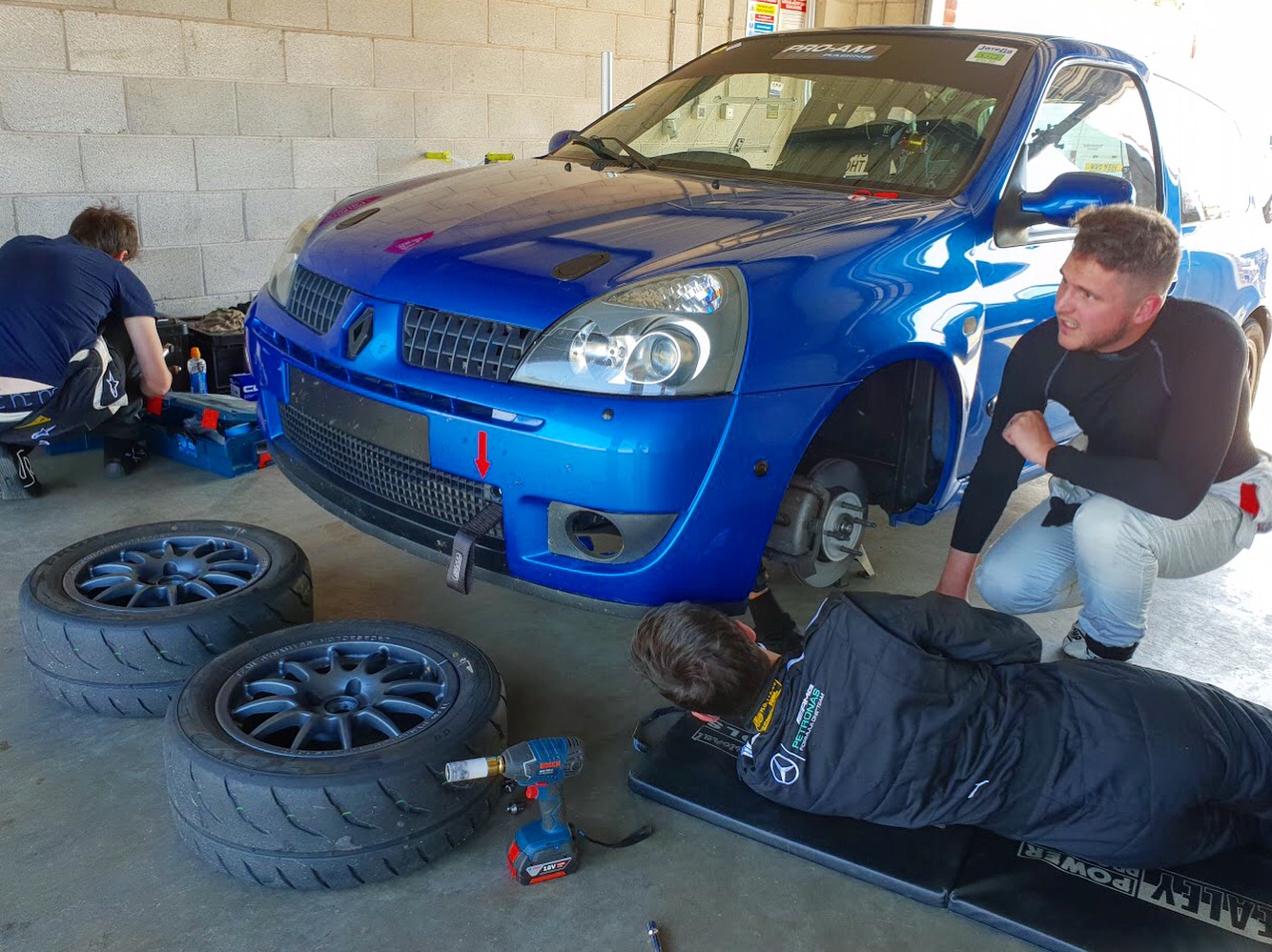

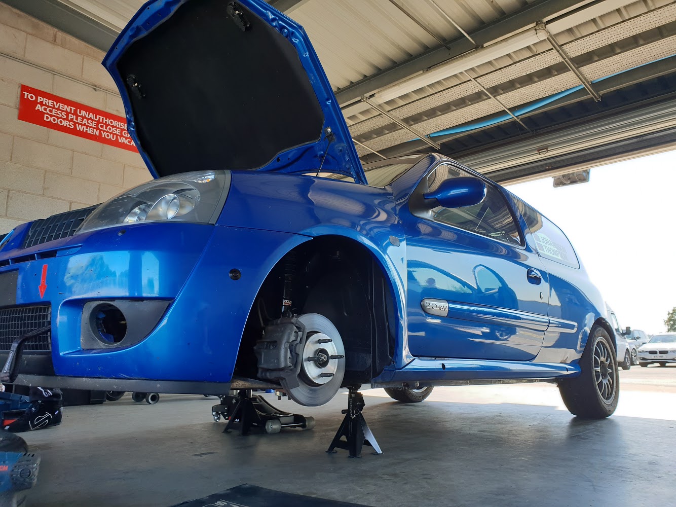

Quick Pad change in the afternoon. Onto our second set of CL RC6s
@Jenbo taking a break. putting his Hans device to good use.

Not much work to do before then, a quick set down, bolt check, setup and off we go.
On the side we are also working on our own roll centre adjustment kit and stripping our spare box to send off the diff to Quaife.. lots going on!
