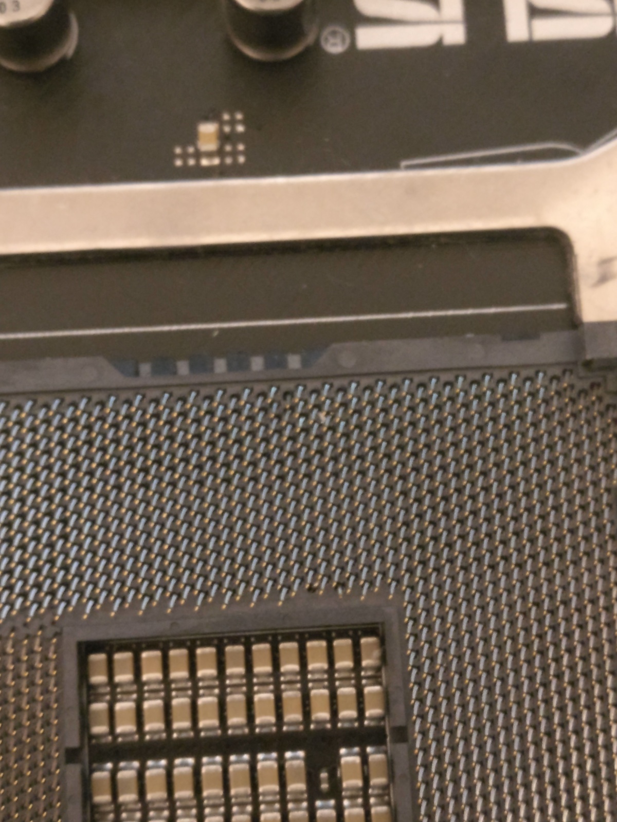

So, given that I've already probably broken the pins on the socket (Sorry @Silent_Scone), and the CPU might be dead, what shall I do? (top side of the middle bit of the socket)
Board is X99 Deluxe II, chip is 6850K. I have now useless 16gb DDR4 and a cooler. I should probably buy a replacement CPU and motherboard
Board also wasn't posting before I managed to get fluff caught in the pins, so who knows how I managed to damage it
Didn't seem to be a PSU (working in the machine I rebuilt at midnight) issue and RAM made no odds.
The 00 code on the mobo display, and the red CPU POST light seem to confirm it's CPU related (at least that's what internet says)
I may just have to buy something else, maybe I'll f**k up less with AMD

What's wrong with the CPU? All I can see is some pins on the MoBo which you can probably straighten out if you're really careful. I've had success with it a few times.
You've got a slightly bent one if you follow the row up from the middle bit you've fucked too.
The board didn't POST *before* I'd done that
Cookie
Pins were straight before I took the CPU out, got some tissue paper :)/) stuck in the pins and then bungled getting it out because I have run out of compressed air

Not checked if AMD's latest CPU offerings are the same, but I always preferred their logic of having the pins on the CPU - and not on the motherboard. Seemed (to me anyway) to be far less risky during the install process - it simply dropped into the slot and you knew all the pins were safely home.
Oh, and if you want some sympathy - I did exactly the same on my old LGA1366 mobo, one time when I removed the CPU. It's so easy to do, though luckily I managed to coax back the pins to a working state with a lot of patience, some TLC and plenty of "f**k, f**k, f**k!" mumblings, under my breath.

New board in, CPU seems happy.
