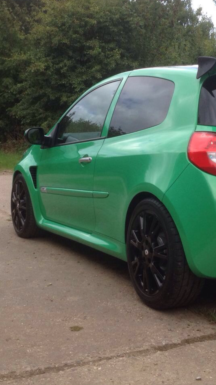

The top picture (standard wheels) are 43 offset I think. It handled well with just the bilsteins in that pic.
The williams wheels are et 36 I think. It handles brilliantly imo (a few trackday videos support this). But it's got ASTs, roll centre kit and a whole host of other suspension goodies so not sure how much the spacers have / haven't helped.

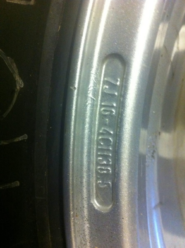

Anyone have a pic where it says the offset on turinis, so i know where to look?
Should be on back of one of the spokes. However I've just seen this which looks as though it's on the outer rim on the rear of the wheel.
Also someone has said on another thread that it is printed in the centre hub of the wheel if they're Speedlines rather than Renaults Speedlines.

Oh and that photo of the numbers on the back of the rim of the cup Turini, that's where they are on mine too :up:

Looking at your car and looking at those wheels I would say the offset is 38.5

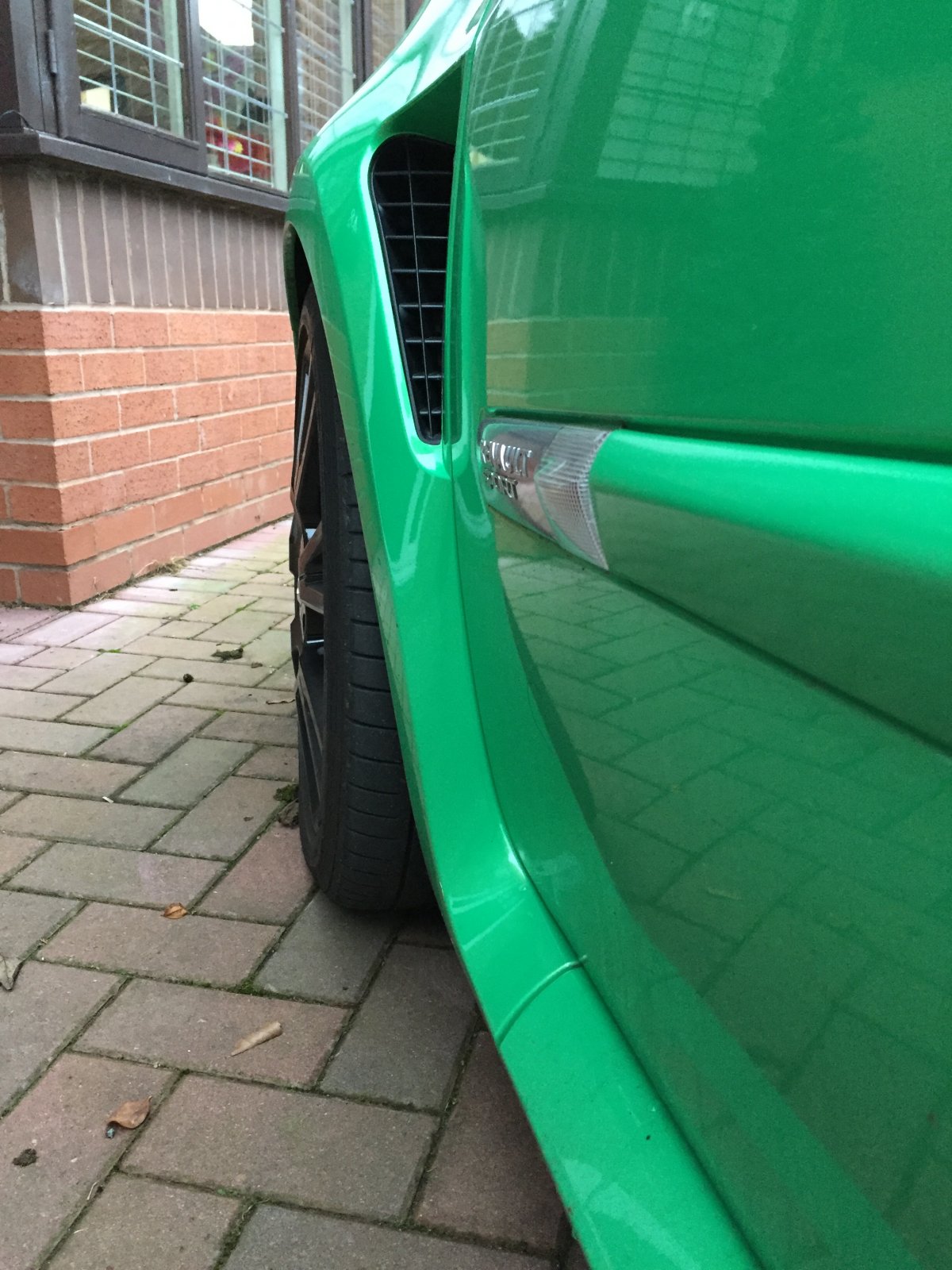

@NorthloopCup I always see people put 25mm on the mk3s and I always think it looks too much. Having a bit of tuck looks more oem even if they are spaced out.
38.5 being cup size (the better size over trophy)?
Yes. The lower the number, the further they stick out. As cup turinis are a lower offset over the trophy ones, they are the more desirable ones to have.

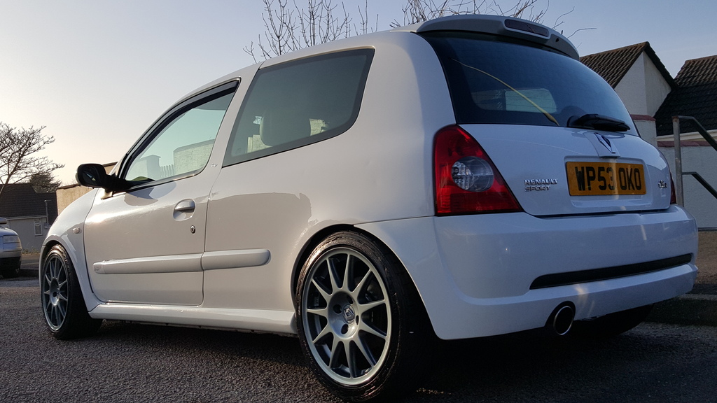

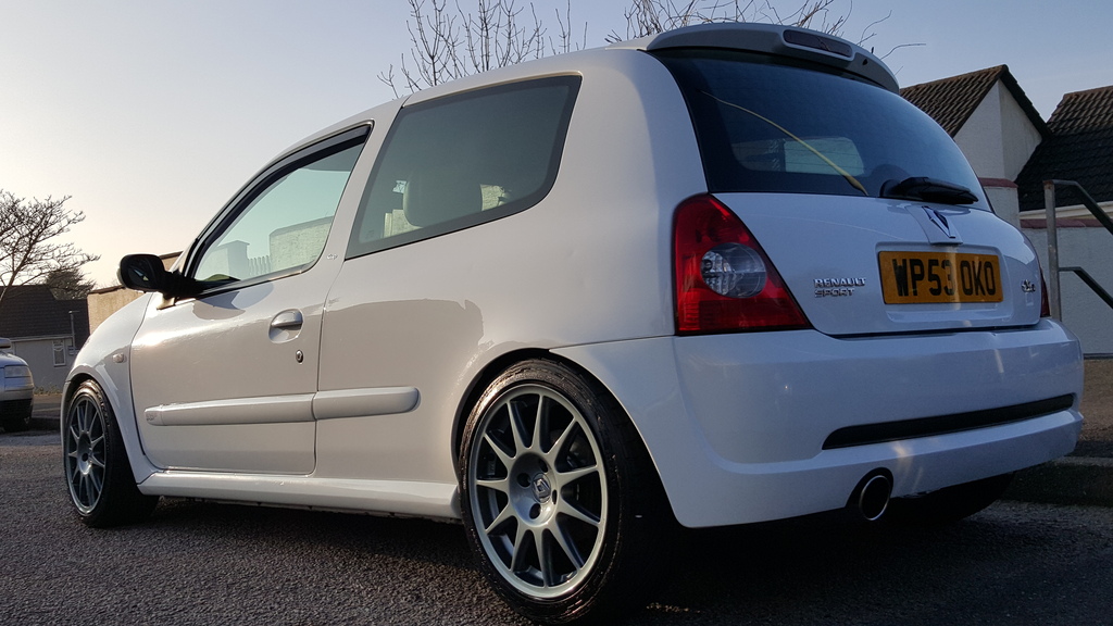

  2007 Megane R26
Wow Chris_Beer that looks great! Never seen a white one before.
I have 20mm spacers on the front which fill the arches perfectly. 20mm on the back will rub with 205's as I found out so currently not using any.
