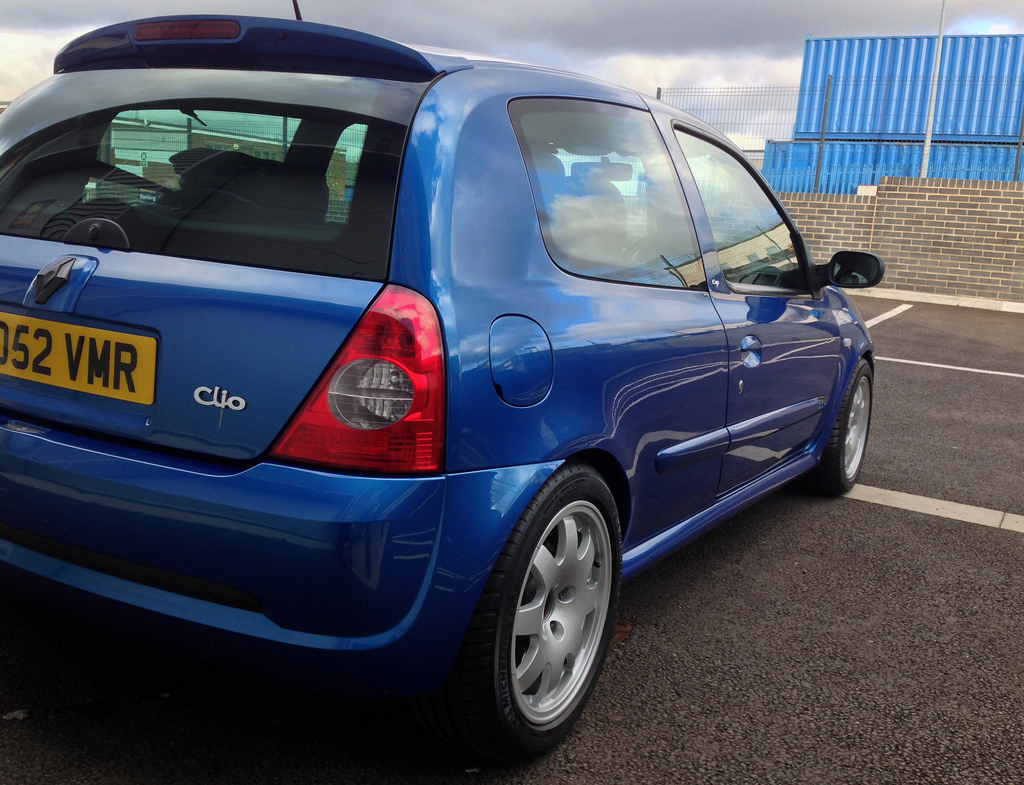

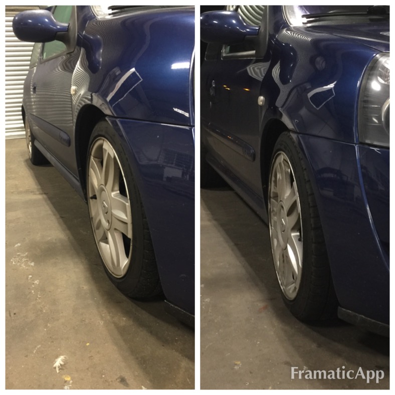

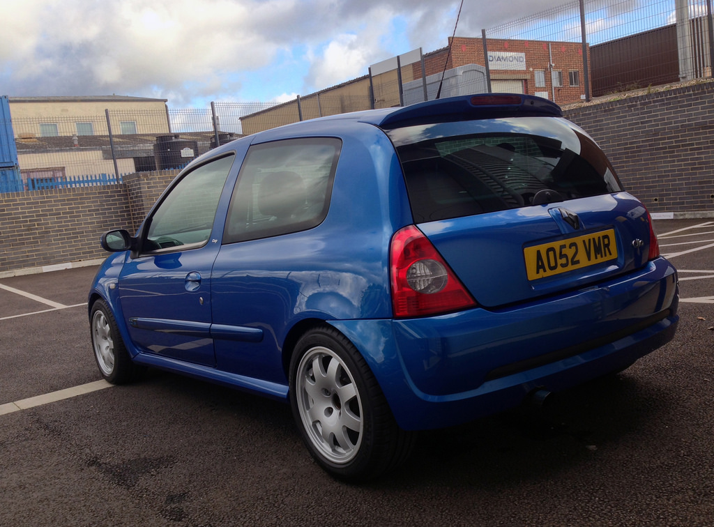

I'm running standard 16's with 10mm rear spacers and 20mm fronts at the minute. Hubcentric with studs/nuts and the added bonus of the wheel trims still fitting.
I'll grab some pictures but it looks a million times better and I can't really say i've noticed it handle any worse? It's nice to know when i'm not running 2118's, my standard wheels will also look good.

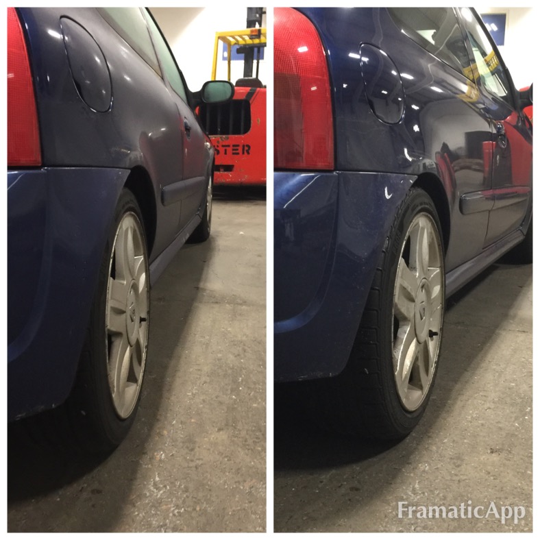

I've got slip on 5mm PMS spacers all round on mine and never had any issues. But again, only 5mm! Still looks really good tho.
Standard bolts are indeed 26mm so I went 30mm just to be safe although the standard ones would probably have been ok with 5mm
