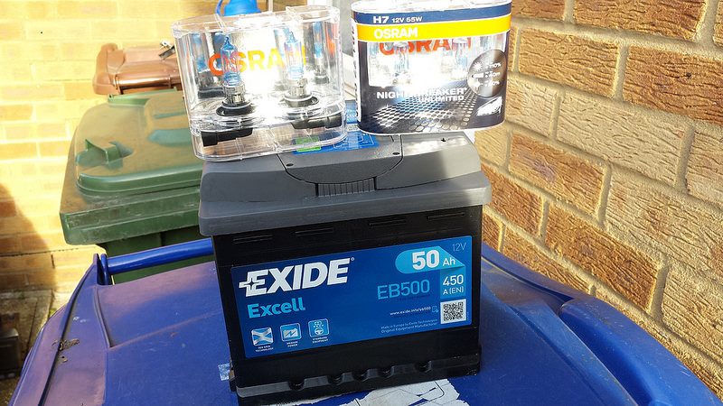

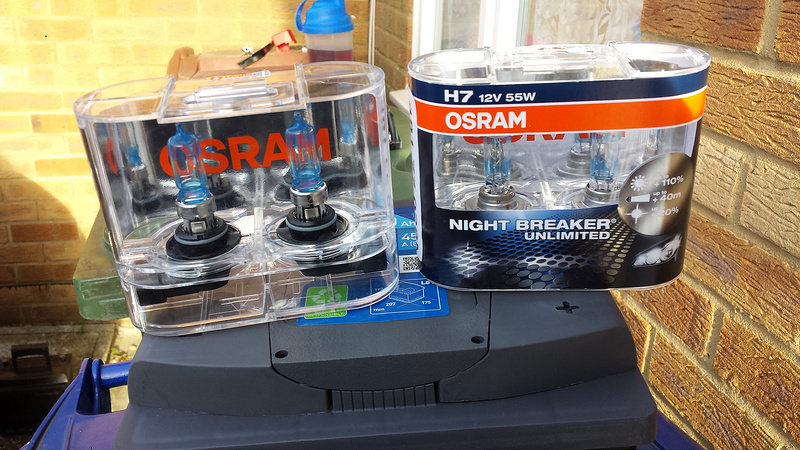

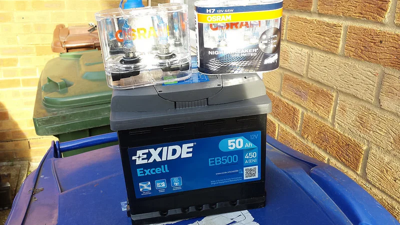

Been buying a few bits for the Clio, one of the things i wanted to do was to up grade the head light bulbs and after talking to Dr Jekyll (Mark) i decided to go with these.
Untitled by scottieraven, on Flickr
I didn't want something to blue and i didn't want to be able to see the blue bulbs from the front of the car as i think it looks tacky and not the look im after.
Next up was the battery, because the Clio sits for a long time not being used its killed the current battery. This time i thought i would get something better that the Banner one on there at the moment.
I know this sounds stupid but i wanted another black battery although grey would be ok, i saw on the ECP web site that they do a Bosh battery but this was blue.
When i took a trip to ECP and spoke to the sales guy he said that the Exide battery was a better spec and it was grey so i bought it.
The reason for not wanting a blue battery is because it would look odd in the engine bay of the Clio, i don't like bright colours and much prefer the low key OEM look. :blush:

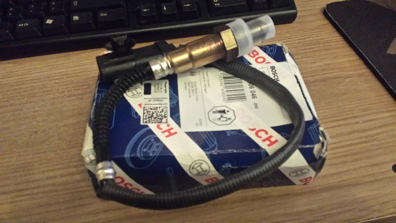

Another thing that needed doing was to replace the lambda sensor, while getting the Clio mapped by Paul at RS Tuning the Clio wouldn't idle. Paul managed to sort it by leaving it running so the ECU would learn, sometimes when driving the Clio hard and coming to a stop it would stall.
Bought this from Marc, £40 delivered which is good.

I have fitted the bulbs Mark and they seem better although i haven't driven the car with them.

They really are good, I need to stick them in my car now I think about it.
They are better than the standard bulbs mate, i have them in my van. I did buy a pair of MTEC H7 which are blue for the main beam but you could see them so i fitted the Osram H7 which arn't so bad.

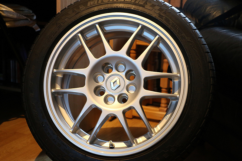

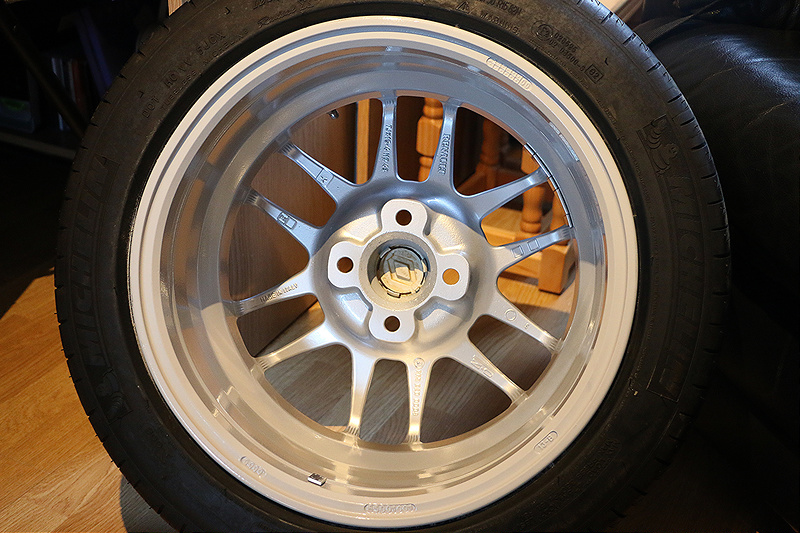

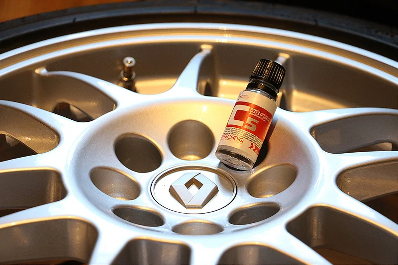

After collecting my wheels from JP Polishing i never got the chance to seal them with C5, as ive not driven the car in 3 months i thought it was an ideal opportunity.
The wheels where already off and clean, they just needed to be kept indoors for a few hrs to get to room temperature.
They where given a wipe over with some IPA and then given a coat of Gtechniq C5.

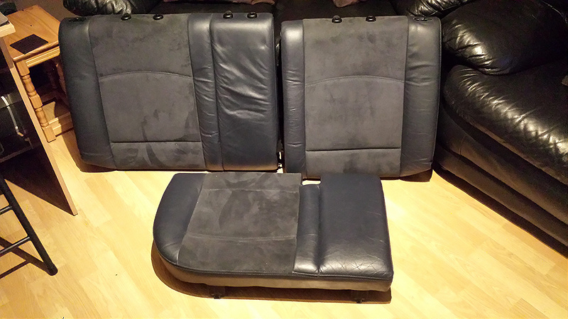

Another thing on the car i wanted to change was the steering wheel, i wanted something looking factory. After seeing Jonathan's flame red PH1 and seeing the steering wheel that Snappy had done for him i knew that's exactly what i wanted.
I put up a wanted add for a mint PH1 back seat so that i could remove the cover and this is what i would be sending to Snappy. After an hr long car journey i finally had a mint seat, perfect for my needs.

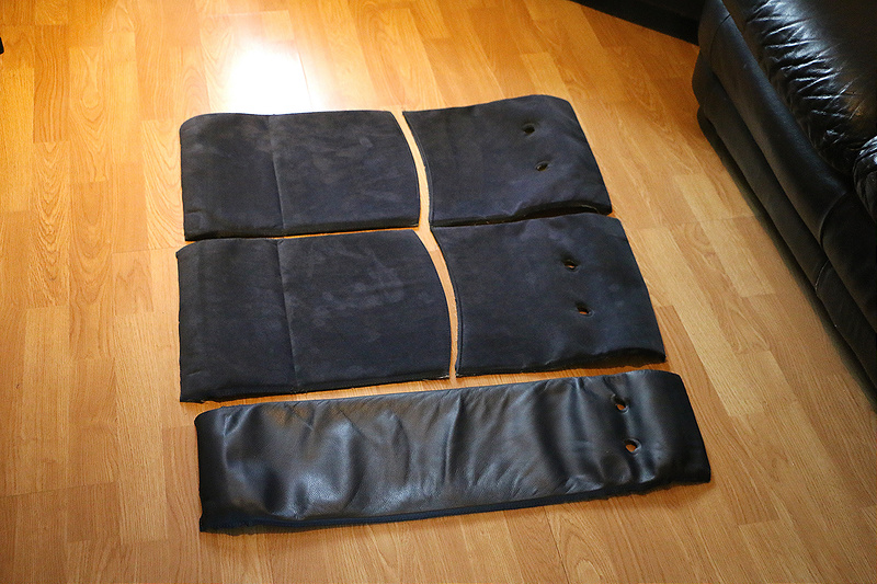

Now it takes quite a while to strip it down just to remove a few bits of alcantara and a bit of leather, after removing the bits i needed i set about chucking them into the washing machine for a wash.
The leather panel has been cleaned with Gliptone liquid leather cleaner and then given a good going over with Gliptone conditioner (smells amazing)

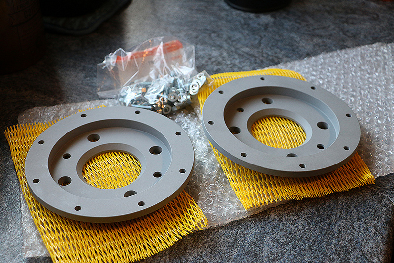

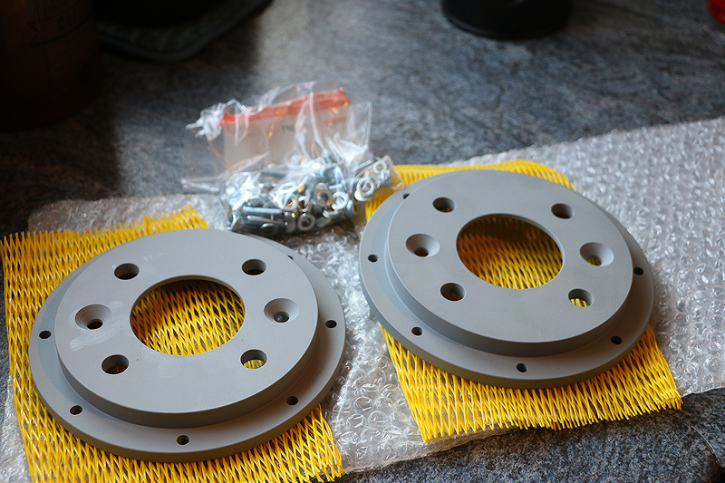

I had a little present arrive for me today, the alloy bells for my front brakes. I need to get over to Hi-Spec and sort out the rotas and see what calipers i can fit under my wheels.

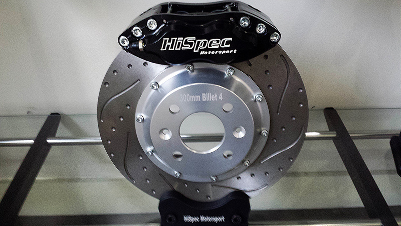

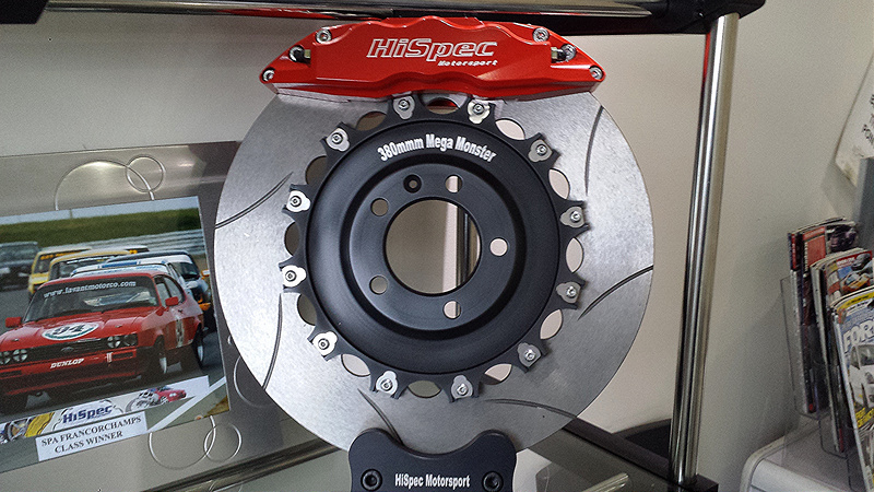

So my trip over to see the guys at Hi-Spec was a success, i have left one of the bells and my F1 with them and they are going to mock up a disc and caliper and then give me a call tomo hopefully.
While i was over there the guy said that a Monster 4 should fit and even the Monster 6. Now the Monster 4's and 6 use a bigger pad than the Billet 4's.
The Billet 4's pad area is 98mm long x 49.5mm wide where as the Monster 4 & 6 are 132.5mm long x 47mm wide. The Billet 4's use a Volvo 440 pad.

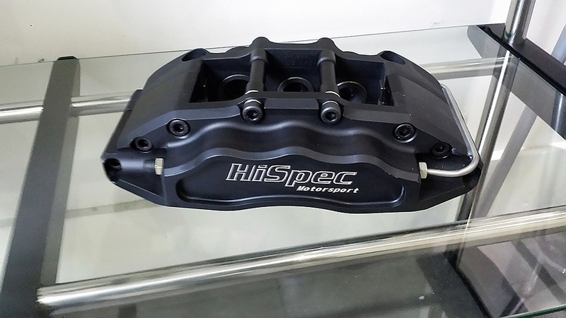

The difference between the Billets and the Monsters is that the Monsters wrap around the disc alot more so clearance shouldn't be an issue, while i was in Hi-spec's shop i noticed they had a race caliper on there display stand which looked pretty amazing. These have a stiffer body but they don't come with dust shields so the guy said the pistons need to be cleaned before they are pushed back into the caliper.
These are only available in black and where there RX132 range.
The Billet 4's which they can do in a more moden smoother caliper like the bottom picture, i like this style though.

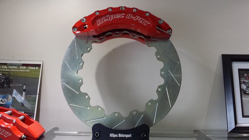

Just a couple of other calipers they offer.
