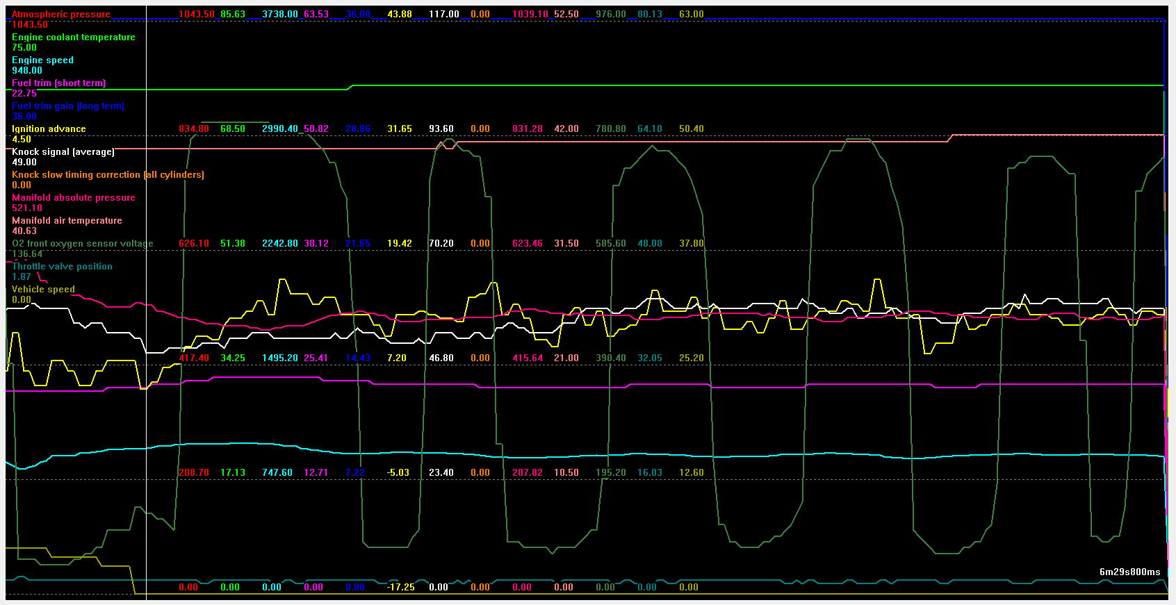

Ok, so car warm.....................i hop in and press the pedal to bring the car to say, 1700rpm..............after a couple of seconds it will drop to say 1500, then back up...........then down, then back up............................for ever
I have a sneaky suspicion that this is tracking with the lambda pulse
J
  2003 Clio 172
Hmm....yeah, ever so slight increase in rpm when I bridge the pins.
I bet this is more noticeable without the RSTuner 98 Ron map........pretty sure my switch is doing toss all so will replace that.

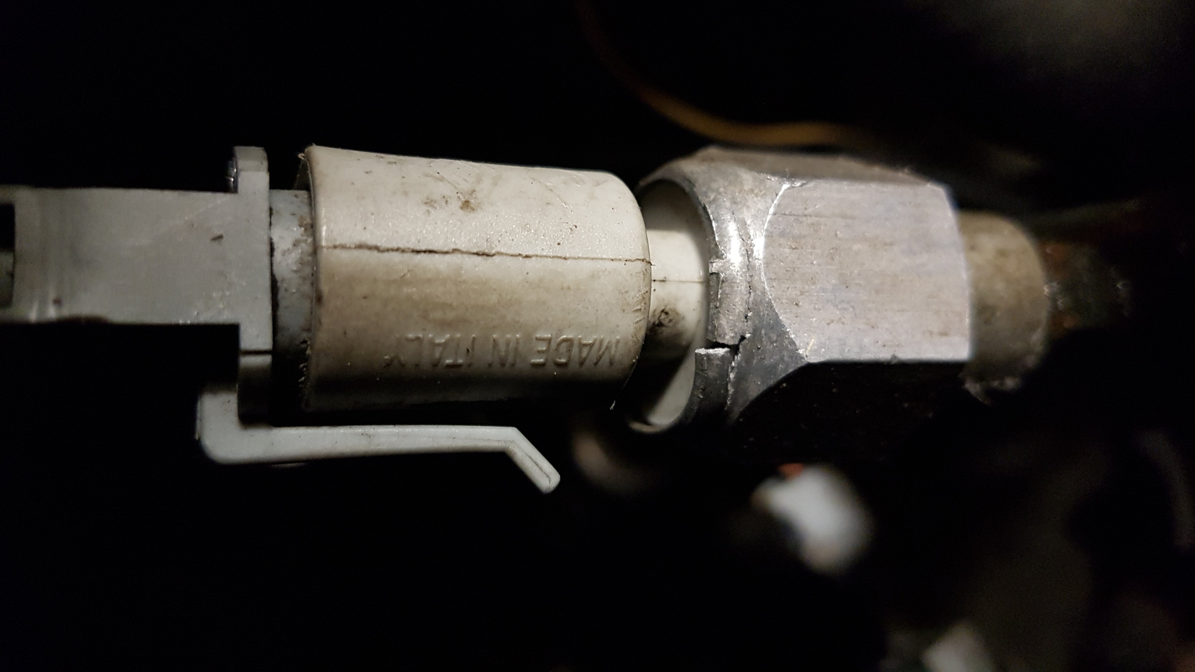

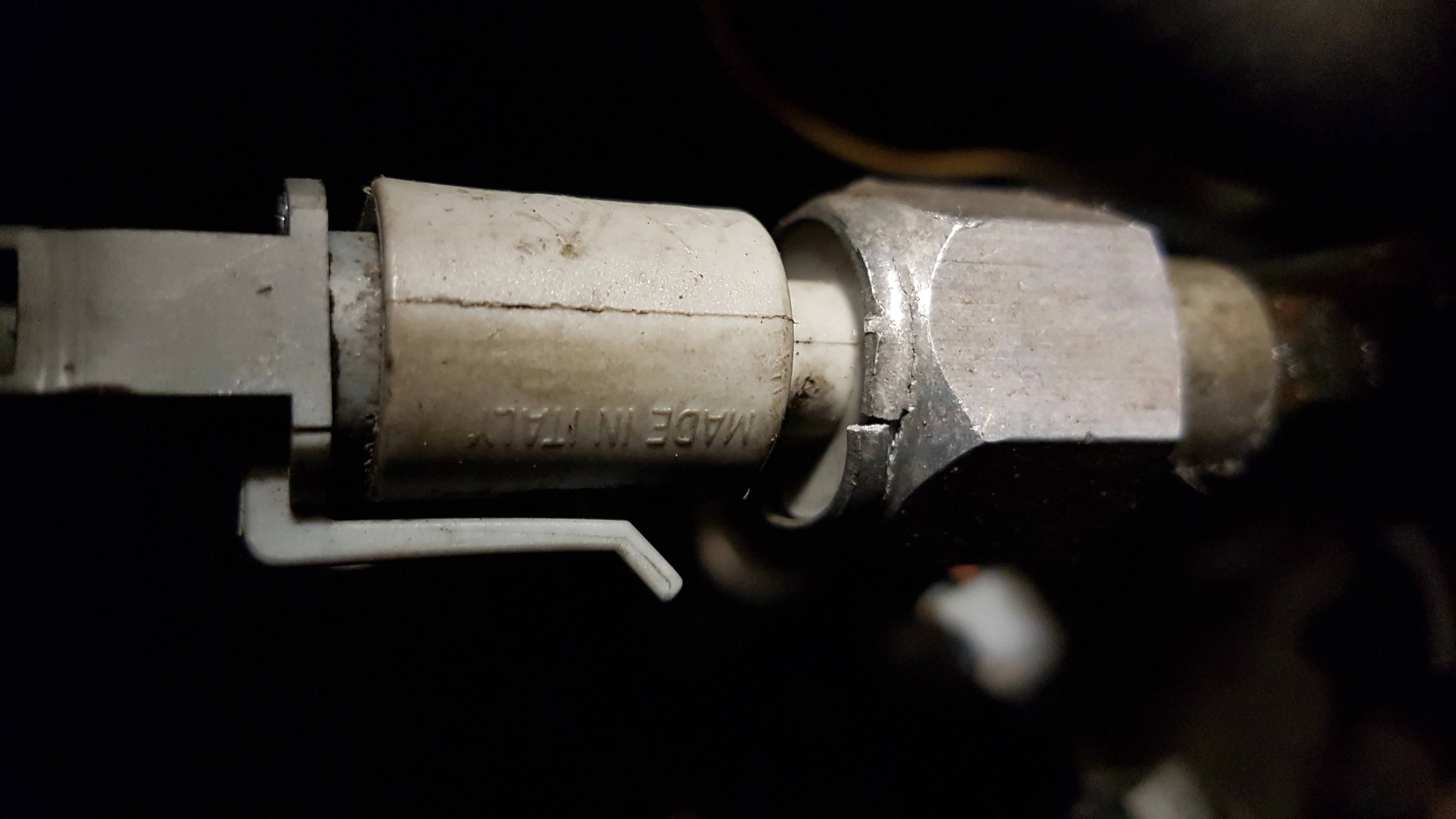

So.......uhh........well, I gave the pas sensor a clean to see what's what.
Umm
Yeah. Was wet after a few quick left-rights.
Scary bananas. Definitely trying to make a bit for freedom @STEVE.M
New one on way.

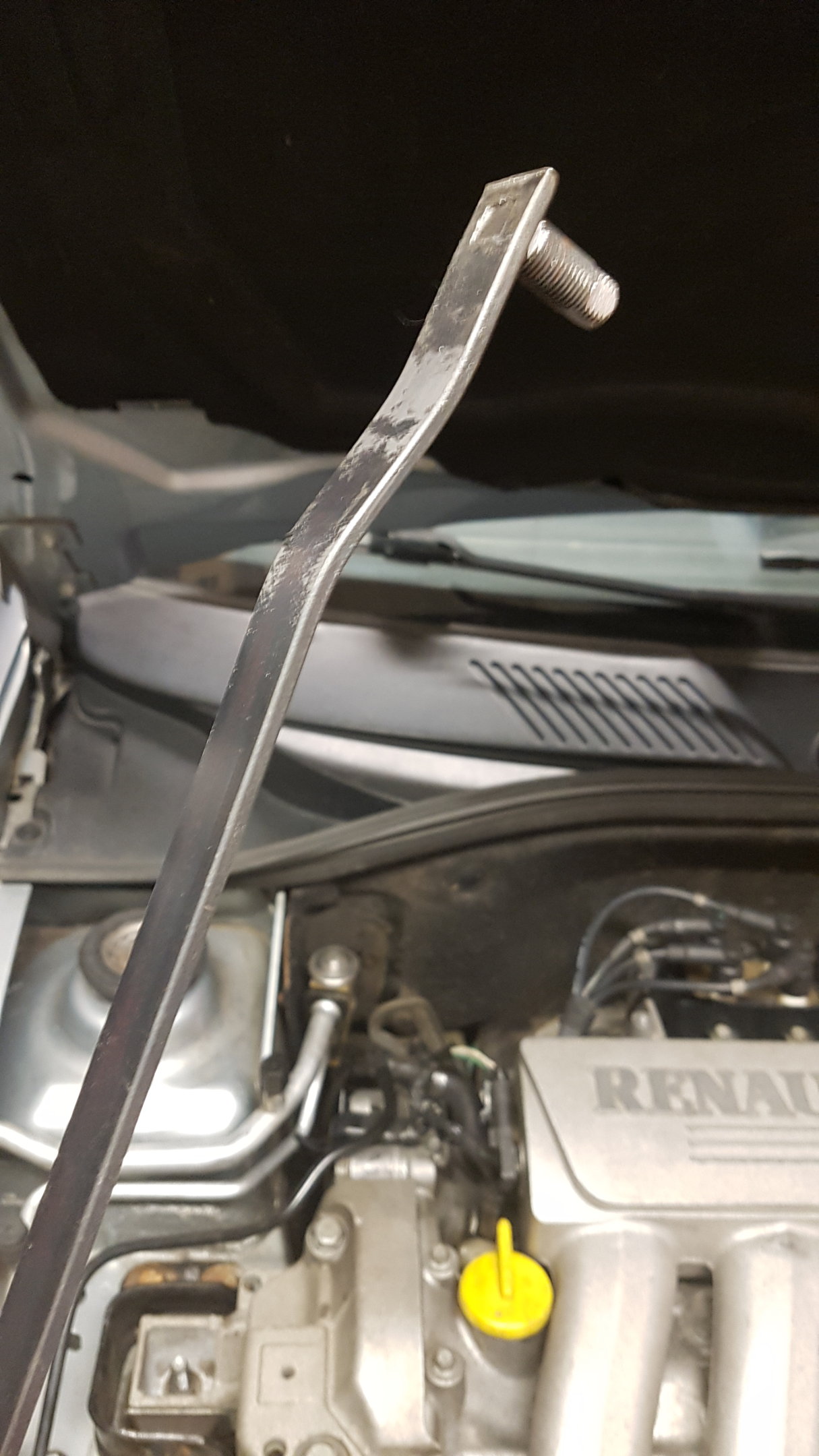

Also fairly proud of my hand-crafted-without-a-welder aux belt tool.
Just undersized a square hole in b and q finest hunk o metal and pressed a bolt that I ground to 10mm square into it with a vice.
Made a second 10mm fitting with a different angle as I couldn't work out which would work best.
Tinkering!
