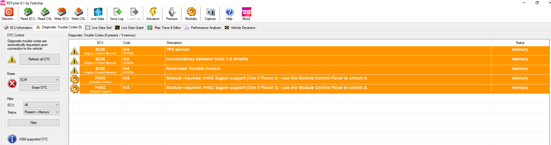

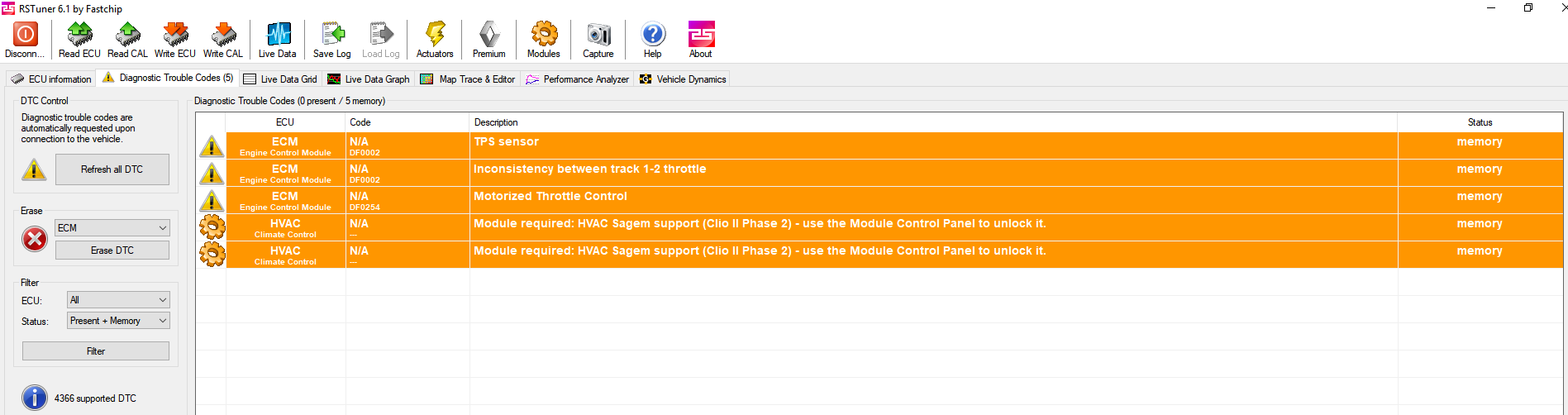

Hmm, happened again however this one left a historic entry in RSTuner

I`d start with the 90 pin ECU plug.
Servisol Super 10 seems to do the trick.
  2003 Clio 172
Ok. all connections pulled and cleaned where needed, given a good coating of the connection cleaner, allowed to dry and refitted so we will see how it goes.
Had a good old hoke around the cables too and can't see any obvious breaks or anything but I appreciate it would not typically be visible.
It was actually quite surprisingly clean in there with only the big 60a fuse showing a bit of corrosion. All relays etc clean as well as the white socket.
Also pulled the TB connection and gave it a clean, blow out and coat with the connection stuff.
