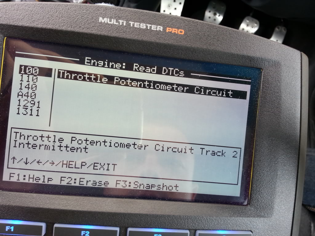

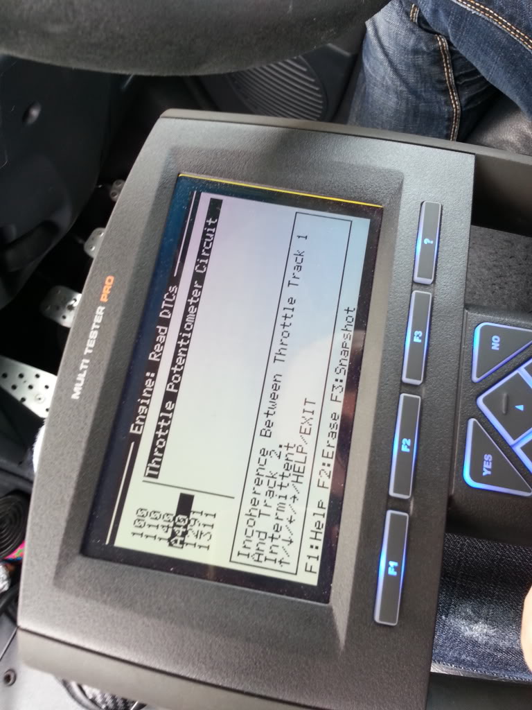

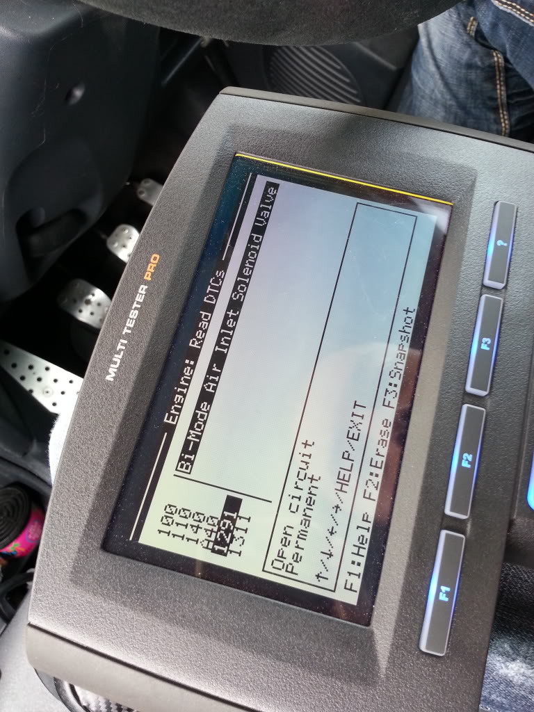

This is what the diagnostics computer said today..

It will be the difference between tracks 1 & 2 that's causing the reduction in engine speed and I will put money on it being neither the pedal or the throttle body. In fact, I'll go all out and say even money on it being a wiring fault in the engine bay loom section.

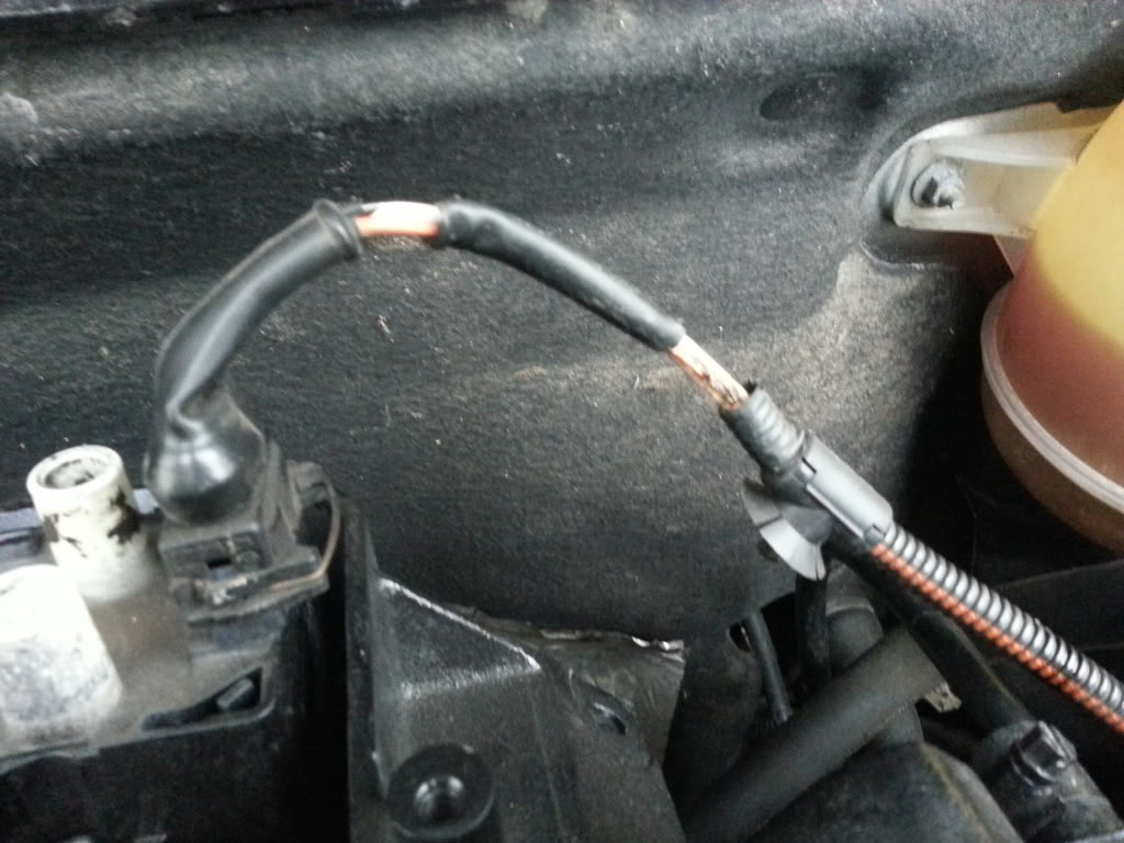

First thing i noticed was a HT lead was broken, so i got a set of leads.

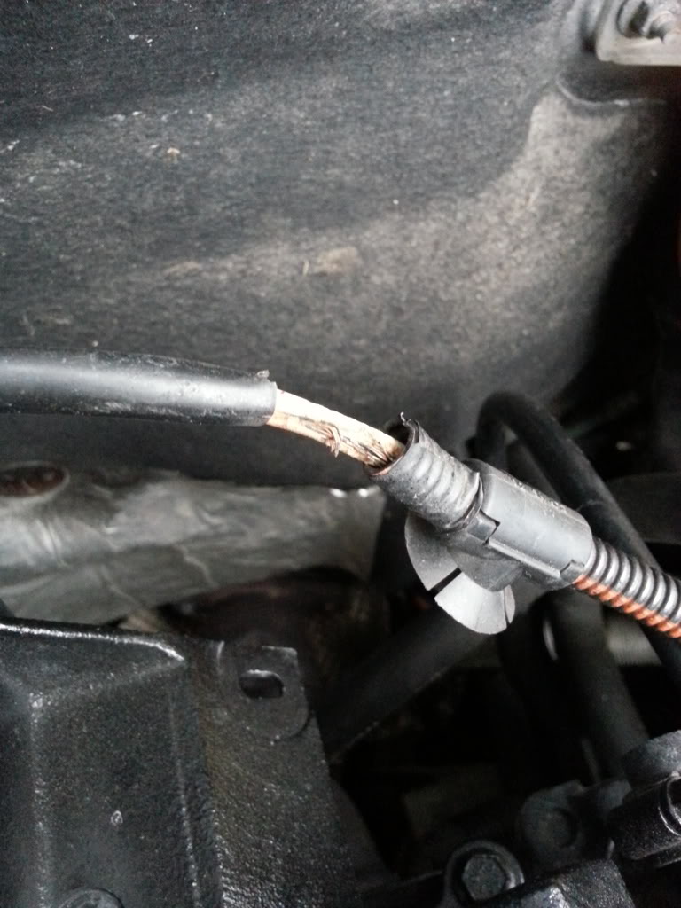

When changing the leads i noticed the inlet gasket was knackered so i got one and fitted that, when i fitted that i noticed the wiring going to the coilpack was damaged, the orange wire had melted and some of the strands had actually snapped.
So, ive replaced the leads, gasket, tried a different coilpack and i cut the bad bit of wire out and rejoined it with some connectors.
I had a good look at all the other wiring around that area but i couldnt see any other damage.
Do you have any ideas where i should check?
Thanks for the help!
Edit- this is the wire im talking about, not the best photos sorry.
  RS6+ & 40d MSport X5
Can you not buy that length of wire from someone that's breaking one? Speak to Fraser.

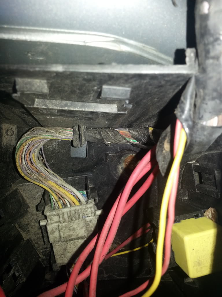

Liam, few simple checks to try In areas I have noticed are dodgy (French) points on these cars on the few cups I have had apart wiring wise.
Change the pedal for a start if you have one or at least put a spray of electrical cleaner or wd 40 into the plug as that's easy.

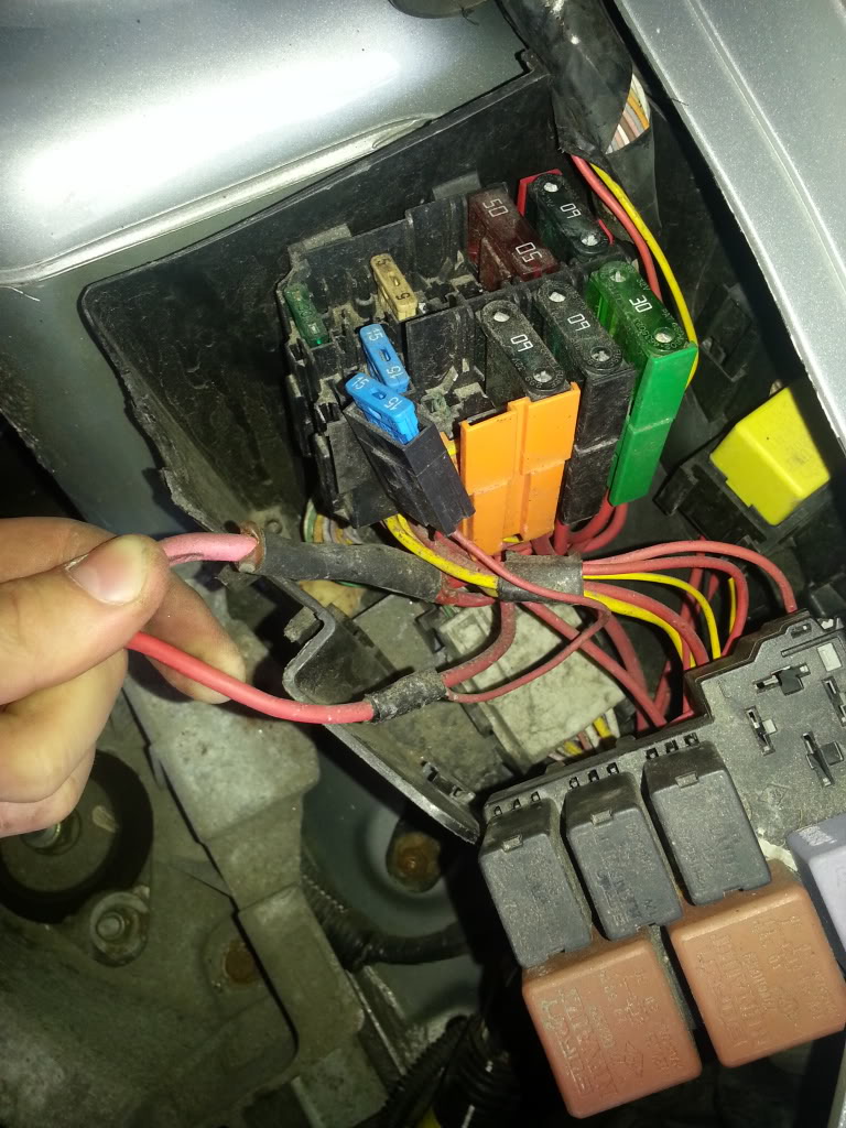

Cabin to engine loom connector, its under the scuttle panel on the passenger side, off with the wipers off with the scuttle panel and follow the wires from the engine fuse box to the car. You will come to a big square connector going into the car, unscrew the 10mm bolt, pull of the plug and check for any white/green corrosion or damaged pins (unlikely) , also a little clean or spray with wd 40 again.
Next one is the wiring loom as it leaves out the fuse box to the engine, take out the battery and removing any conduate or cable ties and check it hasn't been rubbing on the lower part of the fuse box underneath the loom.
Under the battery the loom also T's off in a few directions and the wiring is shocking in there, sometimes coiled up inside the conduate. Basically follow the wiring from throttle body to the fuse box while checking everything on the way and if any wires have went brittle/plastic like then take a note until hopefully you find a damaged wire of some kind.
Hopefully its just your pedal but the code does point towards wiring.
That should only take you an hour or two, it sounds difficult but all you have to do is use your 'enes'

LiamR172
Scotland - NW
I honestly dont know how someone can do this sort of thing day in day out!

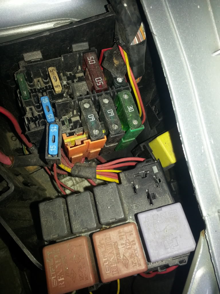

Is this a normal setup? It looks like a big mess to me, its all hanging together and stuffed into the fusebox.
MicKPM
ClioSport Trader
  Clio16v/Zoe Z.E.50
Looks about right dor a ph2 172 yes. I'm not talking to you anymore though as mine gabe me the squiggle box and reduced power this afternoon.
You're bloody infectious!
LiamR172
Scotland - NW
Fuses are pretty bad! Given them a clean now, just going to stick it all back together and see how it is.
Got a new air filter today aswell, last one was disgusting so i dont think that was helping :eek:
