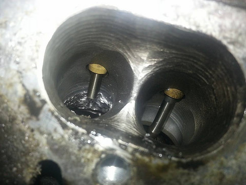

Damages silencer internals, increases the chance of exhaust valve failure and also appears to cause bore wash which shortens the life if the piston rings as well.

Have a look at my photo from my 182.
