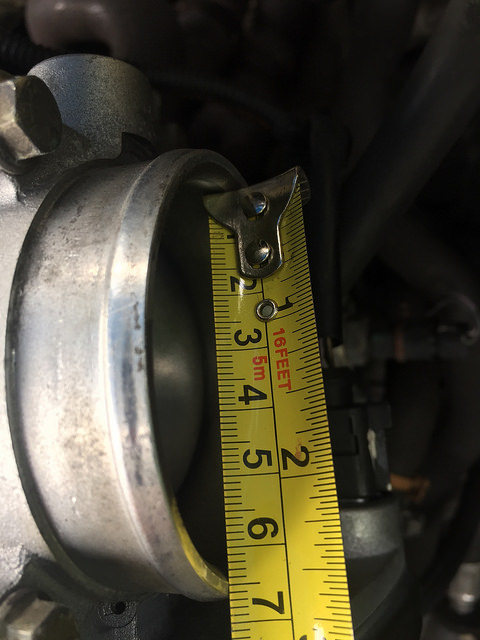

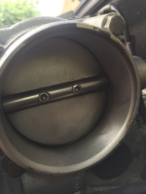

    Car:
    Clio 172 cup
    Measure the internal diameter of the throttle body by taking the inlet pipe off 64mm enlarged and 60mm standard plus you can usually tell if the body has been machined anyway , everything your describing is what these enlarged throttle body's do to these clios , it won't be your map if it has one

    Ok so just to update this a little, rev limit seems to be at an indicated 7500 on the tacho and below is my throttle body so I would guess the next step is to source a standard one and then see how it behaves with that fitted.
    Racing blue
    by Edd Charlesworth, on Flickr
    Racing blue

    Haha I was actually right for once
    Ye put a standard throttle body on that should stop your issues
