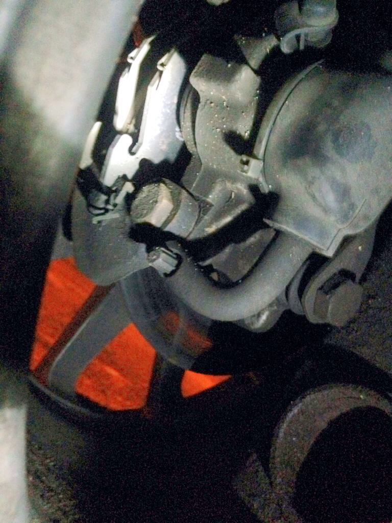

I've taken the two 17mm bolts out, these ones -

Your caliper is seized on the slides or partially seized, you do know it slides on the two opposing bolts from the ones you have circled.
I did have the handbrake off, and the caliper moved smoothly on the sliders, I took the carrier off to check and it moves a fair bit, it just needs an extra 10mm!
I wound it in until it literally wouldn't budge, it's starting to annoy me now and the weather is so s**t I can't even walk to the car without getting f**king soaked let alone do anything to it.

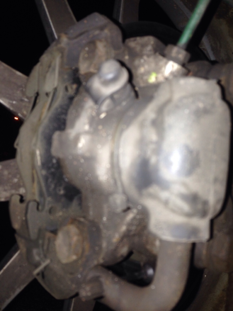

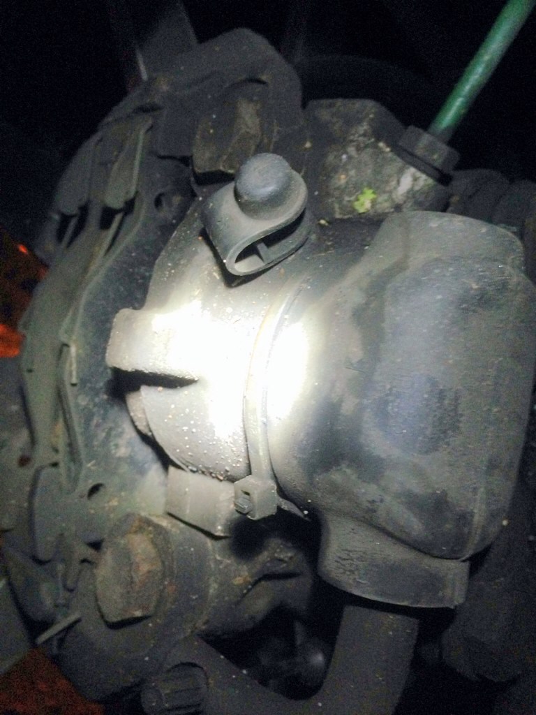

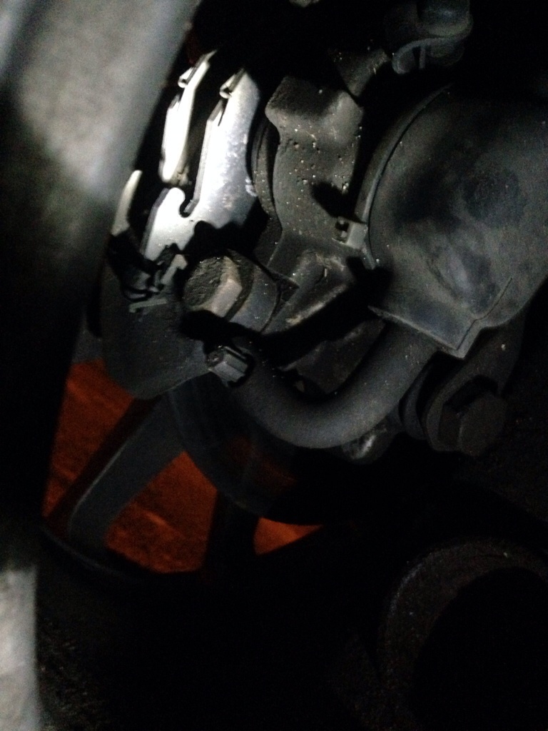

Right well there's no chance of getting the wheel off as there's no space outside to jack it up and the cars on a sloped drive, but these are the best I could get I'm afraid.

hmmm its definitely a strange one.
im guessing you got the washer from him as well?
are you also getting full movement on the sliders??
Yeah got the washer from G as well. I suspect it's the sliders but I'll get a pic of how far in I can get the piston when it won't wind in any more, and how far the caliper slides both ways.
