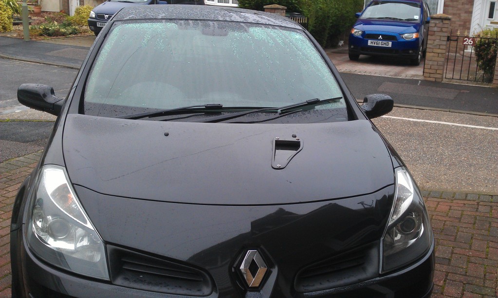

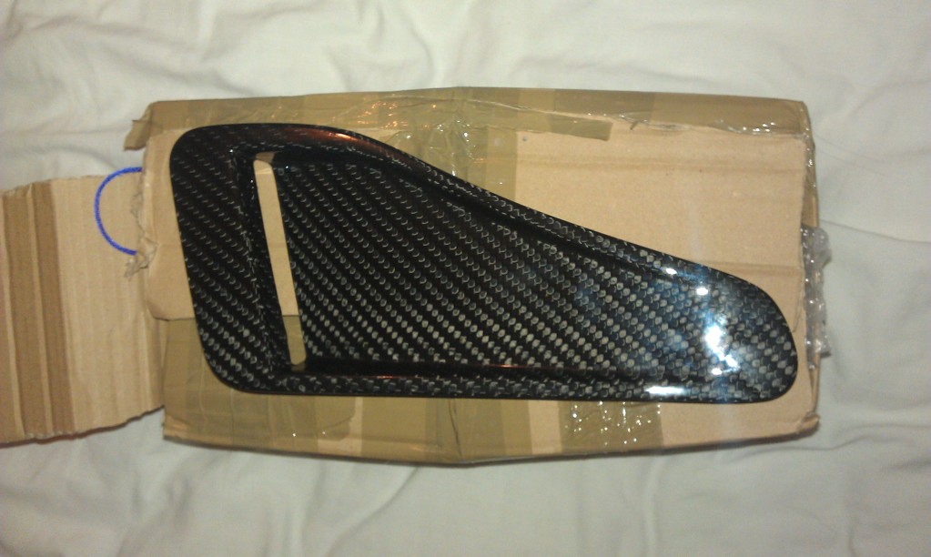

The vent is needed to get cold air in, the vent is in and looks better than maybe you might think.
It hasn't been mapped yet, this Friday ktec. Still on 0.5 bar boost ATM, ktec will change that I'm sure.

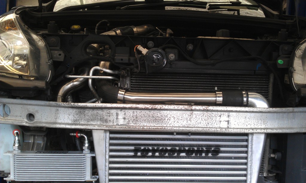

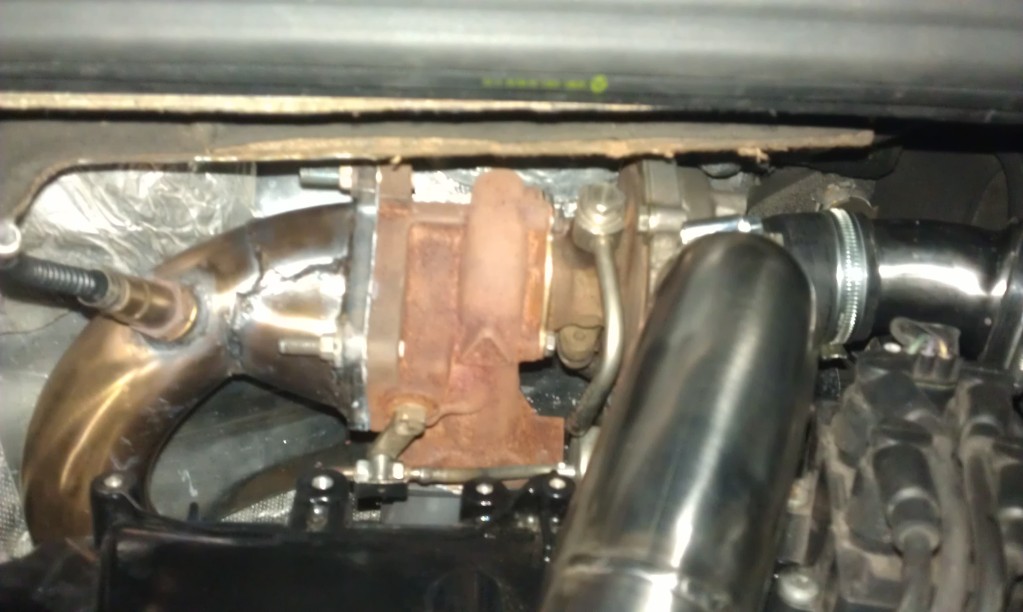

Oil cooler needs plumbing in once I have the correct oil feed pipe, 182 injectors in on Friday and boost control valve.

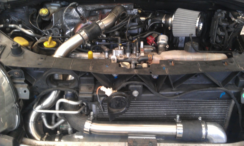

Behind the headlight... Do headlights have holes in them these days.... The filter is perfectly in line with the vent, how is this not as good as behind the headlight...
  Clio tce
i personally dont think you'll be getting much if any improvement with that. you would have if youd made the filter behind the headlight and sectioned off the bay.
And relocated the battery to the boot as it is in the way, this was discussed but means interior out etc etc vent is perfect for where the filter is now.
What would improve things is raising the bonnet off the seal at the back to allow hot air out.
Behind the headlight has a pretty infinte air supply from behind the bumper, thus cooler anyway. Battery relocation doesnt involve interior out atall. My LCR ran the filter on the inner wing with a heatshield. and with a Glowing turbo and manifold intake temps didnt go above 25* on the rolling road, I did see 12* in the middle of june when using WMI
no the headlights dont have holes in them, but what they do have is a force feed duct forcing air into the area behind them, forcing all the hot air out of the engine bay, your filter is currently situated under a vent, above the hottest part of the engine with the vent circulating all the hot air around the filter.
  Clio tce
Thanks Martin you are incorrect it is not over the vent at all. the vent is in front of the filter the air flow is directly onto the filter through the vent... When the bonnet is raised off the seal at the back the hot air will flow out. Keeping temps down and cool air coming in. The hottest part is centre left, as this is where the turbo and down pipes are, the filter and vent is over the left away from the hottest parts.
