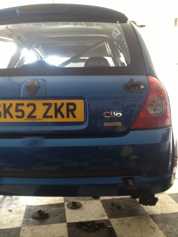

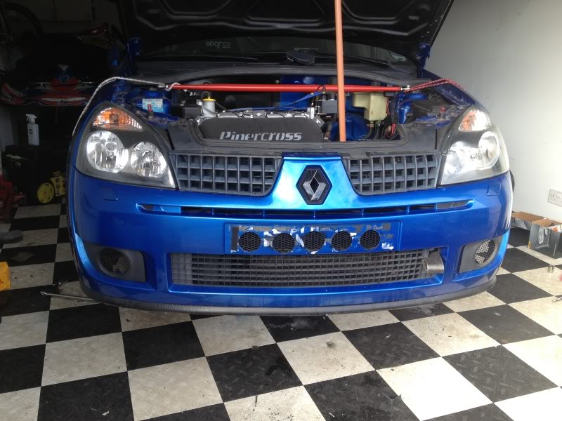

Had a couple of hours on the Clio today to hopefully get it ready for a trackway at the weekend, all the old suspension removed and went to fit camber shims to the rear only to find out it has some fitted:).
Fitted a rear tow strap
Vented the front bumper

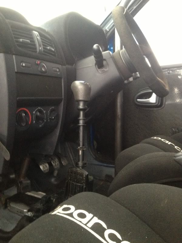

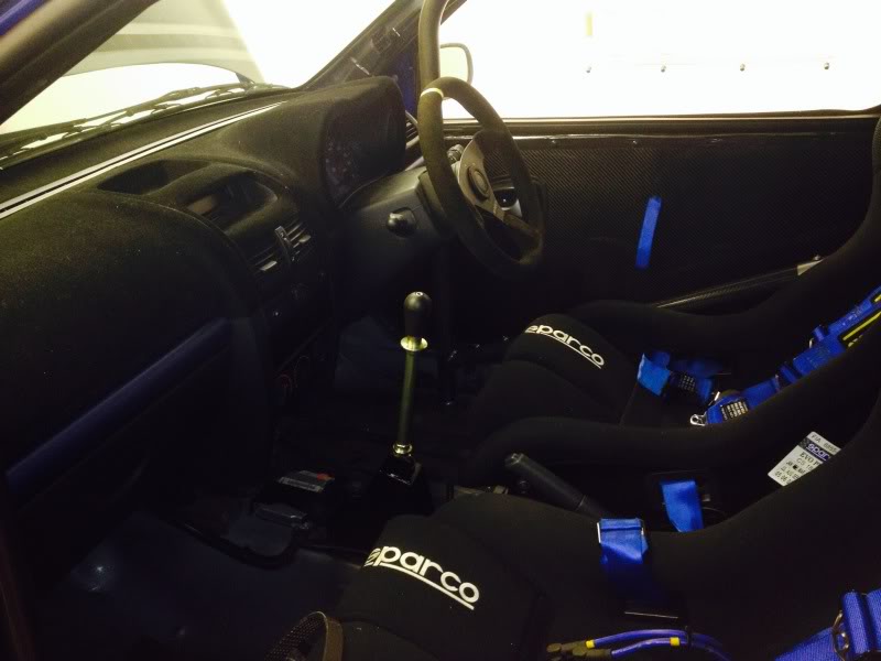

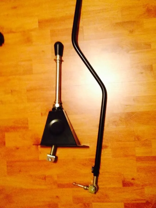

This is a better pic of the megane shifter in 1st gear to give an idea of position.

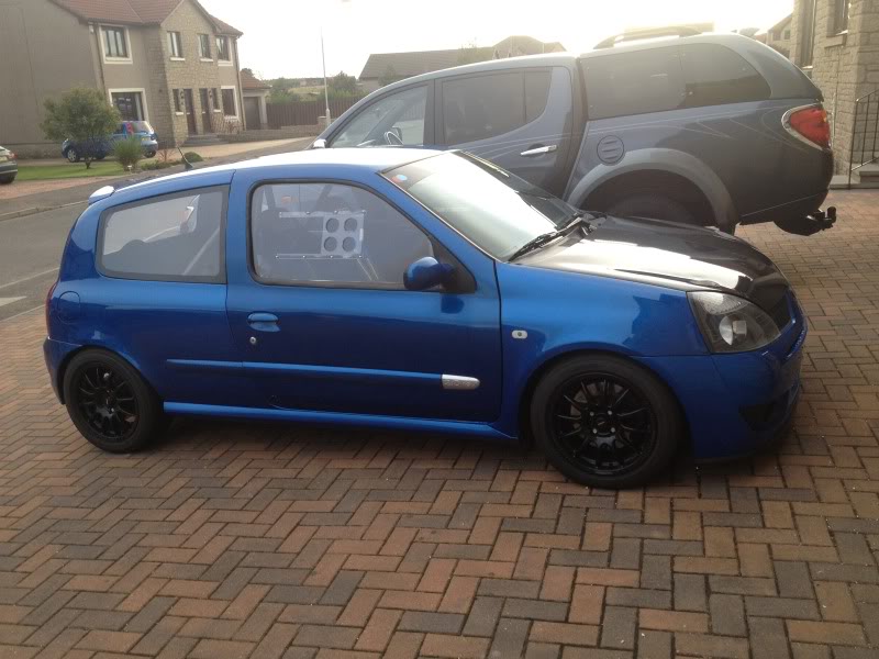

Got new coilovers fitted and alignment done, I've went for -2.5 camber and 10min toe out justnow and will see how I get on with that tomorrow at knockhill.
So gave the car a quick check over and loaded up the truck with wheels and tools ready.

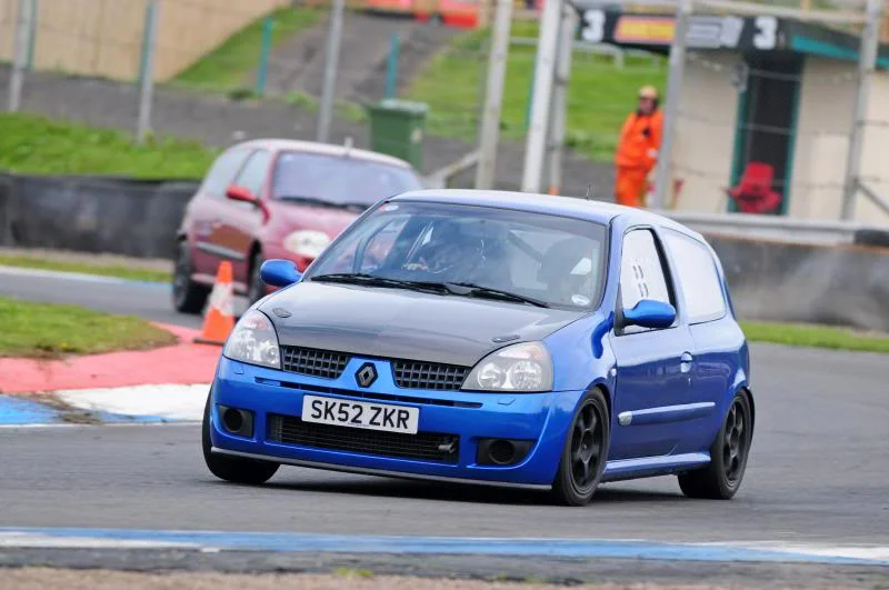

Couple of pictures from Saturdays open pit morning at knockhill.
Car was faultless all day drove it there did 6 track sessions including a couple of 30+ min sessions, changed the wheels and drove home :approve:

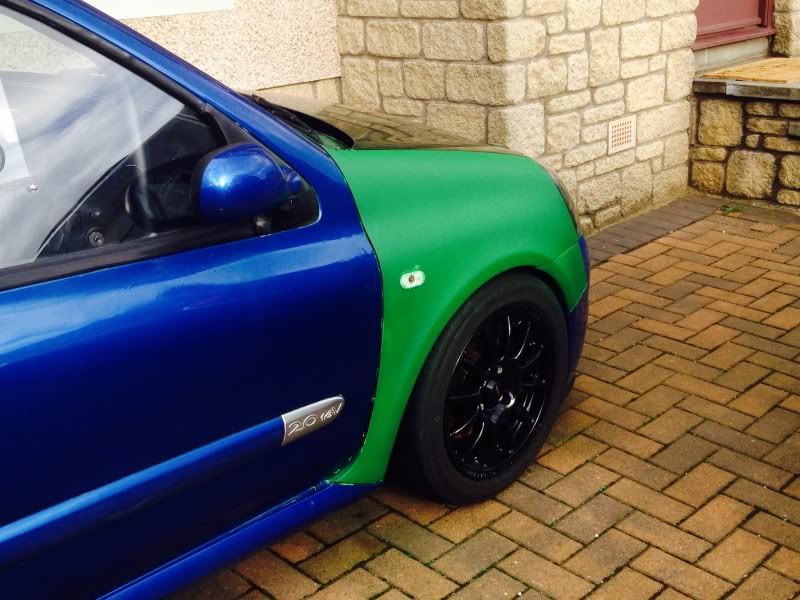

I also picked up a spray tin of bright green plasidip to try as fancy doing the car green with grey renault sport graphics next year, not sure if I like the finish as its a Matt look so may have a rethink about a wrap or paint depending on £££.

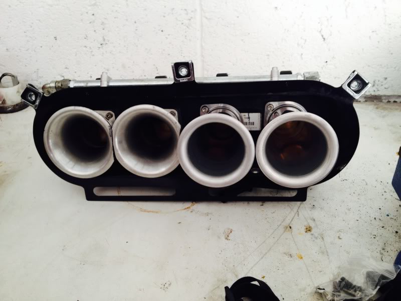

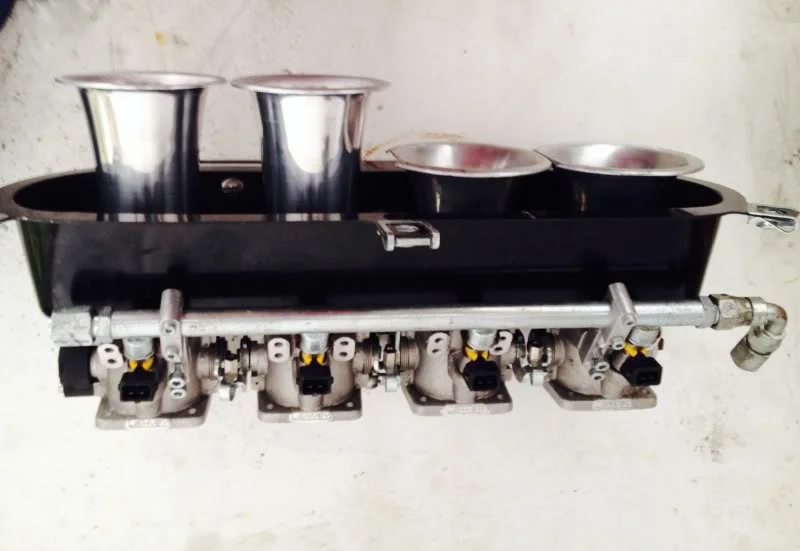

First of the new parts arrived.
120mm compared to old trumpets.

The plastidip colour is growing on me with some anthracite colour graphics to break it up a bit might work. I've peeled off the section on the bumper that came off cleanly in once piece, I've also tried the wing with a pressure washer and did not get any peel.

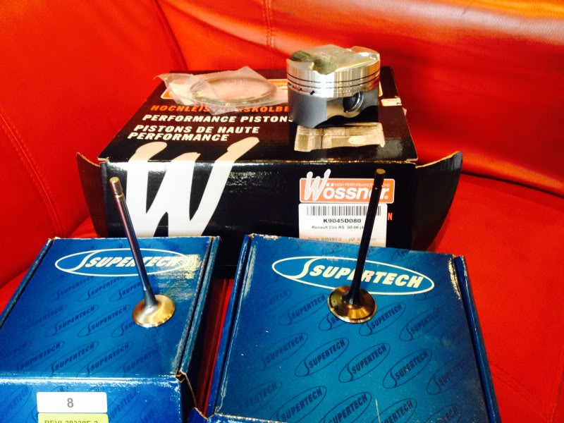

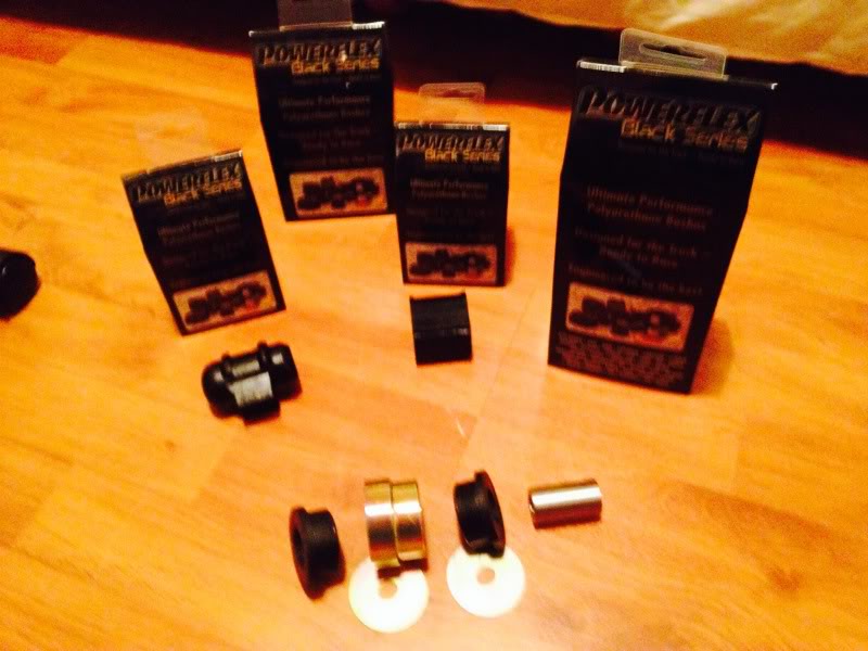

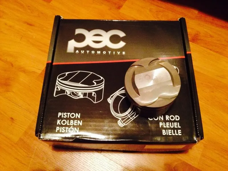

After a mix up with the wosners pistons being the wrong bore they were sent back and I got a set of pec pistons which needed machined to the required comp ratio. I have went for 12.8:1 to keep things safe on available pump fuel, this week I also received my pure Motorsport shifter and a full set of black series bushes for the front end to be fitted with the roll center correction kit.

Liking the mods, I'm still trying to find the time fit my PMS shifter :-s
Where did you order your black series bushes from, after some myself but I remember reading somewhere in here that powerflex had to revise them - or something like that?
neil a
Re: Road/Track 172
I got the bush kit off of ebay, didn't know about the revision ? Only change I heard of was the the metal sleeve as they no longer need welded in.

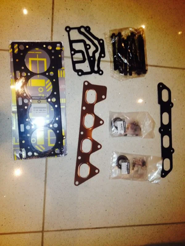

Ordered a head gasket set , head bolts and also a set of cat valve springs, so hopefully now have everything ready to build the engine but going to be away with work a lot over the next 3 months so could be slow progress.

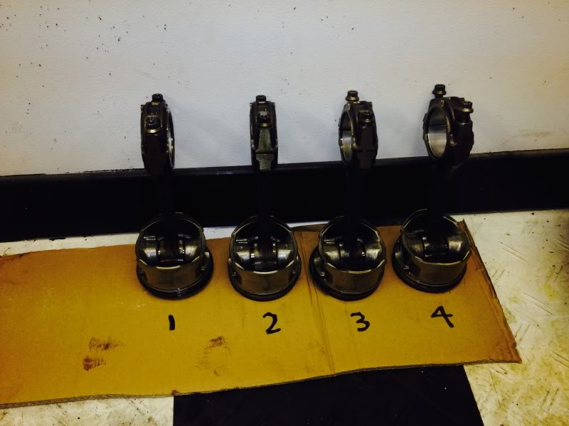

Today's progress.

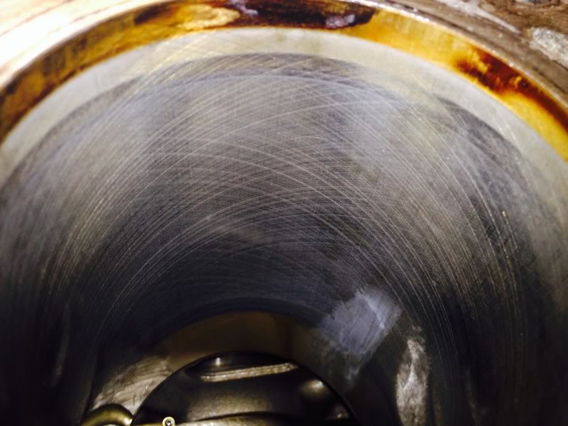

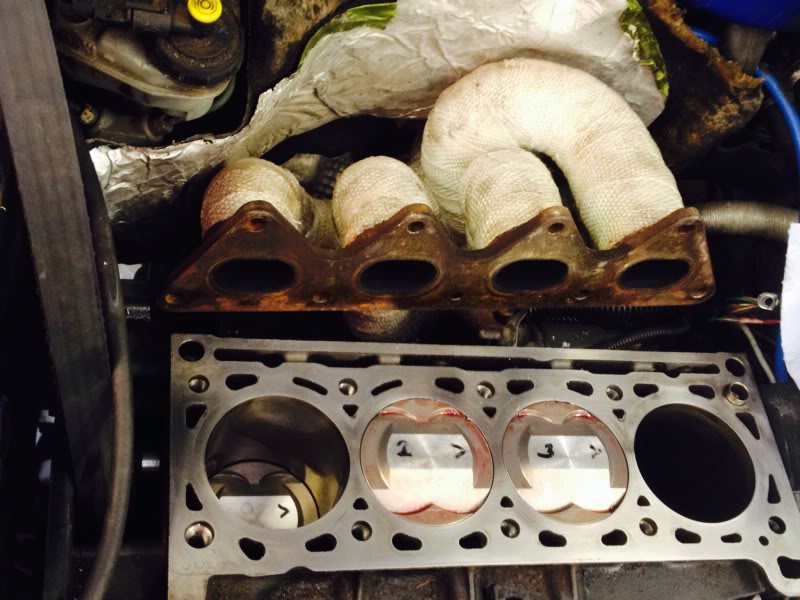

I got the head off and bottom end stripped, really happy with the condition of the shells and bores they are both like new. There are no lips or scores in the bores and you can still clearly see the original honing marks.

Got the bottom end almost built up but one set off rings were the wrong size so Dave at PEC is sending out another pack. I was shocked at how high the pistons sit and intrude into the head, but this is the first high comp engine I have had in bits as use to turbo cars.

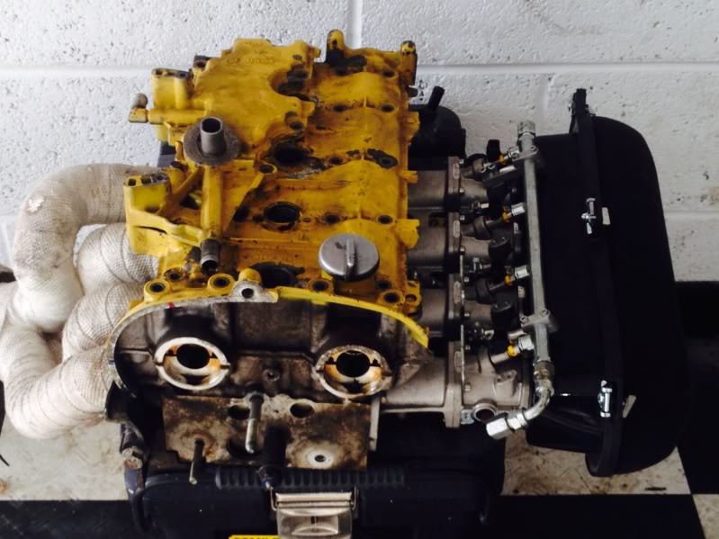

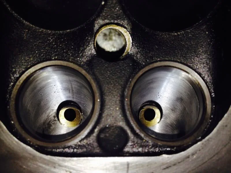

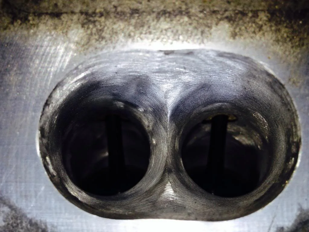

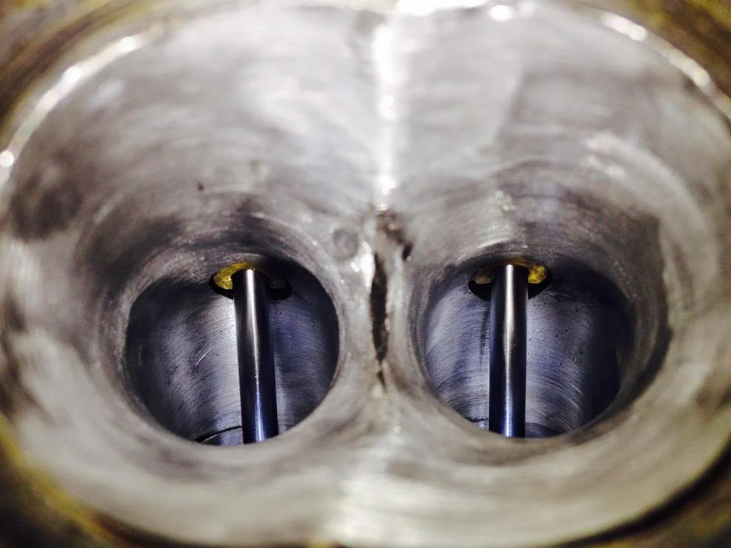

Bit of a boring update as been away with work so not got much done, I have finished the bottom end build and hope to pick the head up on Monday as its nearly done. I dropped off some uprated cat cam springs and valve stem oil seals today , and got some phone pics of the head work so far.

How much did the pistons set you back if you don't mind me asking? £800 odd?
what power figures did you have before with the cams and bodies?
neil a
Re: Road/Track 172
I'm sure the pistons were around £400 , then. £40 to have them skimmed to drop the compression down slightly as they are 13.2:1.

I just cc the head and skimmed the pistons going by the chart supplied with the pistons James.
It should work out at 12.8:1 but if it turns out to be over that and I get problems during mapping I have the option of the .85 gasket to drop it down to around 12.3:1.

Hi, following with interest, how did the Megane gear lever work out ? I like the idea of a slightly longer gear lever but all the megane ones I can find seem to be cable operated.
neil a
Re: Road/Track 172
It was very good on track it was 100% better than the standard one, I've only switched to the pure one as I liked the look of it :cry:
Against the pure gear stick the megane one is about 2" shorter , I will be selling my megane stick complete with yanoo stiff shift once I've tried out the pure one.

Picked up the head and jenvey inlet at lunchtime and set about fitting the head, and getting it timed up. Due to the porting I have lost the o ring on the jenvey manifold as it had been opened up and matched to the head, luckily I had a new inlet gasket with the head kit I bought so opened it out slightly and fitted it.
