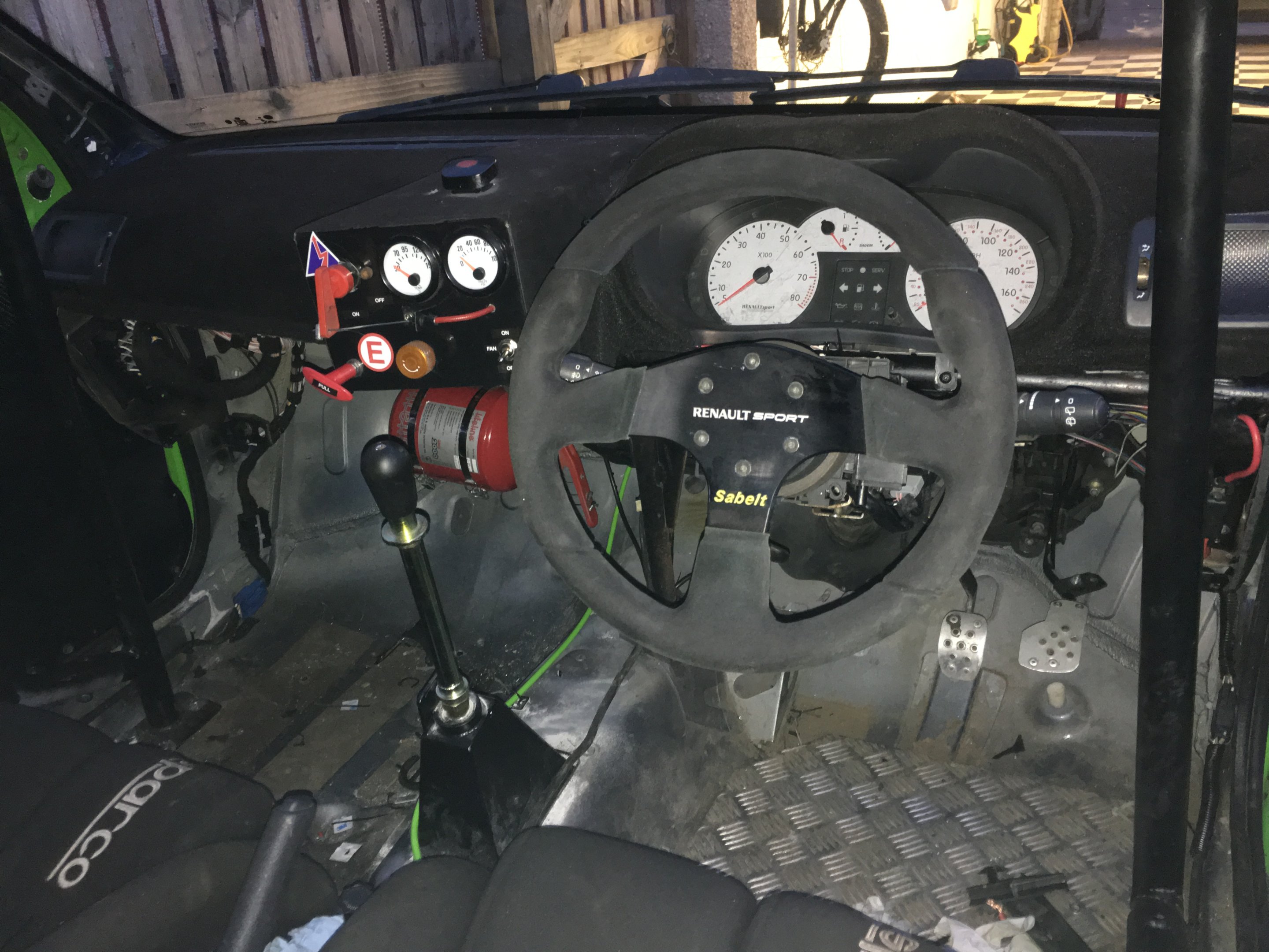

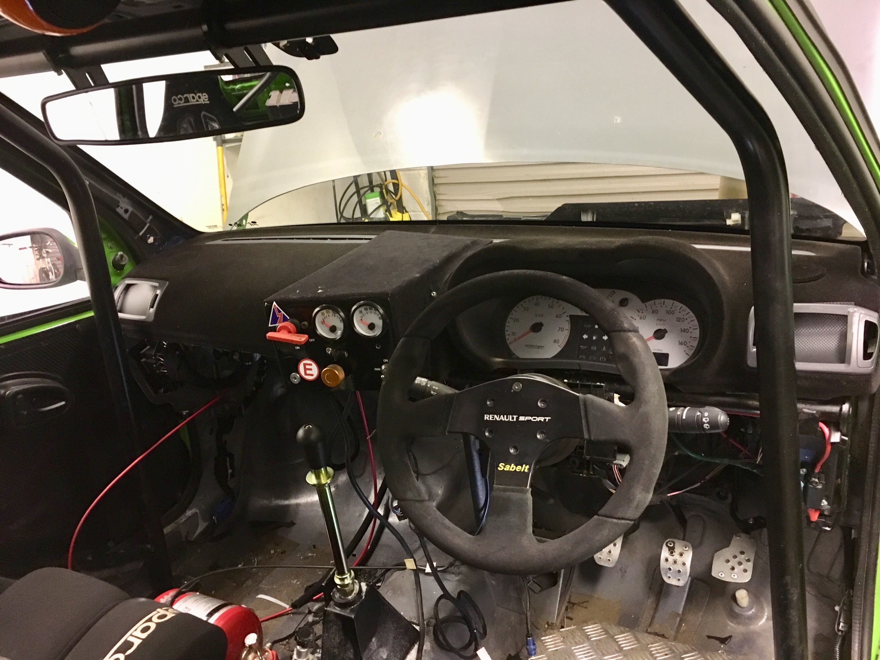

A little more progress made today.

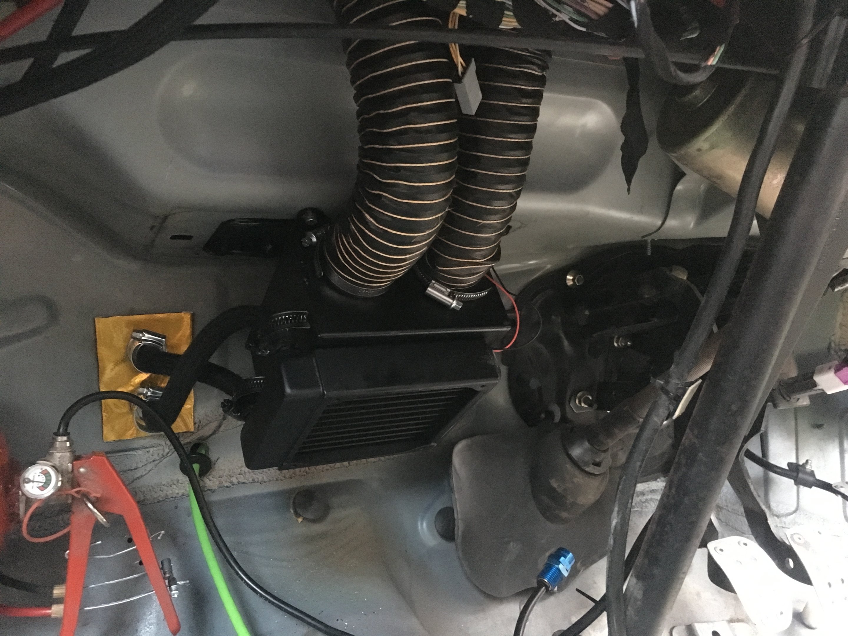

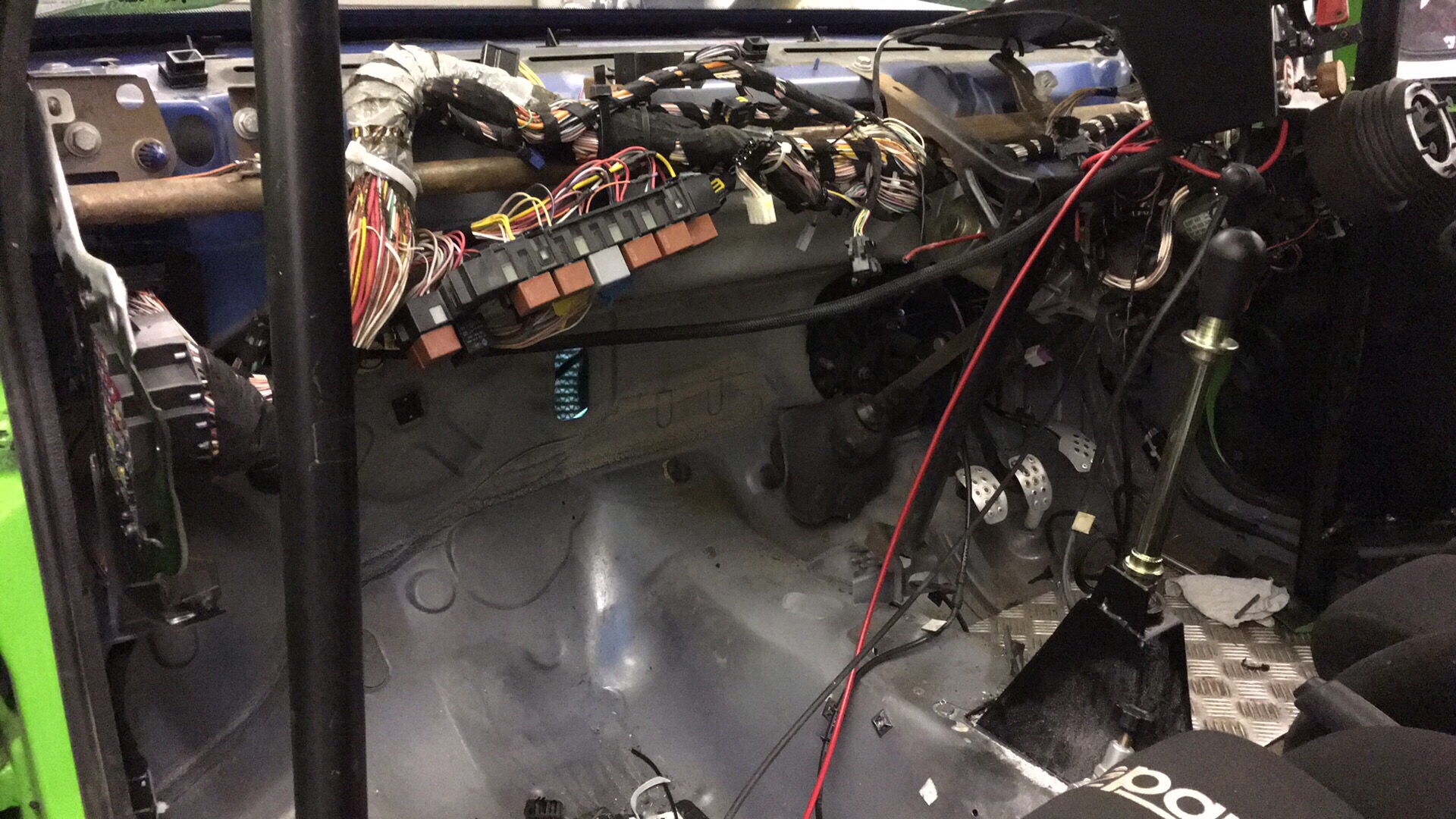

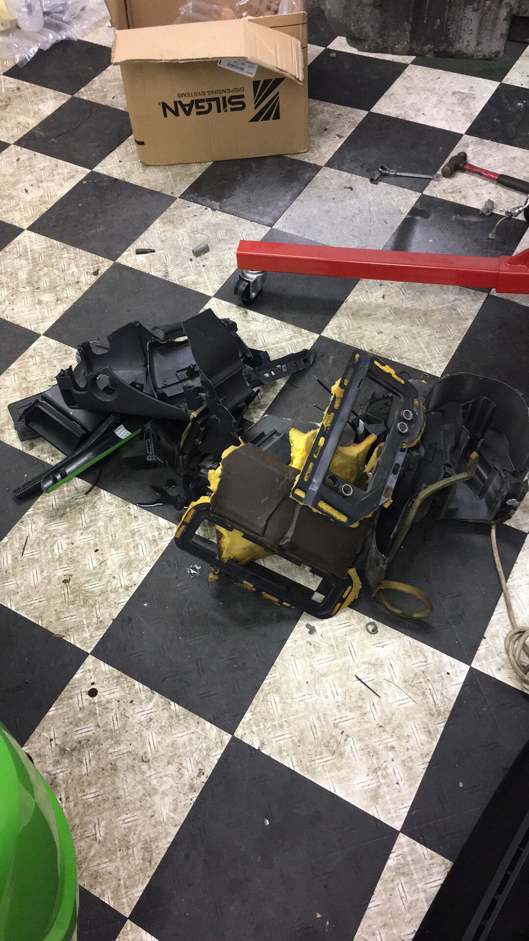

I removed the heater blower and box ready to fit the little electric blower.

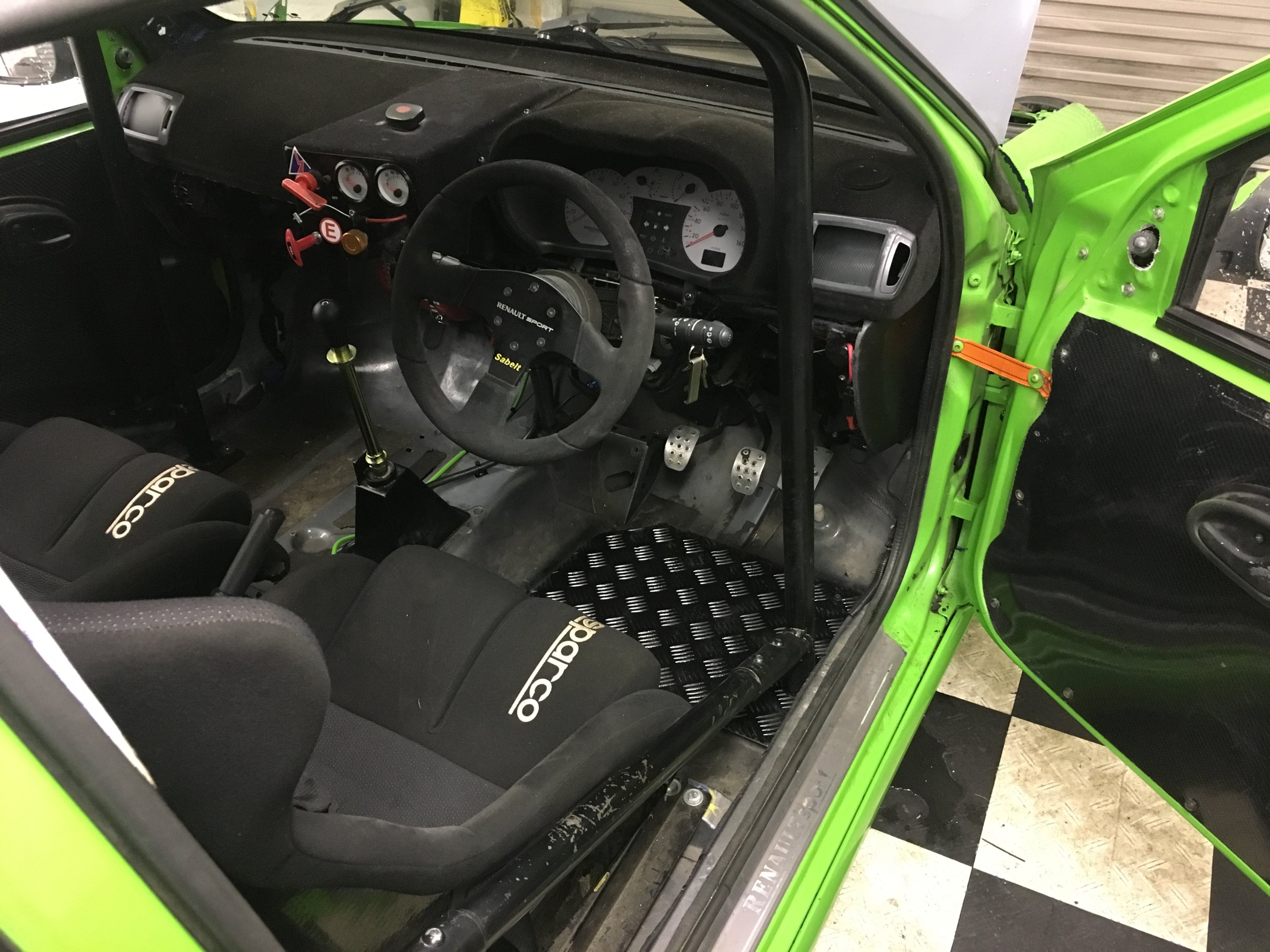

Then started to re fit the dash along with pod/ kill switch / gauges.
While I had the dash out I gave the flock a spray with suede die as it had started to fade in parts. It came out well so decided to do the steering wheel aswell as the blue really didn’t go with the colour of the car.
Still a bit of tidying up to do but it’s getting there, ideally would like to trim back the loom a lot but that can wait until next winter.

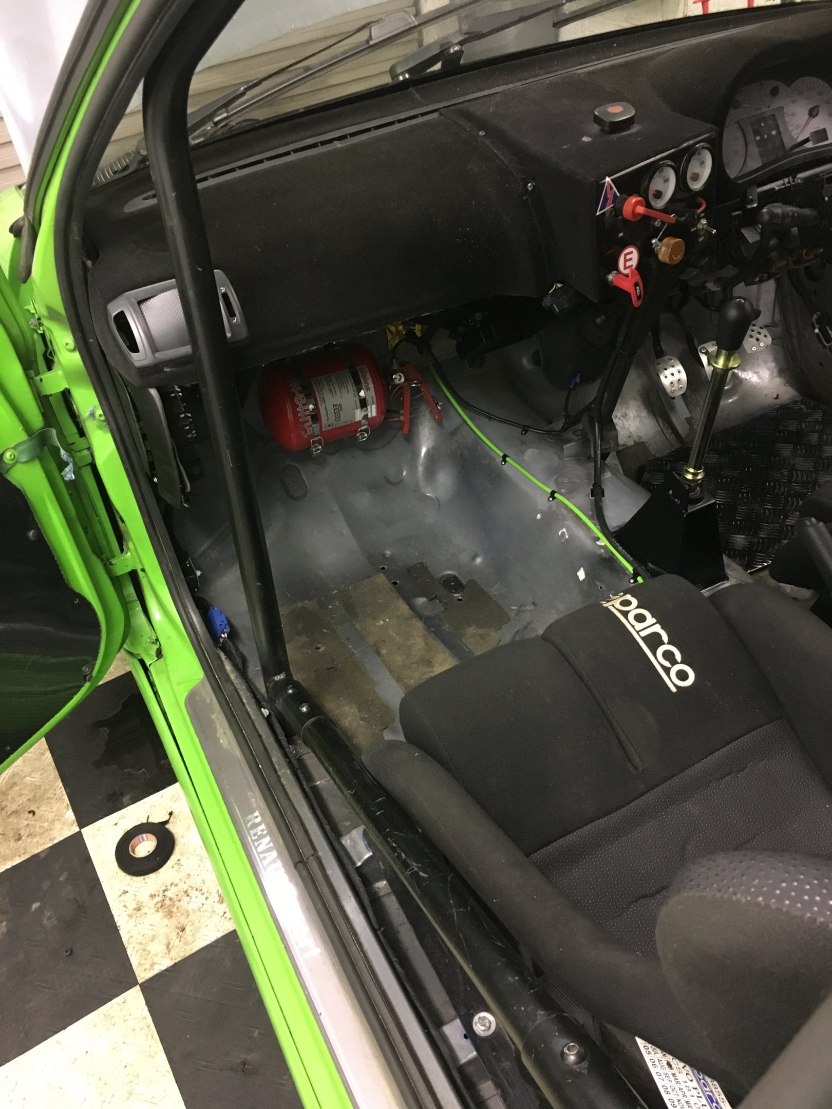

Got most of the inside completed today moved the fire ext to the front of the footwell, so just the battery to move and clip in the power cable.

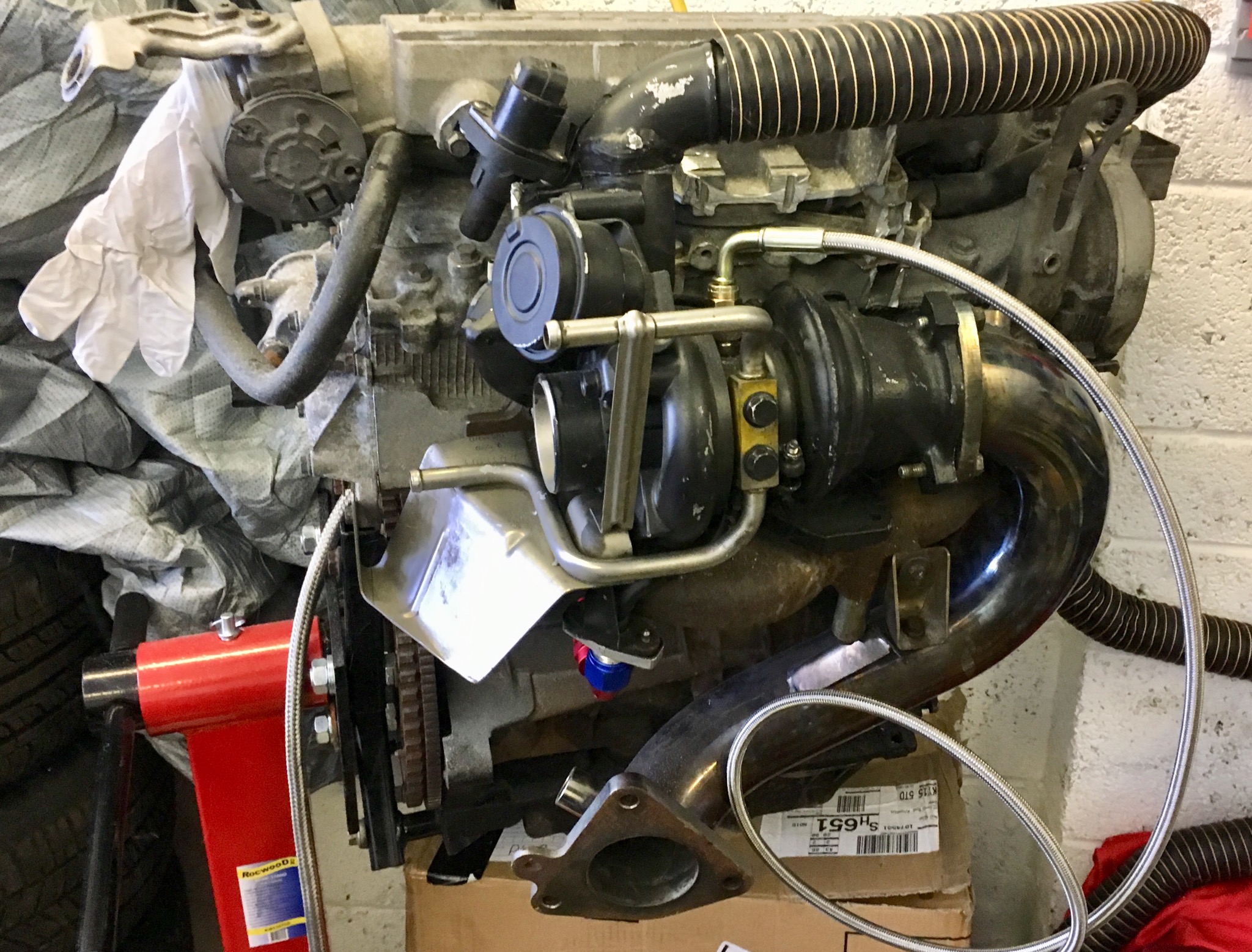

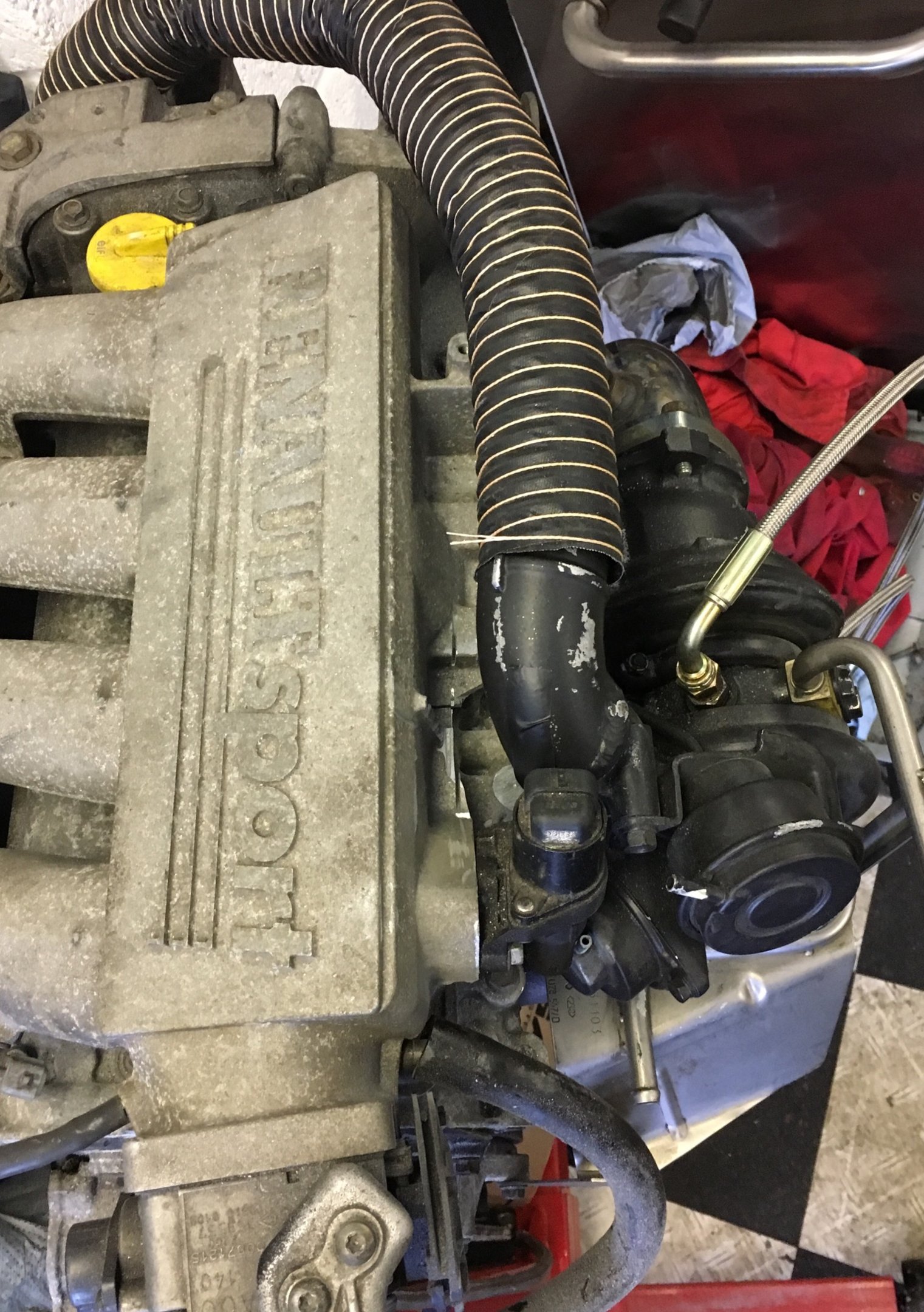

Also started a mock up of the turbo in my spare engine , I think with a few small mods the standard inlet should fit with the 225 turbo

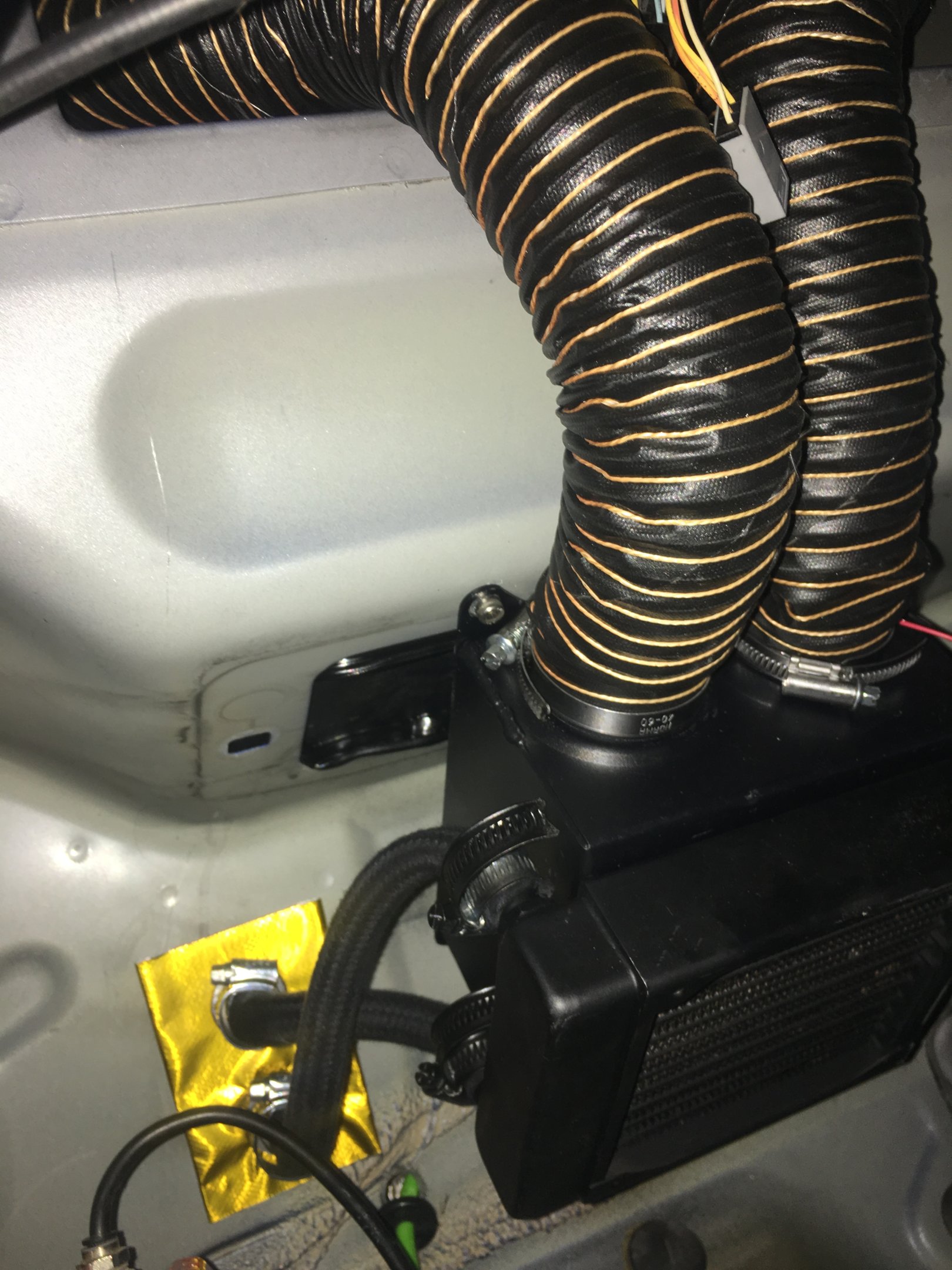

Which electric blower are you getting? And is it just a cold air blower, or is it heated?
The heater has been removed in my track car and the screen keeps misting up - have been looking into options...

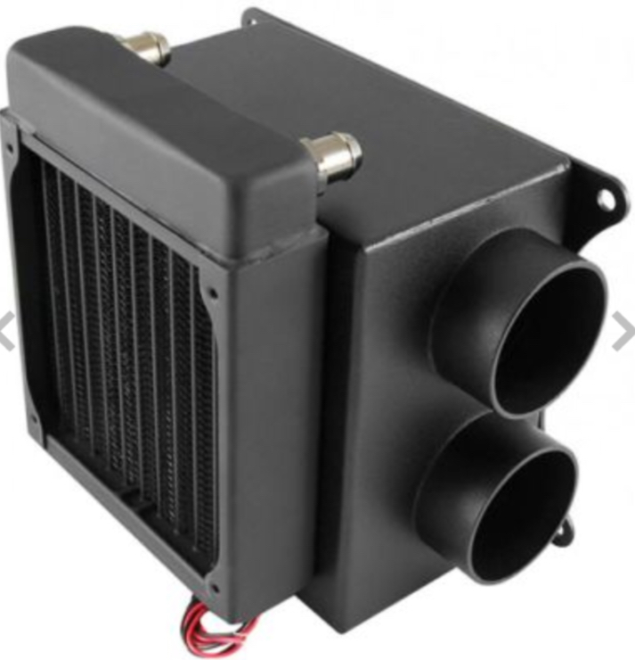

I’m using this heater I have blanked two of the outlets and ducted the other two into the original feed hole that feeds towards the screen. I got it plumbed and wired today and it seems to move air well but is loud.
  16v UK Cup Race Car
Can you post pics of how you've mated the ducting into the feed hole please?
I spoke to T7 Designs yesterday about doing the same...

Not much progress this week due to “the beast from the east”

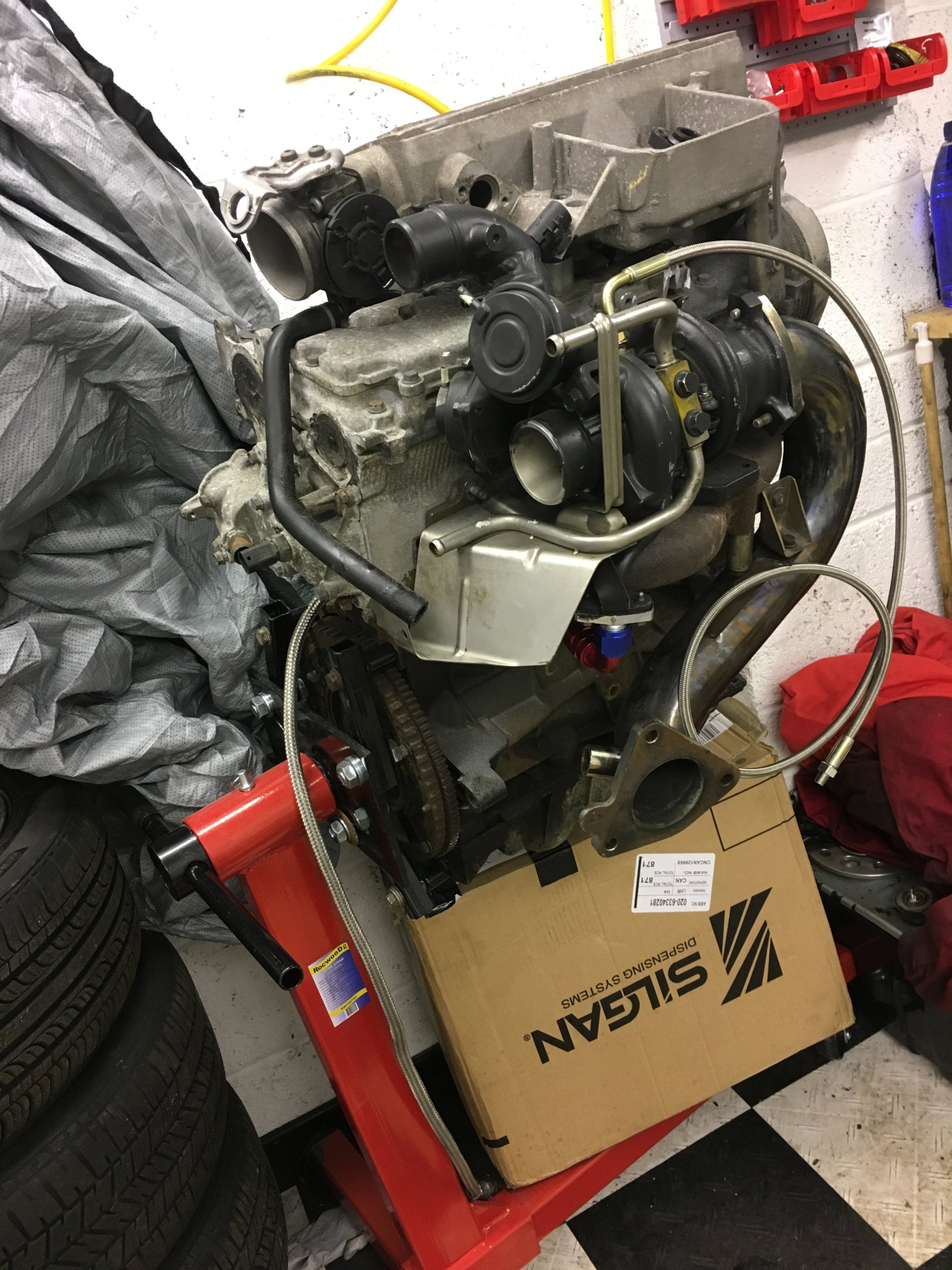

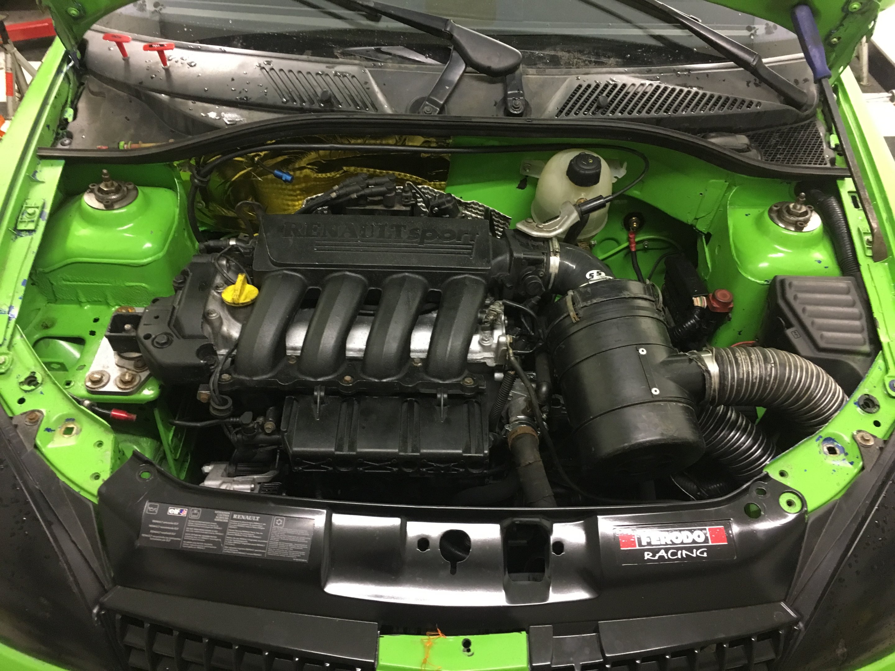

Did make a bit progress on the turbo engine , by removing the coil pack mount and rotating the turbo outlet. Should ideally make pipe runs short to the cooler.
Flexi ducting just used to check clearance.

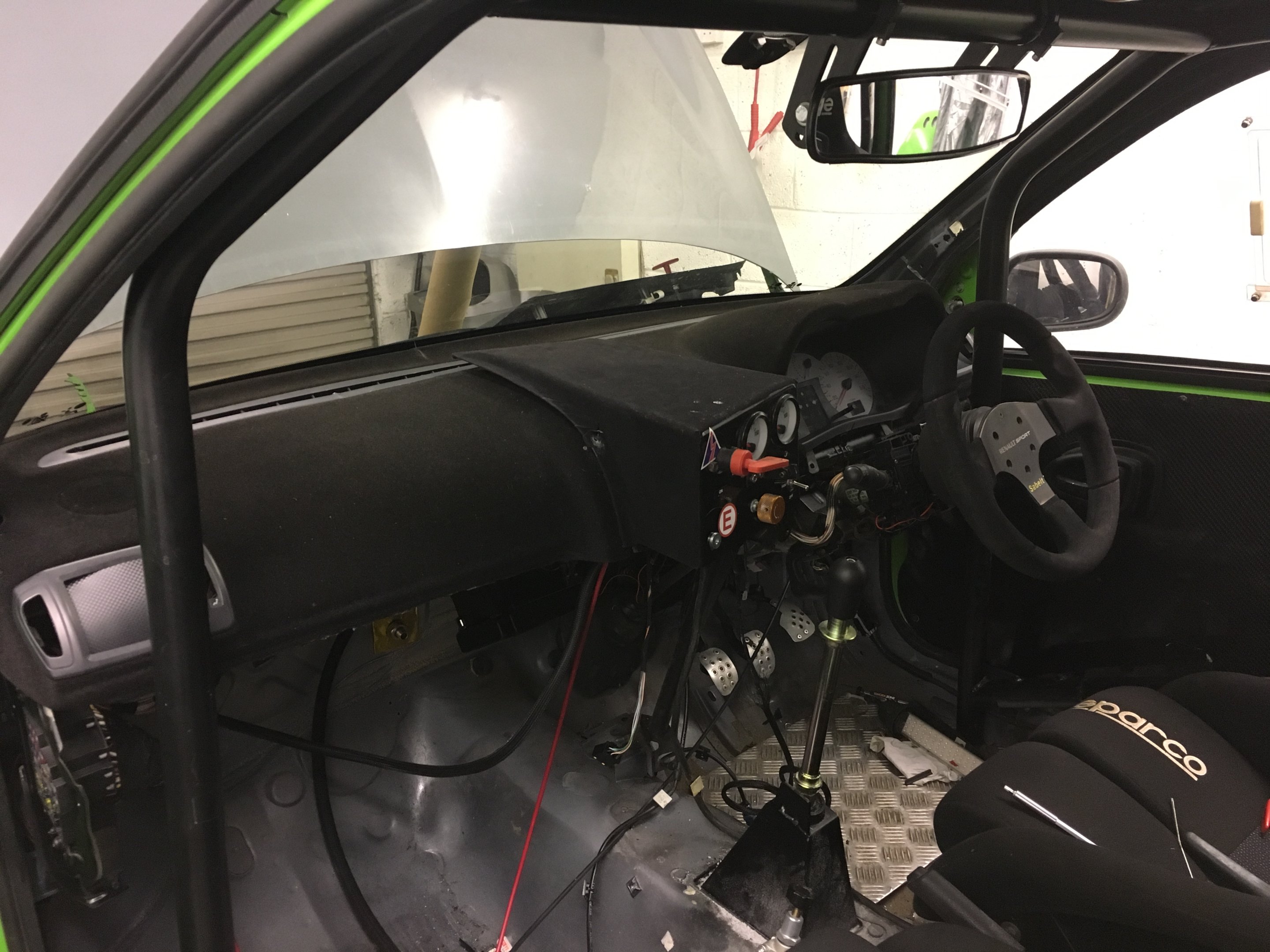

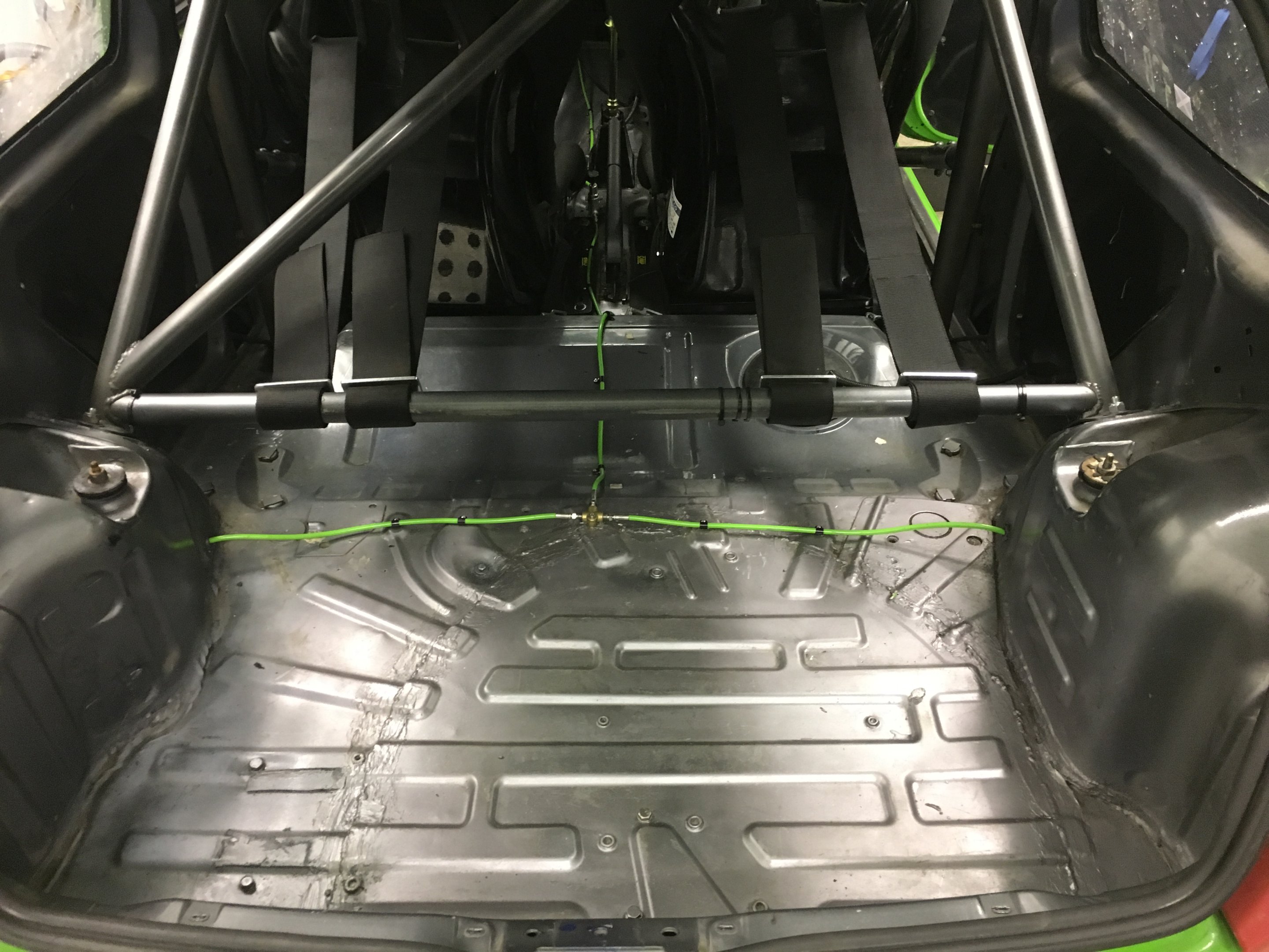

Bit more progress made today.
PMS rear roll bar fitted.

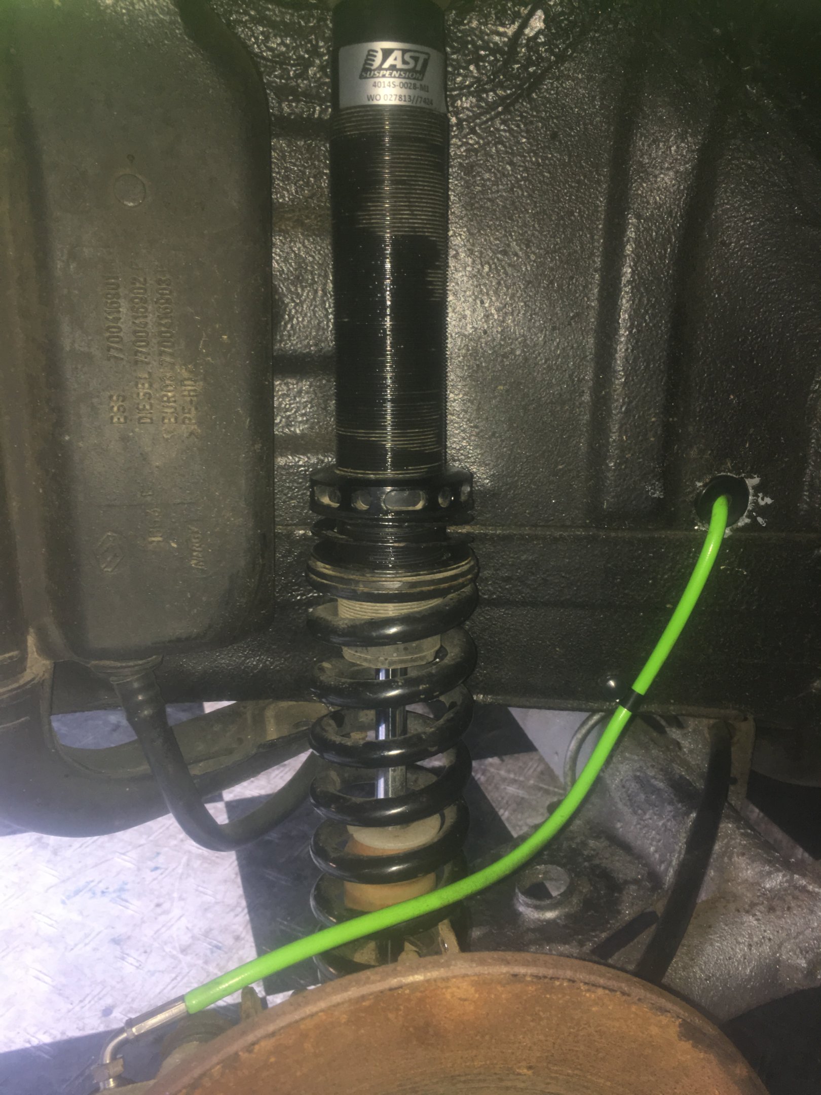

Brake lines clipped in

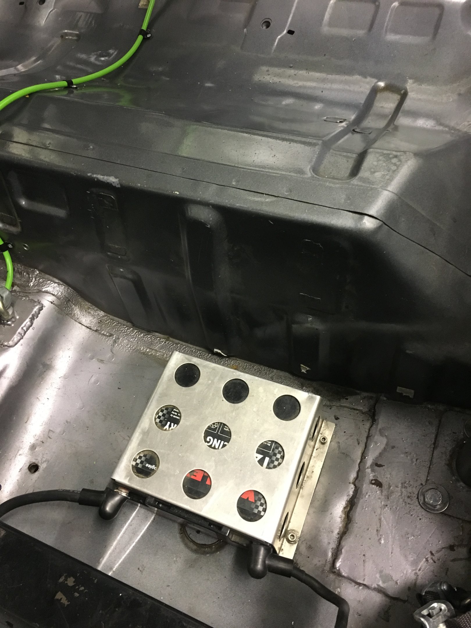

Battery moved to behind passenger seat to clear up the rear and move weight lower
Got the dash finished and wiring wrapped
Engine bay hoses clipped up and battery bulkhead connector fitted
I also bought a couple of parts last night that have sort of blown the budget spec plan , but they are quality parts that always seem to hold value if it was to sell in the future

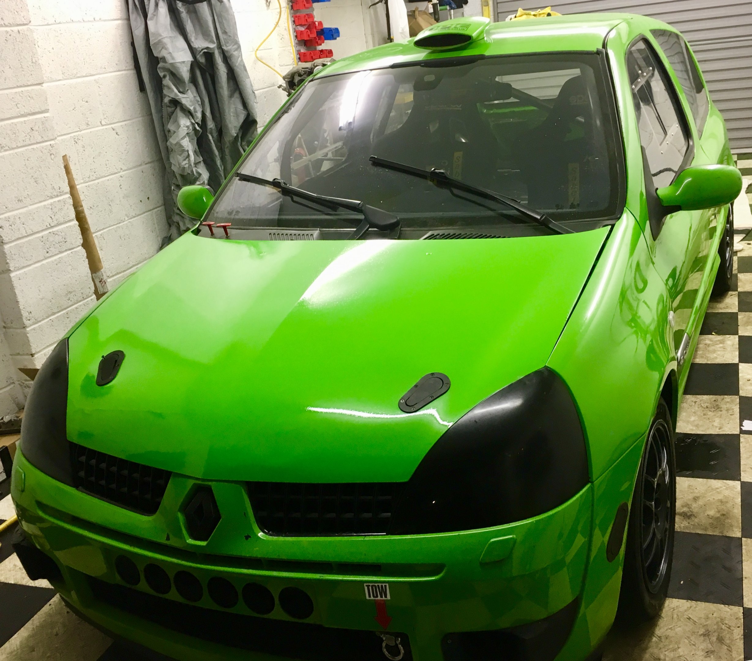

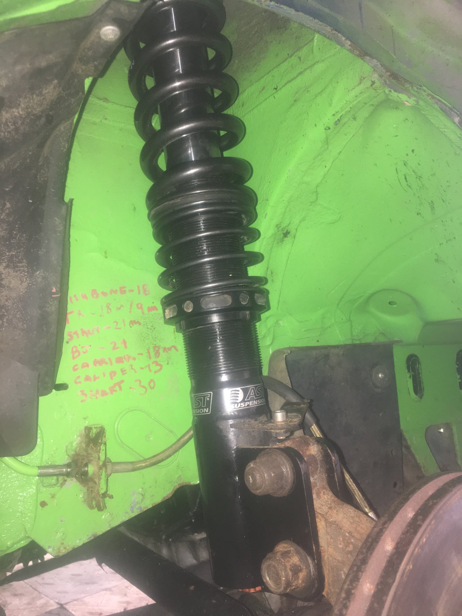

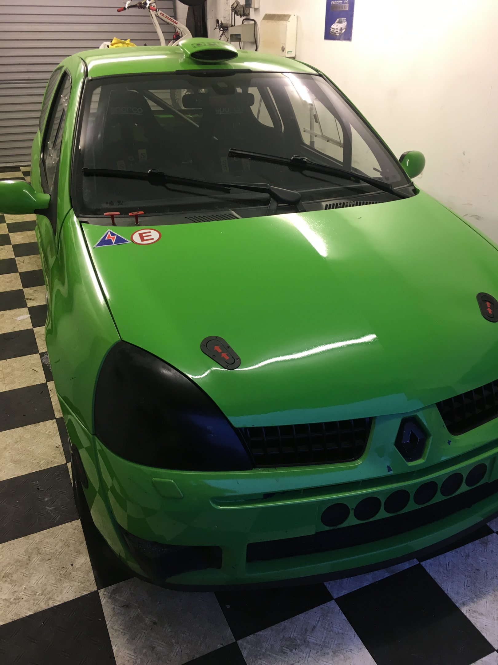

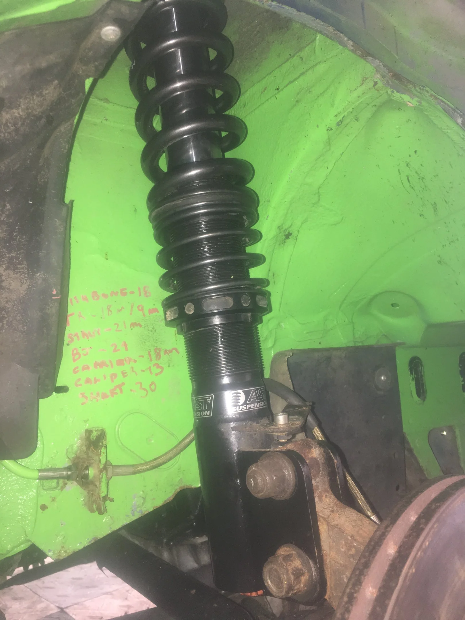

Spent today stealing parts from this.

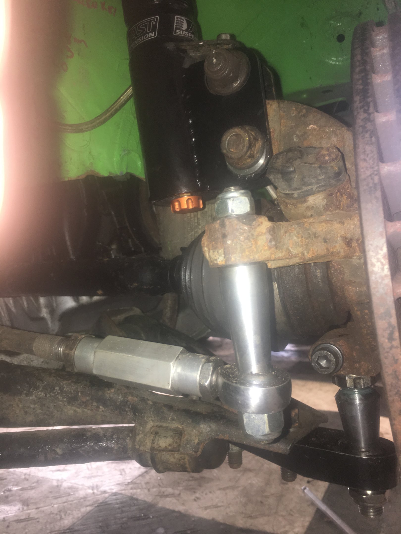

So the car now has AST 5100’s and a roll center kit fitted.
bonnet is now painted and fitted aswell, so really just alignment and a sunstrip to finish

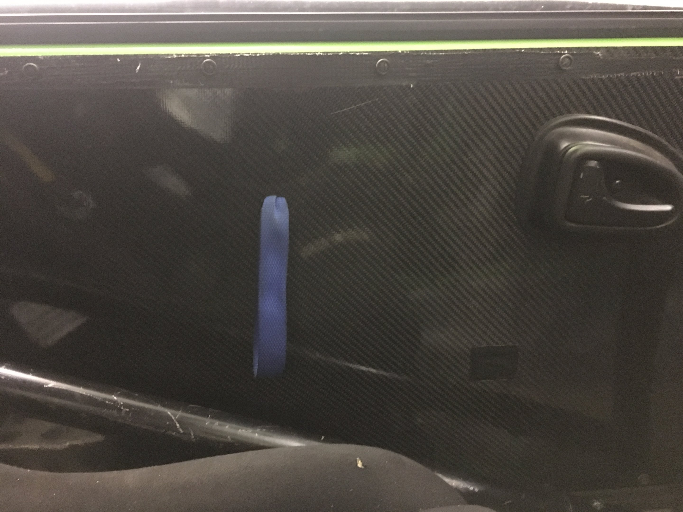

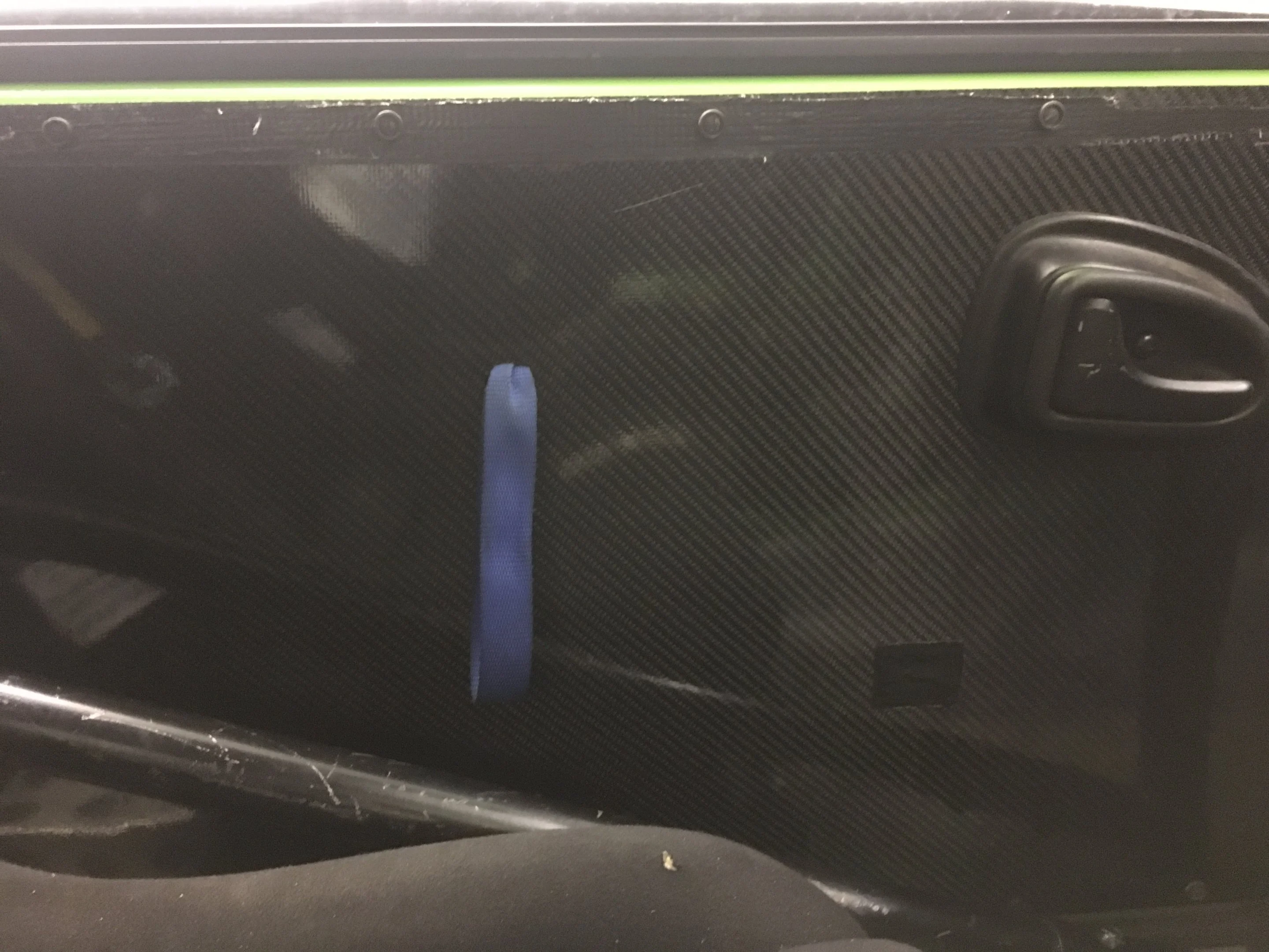

Any advice on what to use to try and clean up the poly windows as they are a bit of a mess after having stickers on them and general scratching.

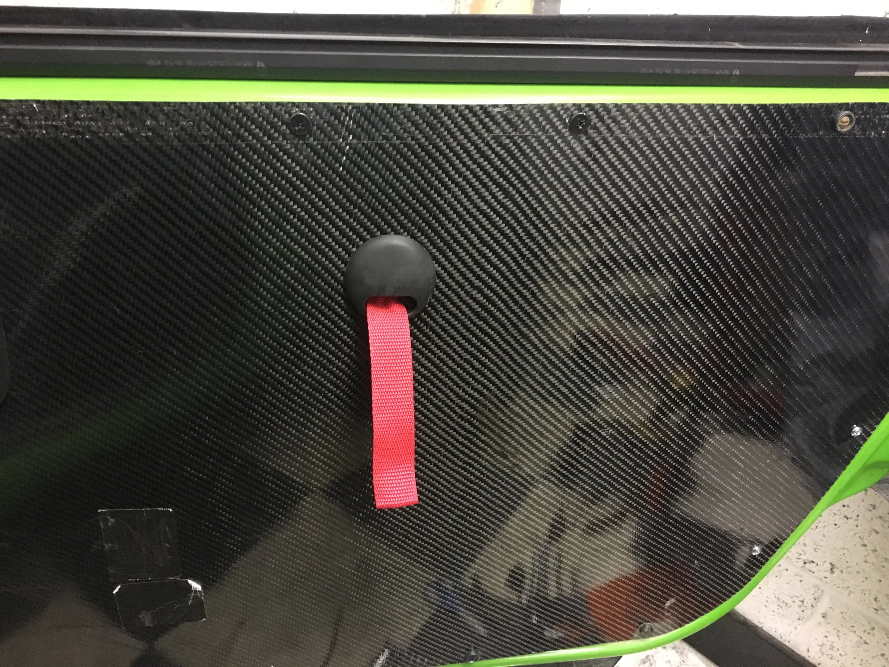

Hey,
I have a Clio 182 that is been building for a year to enter in the ktec Clio 750mc series, I have done the same thing as you with the kill switch and extinguisher pull cords on the shuttle panel. However, I can’t make the panel tough enough to be able to pull the cords without it lifting.
What have you done to make it secure etc?
Cheers
Jason

Hey,
Cheers
Jason
Are your clips that go under the windscreen still in place? Usually a large repair washer under the scuttle plastic is enough, but they all flex and u really need to push down on it as u pull, which is ok if u know that’s what’s needed but any Marshall running to pull it in emergency may not have that tact.......

No the clips aren’t there and whernt here when I bought the car I was gonna buy replacements but wasn’t sure wether they would still keep the panel in place as like you say I need to push the panel down to pull the cords which the marshals are unlikely to do, which is why I was wondering if there’s a stronger alternative option.
My other plan is to make a bracket to hold them on and drill the holes in the panel larger so it just passes through the panel rather than being attached to it
neil a
As Craig says above I still have the clips under the screen which helps also make sure you have the clip fitted under the hinge as this helps as well, the panel still flexes but the pulls will work, in an emergency if the marshal brakes the panel then that's the least of my worries :fearscream:

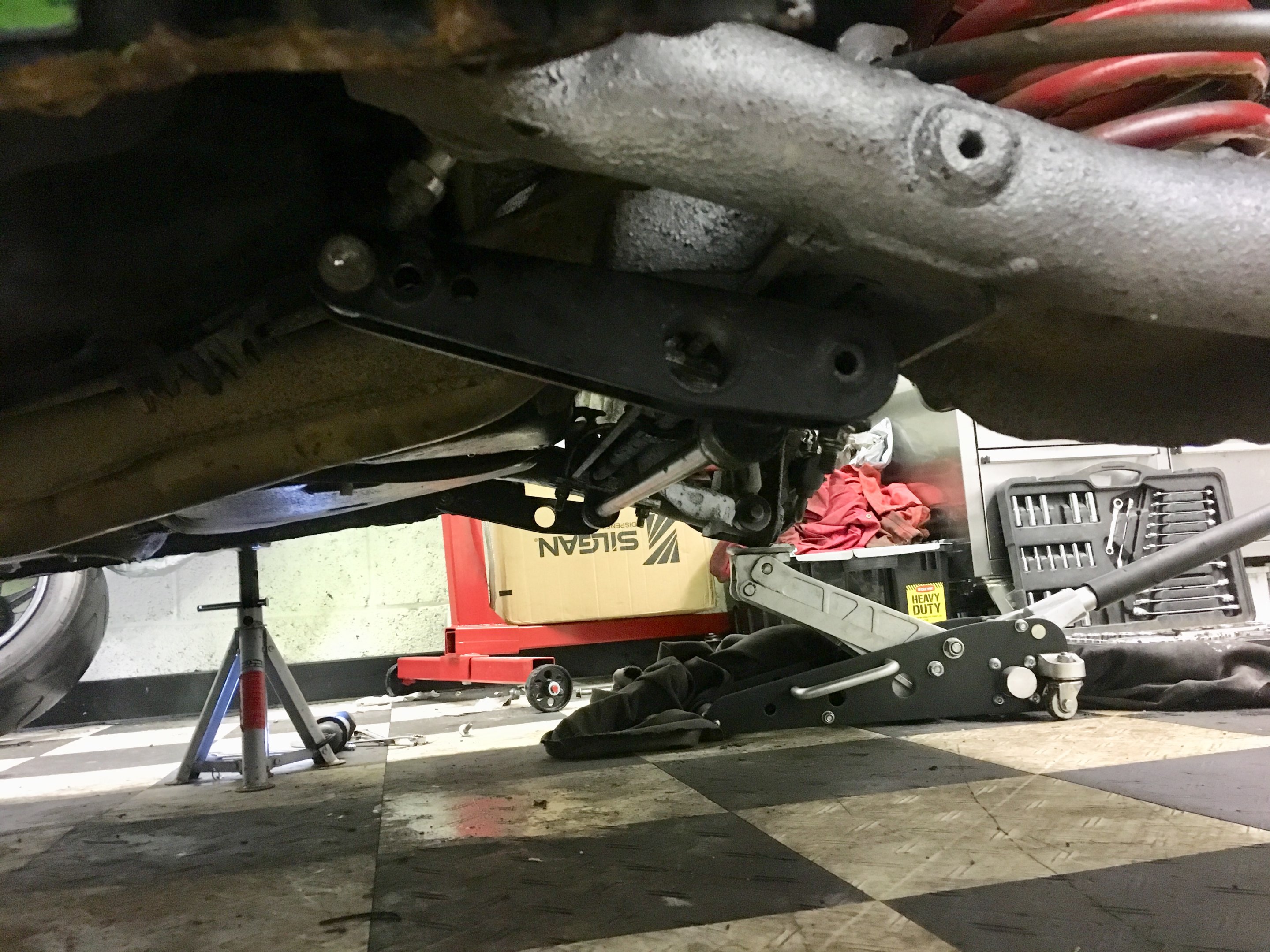

Getting the car booked in for corner weight and alignment within the next 2 weeks , and will give it a spanner check underneath while its on the ramp. Was just going to get a basic alignment but with spending extra on suspension will corner weight to make the most of it .
I had this issue. Ended up getting so fed up with mine I replaced them for ones with the marguard coating. It's worth every penny extra.

I will try and clean up the windows if I can get them half decent they will do.

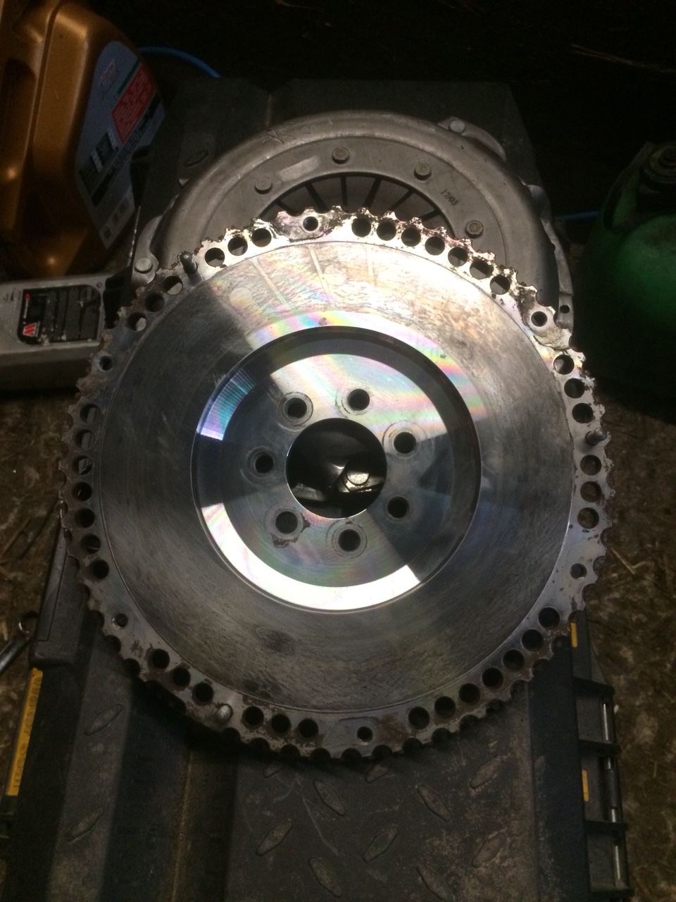

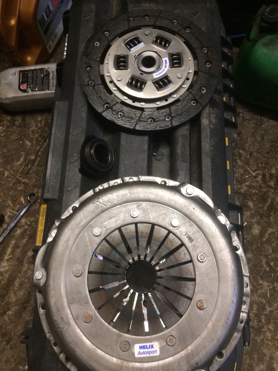

Few more parts soon to be added to the "budget blown" pile , helix clutch and lightweight flywheel .
Will probably fit these after a few track days along with some arp rod bolts and flywheel bolts.
After seeing the results Bloke got with the group N timing , Im looking forward to trying Fraser's old engine out as they look to have a good torque spread with this set up.

Will do .
Like you say in a track car it doesn't matter but I know how annoying a rattly clutch can be in a road car.
