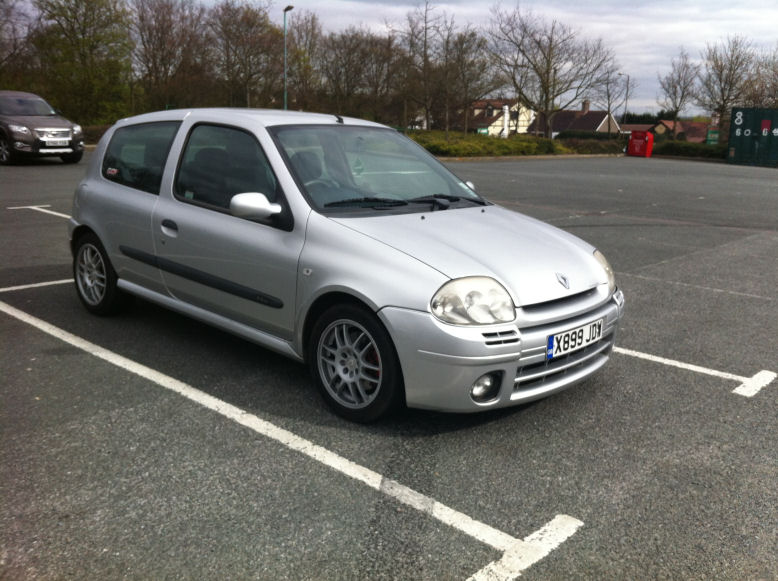

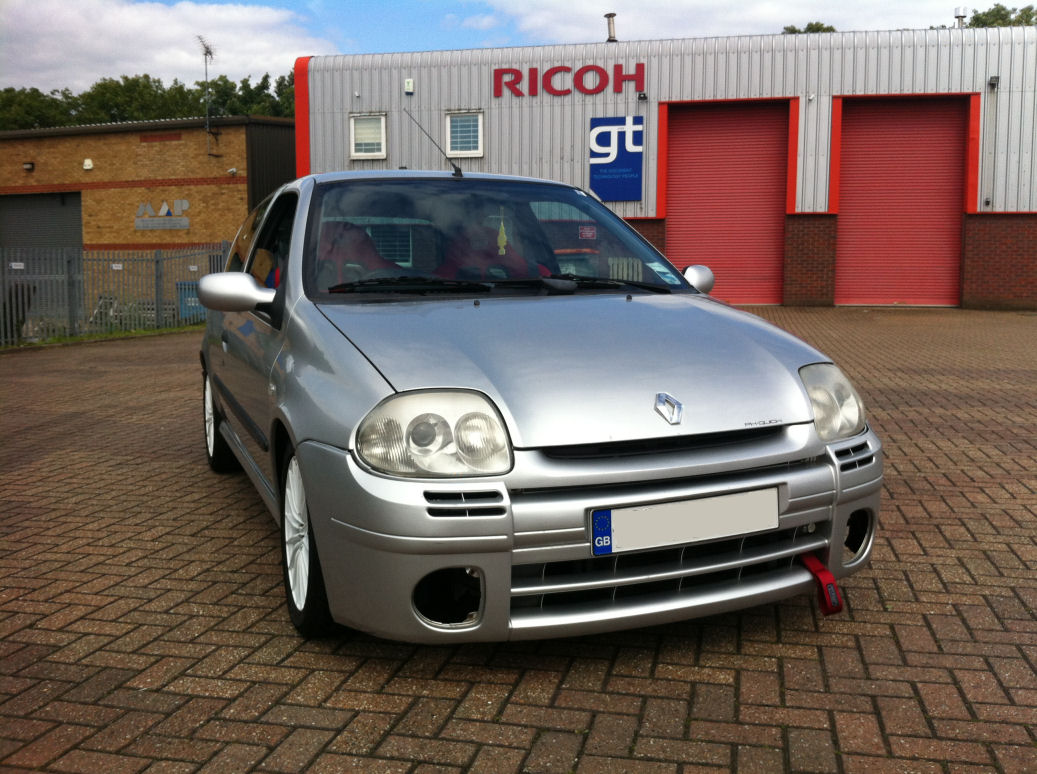

I spent ages looking for a decent one but in the end I got fed up of waiting and bought a fairly standard one with 114k miles!

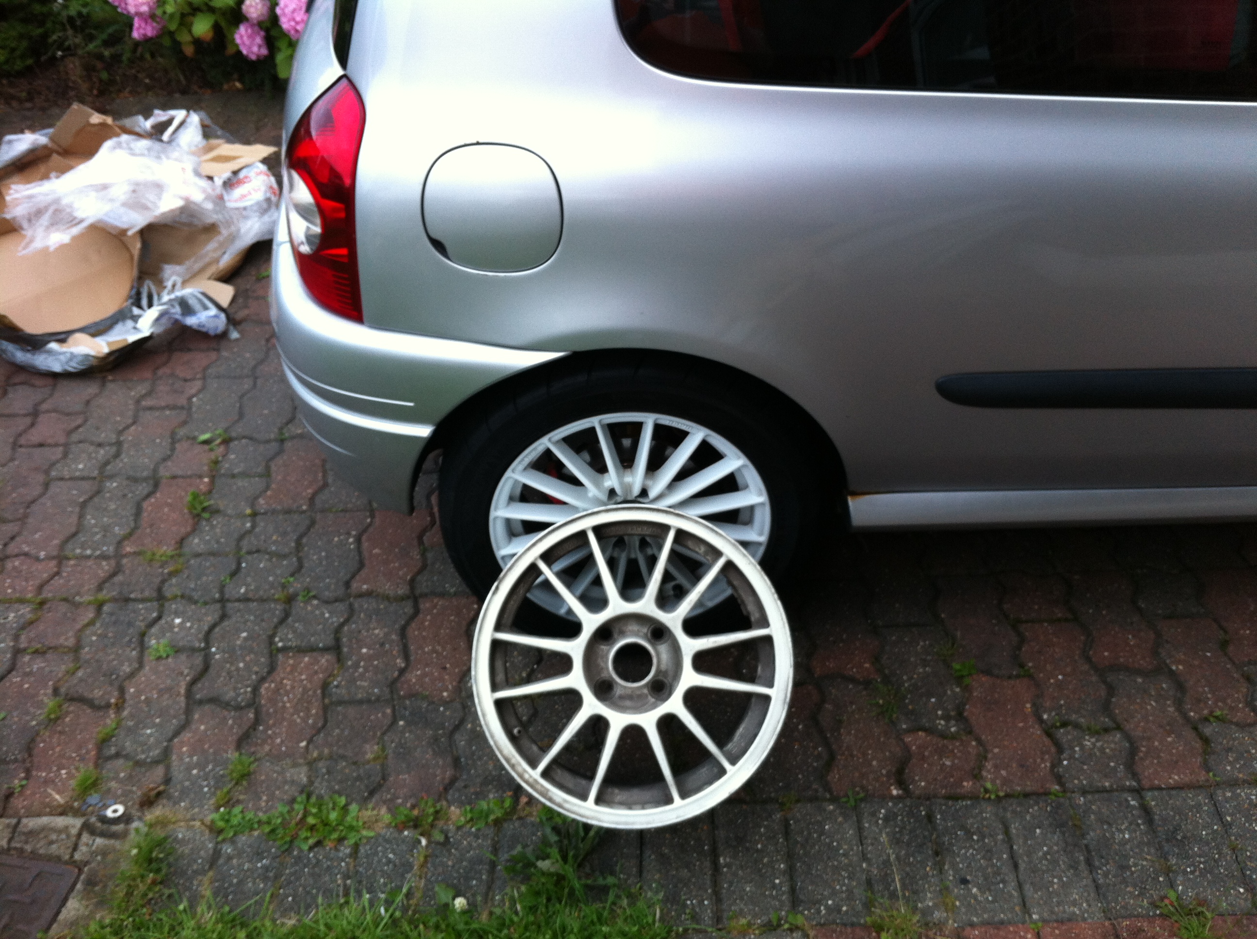

On the drive home I found out the wheels were tat. Lots of vibration. I went to get them balanced and two of them were buckled.
So annoying as I wanted to keep the F1's

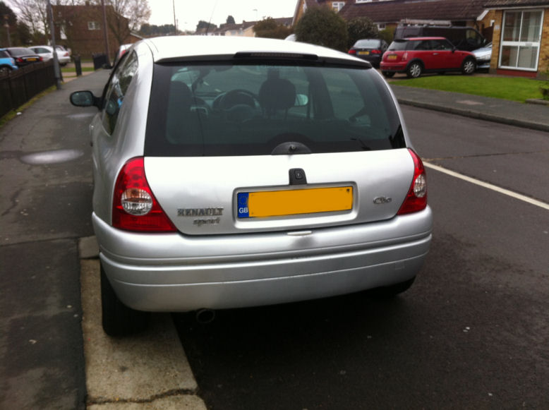

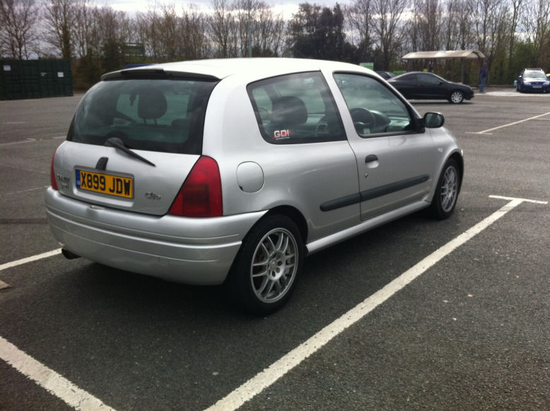

First job was to remove that knackered rear wiper, and I also changed the rear lights to PH2 as I prefer them:
I had to get the wheels sorted pretty quick as I found I also had a slow puncture. Searched about for deals and ended up collecting these Inovit 15s with Yoko AD08s
Needless to say, they were not very well received on here! Not my favourite wheels either but they were a bargain and almost new.

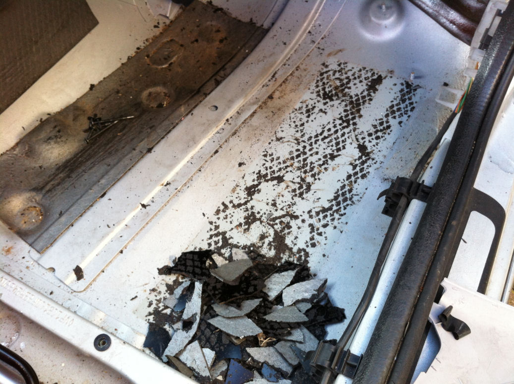

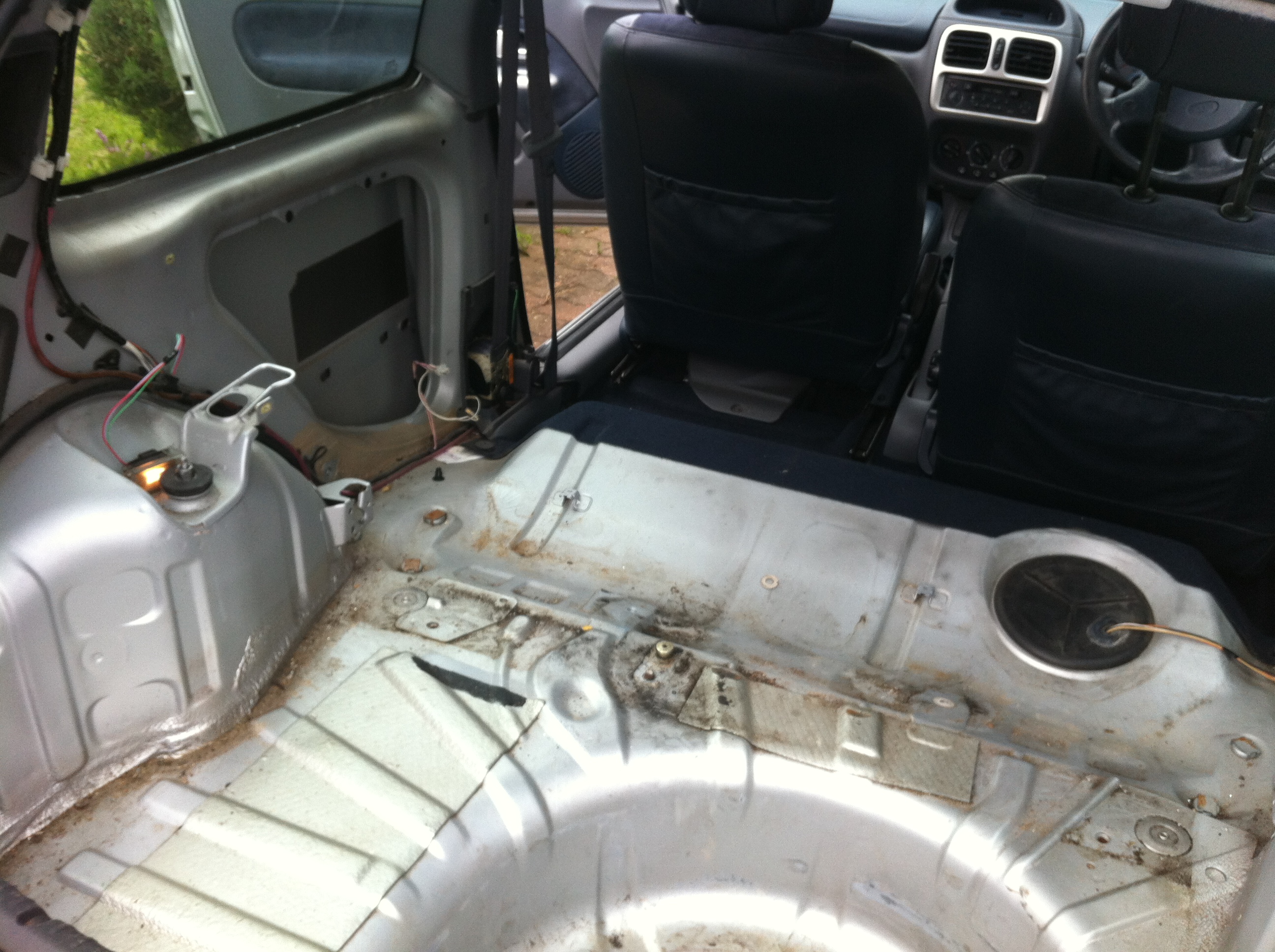

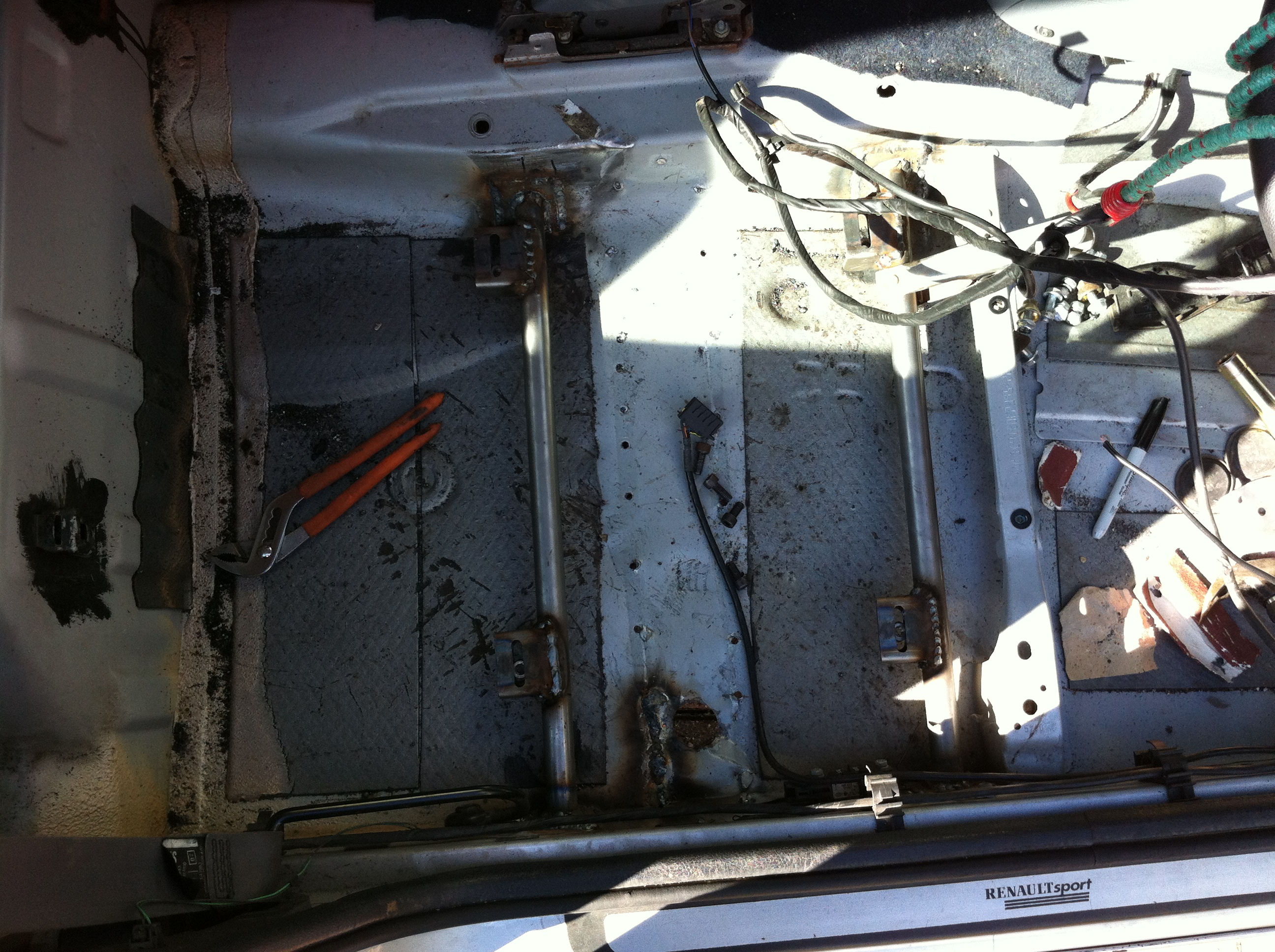

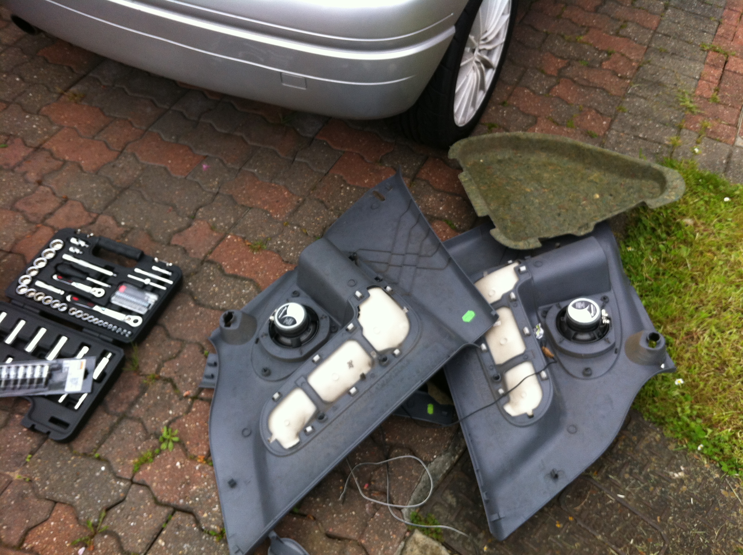

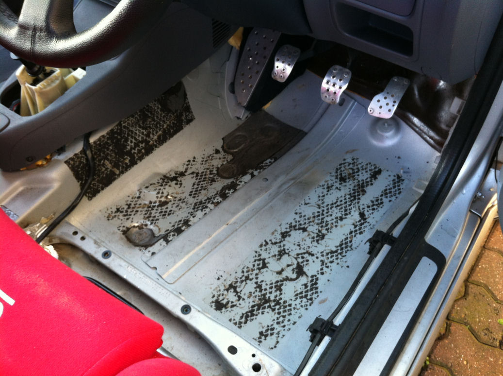

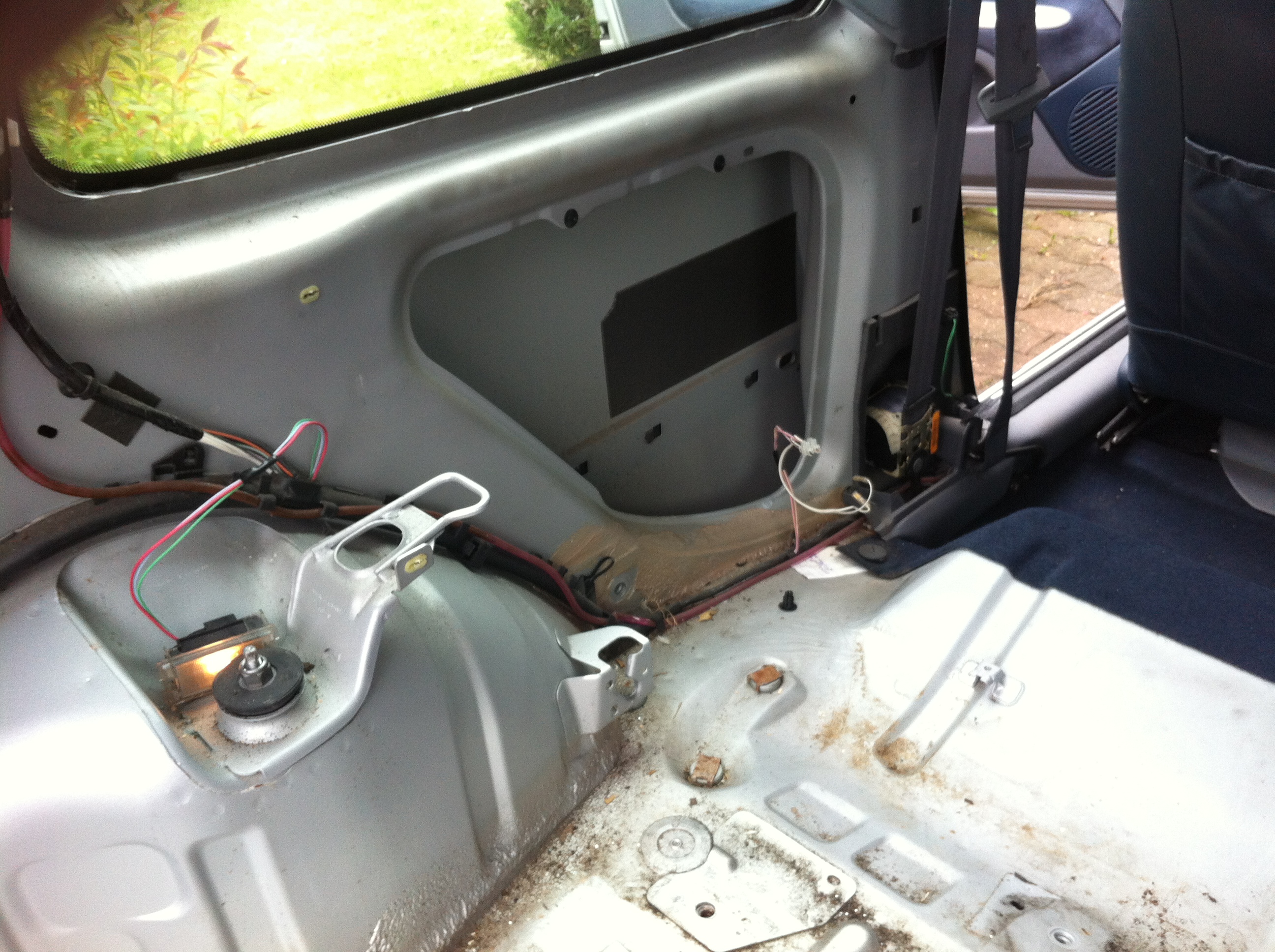

Next step was to start stripping out the rear interior etc:

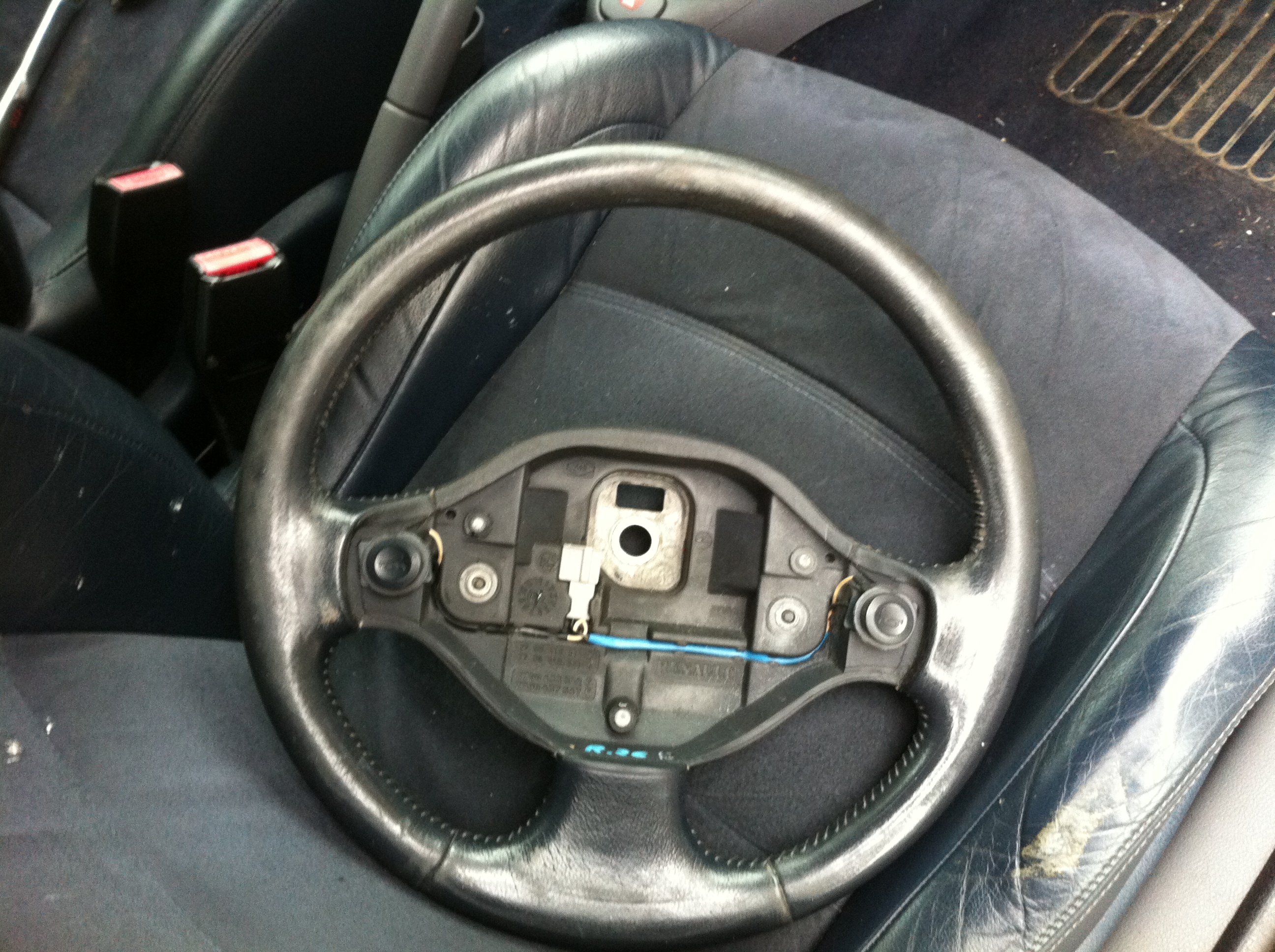

And even though the steering wheel was in good condition, it had to go!

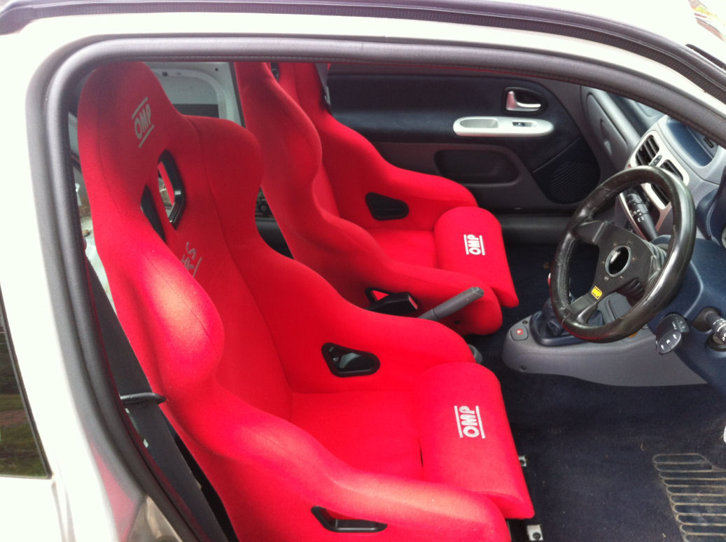

Next up was the seats. Unfortunately I'm trying to do this on the cheap so I bought some OMP TRS seats. One of the cheapest out there but still cost nearly £500 with the subframes & side mounts etc:

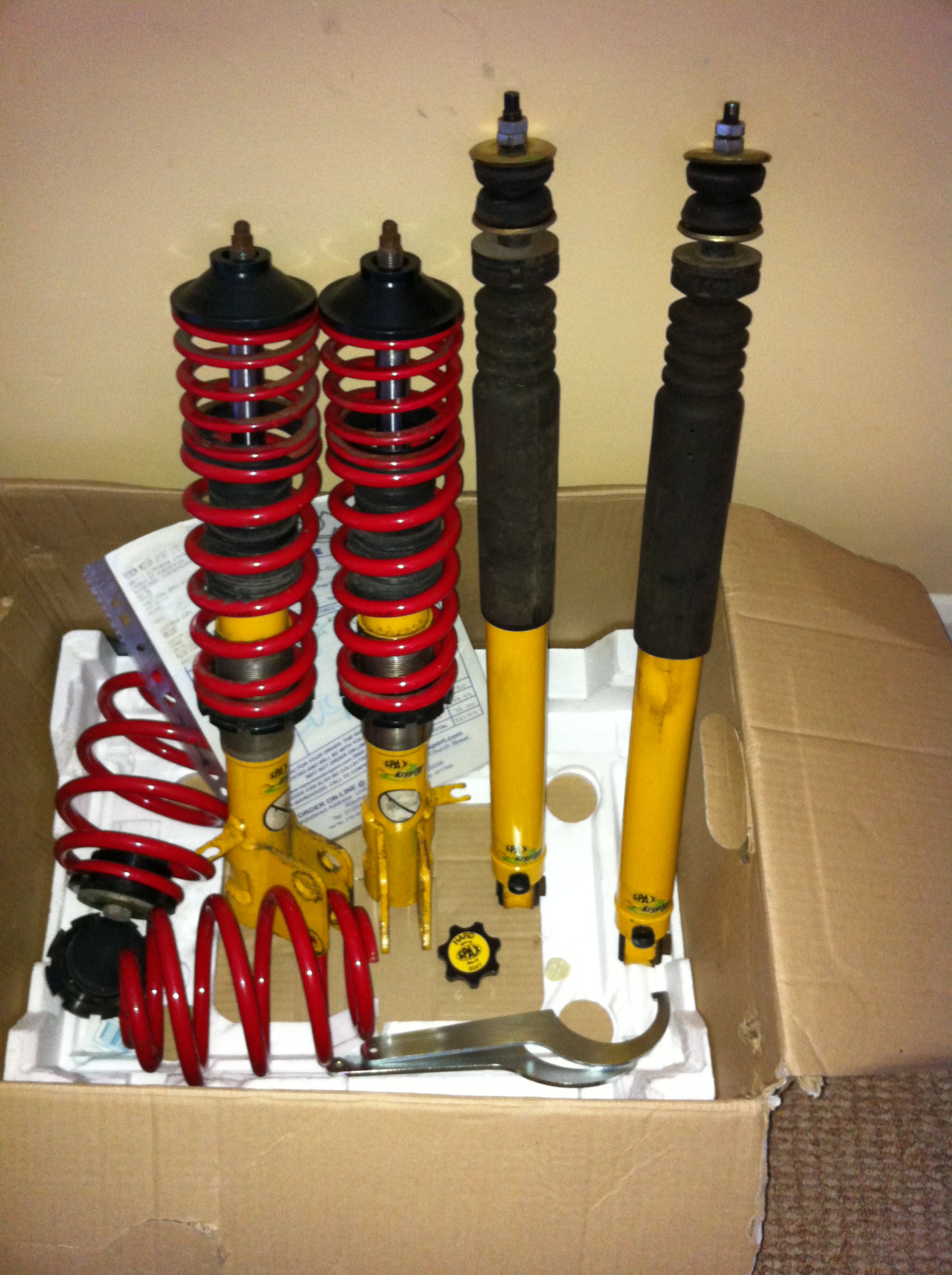

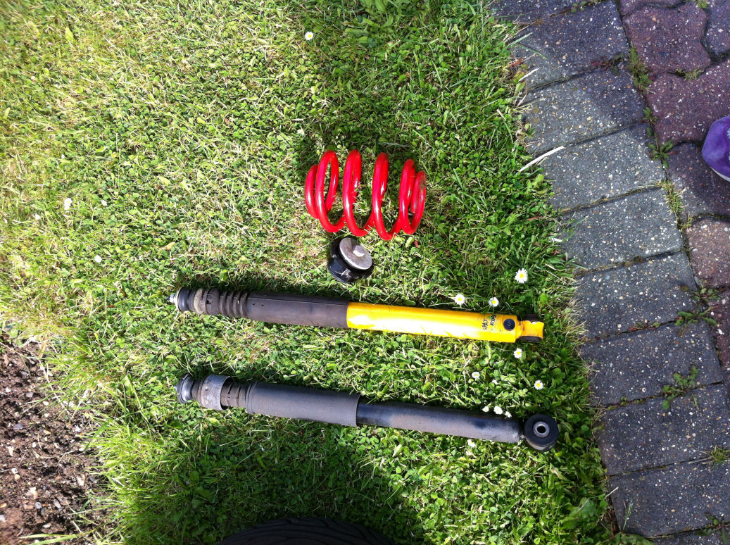

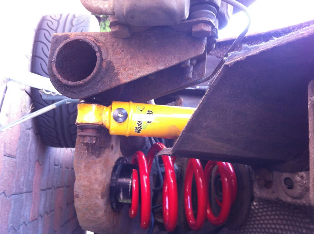

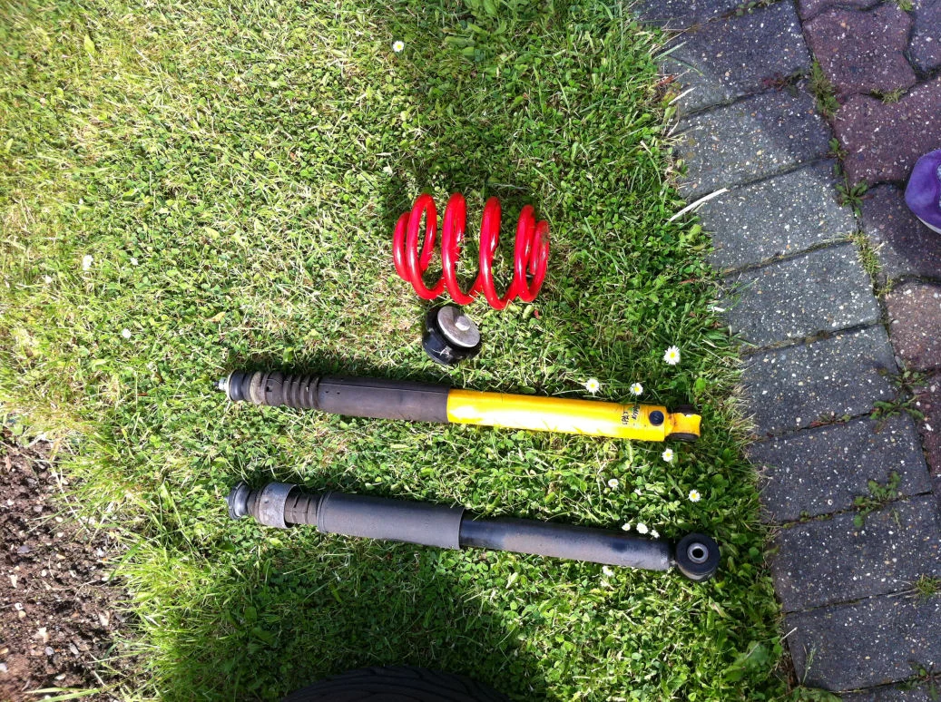

Suspension was next. Got these SPAX RSX second hand from Stu on here:
Fit the rears and had terrible trouble with the fronts. Had to give up in the end and took them to a garage. Even they had a nightmare. I picked it up from them on the day of its first track outing at Brands Hatch:

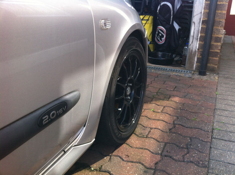

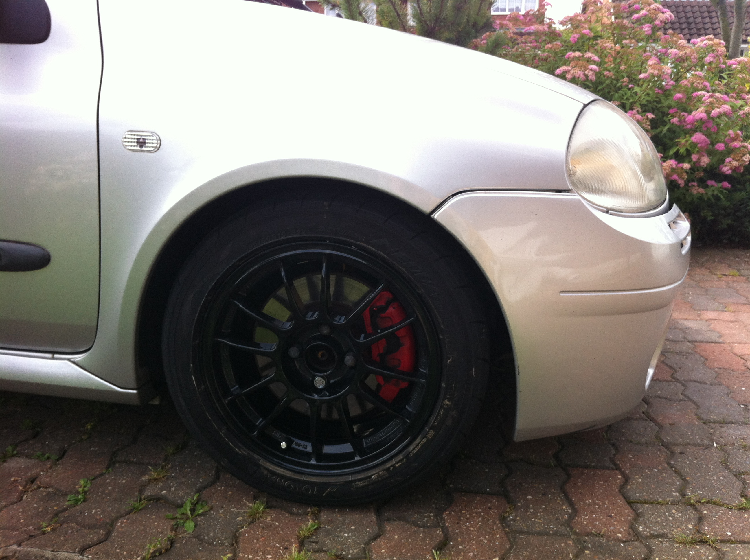

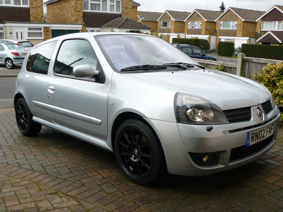

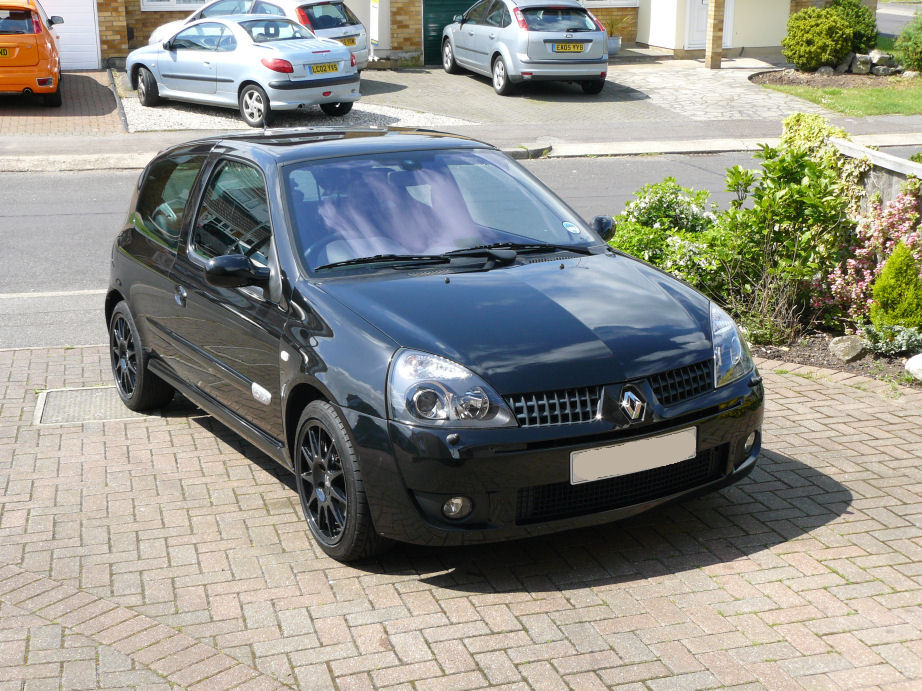

Then I had to do something about the wheels. A bargain set of OZ superleggeras came up. I had to have them:

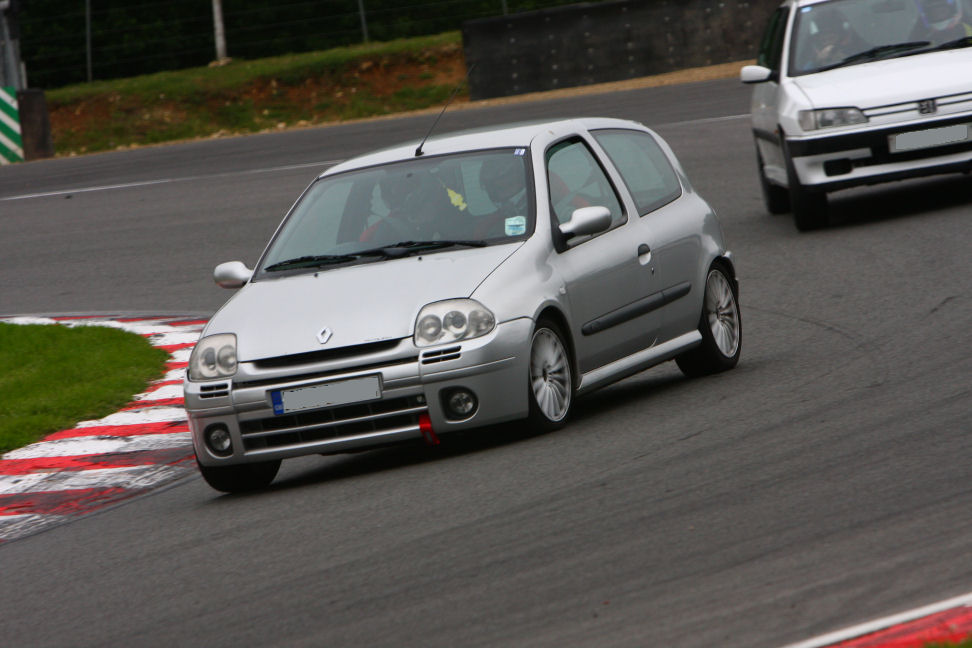

I had these refurbed and powercoated gloss black. Then I went off to my first track day at Snetterton:
Again the brakes were shocking. Like really bad. Came off the track a couple of times. Had to brake super early in the end so it took some enjoyment out of the day.

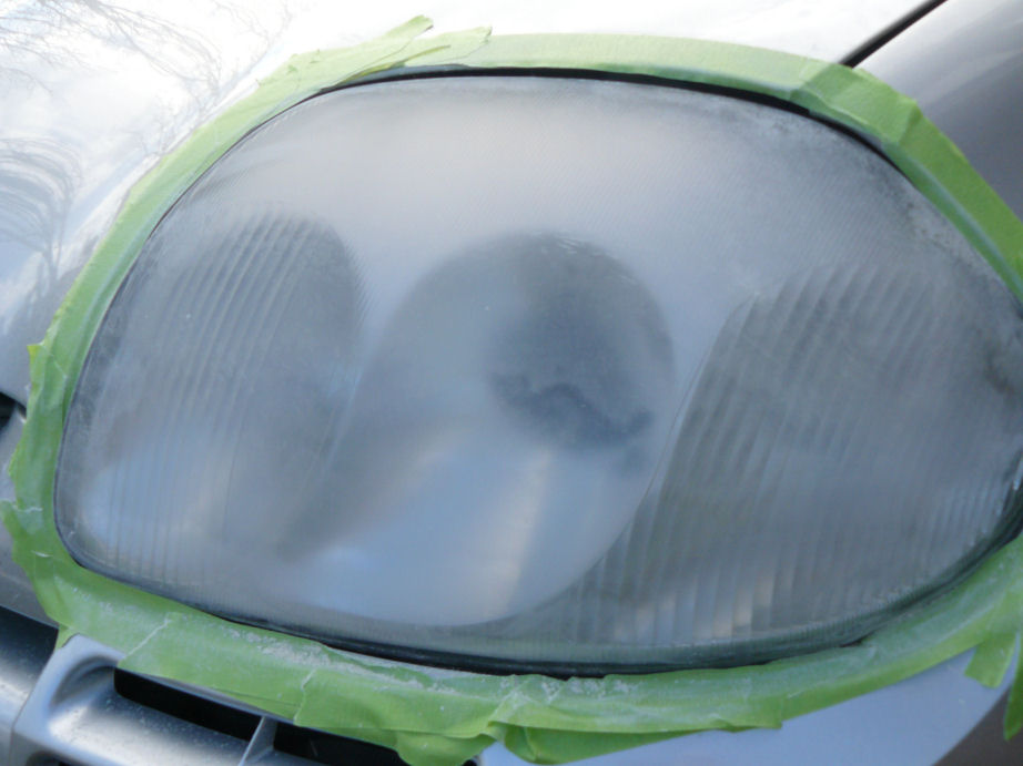

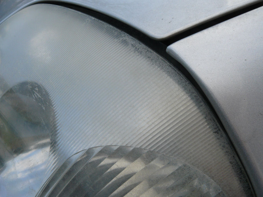

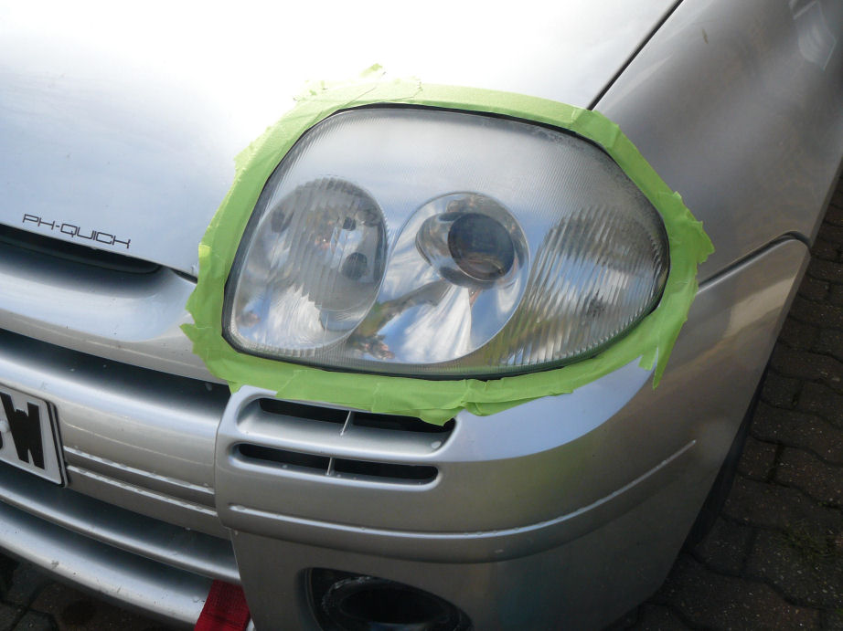

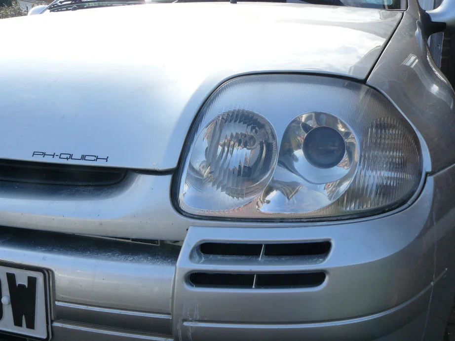

The headlights were pretty yellow so I wanted to clean them up. I got the 3M restoration kit and it really helped:

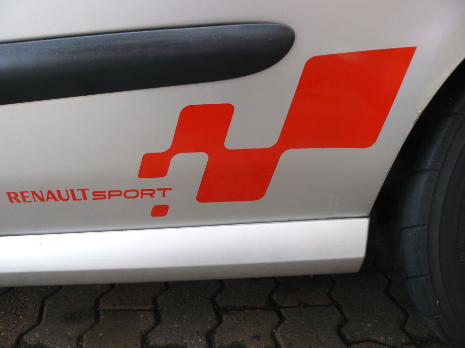

I wasn't sure about these graphics I had put on either. I have now removed these

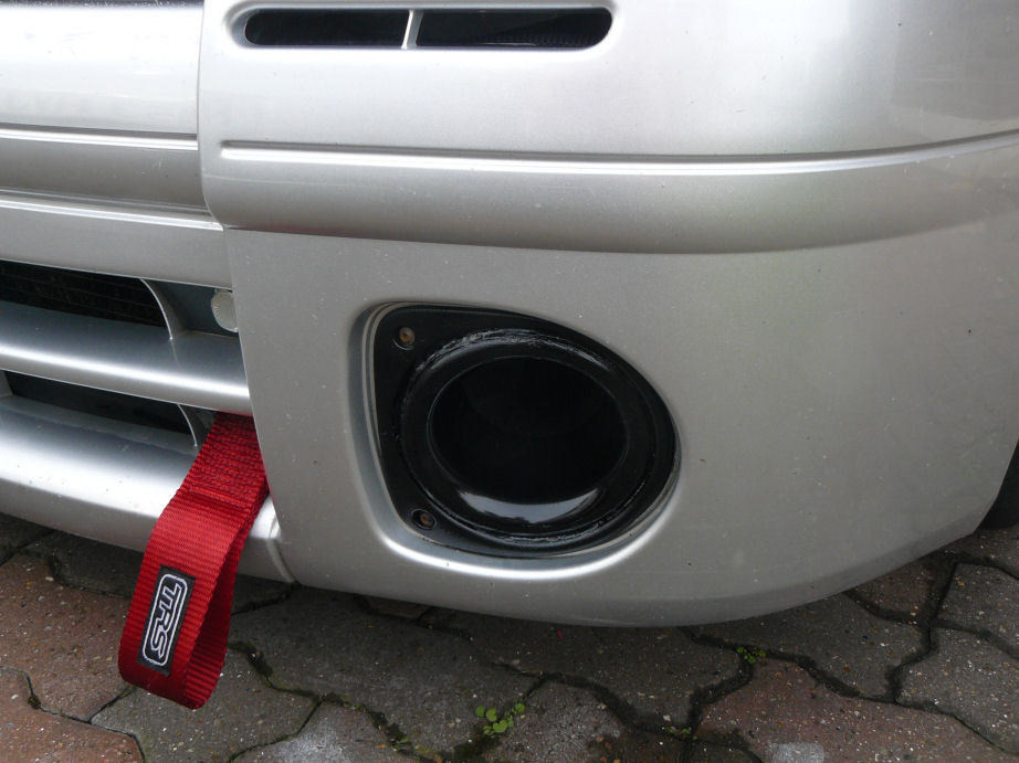

Bought some speaker ports to make into fog light ducts. Didn't bother with any ducting yet as I removed the arch liners anyway

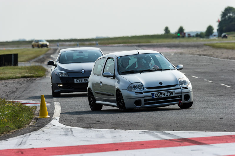

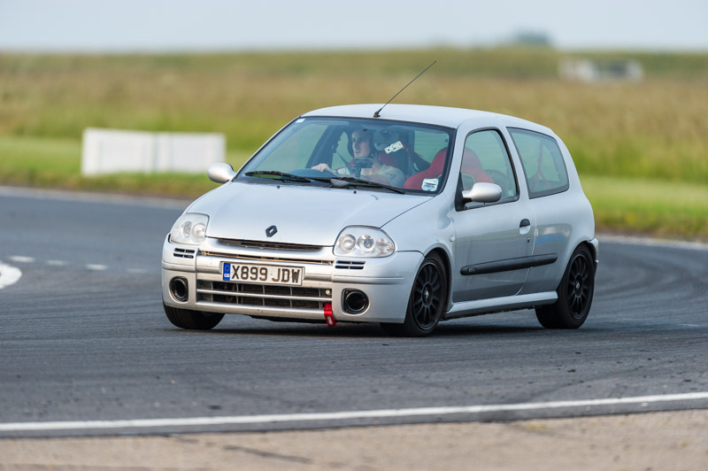

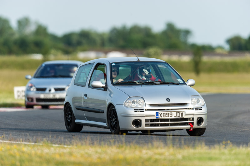

In July I did the Renaultsport evening at Bedford. I had a fantastic time. Proper nice sunny day as well. For the first time the car felt perfect on track. The brakes were fantastic, it handled well and it was great fun:
The track day showed up another couple of issues for me though. The main one being the gearstick. I'm 6'5" tall and the car had a B & M quick shift on it which is quite short. I was finding myself having to bend forward and down to reach it properly.
Luckily after the PMS shifter group buy, I was able to buy Swede Cups old Yanoo fast road shifter. This is a couple of inches longer than the standard gearstick and has made the world of difference. Unfortunately I have no pics of that.

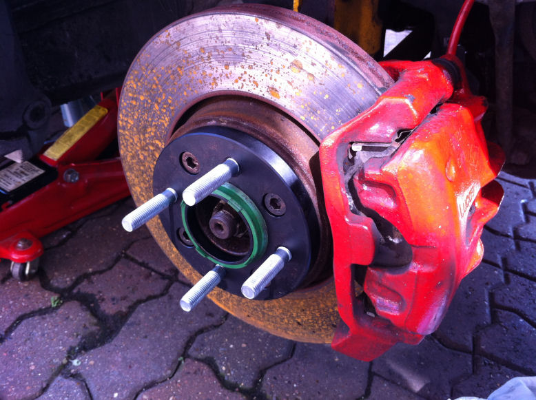

Another issue was the wheel nuts coming loose. I wanted spacers anyway, and I managed to get a set from Steve @ rsports cars. I didn't realise until I got home that he'd also included a stud and nut kit.
Got the 15mm spacers fitted to the front, but not used them on track yet.
I also have stud and nuts for the rear to fit and 10mm hub spacers with 1 degree of camber. I'm still not sure whether to fit these rear spacers or not. If I do I might need to increase the size of the front ones.

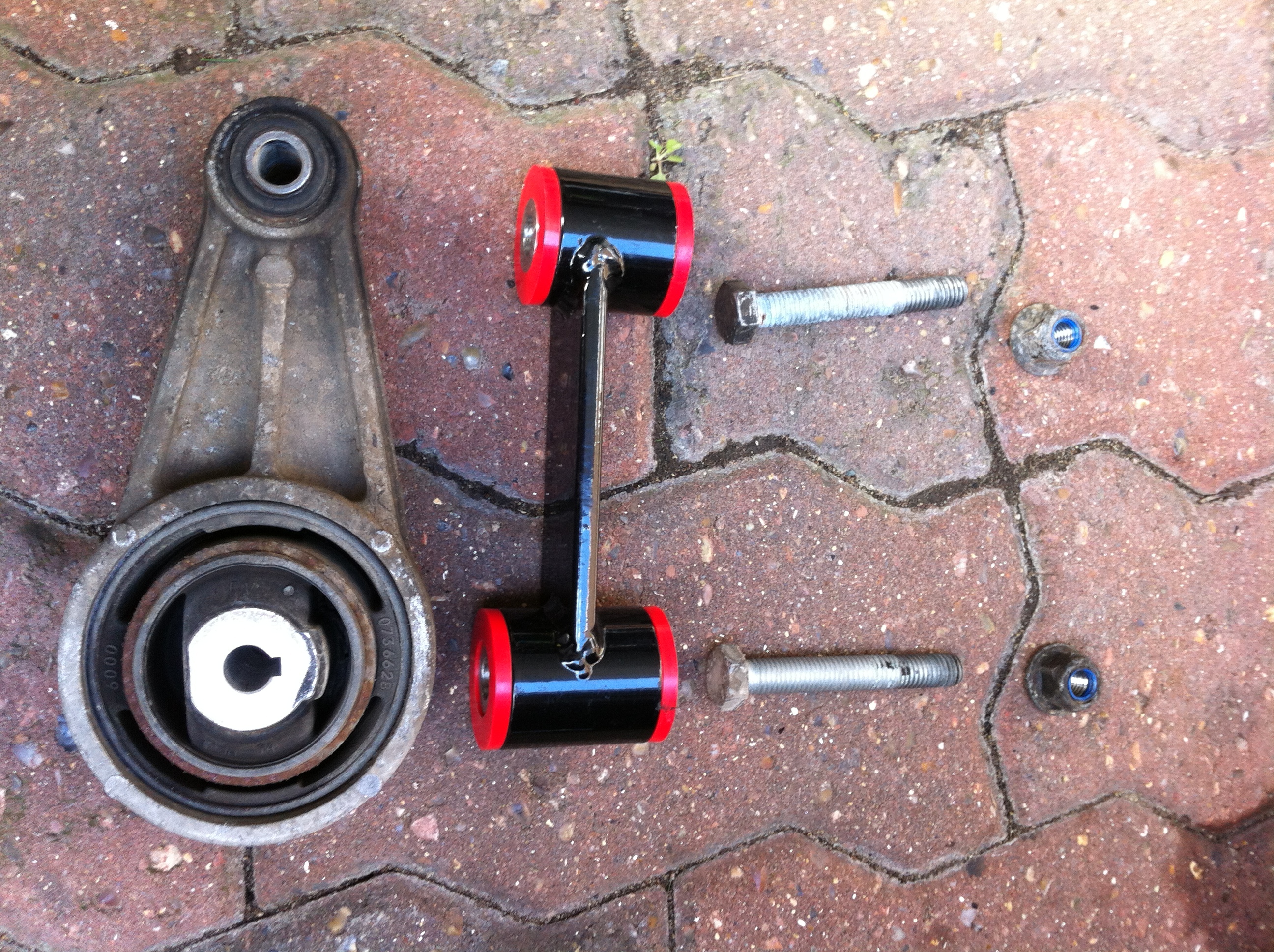

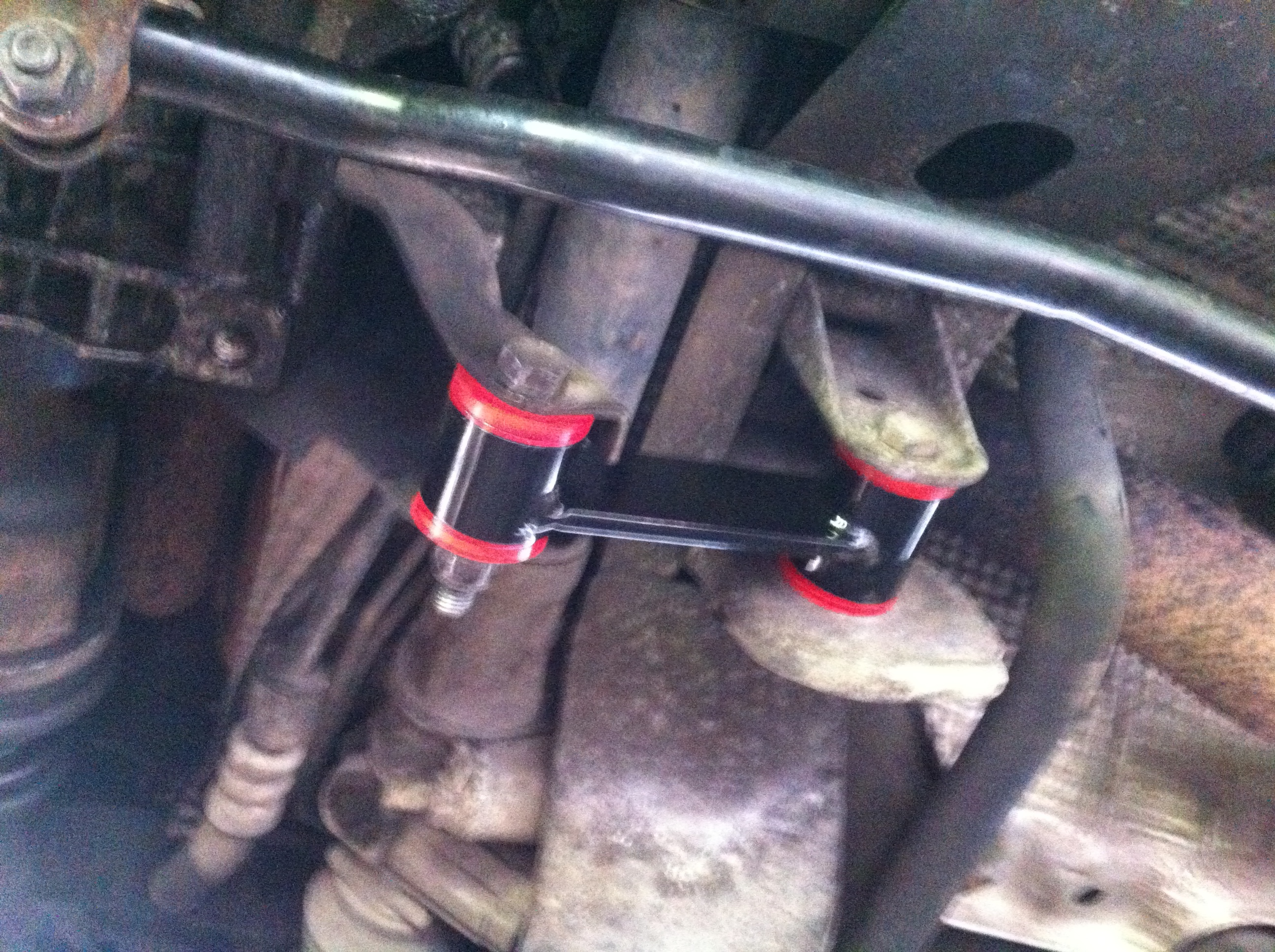

Another little mod I did was the Evol engineering gearbox mount. My car did clunk a bit from pulling away etc. It probably needs the other mounts replacing too but I added this one for the time being:

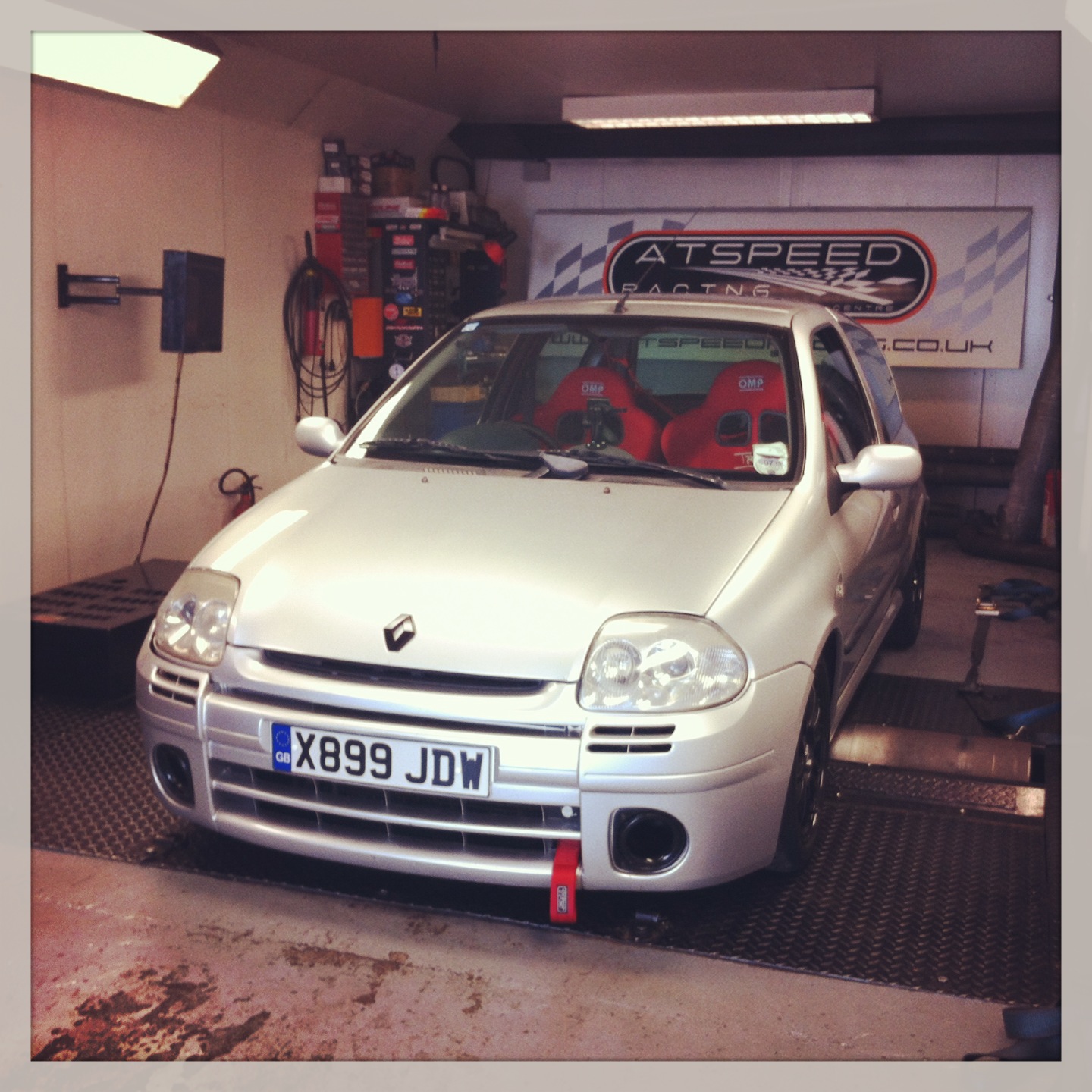

I went to the Essex rolling road day in July. It was very hot and the car scored the lowest figure of the day, 161bhp. Not terrible, but I was hoping for a bit more. At least there's room for improvement I guess.
Got some redex to stick in it when I go out next. But will try changing the spark plugs also. No idea when they were last done.

Glad you changed them wheels too, definite marmite stuff.

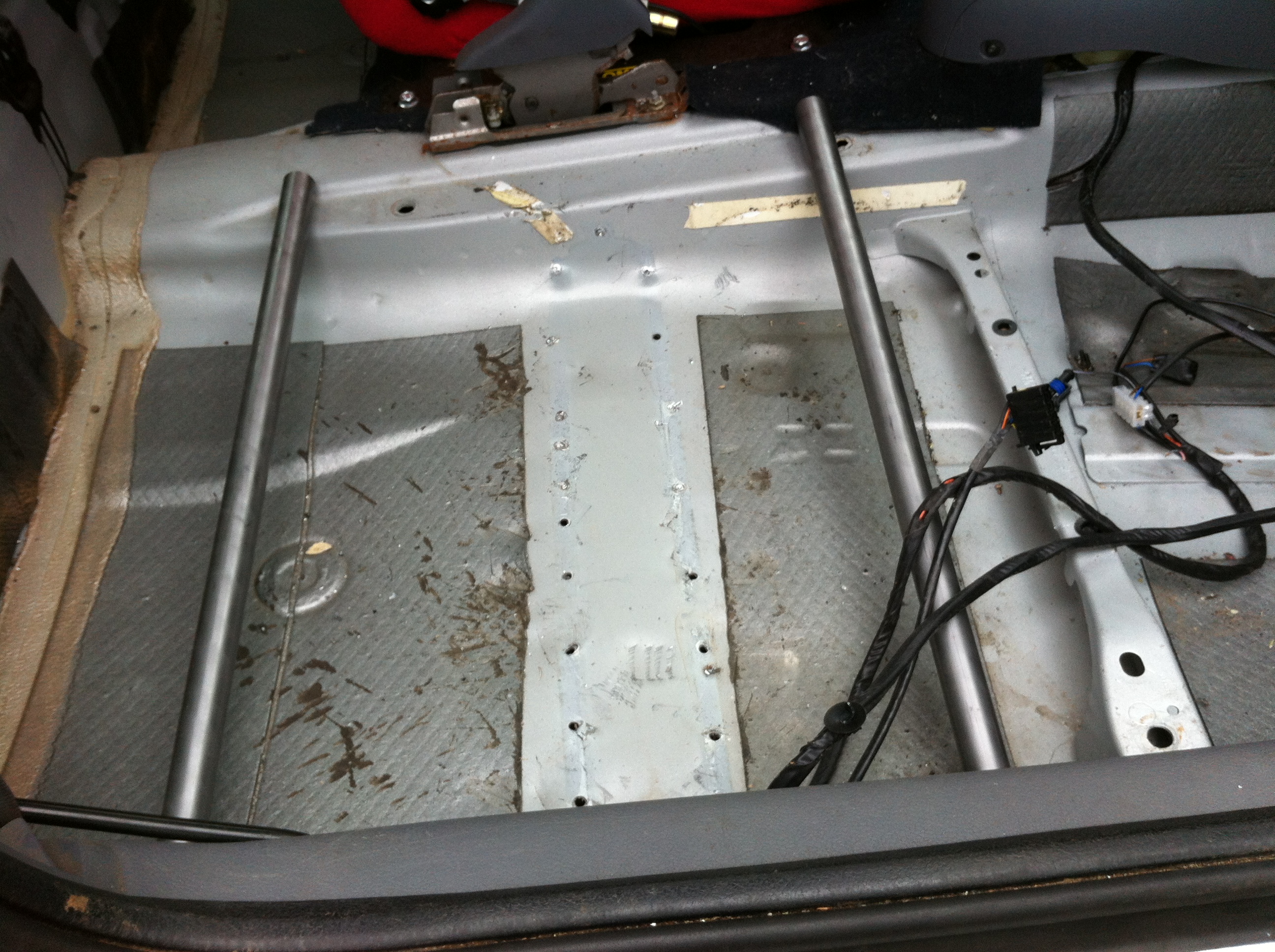

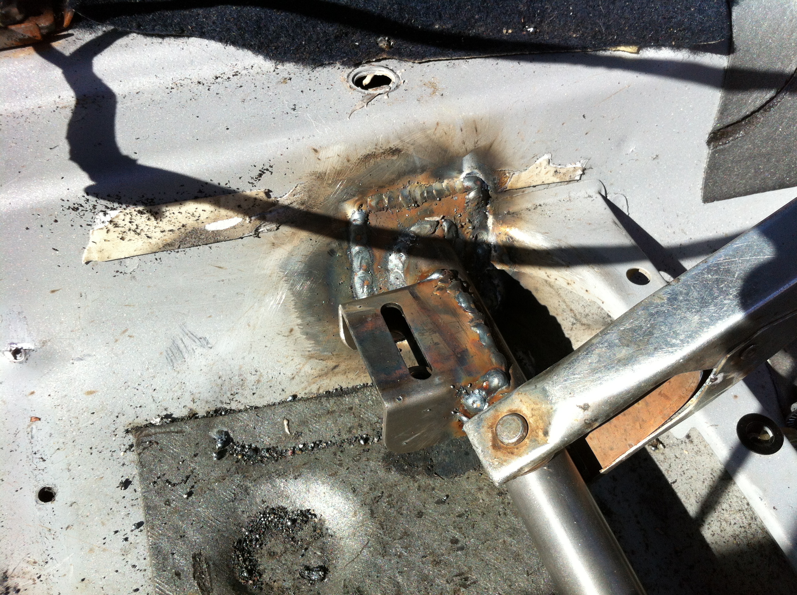

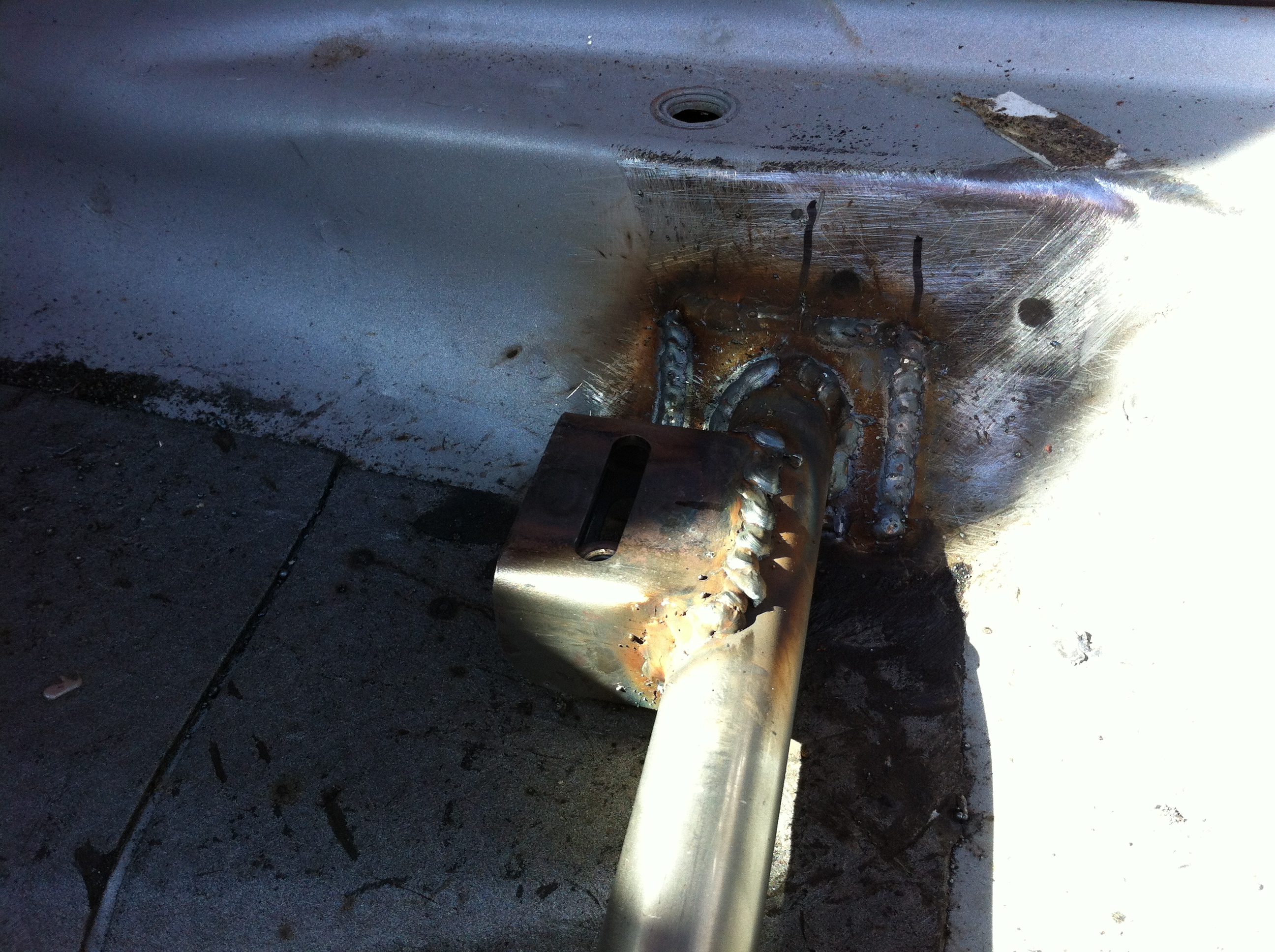

I had to make the seat lower as it was still too high.
I had already cut the subframe, but went a bit more extreme but removing the original seat rail and welding in new ones. Luckily my brother is handy with a welder but I still managed to ruin the floor when removing the original rail. Lots of holes through the floor!
Seat is mounted much lower now, but the passenger seat is far too high! Going to fix that when the temperature starts going up again.
I also bought a rear seat belt buckle from a Citroen to replace my pretensioned Renault one. I bolted this through the original seat mounting hole so now I can thread the seat belt through the side holes in the seat. Much safer and tighter. I also bought a CG lock to use on the next track day.
Unfortunately I cannot use harnesses as I am too tall. My shoulders go way above the holes in the seat.

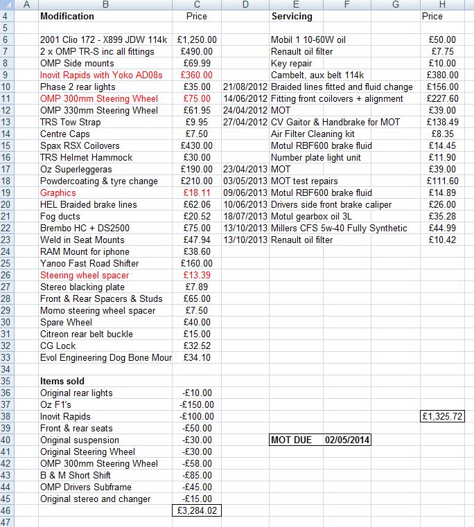

One last image for the moment, and this should show all the costs involved so far.
Its crazy how quickly they add up. I could have just bought a second hand car with a much better spec, but part of the fun is doing bits myself.

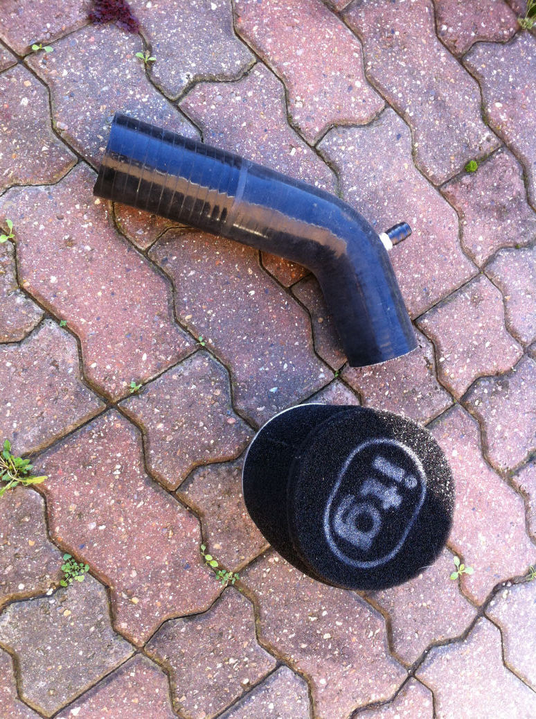

4. Home made induction kit and airbox

this is why I have never and will never do a cost breakdown on any of my projects, just too damn scary to think about!lol!
nice work though :)

Car sits nice on the 15mm spacers. Stud and nut kit is what I'd like to do, so much easier for wheel changes.

i reckon I might relocate the battery as well so I can make an induction kit for it and heat shield.

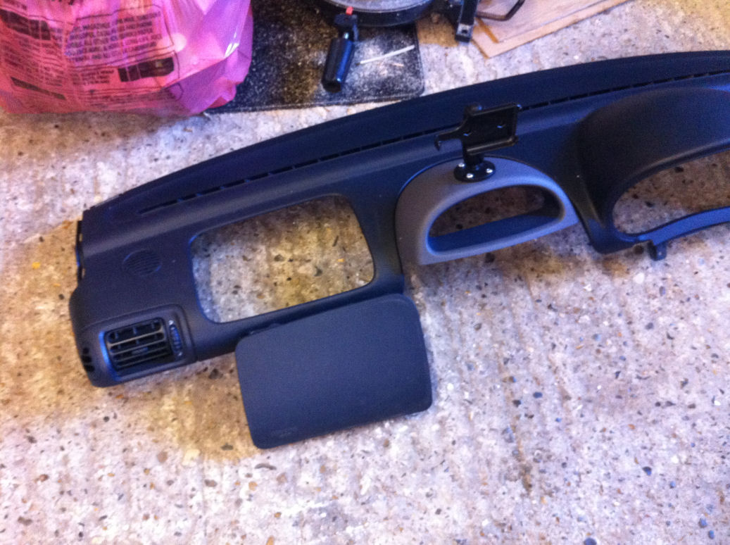

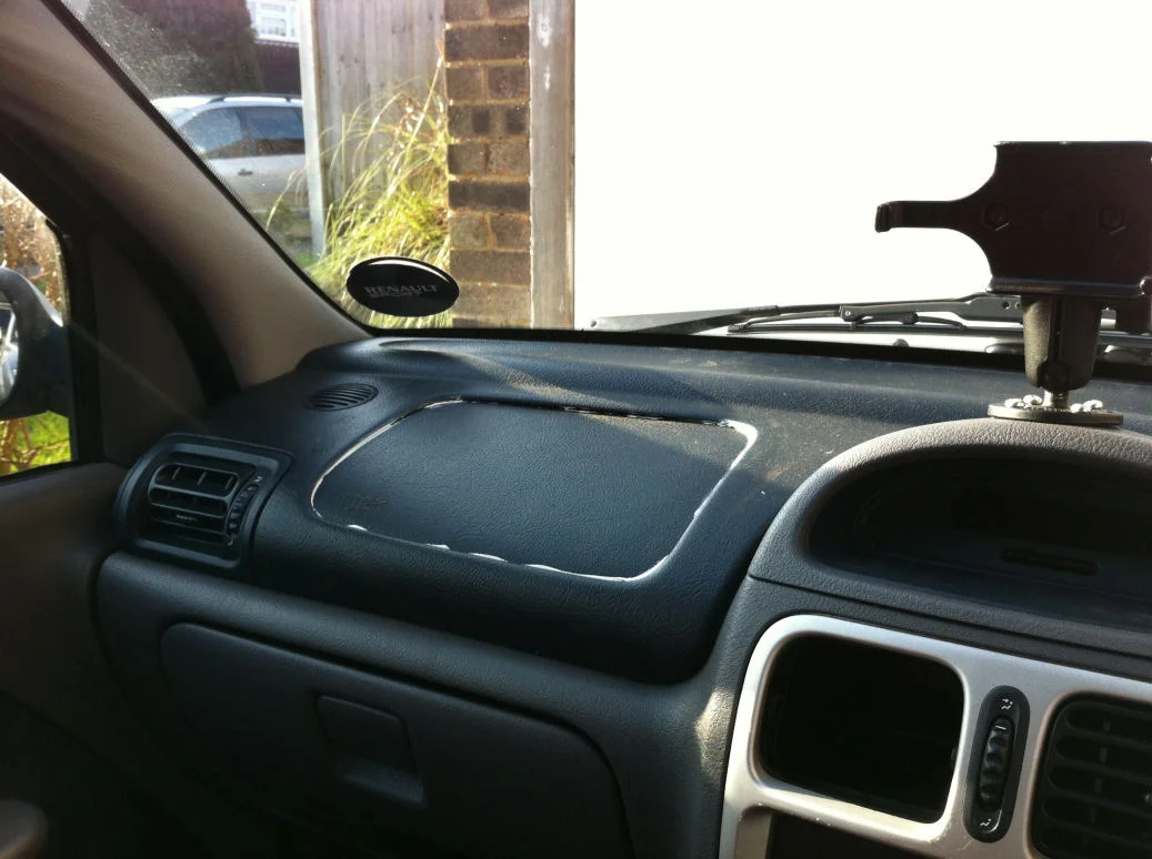

Small update today:
This arrived in the post from PH1 Tom
The I got the dash top off to glue the airbag cover into it:

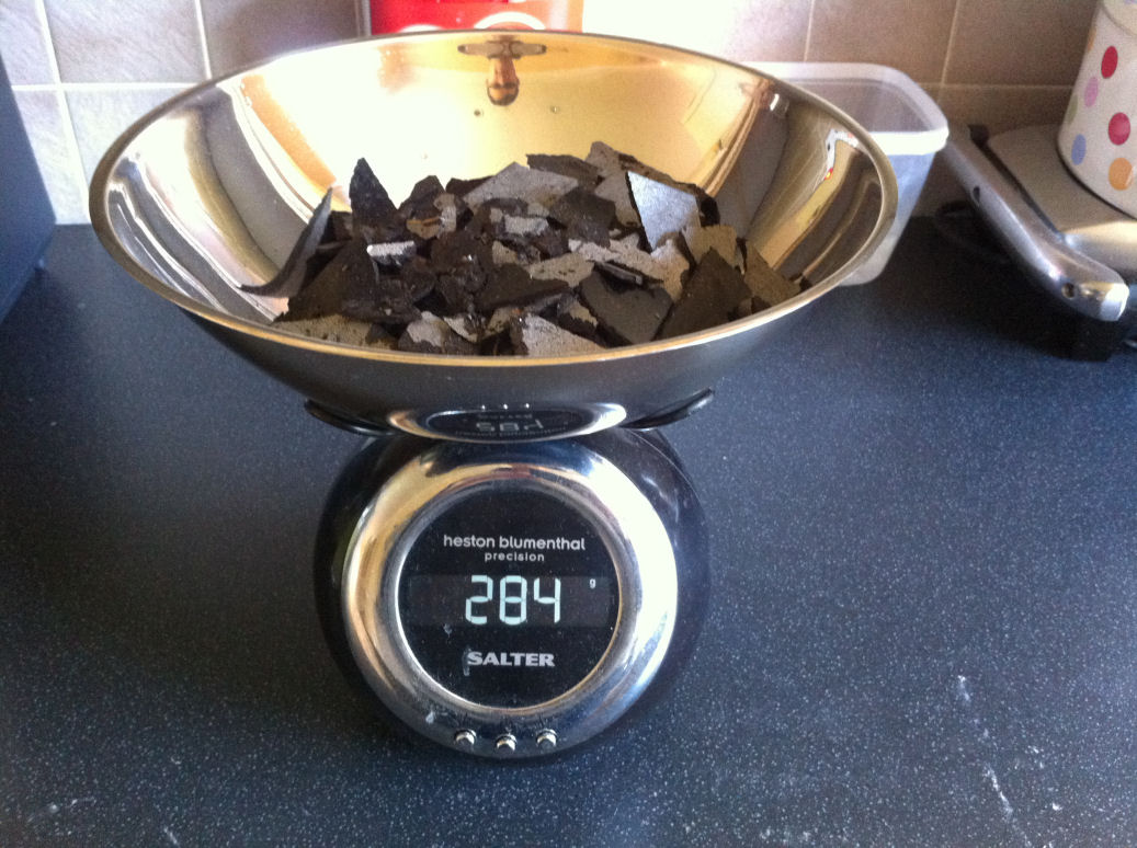

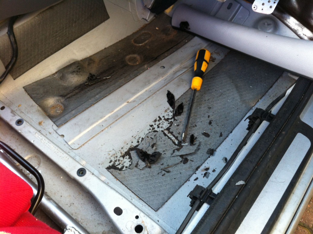

While the glue dried I had a go at these with a hammer & screwdriver:
Came off fairly easily:
This was just 1 patch:
I counted about roughly 14 patches visable which adds up to about 4kg.....
Got bored though and left it like this:
Dash top back in..........doesn't look pretty! But maybe I can tidy this up a bit in the future. Although to be honest I'm wondering whether to just not have the dash top at all lol
