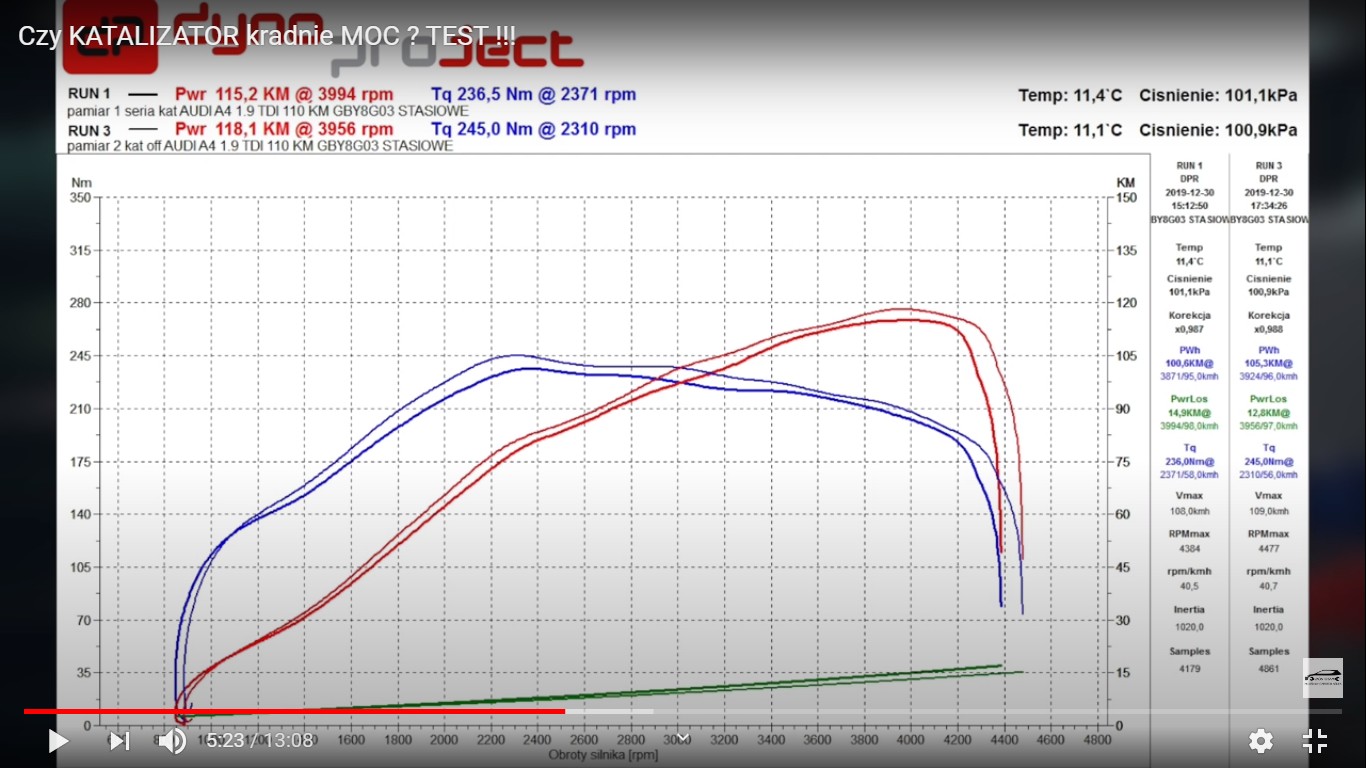

It`s common in turbo diesels that decatting ,gives a little bit of torque and faster turbo boost. As on the gif below , that `s an 1.9tdi 110PS (+ 9nm , +2-3PS) with cat and w/o a cat
