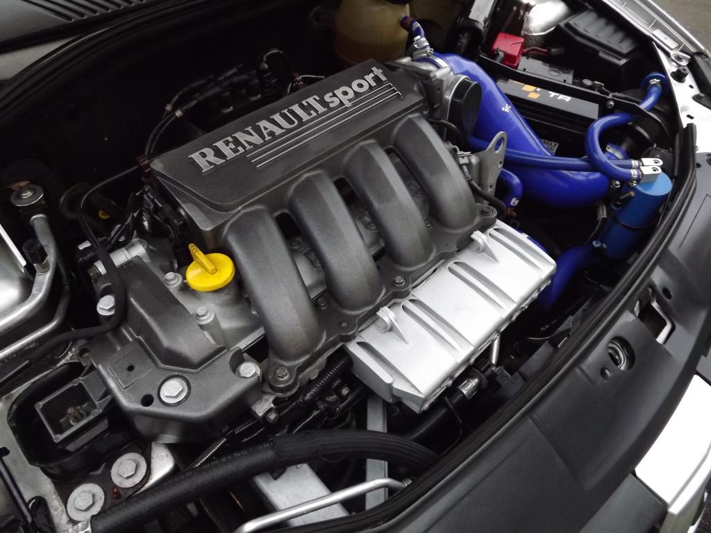

i'd just make myself a DYI catch tank instead
Hai :D
Temporary positioning of catch can at the moment
