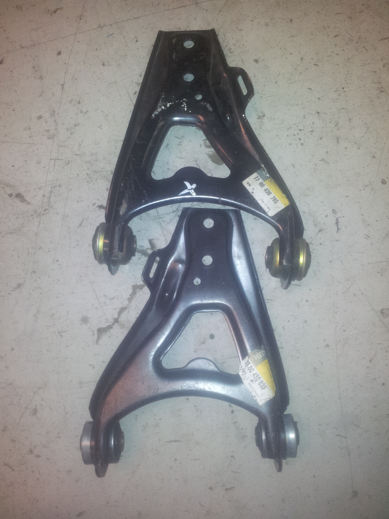

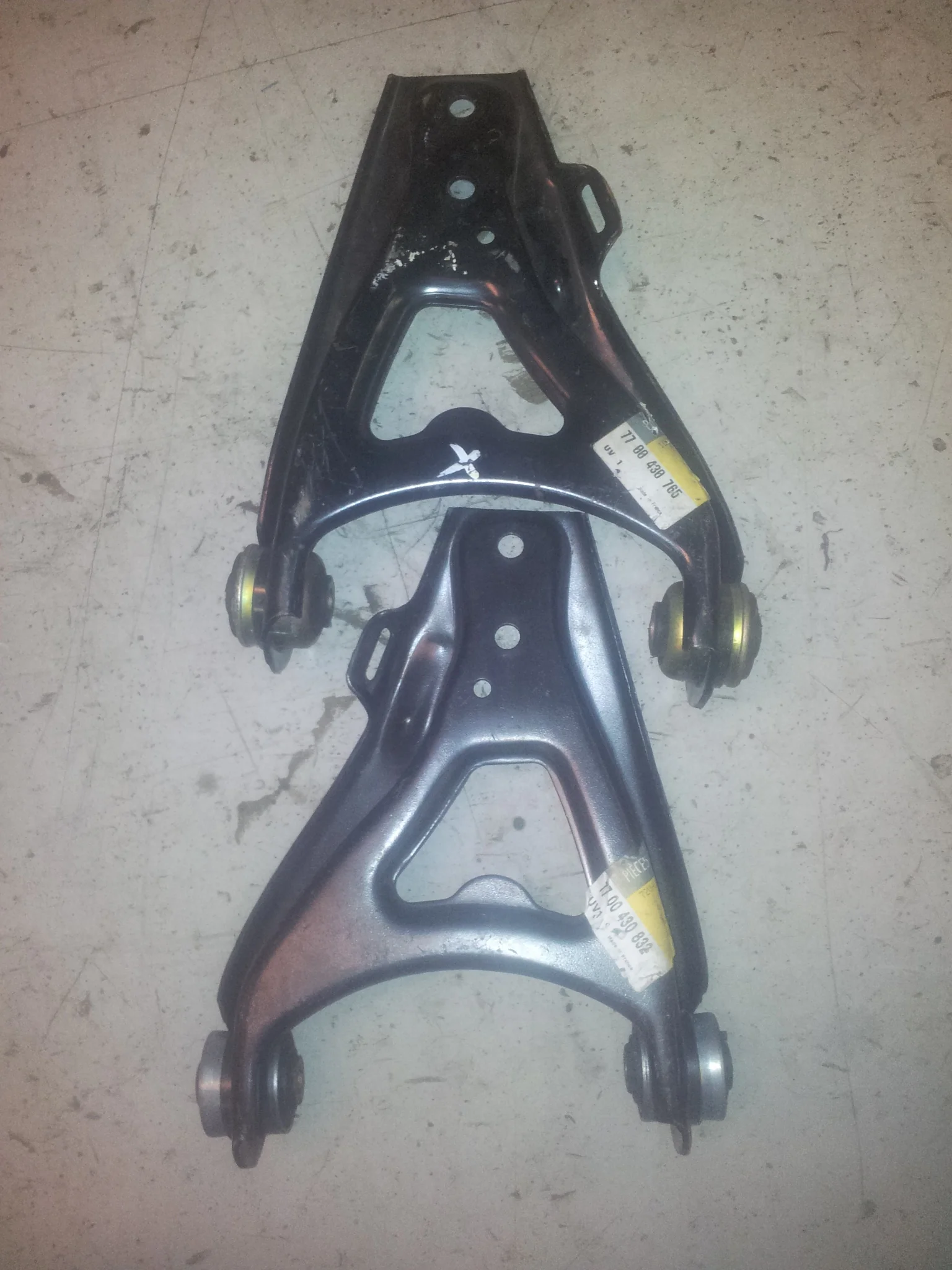

I got them from this picture...
Unless the 0's are 8's?
These look like the ones the cup racer wishbones are made from with the outer ball joint hole in the middle, they have an offset bush welded in on the cup racers to give more castor but the cup wishbones i fitted actually give slightly more overall castor anyway. So IMO buying cup racer ones is pointless, ill be using cup wishbones with pure motorsport rose joint inserts fitted from now on.

Had mine up on the ramps recently and when replacing a balljoint I paid particular attention to this
my 182 WITH CUP PACKS wishbones have the outer hole clearly off-set toward the front (unlike the pics above which look "normal"). So, 182 cup pack is just like the 172 cup ones, as shown in the pics very early on in this thread. Hope that helps.
