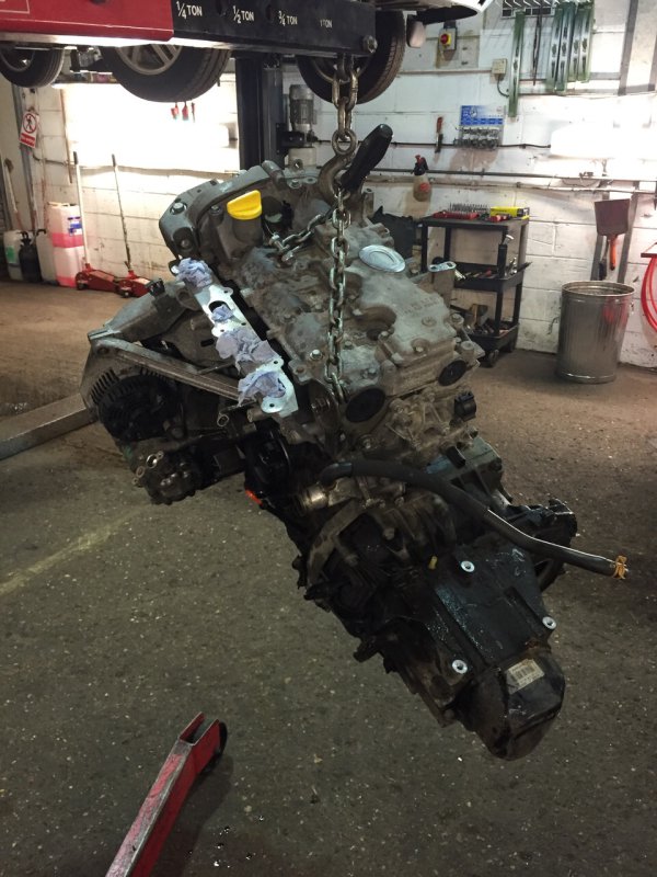

This is it for the year, needs a few bits an pieces sorting out before it's used next.
Big old list to do, main one is the gearbox, it's always had a whine so it's time to sort it, clutch too, needs a cam belt as it's been leaked on from the cam seals, dephaser pulley needs doing as well, plus an oil cooler as it gets a bit warm.

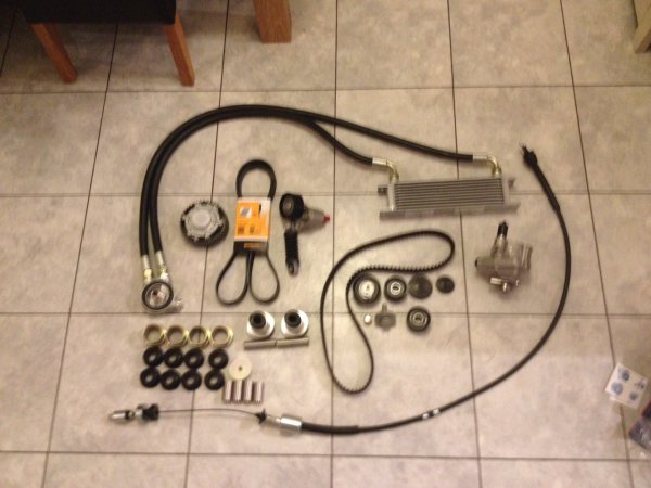

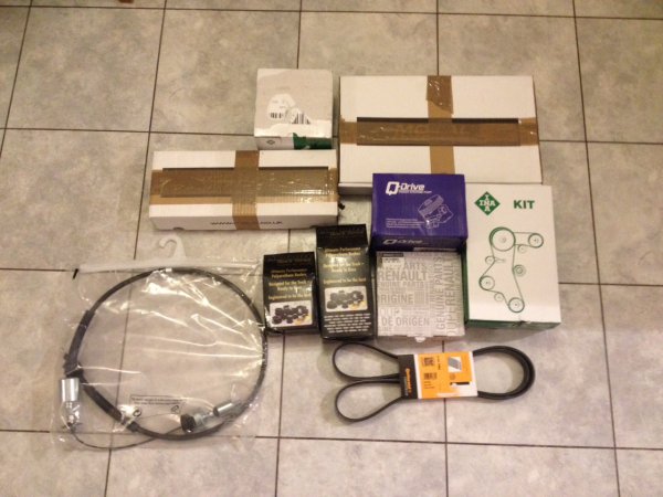

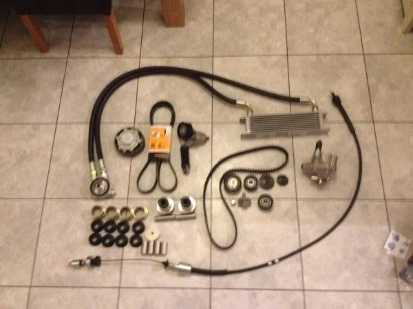

Got a load of bits ordered today;
Powerflex front arm bushes
Powerflex rear beam bushes

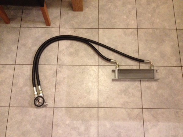

Mocal 10 row oil cooler with thermostatic sandwich plate
INA cambelt kit
New aux belt (again) and tensioner
Power steering pump
New clutch cable
New dephaser pulley
New gear linkage bushes
Got an organic clutch kit sorted too but I want to have a look at it before I decide on that one or not.

Gearbox has been collected by the local gearbox company to be inspected and have anything which is worn replaced.

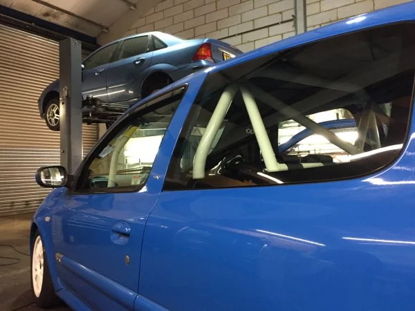

I'm seeing a guy on Thursday about a roll cage, getting some prices and seeing what he can do for me.

Gearbox is done, didn't need anything really but I told them to do the bearings anyway and replace all the seals so it should be spot on for ages now.

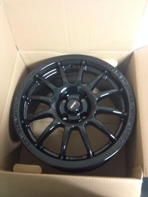

Got some more wheels ordered today, same as the white ones but gloss black, bit disappointed that they didn't have white but they'll do.

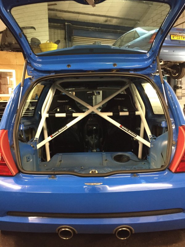

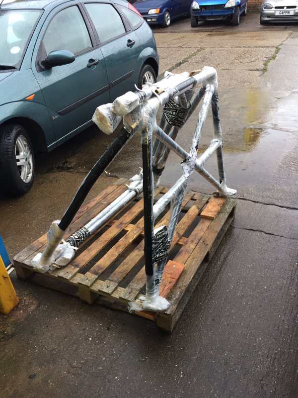

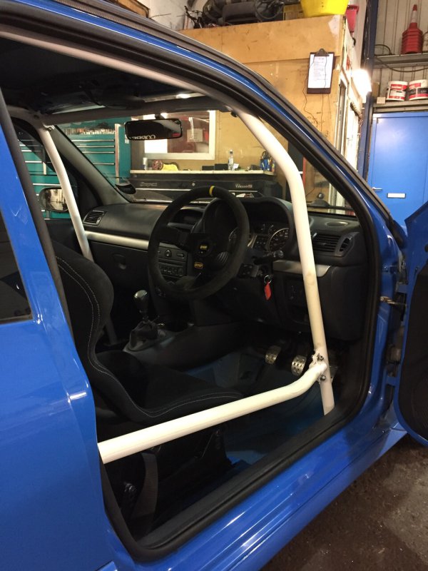

Also sorted a roll cage.
4 weeks today and the car needs to be done!

7x15 ET35, same as the other set.
They don't catch on the arches but they do catch on the spring seats so need to pull some camber out :(

Am I correct in saying Et35 means they are more "flush" to the outside of the arches and an ET 38 will do the opposite? How much are you lowered by? Im thinking of going between 15-30mm
Correct. Not sure on how low it is, it's pretty low but it's on coilovers so it's hard to measure.
Or stick a 5mm spacer in there.
That's the plan but need to convert to stud and nut to do it really
Would I be right in saying an ET of 38 would make your problem of rubbing worse? I just ask as I want to run 15's with no issues.
It would have done, I think it would have destroyed the tyres on the spring seat.

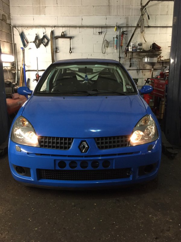

Yep, rear with double diagonal and harness bar, front with single door bars.
Was a few quid but it's worth it!

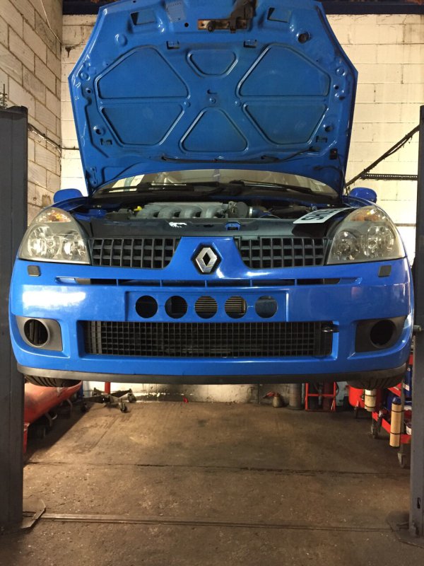

Nope, just had a cracked foglight which was bugging me so removed them both.
Planning on doing something about it next year, it hasn't needed it so far though, the brakes have been perfect.

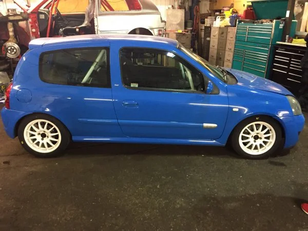

Looks good with the white wheels and cage. Don't fancy the Gordini stripes?

Had the stripes on it when I bought it, I've got used to it now without so I think they'll be staying off.
