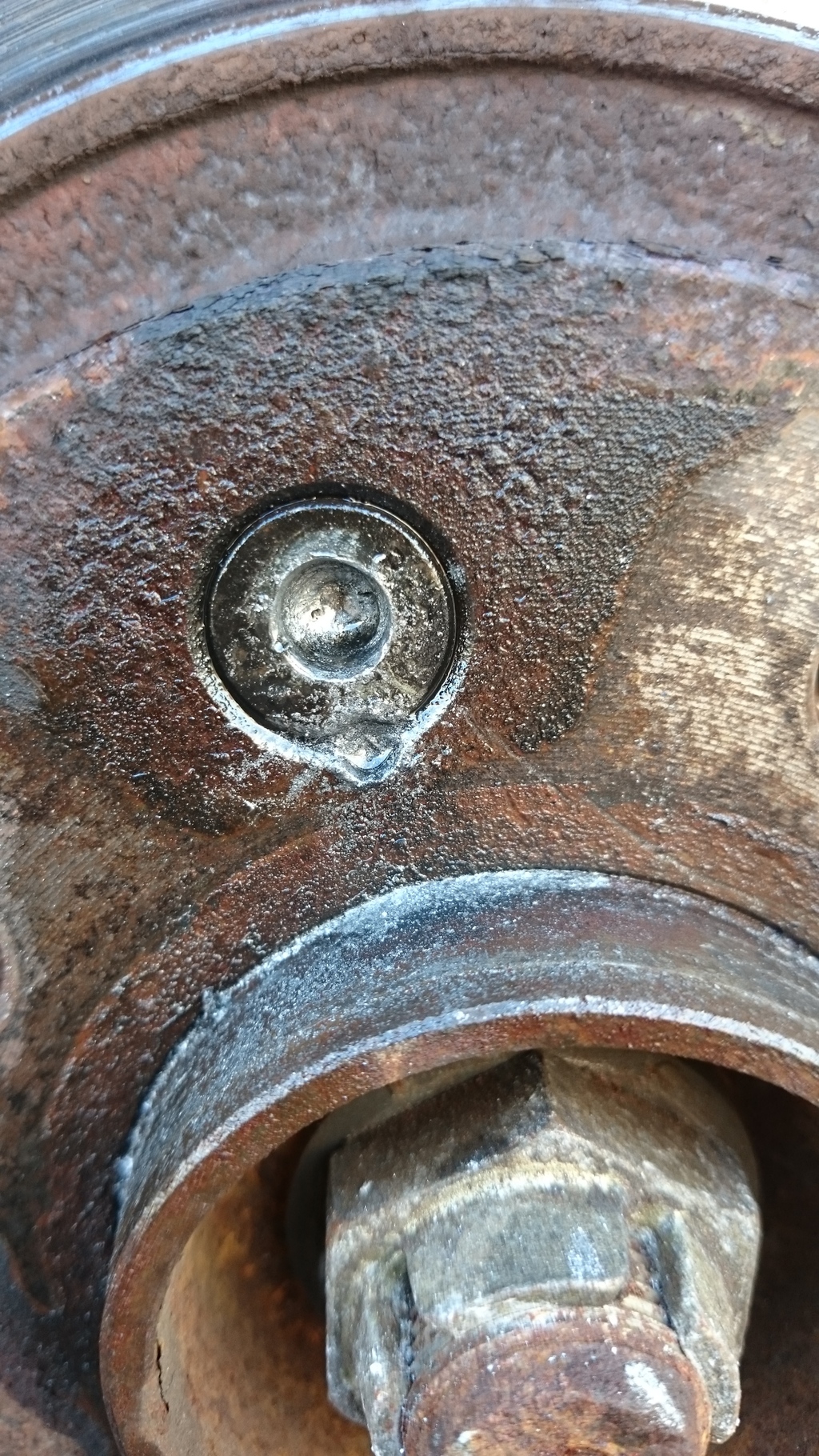

What I want to know is if anyone has any recommendations as to where I can get a decent set of drill bits to drill mine out? Started earlier today & all it's doing it wearing away the drill bits I was using. It did some damage to the torx bolt I was working on just not enough. Any advice is greatly apprecieted.

This is as far as it's gotten -

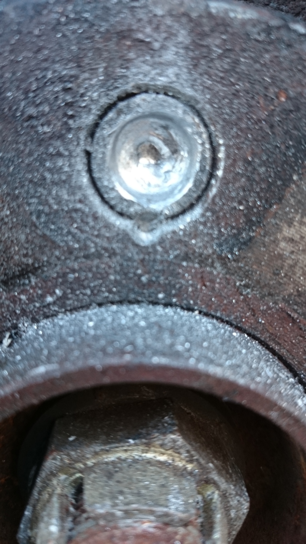

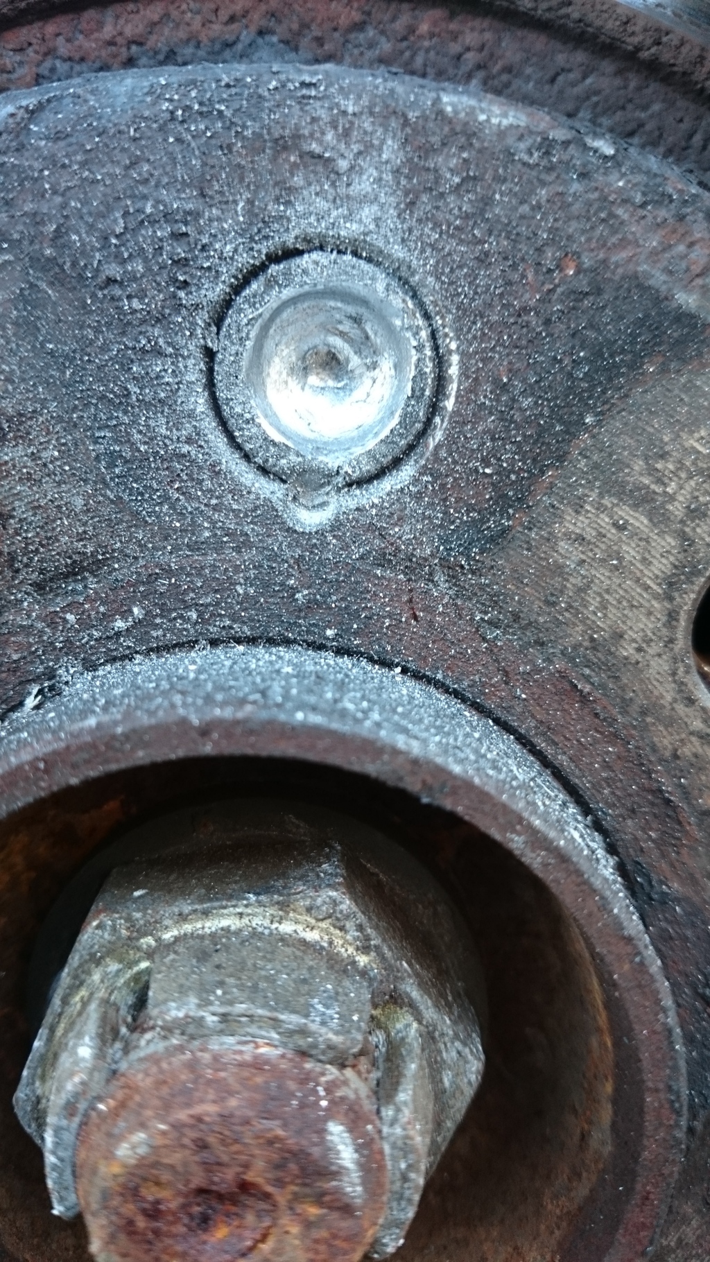

Cut the head and disc like this , keep going deeper , keep checking every now and again to see if you have reached the bottom of the disc as you dont want to cut too much into the hub behind although its not the end of the world if you do strike through the hub.
It will be really easy with an angle grinder.

looking at the pic it looks like you are almost there though with the drilling. How many drill bits have you been through?
Got the angle grinder & it came with a thick grinding disc, bought a pack of thin cutting discs as well. Will tackle this tomorrow & hopefully this will be it sorted now. After I've made the X with the angle grinder should I use a chisel/punch/flathead & hammer it anti clockwise yeah? Some carry on just for a couple of bolts. Any other time it's been a simple change over & none of this.
I've used a few different sized drill bits. Looks like they've got a bit of wear on them now right enough.

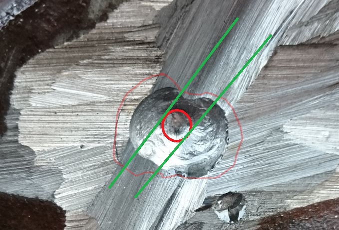

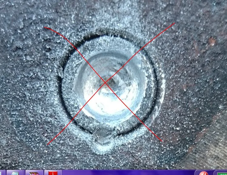

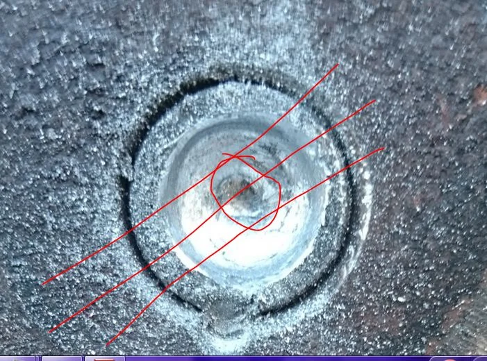

That might be a better way of cutting, you basically want to keep digging at the red circle which is lowest part of the bolt head.
Will do cheers mate.

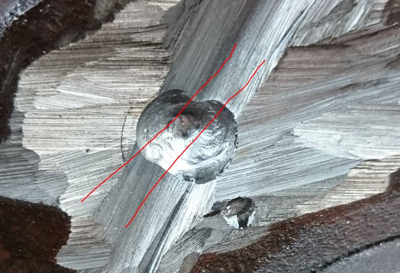

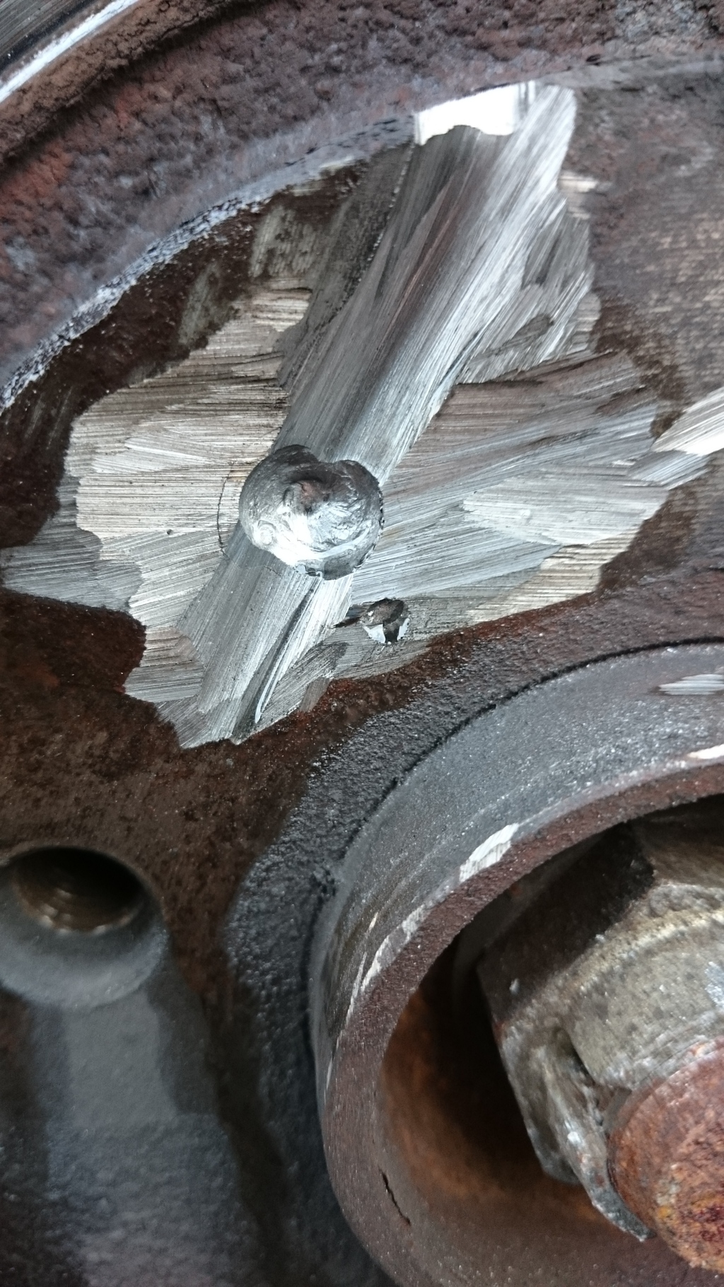

This is as far as I'm getting with the angle grinder, been at it for about 15mins. Any ideas toow long I've got to go? I've still another 3 torx heads to do after this
Crybert
  Cup 172
These wee bolts usually shear quite easy. I'd be smacking that disc with a hammer behind it. Reckon the bolt will shear then.

That screw head has gone, hit it from behind with a hammer

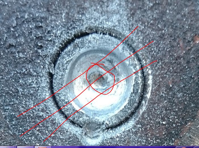

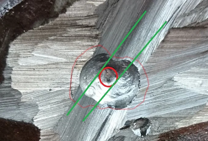

You just need ot go a little deeper, cut this:
keep going, no need to spread the cuts as much.
Once you have done 1 you will be able to do the others really quickly.
Gus
  182Turbo,DCi90
thin red outline is the bolt, you can see you have made it about half way, just push quite hard and cut between the green lines. you are almost there.
