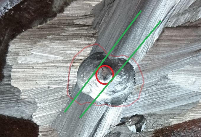

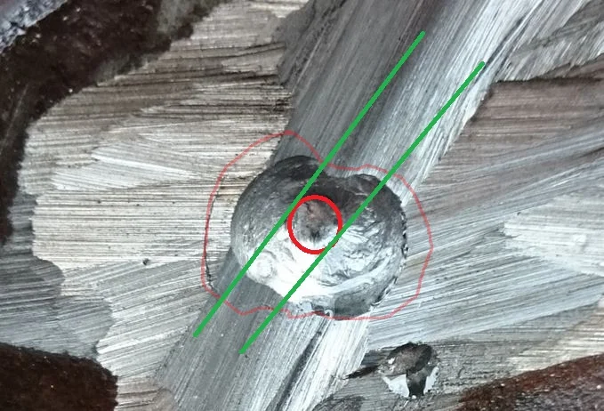

thin red outline is the bolt, you can see you have made it about half way, just push quite hard and cut between the green lines. you are almost there.
I managed to get this one sorted just after the picture was uploaded. Tried smashing off with a hammer but the other torx wasn't breaking up. Started to grind the other bolt head down before I decided to leave it for now.

You told us you don't have a a dremel tool or a blowtorch. And forgive me if I'm wrong but it looks like you've just drilled and grinders the hell out of it. The first method I suggested sometimes fails. The second rarely fails. From your last pic, I'd assume you're close to needing a new hub assembly (something that will add to your wallet pains). Again sorry for being patronising.
