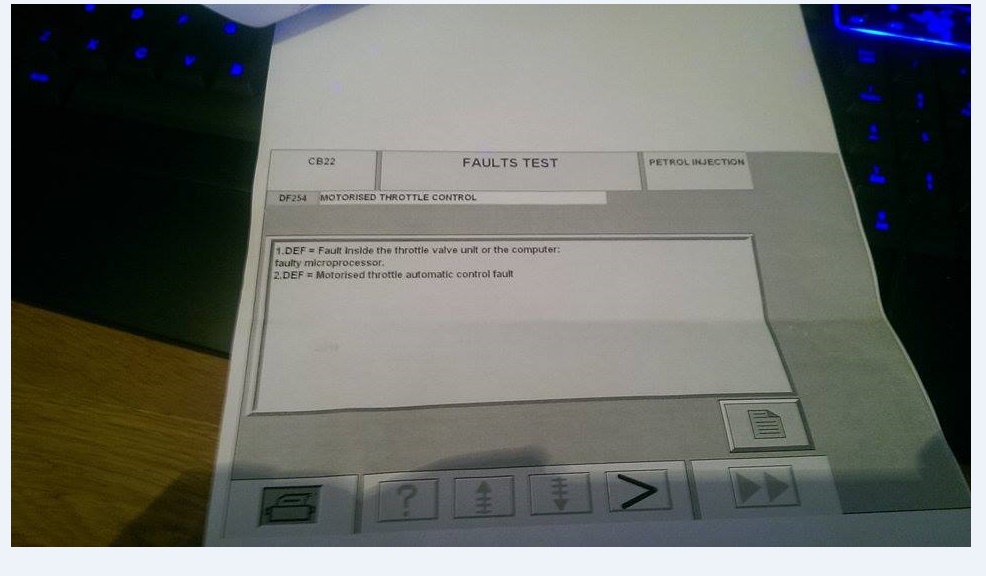

c8381c34d1.jpg just got home this is what they gave me, cost me £85 f**king rip off never going to renault again

So they've got a DF254 out of '120 but no sub-code and are condemning the throttle body? Damn, I wish diagnostics was genuinely that easy!
Just gonna leave another one here: That is 100% a wiring fault
