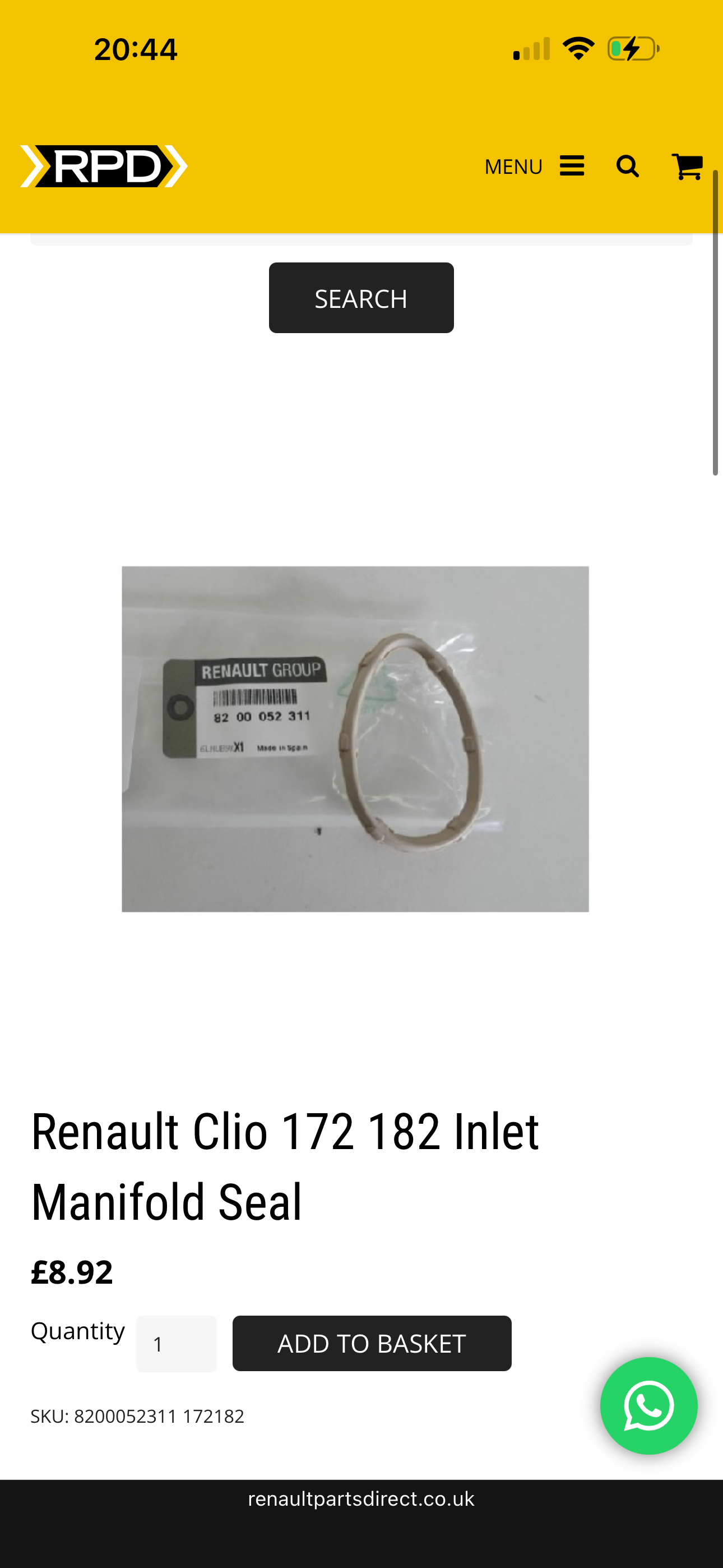

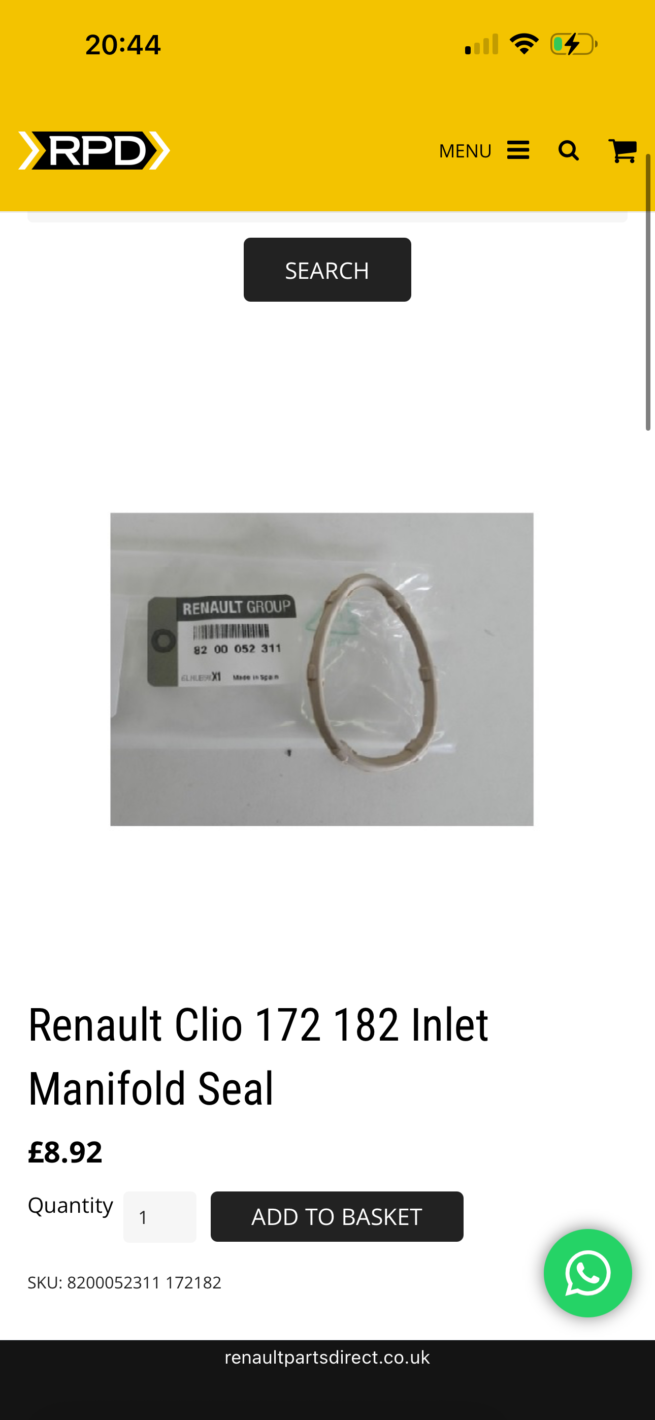

I've never changed it; in fact, looking at it now, I'd say it's either worn out or there's hardly any trace of it left from the times I've taken the manifold apart... because I don't remember seeing it so exposed as it is in the photo.
For the sake of a very little money it’s probably worth getting.

Yes, you're absolutely right. As I mentioned, I have the large one that goes between the two parts of the intake manifold, and the one in the photo has never been changed; they're the original ones from the car.
Yep, the upper inlet manifold gasket is a piece of cake to change. You will struggle with the lower inlet to engine manifold as there are some awkward bolts to remove as far as I remember.
