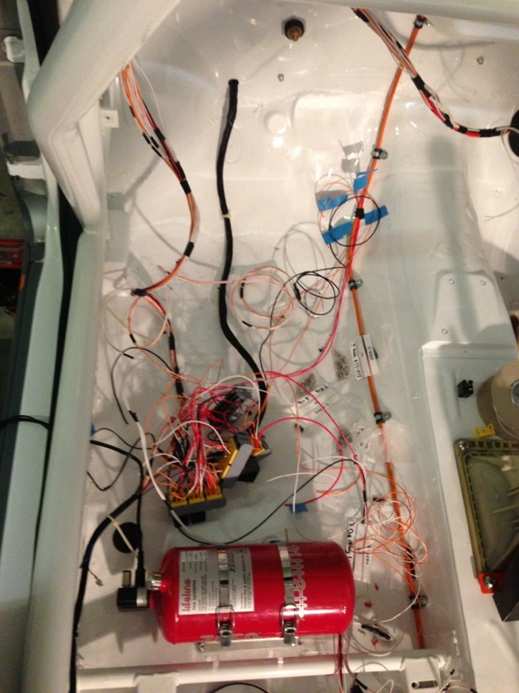

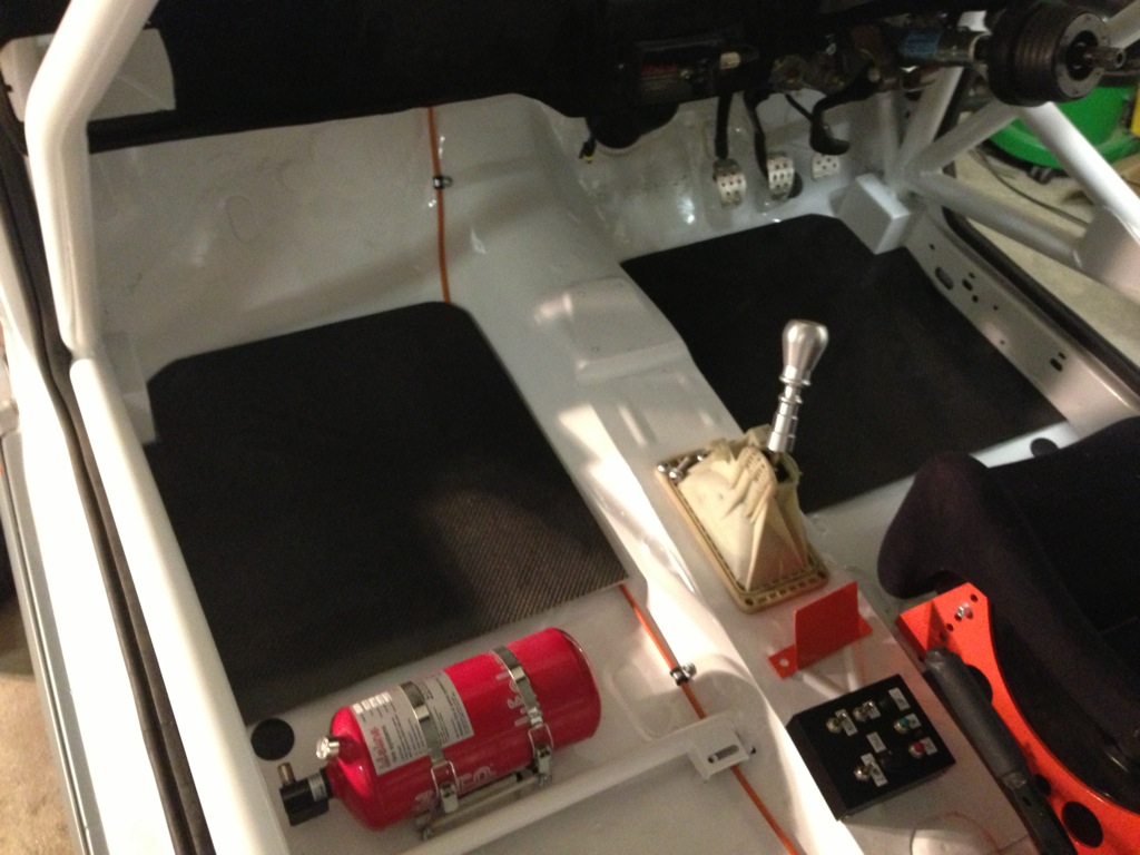

Massive thanks to Ian at Godspeed brakes he sent the fixed calipers back to me earlier this week which was very good of him so thanks for fixing them. I am still waiting on Demon tweeks delivering the double locking bleed valves just so that I don't put any future wear on the seat of the hole but these are due for another week.
On other area's Jay very kindly came up to help me with the wiring last week and we had two full days on it and made really good progress. Not only did he do alot of the work but also showed me how to do it and also how to fault find so I have a much better understanding of electronics now :) Unfortunately since he left I haven't got much done as i've been too busy but I made another order of bits the other night so Monday I will have all the remaining bits I need to finish it and then will try and get it finished. Then it is just a matter of me fit the calipers back on, Get the bulkhead and steering wheel autosport connectors fitted for me and then ready for mapping at RS-Tuning and shakedown. Plan is to do the race at Brands on the 6th May so I better get a move on as the entries close in 10 days!

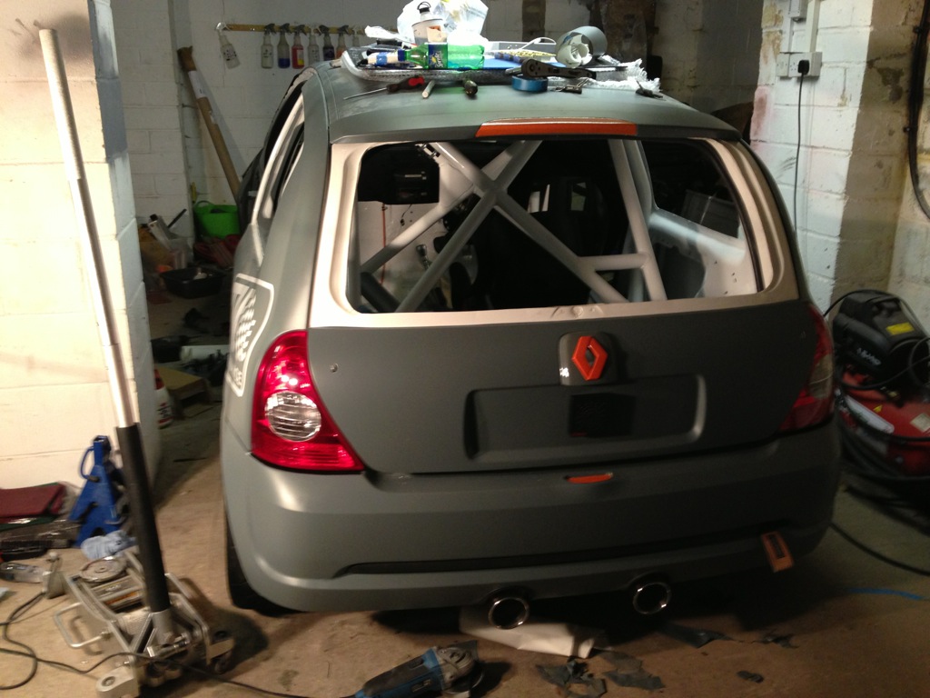

Wrapping the new panels complete

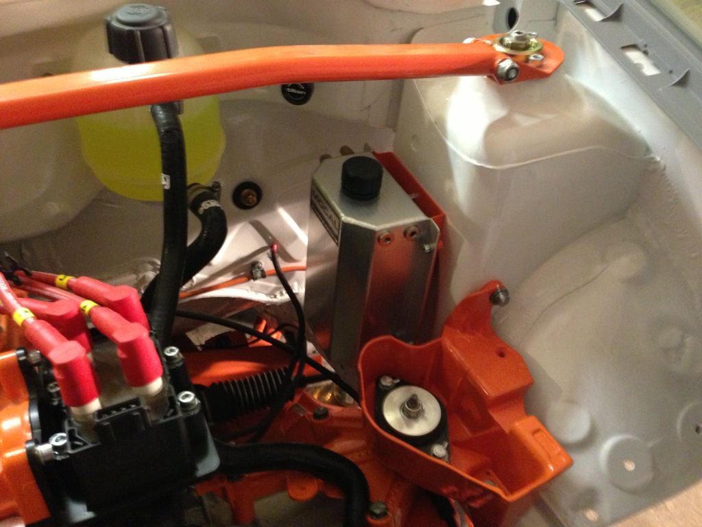

New catch tank mount

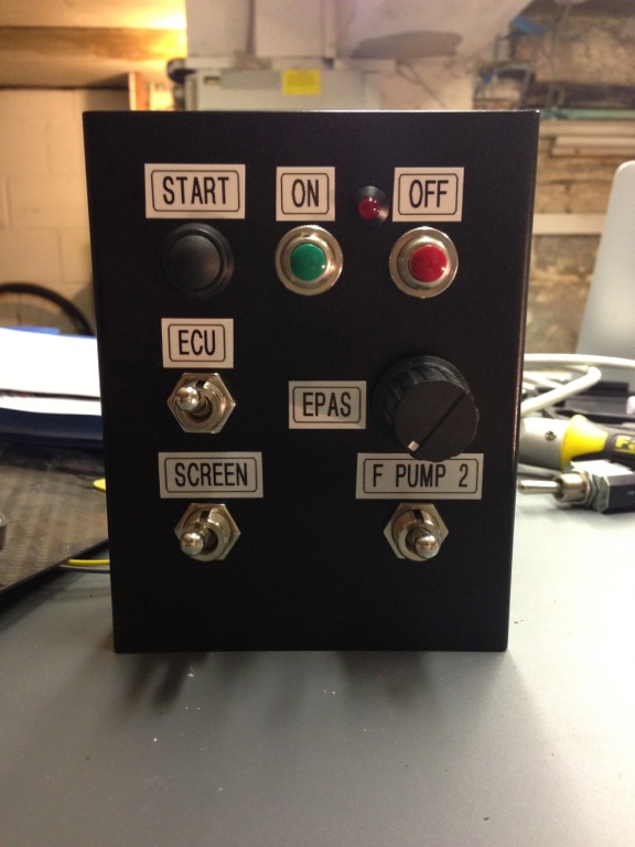

Bracket made to hold the switch panel for all critical functions
Switch panel

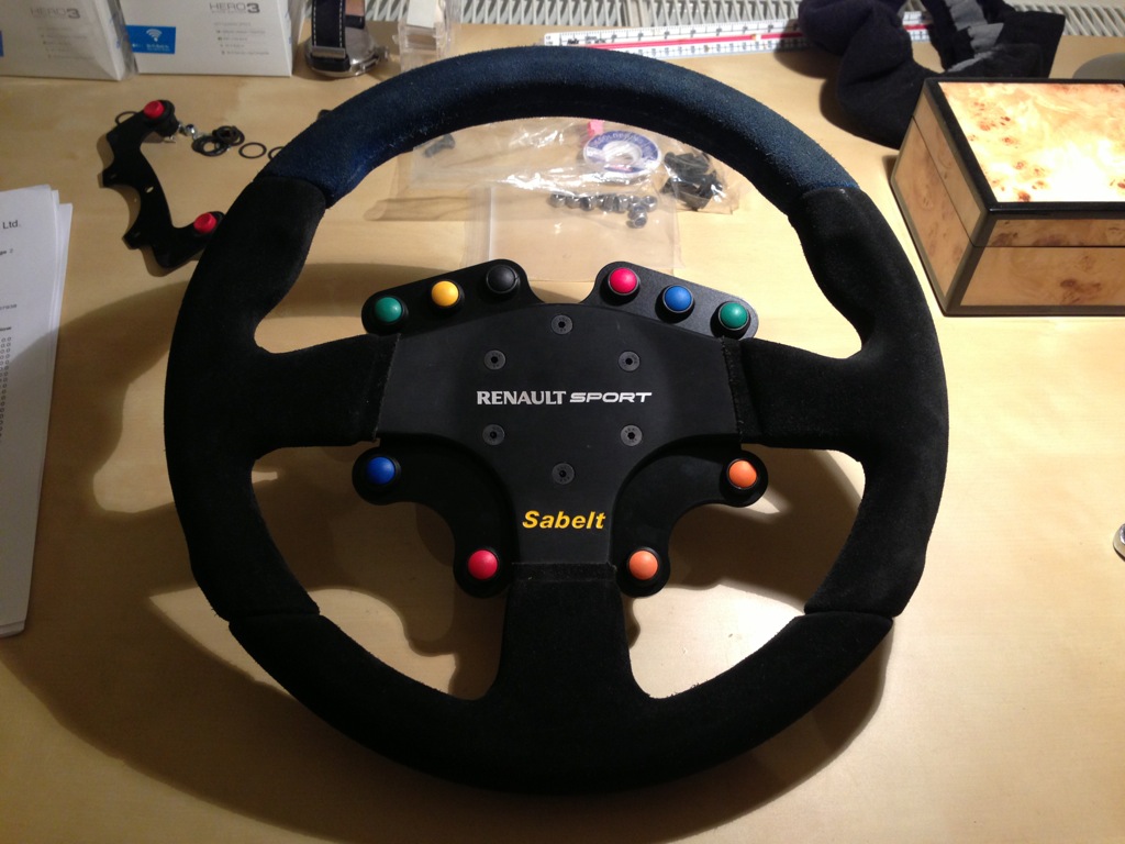

Steering wheel housing all the auxiliary switches

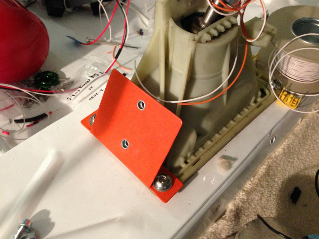

False floor to mount the electric components to the floor to keep them out of the puddle that normally fills up
The wiring so far

out of curiosity how did you mount the carbon floor plates?
Thanks Neil, I haven't actually mounted them yet but will be rivnuting the floors and then making standoff's and then bolting through.
