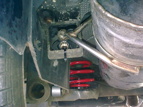

Wondering if anyone can help, recently purchased some vmaxx coilovers, only a couple months old and since I've fitted them I've been getting a banging noise from the rear when I go over bumps, I thought it could be the shocks bottoming out so I raised the car slightly, still the same.
Could it be the bushes/washers that vmaxx supply are actually crap or could it be the rear spring is actually too soft, as when I look underneath the rear spring looks fully compressed
If anyone can shed any light or give some advice it would be greatly appreciated

exactly, top 3 coils are touching however there is a gap between those and the bottom two coils
Jekyll
like this?
  ITB'd MK1
have you fitted the original rubber on the top of that spring? can't see it in the picture.
that spring doesn't look quite right, but a lot of the kits that mount like this do similar

mine are coiled up aswell and its not even sat on the floor,
its still on axel stands, tbh the springs are not that good,
but as soon as it was back on the deck, with wheels back on
they coiled right up tight,
just like dr jekyls

I had two sets of vmaxx on my ph1 172 and they never looked like that, really strange

That doesn't look right to me, my old v-maxx didnt look like that, I just went out and had a look at my k-tec coilovers
and they don't look anything like that, but I guess it could be that there a different spring.

My old V-Maxx kit didn't look like that at all.
I never had any knocking/banging from the rear. Only the top mounts made a bit of a creak.

have the exact same issue myself mate but no cure i made a thread not long ago on all the things i checked. and when i was in jamsport getting the geo done he mentioned the rear being like that and mine looks just like yours.
if there is a way around it id love to know. i was thinking of getting different springs but dont know how that would work?

was just wandering if your springs look like that but they dont. i know marcushookdale had a similar thing problem with his.
i havent got my top rubber in on the spring but i have not had any knocking noise.

Just wondering if they are a progressive spring which means they have to be instaled in the correct orientation, I've been looking at the instructuctions that cam with my B14's and they show the adjustor at the top, and the spring can only locate one way,wider coil spacing at the top/closer at the bottom.

I'm pretty sure they've changed something tbh. I dont remember the springs being like that before and I've fitted a fair number. Will ask the question with the supplier
